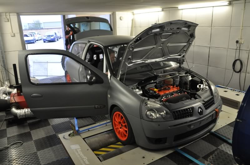

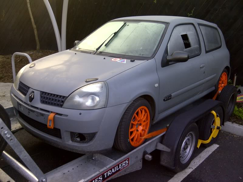

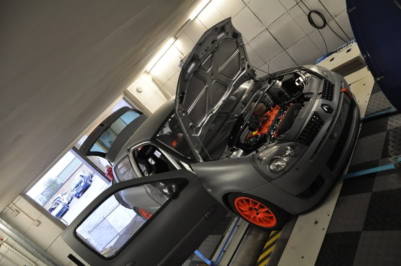

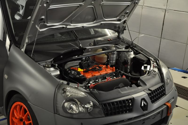

So Tuesday saw us venturing to Brands Hatch for a track day in preparation for the first race there on the 7th May with the CSCC Tin Tops. I started out on Monday morning heading down towards TDF and en-route had to collect the Timing transponder from Tamworth, a trailer part from BJT Daventry and a couple of bits from GPR Silverstone. I got to TDF at about 2ish and had a good look round the car. As always the TDF boys gave great hospitality and made me feel very welcome. As per usual when I'm down at the workshop I try to give a helping hand although this does always slow them down so thanks for taking the time to explain everything to me. We then got the car on the dyno just because Matt wanted to give it a run and make sure everything was okay as we can't now drive it on the road. Everything was fine and I have put a video at the bottom from when it was on the dyno. We then packed the car onto the trailer and we headed down to the pub for a bite to eat which was very nice and was good to have a chat with Matt and Al as it always is. They both really are top guys and can't thank them enough for everything.
After our trip for dinner, I headed off down towards Brands Hatch and collected a friend who was going to help out. Managed to choose what seemed like a safe parking spot to leave the car and trailer for the night and then proceeded to bed. We stayed at Premier Inn at Swanley (10 mins from circuit) it was a great place to stop for the night and at £38 we couldn't grumble.

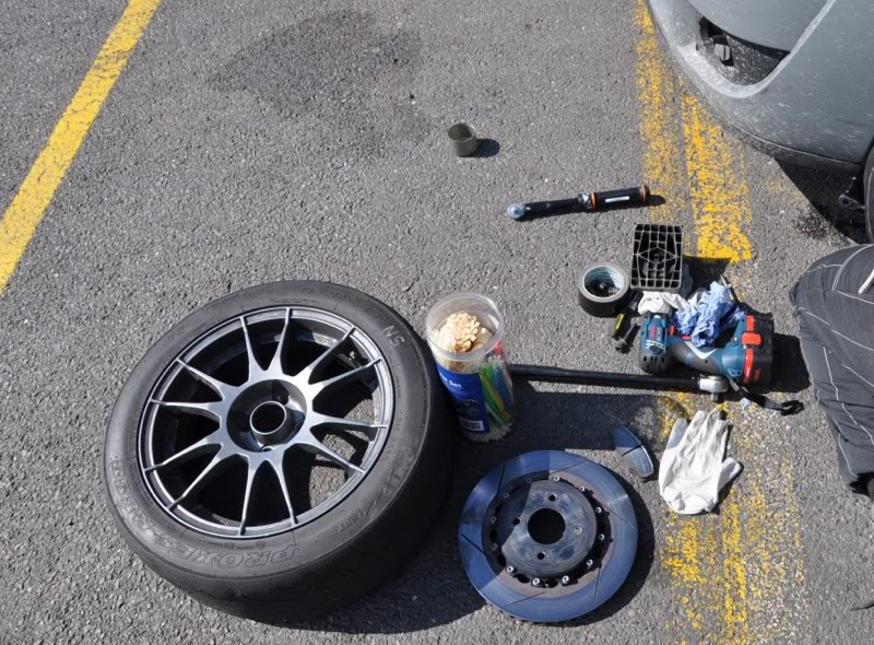

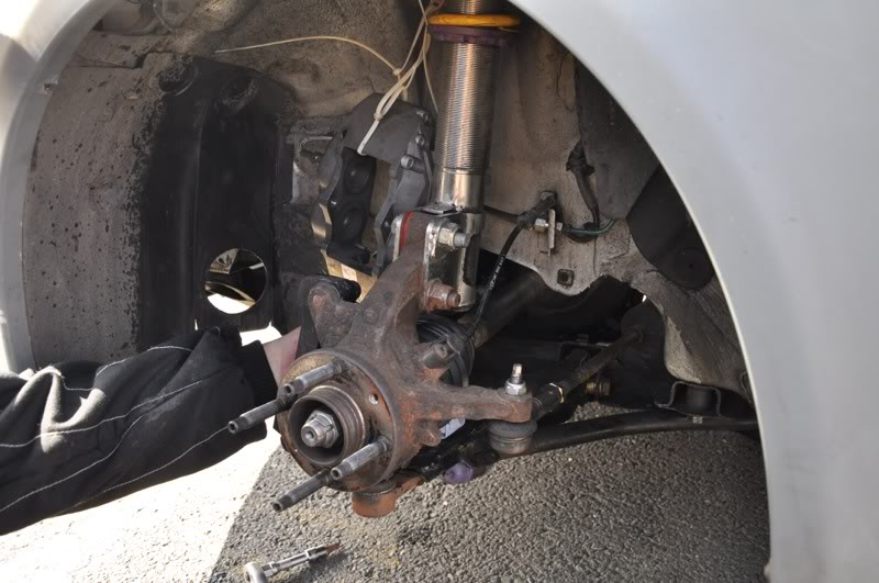

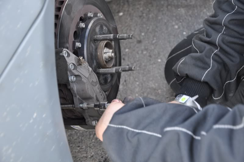

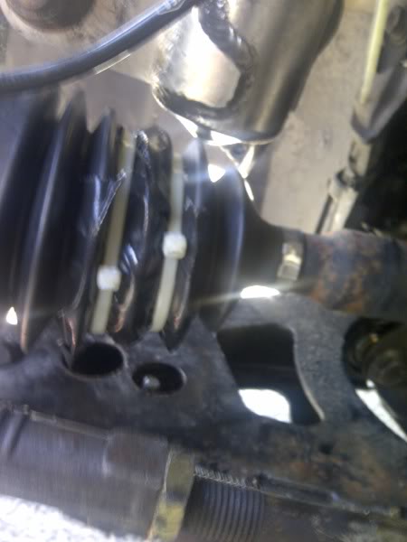

Got to Brands at 7.30 to be greeted by a very busy Paddock which was a shame as I was hoping to get a garage but anyway serves me right for been stingy and not reserving one. Went to meet up with my instructor Howard Hunt who was going to be with me for the day and proceeded to briefing. We then had to do the mandatory sighting laps and then we were good to go. Started off by doing a few laps just to warm the car up and to get a feel for the track as I had never driven here before. On the third lap coming into Graham hill bend we had the PAS fail again. We came straight into the pits and I was expecting to see similar to Anglesey with a flood of fluid everywhere but it hadn't. I checked the tank and it was still full although some had escaped from the breather. I called Matt who said unfortunalty some debris from the old pump must of got stuck in the rack valve and causing it to happen. He told me to go around the paddock and get plenty of lock to lock and try to free it and sure enough this worked. We went back out but it became an intermittent problem. PAS lasted a couple of corners and then failed for a few and then came back so it was a handful to drive. It then started to become better and last a few laps and gradually lasted longer and longer. After about 15 minutes we came in to check on the tyre presures etc when my friend noticed a small few drops of PAS fluid in front of the front wheel. This is where the breather had been blowing some out. I took the wheel off to mop it up and was greeted by a wheel arch full of grease. It became apparent that we had an issue with the CV joint although this was the one that was only changed 3 hours (Track hours) before. My total mechanical noobness showed through and I didn't have a clue what I was doing but got stuck in and after about 30 minutes of cleaning up I found a hole in the CV boot which had visibly been caused by a manufacturing defect in the boot upon very close inspection. At this point yet again I thought it was game over just when it seemed that the PAS issue was manageable. Matt called me up and suggested some race tape and try to cover the hole, unfortunately I didn't have any but a team with a radical gave me some very kindly so I stripped down the NSF to gain access. This involved calliper and disc off which doesn't sound much but I really am useless with mechanics lol. I then managed to get the hole covered over with tape and then secured it in place with cable ties to ensure it didn't come flying off. After sending a photo of my repair (Which i'm really proud of
) to Matt for his approval, I put everything back together and then went for a drive round the paddock to try everything out.

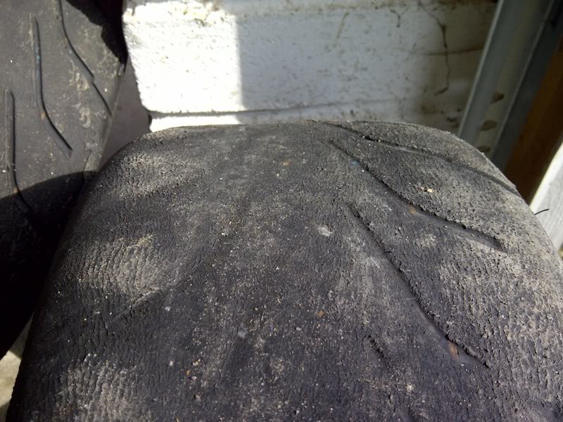

Tyres definitely ready for a change

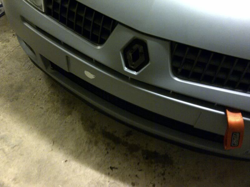

Unfortunately damaged the wrap when taking the number plates off but it will get covered by stickers anyway
