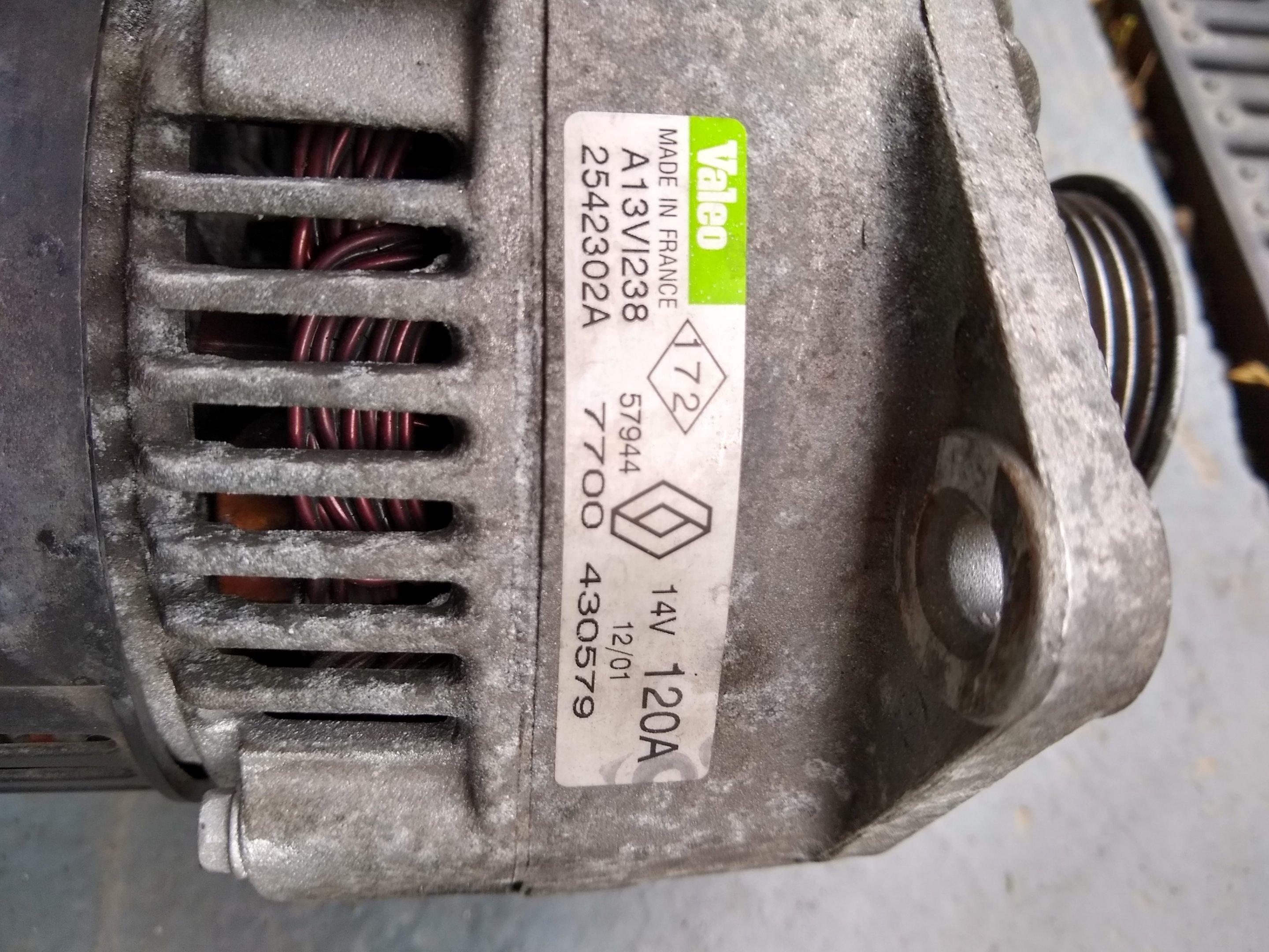

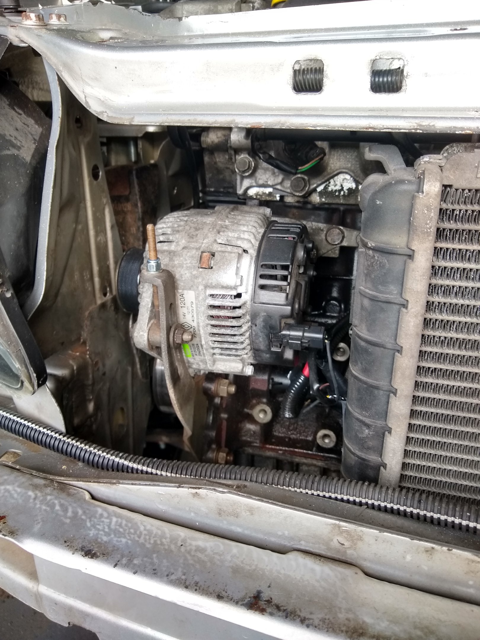

Over the last few months I have deleted my ac and carried out the epas conversion. To get rid of the two pulleys I decided to run the cup alternator conversion by using Volvo 340 parts. My only option was the 75amp cup alternator, but it seemed silly running the epas conversion that uses more ampage then running a smaller alternator. My car is a FF Clio 182. After much ebaying looking at images and cross referencing part numbers I found a 120amp alternator that fits.
bigfella2
  FF Clio 182
According to the eBay advert it's of a Clio MK2 ph1 1.9dti with a/c. I believe the non a/c version uses the 75amp cup alt. But pretty sure it will be used in other Renault's.
