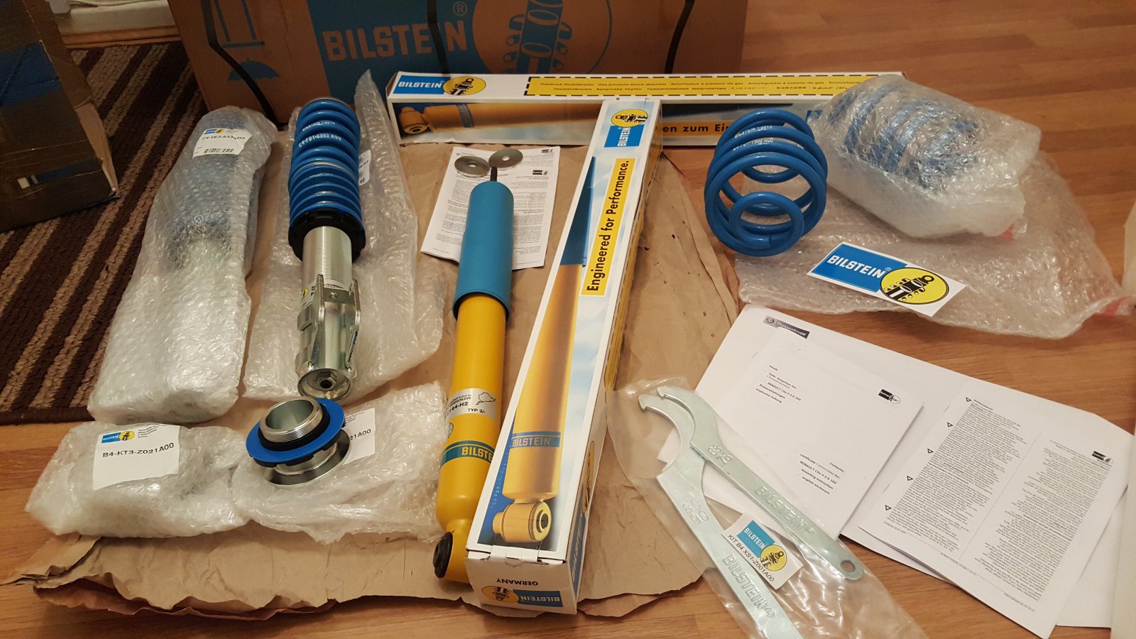

Use Google chrome and right click translate each page. Make sure you know your bolt spacing (60mm for trophy) below are the ones I got which are 54mm ones.
Absolutely top quality company and fast delivery.
mk-fahrwerkstechnik.de
BILSTEIN - B14 PSS Gewindefahrwerk für RENAULT CLIO II (BB0/1/2_, CB0/1/2_) 2.0 16V Sport (CB0M) / 47-087750
Menge: 1 | Art-Nr.: BB14.00302
