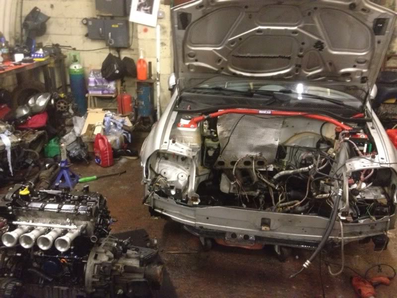

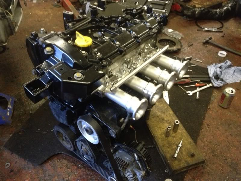

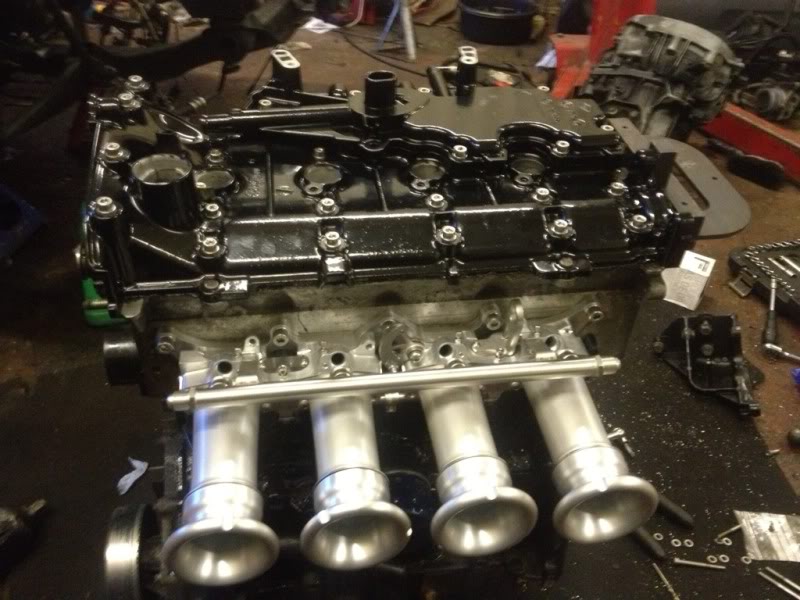

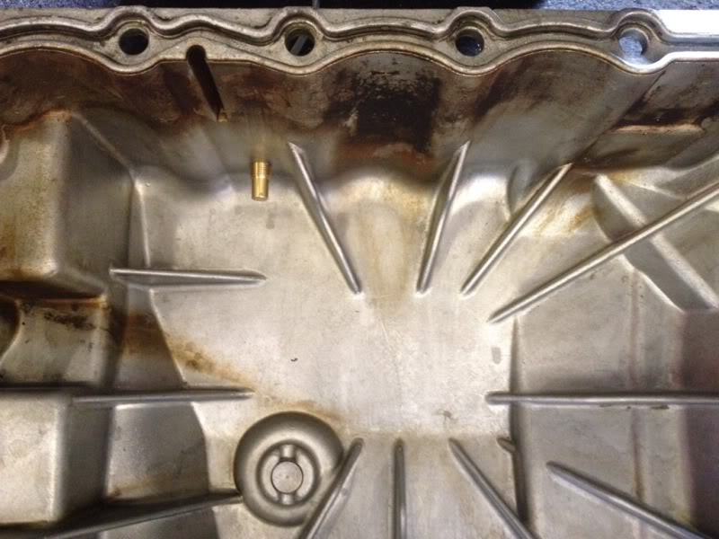

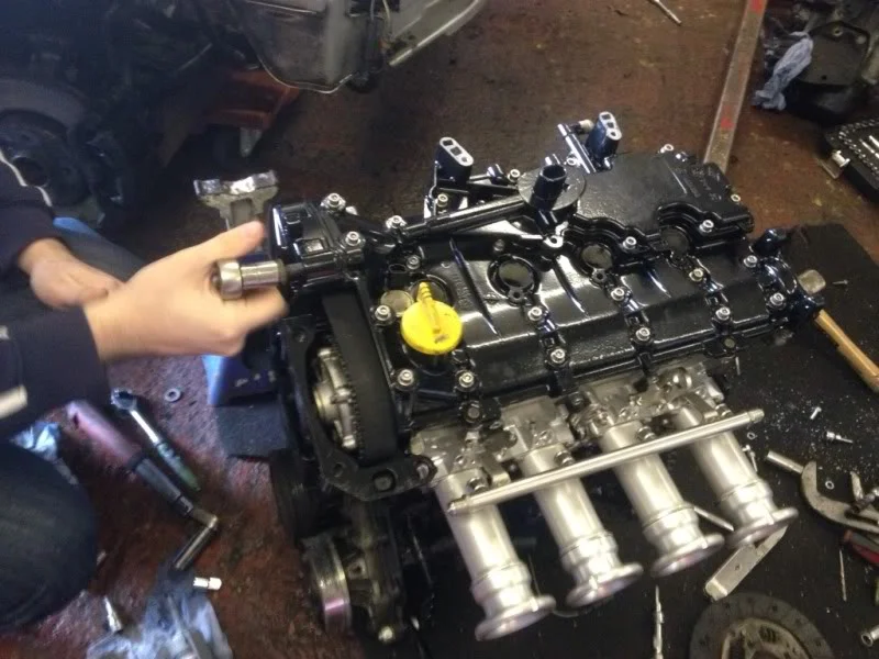

Quick little update!

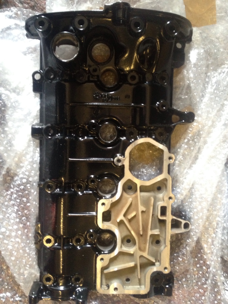

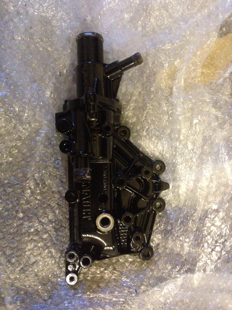

Got a load of parts powdercoated. Looks much better than stained oilly Ali.

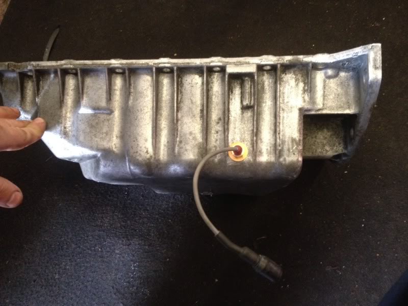

Had the sump cleaned and drilled and Tapped an SPA oil temp gauge sender into it.

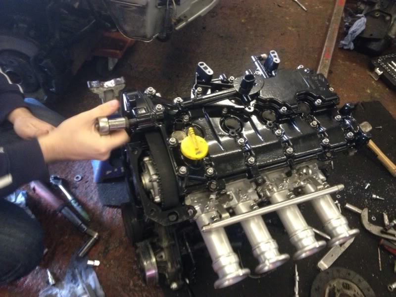

I put the 438's in today and replaced the rocker cover bolts for some stainless steel cap heads to keep it looking clean and bolted the bodies on.

Looking good so far mate. Shall I bring some dirty clothes up to give you a hand Monday evening?
Or are you going to be onto clean stuff like mapping by then anyway?

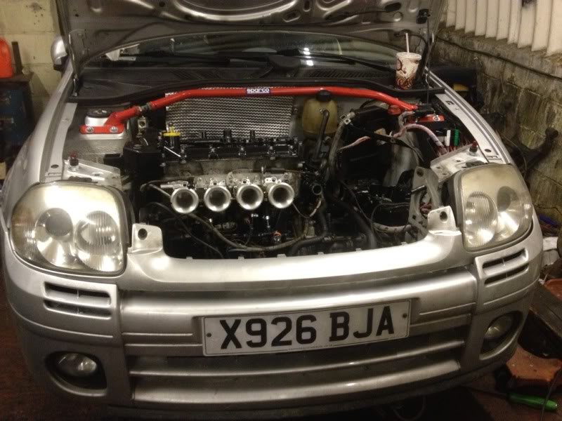

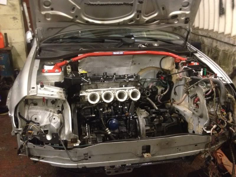

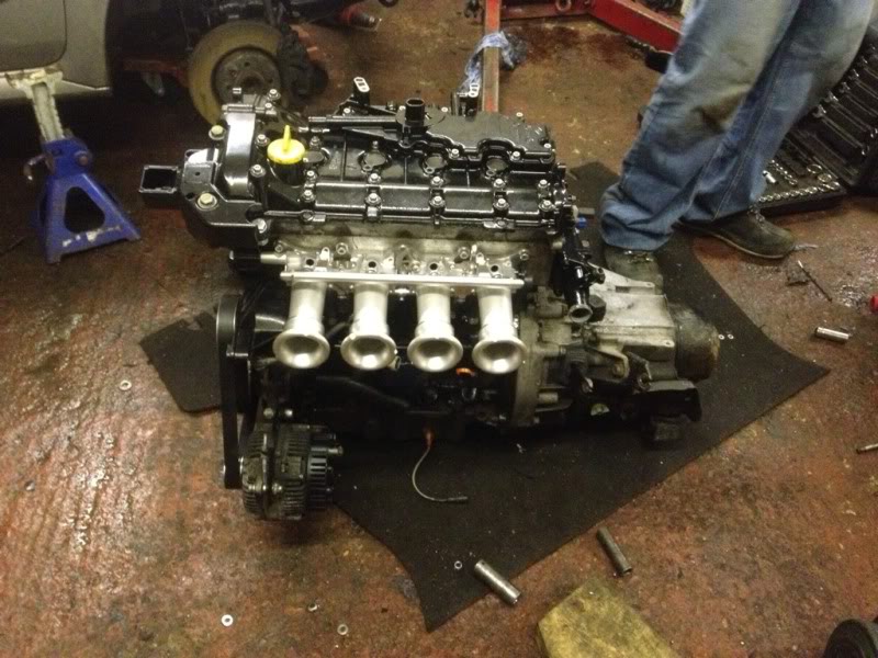

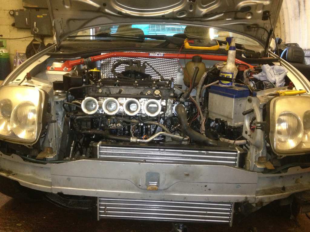

Quick little update,

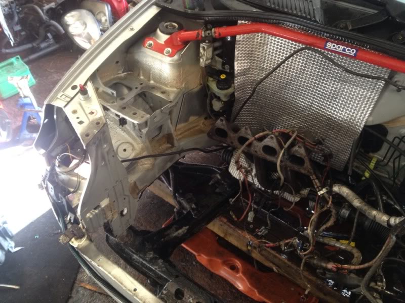

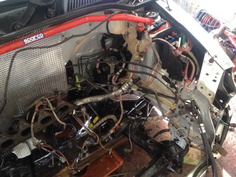

pushed the car outsise and steam cleaned out the engine bay.
Put the cambelt and all the other bits and bobs back on the engine ready for it to go in.
Then
Then dropped the engine in the whole :)

When I left him he started work on his car , all I can say is when I want more mods done he the man to call , top work
