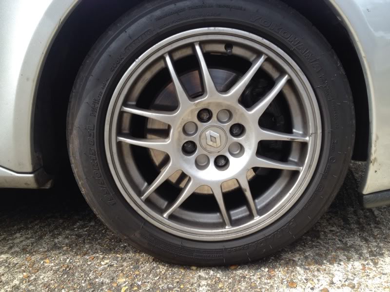

Yokohama Prada Spec 2 tyres

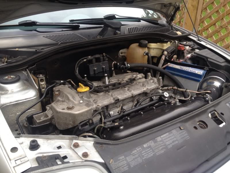

Heres some pictures:-
Cams going in

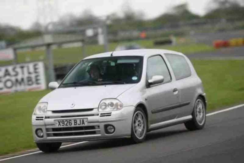

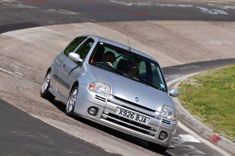

At the ring

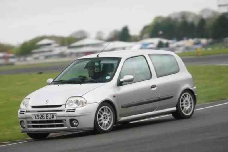

Castle Combe spring action day

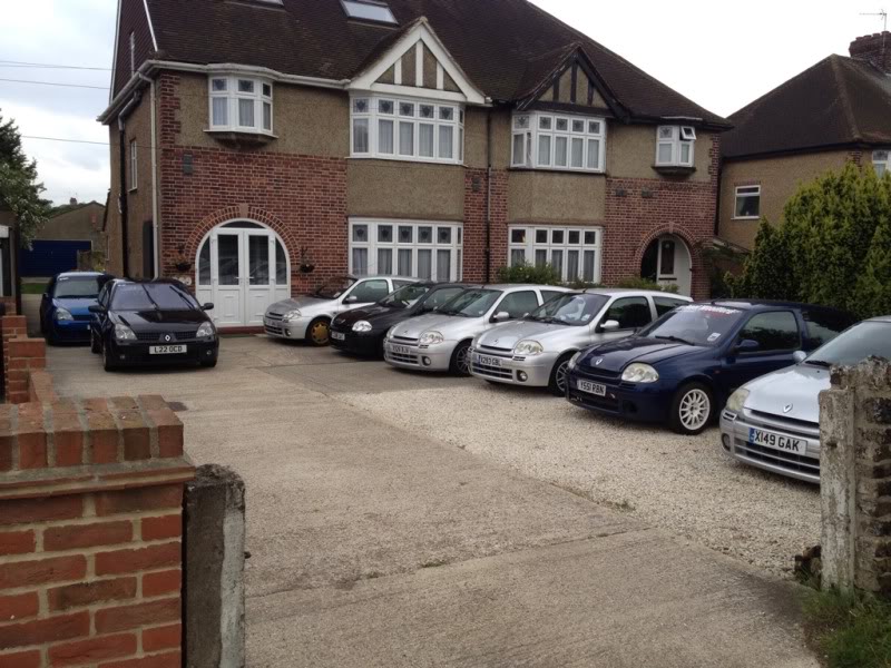

The state of my house a couple of months ago :)
I was really really happy at the compromise between comfot and handling. The cup dampers and Eibech Sportlines are a fantastic fast road set up.

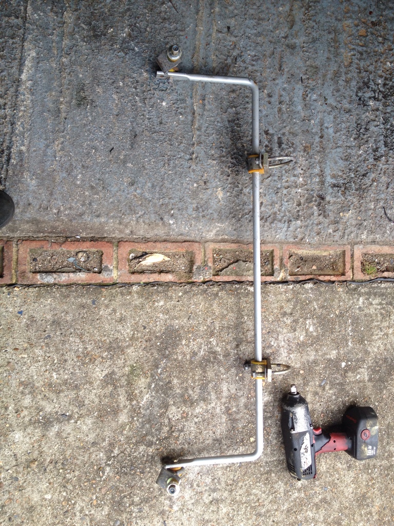

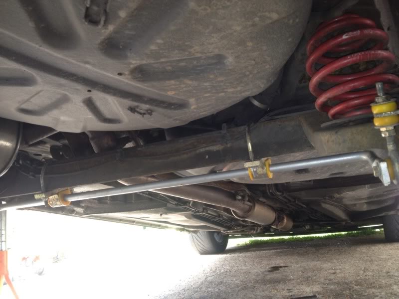

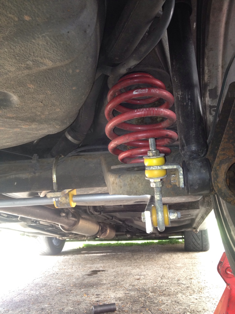

Started with a 2nd hand Whiteline rear anti roll bar.

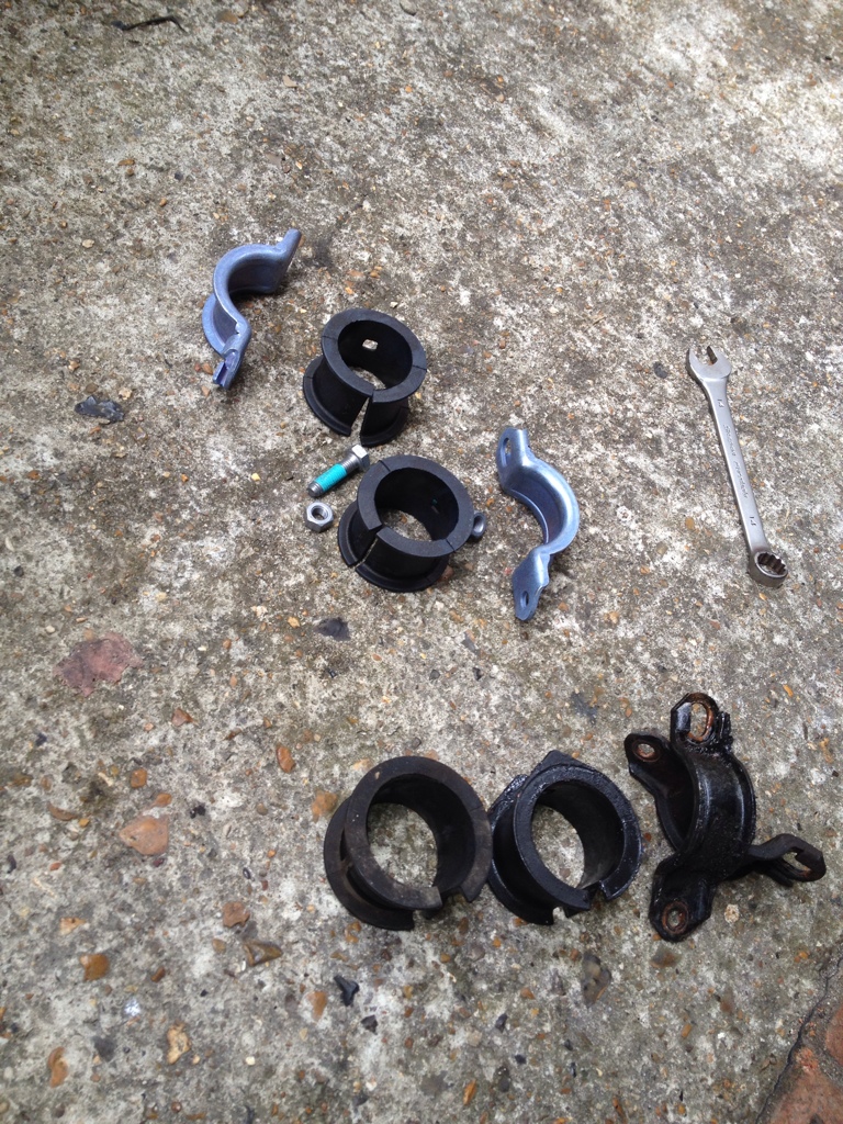

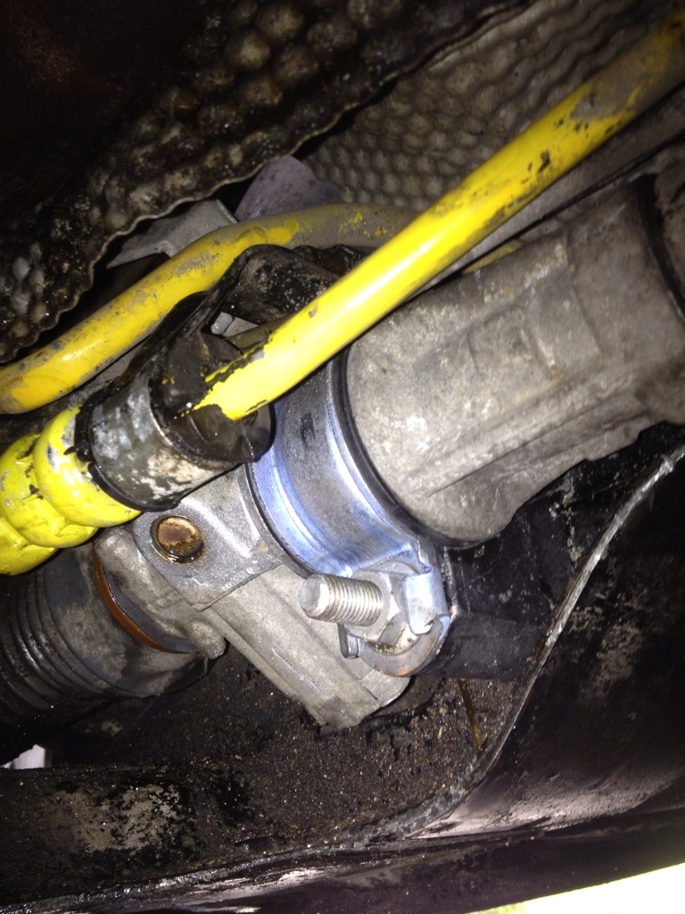

Then I replaced the steering rack mounting bushes. These are starting to become a problem on many 172's. They don't affect the grip as such, just make the steering feel really vague.

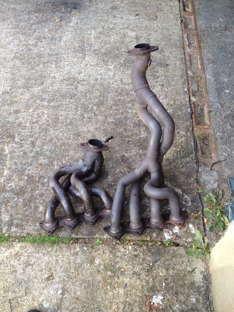

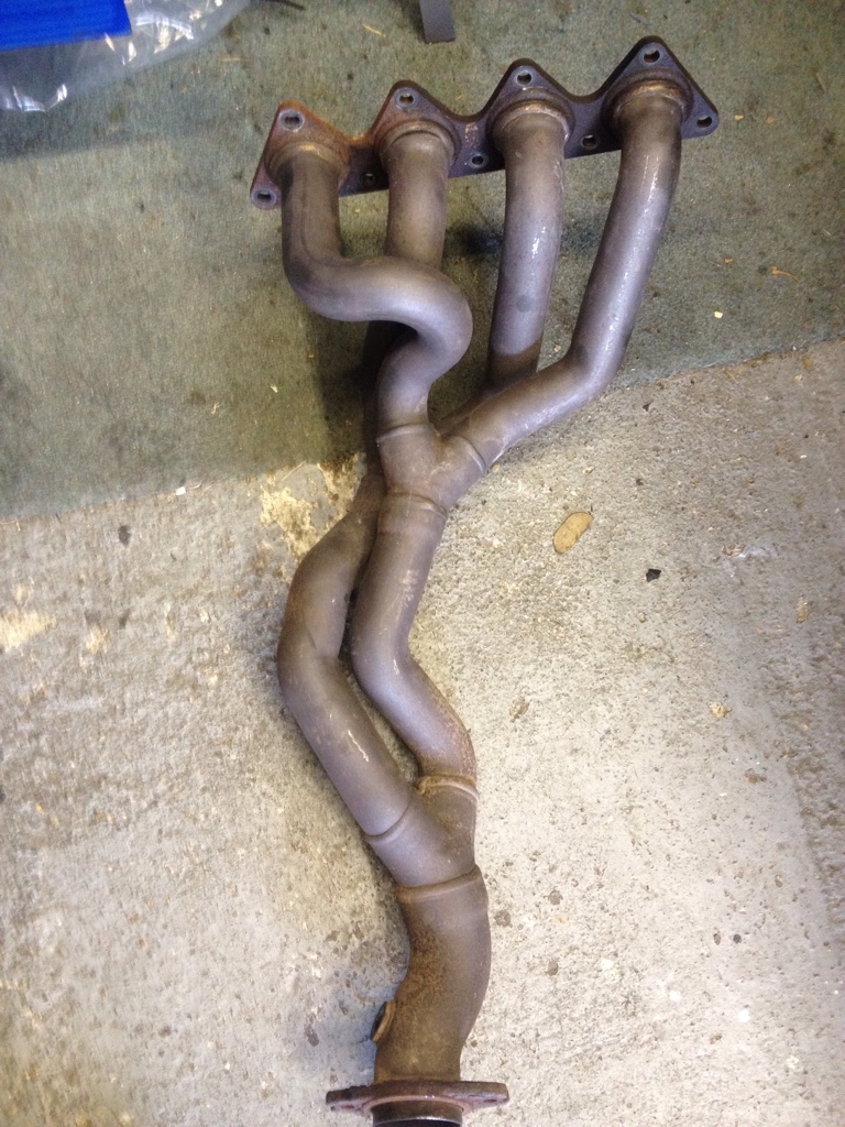

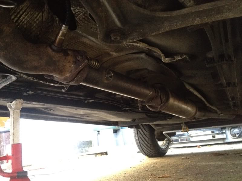

I got my hands on an exhaust manifold from the Clio 182 which gives much better torque in the mid range.
They are a total nightmare to fit as the whole subframe has to come off to get them in.

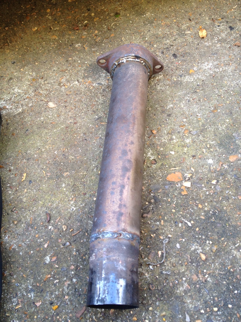

I then had to make my own custom link pipe to link it up to a 172 exhaust system.

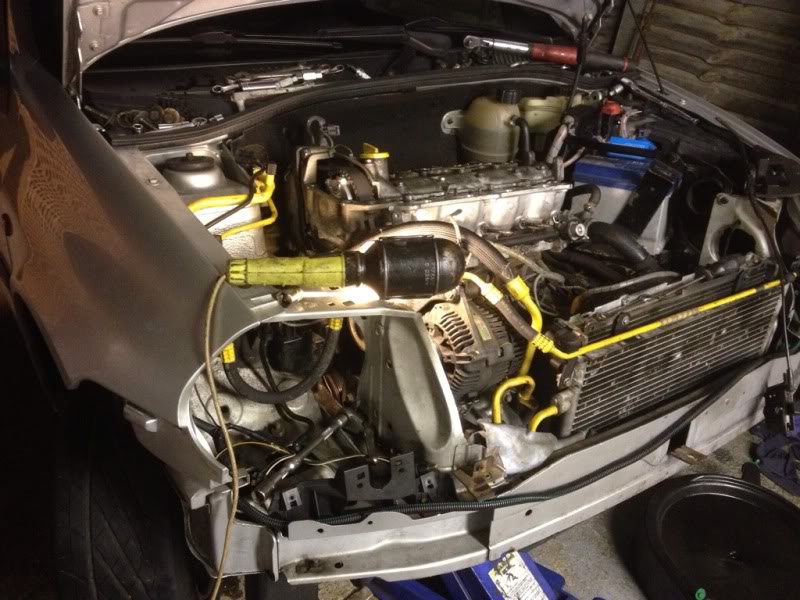

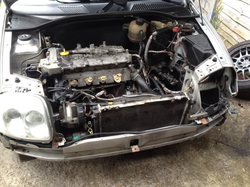

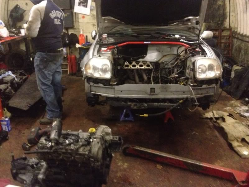

I've started stripping the car down to fit the RS2 as well.

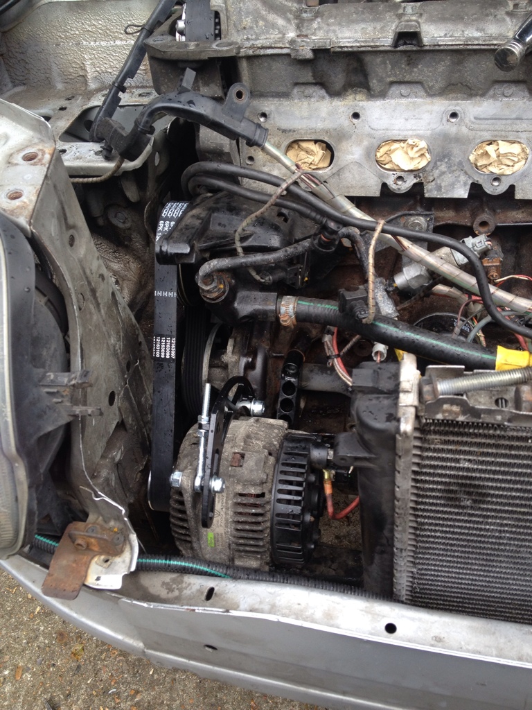

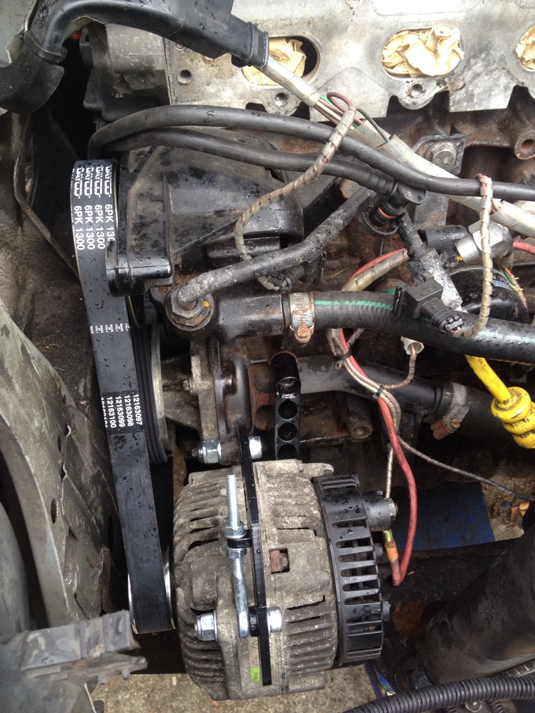

I have removed all the air con junk and and just waiting for the delete kit to arrive to delete the pump.
Got my air con delete kit on :)

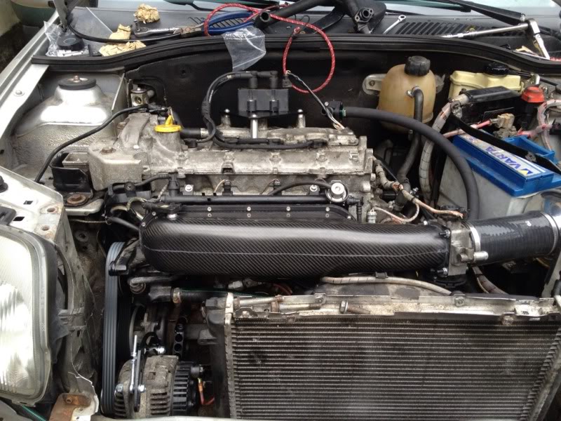

And install an RS2 Inlet to get some more power

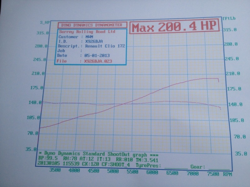

And this is its new power graph.

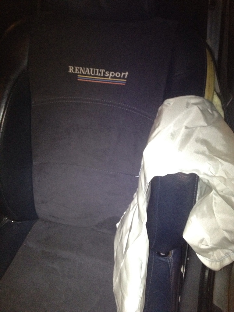

After a little bit of other entousisatic driving round a roundabout in Milton keynes, I crashed. Nothing major, Just a bit of bent suspention and set the side airbag off.

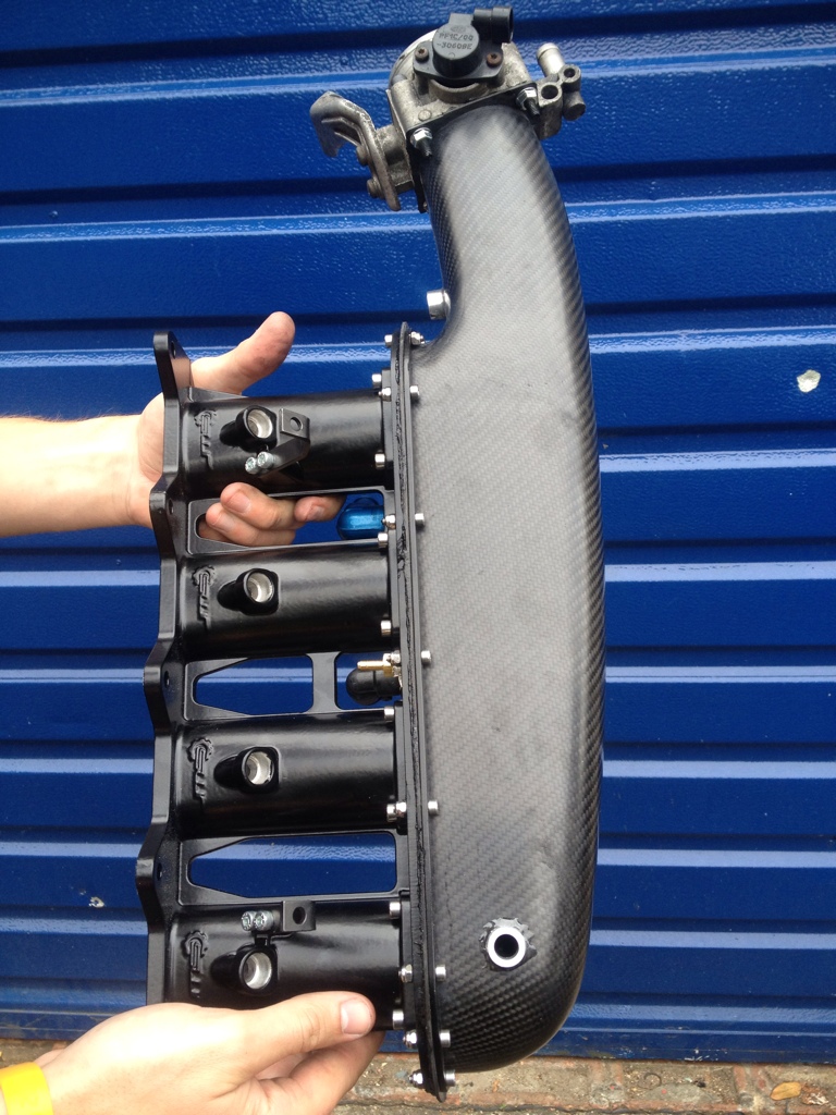

I sold the RS2 and the 197 cams and have brought some AT power throttle bodies, Some Catcam 438's and an Omex ECU.

Remove engine

Fit ITB's

Do you think its possible to fit the PM A/C delete without taking the radiator off ? My A/C rad has already been removed from the car.

Those ph1s need parking in order black one the blue then the 4 silver.
Why does that bug me. 2 Clios is the most I've had but if I had spare time and money I'd have a drive like that

The rack bushes are quite easy to do once you've done a set. I went for OEM because there weren't any Polyflex bushes for the rack when I looked.
It's quite a strange feeling when they are worn, because the car still has loads of grip, it just feels really really vague. Almost like its floating along the road.
Best thing I ever did to that car was to renew the rack bushes.

I doubt the standard injectors are good for much over 205bhp. As at 200bhp my injectors were at 96% duty cycle at 13.5:1afr on the rev limiter where it made peak power.

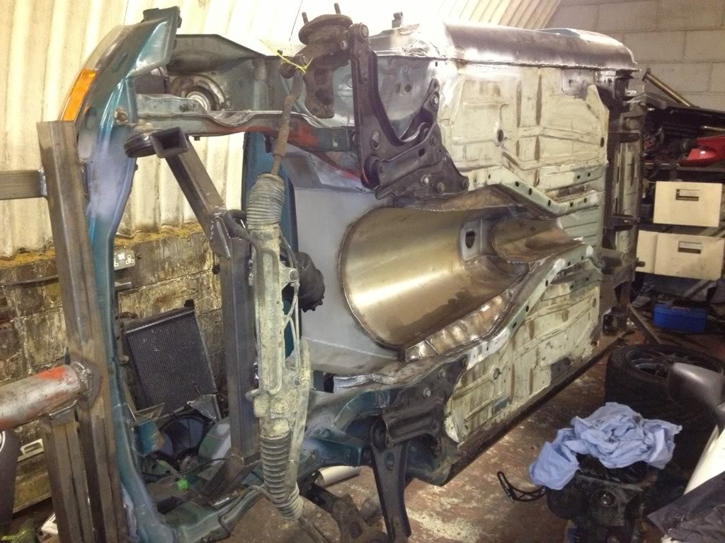

Being a ford man I'm surprised you didn't spot the backdrop though ;)
