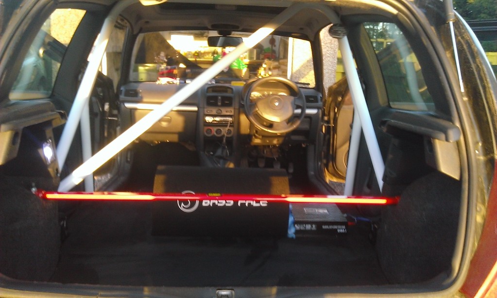

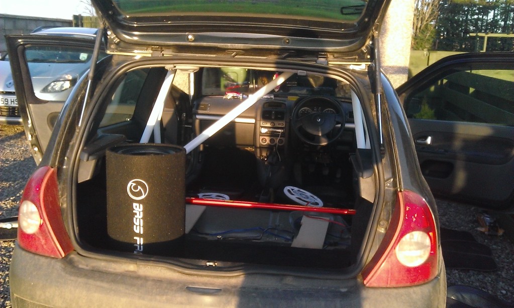

Biggest part of the update will be the rear of the car as it was a case of removing the back seats and off to b&q to buy a sheet of 8ft x 4ft mdf think it was 12mm thick. Yes you guessed it. False floor. Along with the wood i also bought 6 meters of suede fabric and a few ins of spray glue.
Whilst buying all this i went online and ordered my self a 10" bass tube subwoofer and an amp and wiring kit to go with it!
When it came to the day of cutting the wood i thought of the idea of cutting out a hole in the centre of the rear of the false floor for the sub to sit in. which has worked out great as you will see when i upload pics as in really happy with the finished outcome.

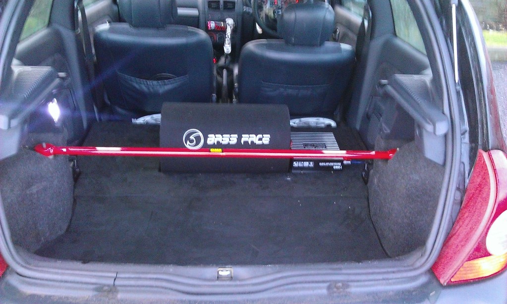

Now for the rest of my "boot build" I got everything mounted in and wired up and felt their was something missing, So back online i went and ordered an omp rear strut brace. Got that fitted the minute it was delivered. After that was having a quick look for some ideas on here and quickly decided i wanted a rear half cage and with no mucking about i ordered my self a rear half cage with single cross bar (bolt in kind) This is yet to be fitted though.

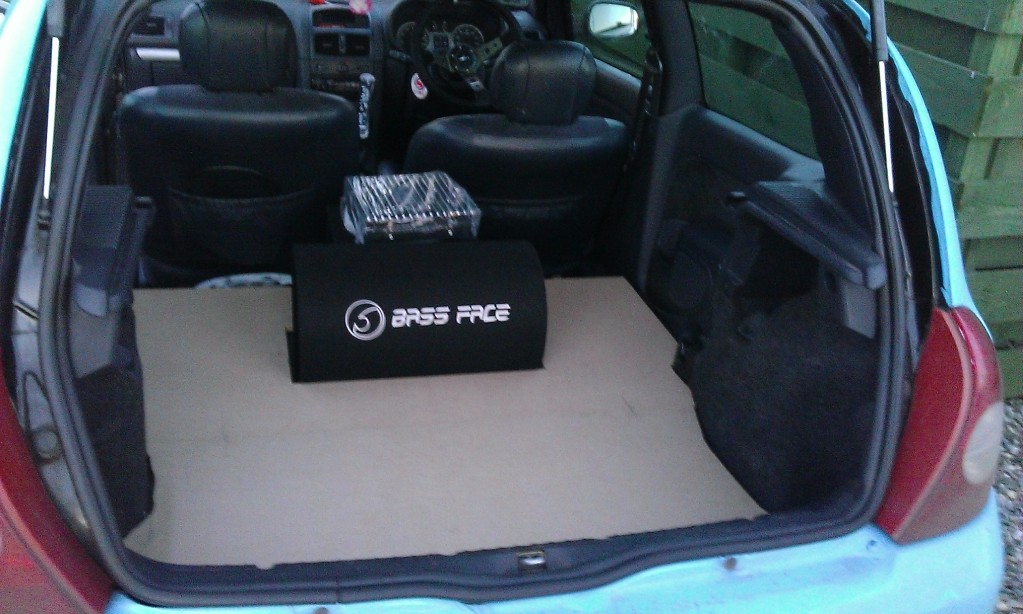

First of all as mentioned was the false floor.
Finished product minus the cage as that is still not painted yet.

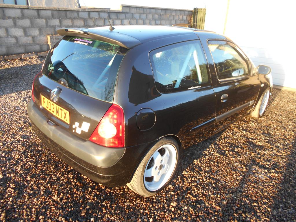

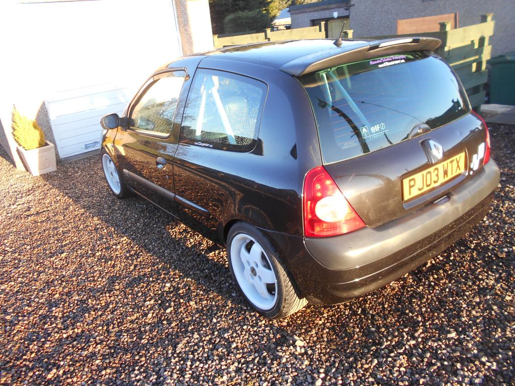

And finally a quick snap of how the car looks atm.
Now
Last month

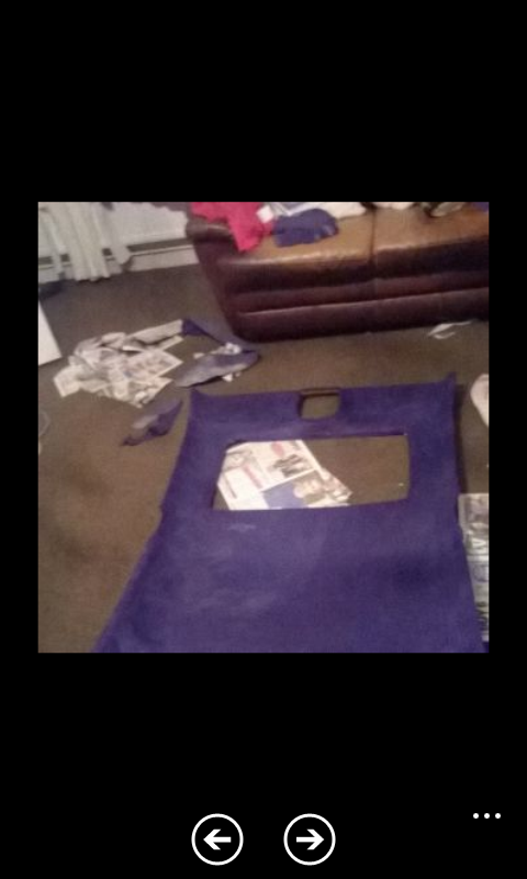

Ill just tell you in the post incase anyone else is interested. All together it cost about £30 got some 8ft by 4ft 9mm thick mdf from b&q and some suede black fabric from ebay. I got the wood cut in b&q into 4 2ft by 4ft sections iirc.
When i was fitting it in the car i used two of the section, 1 for the seat area and one for the boot area.
the seat area is the easiest part out of the two as its the wood fits straight into place, all you will need to do is cut the wood to fit around the rear seat mounting points.
The boot area is a little more difficult what i done was cut out a piece of card board and placed that in the boot marked out all the edges and cut the cardboard to fit perfectly in the boot, then it was just a case of placing that on the wood and using a jigsaw to cut around it.
took a couple of hours to do like but that's including fitting the fabric. Just used fabric glue for that and tucked it under and stapled it in place.

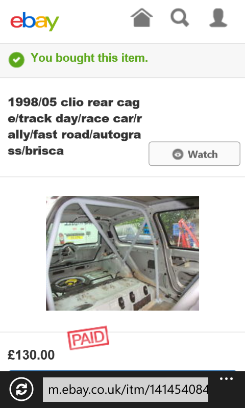

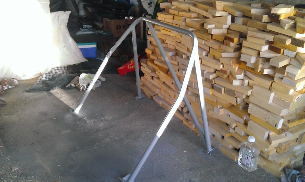

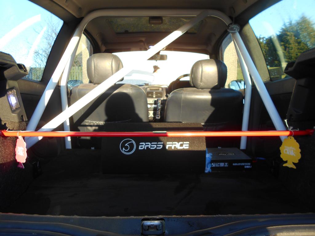

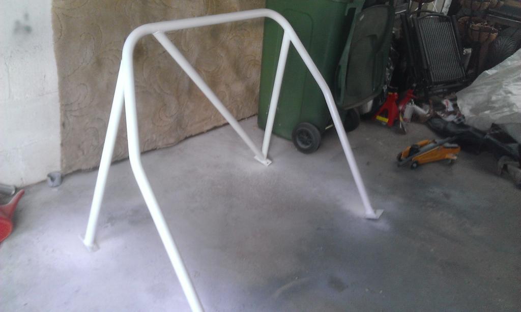

Now as mentioned before i bought a half cage but haven't really posted any photos of it, so this is where the update begins.

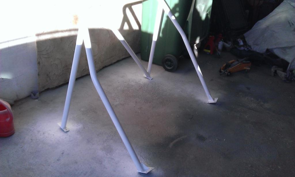

I finally got my finger out and sanded down the cage all ready for a good few layers of primer (cant really remember how many) but spent a good week end prepping and spraying it a couple of weeks ago.
Now it was time to think of a colour i could put the cage and to be honest i did have a lot of bright lairy colours in mind but really i thought i would keep it subtle just to be on the safe side. It was a toss up between yellow or white in the end and when it came to it i decided white. So went and got all the paint i needed and got back and gave the cage a good wet sanding all ready for its fresh new paint.
i spent a good week painting as i wanted it looking perfect, i know it wasn't going to be amazing since i was using spray tins but that doesn't mean i should rush and do a half arse job.
Heres a few pics of several layers being applied.
And finally the cage all finished and lacquered and ready to go in the car (hence the car all jacked up)

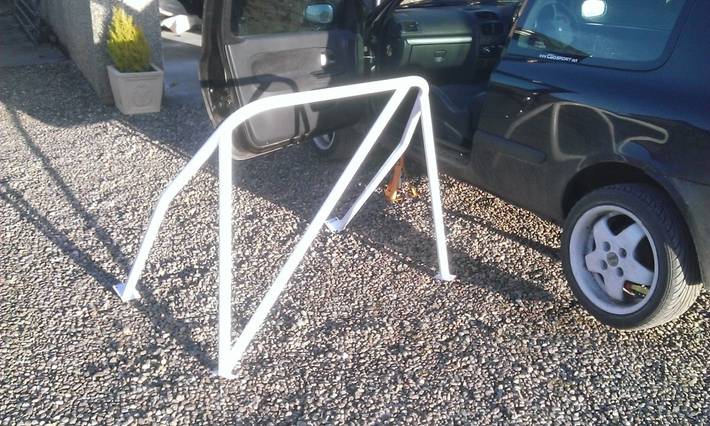

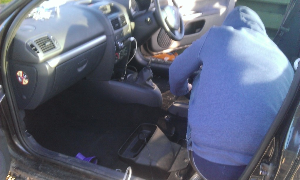

Now i have never fitted a cage before so had no idea how this was going to go so as shown in the pic above i jacked the car up and put it on axle stands and then set about removing the front seats. rears were already removed anyway due to false floor but i removed the front section of that anyway for more room to maneuver the cage.
Whilst i was underneath cleaning up the areas where the seats bolt through my mate decided to give a hand by hoovering out the front of the car, Just as well any ways as the car was manket and plus would have been pointless not to with the seats out anyway. So with the car all cleaned out it was time to put the cage in the car.
I put the cage in through the passenger door and my mate then held it through the driver side, We tilted the front legs up so the top of the cage would pass under the sunroof handle but even then it was a really tight fit. After a couple of minutes of carrying the cage through the car we finally got to the back and after a few god nudges we finally got it sitting where i wanted it. The cage was actually a really good fit, so we marked the holes after cutting the carpet back and started drilling. Strangely everything was going to plan with no mishaps which was unexpected but we finally got it fitted with 10 M10x25mm bolts with lock nuts and we used loctite on the threads as well.

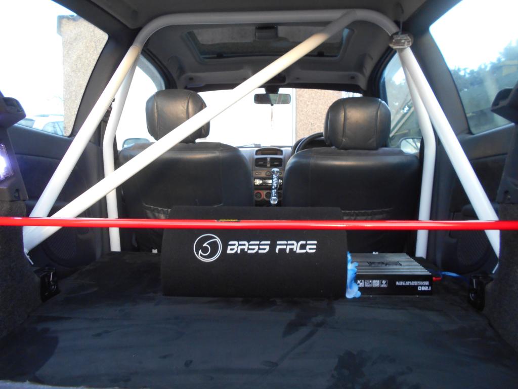

Heres a few pics and then a high res pic of the finished product.

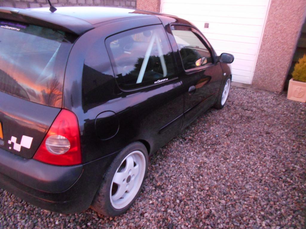

And finally one of my now favourite photos of the car at the moment, Its exactly how i wanted the rear to look. Some of you may notice the missing visors and interior light surround these will be getting replaced very soon just haven't gotten round to it yet, I also have my original steering wheel back on, Refitted the original for m.o.t time as i cant seem to figure out how to connect the horn to the aftermarket one.

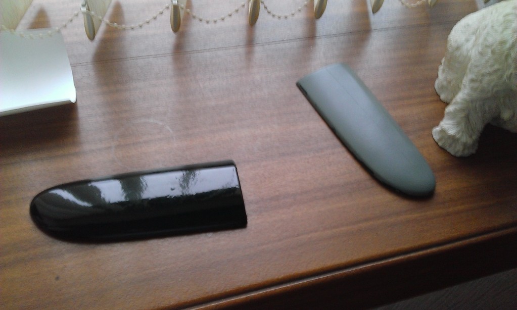

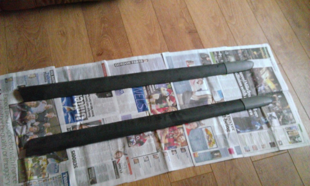

Right made a start of the colour coding today and gave it yet another wash (waste of time really, Theirs workmen digging up the road outside my house and the place is a mess!)
Anyway i only managed to get the rear of the door mouldings done as had to go into work but ill hopefully get the rest done tomorrow. Even though its just the backs done i can already see their going to look a million times better. Just need to get the fronts free and finally work out how to remove that rounded off screw so i can do my door handles.
Also finally got something to cover the two pin holes from where the badge was. Yeah its just a sticker (Dont worry its not cringeworthy) but i like it and it goes with the colour scheme.
Now i know the pain has flaked off my arch and also my front bumper is a mess at the moment but all this will be sorted soon because its beginning to do my head in.
Anyway heres some pics for just now. Excuse the amount of sun glare!

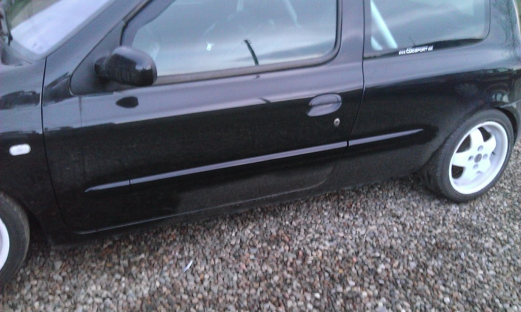

Finally got my door mouldings off today thanks to the help of a big screw driver and luck that the moulding clips didn't break.
As i thought it has made a difference and looks much better.

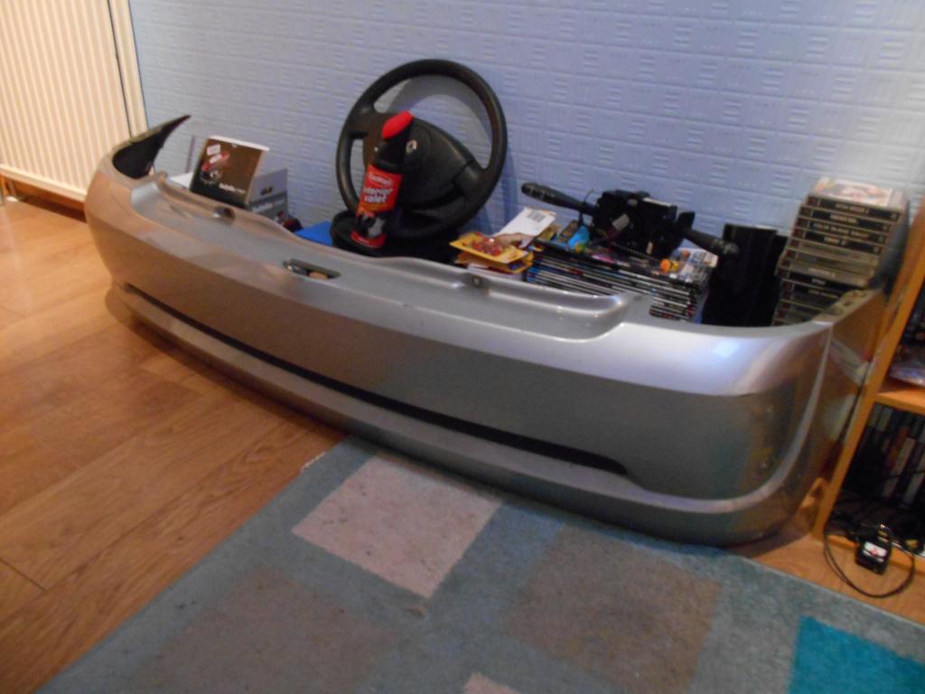

Now hopefully the next time go to the scrappies they have a black clio in as im really in desperate need of a replacement as seen in the last pic!

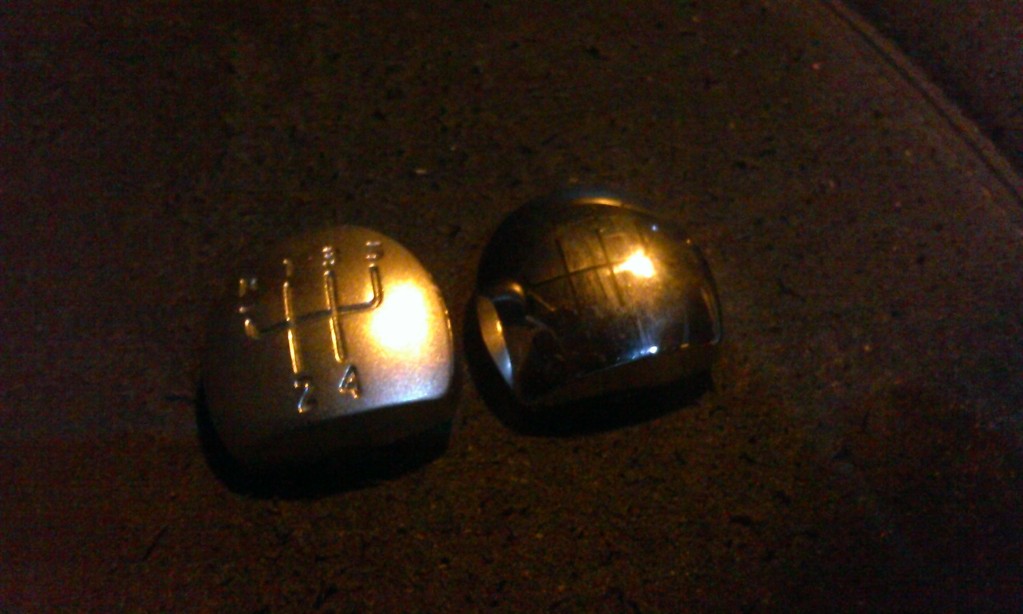

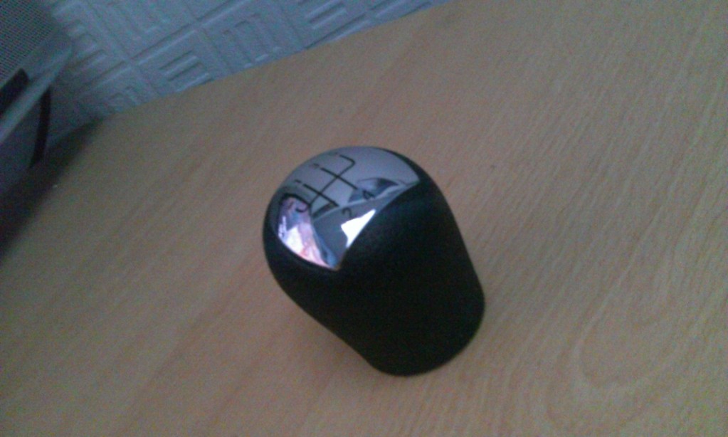

Took delivery of an original gear knob today, so i got that fitted and it looks alot better. Less chavvy and well ridiculous to be honest.
Only thing is it came with a chrome look insert which i didn't really like the look of, luckily i already had an insert from a 172 lying in my toolbox from my previous gear knob.
I also took delivery of this. A 172 Rear bumper. Only £30. Yes it has a few stone chips but it will be getting a colour change to match the car anyway.

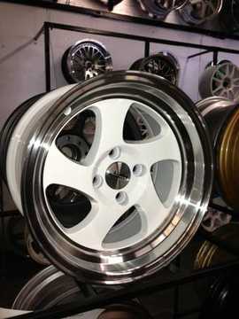

I do have a few sets in mind though that i do like.
White XXR 527
Feel these have been overdone though
White Japan Racing JR15
