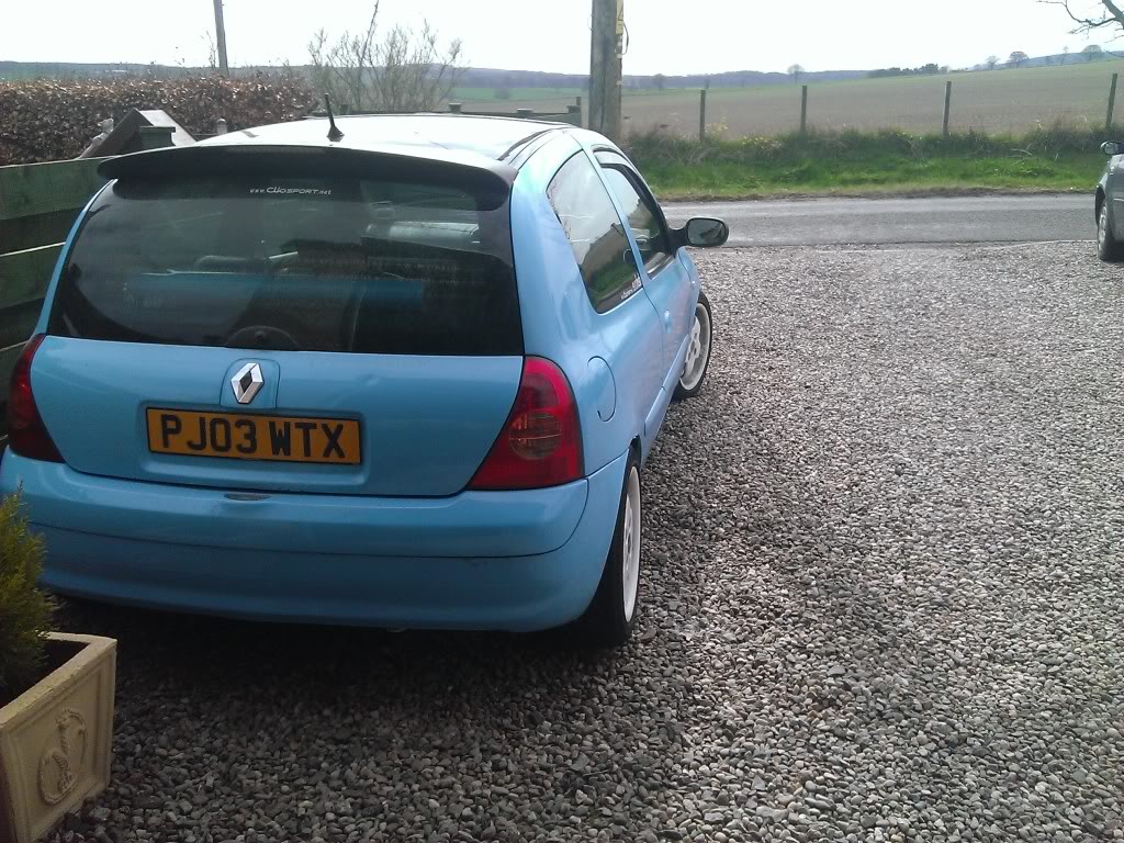

Yeah i have removed the rear adjusters and that seems to be as low as it will sit unfortunately, might actually get a set of custom springs for the rears that should sort the gap out.
I am thinking about a 172 rear bumper tbh and the spoiler, well keep an eye on this thread and you'll see what's in my next update all im saying is. It cost a fair bit for what it is ;)

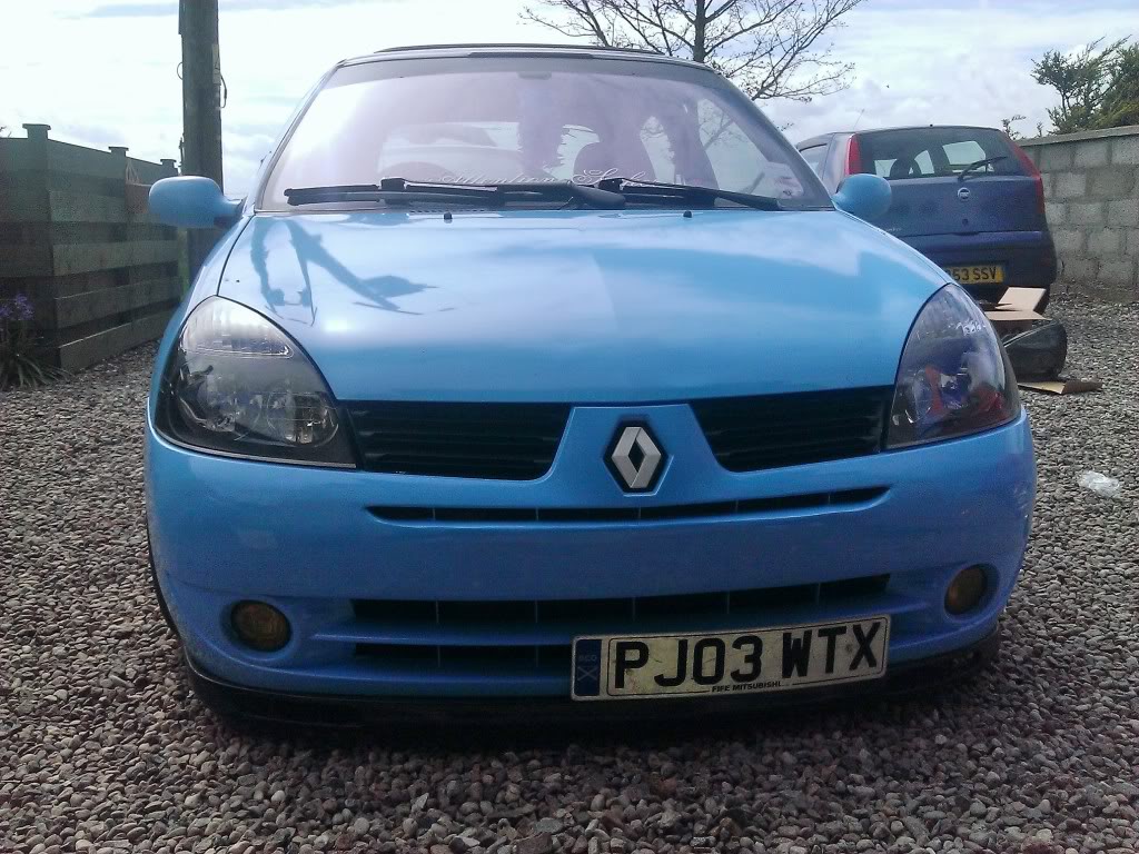

Front bumper is standard
If I were to advise on front bumper I would suggest ph3 bumper smoothed and wrapped
But nothing more annoying than posts that have no purpose
It looks terrible because it's been wrapped and half of it is peeling ripped and/or damaged.
The car looks terrible, because it is. Awful waste of time and money to produce that.
Ps. Before anyone starts flinging their toys out of their pram (Spinksy..) - Remember this is a forum, if he didn't want comments,he shouldn't have posted a thread)
Give the lad a chance to fix it

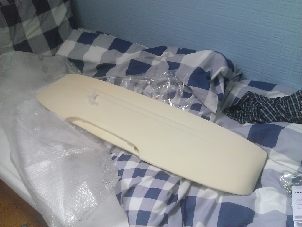

Well finally i got delivery of my spoiler, my first impressions of it were great and honestly couldn't wait to get it on the car. This is where a whole world of problems started happening!
1st of all took the spoiler into the garage and went to start wrapping it.... The wrap wouldn't stick to it for some reason, i have never had this problem before and couldn't understand why it was happening. So i then decided to spray it, This went horribly wrong also as the paint just reacted the minute it hit the spoiler! so basically i spent most of my time wet and drying it to get it looking new again.
Now 2nd of all i thought since i cant get it colour coded just now i thought be as well test fitting it. So i took all the bits i needed off of the old spoiler and went to go fit the brake light to the new one.... It didn't fit, had to drill out all the holes for the all the clips and for the rear washer hose, finally got that done and then the brake light fitted.Its not the best of fits as their is a gap round the edge of the spoiler and the brake light at one side, Not happy at this is its quite noticeable.
After this i then encountered my next problem! the bolts to hold the brake light to the spoiler wouldn't fit in the gap that was inside the spoiler. so i spent even more time sanding down and slightly chipping away till their was enough room for them to fit. The finally the brake light was fixed solidly in place and so it should be with all the hassle just for that one part.
Next was actually fitting the spoiler to the bootlid. Now when i went and put it up and went to line up the holes i really wasn't amused! Out of the six holes for the bolts roughly only two of them lined up. So i got the bolts in the two holes and their was an unsafe/unstable amount of play in the spoiler. So basically their was no other thing for it some of them i was able to bend some of the bodywork out of the way and finally get the bolts in (not happy about doing this) but iirc two are still missing.
I know it was a replica spoiler and tbh i wasn't expecting it to be perfect but for the £90 asking price for it i really was expecting a bit better than that.

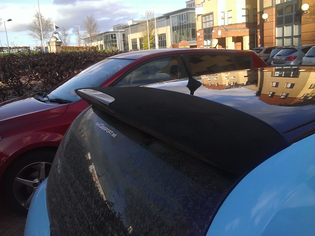

Heres a few pics of the spoiler and the spoiler fitted, Can't really complain to much as it does look good. and tbh when its colour coded i think personally its going to look great.
I tried priming it, stuck a wee bit better but nothing great, still basically able to take it off with ease. I think its because its fibreglass or maybe the type of vinyl i bought. Giving it another try at the weekend.

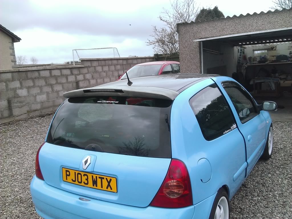

Update. 1 of 2
Spoiler

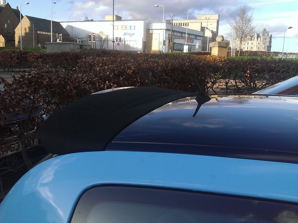

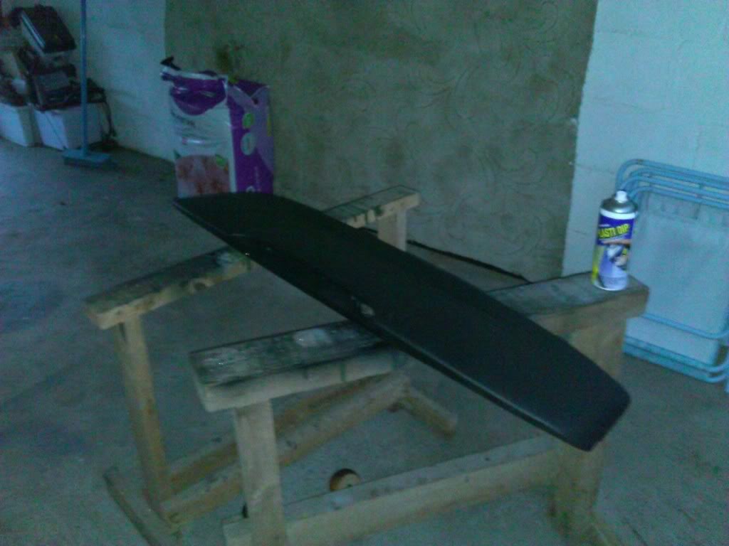

Right my trophy spoiler was beginning to be a bit of a head ache with its non sticking vinyl then nothing lining up. Finally got around most of the problems.
I firstly tried fabric wrapping it as it was the only wrap i had that was sticking properly, Some people actually said it look alright but to be honest i thought it looked a bit daft! Black nonetheless though
After a couple of days of searching of other ways of getting it wrapped in proper vinyl or getting sprayed i then decided to turn to plastidip. Never actually used it before but i have heard its quite good and will basically take to anything. Gave it a bash but not really to pleased with the finished texture. Kind of feels like solid rubber.
Looks a lot better imo though.

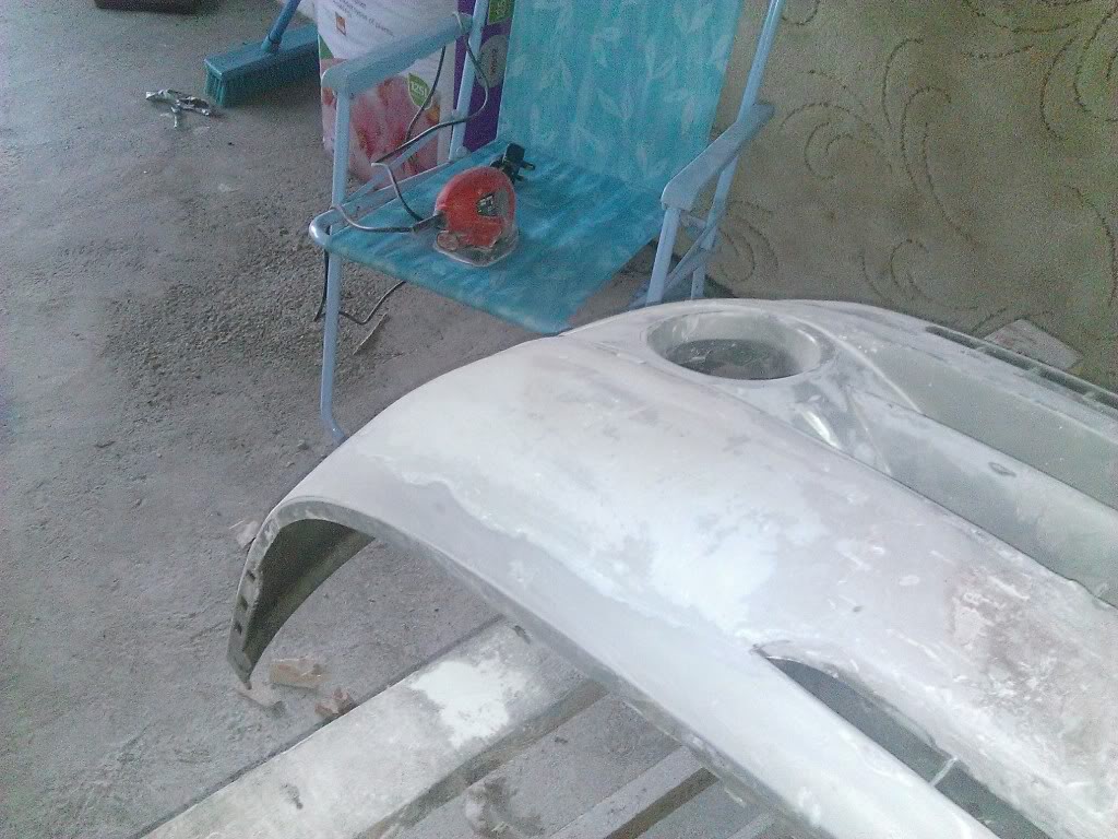

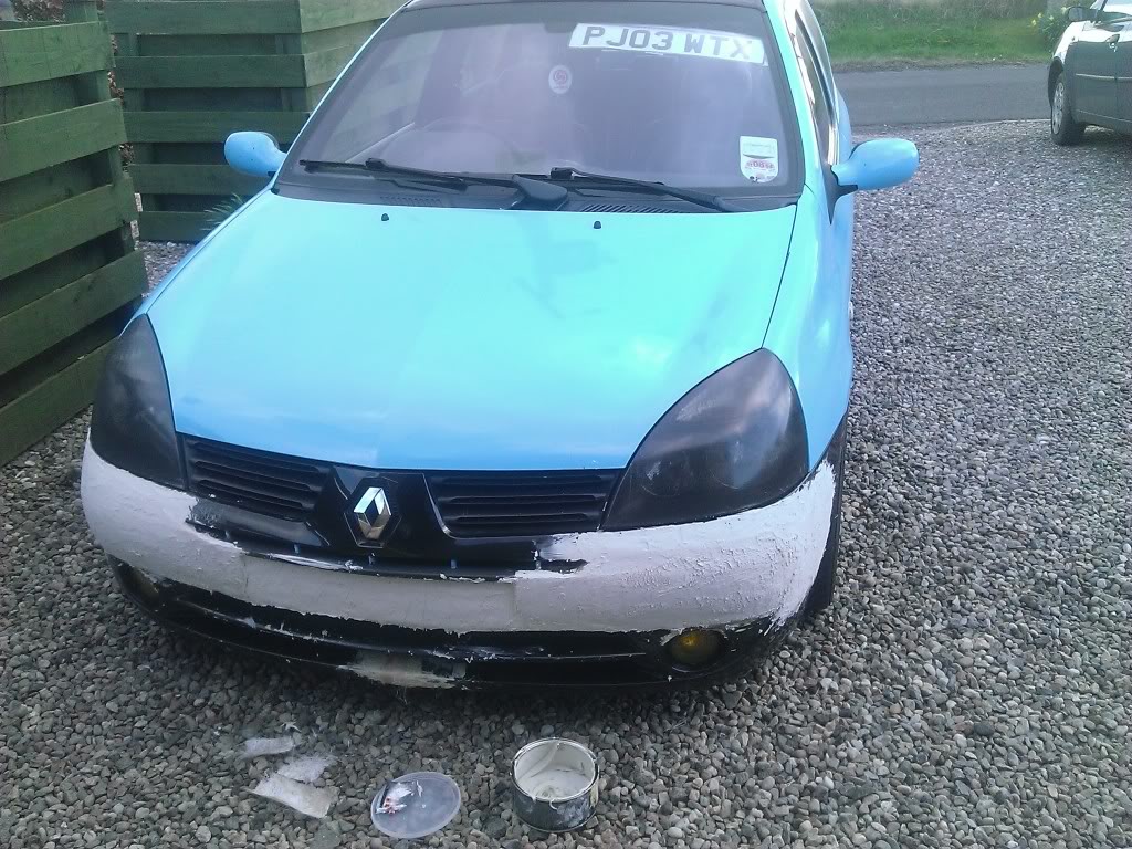

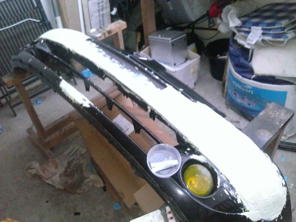

Right i eventually thought i would get this sorted since people were pointing it out more and more, My bumper.. It was starting annoy me my self as the vinyl was peeling everywhere and it was really badly damaged. So basically i went down to B&Q got my self an electric sander and loads of sand paper. Then a trip to Halfords for some auto body filler and some fibreglass.
Now i have never actually done repairs before using any of the stuff i had bought so i wasn't expecting this to go well at all and my first attempt went terribly wrong. Now seeing as i basically had a ruined bumper any way, I thought i would have a go at something.. Smoothed front end!
1st Attempt
Now seeing as it just wasn't turning into anything what so ever and i felt as if i made an a**e of it due to not taking the bumper mouldings off in the first place i decided to just take it all off. I know complete utter waste of money and time but it was a learning curve.
2nd Attempt

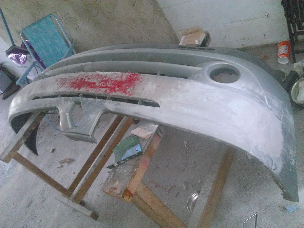

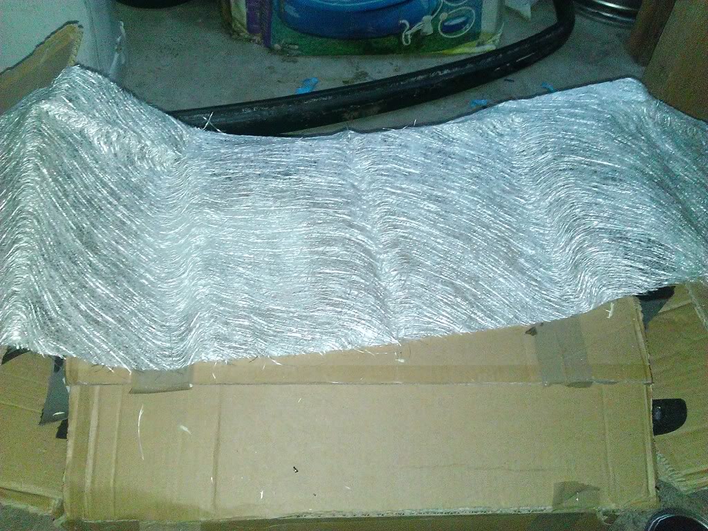

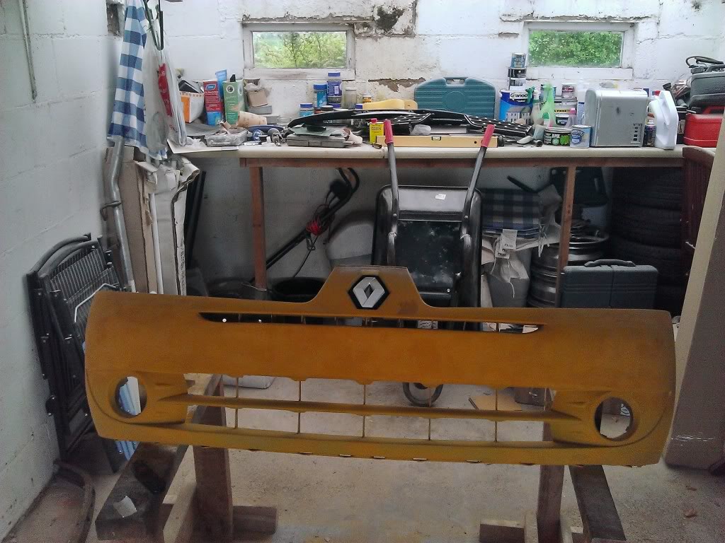

Now seeing as attempt number one was a shambles, I went to the scrappies and got myself
another bumper for £25 and more filler and hardener etc. I feel this attempt has went a hell of a lot better, Now its no where near finished but heres a couple of pics of the stage i am at now.
Pics are not in the right order but you'll get the gist and the look that i'm going for.

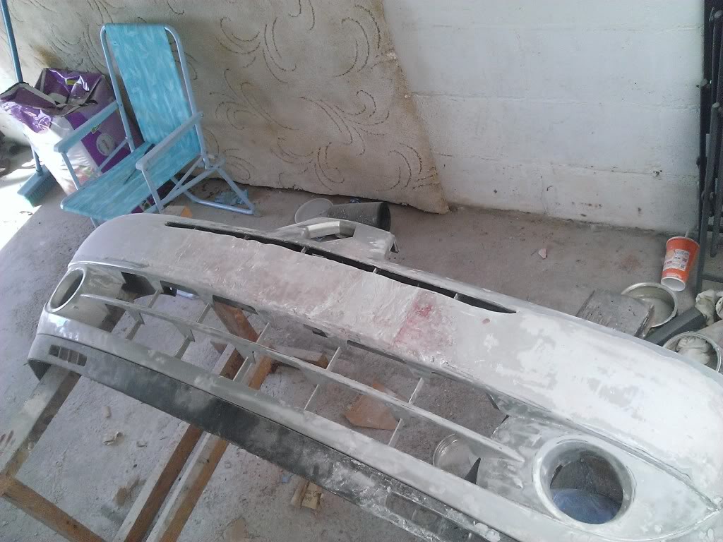

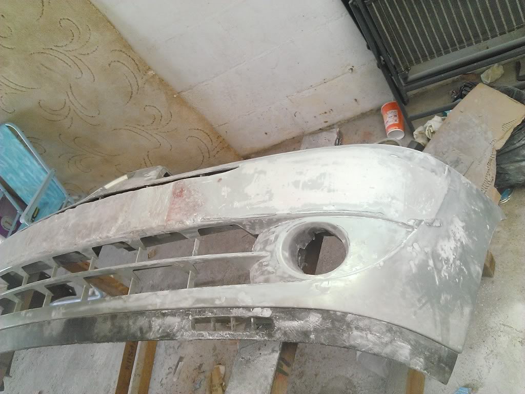

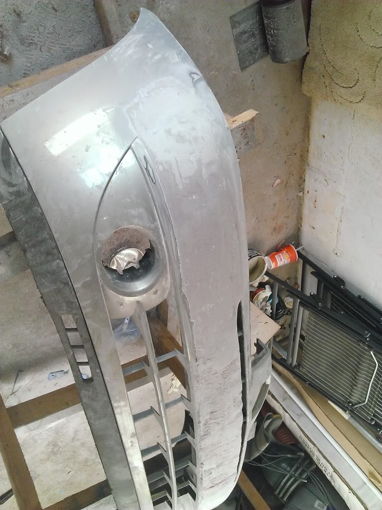

Sanded and filled a bit more Nearly ready for primer
Got it as close to decent as i could. Never done it before as i said but i was hoping it will turn out good.

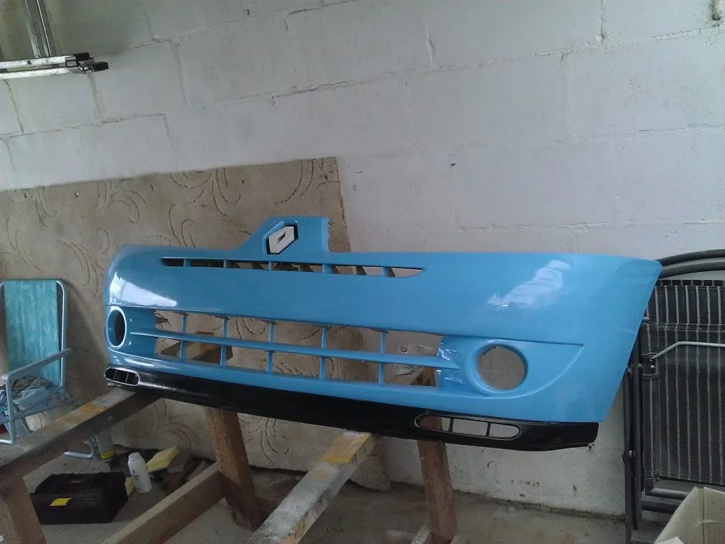

So i got a few tins of filler primer and gave the whole bumper about 6-7 coats

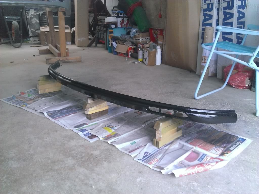

Also re sprayed my splitter
and then gave my bumper about 6 coats of normal primer.
Next was to sand down my sideskirts once the primer was drying off between coats in the garage for a couple of days fairly happy with them and im sure they will really finish off the car.
Now its time to wrap the bumper,fit the splitter and also got brand new headlights in the post to freshen up the front end of the car.
