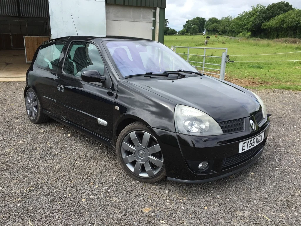

Sooooo, after about a month of looking at 182's that weren't up to scratch I finally found one I liked. Load of history and been looked after. loved the seats too ;)

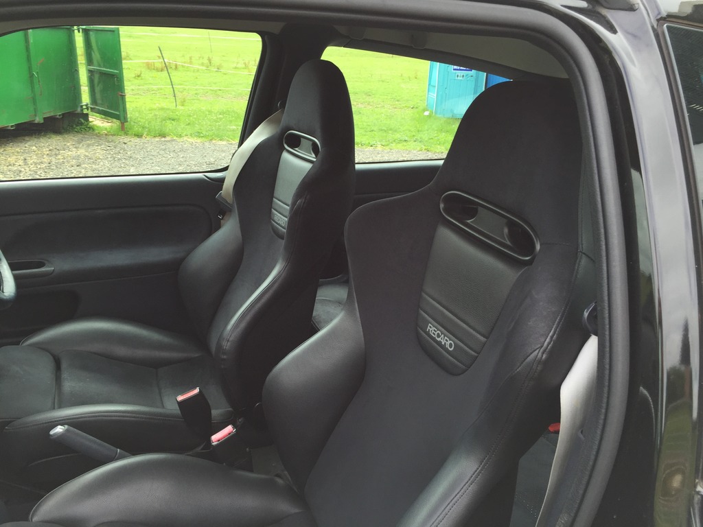

That looks a cracking example and quite rare to have those seats.... as said above though, they will be worth very good money should you sell. The 2118's are a great choice btw, sooo tempted with a set for mine. But then there's Turini's. Choices choices!!

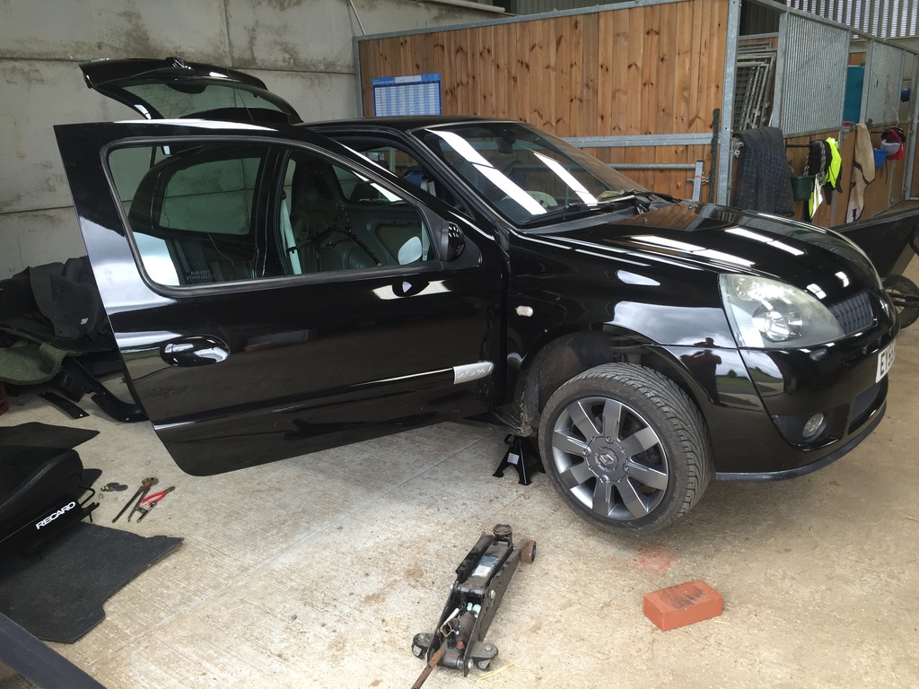

Managed to spend a day on the car. Got it off its feet and took the seats out and yeah they are pretty heavy so will be looking to replace them in the future. Got all of the trim and carpet out that I wanted too.

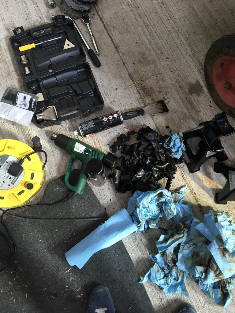

Then I discovered the joy of removing sound deadening...
Need to look into tidying up the wiring. And how do I get the gearstick surrounding trim off? Couldnt figure out how.

For gearstick surround.. Just pull the ashtray out then pull the cup holder out, don't forget to unplug wiring from cigarette lighter, lift up gear stick gaiter as from what I remember there's a big white clip underneath it which secures the surround to the floor... Then just pull the surround off as its only clipped into place.
I tackled these jobs a few weeks ago when I fitted my bucket seats.. What an awful job removing that sound deadening is. I weighed it and it was roughly 6kg that I removed.
thanks :up: yeah i was surprised how heavy it was. worth it, just a boring ass job

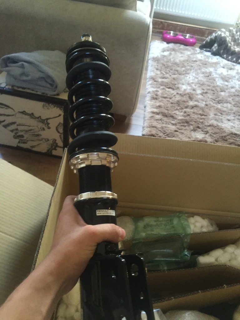

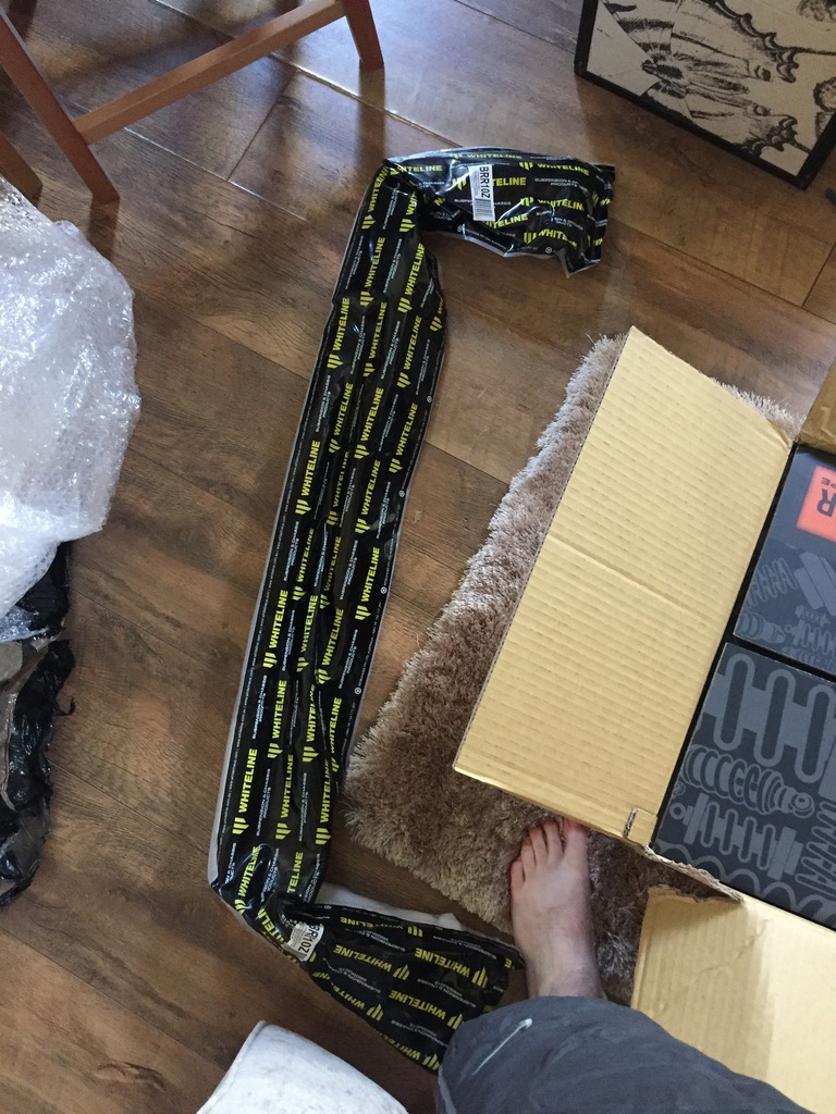

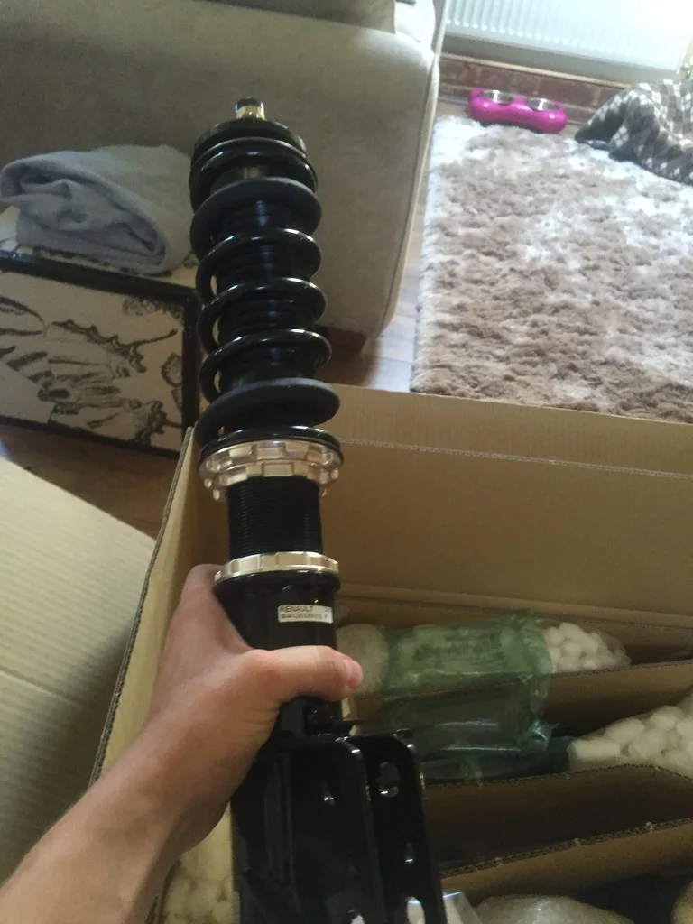

Mini update, Been on an ordering spree. Bc coilovers, top mounts and the whiteline rarb should be here next week. Also ordered the 2118's in anthracite wrapped in r888's (looking forward to those arriving). Need to order the brake ducts.

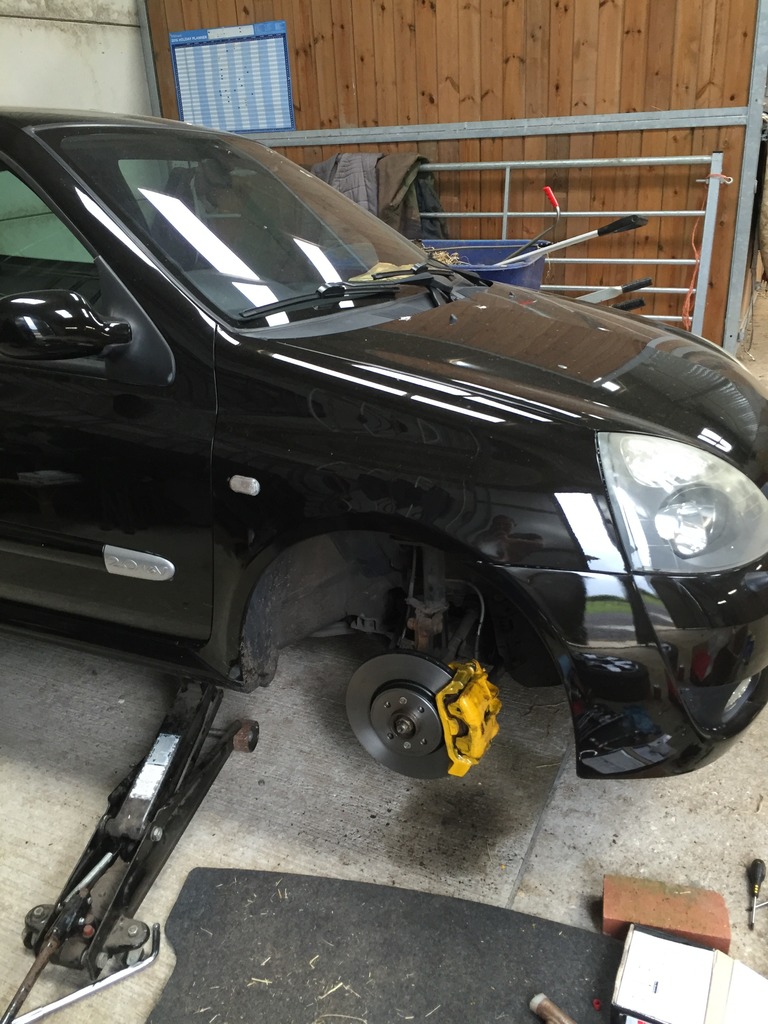

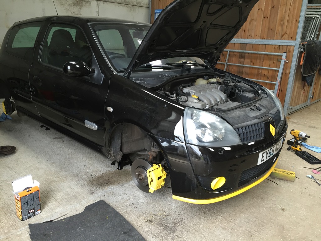

Brake parts arrived from RTR. HC disks, ds2500 pads and goodridge lines. While taking everything off decided to paint the calipers. Tried halfords paint which turned out crap its far too runny and wasn't doing the job. So i've put them back on for now and ordered a Follitec kit which is supposed to be a lot better. While taking the rear calipers off i found the rear pads/disks had seen better days so ordered some new oe disks and ds2500 pads for them as well. Still need to do the fluid but didn't see the point until i was happy with all of it. Decided on a black and yellow theme too (brakes/splitter/brake ducts/cage/harness will be yellow the rest black).

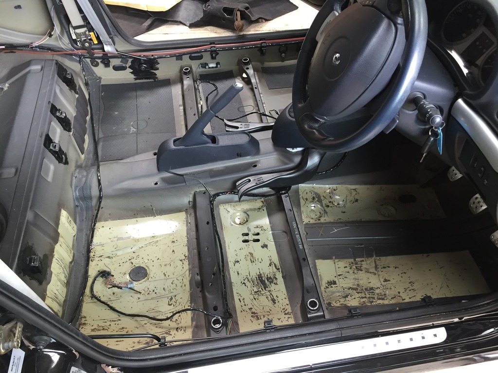

More progress... Come to the conclusion i hate sound deadening...

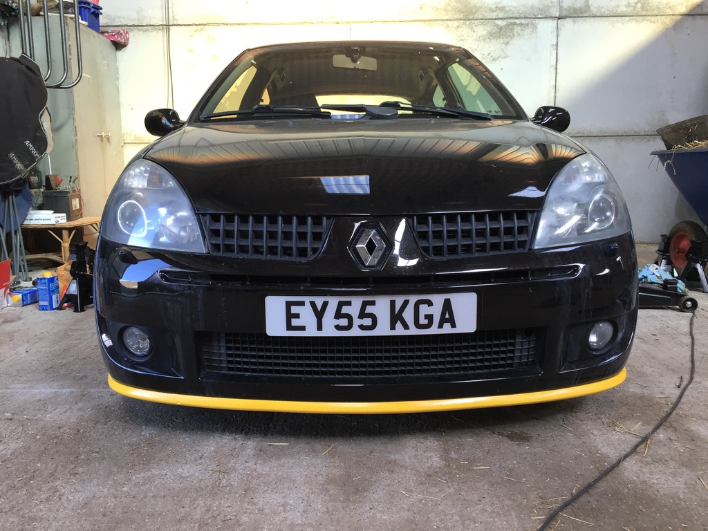

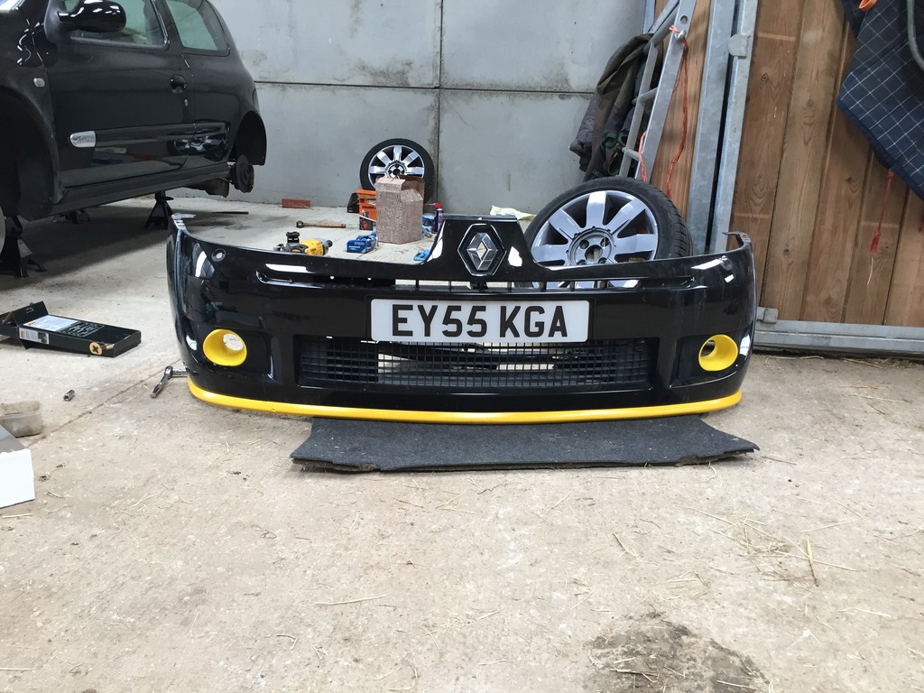

Painted the splitter too...

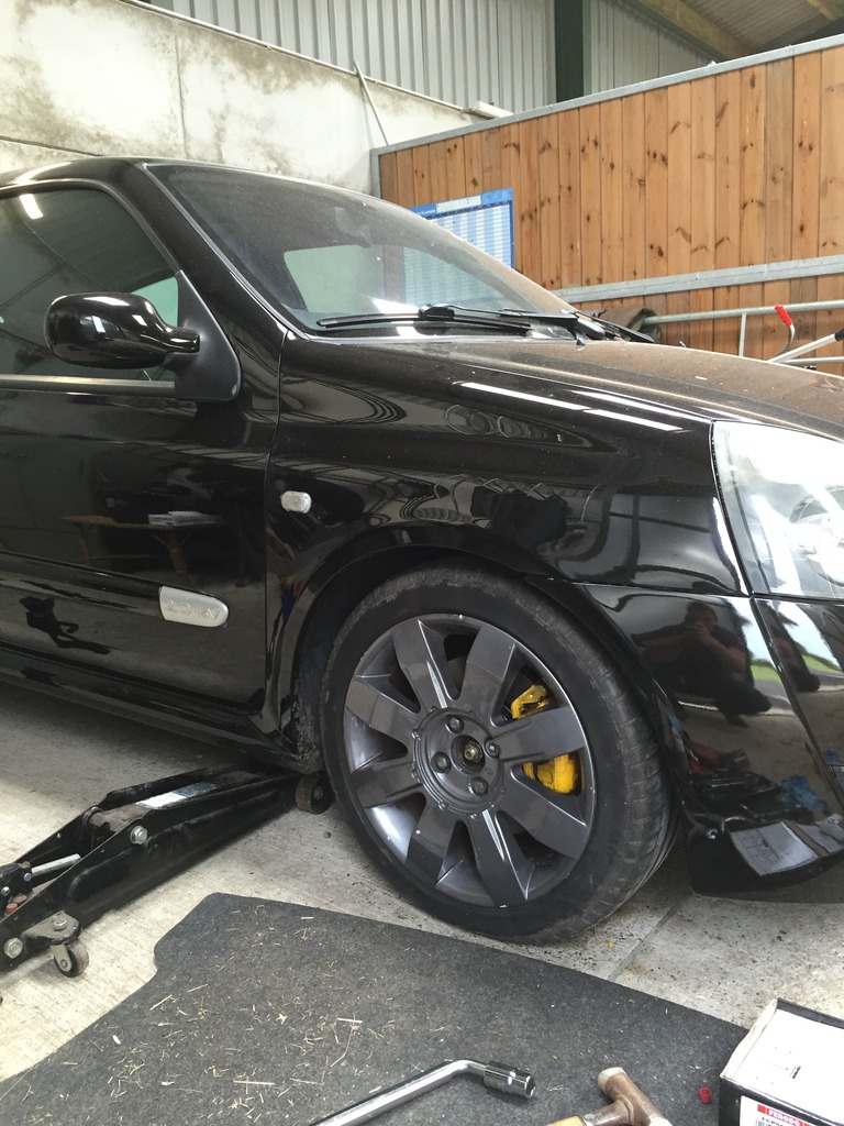

Front brakes are done, just need to wait for the rear disks to turn up then can do the fluid and go test them. Jumped on the group buy and put my name down for some flat door cards, so need to look into replacing the windows and removing the motor. Anyone point me in the right direction for this?
Bit more done today. Finished installing the new rear disks and pads. I couldnt get the 30mm bolt off that holds the rear disks on so had to buy an impact gun for that. Best thing Ive ever bought. makes everything soo much easier. Need to bleed the breaks tomorrow, think ive got a bit of air in the system changing the lines and everything but wanted to change the fluid anyway so no biggy.

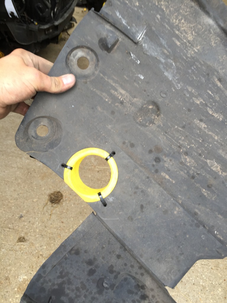

Got the front bumper off. took the acoustic valve out and cut the horn down to one bit and installed some brake ducts which i found on ebay. dont know if they are going to do much but look good and keep in with the colour scheme. need to take the grills off and paint them anthracite as they look really tatty but thats a job for another day. Removed the headlight washers and lines. I bought some blanks off ebay but they where crap to need to find some new ones. Anybody recommend any?

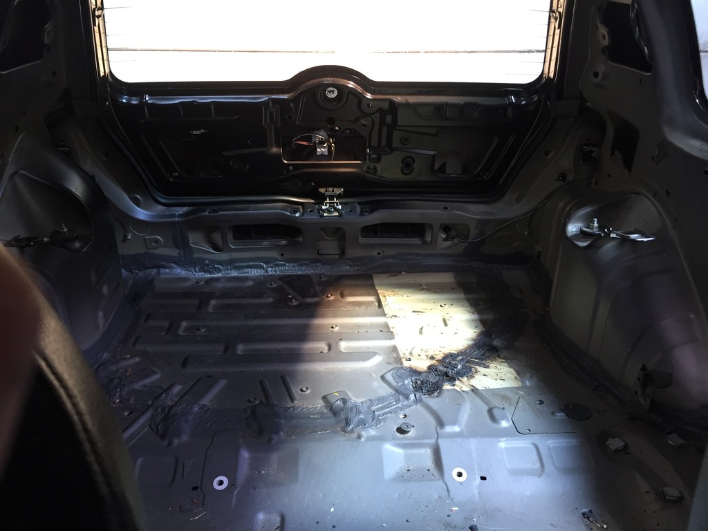

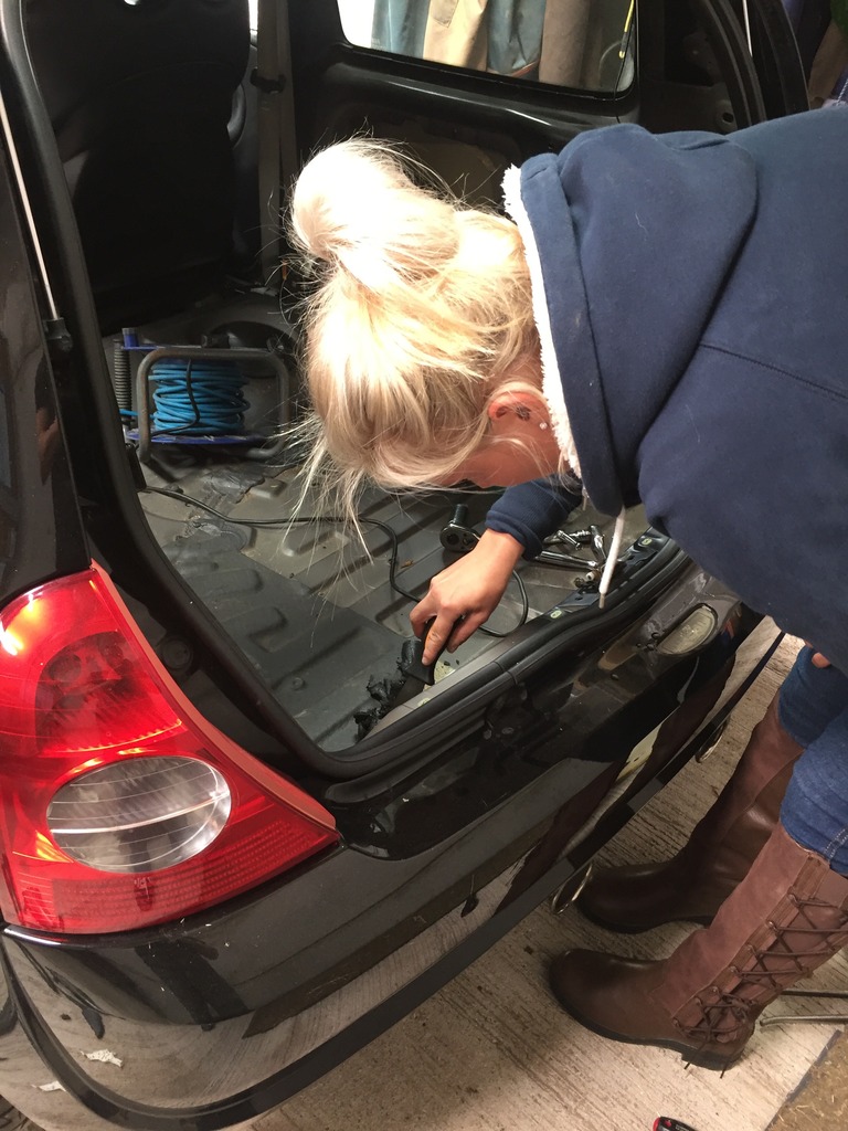

hired the mrs to get rid of the sound deadening
spend ages stripping and moving the rear loom down the side channels. pic doesnt do it justice but cant see it now. especially when the new rear door cards turn up.

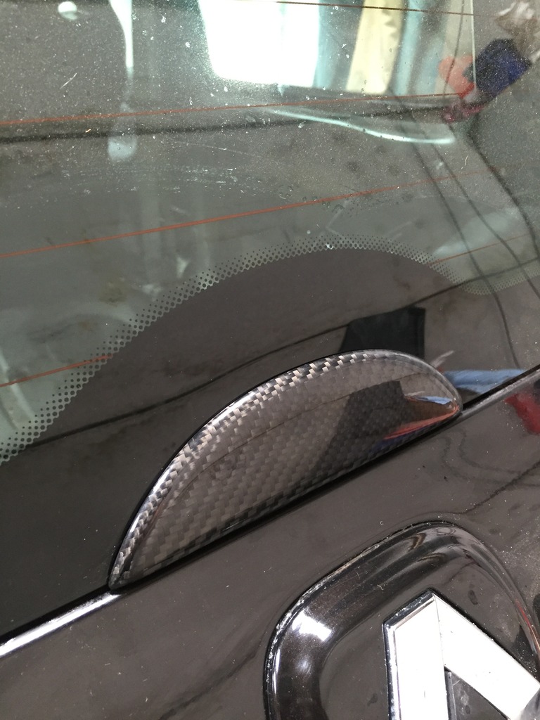

also got rid of the rear wiper/motor/lines and installed a carbon fibre blank.
also took the ariel off and wiring. looks much better now. need to find a blank for it though.

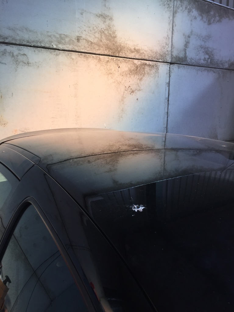

Nice! I've got to remove the tar on mine soon.
The only downside is i'm not sure i'm going to tackle the roof. You see the side bits of tar on the rear quarters behind the foam? That might be a bit tricky too!

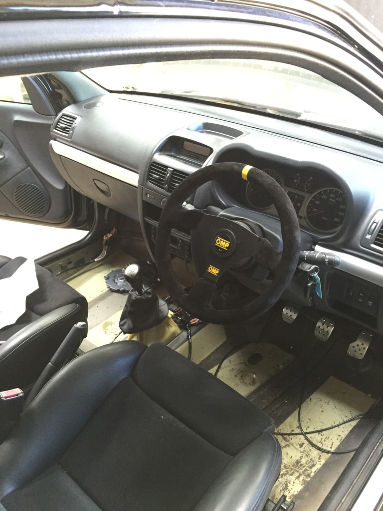

Few more odds and sods while waiting for parts to turn up. Omp wheel with momo boss installed, kept it black and yellow too. Also got a yellow tow strap and some carbon fiber washer blanks so need to get the bumper off again and get those on...

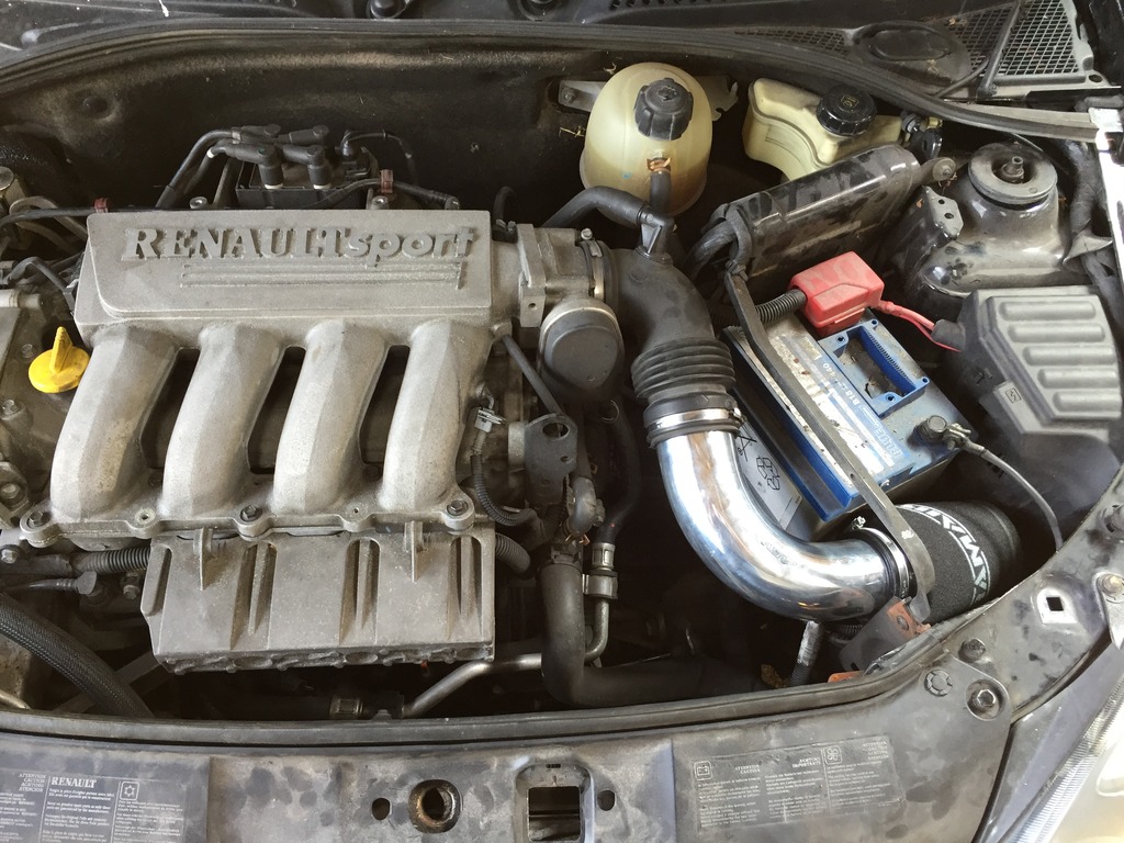

Fatty induction. Decided to tackle the engine bay over winter. Been looking at some of the ktec performance packages but just raring to get this on the track at the moment.

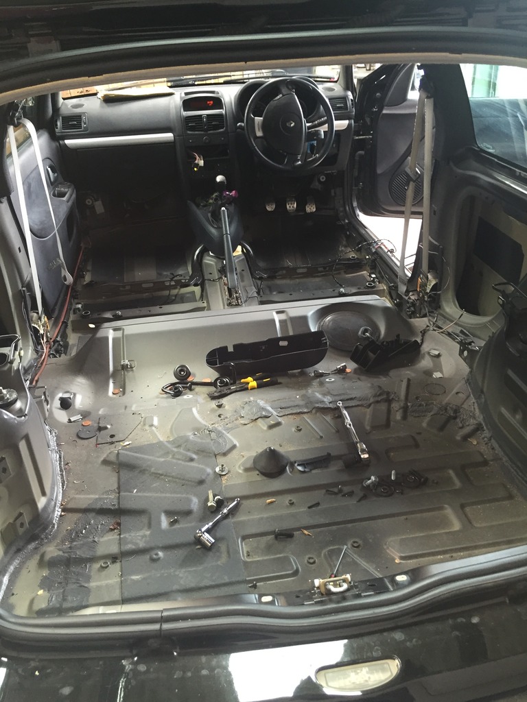

Finished stripping the interior for now. All that's left is the recaros and the full dash at the moment. Got some door cards coming from the group buy but cant decide what to do with the windows for now. And make a decision on the size of cage to go for and figure out if its worth getting one welded in or buying a bolt in one. Decisions, decisions. Anyway DPD turned up today with some goodies...

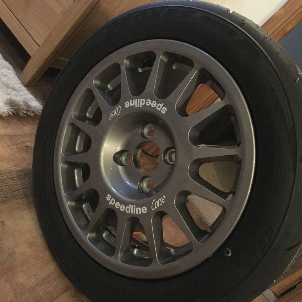

Currently talking to someone about changing the bushes, installing the coilovers/rarb, some camber bolts/shims and getting the geo setup for track use. Then i can slap the speelines on and get to a track. :up:
