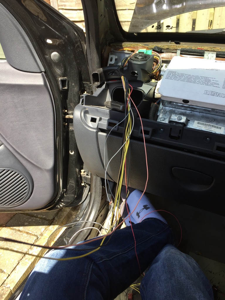

Bit of an update. More interior removed. Passenger airbag out and more wiring hidden/removed...

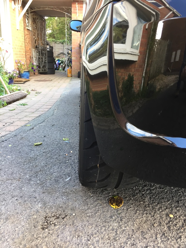

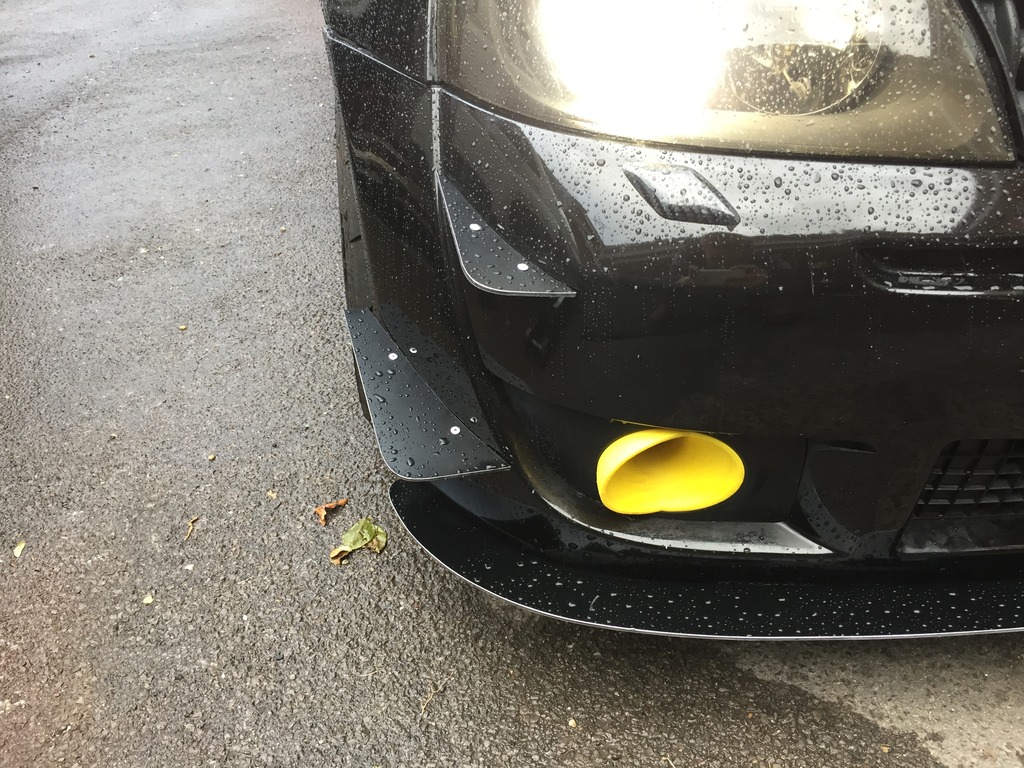

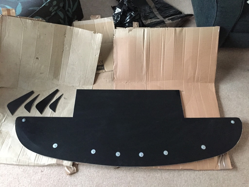

Speed-lines on...

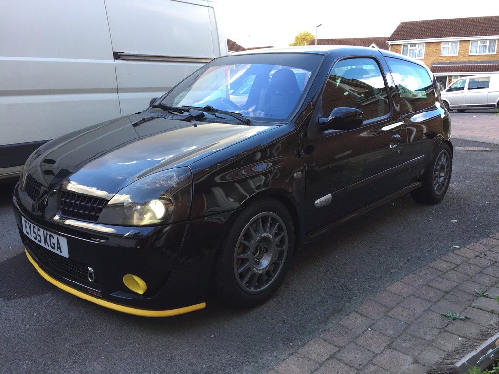

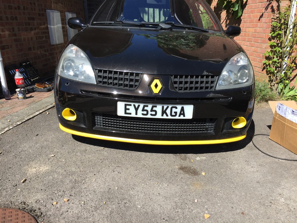

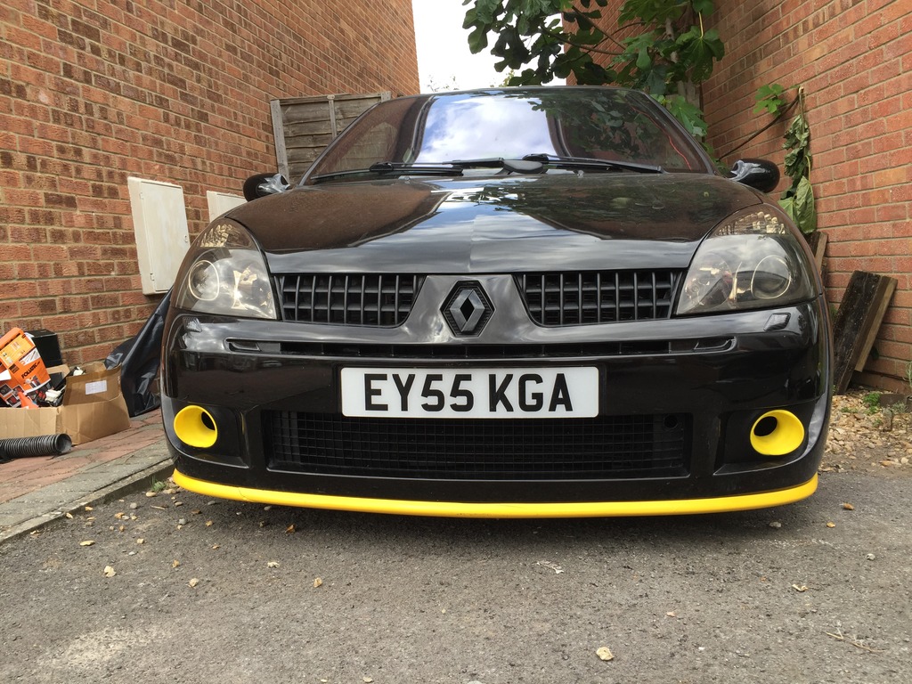

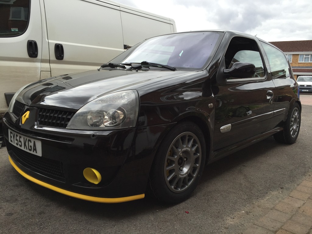

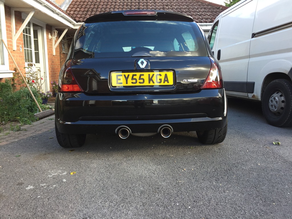

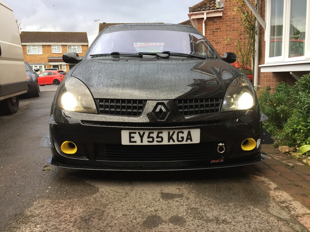

I wasn't happy with the way the front end was looking. So I got some new headlights, sprayed the badge black and restored both grills with some Auto Gylm polish. I think it looks much better. In need of a clean but I ran out of time today. Before and after...

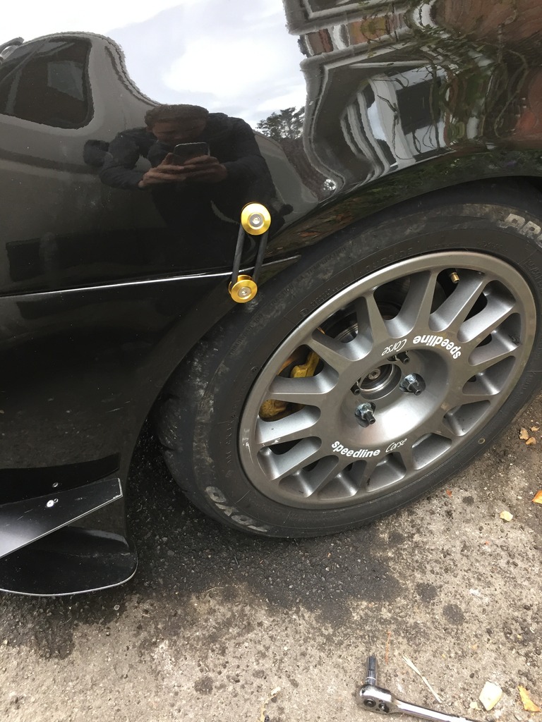

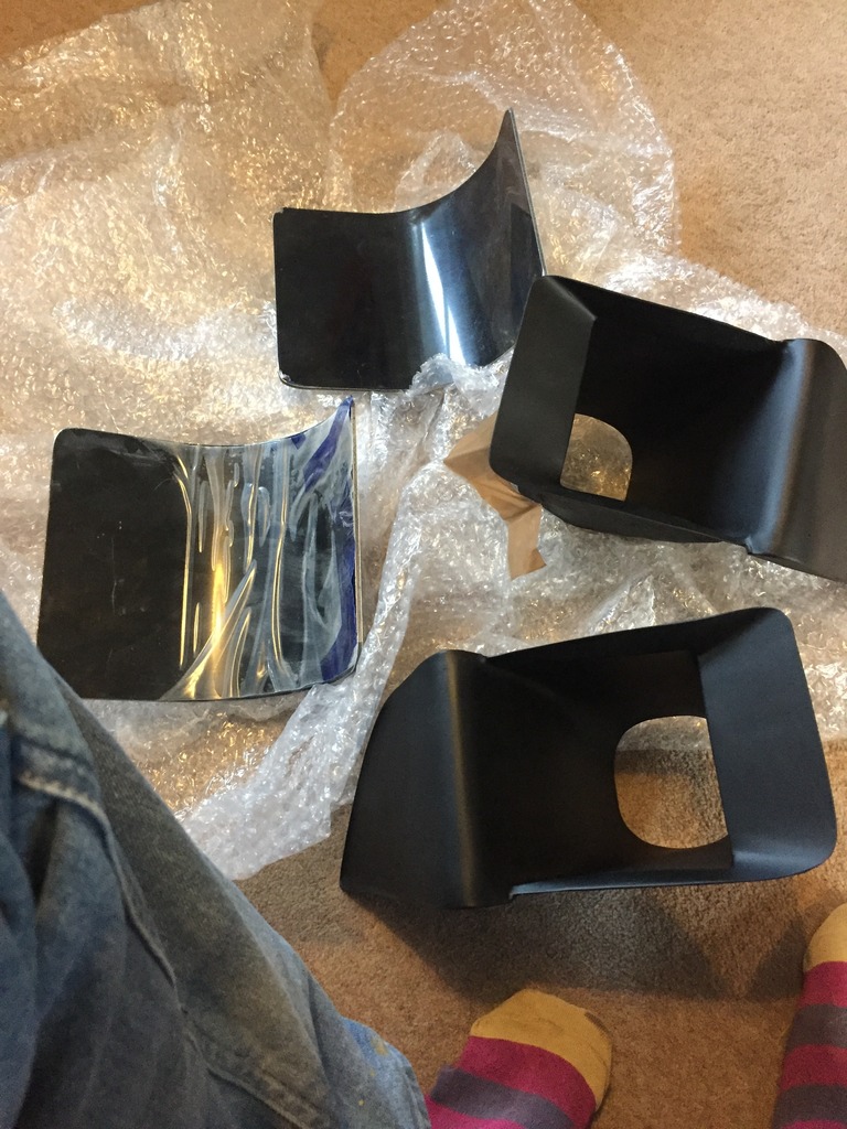

Also found a problem with the brake ducting. The tubing is held on to both ends by cables ties which is fine the first time you fit them but every time you want to take the bumper off/put it back on its a right pain. So left them off for now and see if i can find something else. Slightly ashamed but my inner chav came out. The car is jacked up here so no laughing at the arch gap...

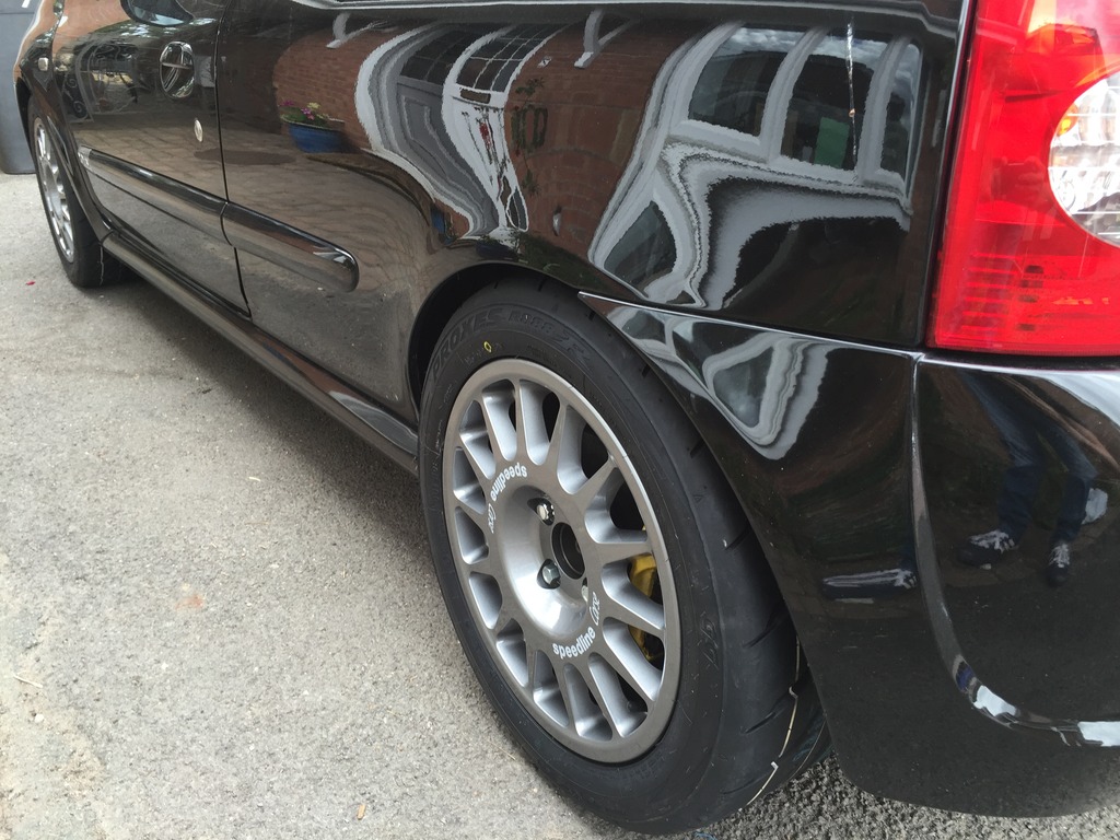

Great progress again, really am feeling a set of those wheels for mine at the mo :grin:
Will look awesome when lowered on the coilivers though, that'll make it sit much better on the wheels............... oh and those stickers are acceptable, they don't cover half the rear panel lol!
thanks :D i think there is a set for sale the same as mine on here. buy them before i do! i need a set for wet tyres

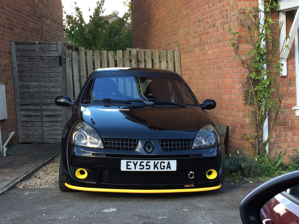

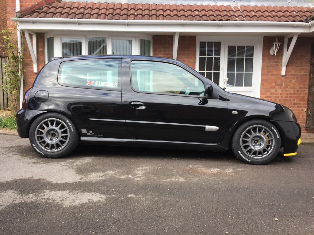

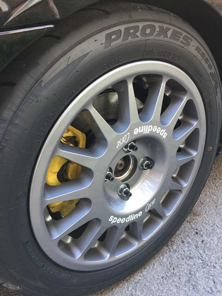

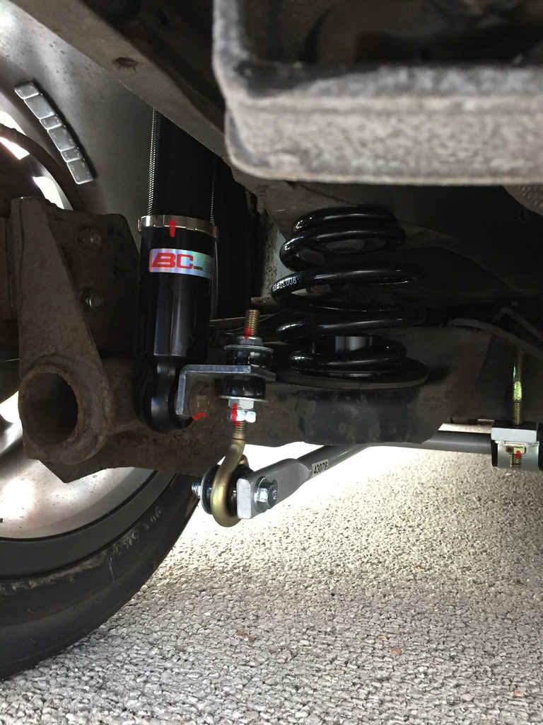

Soooo driving up to the matey who was going to do some work for me the car died (3 times). Luckily i thought ahead and got a mate to follow me in his car with jump leads and every time it died we managed to jump it. Was very stressful but we got there in the end. He managed to source/fit a new alternator and that's cured the problem so that's good! Anyway here's what its had done:
  • Installed BC Racing coilovers & adjustable top mounts
  • Installed Whiteline RARB
  • Full suspension/roll bar polybushed
  • Engine mount polybushed
  • Axle spacers behind and hubcentric infront
  • Camber bolts/shims
  • Hub stud conversion
  • Full get setup to use the 15" 2118's and R888R's
Here's some piccys:
Also done a few other things to tidy up the car/help on the track like pms tow eye and matte black sunstrip. Bedford is booked for the 17th October so cant wait for that. Ive joined the group buy for a full cage from MarkFish so thats next on the list a long with some buckets and harness. Thinking Sparco Evo LF's & Schroth Clubman 2 6points. Let me know what you guys think.

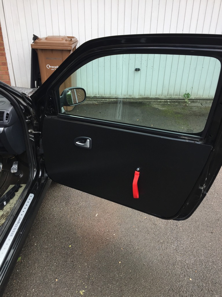

Where are your door cards from, what have you done with the electric window switches or you fitting poly windows?
The door cards are from a group buy on here from Bristolnate. I've just tucked them behind the cards for now. Once the cage and harness are done the next step will probably be fibreglass body parts and plastic windows so didn't see the point in wrecking these. I don't use the car for anything but track so it doesn't bother me

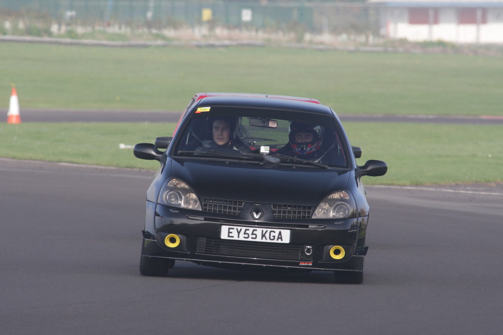

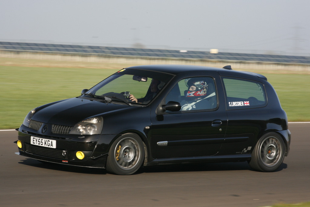

Hi mate. Was good to meet you. Had great fun chasing you around Bedford. I was waiting for you to come flying pass me and outbreak me on that hairpin :smile: what brakes are you running you were stopping seriously quick? I remember you said you had to run the 16's.
Yeah put the vids up mate that would be great! :up:
Hyperhatch
  182
I'm running the PMS 300mm disc brembo 4 pot conversion with DS3000 pads. Only just fits under the standard wheel with 25mm spacers and wheel weights on the inside:tearsofjoy:
First video is before lunch (I think your mate was driving?)
Second video is after lunch after the Red flag
It felt even closer than the video shows at the end of the back straight 🙈:up:

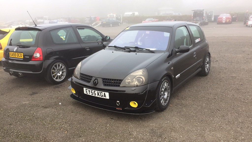

Haven't got too much to report at the moment. Took the car to a very foggy Castle Combe. We didn't get track time till after lunch which was annoying but nothing you can do about it so spent the time talking to everyone and drooling over the Radicals and a 400bhp CooperS. The car has been flawless so far, hasnt skipped a beat. Really happy with the setup and everything. I'm burning through the toyo's :smilingimp: Might switch to the DS1.11 pads for the fronts when the DS2500's die. Few pics from Combe...
Just been doing a few bits and bobs to the car to improve it nothing too exciting. Waiting on the cage at the moment then once I have a date can order some buckets etc. Bedford is booked again for the 19th this month and that might be it for the year. Will be doing my trailer license over winter so I can take the car off the road and really strip it out.

How you find the bc's mate ? I've been toying with the idea lately can get a pretty good deal on them
  MK7 Golf R, Clio 182

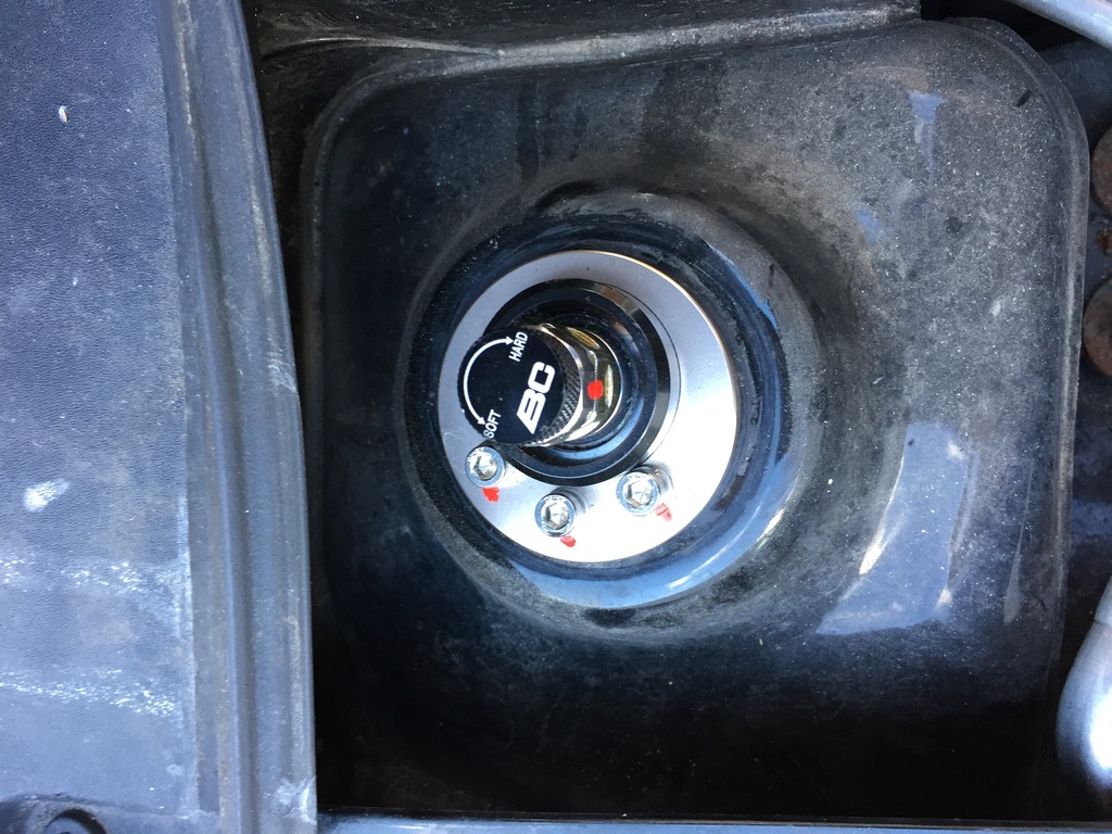

They have been spot on. My mechanic/Motorsport prep guy was very impressed with the quality. They have been great on track so far. Brilliant on the full hard setting. Brutal on the road though. But you can turn them to soft I guess. Get the adjustable top mounts too. Think for the money there isn't much better :up:

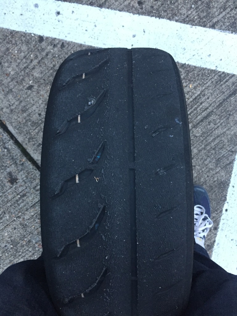

Did another day at Bedford. Car behaved brilliantly only problem is im eating tyres haha

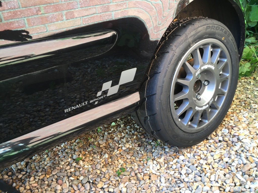

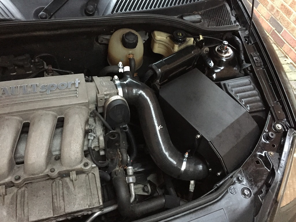

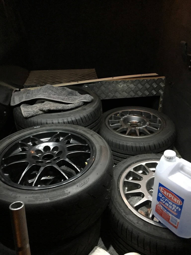

Bank account has taken one for the team recently. Managed to pick up another set of 2118's with some wet tyres, was lucky enough to get a battery cover from the group buy and fitted a ktec induction at the same time.

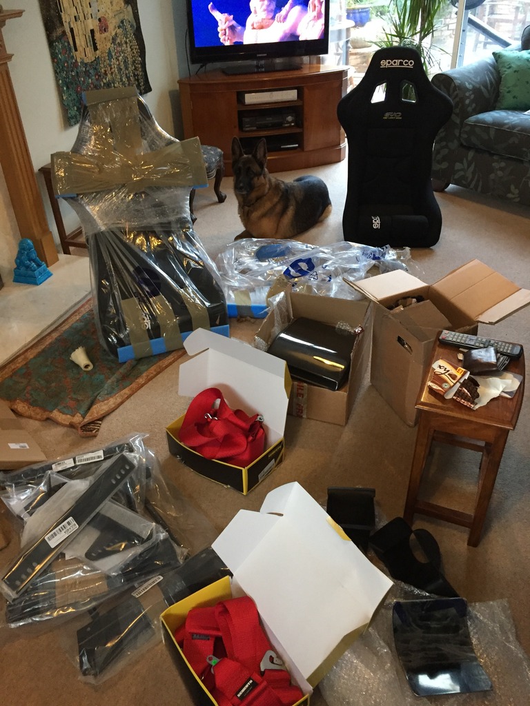

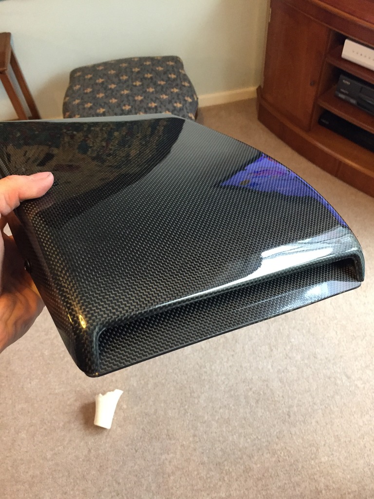

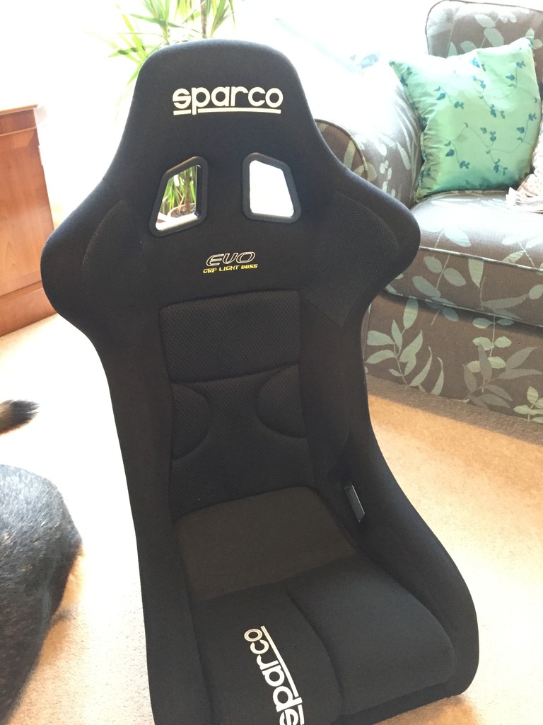

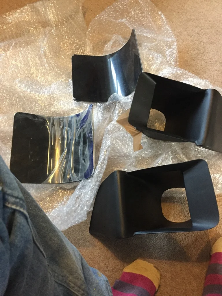

Sparco Evo LF buckets with subframes and runners, Schroth 6 point harnesses, trs carbon fibre roof vent, cm composites brake duct system. Hopefully going to have time to get this all in before the new year. Then just waiting on the cage and can get the interior painted when that's fitted. :up:
