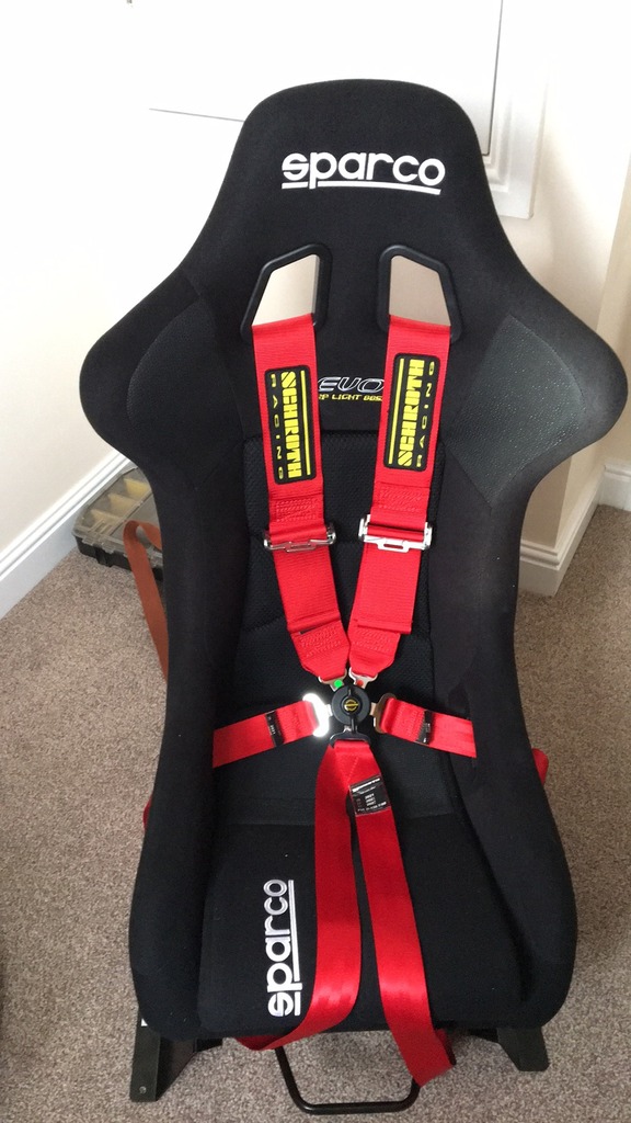

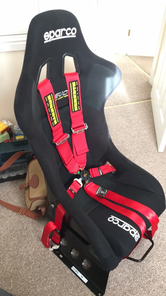

Picked up a few more parts that need fitting. PMS a/c delete, PMS racing exhaust with decat and PMS gear linkage kit. Also got a Ricky Evans heated front screen so we can completely ditch the heaters and fans to save weight. Came in a nice big box (not sure how im going to get it to my guy yet)....

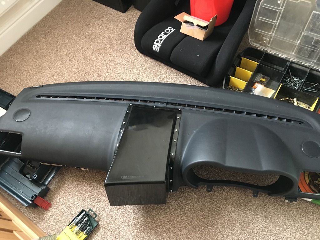

Been doing little things that I can do while its waiting to go off for the cage. Fitted the dash pod and made up the seat runners and frames ready to go in so I can strip out the seat belts and get the Trendlines out (which i will be selling)...

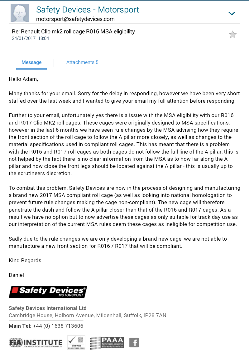

You're waiting for the new cage to be produced I assume? I emailed safety devices last week and they've confirmed the current ones are no longer Msa approved and are now specified as track day only

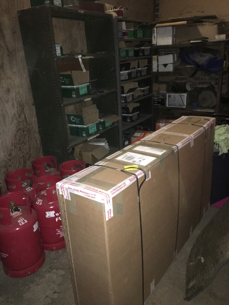

Im at a bit of a loss with what to do with it to be honest. Ive ordered the old cage (my order was placed before this whole problem started). I dont know weather to install it for now and change it (which would be a pain in the ass) or sell it as a track cage and buy a custom cages msa spec weld in. I could pull out of the buy but i've paid the deposit and dont want to be a pain for MarkFish. But he also said that the cages were going to be in for delivery around xmas last time I spoke to him and we are a month on now and i've heard no more. Its all a bit of a mess at the moment.

I'll grab a screen shot of the email SD sent me, basically they won't be doing anything for those of us who have the existing cage, no new front sections or compatible replacements etc etc :(
  MK7 Golf R, Clio 182
I'll grab a screen shot of the email SD sent me, basically they won't be doing anything for those of us who have the existing cage, no new front sections or compatible replacements etc etc 😧
b****cks. Thank you for putting that up that's great help :up: Wonder if im better off just cancelling my order and loosing my deposit? (Was £100 but otherwise im going to be stuck with a useless cage. Guess selling it wont be easy as most people who want a cage will want a MSA spec one.)
  Clio 172 Merc ML55
It may well be, £100 isnt the end of the world compared to being stuck with a cage that can't be used. Unless Mark Fish can do something regarding the 'new' style cage

I'm on the list for the new cage with Mark Fish. I've been told 20th March (approximately) delivery for it and then it will still need installing. Not ideal but the above email above has confirm it will be worth the wait. Ideally I wanted to be using the car again early March:pensive:
  Clio 182
That's absolute crap that they won't make the new style front cage compatible with the old rear cage.....don't see any reason why they can't other than to make someone have to buy a complete new cage that has the old one!! Very poor show from safety devices if that is the case (and I fitted a full cage last year with the intention of being able to race the car at some point). Most Clio's I've seen at race meetings have the bolt in dash dodger type cage!!
I was tempted to do the same but I don't really want to wait that long for a cage. Been waiting two months now to find out this one isn't going to be good enough.
Think it was MarkFish's idea to save people money and hassle but safety devices arn't doing it from what I've heard. I know a few that race with this cage but some havent heard about it. Guess everyone will find out when they go for scrutineering
Having got the cage myself I can't see how/why the newer style front section couldn't fit the old style rear cage as that won't change I don't expect, would be purely a money making exercise in my opinion!
Ive got a friend who fitted mine who is a fabricator/cage builder anyway so will mention it to him as to whether he could either mod my front section or fabricate a new front section altogether.......
SD did touch on the fact they've changed the material cages are made from, whether that has an impact or not I don't know, short of going to the MSA, which I am tempted to do to be honest
