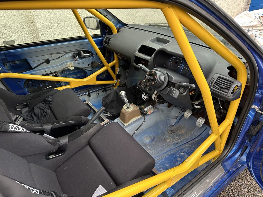

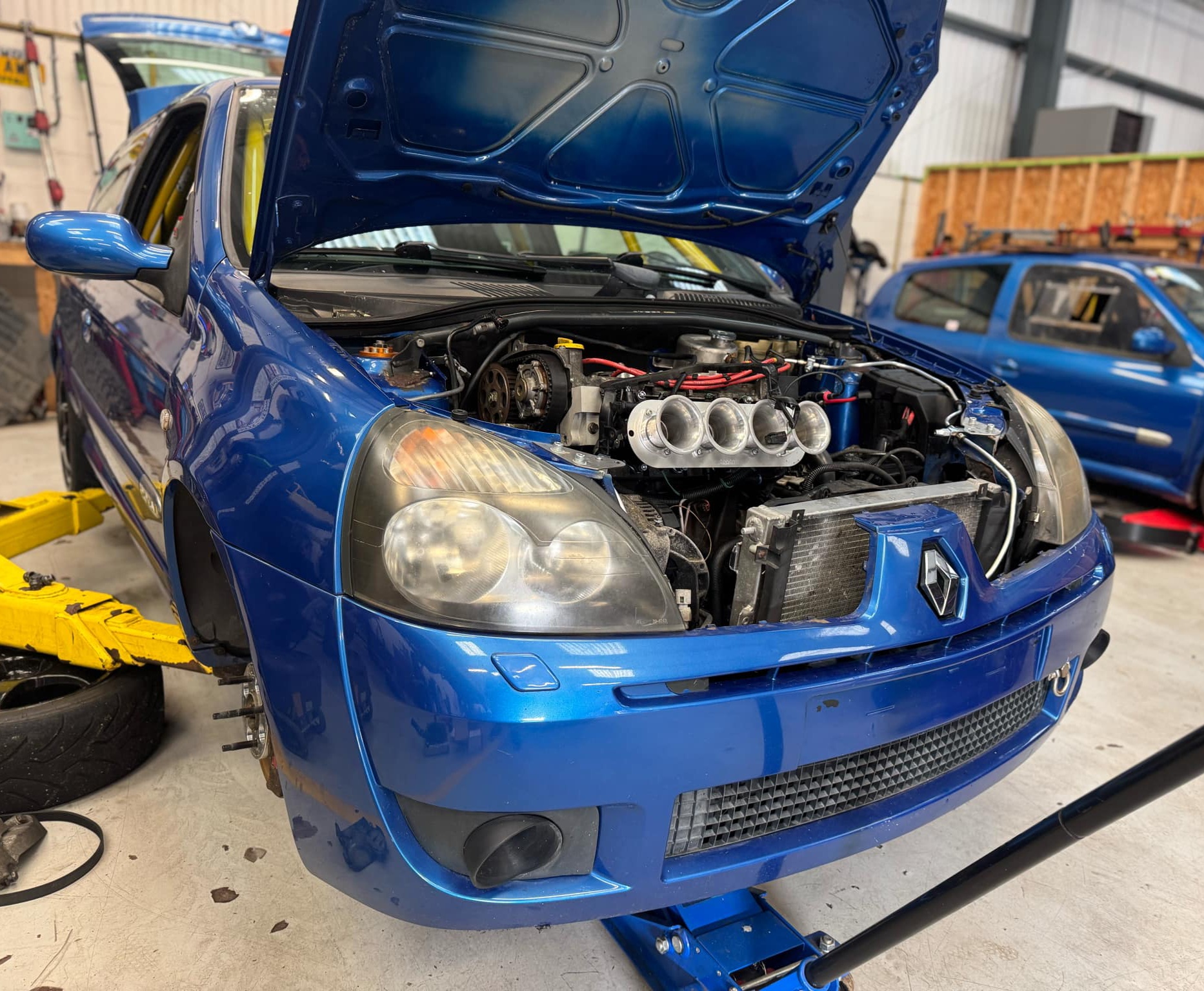

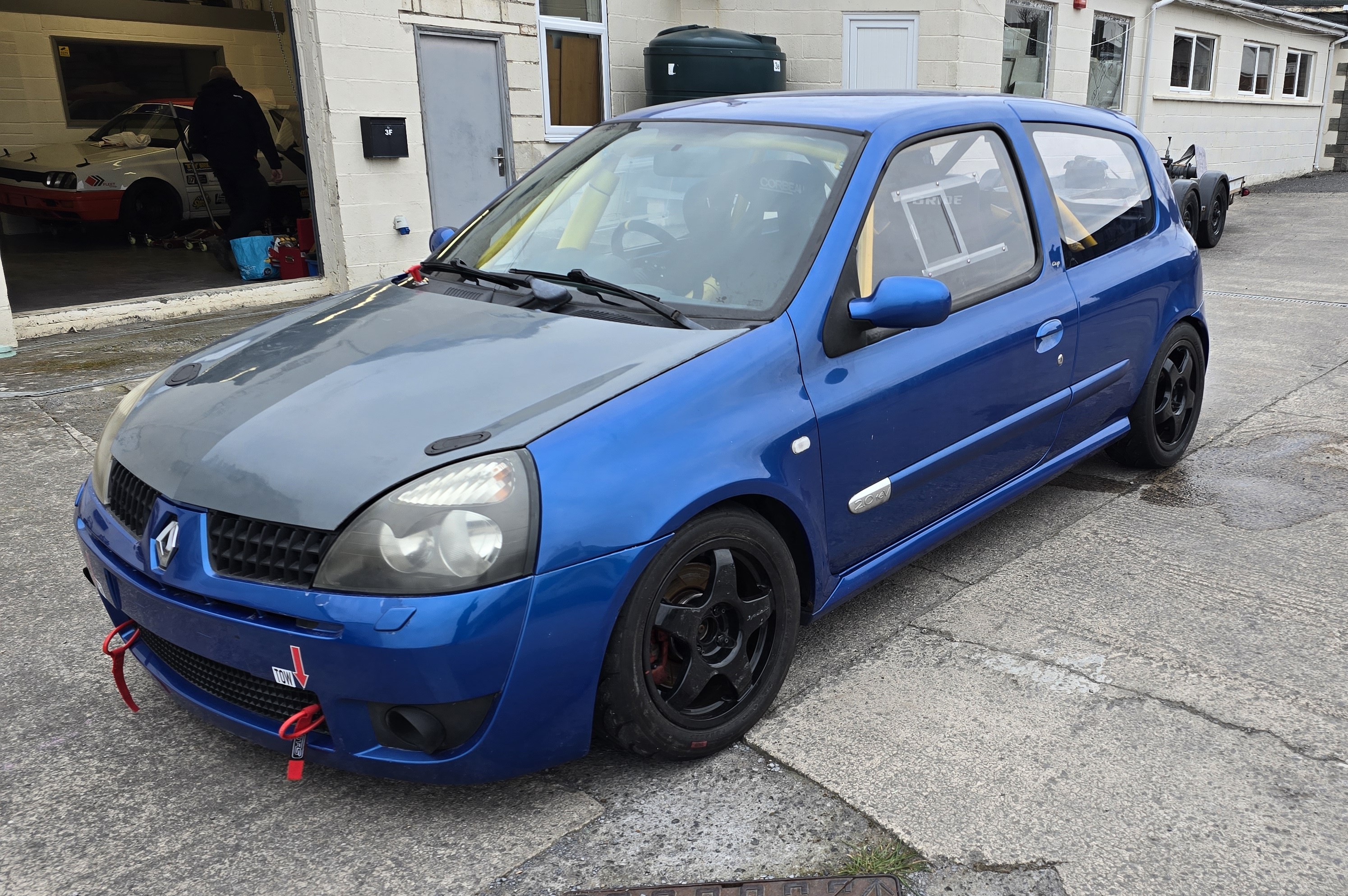

Hello, new to the forum, nice to see a forum still alive for once!

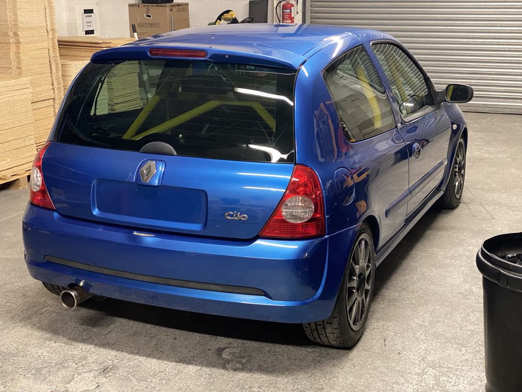

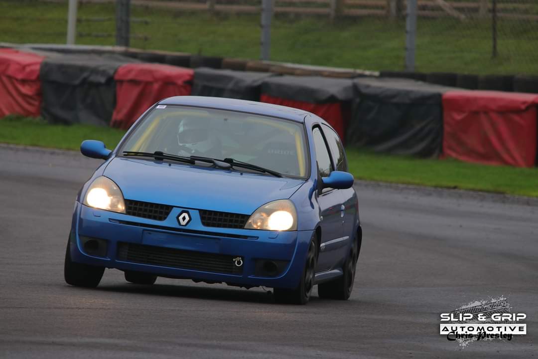

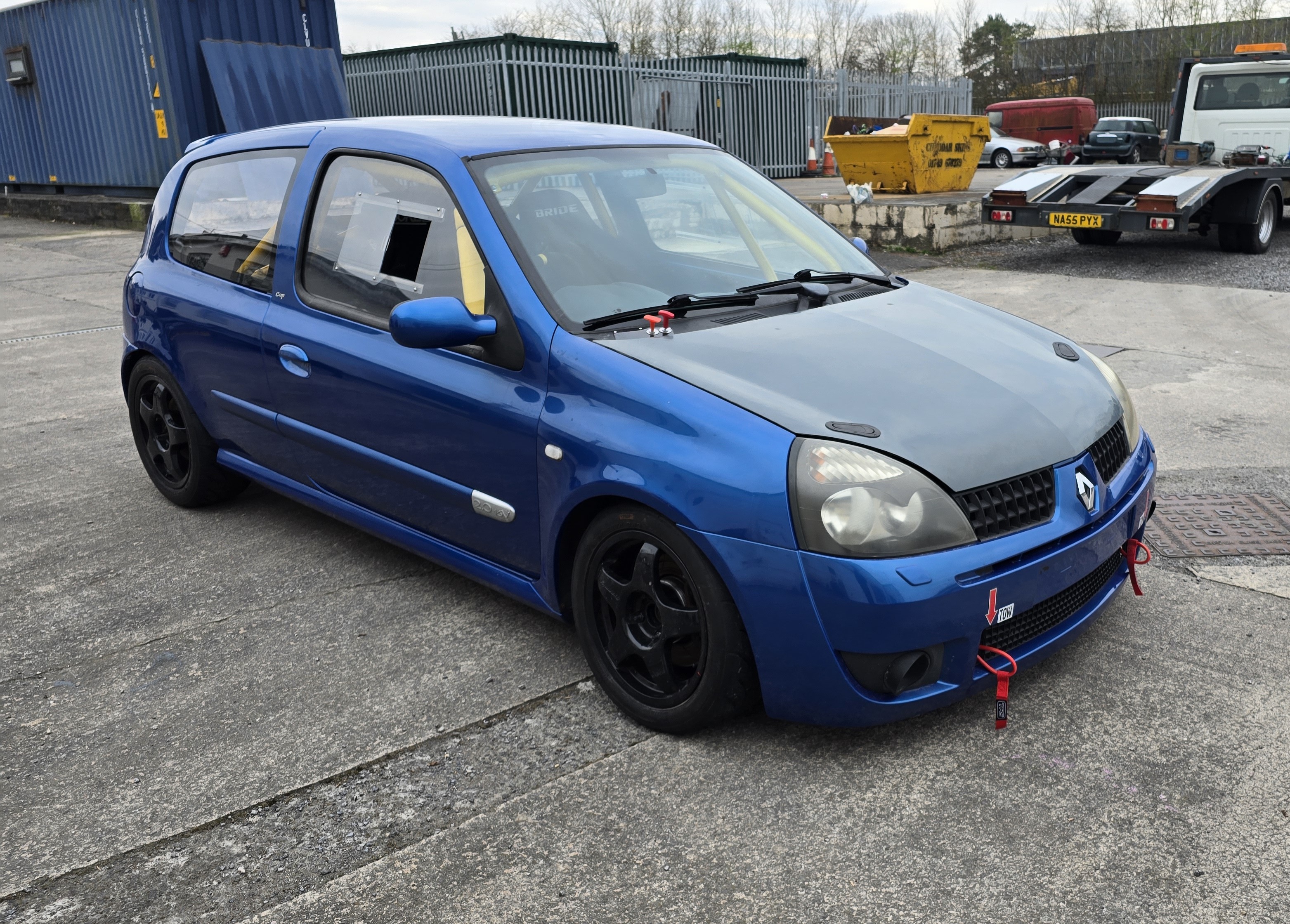

Here's my 172 cup that's been built over the winter to compete in the 2025 hot hatch championship at castle combe 😊
Last year I ran the peculiar mk3 golf, due to waiting for the peppier engine to arrive, the clio has gone from "seat time car" to "out of hand car"
Dan

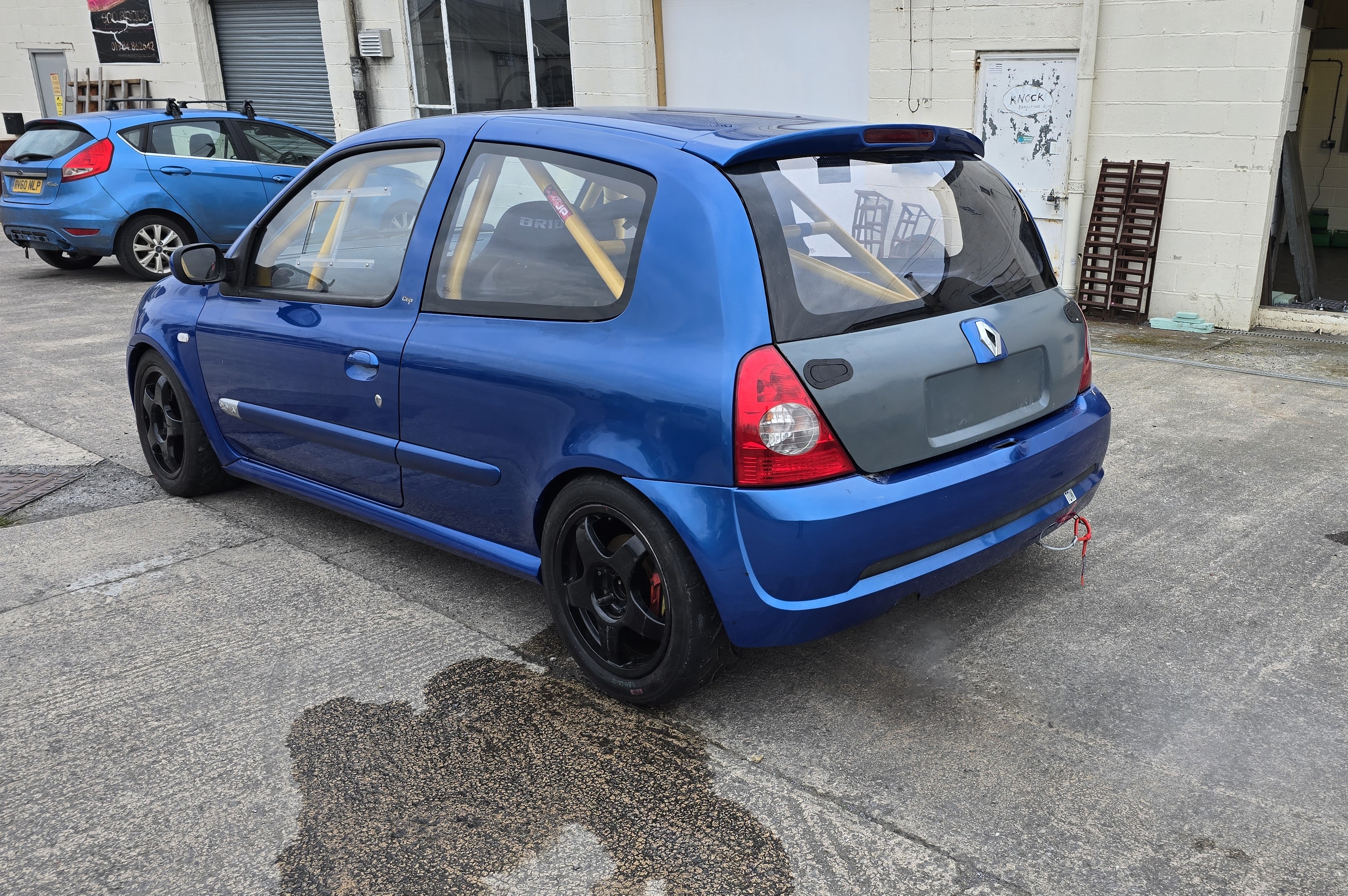

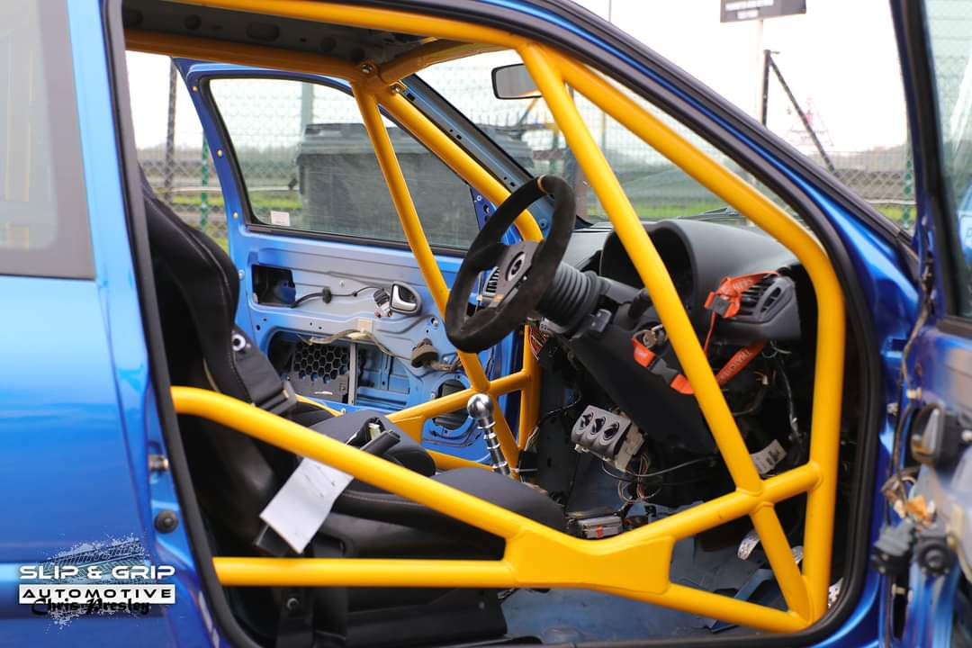

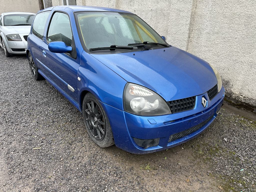

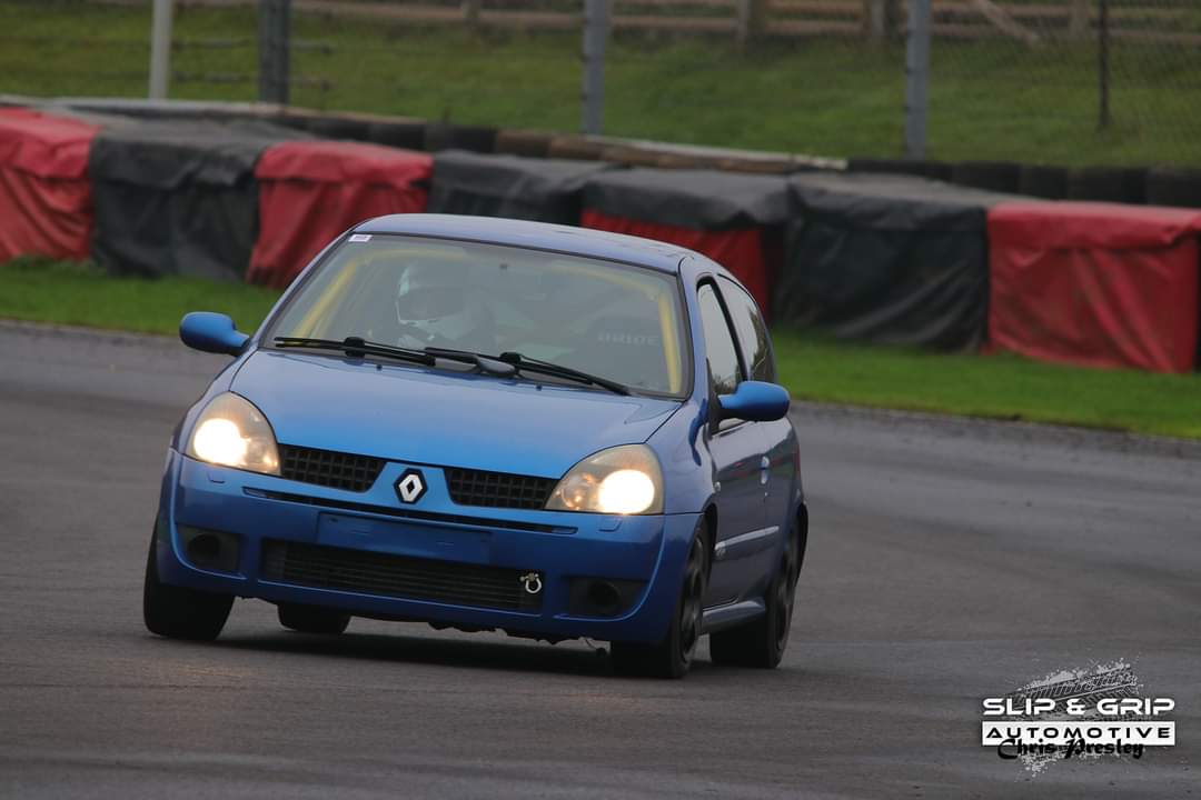

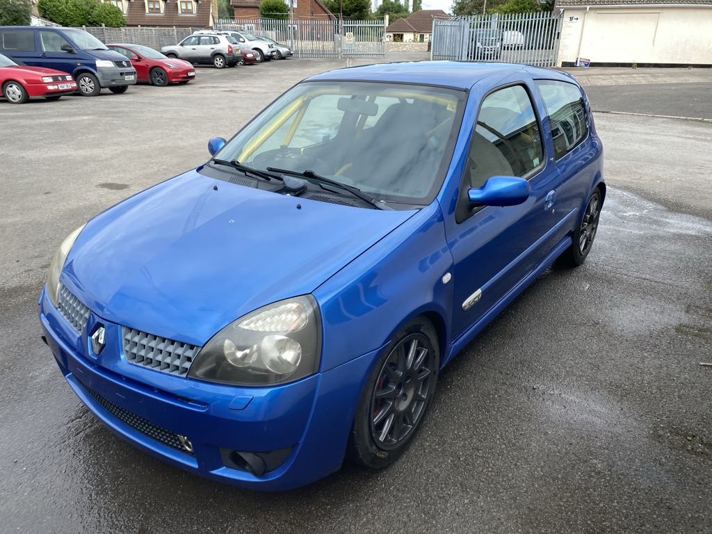

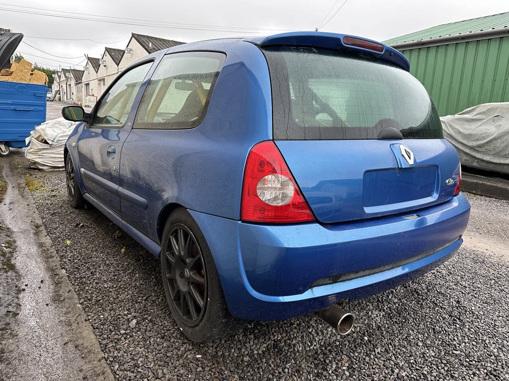

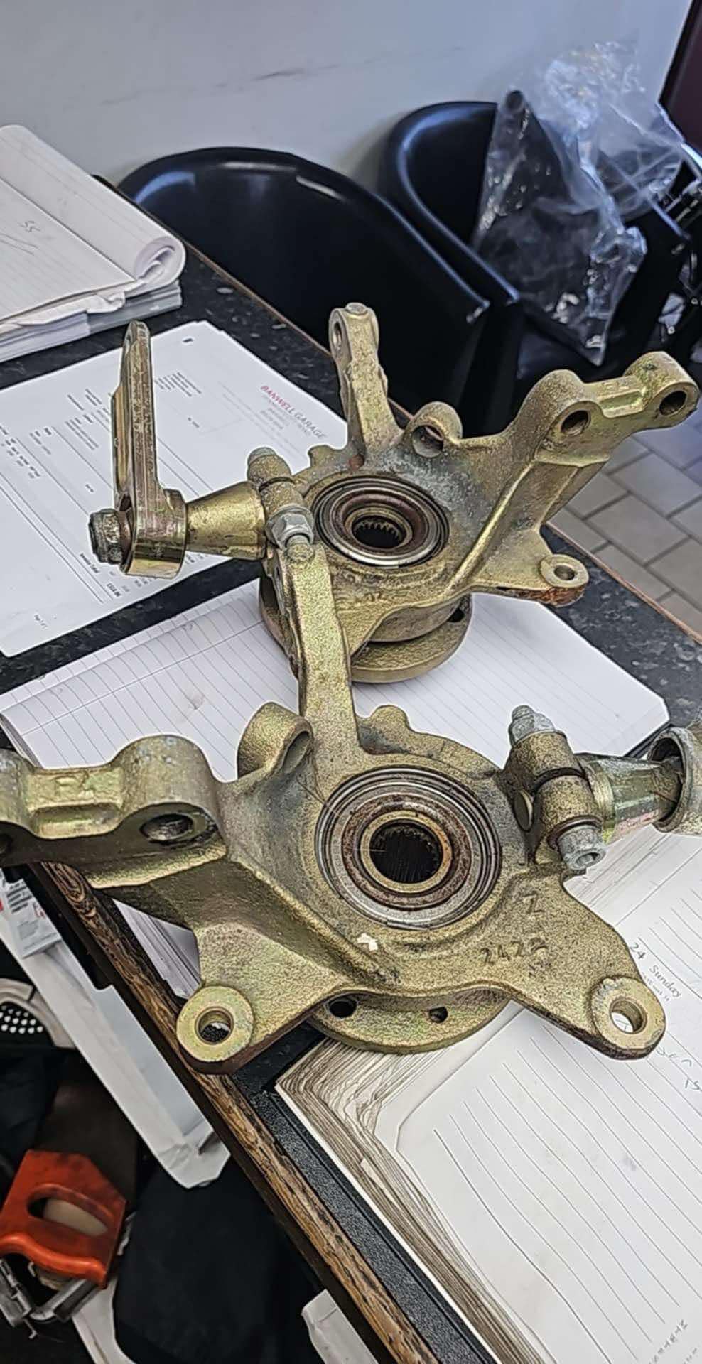

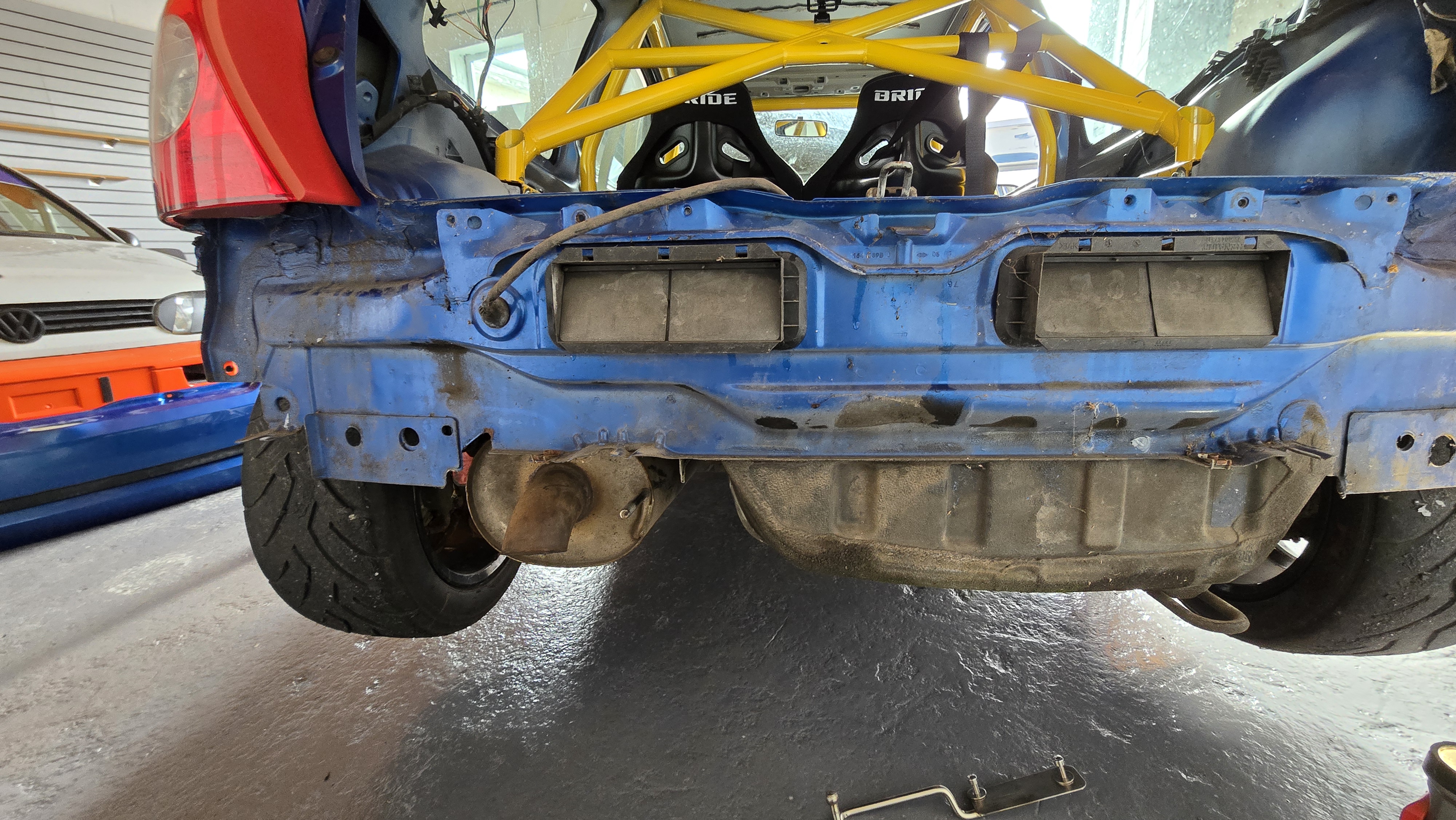

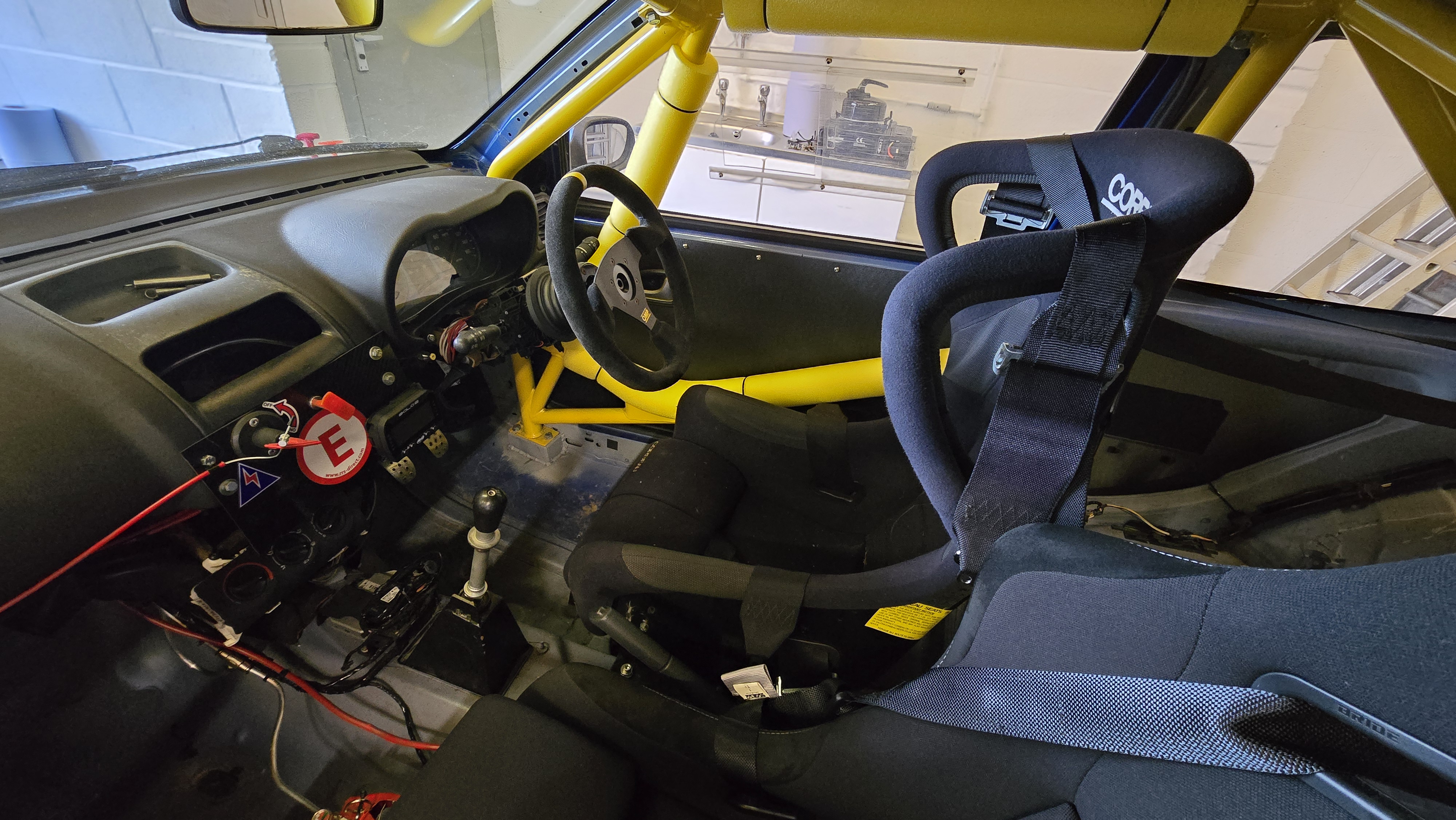

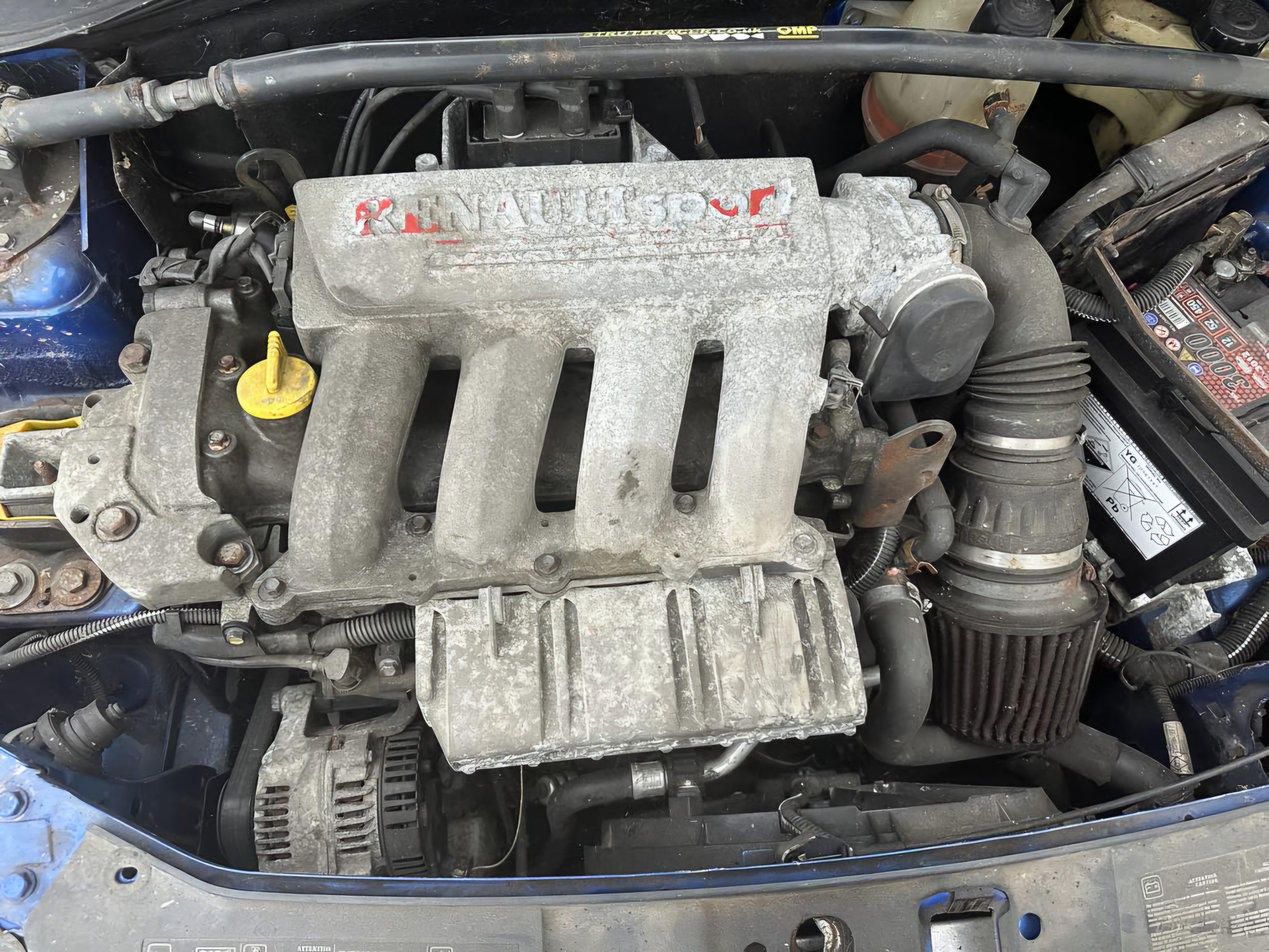

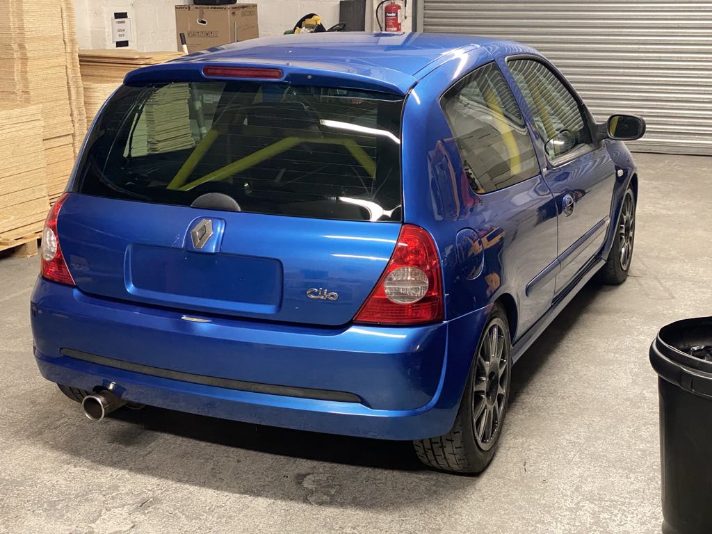

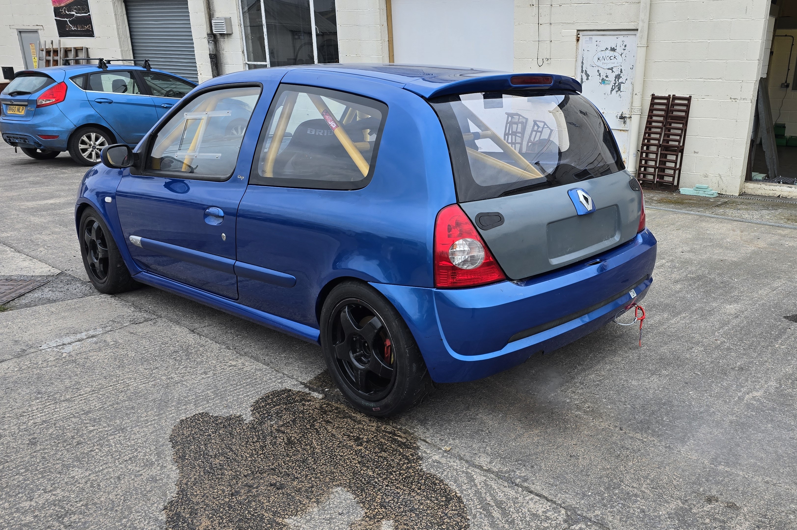

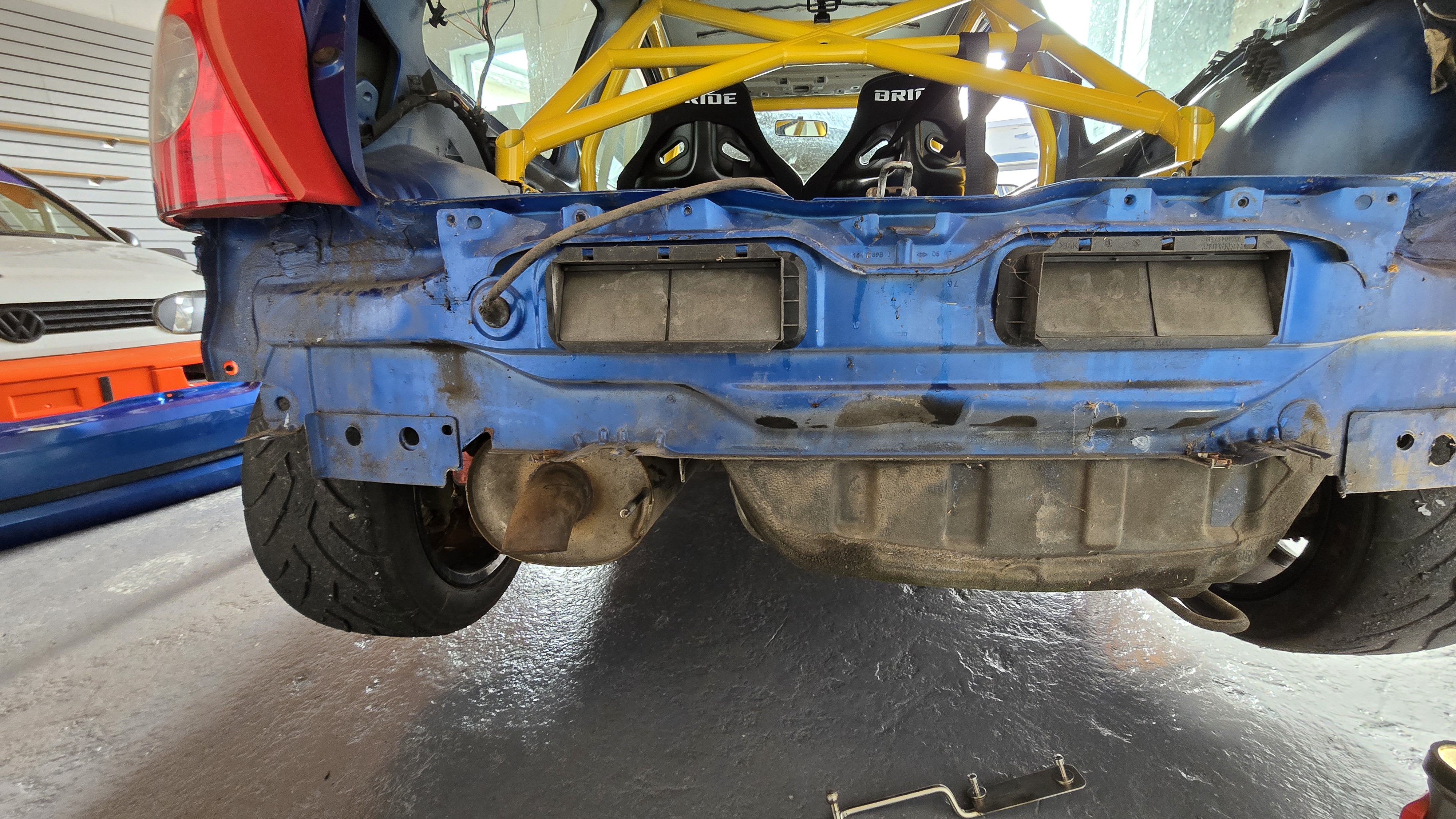

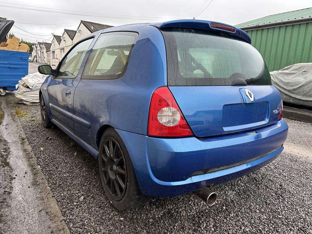

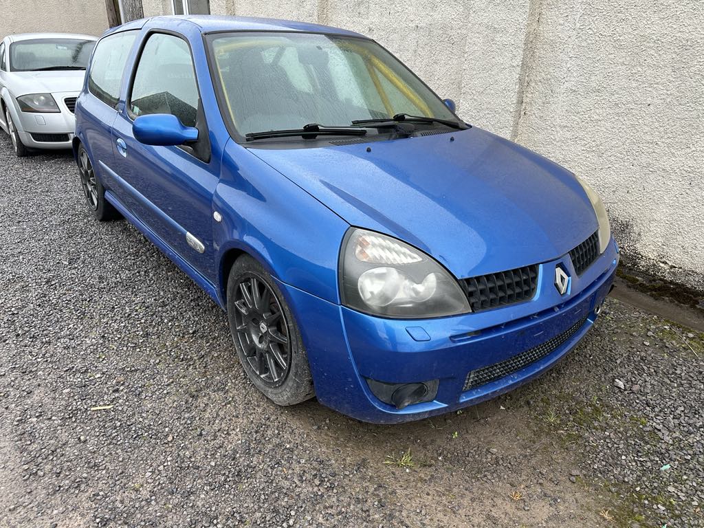

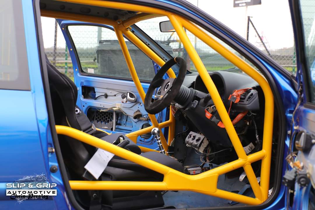

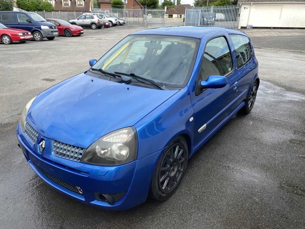

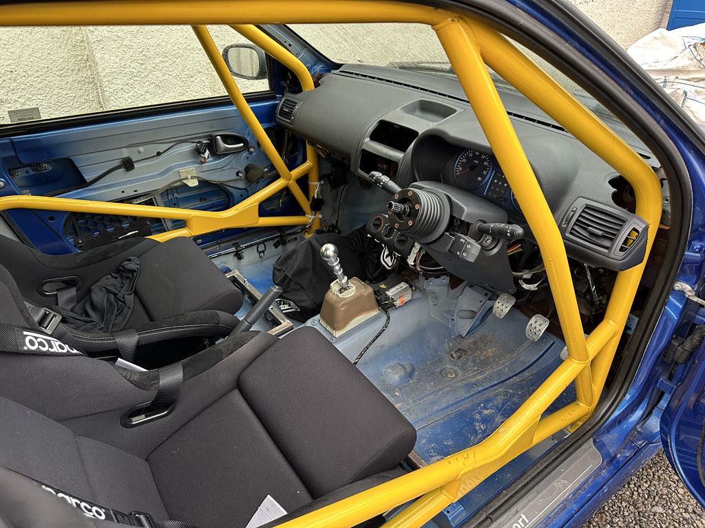

Clio as purchased mid 2024, a cup, partially stripped with a jp cage, essentially standard, ideal for some cheap fun..

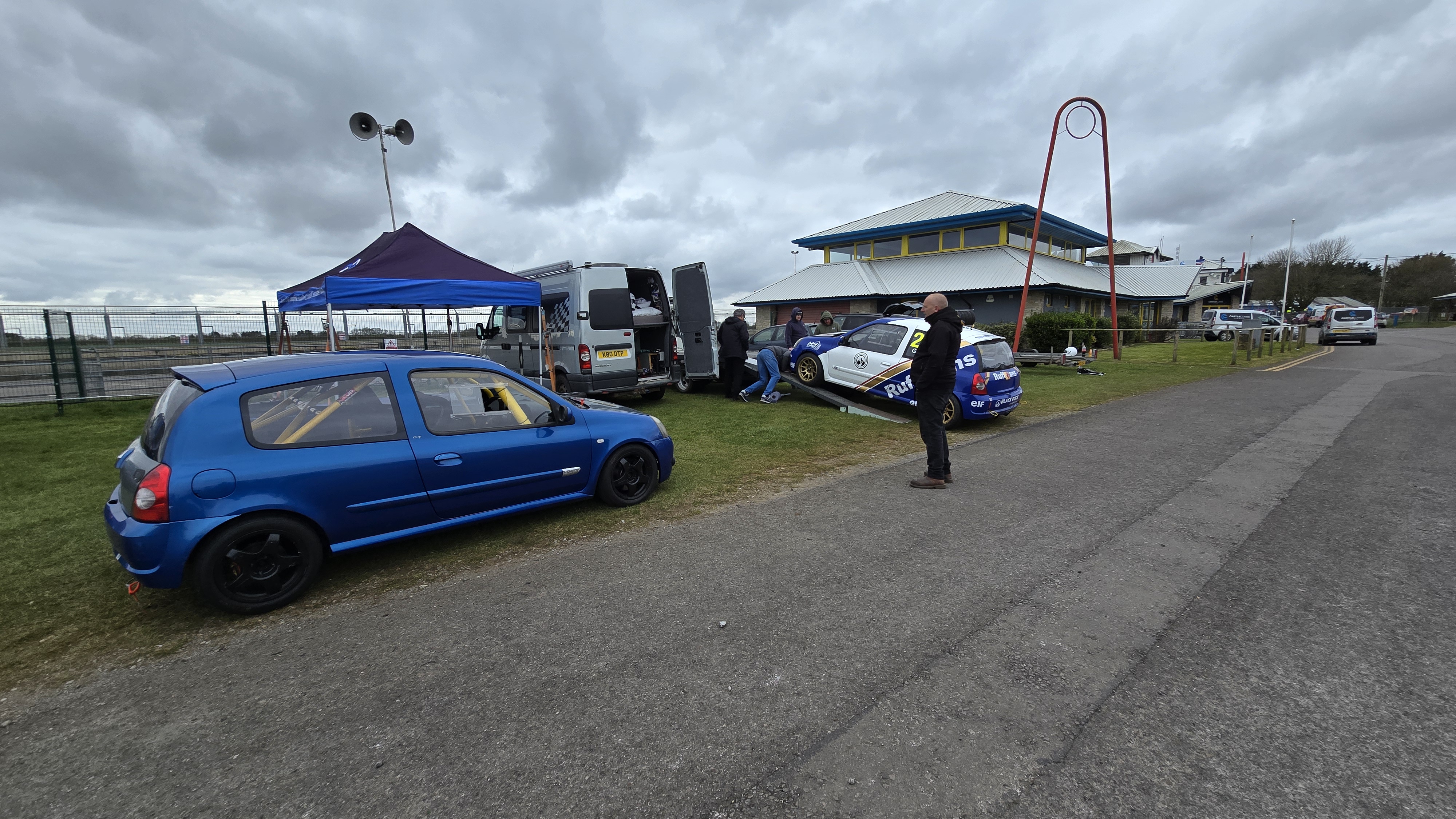

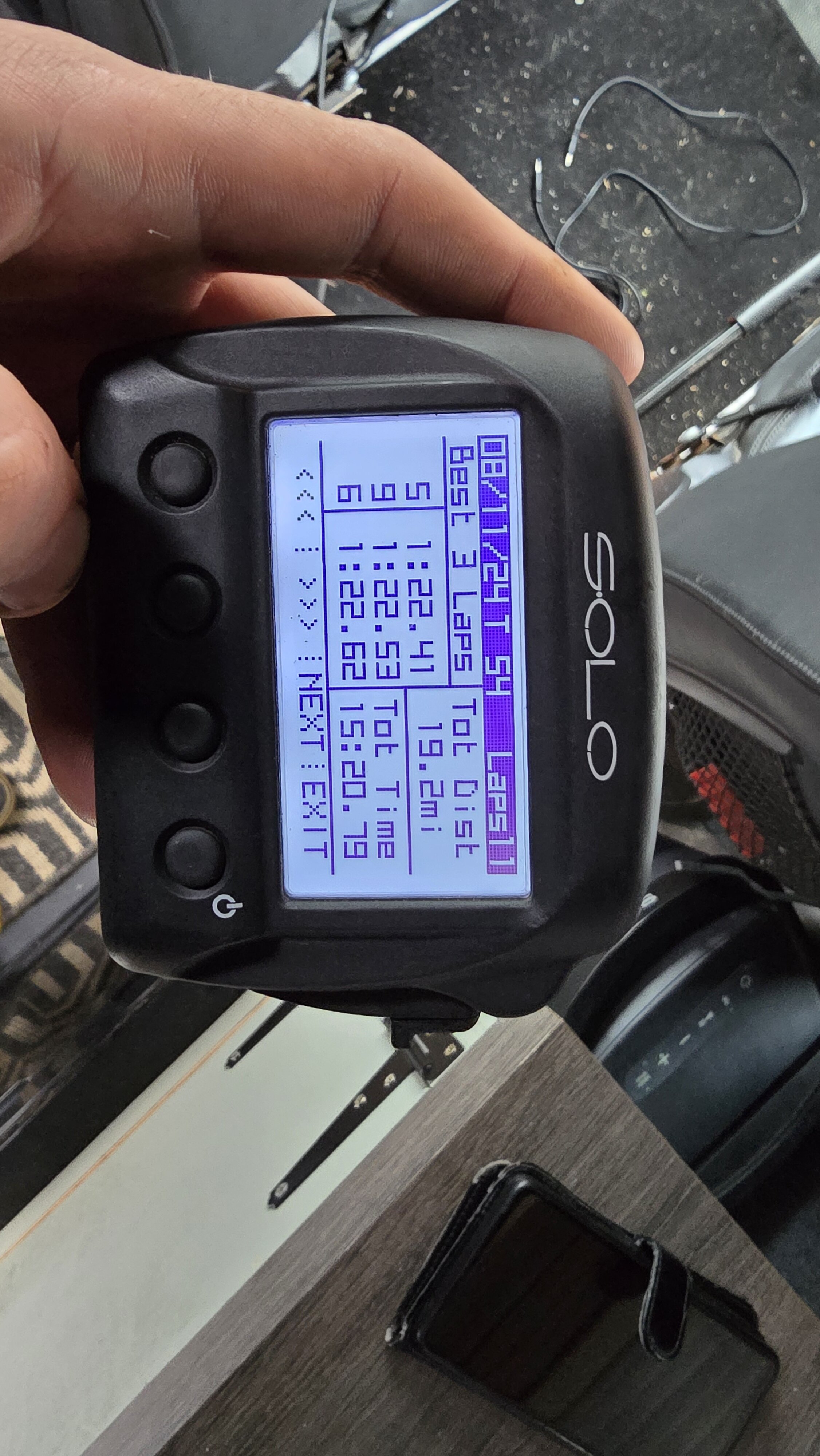

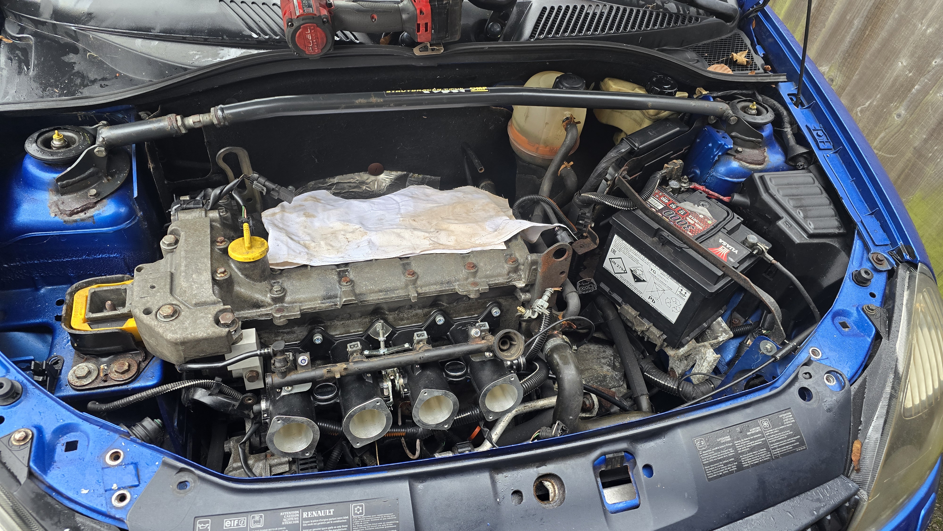

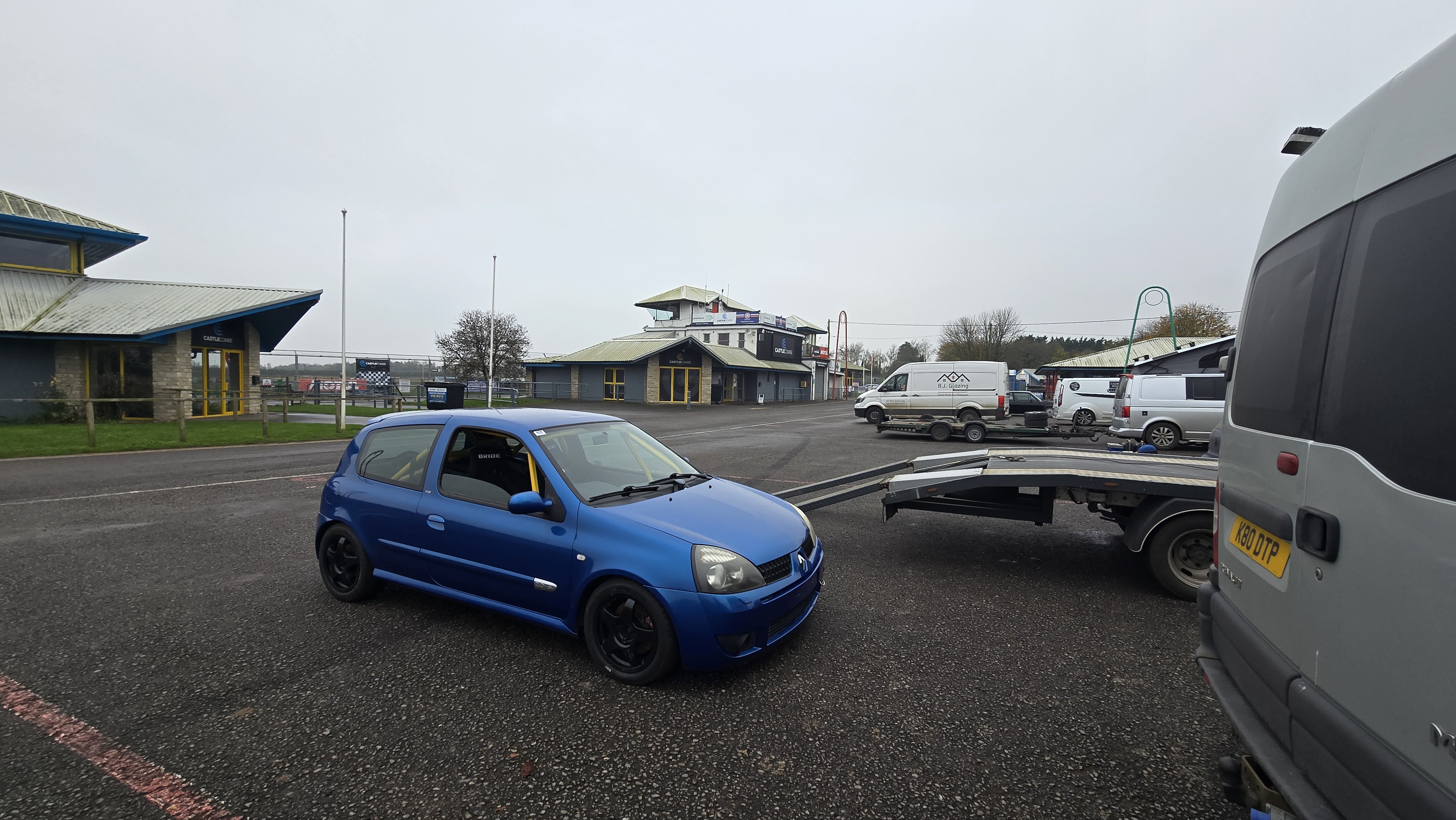

In November we headed to castle combe for a trackday in its bought form, this was after the end of the race year, golf's engine was already out, the clio went well, weird misfire issue but ignited the urge to build the car over winter, March 17th we have a test day booked, this was the time goal 🥲

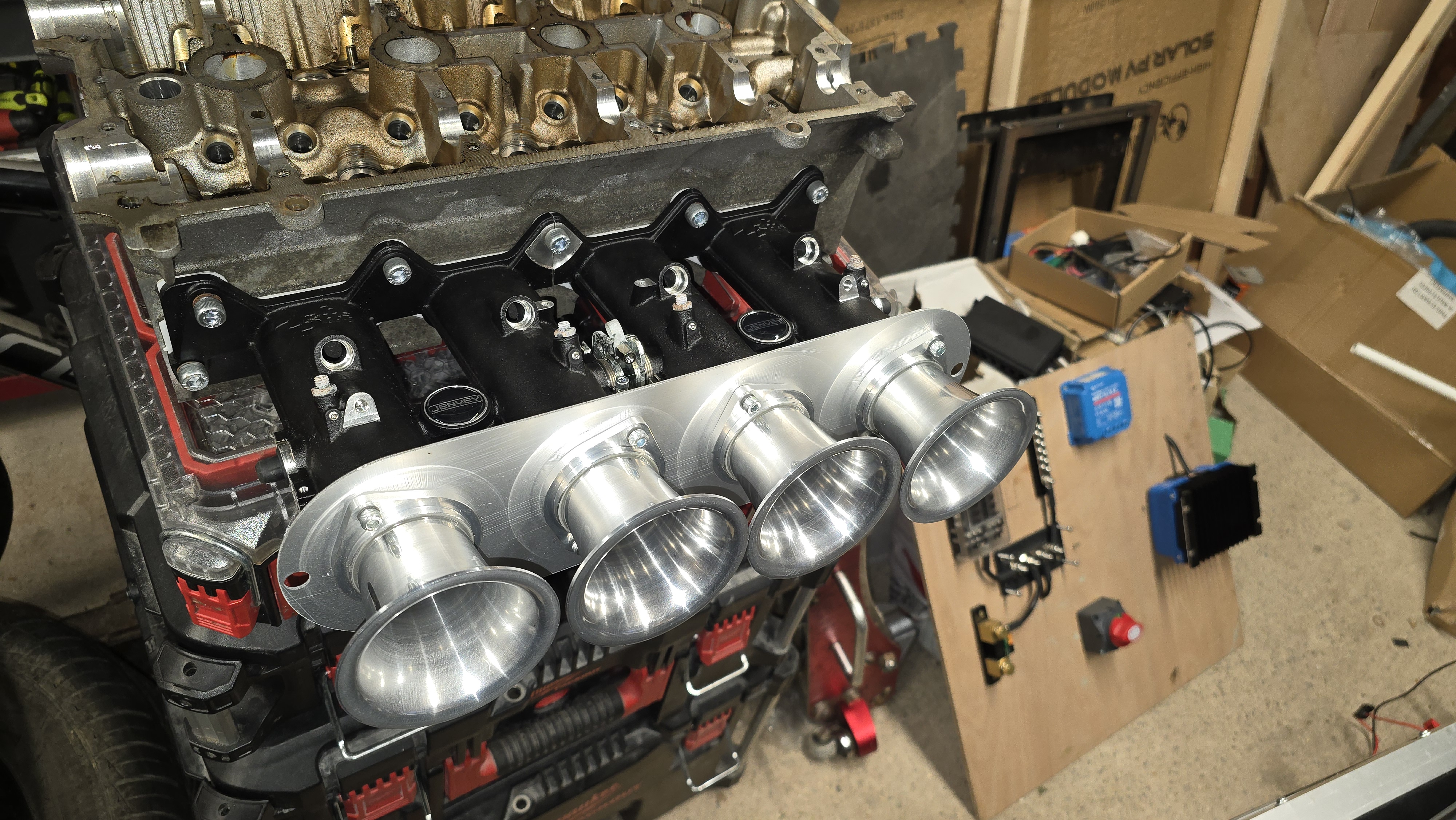

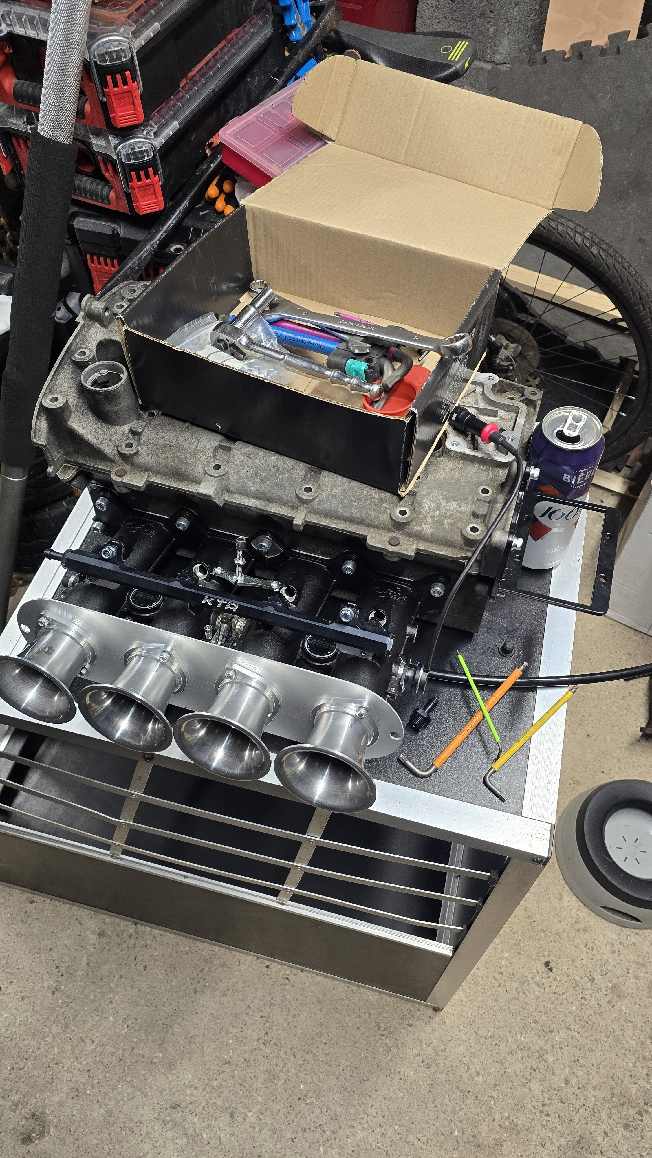

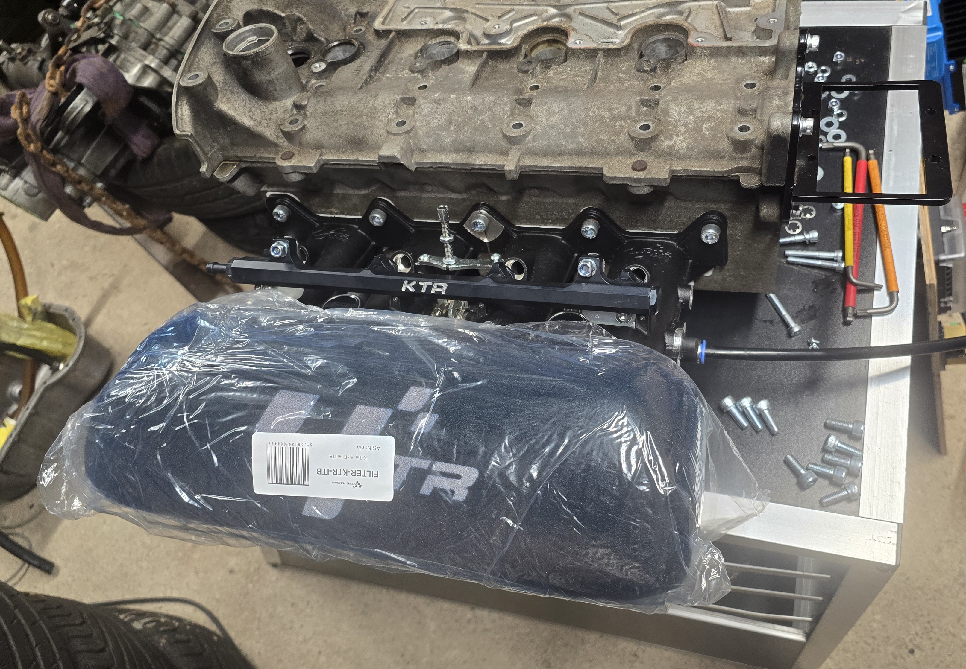

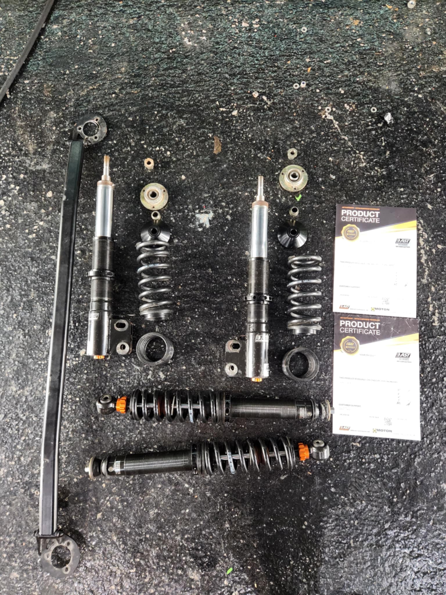

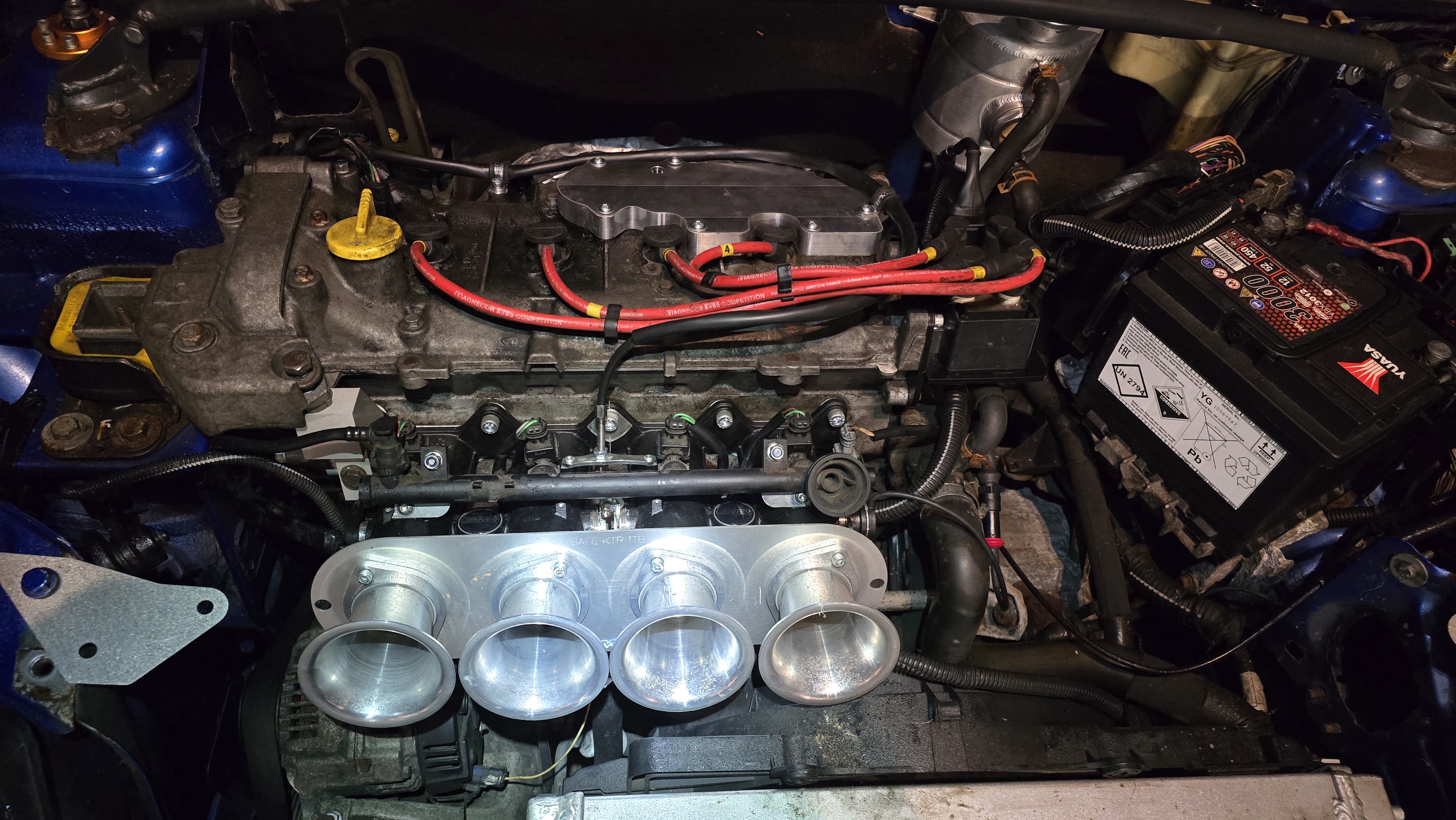

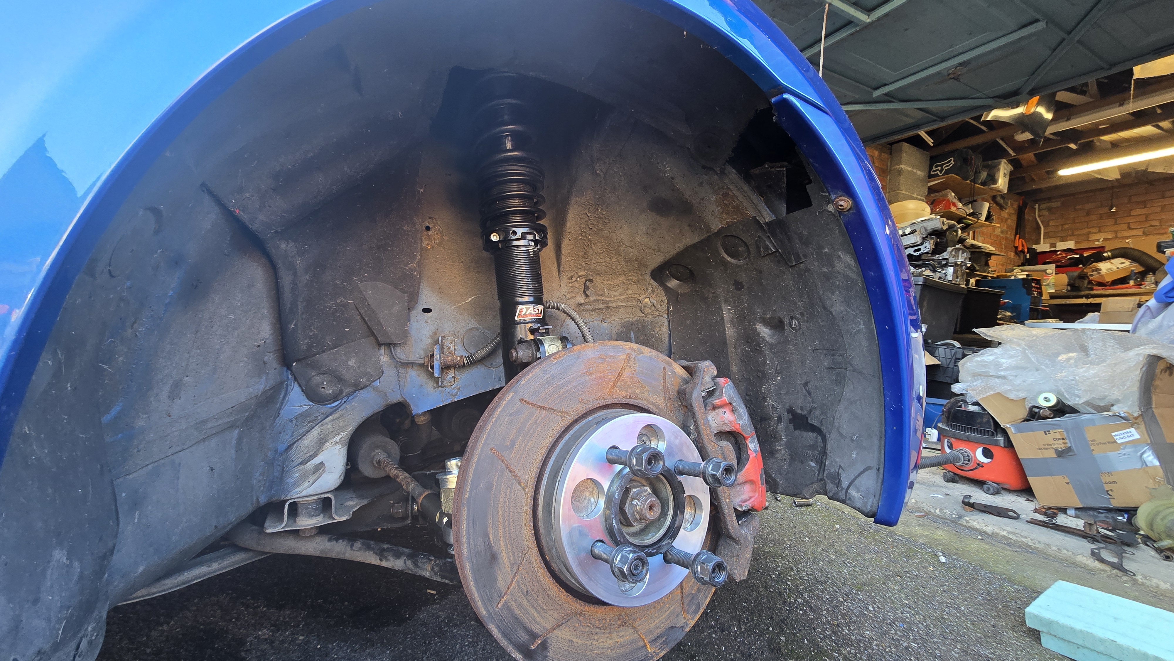

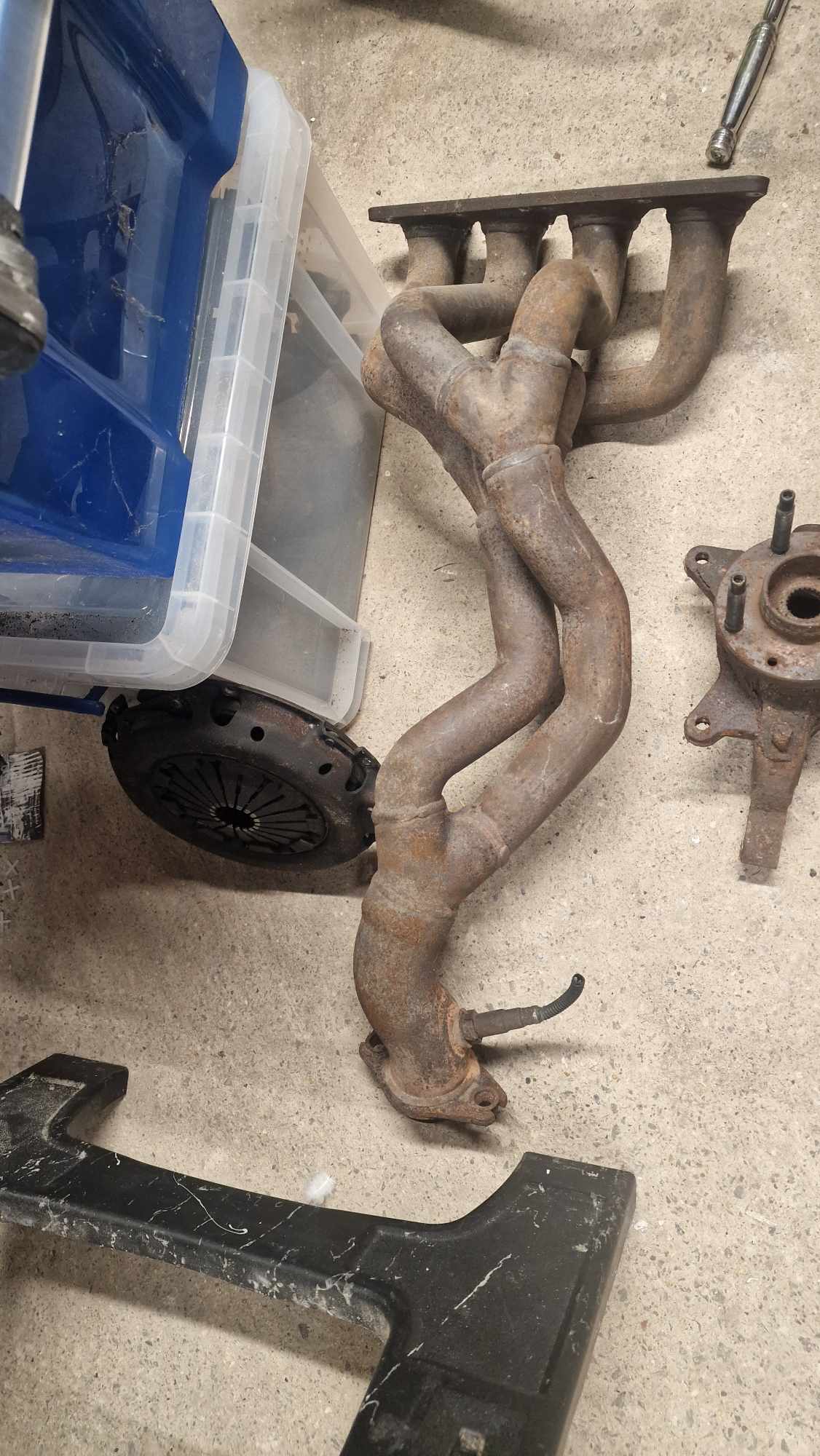

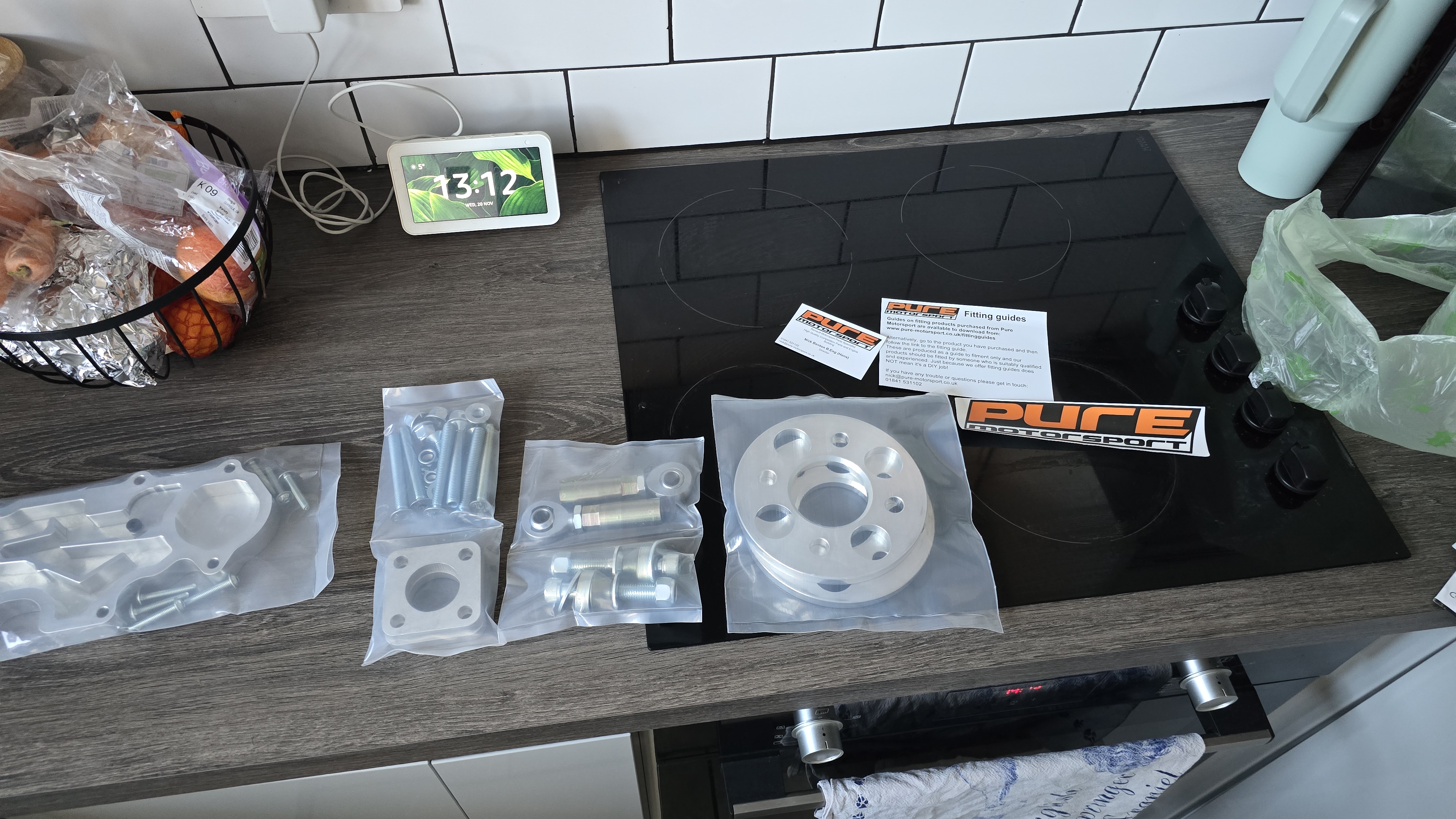

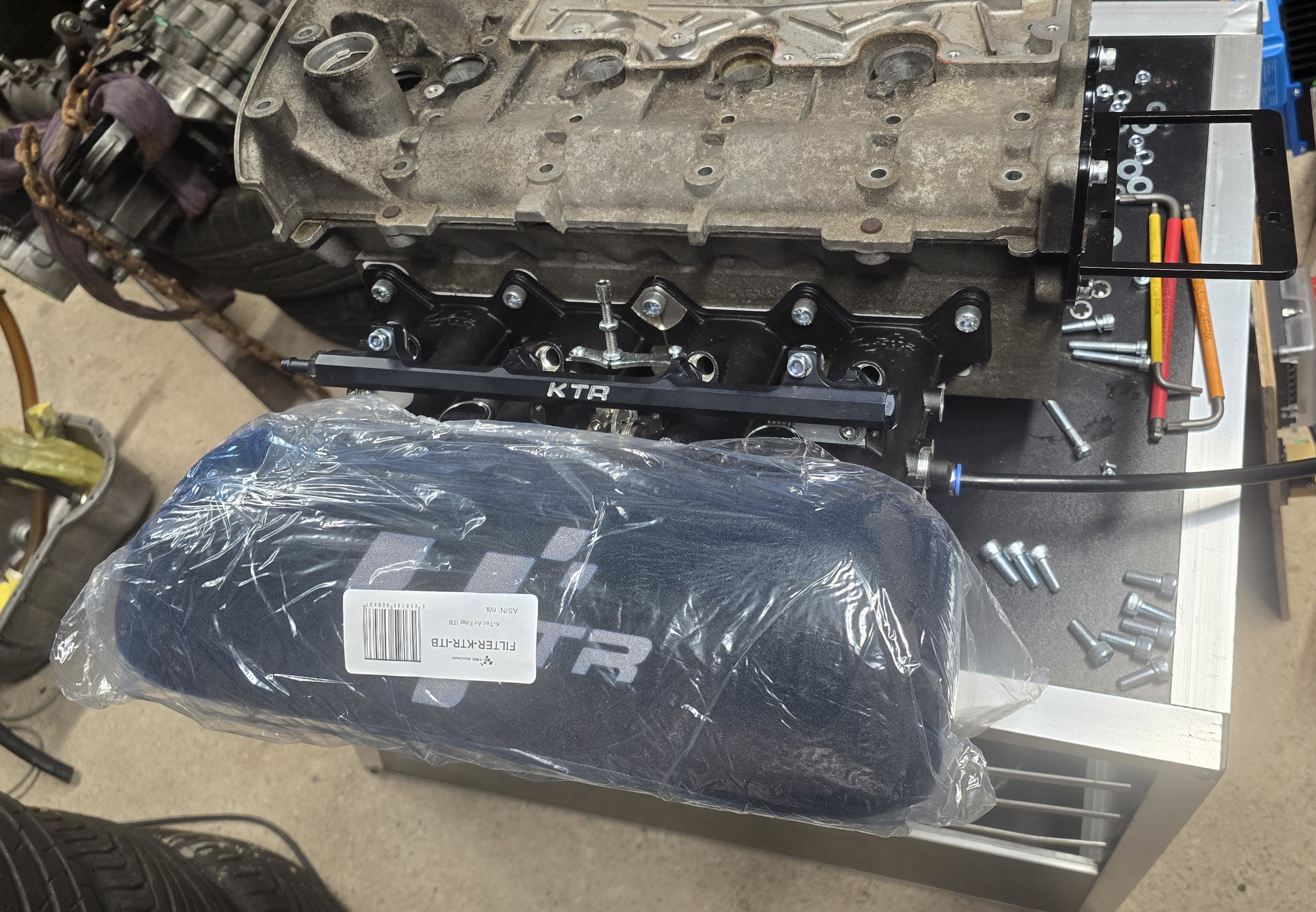

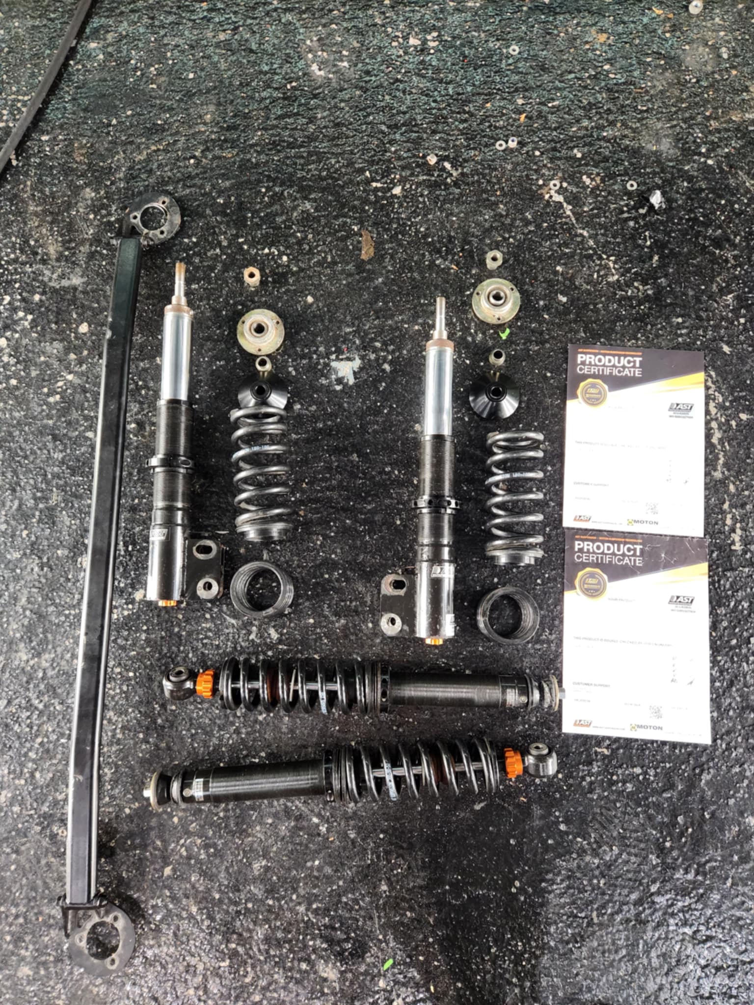

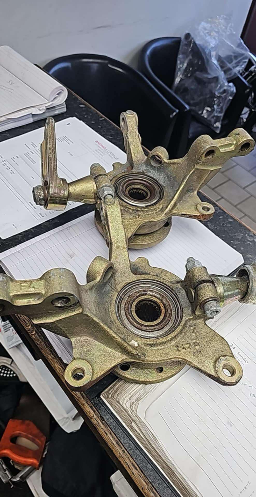

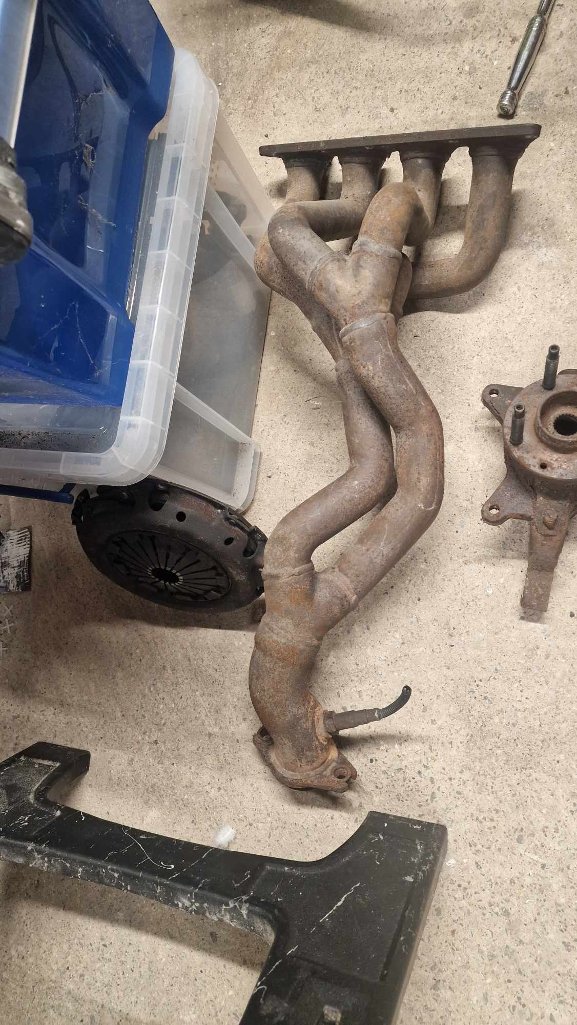

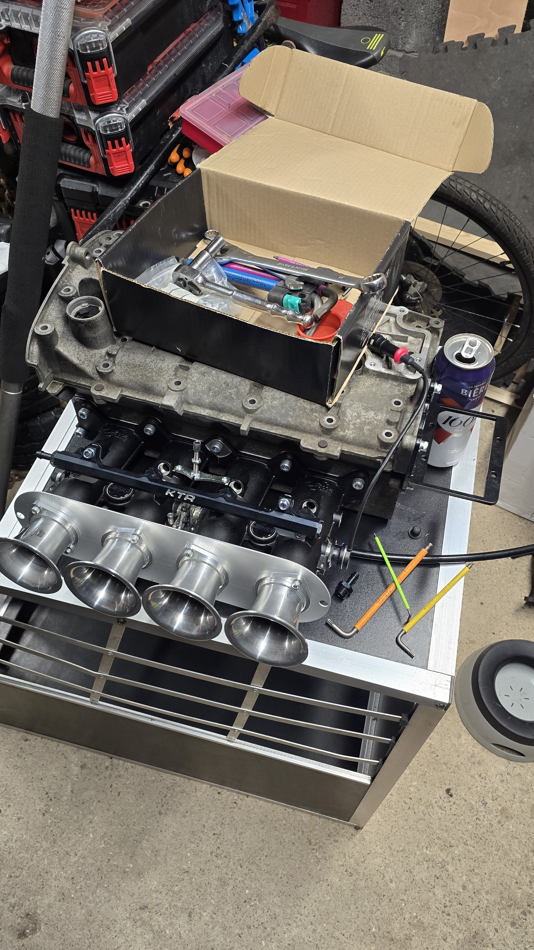

Purchases 🤝🫣

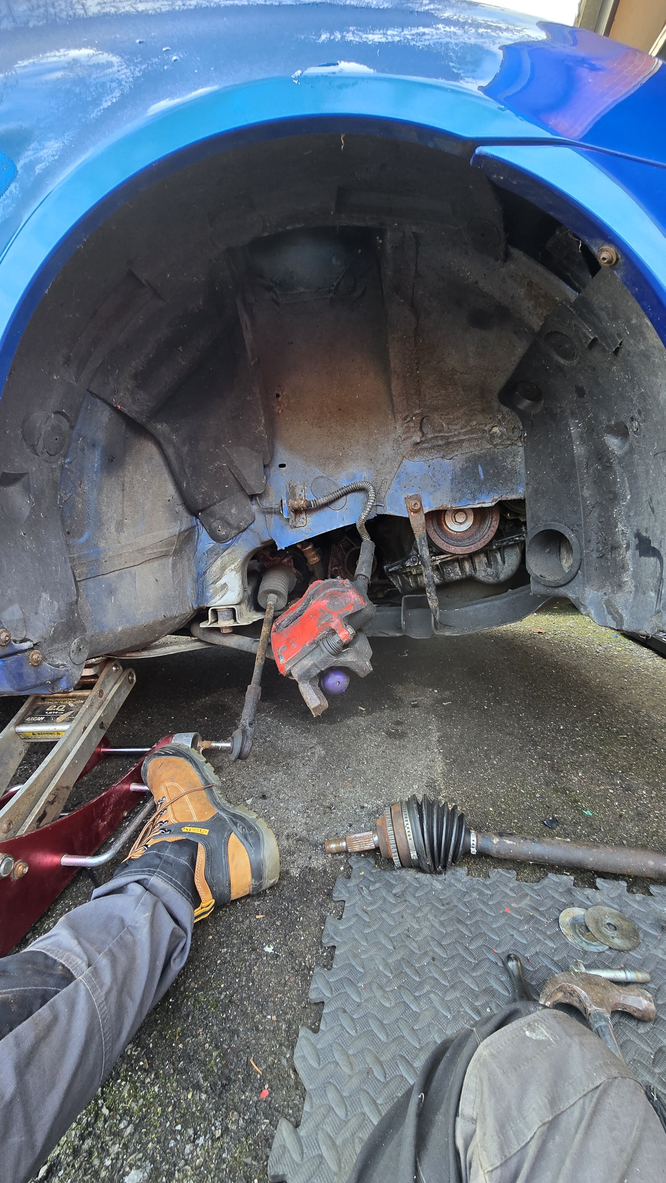

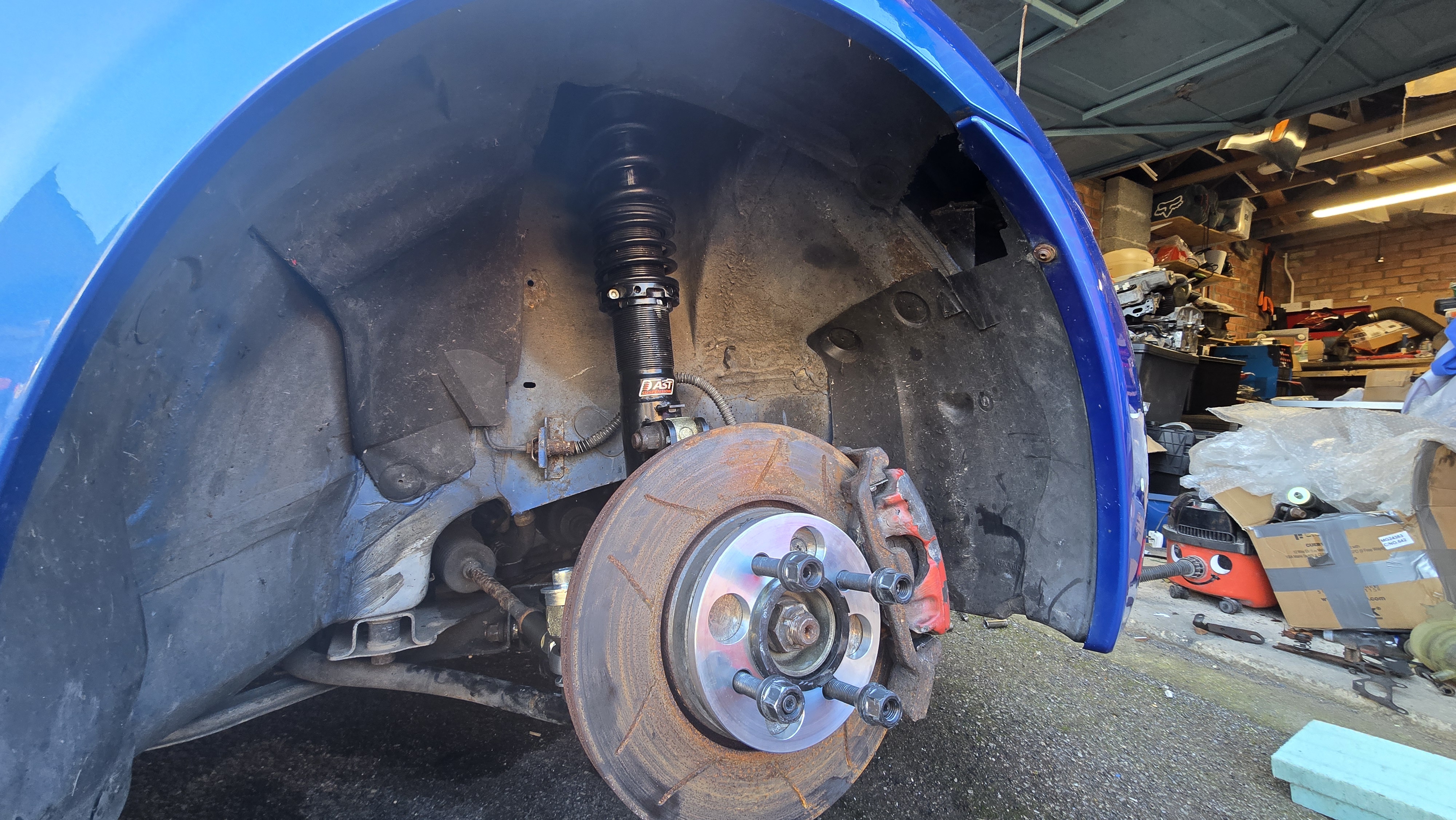

Due to time and budget, most was second hand but the best I could afford at the time

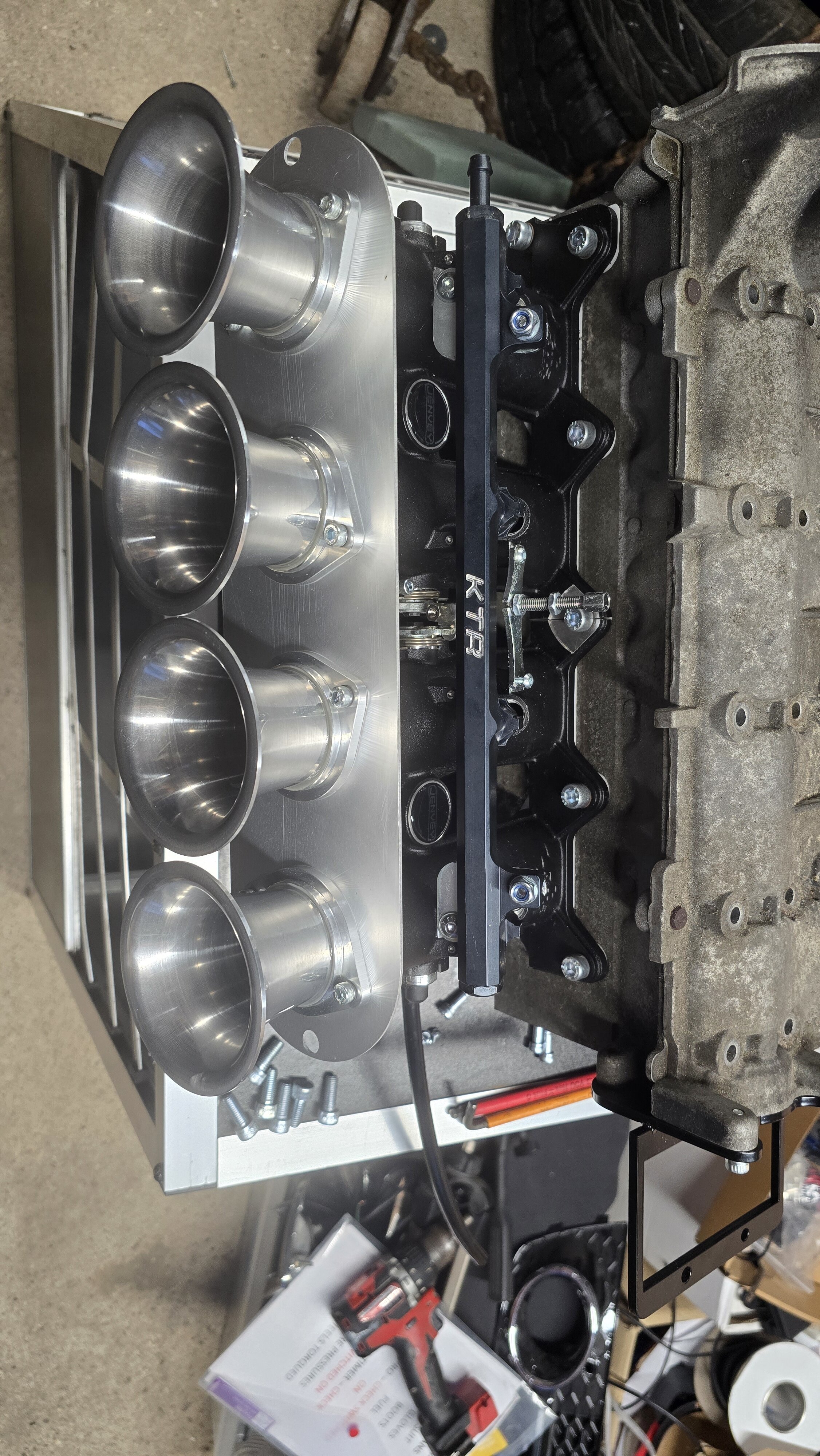

Ast 5100 coilovers
Ktr throttle body kit
182 manifold
& a few more trinkets

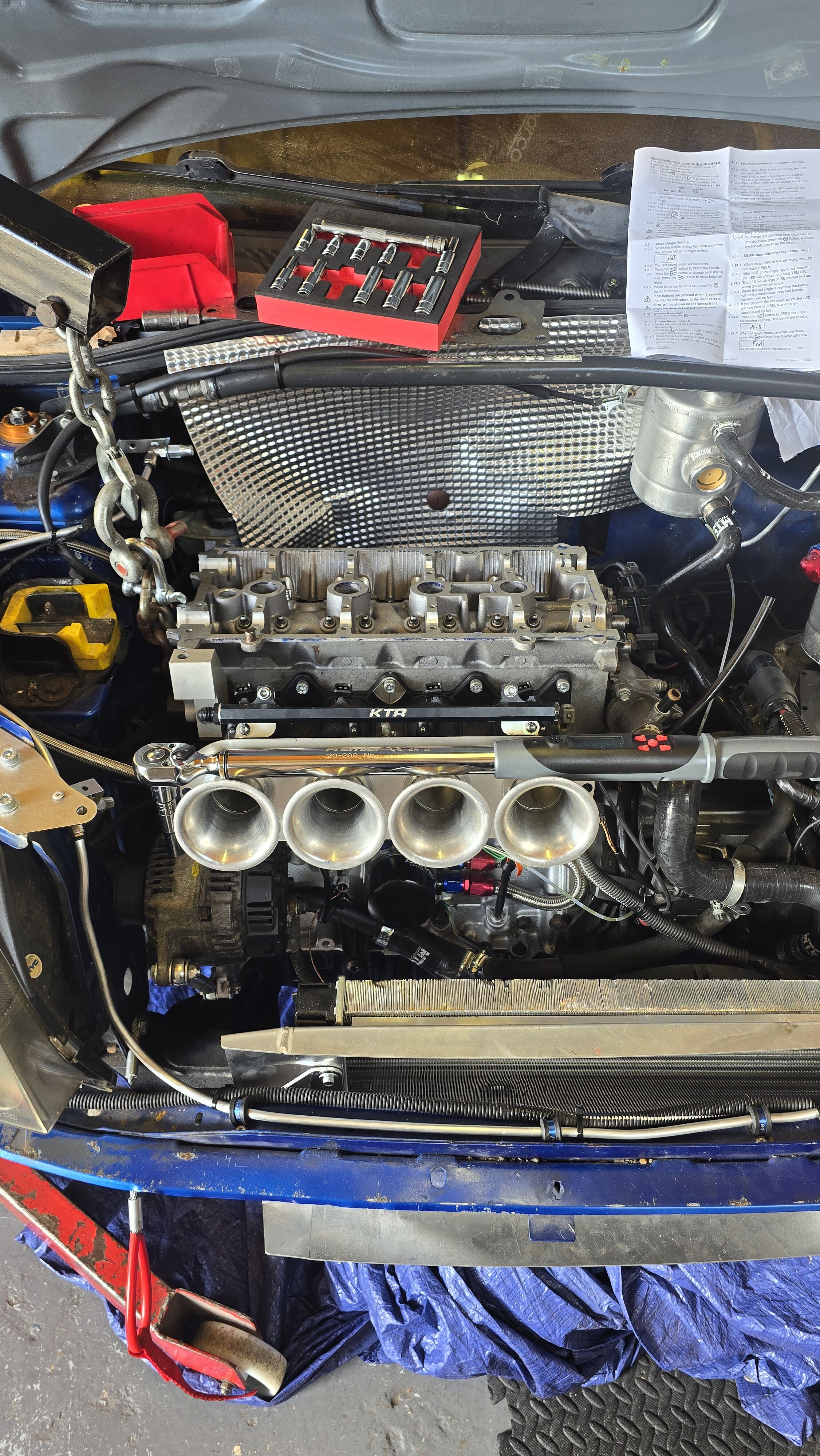

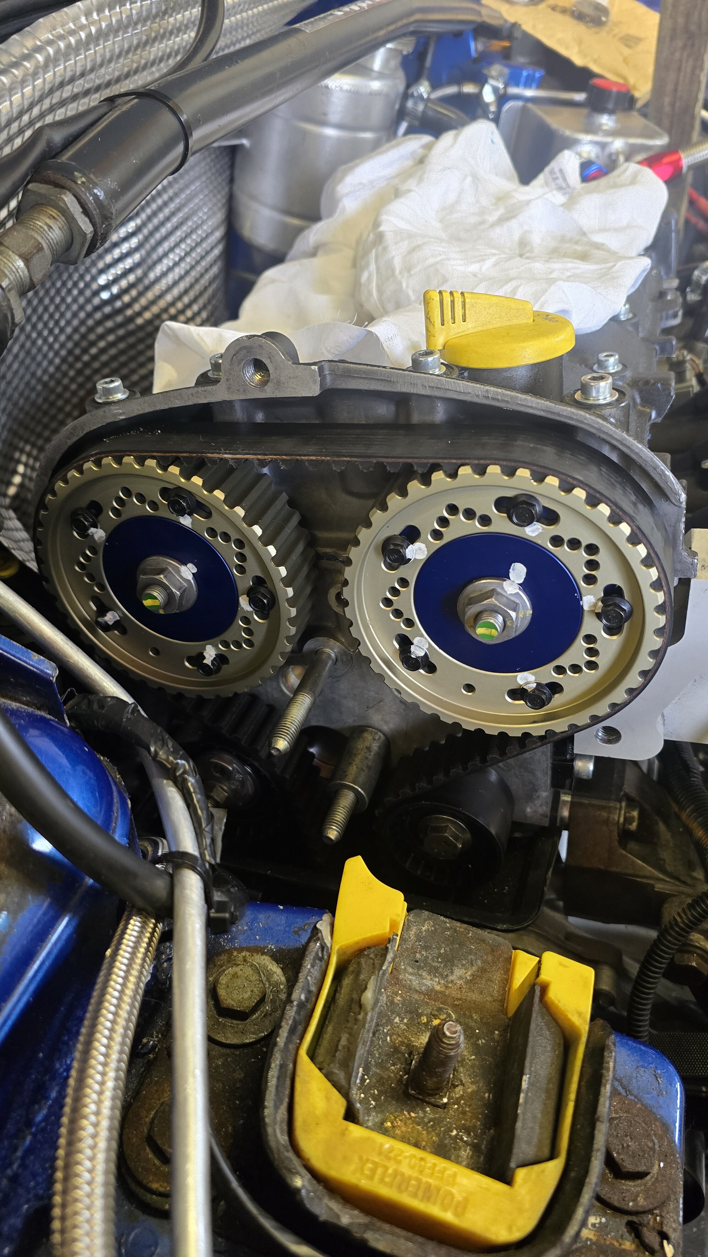

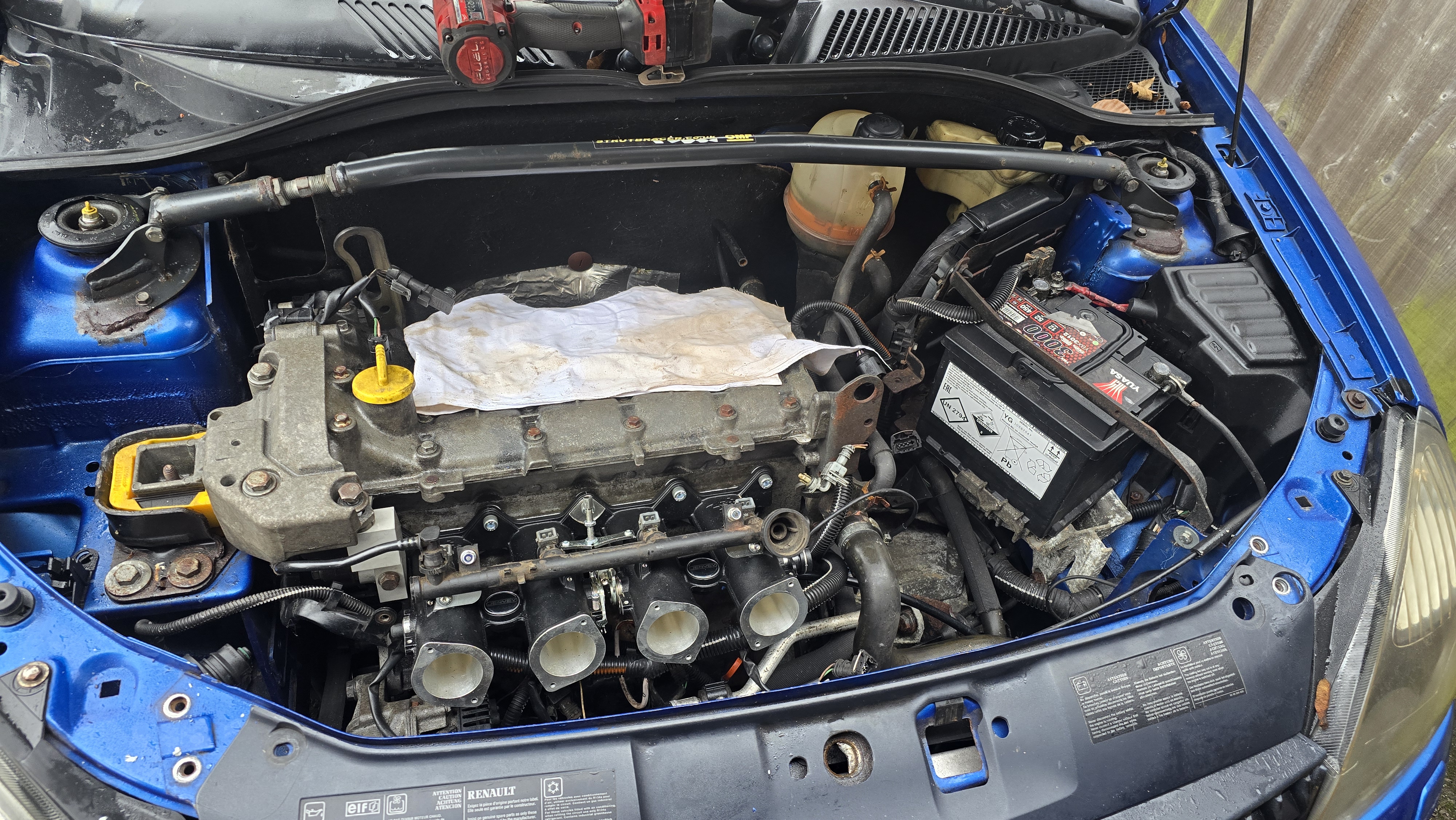

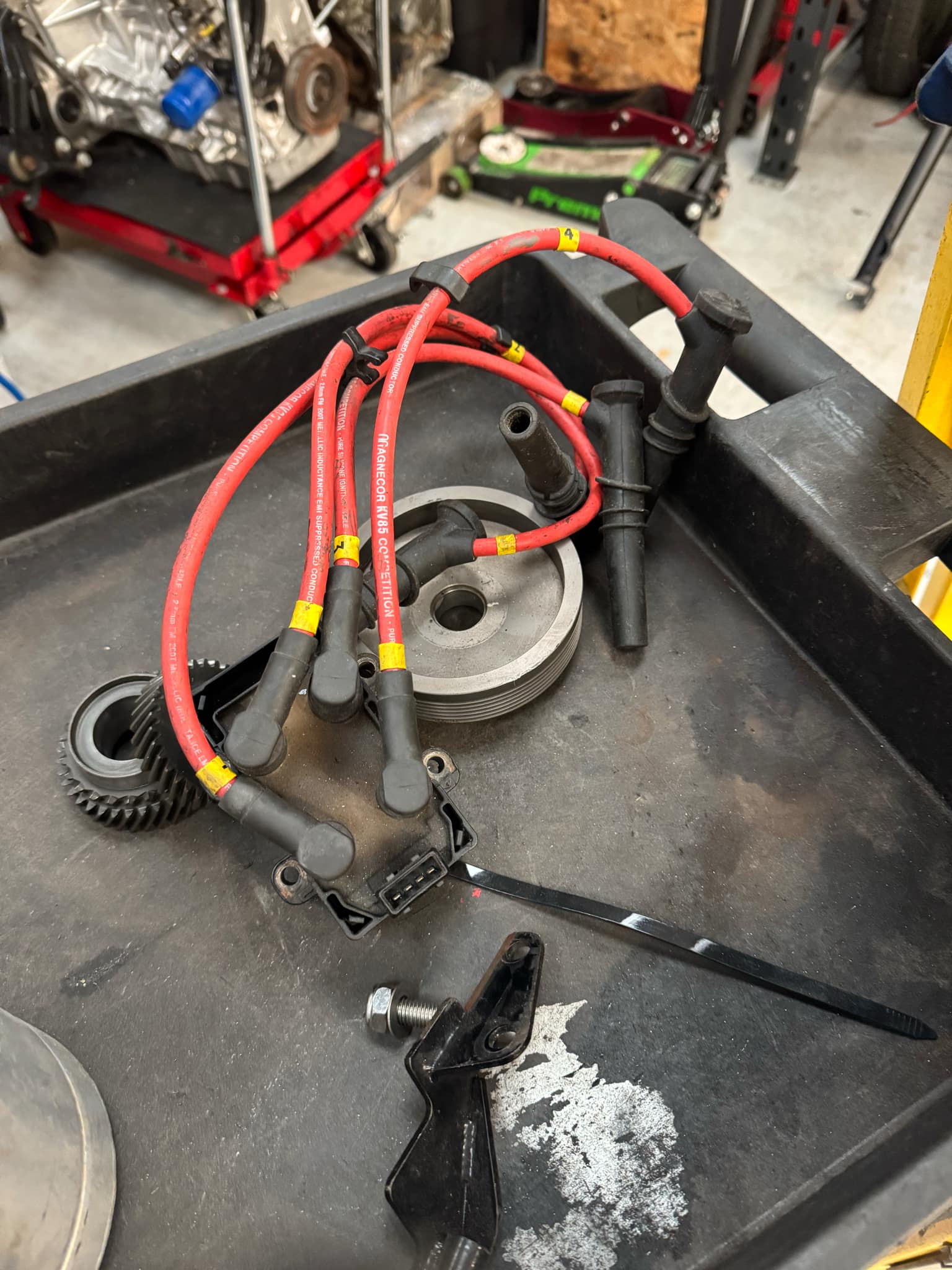

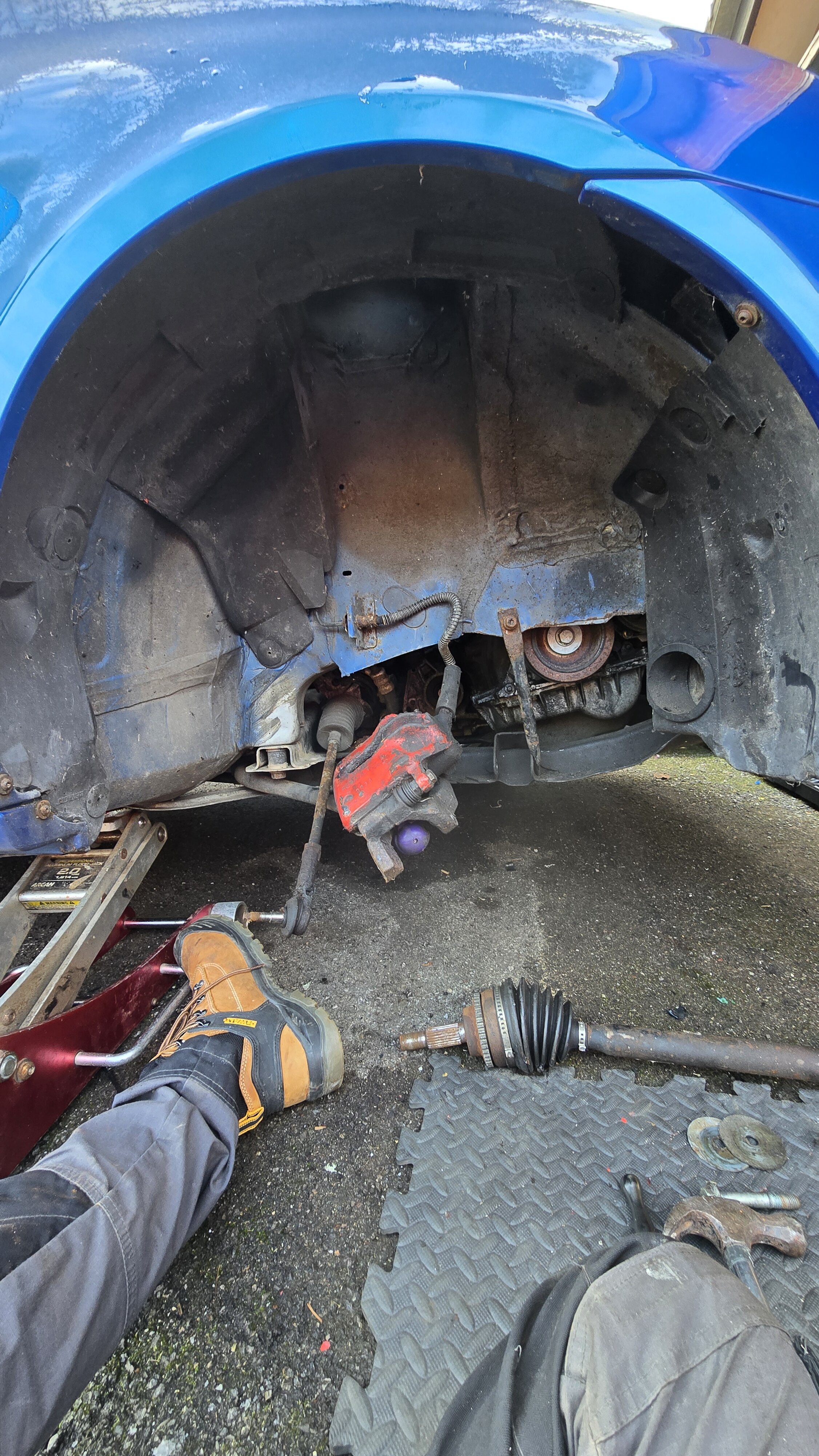

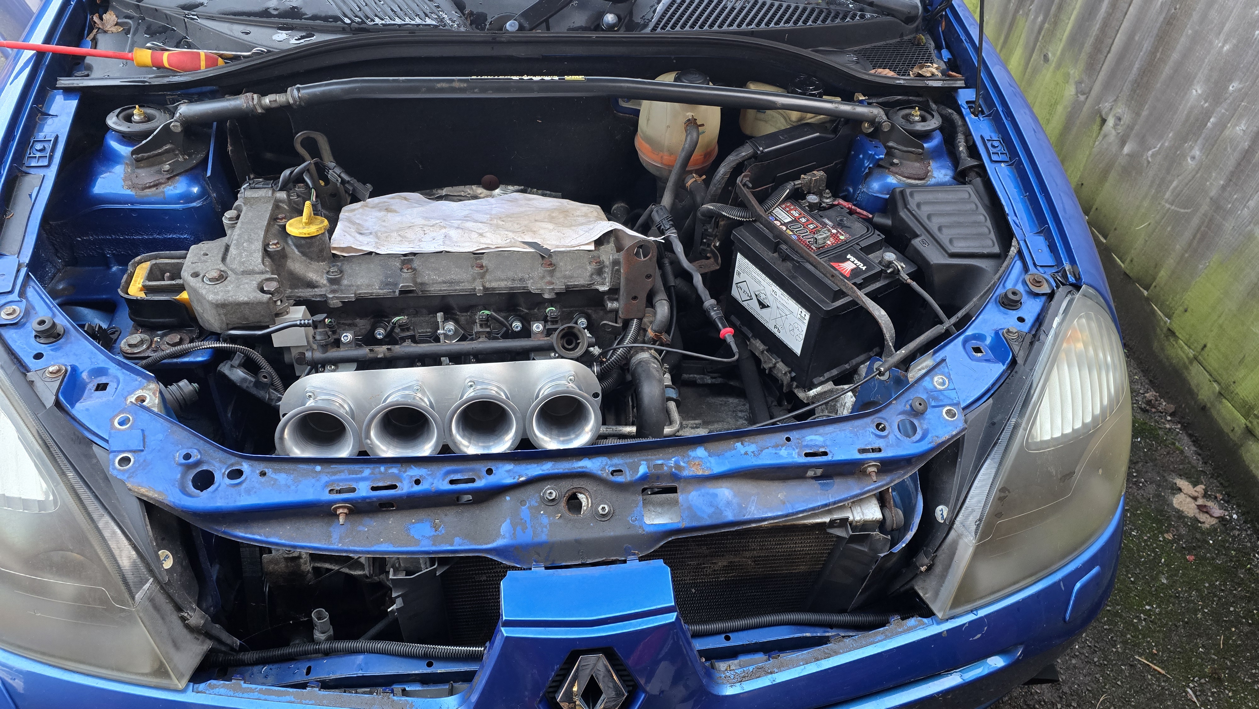

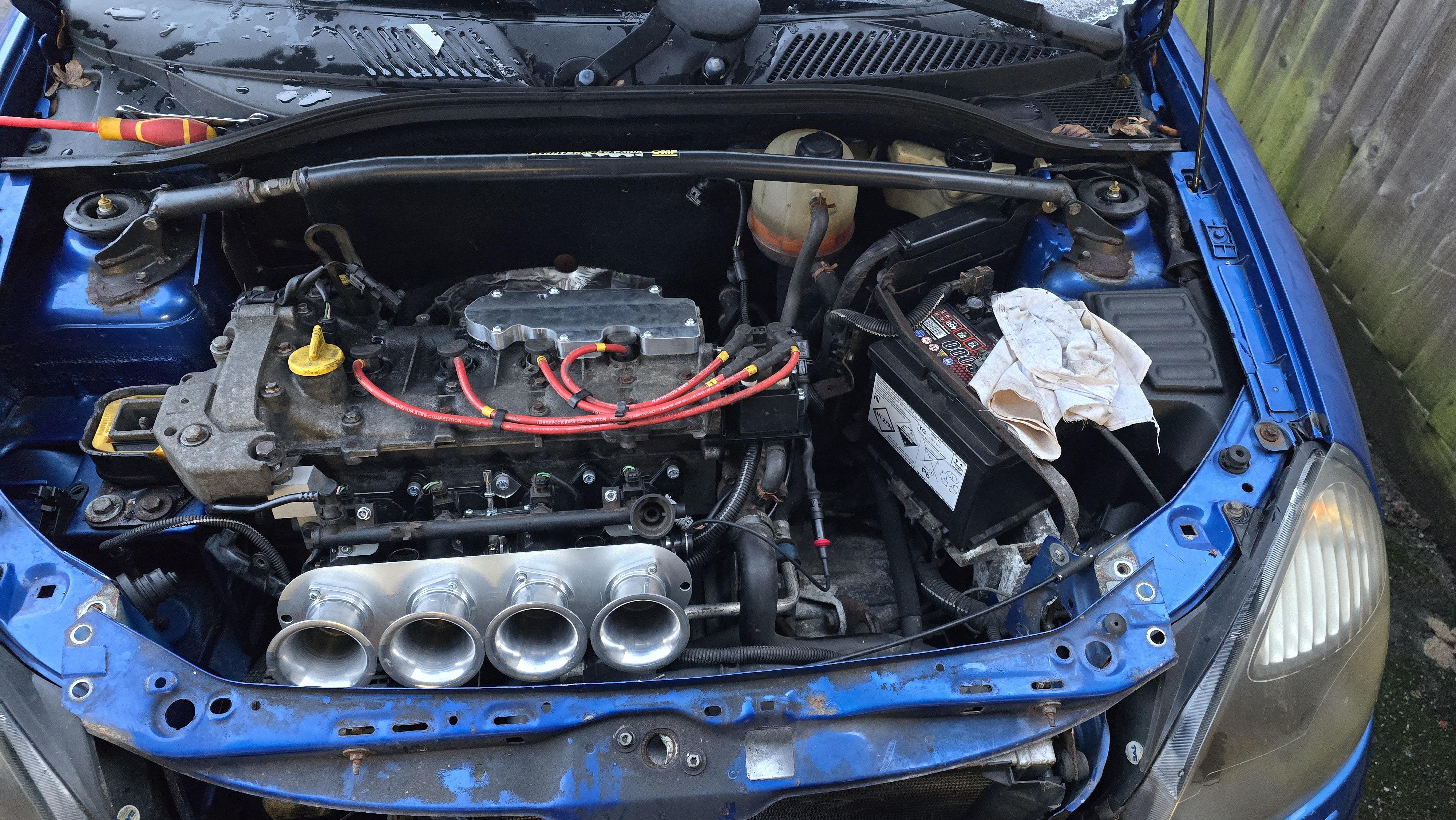

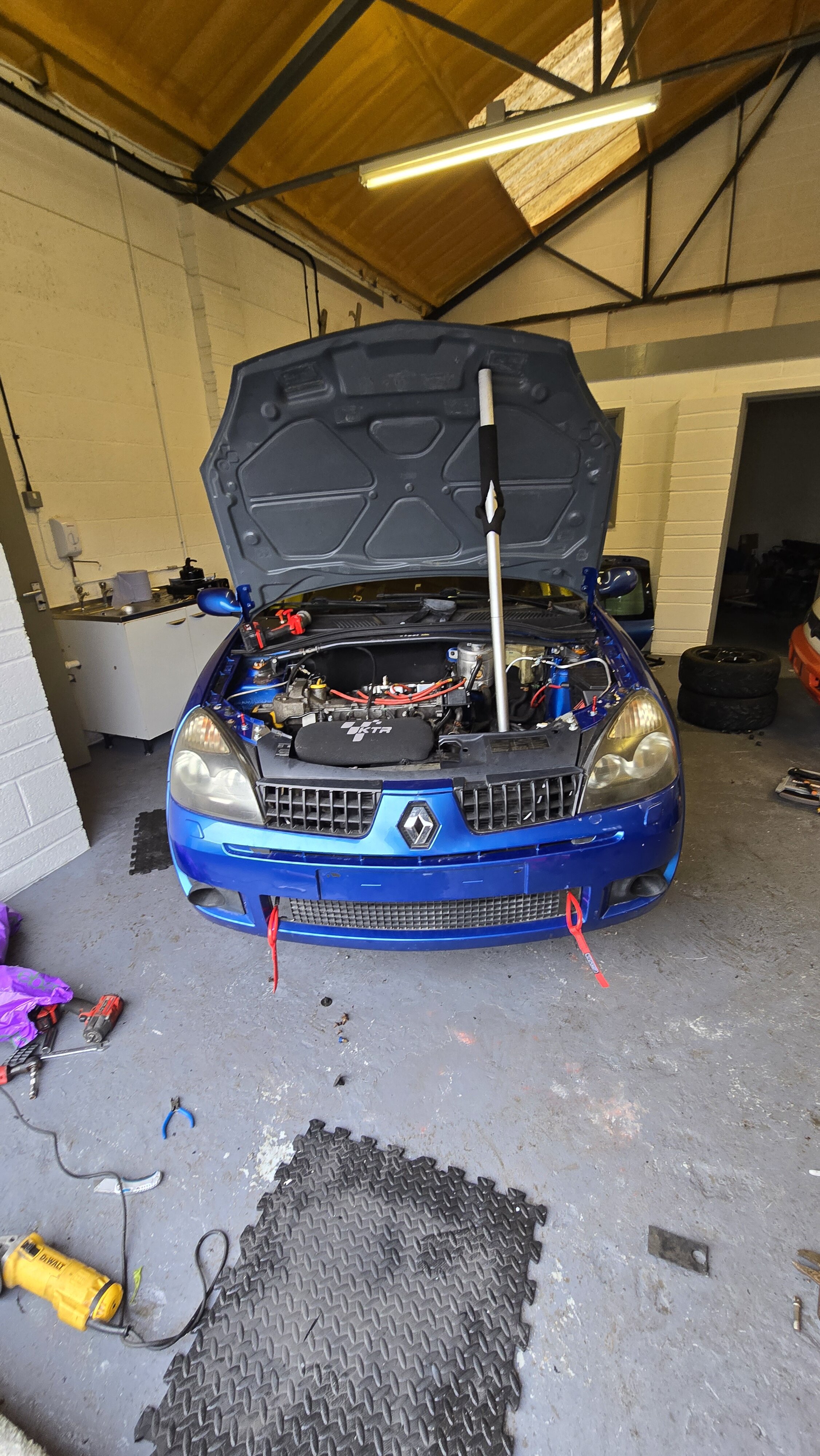

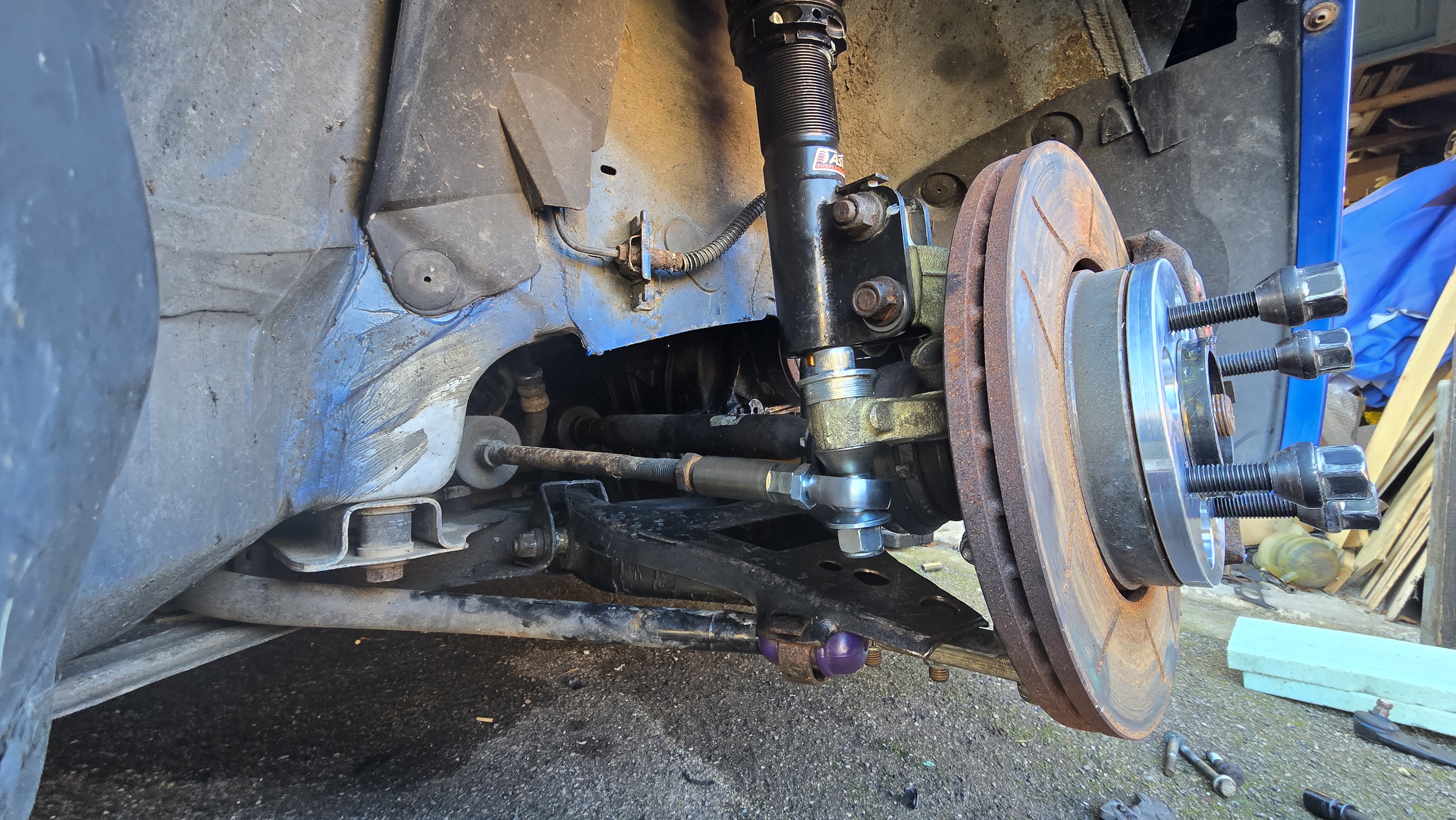

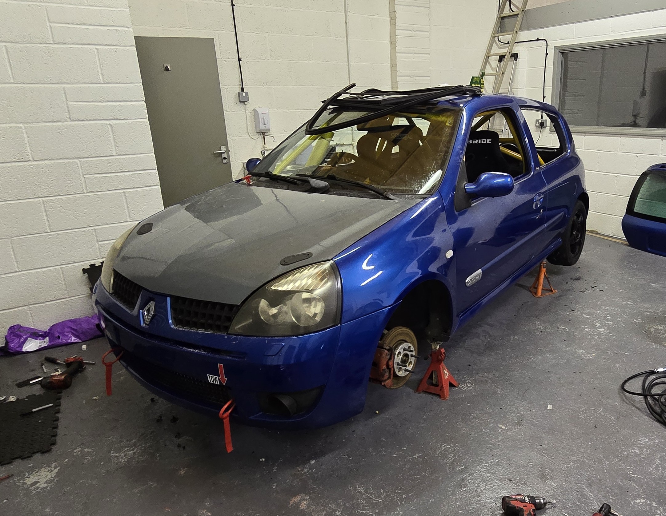

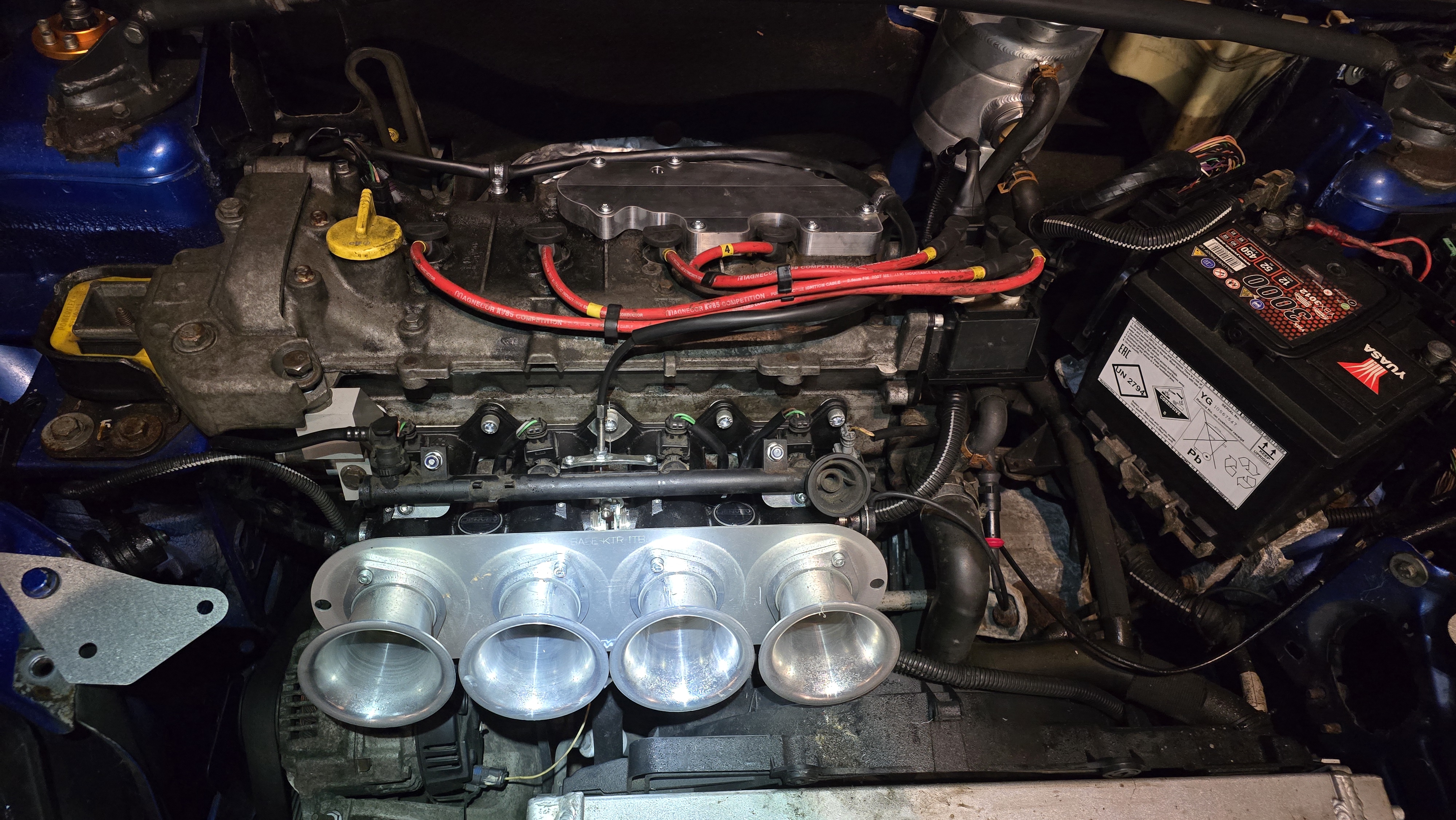

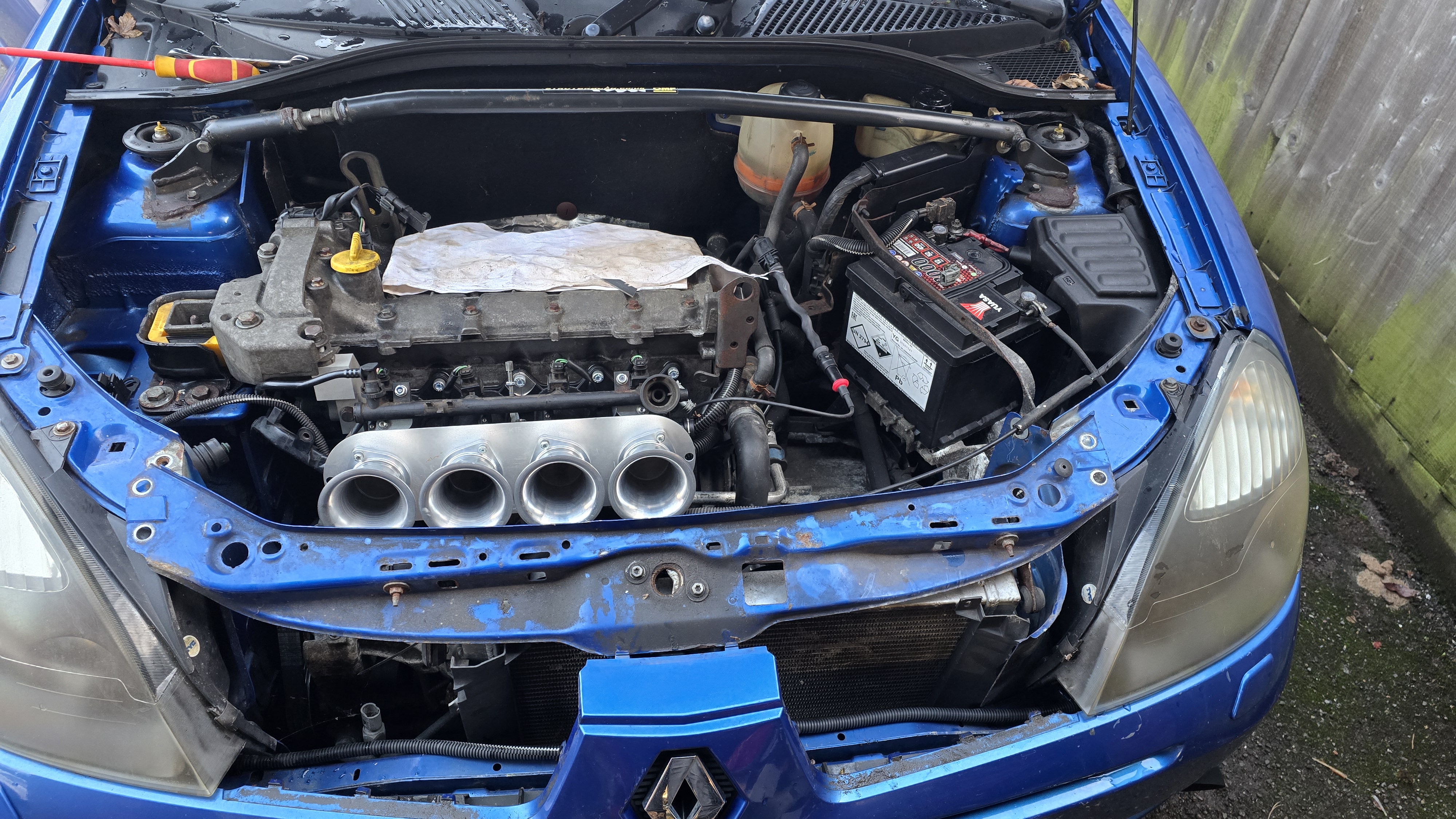

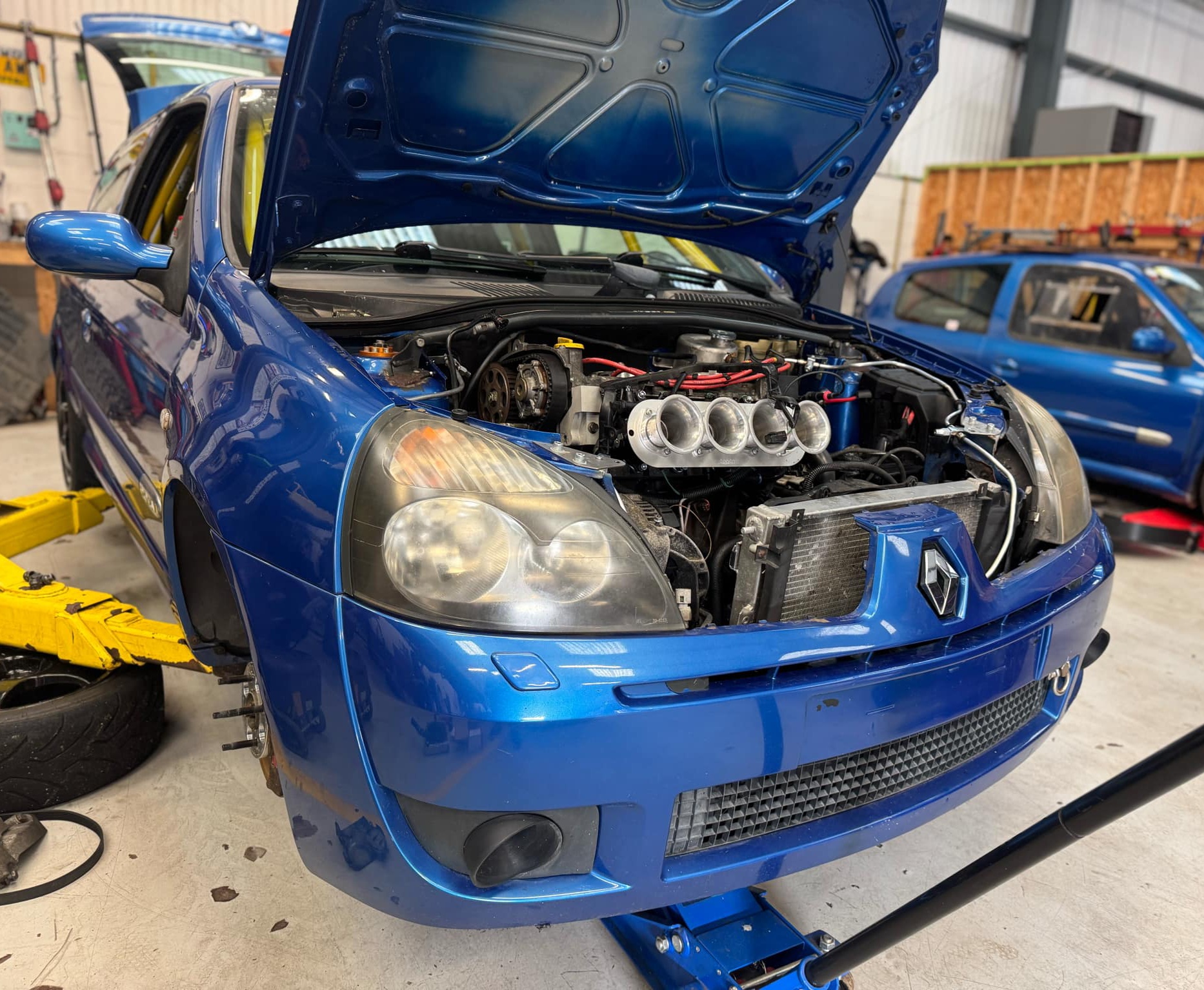

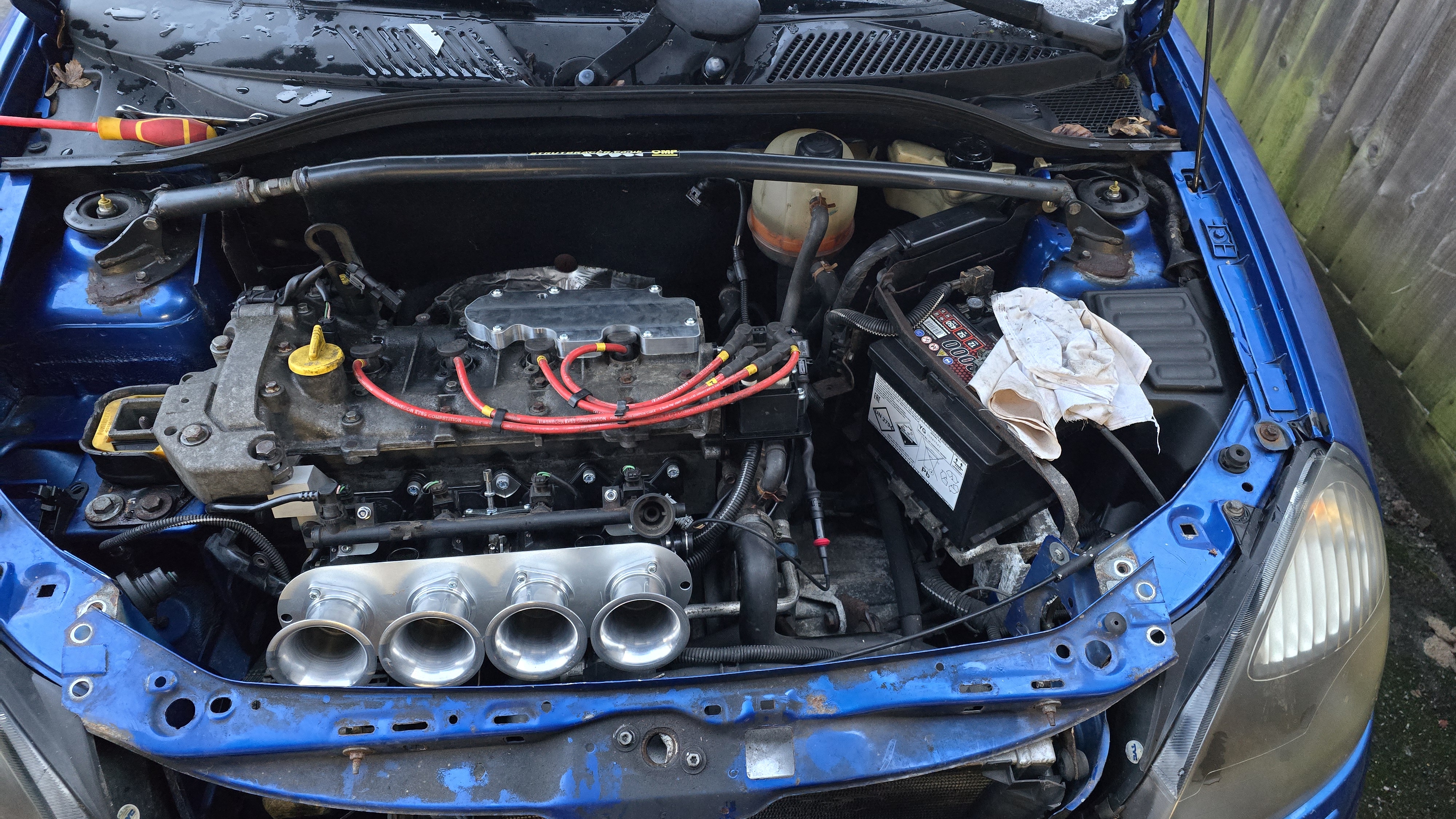

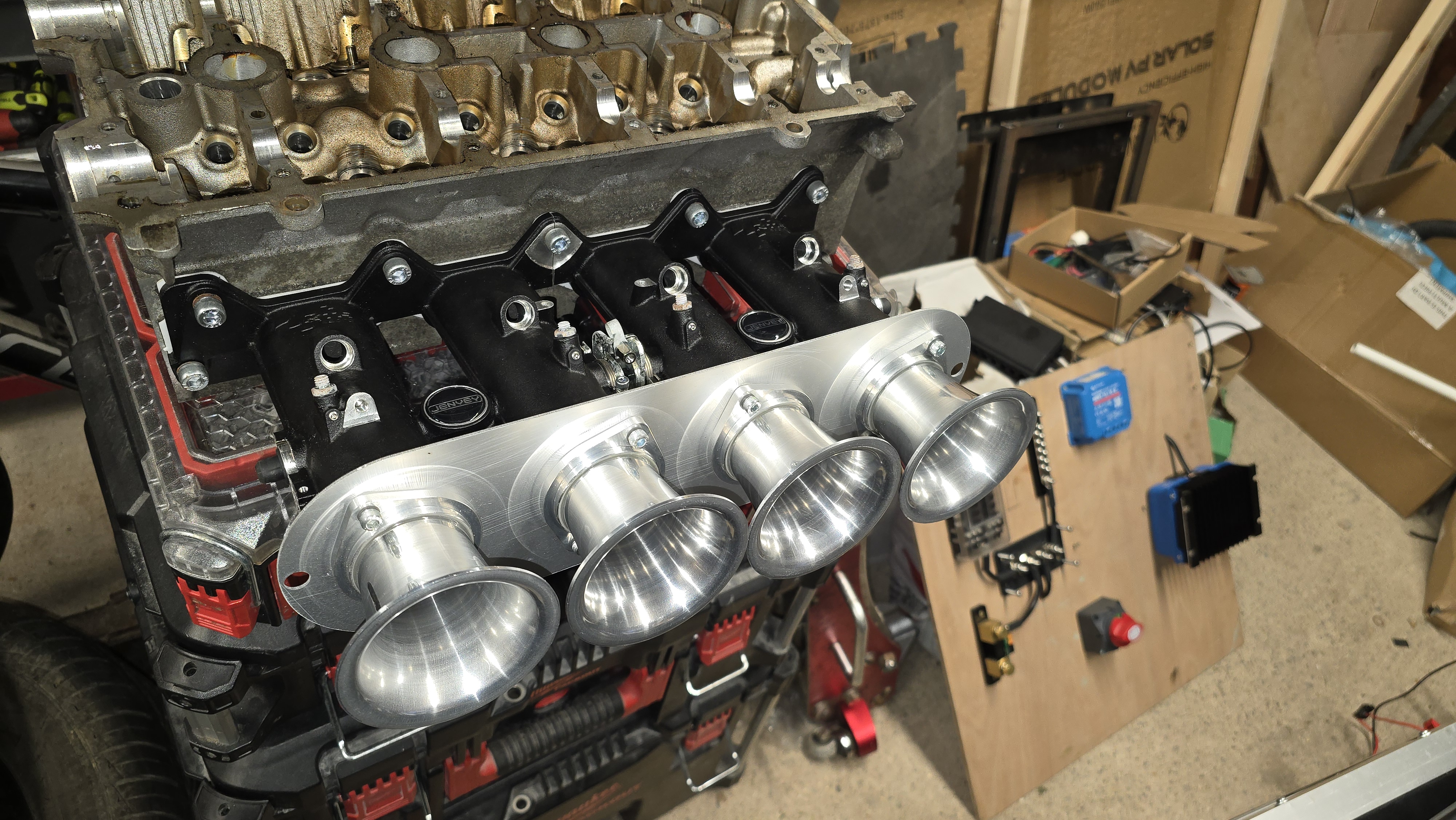

Then went on the bodies, it was around this time, the 182 manifold went on, 197 cams were fitted along with some 197 cams, a proven setup that should be reliable 🤞

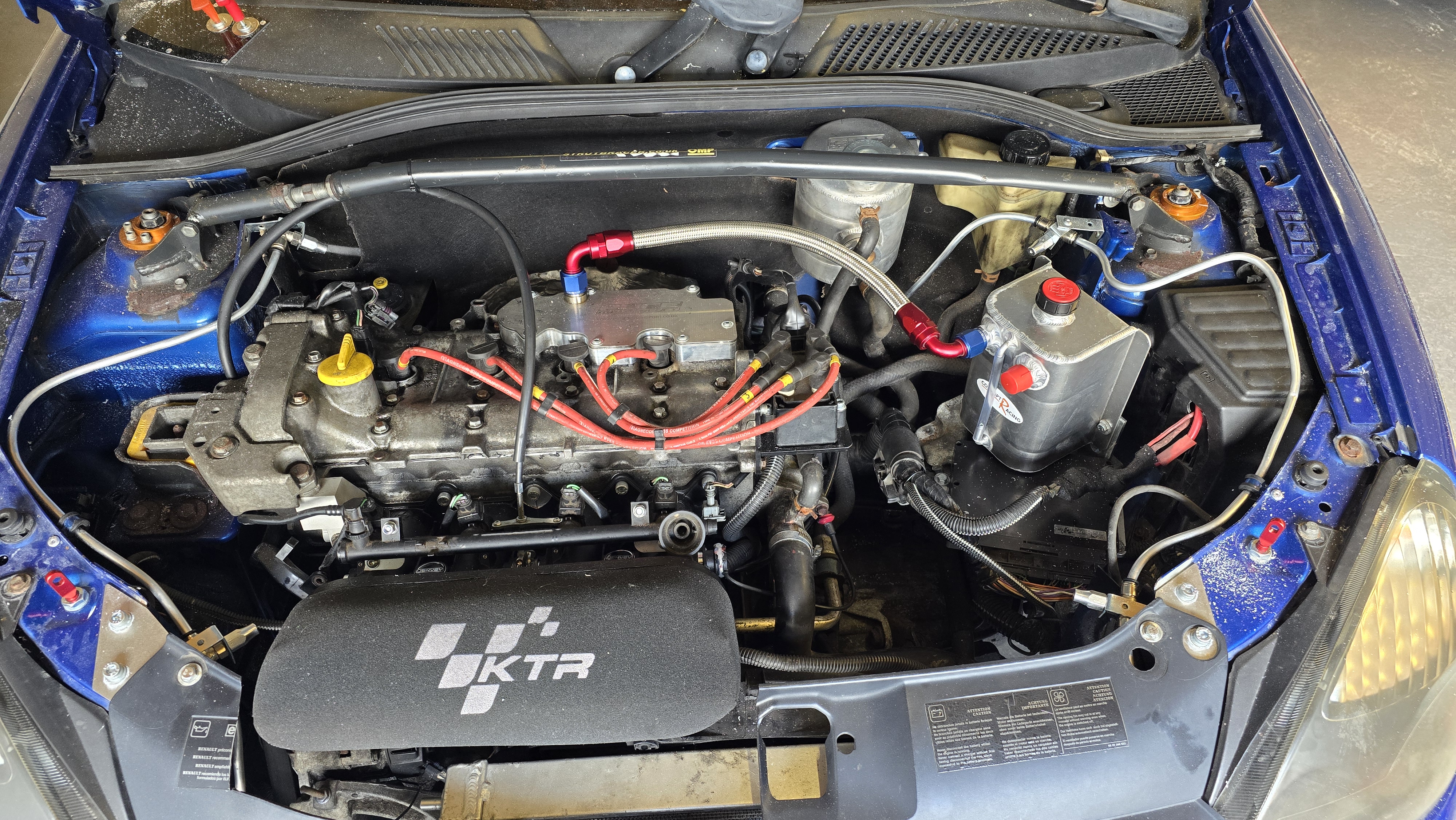

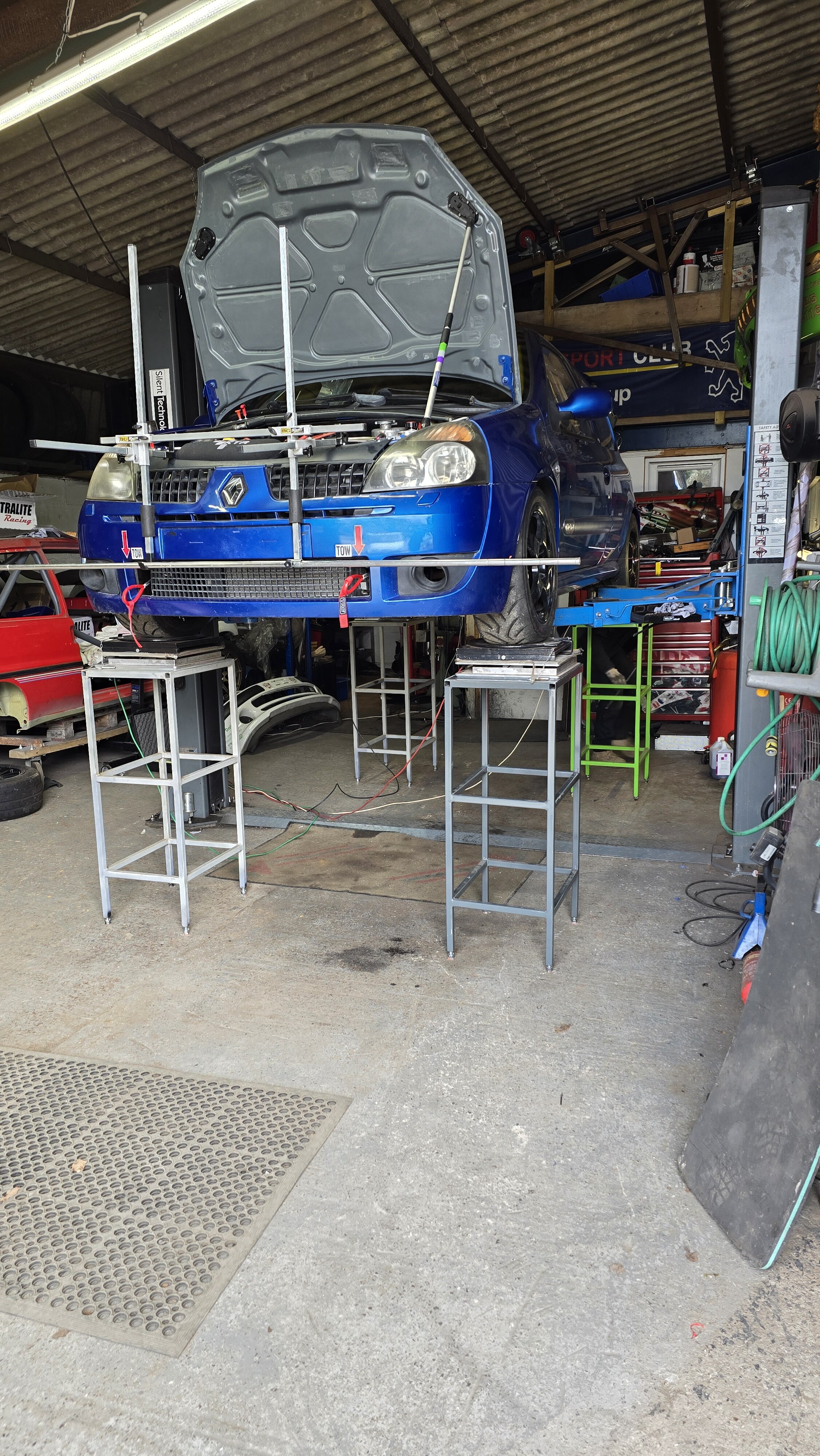

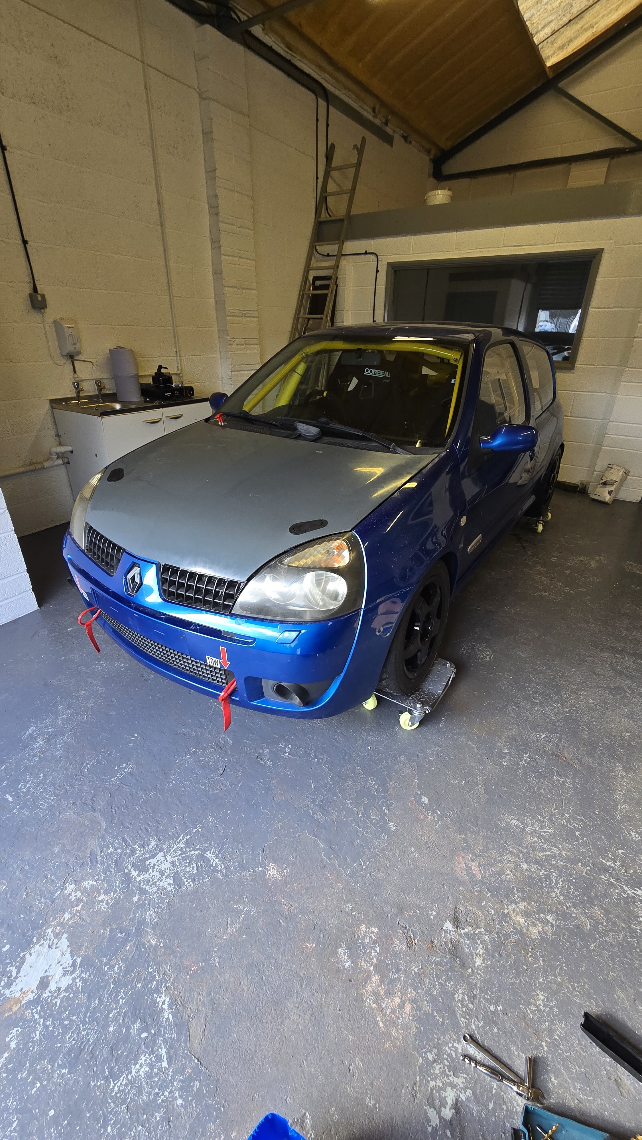

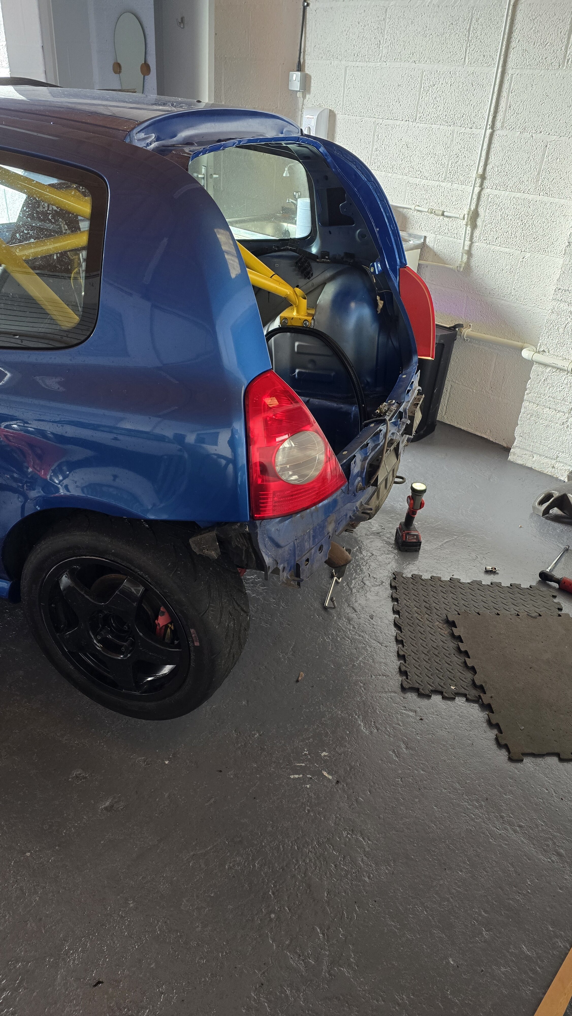

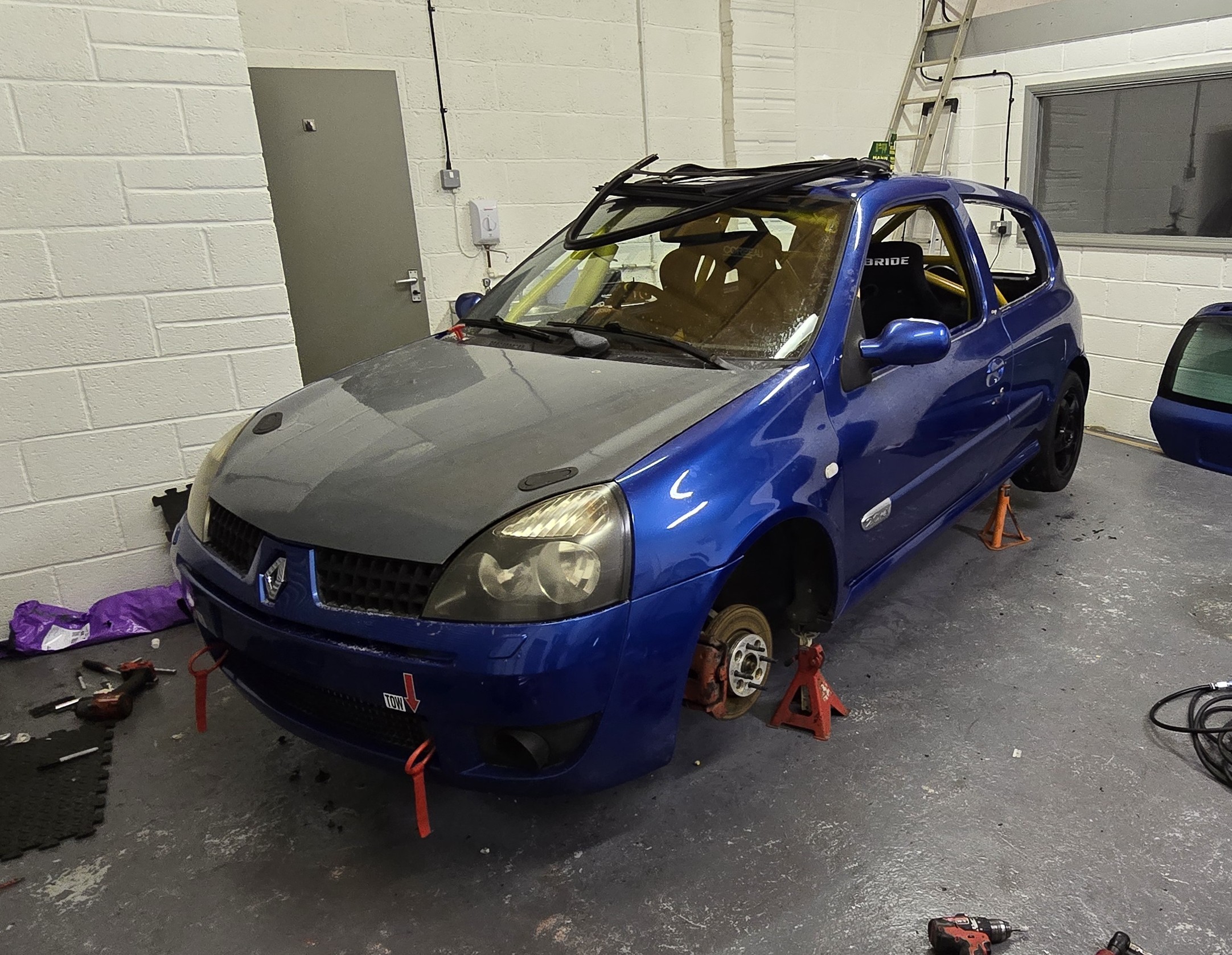

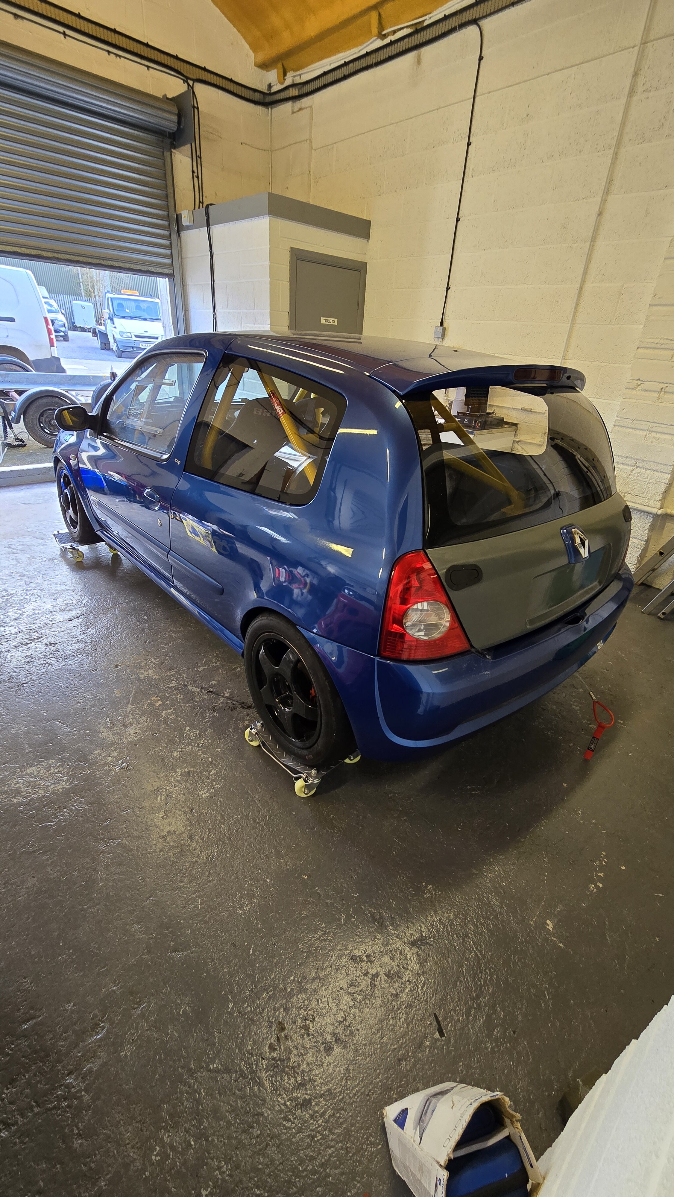

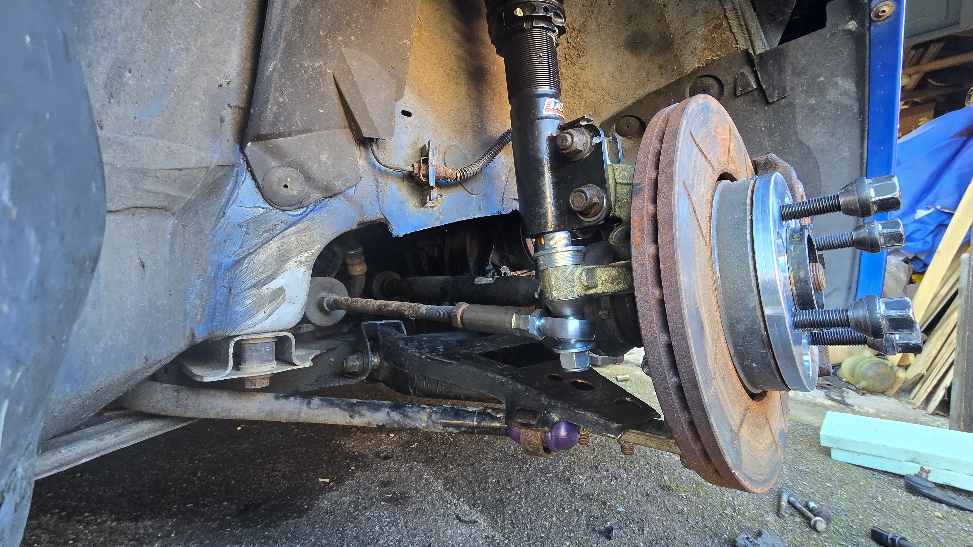

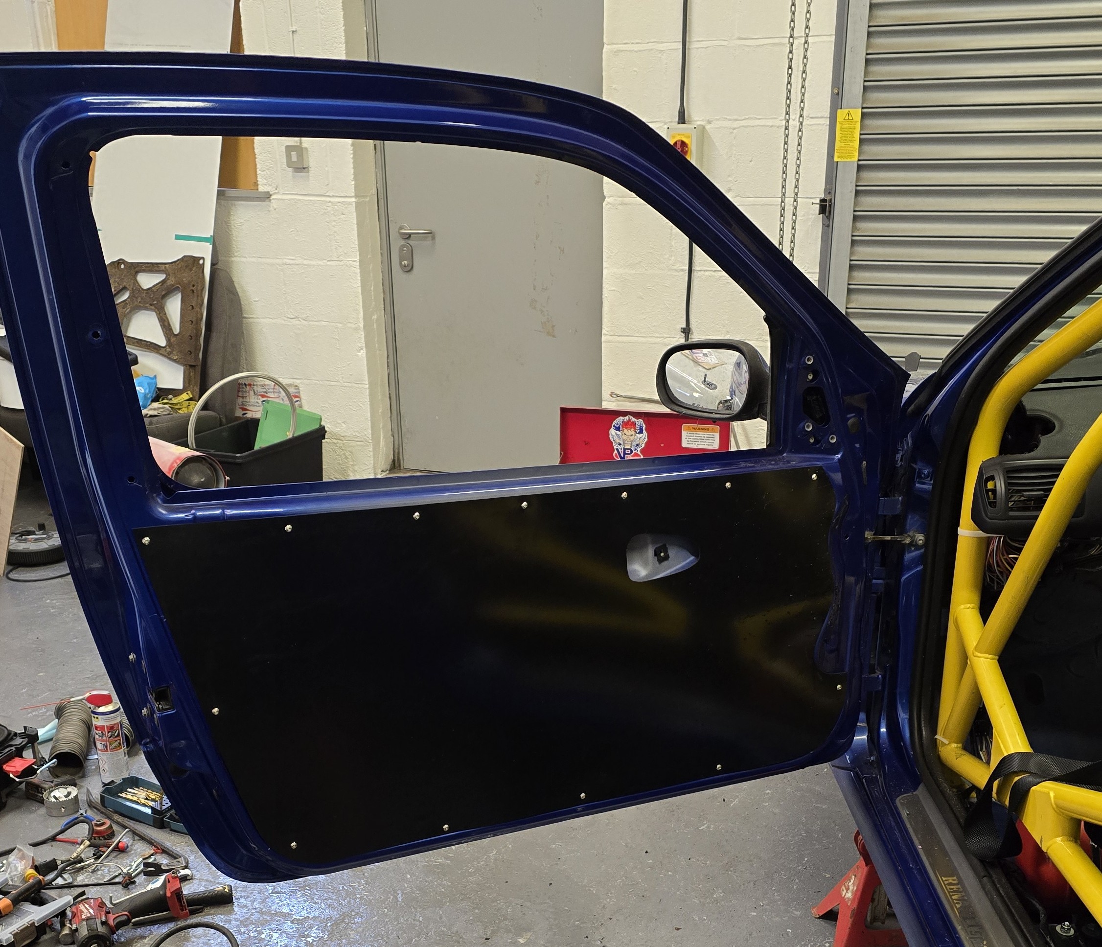

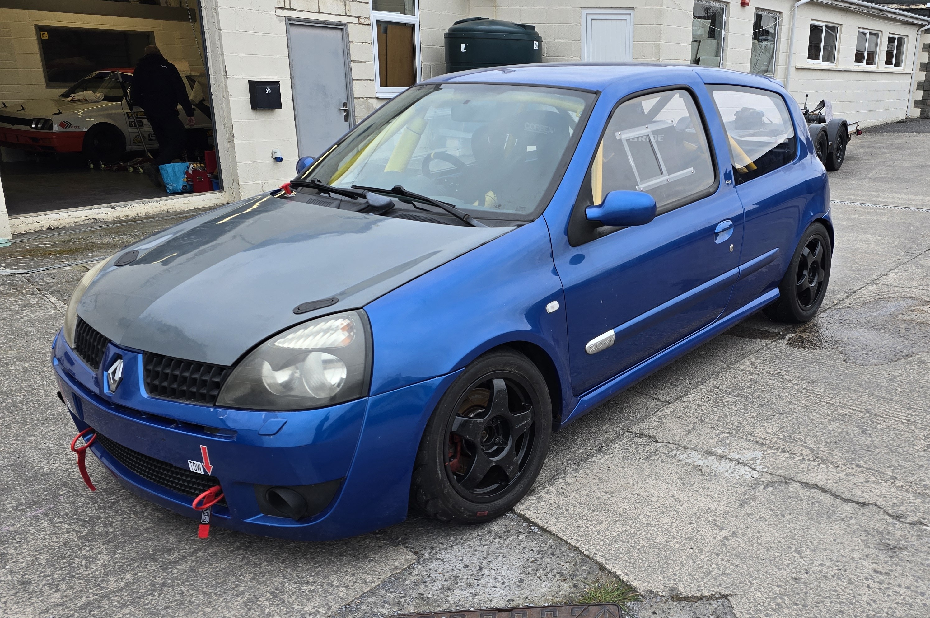

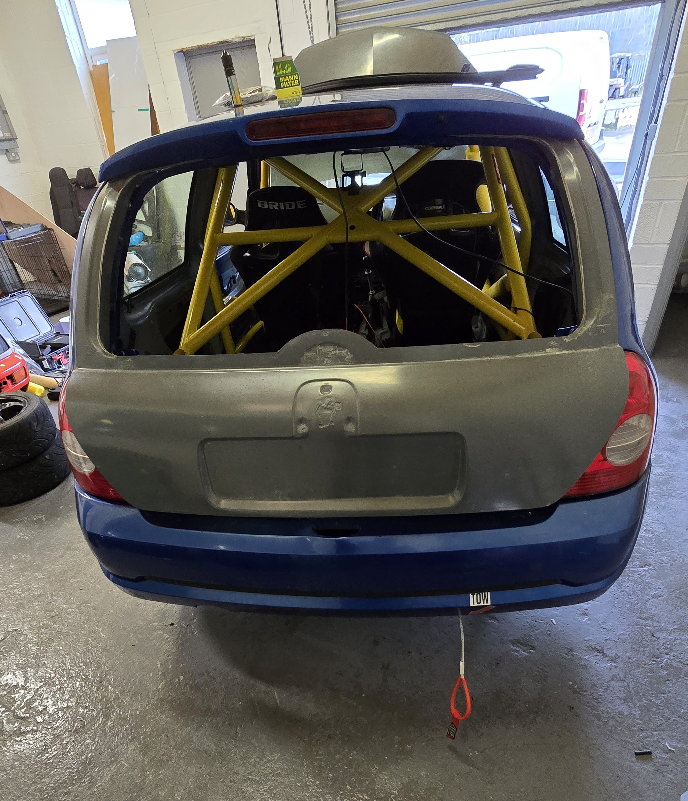

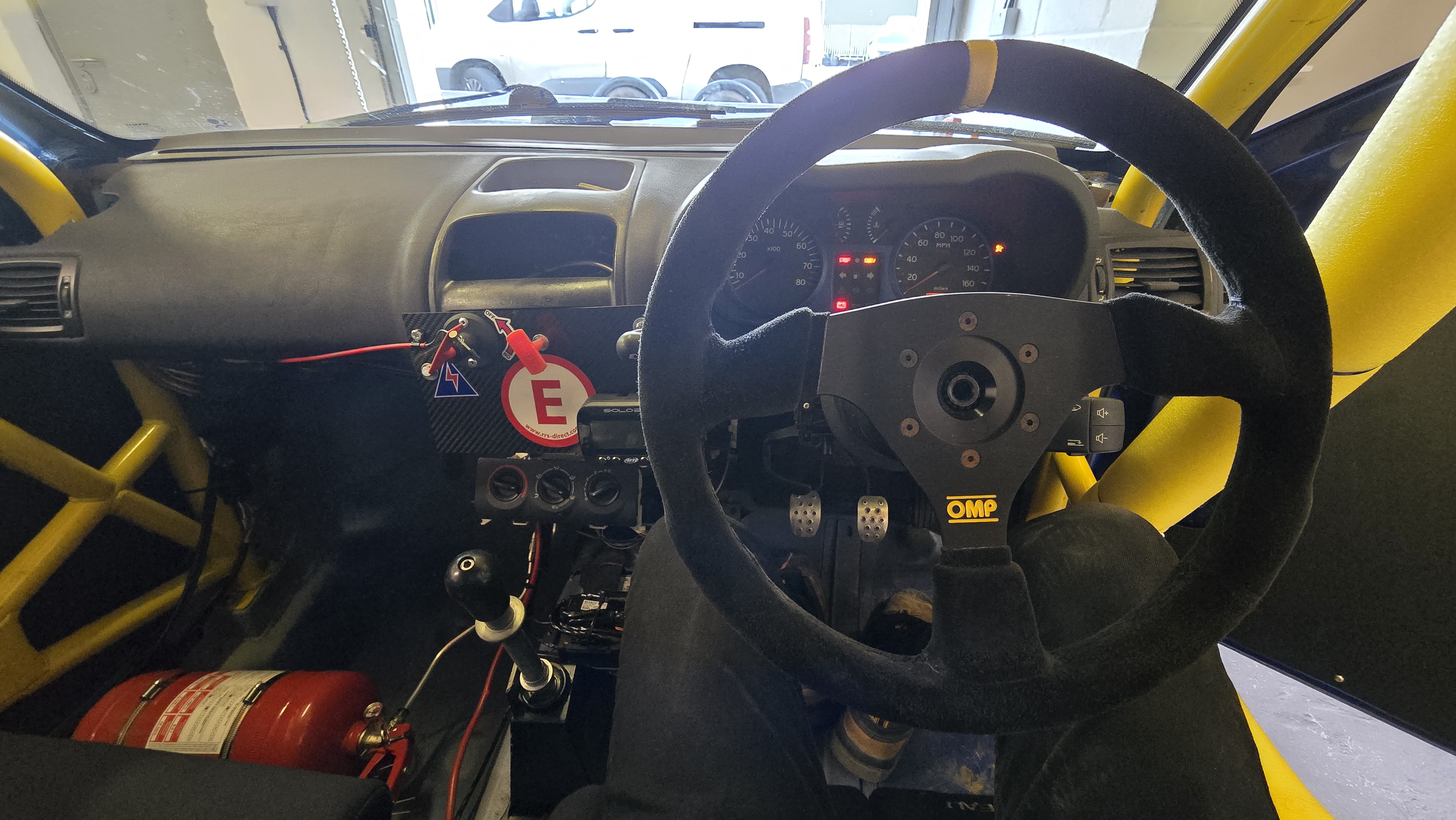

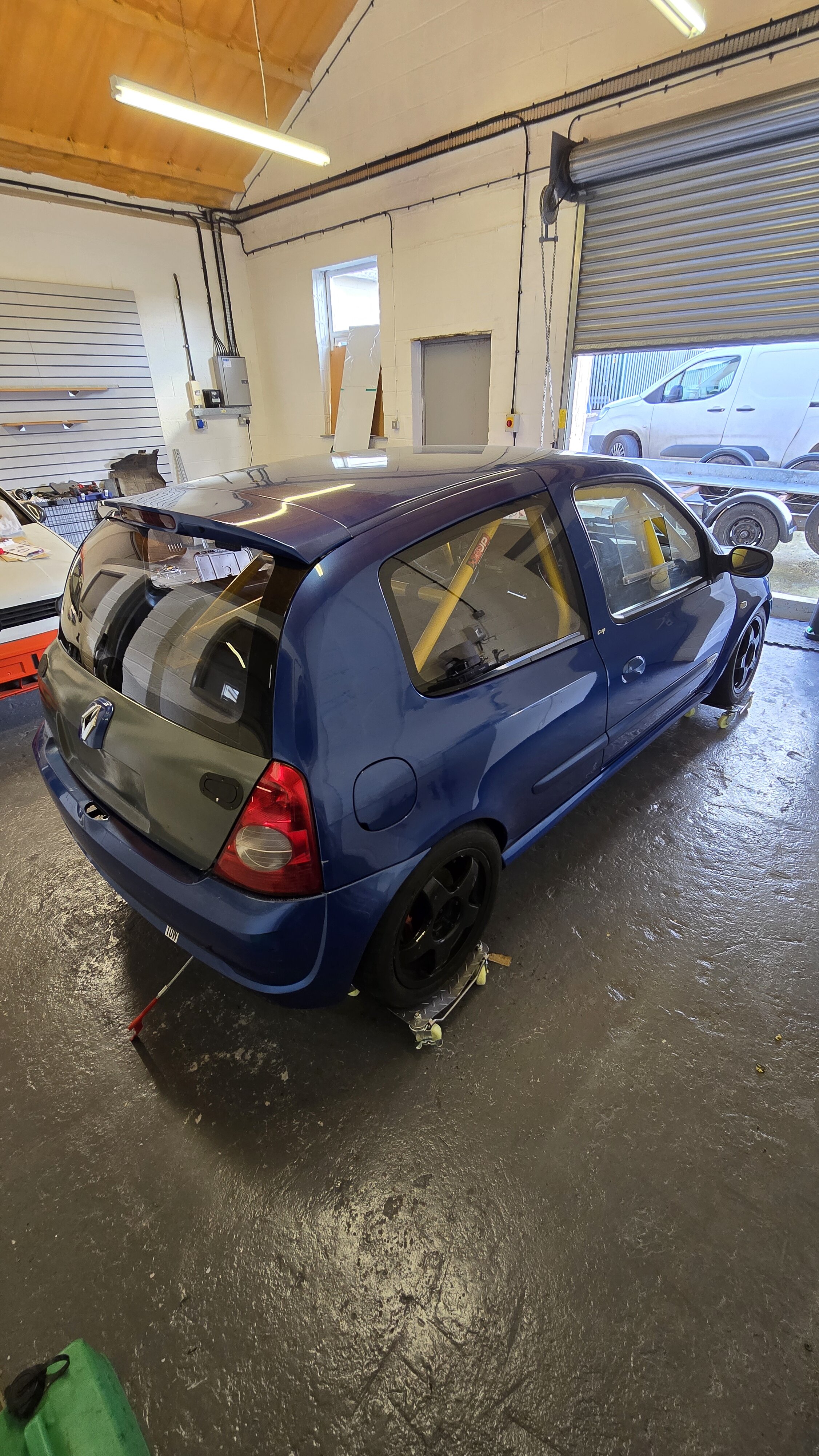

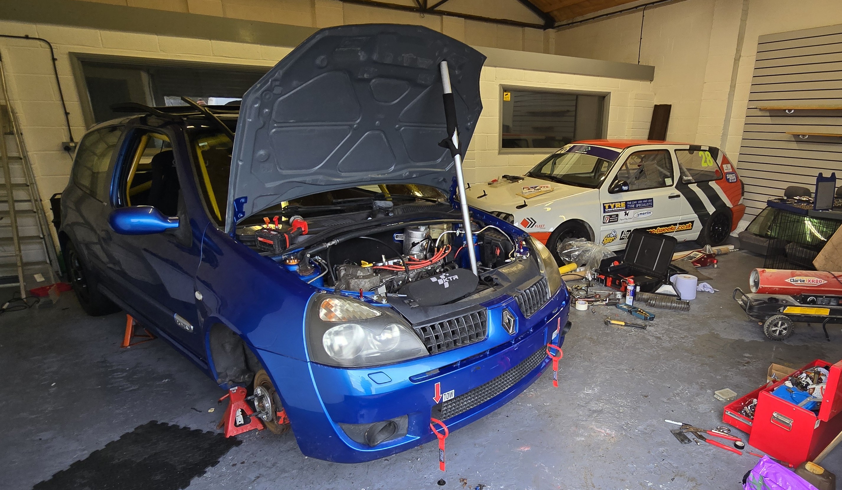

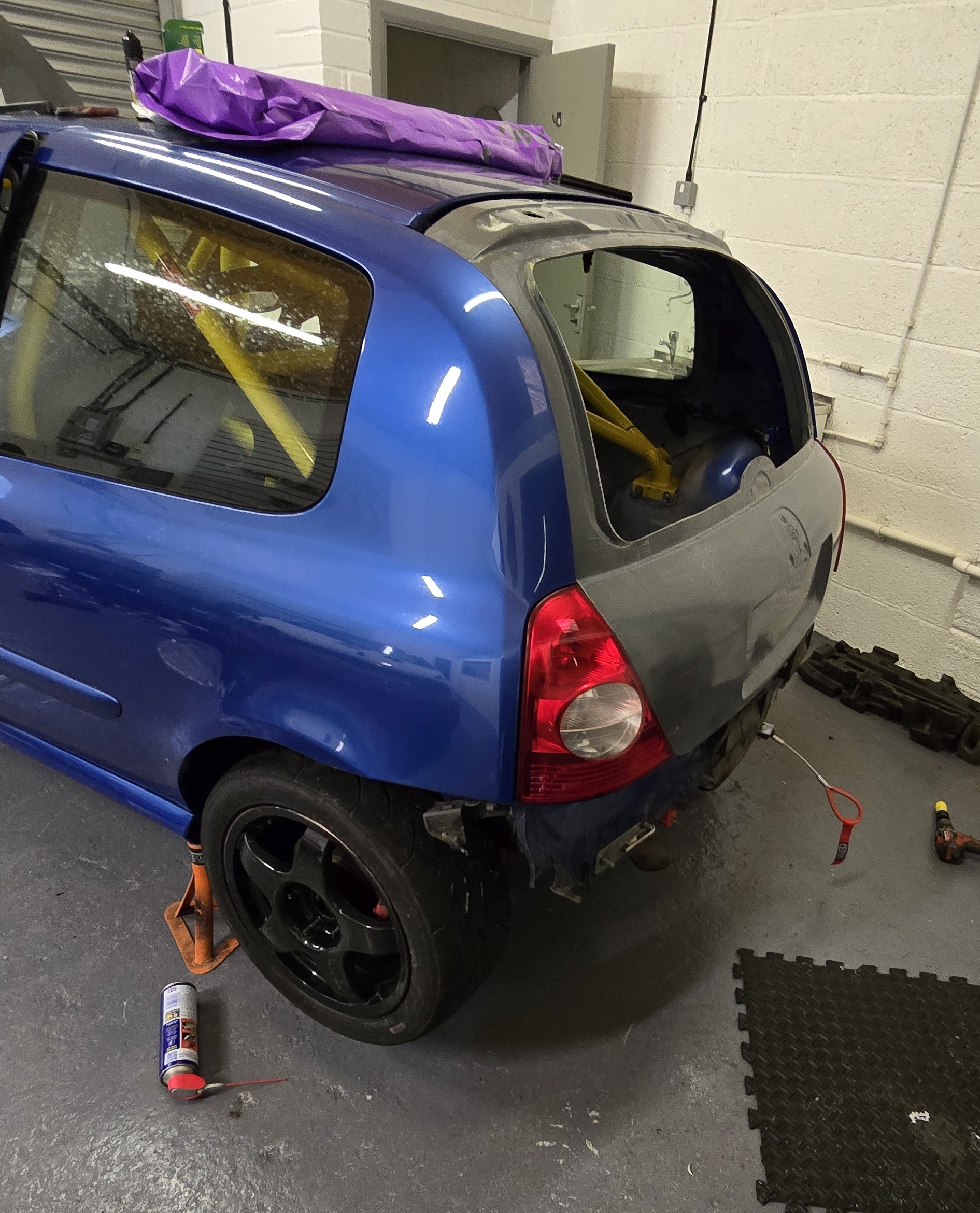

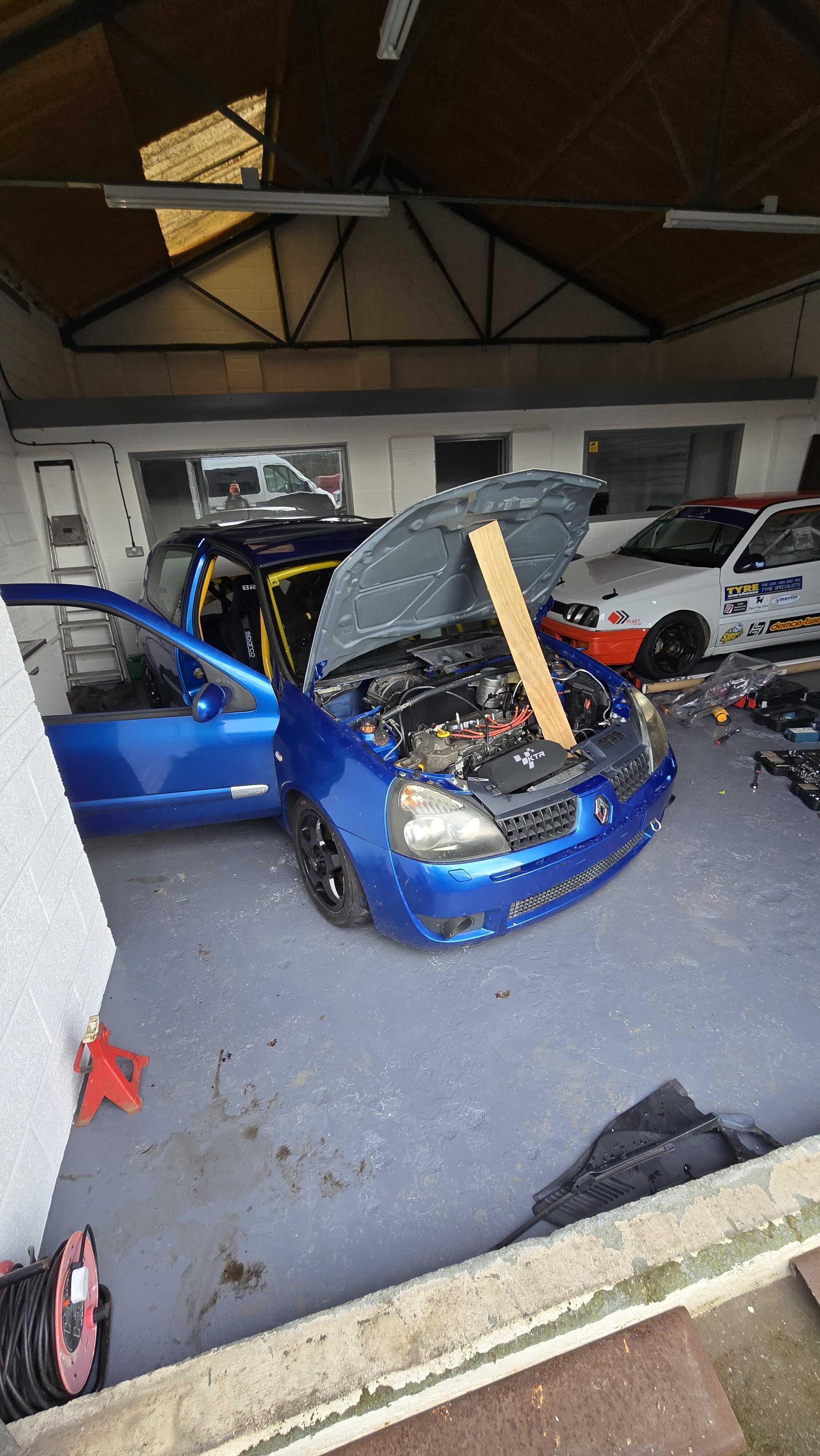

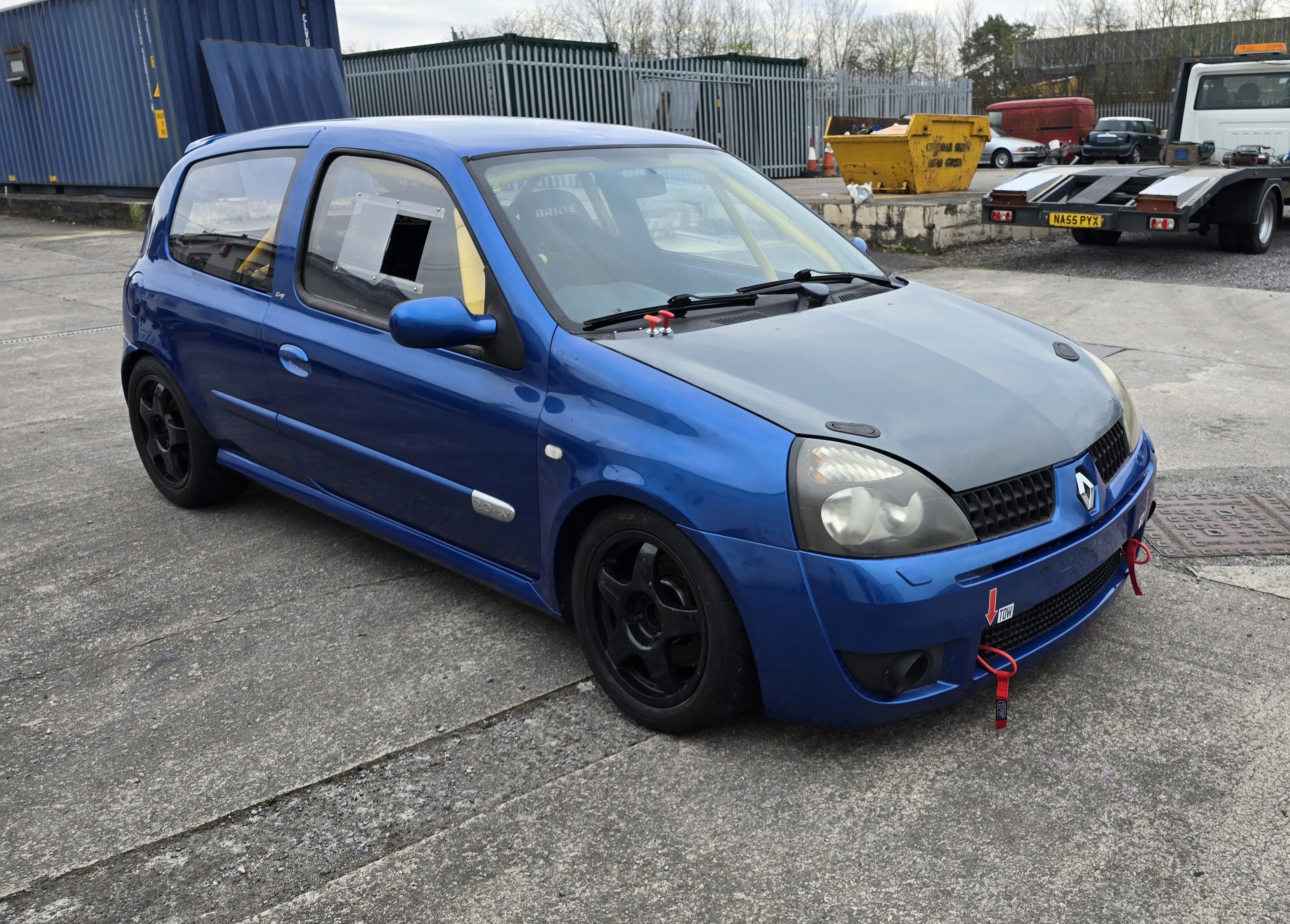

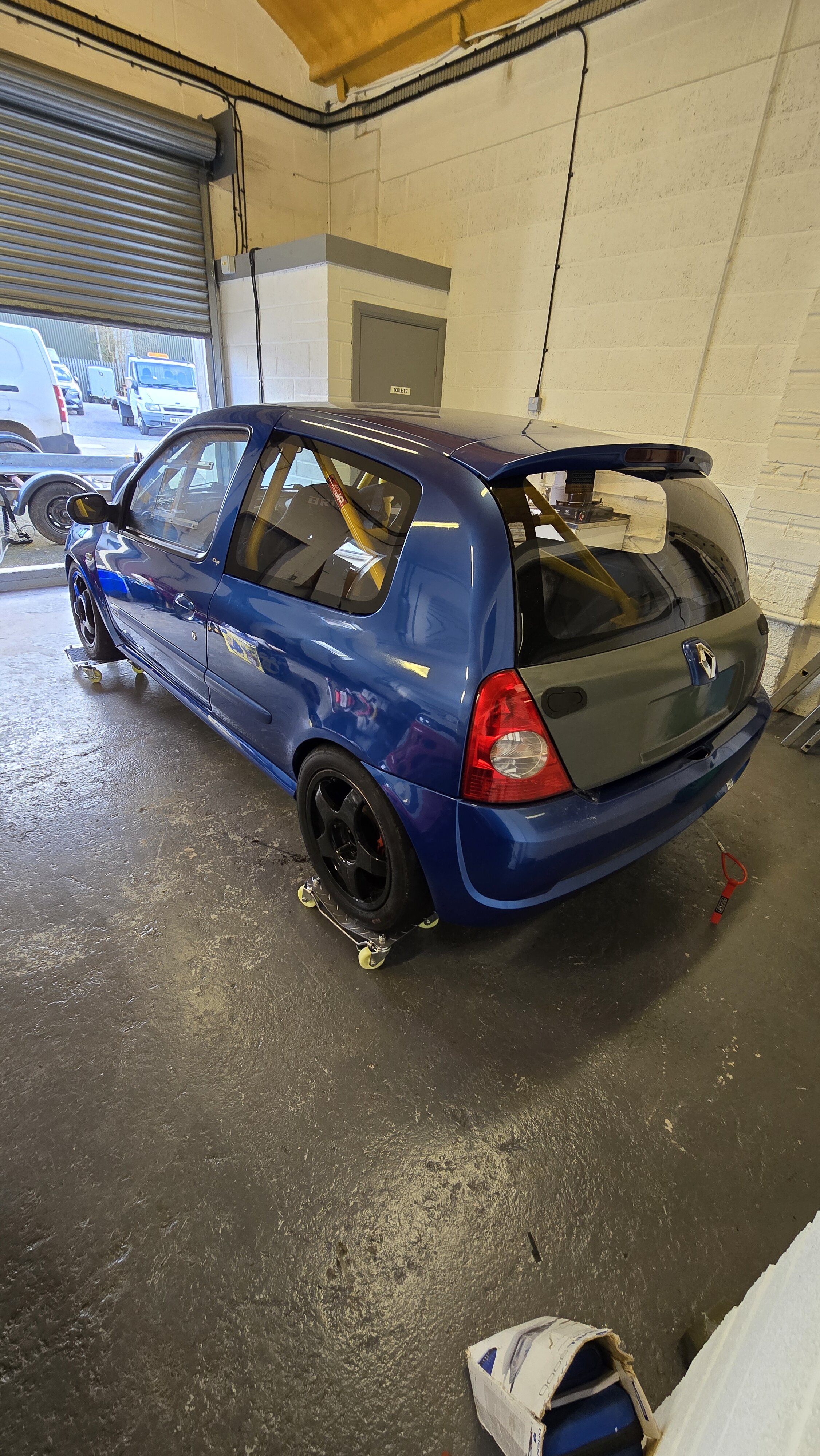

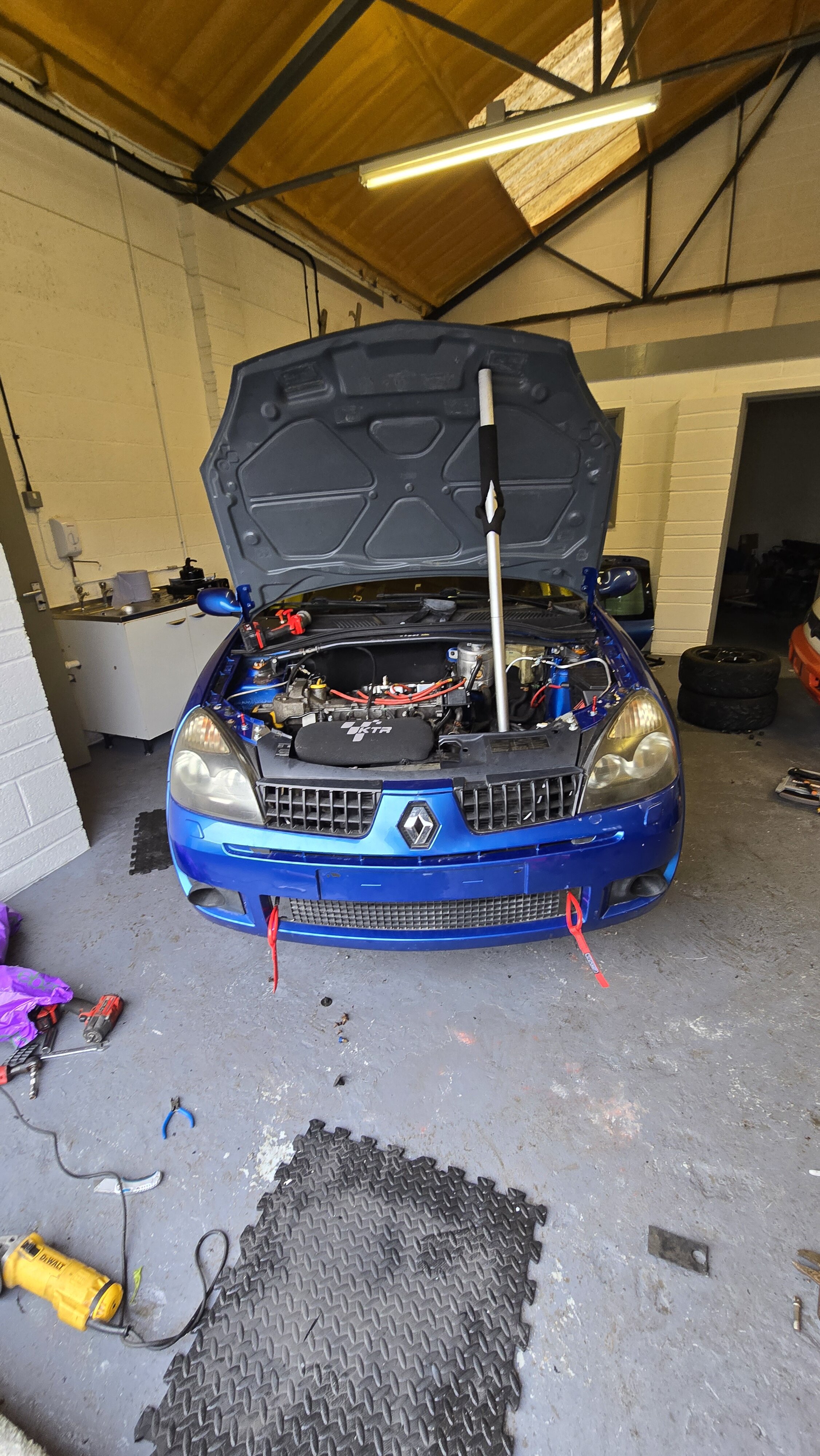

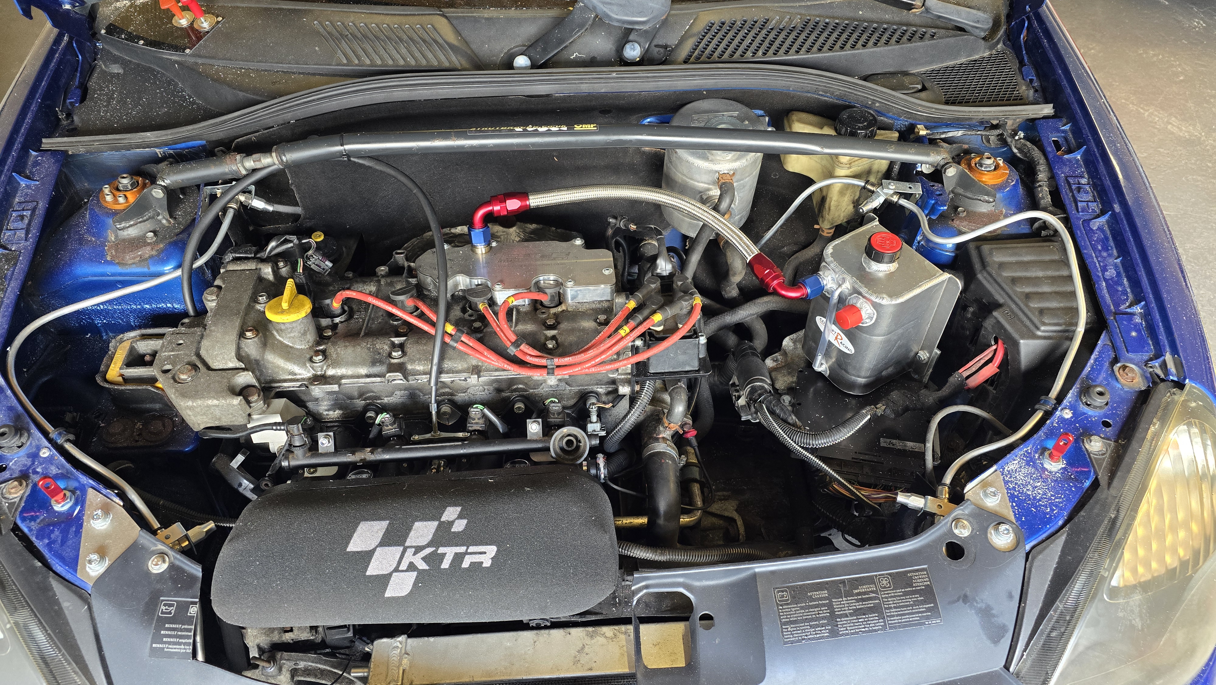

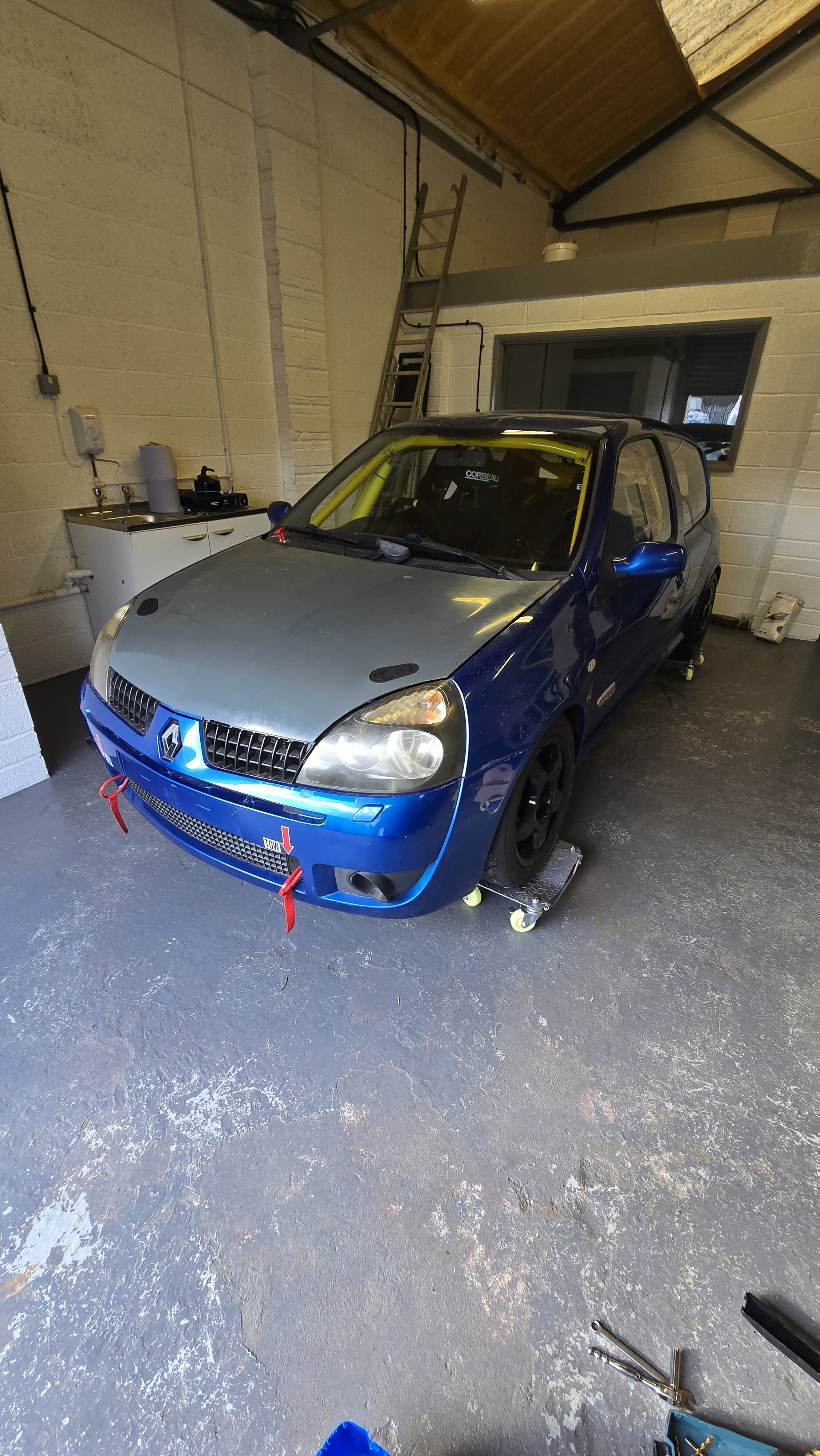

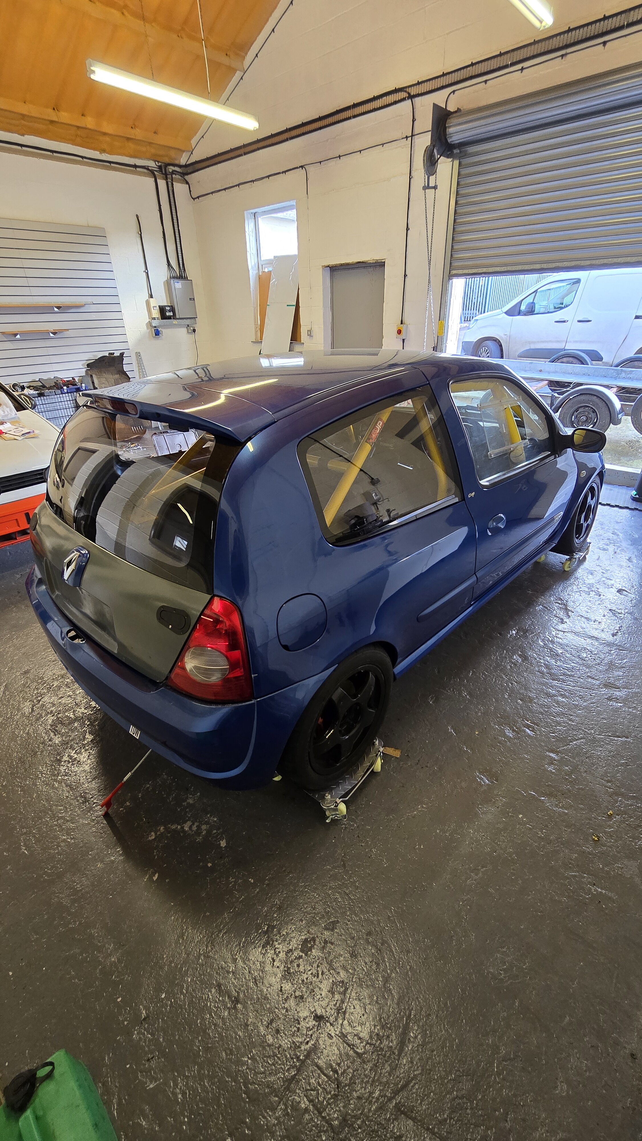

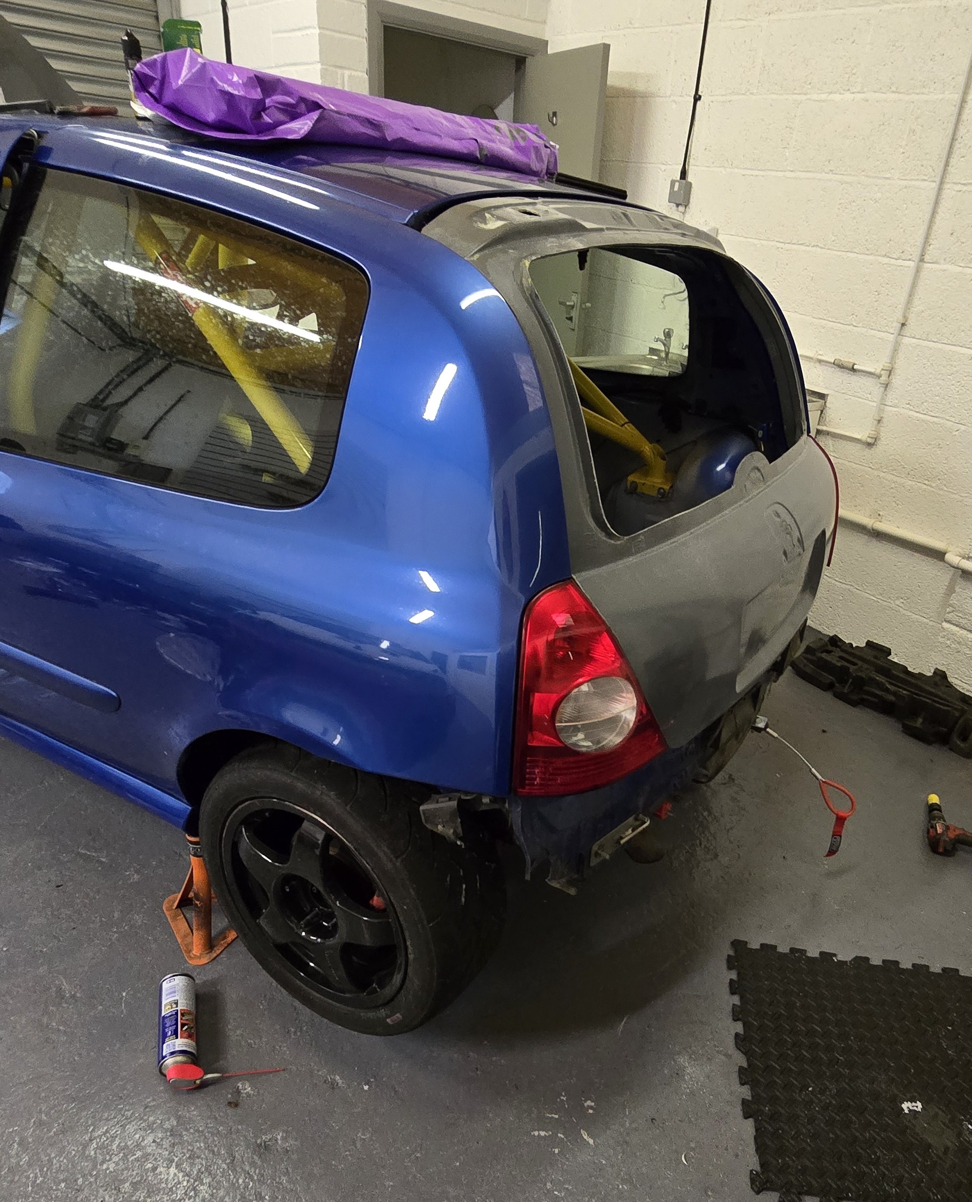

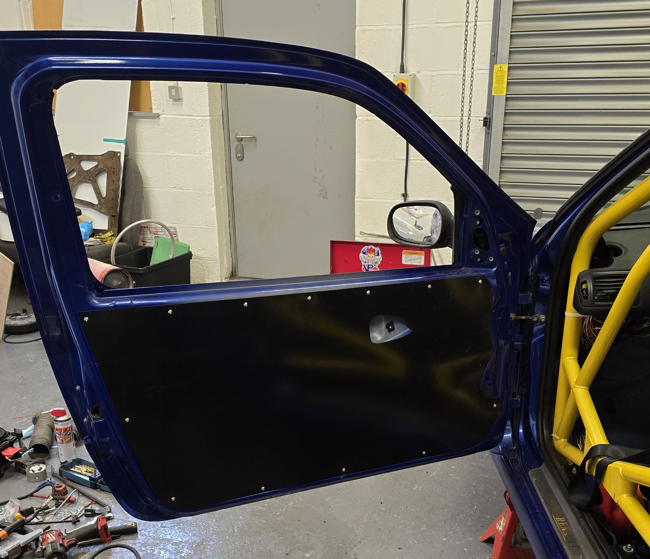

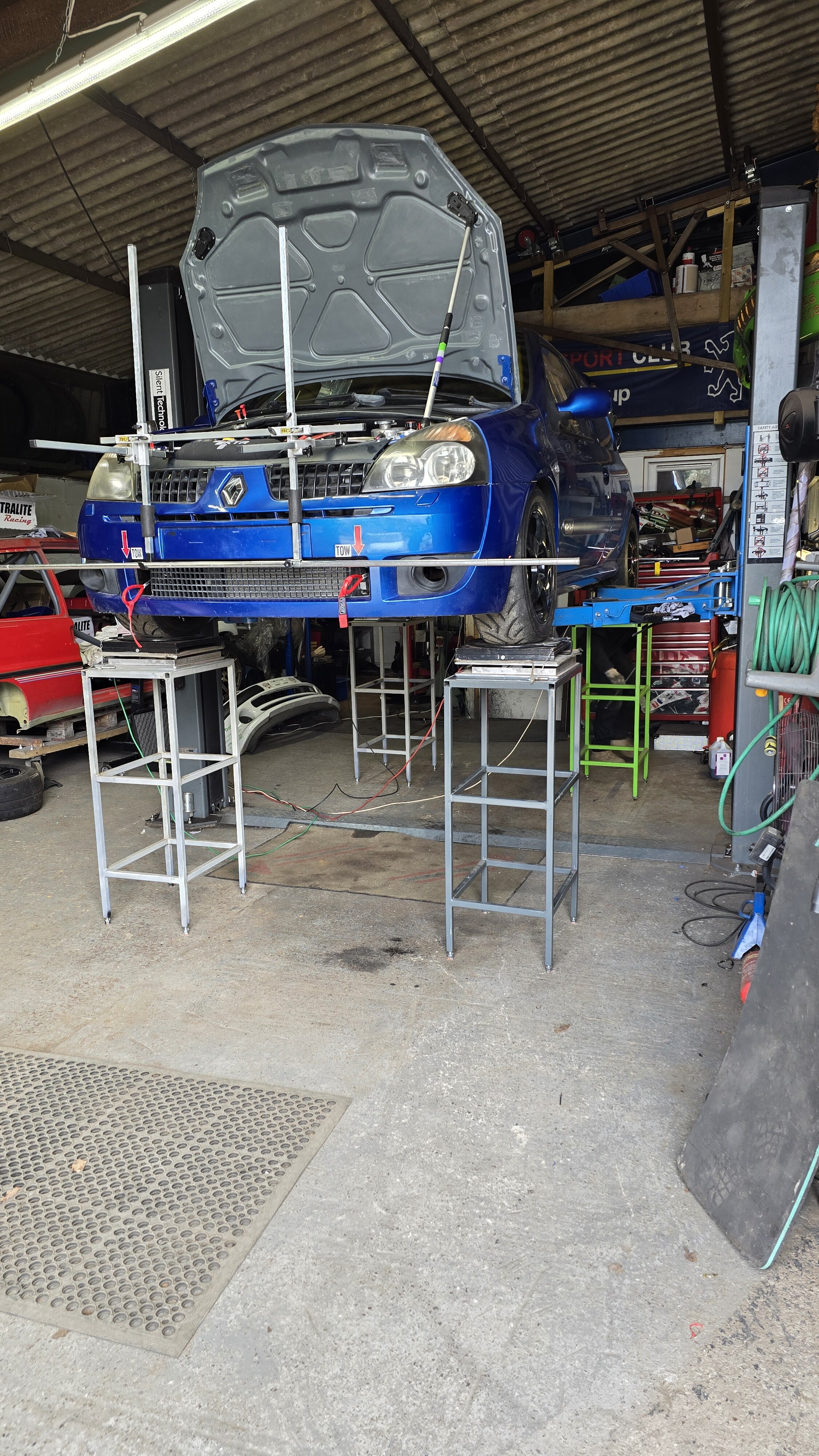

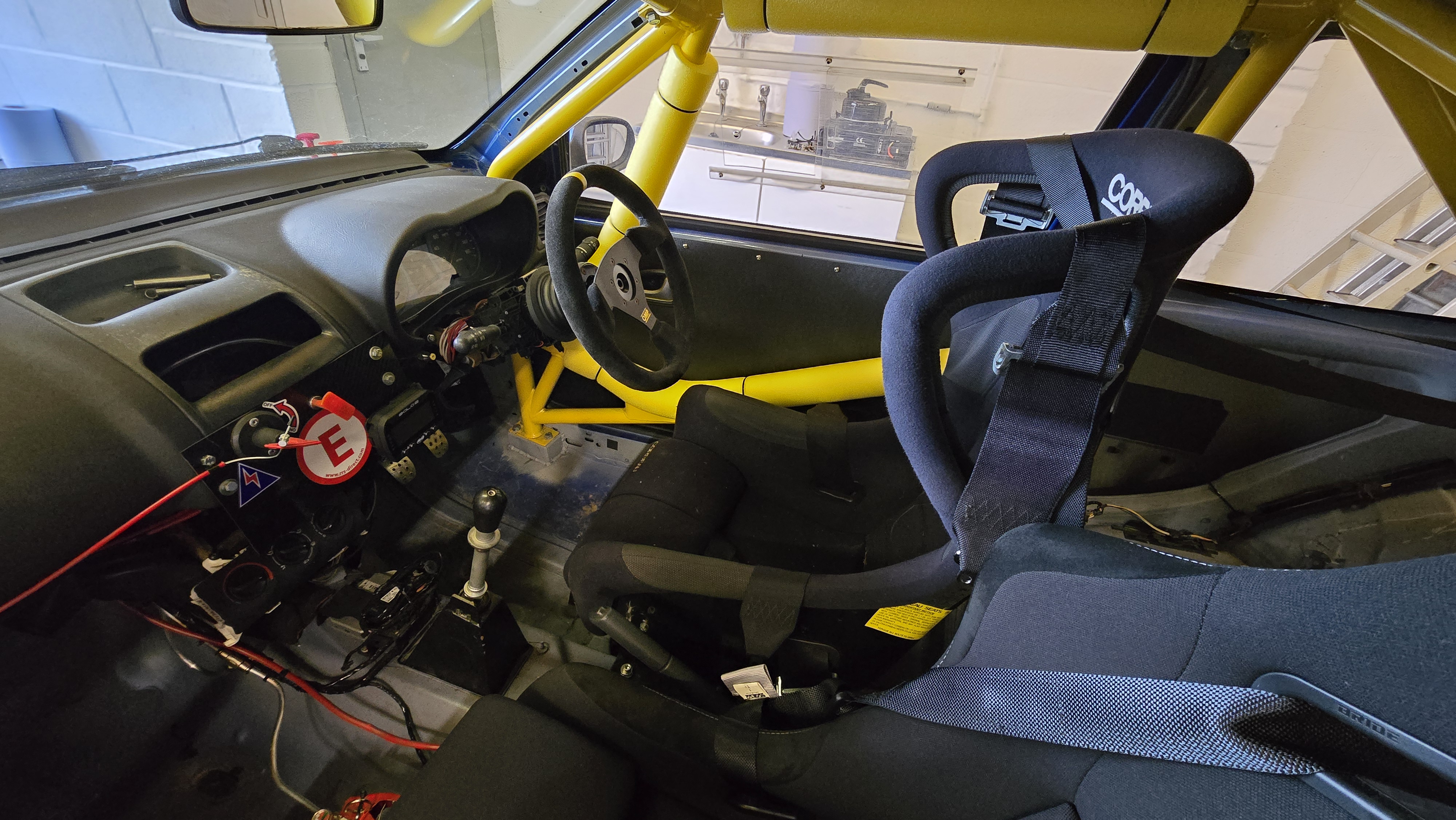

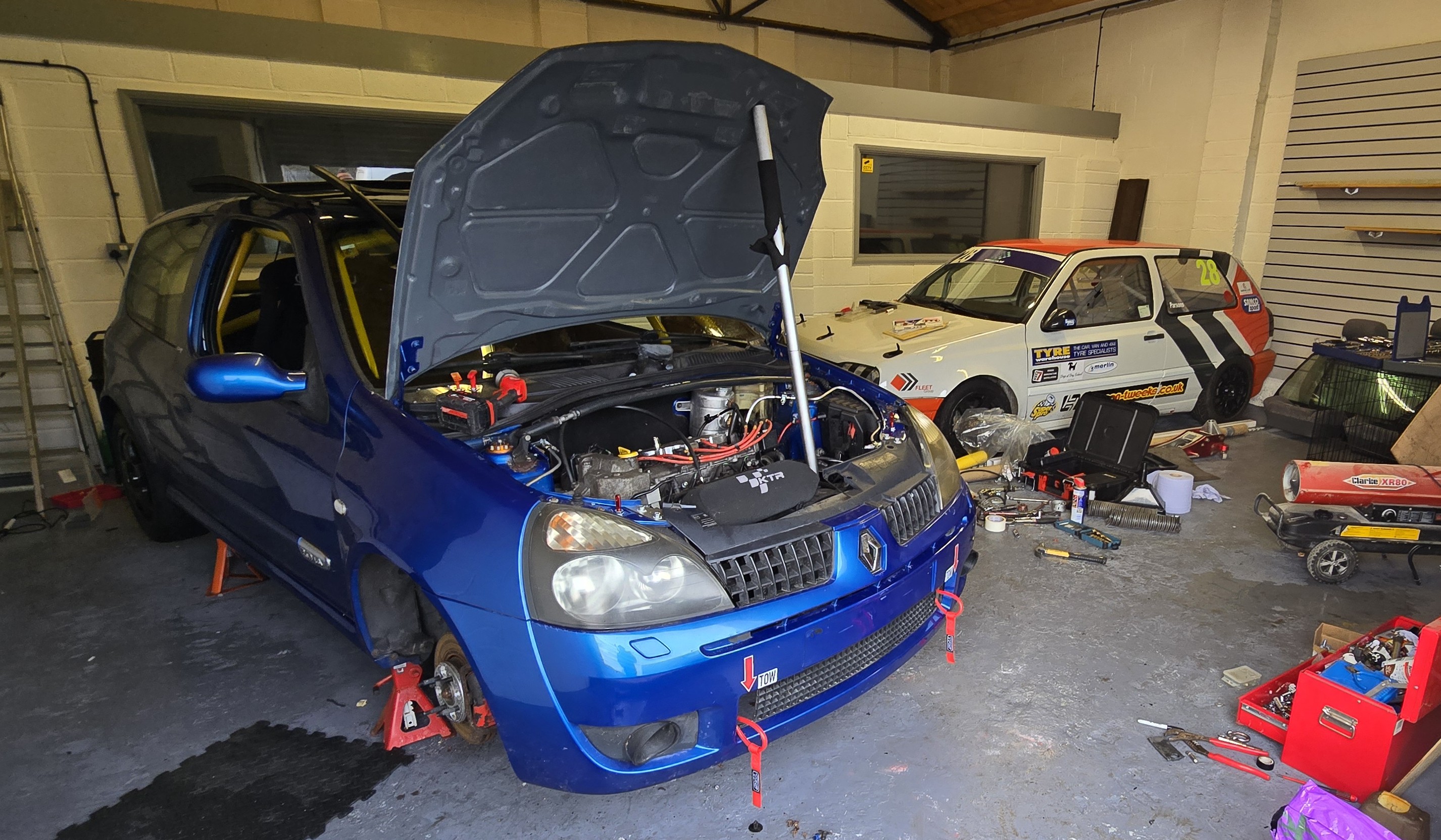

Lastly, to try and get back to the current form

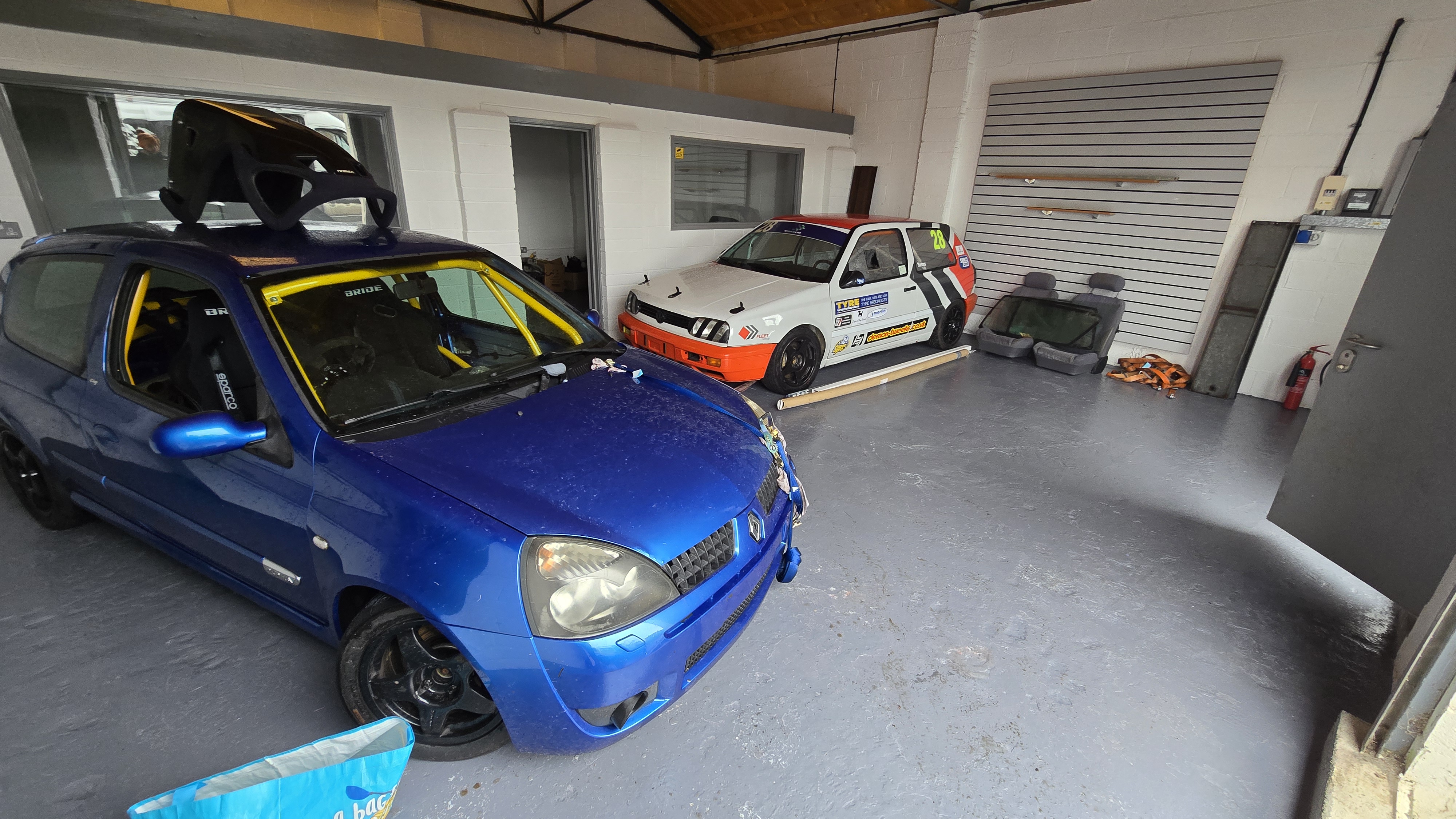

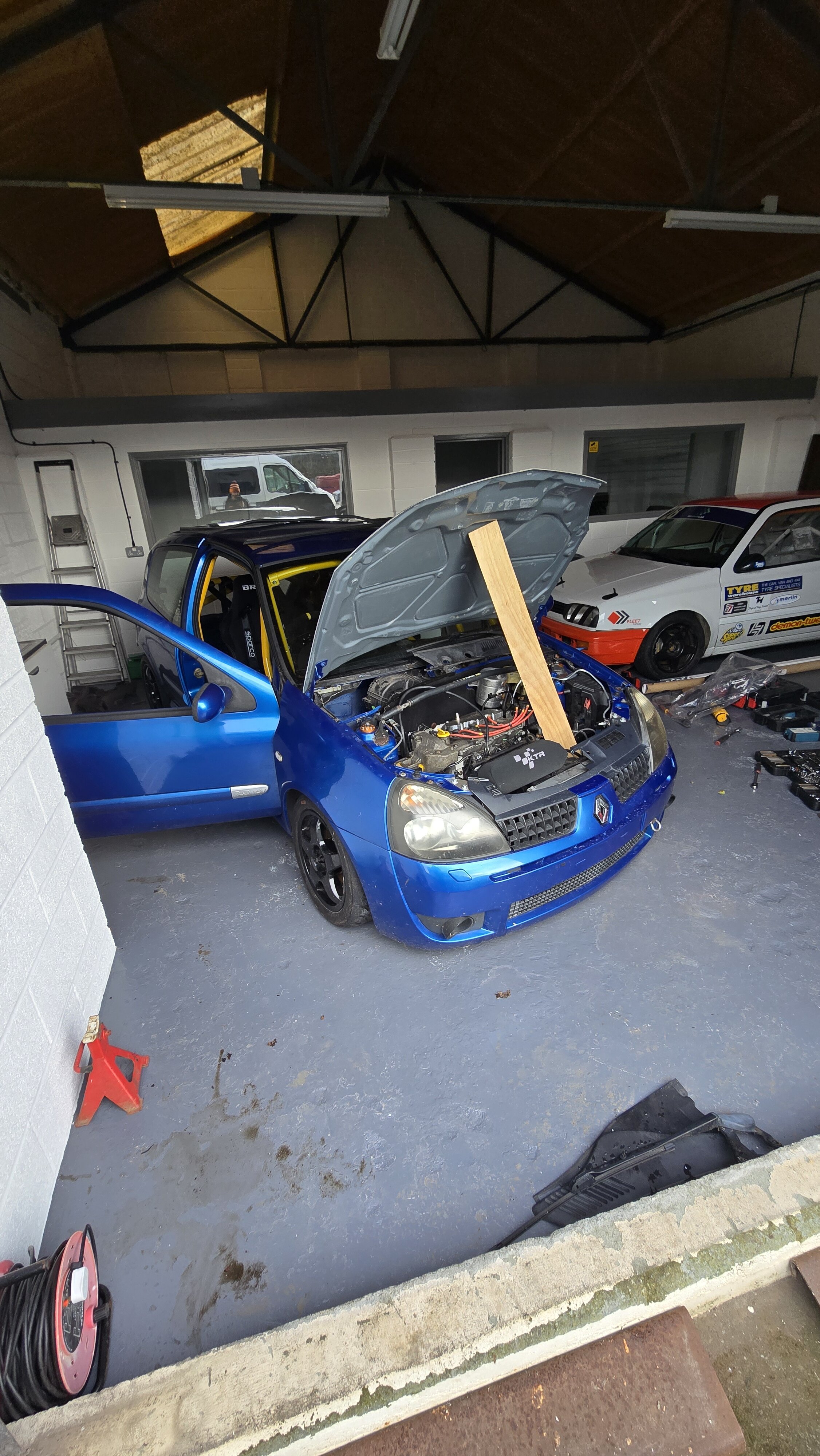

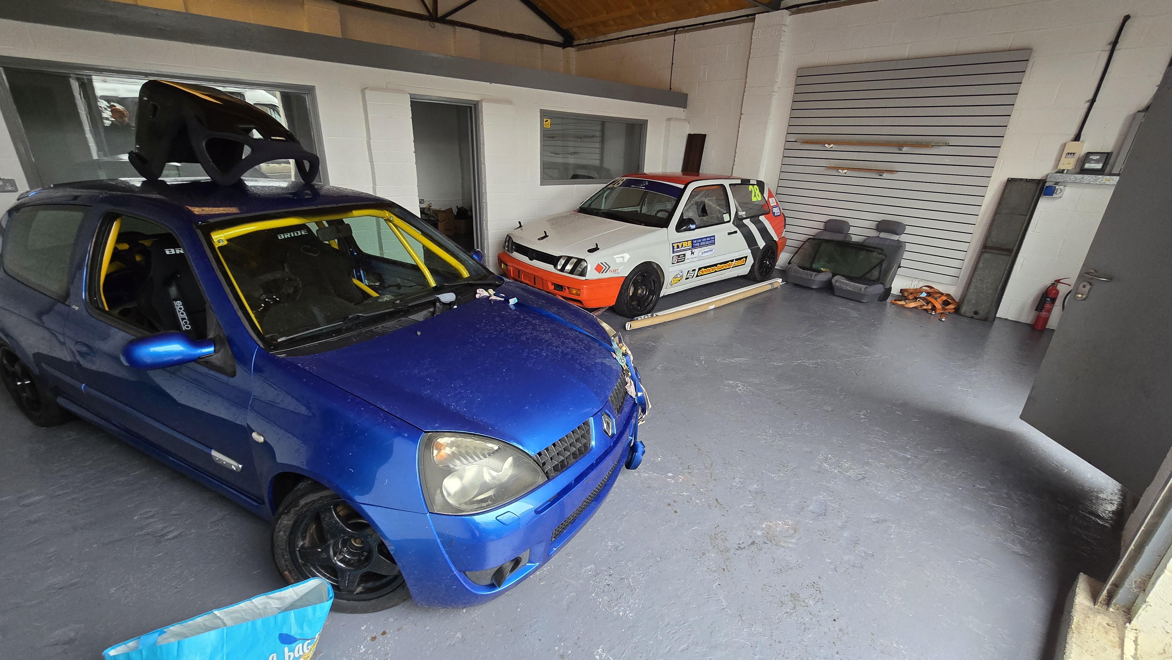

We acquired the unit, where all the tasks that couldn't be done on the driveway happened!

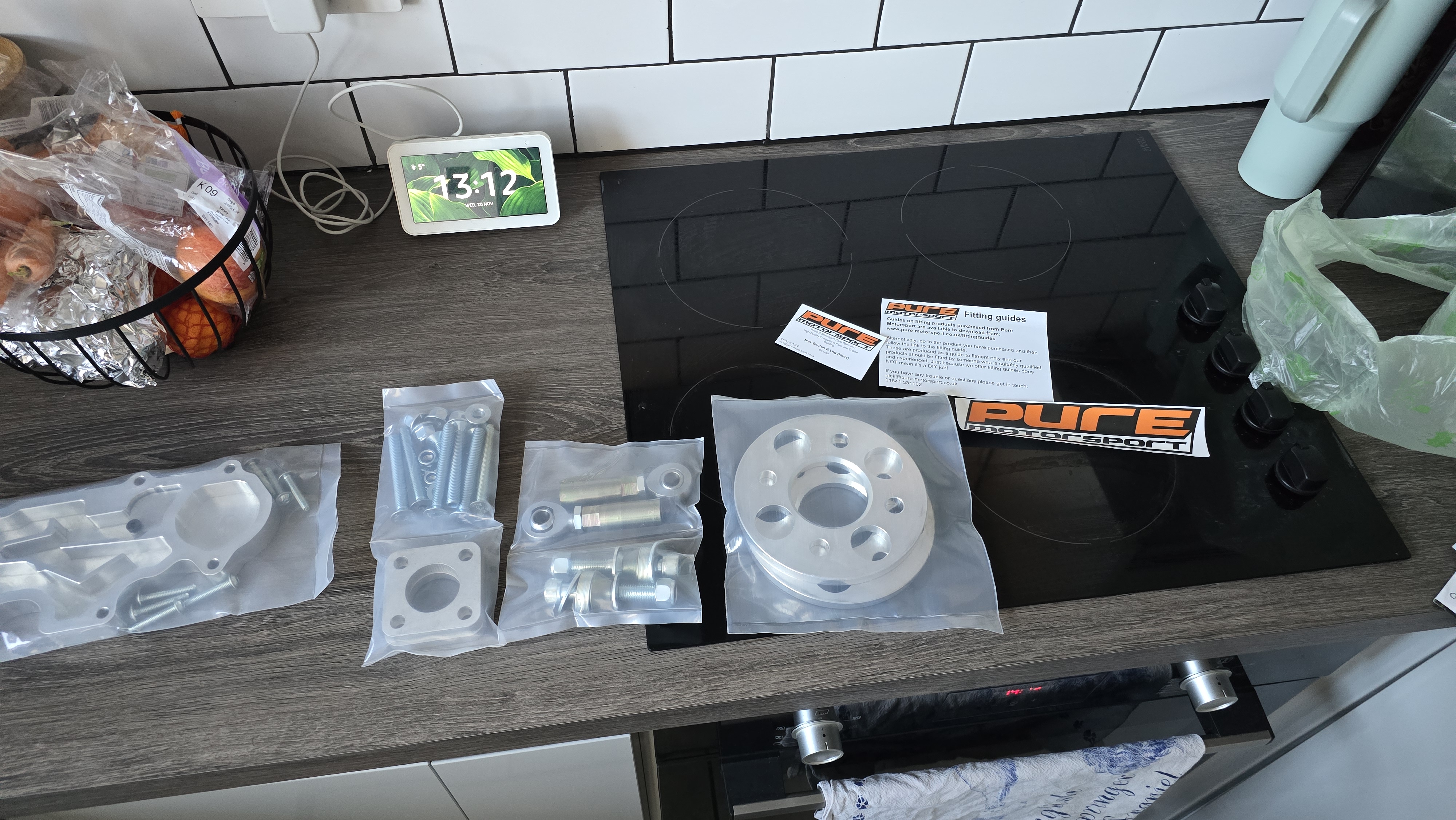

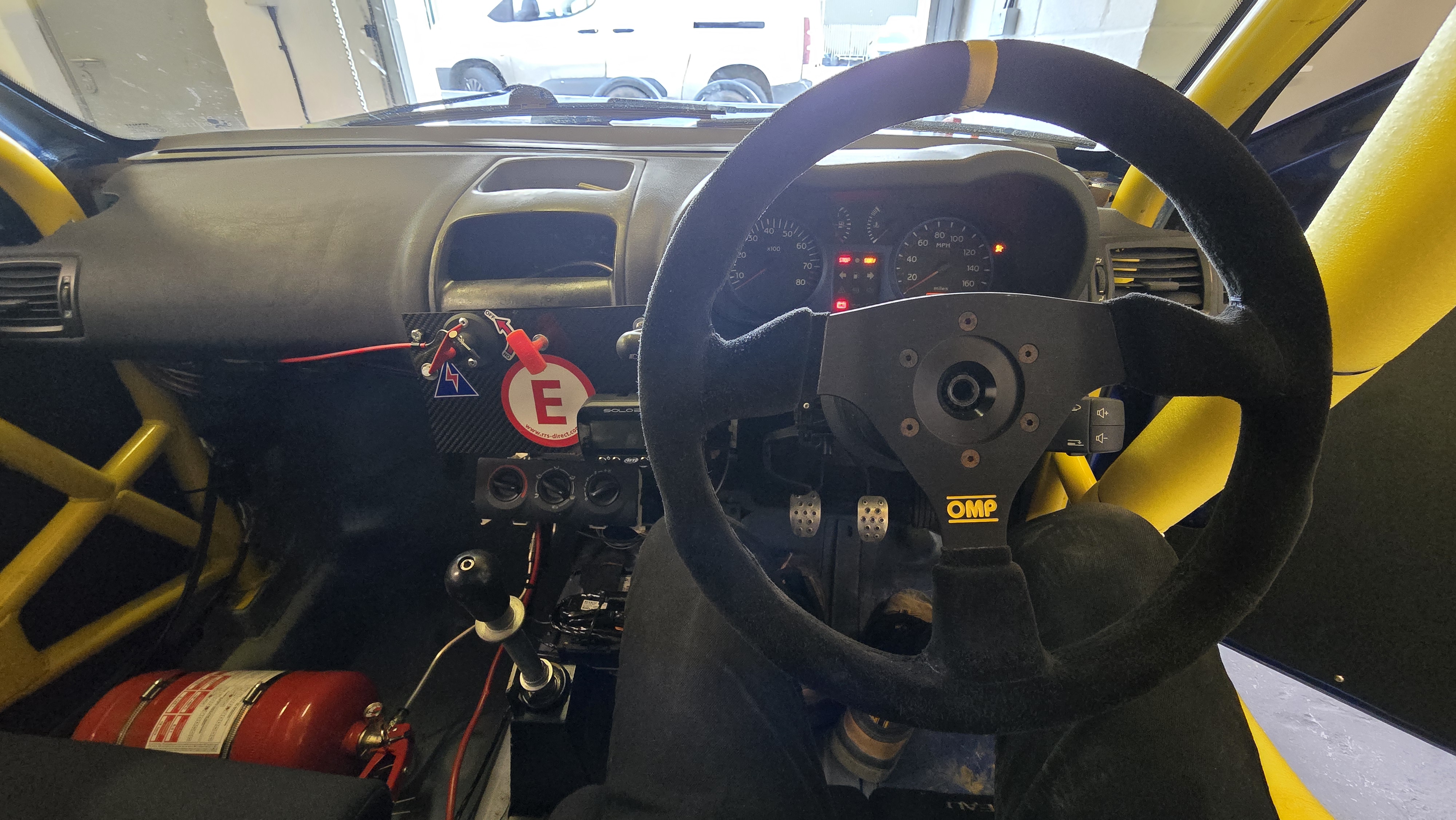

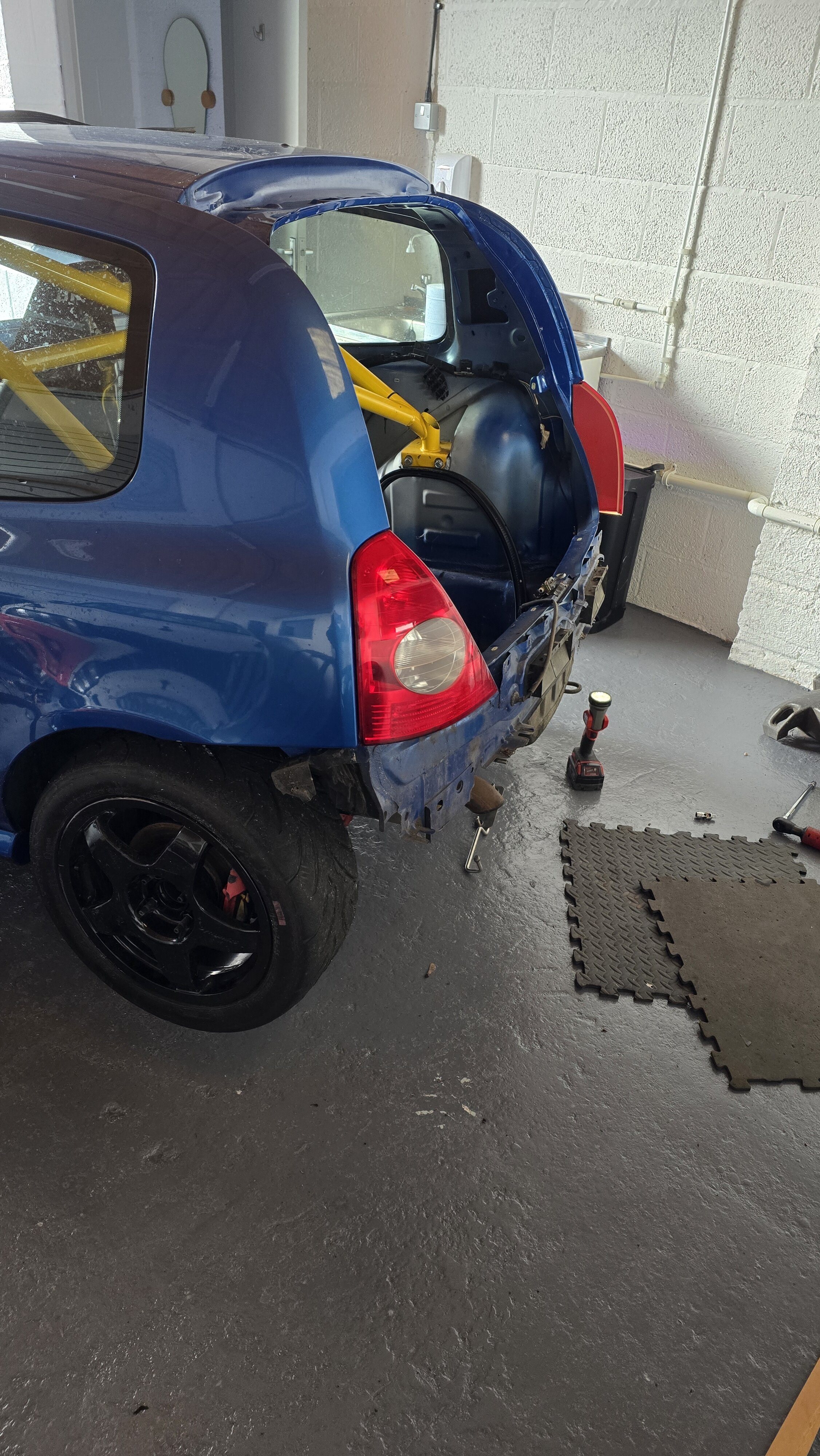

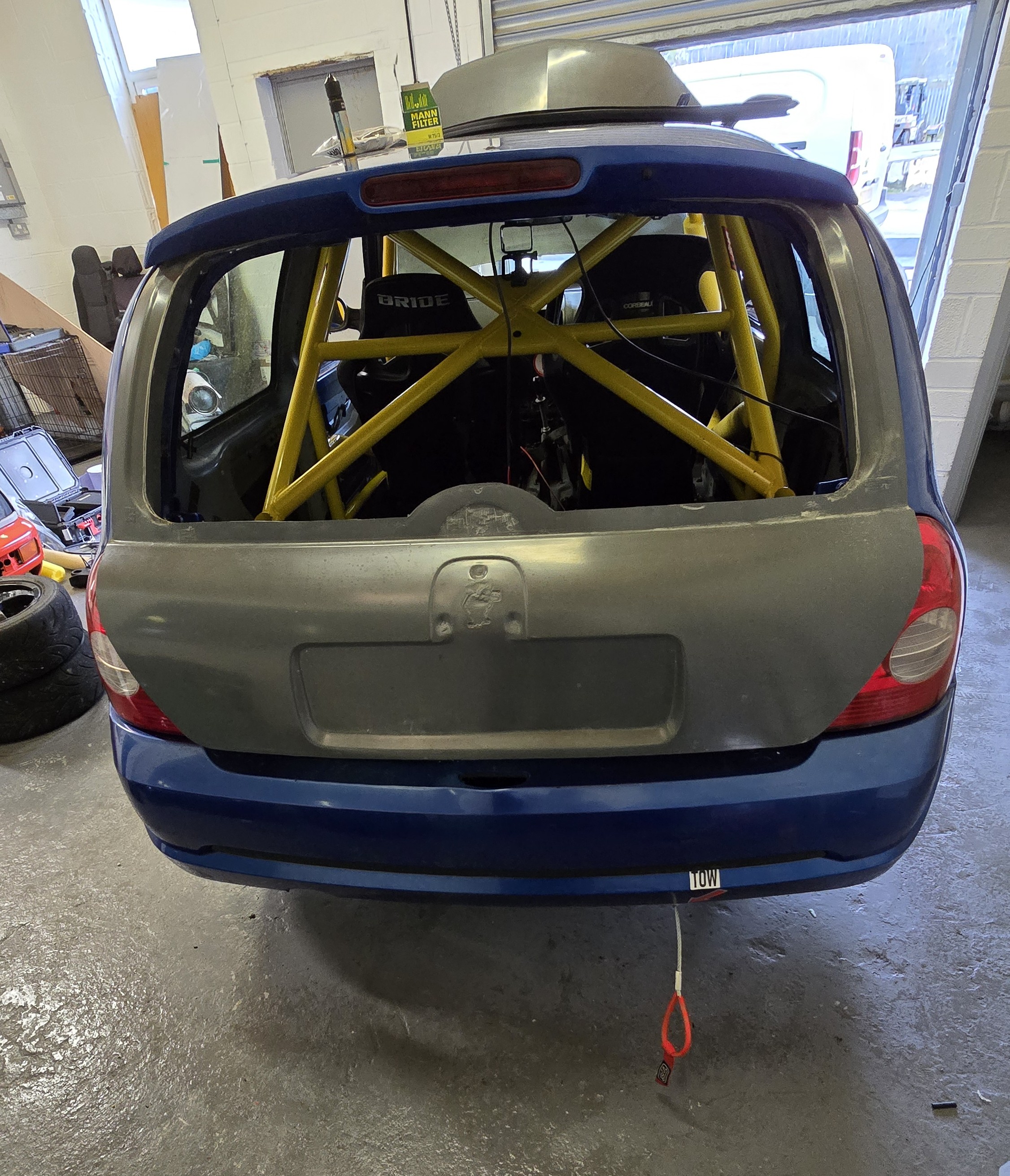

ccf bonnet and boot, poly carbs bonded in, pms stub axle spacers, all the racing reg bits, fire extinguisher, cut offs etc, pms shifter, catch can.
Suspension setup Friday, testing Monday 🫢🫣

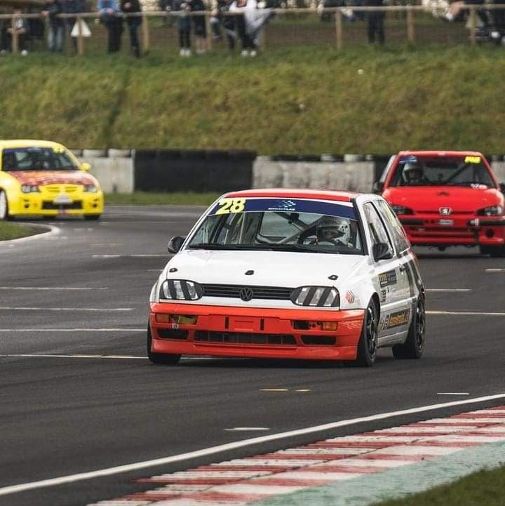

What's the spec of the Golf? Rare to see a MK3 these days!
A quick spec/history of the car for those interested..
Originally built and raced abroad, it was then bought and further developed by Will McAteer and most recently Mark Shepherd, predominantly in the Classic VW Cup & pre 93s.
Bodyshell: The bodyshell has been chemically dipped and seam welded. Welded in cage. Fiberglass tailgate and bonnet and front wings. Polycarbonate windows.
Interior: Corbeau Revolution race seat. Red top battery. Racetec gauges and a custom made wiring loom. Lightened dash board.
Engine: 2.0l 16v engine (9a bubble block with KR head) fully blue printed, ARP rod and head bolts,Motorsport baffled and gated sump. Twin 45 Weber carburettors.
Gearbox: 020 close ratio 5 speed gearbox fitted with a Quaife ATB diff and 3.9 final drive. Sachs racing solid paddle clutch and lightweight flywheel.
Suspension: Fully adjustable Gaz gold dampers, Rose jointed top mounts. Ball joint spacers to correct roll centres. Seam welded front subframe and wishbones.
Brakes: AP Pro Race 5000 front calipers with AP304mm discs, mounting bells and brackets, Bias pedal box with remote cylinders and in car adjuster. All lines are Aeroquip.
Other bits: ATL FIA 60 litre fuel cell. Red top fuel pump. All fuel lines and fittings are Aeroquip and run inside the car. Lots of one-off custom-made parts including airbox. Quaife quick rack.
Car is left hand drive and weighs 870kg.

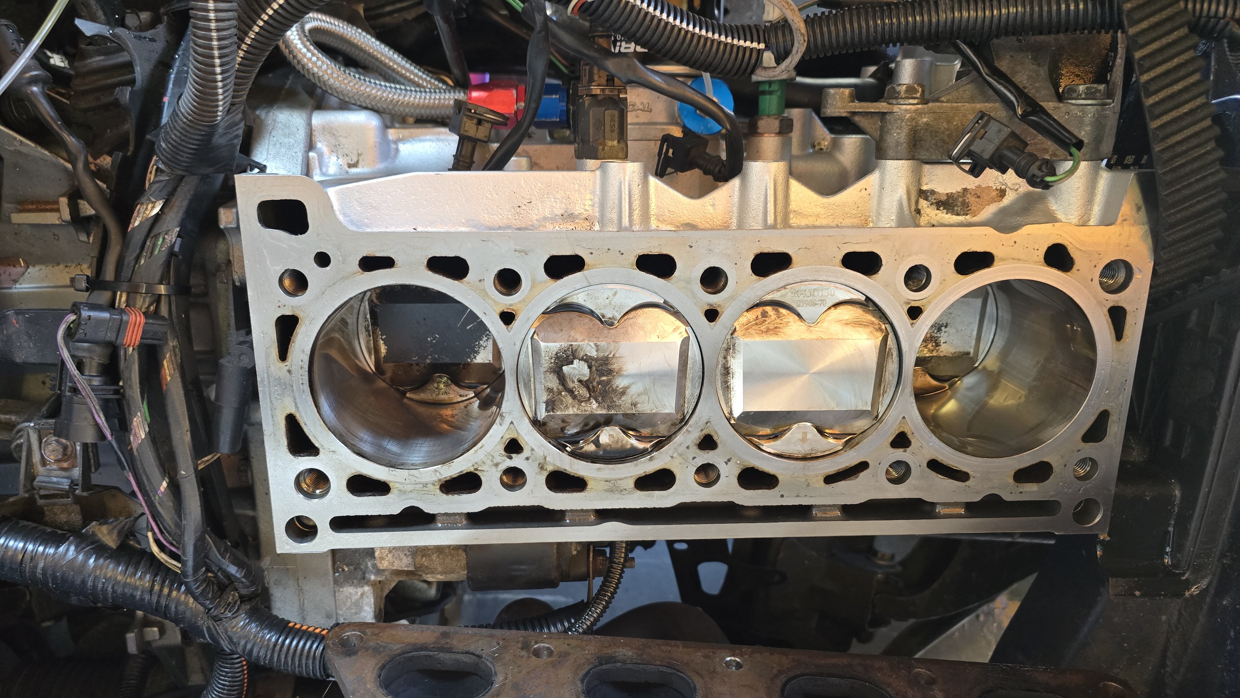

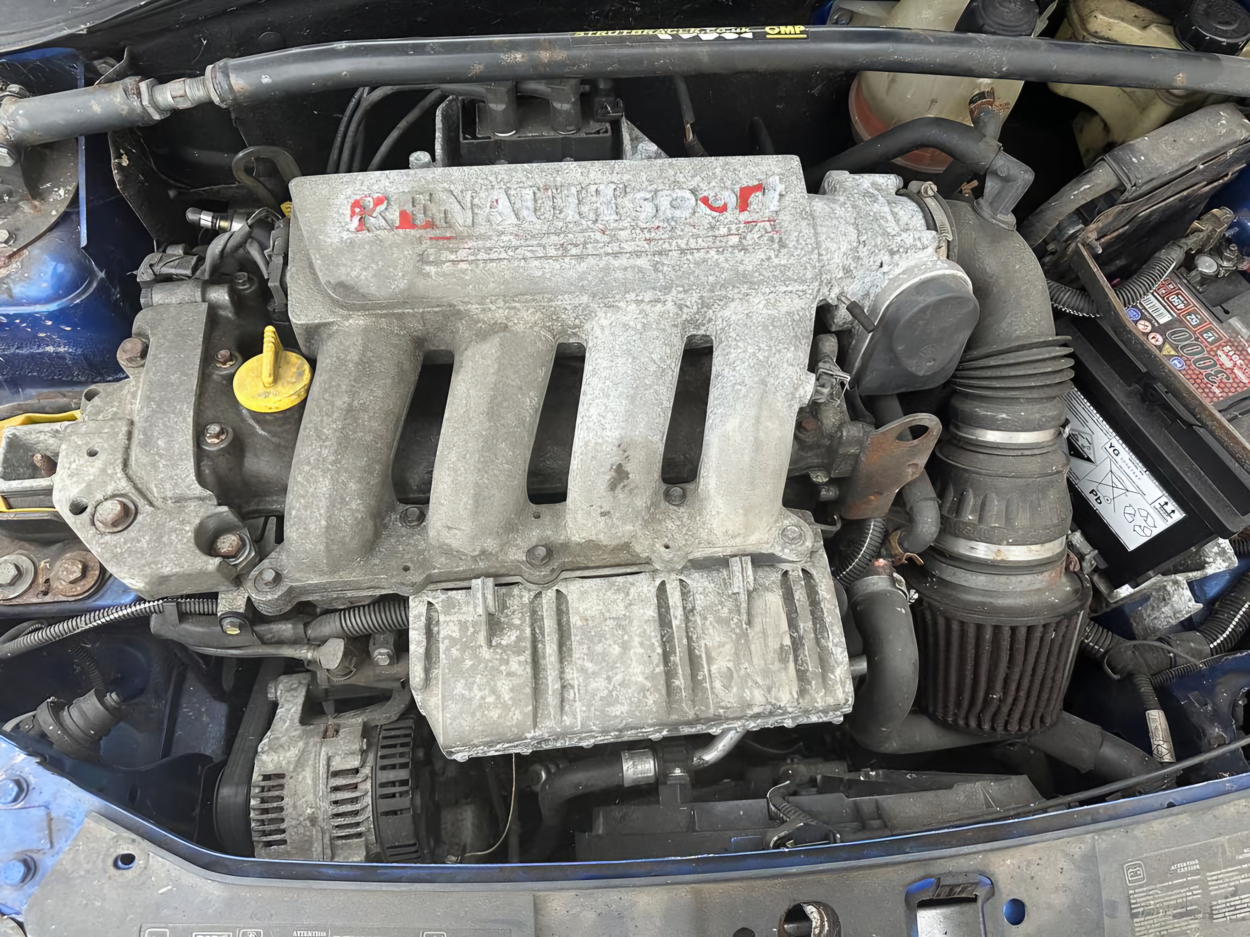

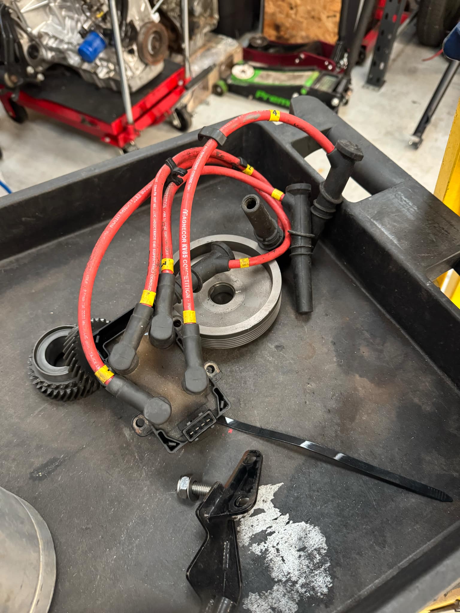

What’s the history of the motor? Defo the bottom end that’s s**t the bed?
Unknown to be honest, just had 197 cams fitted, belts and an oil change last week, I believe so, cams are turning so not the timing belt, very tight turning over by hand, need to drop the sump and inspect 🥲
I guess race pace and 20+ year old tuned engine 🥹

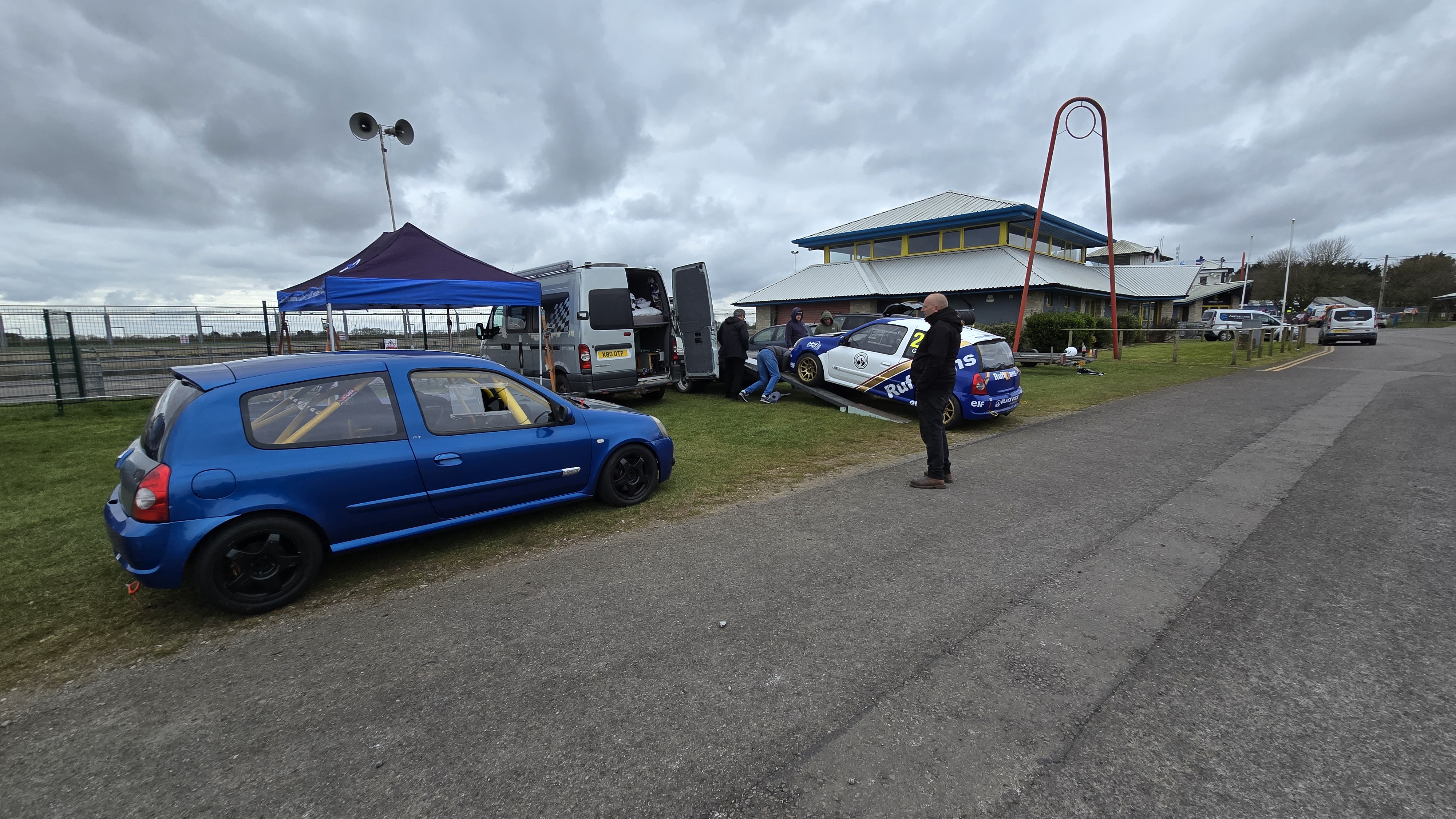

@ParsonsMotorsport Did you get it sorted in the end? Stood at Quarry to watch the CCRC Hot Hatch yesterday. Saw three Clio's running: Gulf livery, Ruffmans livery (great run on a Civic into Esses) and the green/grey wrap
Unfortunately didn't make the round for racing, I was up there, Darren in the ruffmans catastrophically failed (fireball photos are on jackflash photography page) Justin Holloway did well in the gulf livery car, still waiting for pistons to arrive then can build my engine up 😊

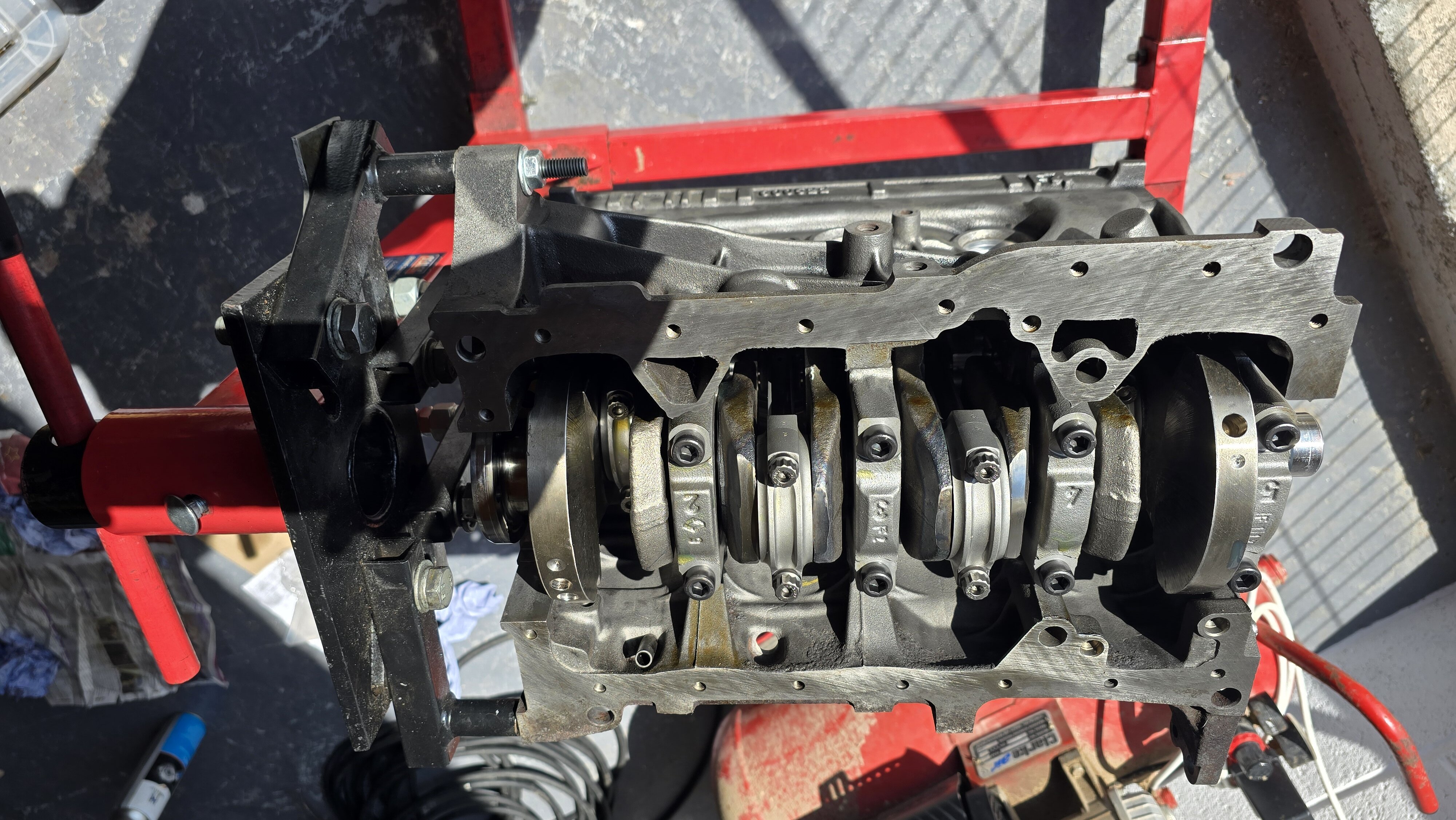

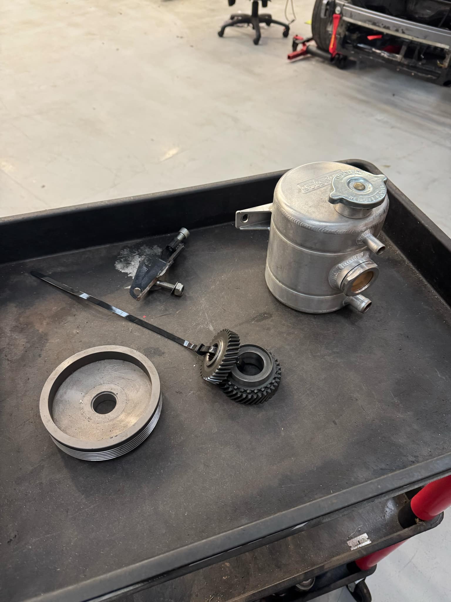

Copy and paste from my Facebook post but you guys get the jist, clio issues dont end!!

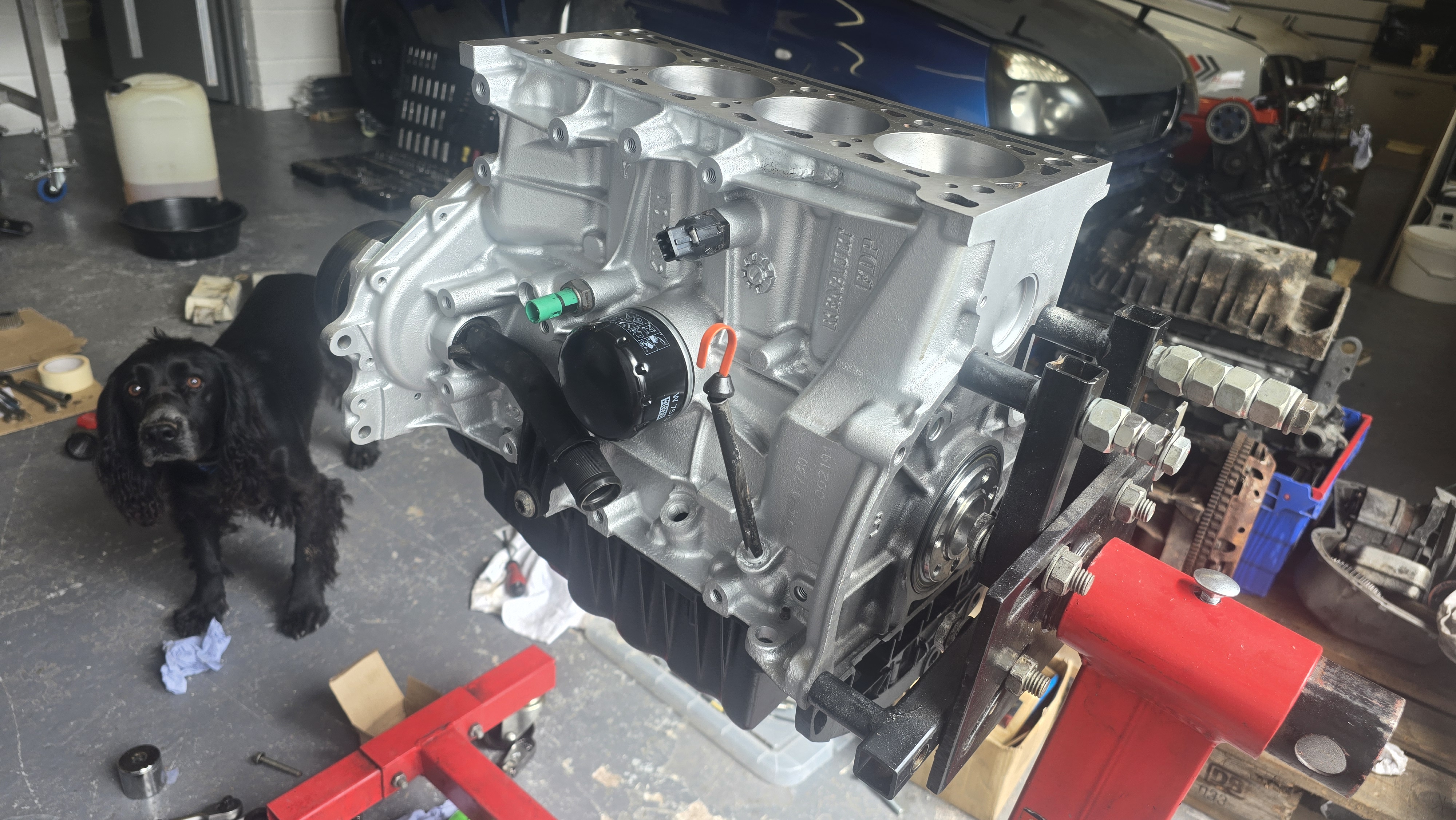

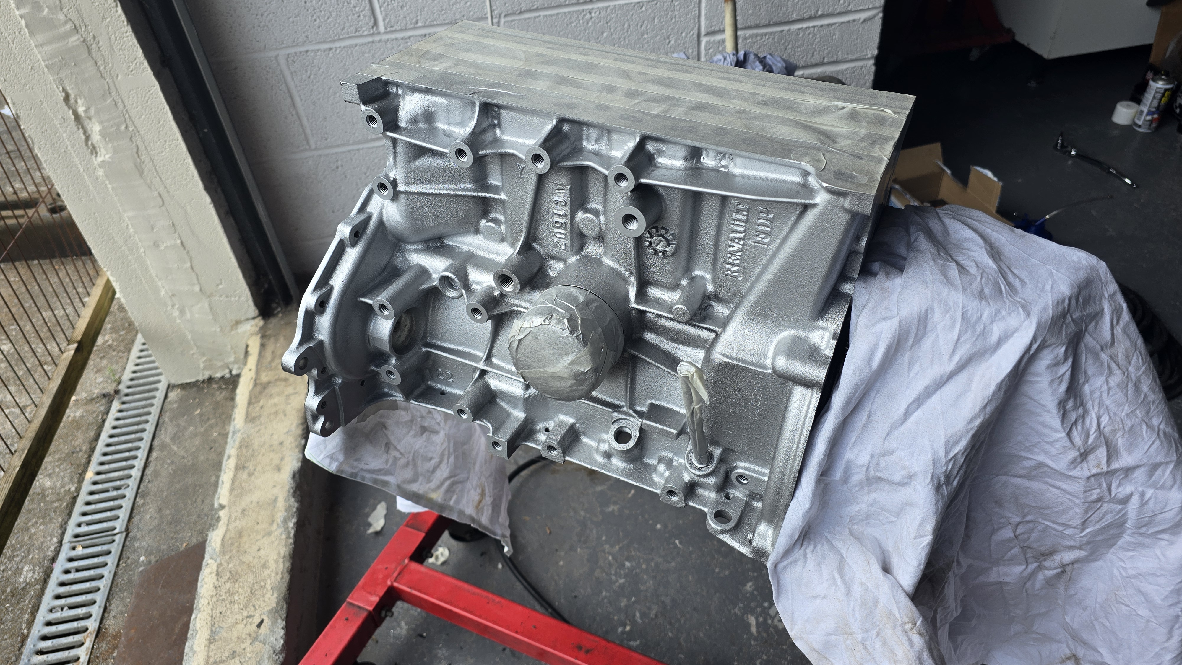

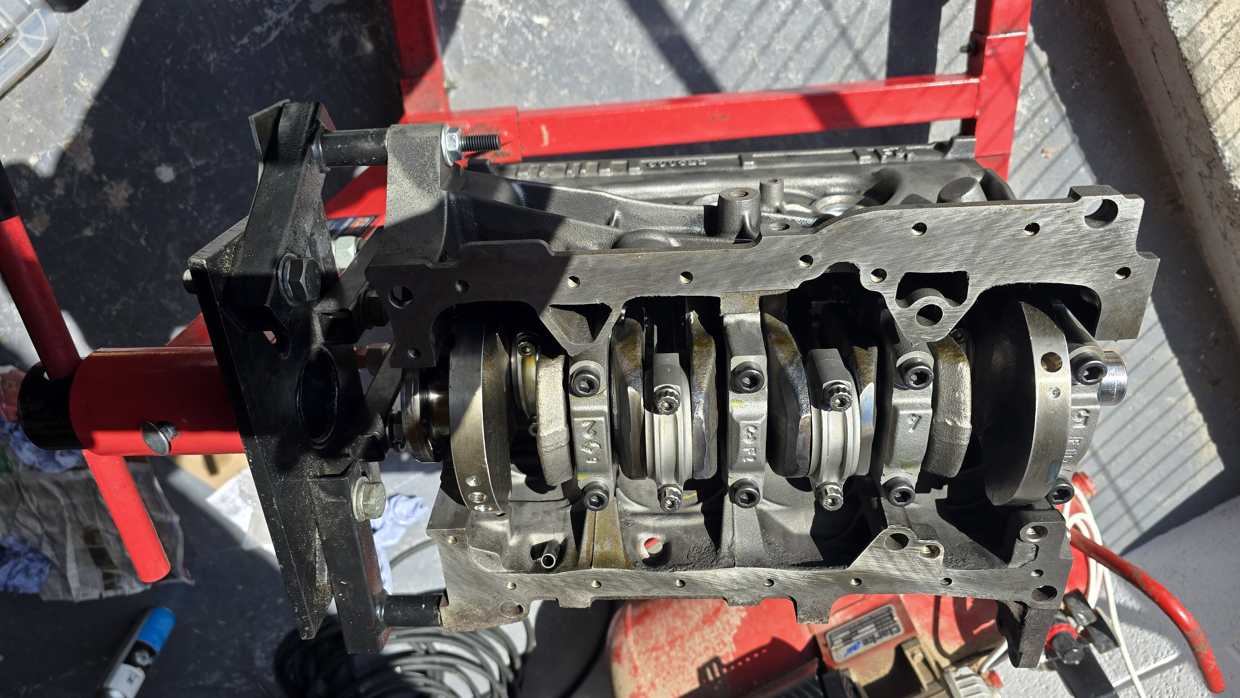

"Where to start..
With the bottom end failing during testing ahead of the 2025 season..
We set about building a strong bottom end, a trip down to Hyland Car Sales Ltd (hyland motorsport) we collected a set of manley rods and a phase 1 crank and block, thanks Corey Webber!
This was then dropped to Dave Yandell at DY Engine Services, who machined, polished and cleaned every orifice, likely in his lifeguard tshirt..
A thankyou is in order for Engine Dynamics who sourced us a set of pistons from Germany and got them sent to us nice and quickly, along with squirter jets and flywheel bolts, cheers andy!
Not forgetting the lads at FrogJam Motorsport for supplying the initial engine rebuild parts and last minute panic order of bearings they managed to get out on a next day order.

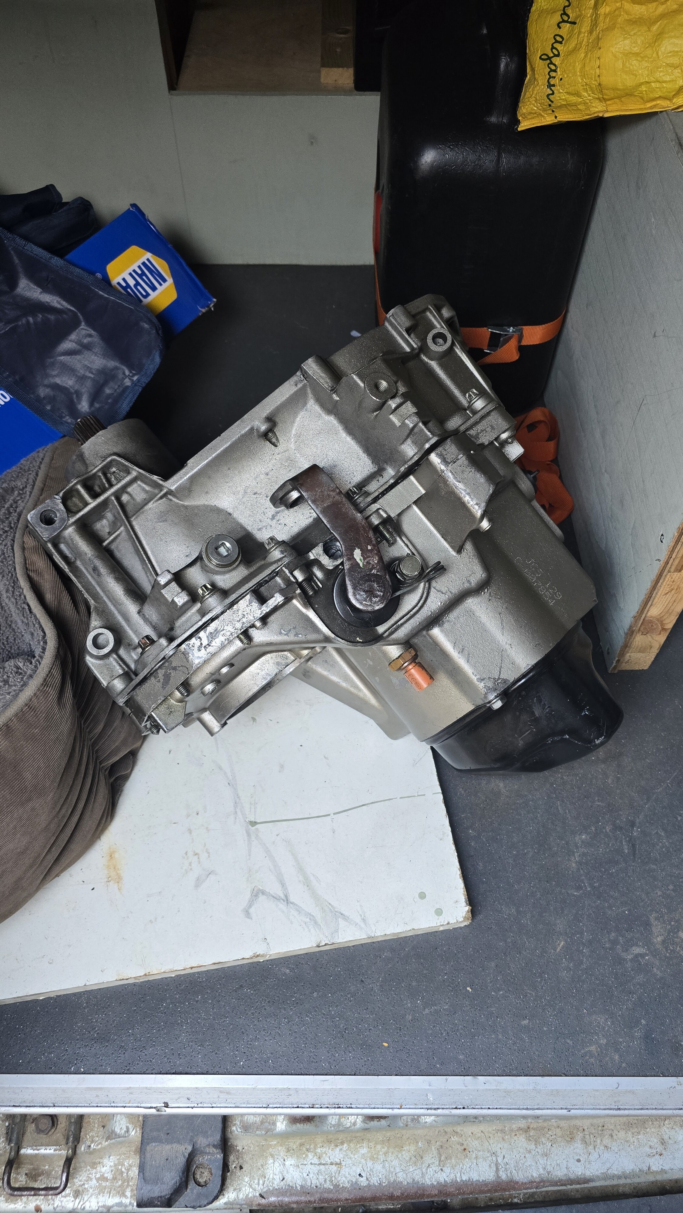

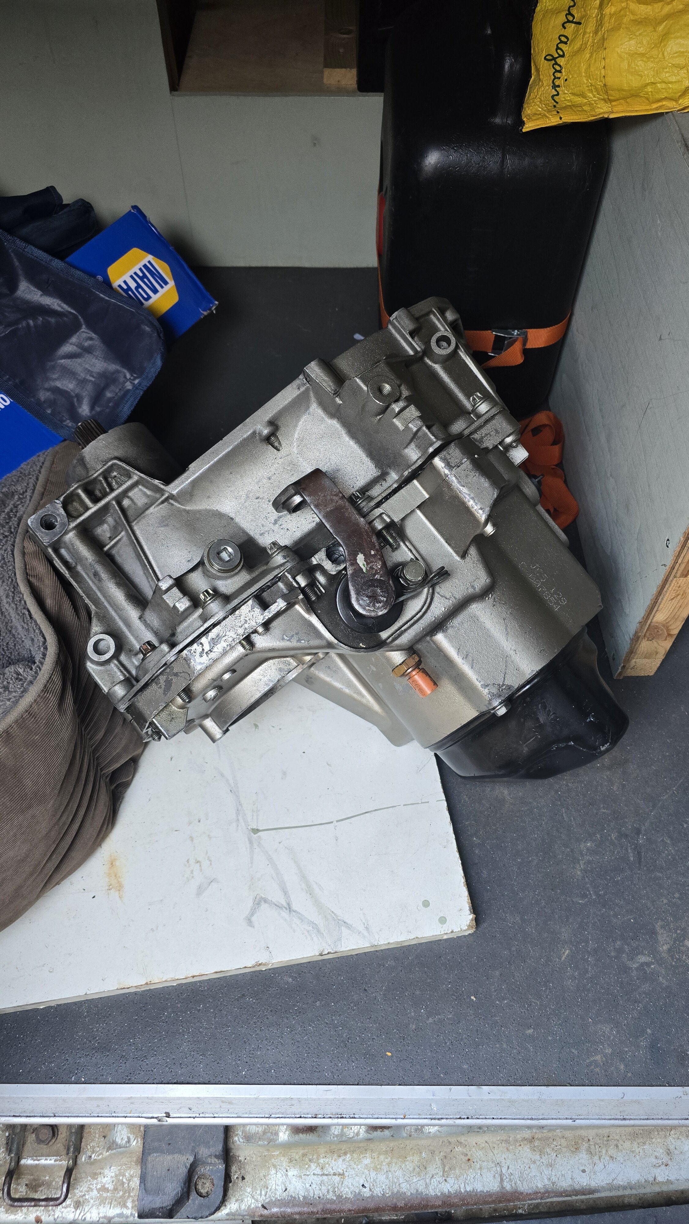

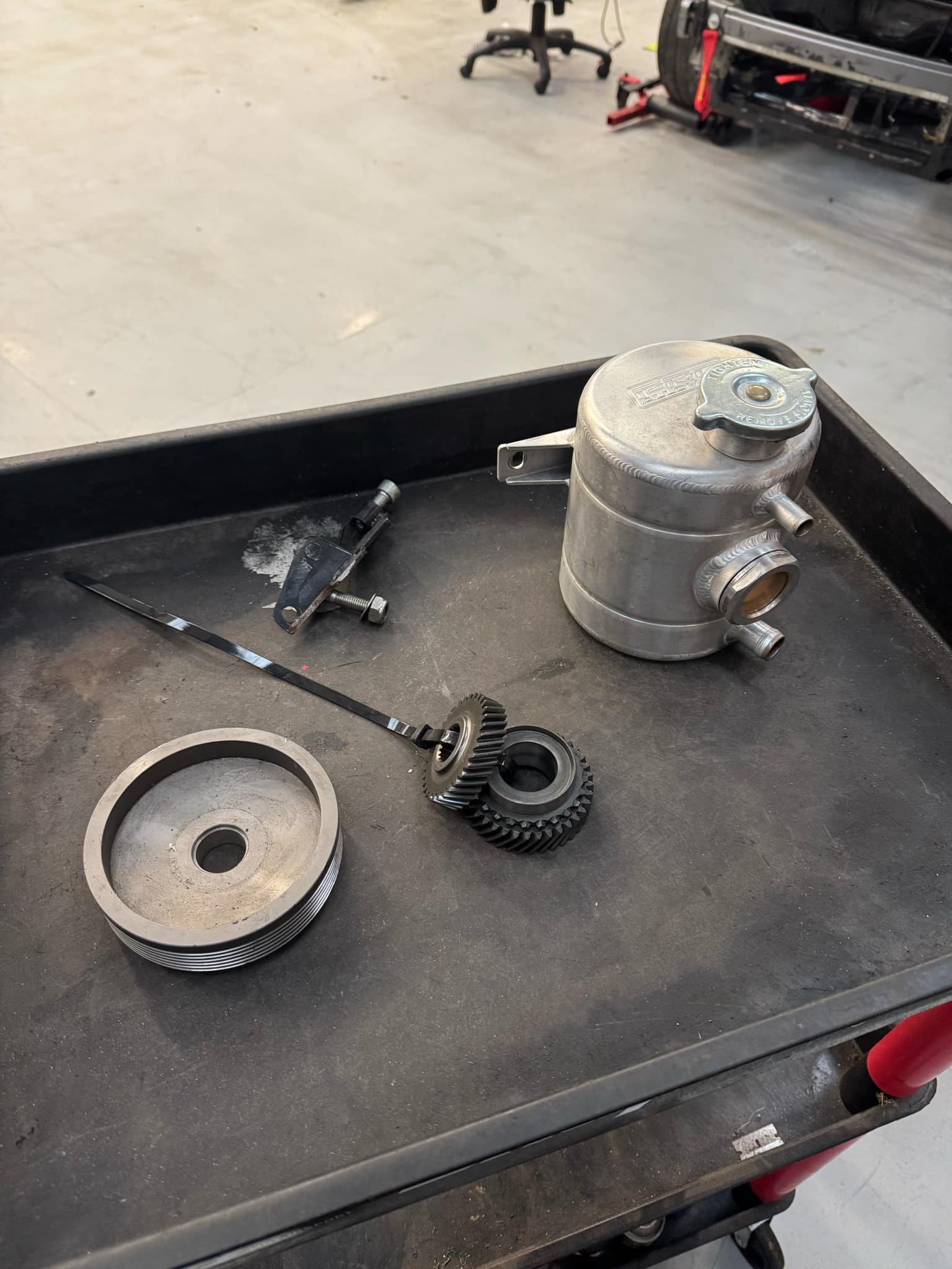

During this, I discovered the box that had been used on the one trackday and 3 laps.. was actually out of a diesel?.. being my first clio i had nothing to compare it to.. other than f**k me this is long geared, having a a short 5th gear set on the side I had wondered why I needed it, not ever getting out of 4th 😂
Very kindly, mr Justin Holloway has lent me a jc5 129 box with a quaife atb diff, while I sort a gripper diff to go in whatever I can at this point, combe lot are great!

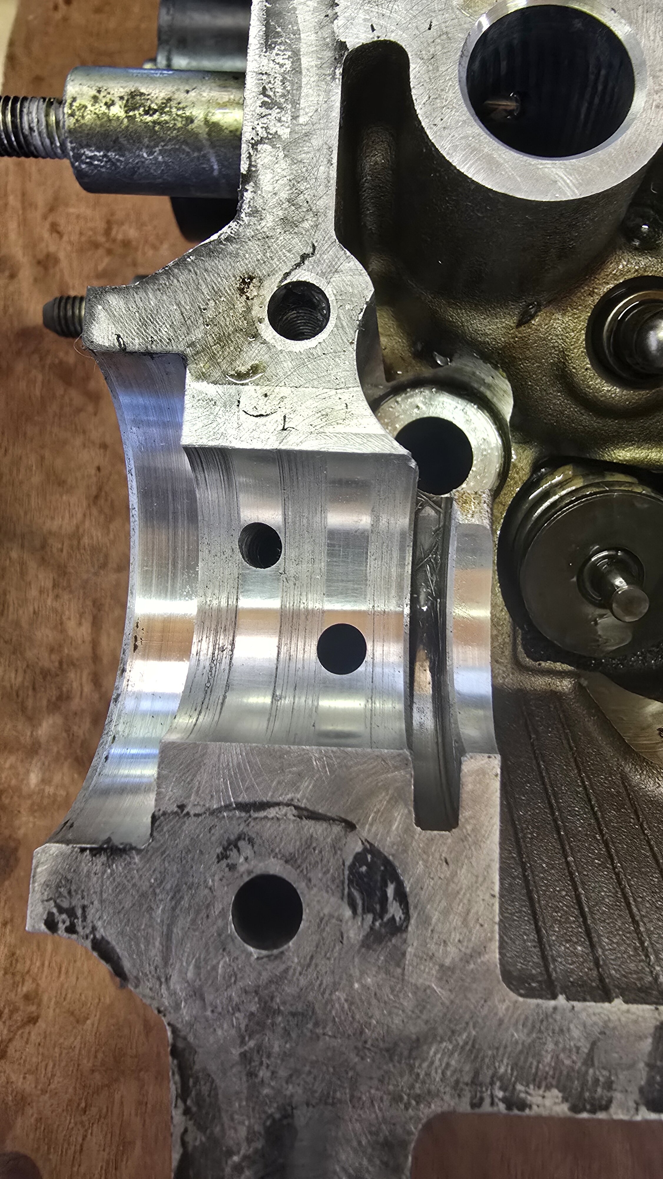

Back to the engine.. me and dad (Greg Parsons) have assembled the new bottom end over the weekend in preparation for the 26th may, unfortunately to find the cylinder head in poor state, likely from oil starvation, next plan of action needed to work out which viable route to take for this!
Sadly, Adam Wilks & Anthony Cooper have had there own personal battles to contend to in the past weeks, we hope to see guys soon back at it!
Less said about the mk3 engines the better.
Thanks to all that have helped thus far, time for (more) pints!"

Sooo.... I had engine trouble, had a weird knock noise that wasn't a knock in the brand new engine, after testing just about everything I pulled the head and sump, gudgeon pin clip was found in the sump.. causing the piston to rock at the top of the stroke, thankfully no damage caused, correct mls gasket now fitted and correct pair of cat cam pulleys and back together but meant I missed yet another round, having a sh*t season! With two rounds to go, mapping on the 19th, wish me luck 😂😂
