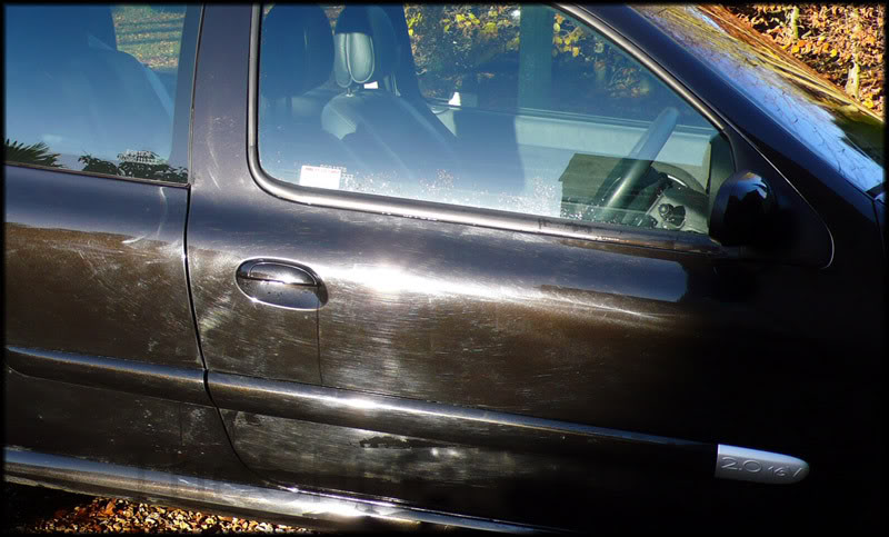

As soon as I saw the car in the early morning sun I knew I was in for a long day. The paint on RS Clios is rock hard. Fortunatly those boys in Dieppe really go to town on the paint and readings of 150 microns are the norm with these cars.
I have detailed more clios than I care to remember but this was the worst and the hardest!! Still isn't 100% perfect could now do with a full detail ;) but not bad for 10 - yes 10 hours on a diminutive car! Megs #83 and IP were 'team tagged' as conditions were changing panel by panel.

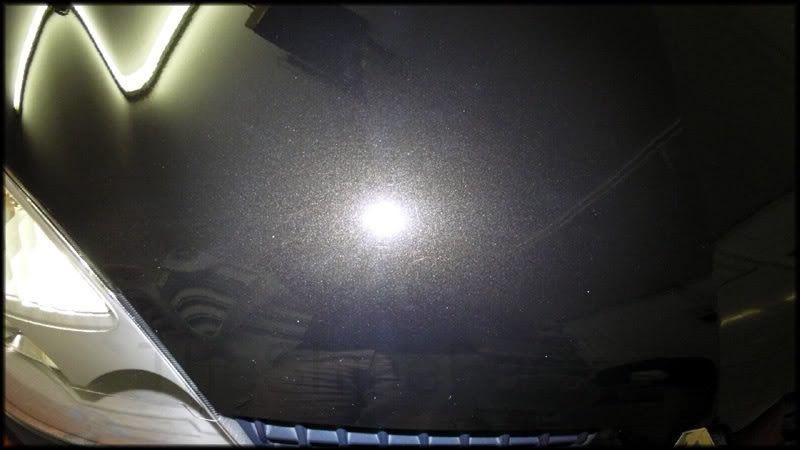

And now the odd bit

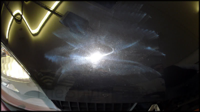

And then under the sun gun in the garage almost a 'flower petal' or star burst holographic swirl effect on the bonnet - have never seen such deep holograms/buffer trails!!

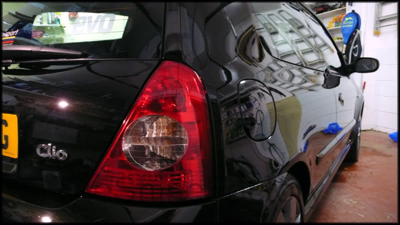

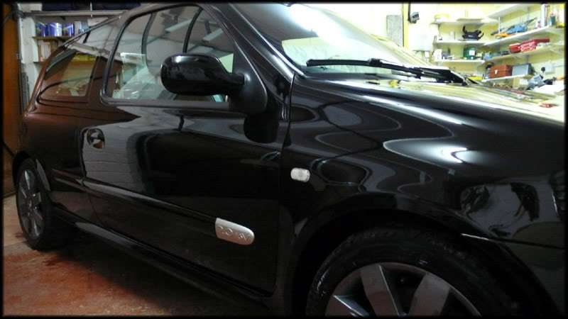

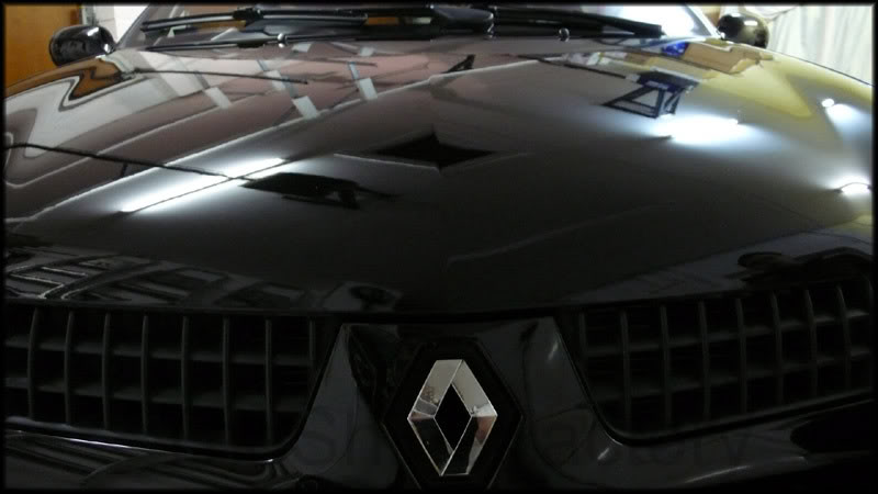

And afterwards
And a few afters in the garage

LoL i thought mine was bad when i bought mine!!!! Trouble with black is it never shows the swirls in dull overcast light. (viewed the car like this) I was horrified when the sun did make an apperance. Safe to say a few days with the PC + IP brought it right back. Well happy with it now.

Crikey those are definately buffer trails! It looks like someone used a fast one speed buffer and a harsh compound. Thats a real example of what a difference to the overall appearance of a car a professional detail can make.

Out of interest, how does your car get those holograms? Mine has a couple? Is it amateur pc'ing gone wrong? Thing is my car is really shiny and has this hologram which I thought meant it had been pc'd at some point in it's life, but then it's covered in swirls still. :S Ah well, I'm getting rid so nevermind, eh?!

Its caused by a number of things mate...
Poor washing/drying technique, poor polish/waxing technique, hand carwash/rotary brush car wash, also if the car has been in a dealer for work they'll usually wash it afterwards with an old gritty sponge..

Just so people know, the hologram on the bonnet was created by Mark, he used his rotary with Megs polish and it initially had that effect, he hadn't seen anything like it before so he took some snaps.
He says the majority of the bad condition would've been due to the use of a carwash from the previous owner and generally poor washing technique.
