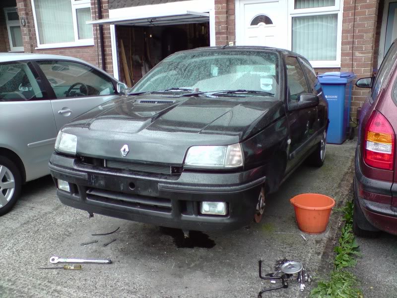

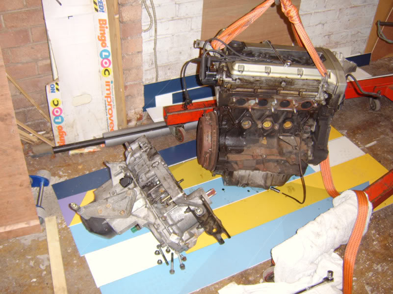

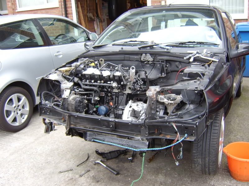

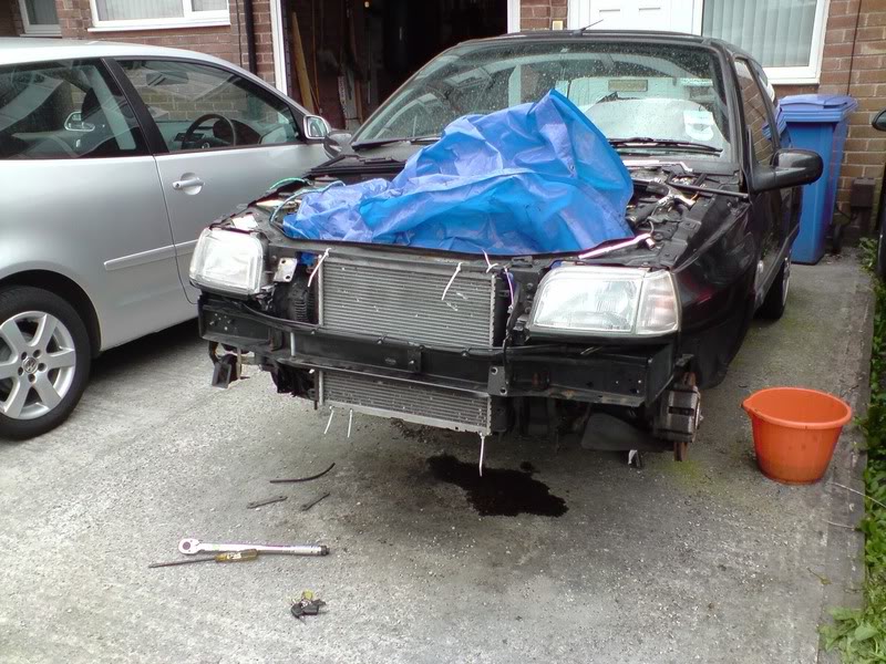

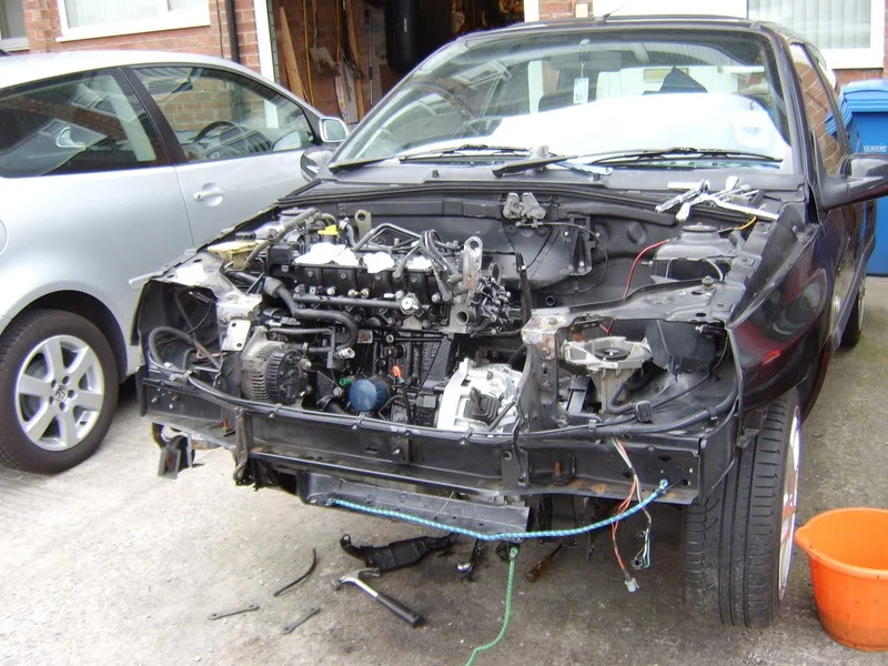

old engine needed to be strip today so i can paint the gearbox and get rid of the valver lump
engine started like this today
firstly split the gearbox

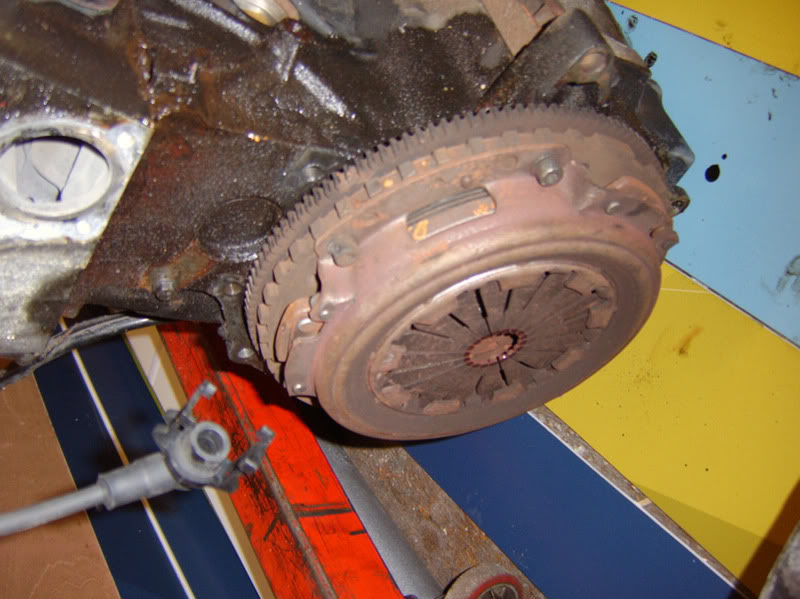

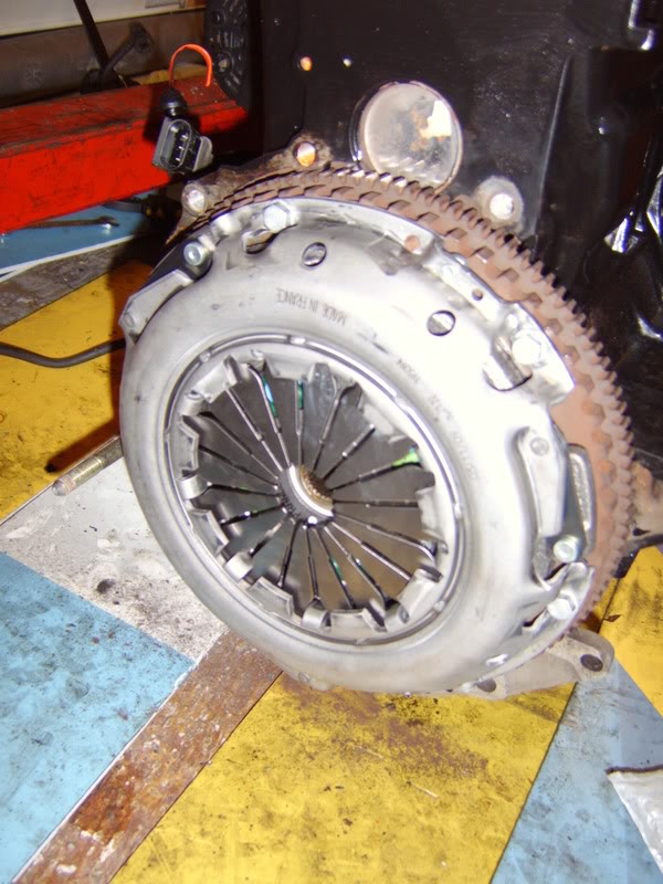

then locked the crank and removed the clutch and flywheel.
the clutch looked in good nick but on the way out it was very thin. i have a feeling it was the still the original
does this look like the original

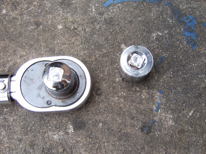

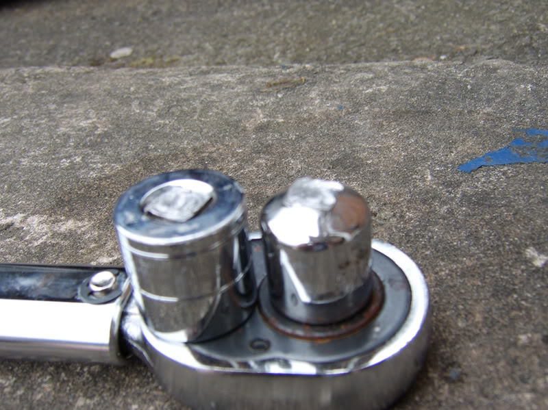

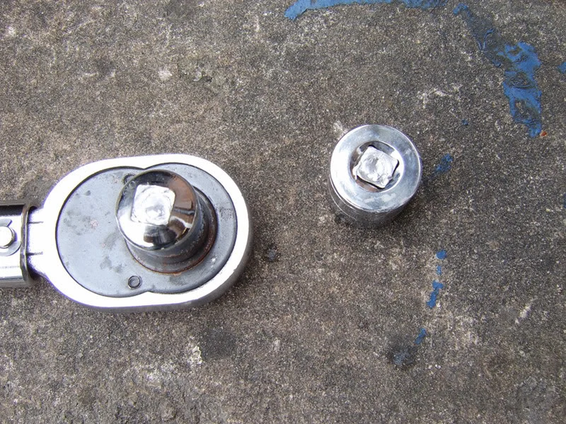

i then went to remove the pully at the bottom. all was going well till bang
managed to snap the reducer. great

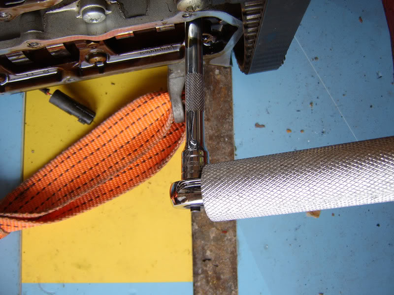

so after a bit of head scratching i remember i had a 19mm 1/2 iinch socket in my new tools. it made short work off it.

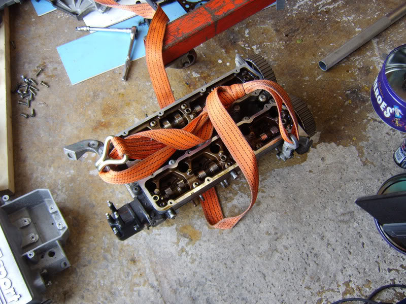

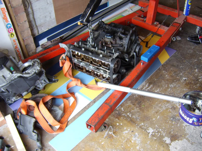

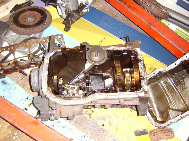

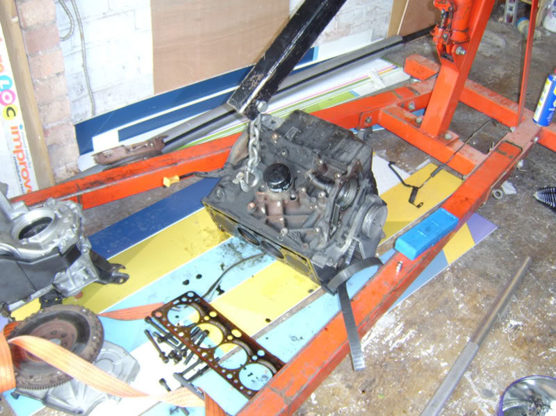

i then lay the engine on its side so i could undo the head bolts.
i firstly tried with my ratchet. the headbolts weren't having any of it and i couldn't use my big wrench because i had snapped the reducer earlier. so out came the big pole. it soon made short work of the headbolts
the head was the finally off
I then set about removing the sump. all was going well to the last two bolts decide to round off. f**king torx bolts.
the were despatched using the dremel. i forgot to take pic of them but i had to truly muller the bolts to get of. it seem to take forever. then the sump popped off freely

more work was done on the lump today to get it ready to go into bay. the lump was suppose to go in on Sunday but Renault in there ultimate wisdom can't count to 6 and only gave me 5 clutch bolts instead of the 6 i paid for and ordered.
I was able to get the clutch bolt till today, so till i had this no more progress could be made.

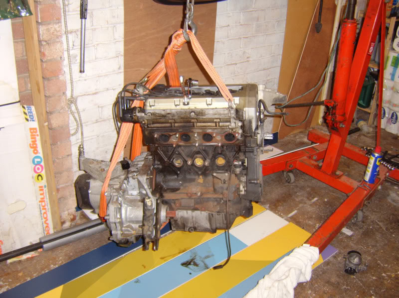

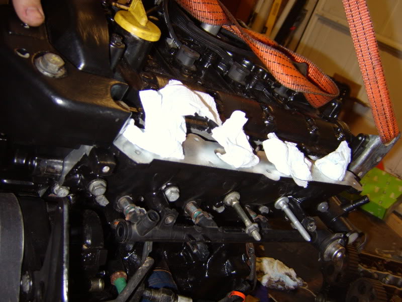

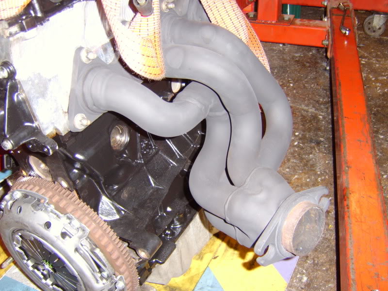

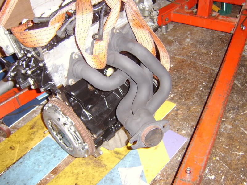

any i finished building up the lump
new valeo clutch(thanks maynard)

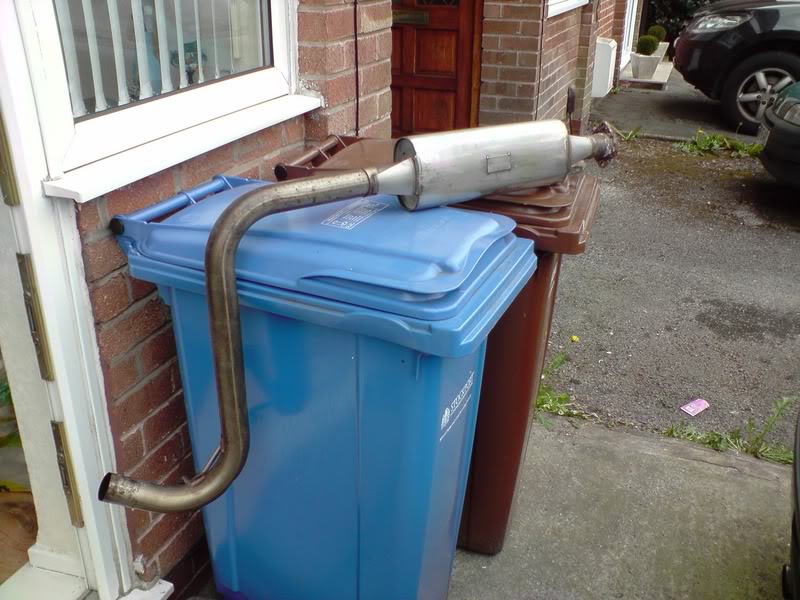

put the exhaust manifold on

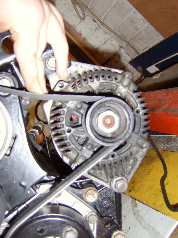

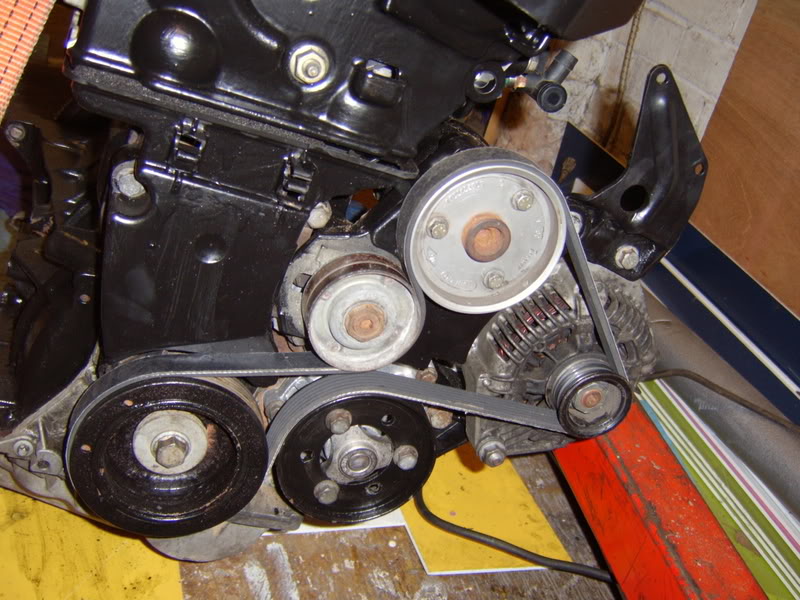

fitted the aux get up

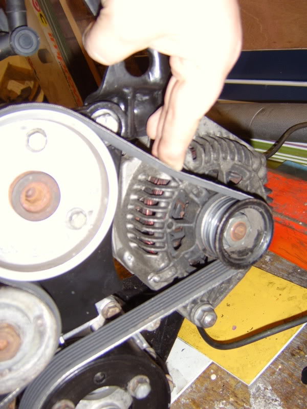

then tensioned it up. is the belt tensioned enough
the tensioner is full done so think i might need to swap to a slightly smaller belt because this one will eventually stretch a little and not be fully tensioned

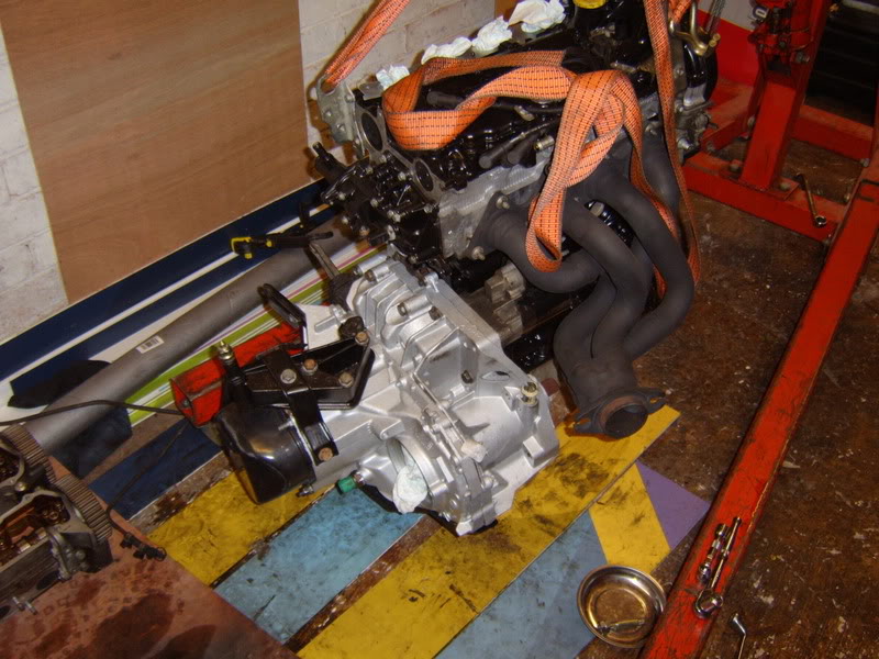

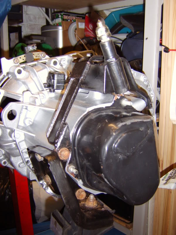

put bottom inlet on

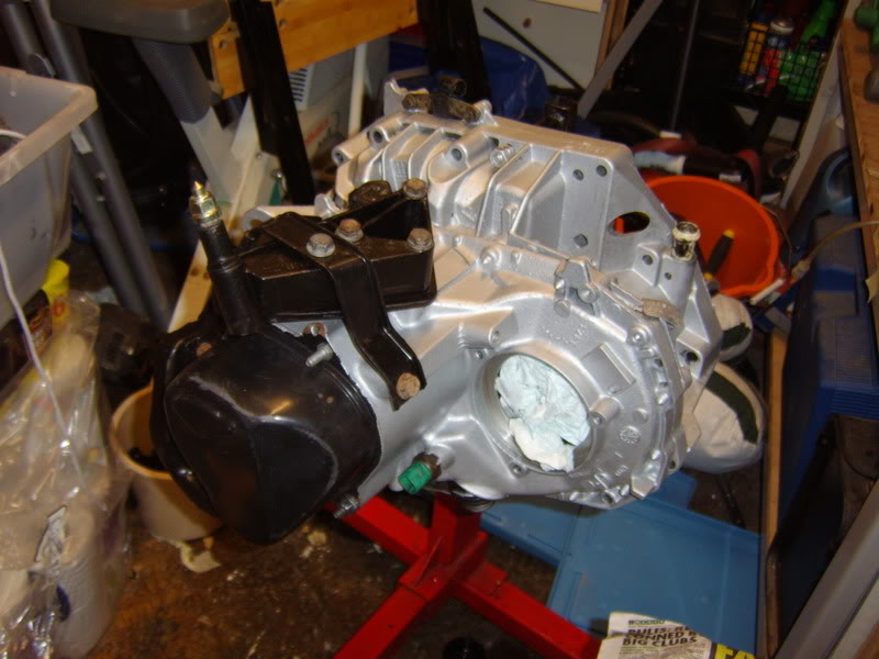

reassembled the gearbox
new willy mount and 4th mount
then reattached the gearbox to the lump
i also need to reattach the dogbone match bracket. i forgot earlier :oops:
the popped the 172 starter on. should have cleaned it up a bit but couldn't be arsed
all being well the lump should go into tomorrow when i get back to from work :D

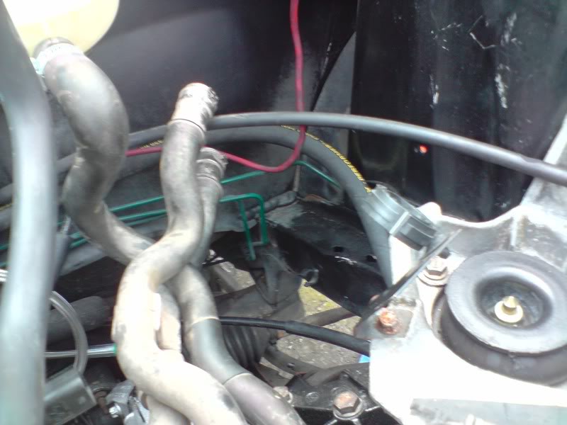

and now seeing it in the bay I'm 99% sure i will not have to modify my steering rack to run the pas will just need new line for every line bah the return to tank.

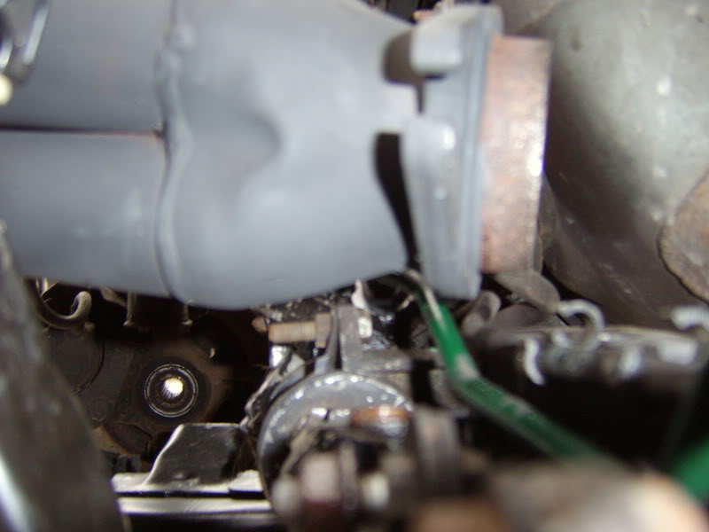

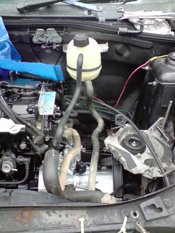

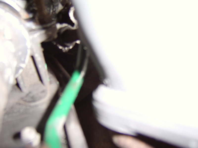

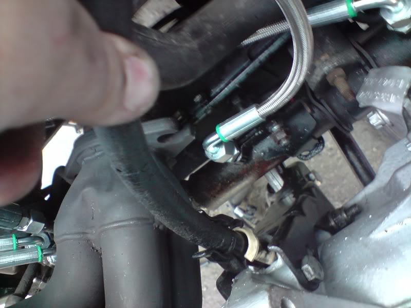

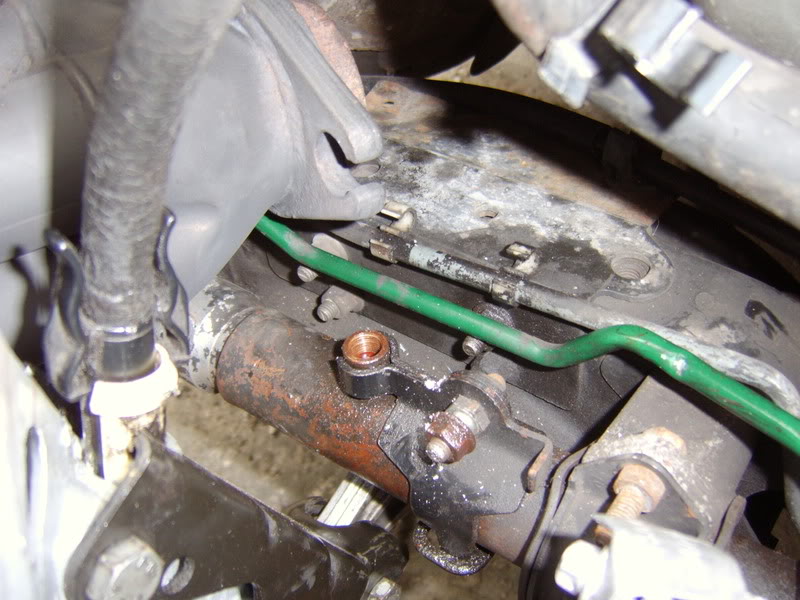

pic of the engine in
and ones just for Matteh

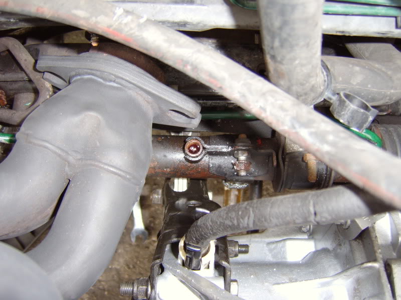

loads of room :p will just need a line that has a 90 on the end like you said, just like you said
as you can see i need to adjust the return line as it is rubbing on the manifold flange.
and one of the original green lines fits but is a bit close in some places but will see how it goes for now. i will most probably replace it to be on the safe side.

oh!
now that is intriguing... wonder why mine isn't like that
could be a phase thing or mine had a new rack at some time. do know really
i think aswell that the other green line might fit also, going to give it a go tomorrow and see if it does fit. if it does only need to replace the main line then

  '92 172, Lotus Elise
looking at my pictures, it seems i have similar space to you
but perhaps if you just run a pipe straight upwards it ends up too close to the manifold
either way, it's tight!
like you say running a line straight up will most probably foul
if the original line doesn't fit I'll spec a line with a 90 end so to run away from the manifold before going up to the bulk head and back to the column

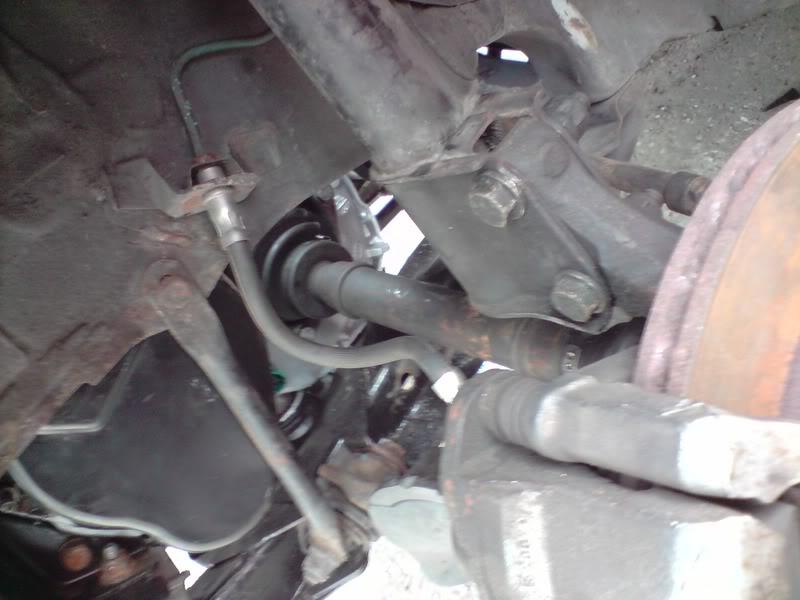

put the passenger drive shaft on
couldn't put the drivers side on because i need to replace the inner cv boot

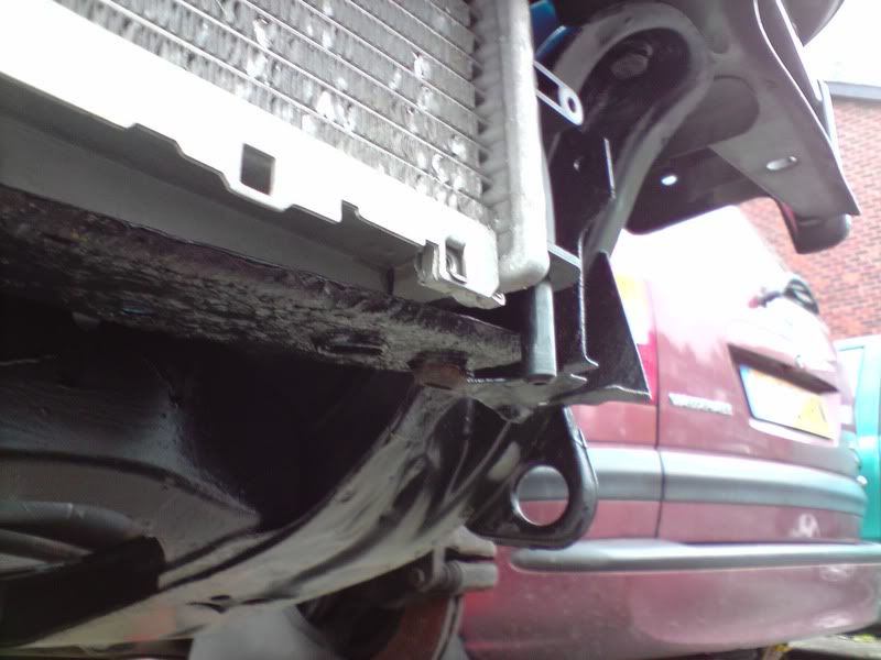

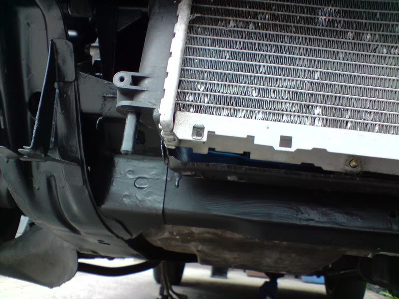

I then put the 172 rad in.
I couldn't get it to fit fully because its to big which i was expecting. but wouldn't locate properly even if in place in at the passenger side and rest resting on the subframe at a angle. So I just rested it on the subframe
the cross member was the put back on and the radiator was cable tied to it and the subframe. it is a bit pikey but it'll do

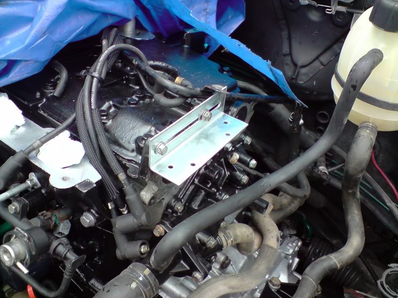

and then start of my coil pack relocation. it'll need a lot of work but should do the job
the bonnet and bumper was put back on and it actually looked like a car for the first time in ages. it also make remember how much i love the look of a valver front end, so aggressive and purposeful
Try and get the bracket a lot lower, im re-doing mine as it means you have to turn the TPS upside down which isnt ideal as it fouls on the bonnet :(
Thats what i thought it would be a bit high. i'll have another scan round the garage and see if there is any more suitable brackets to start with.

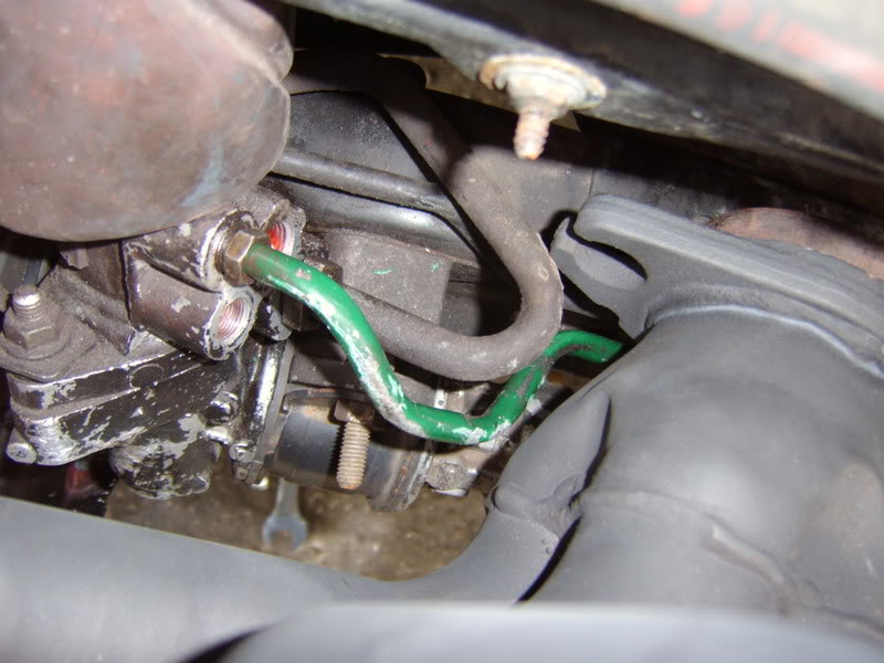

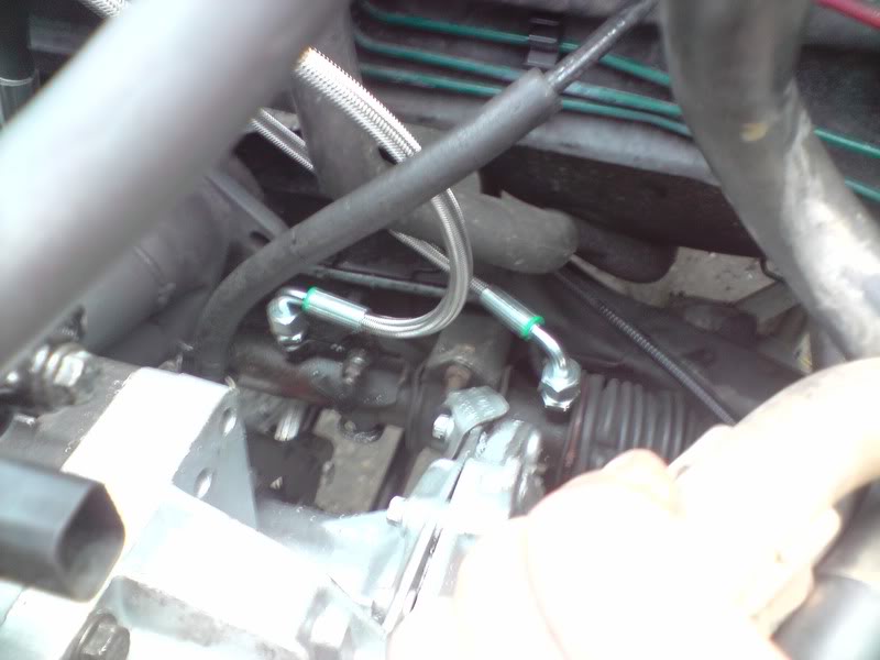

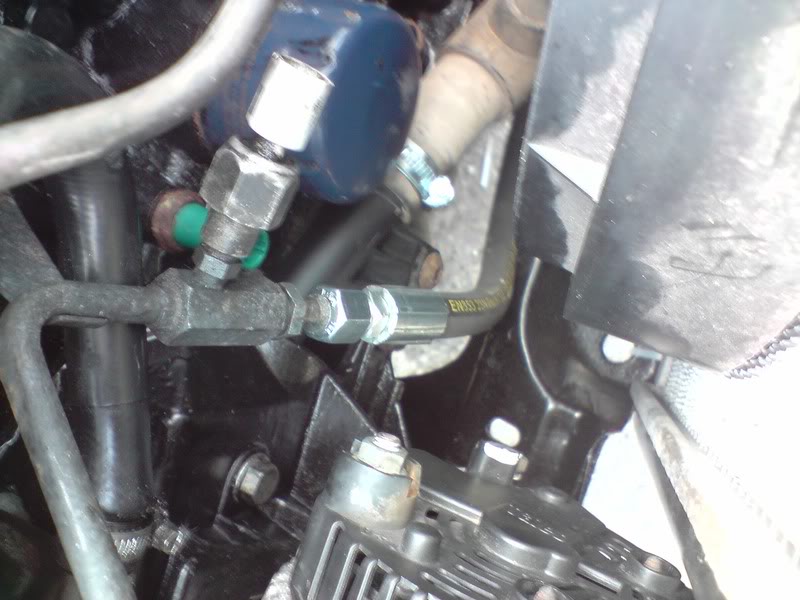

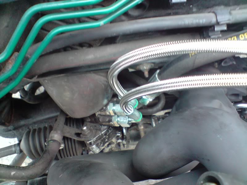

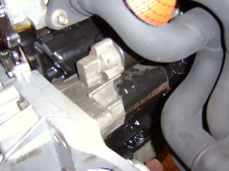

my custom line have just arrived for the pas and like a kid on christmas, i ripped them open and set about fitting them.
all went in with relative ease and both the lines for the rack and the new line for rack to pump.
any here the pics of them in
sorry for the rubbish pics, like said early i put them on quickly and only had phone on me

also does anyone know of a way to protect the braided lines so that they don't rub threw anything/less prone to
When i used to have my oil cooler fitted, I got some rubber pipe of slightly larger ID, cut it open and wrapped it around. Just where it might touch other stuff.
thanks i'll sort that out in during the week

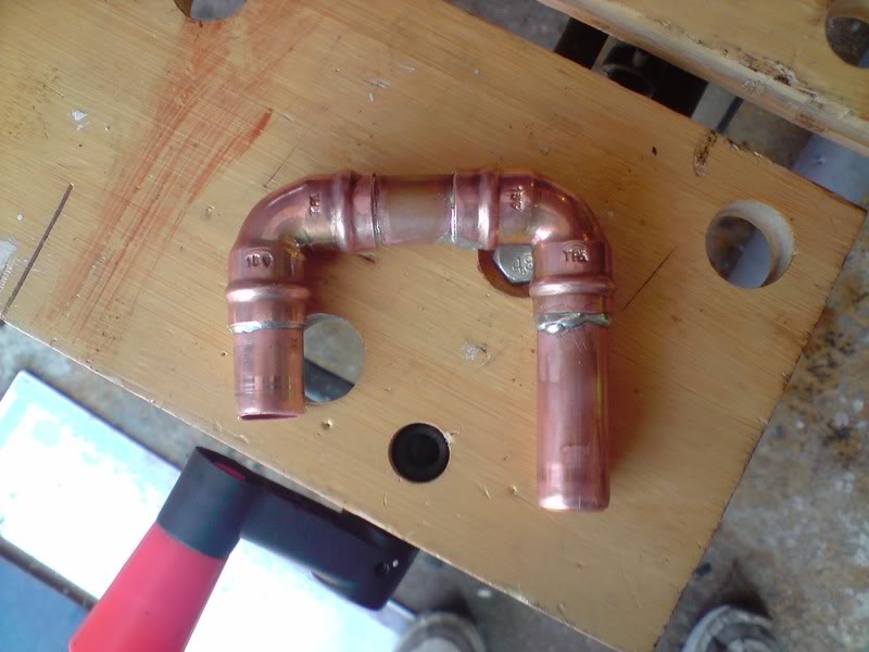

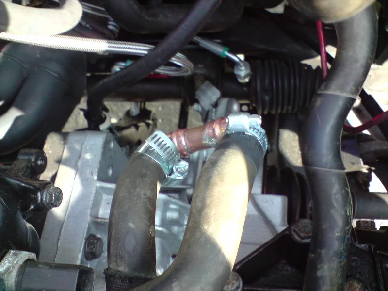

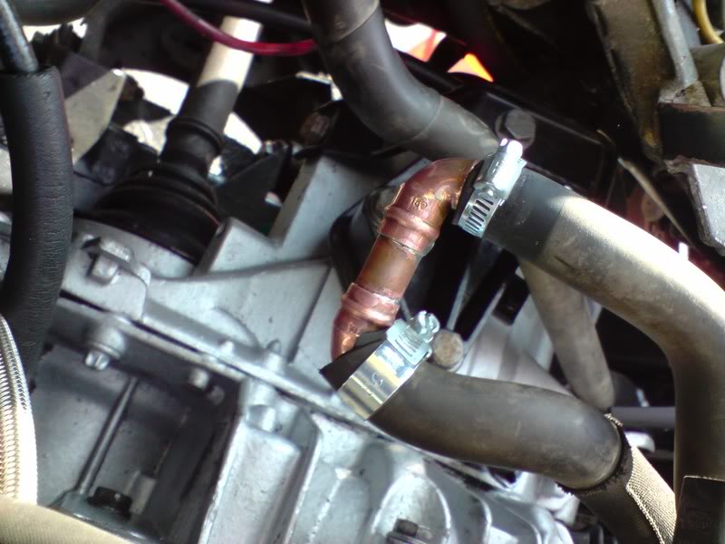

whilst checking my hose the other day i noticed one had split in a place that wasn't repairable. so my plans of finishing the connections so i could run with a heater were put on hold till i sort new hoses out(may get some fancy ones).
so for now so i can get the car back on the road a bodge was needed. out came the plumbing gear.
then put on the hose's
hopefully they'll do the job as temp fix till i find another solution.
wilky19
  Leon FR 184
yeah the hose i bought had split in a place that was not repairable at all. i did want to have a working heater but s**t happens, i'll just have to fix them before winter.
