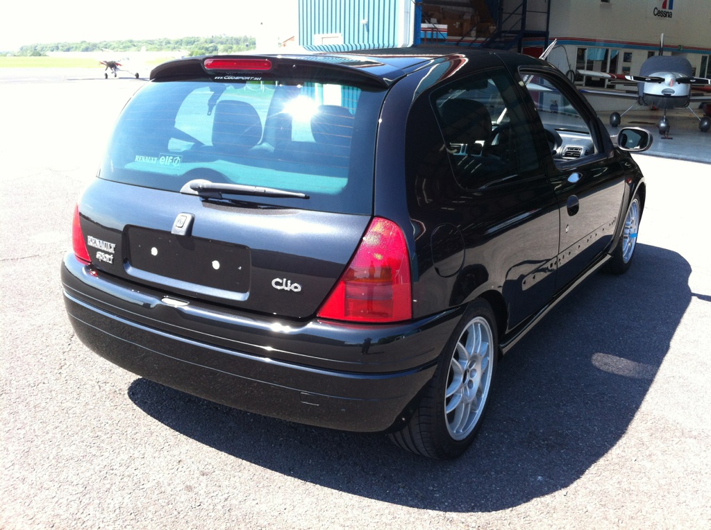

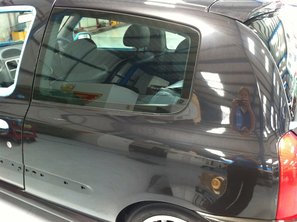

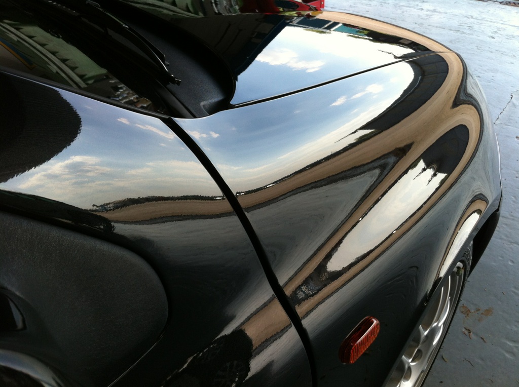

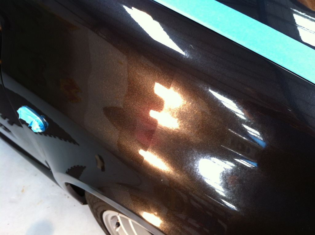

Hey guys, just a few pics from a long hard weekend on Couzens ph1. She was dropped off to me friday eve (late! :rasp:) So I got her washed, the usual iron x & clayed (not needed really, we did her not so long ago)
The paint work required a little attention shall we say ;)
Pics! No particular order

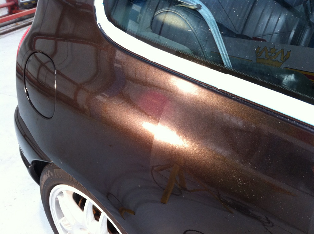

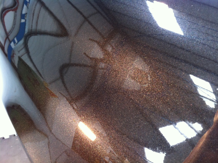

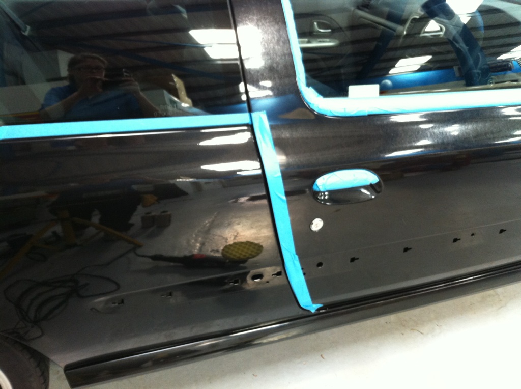

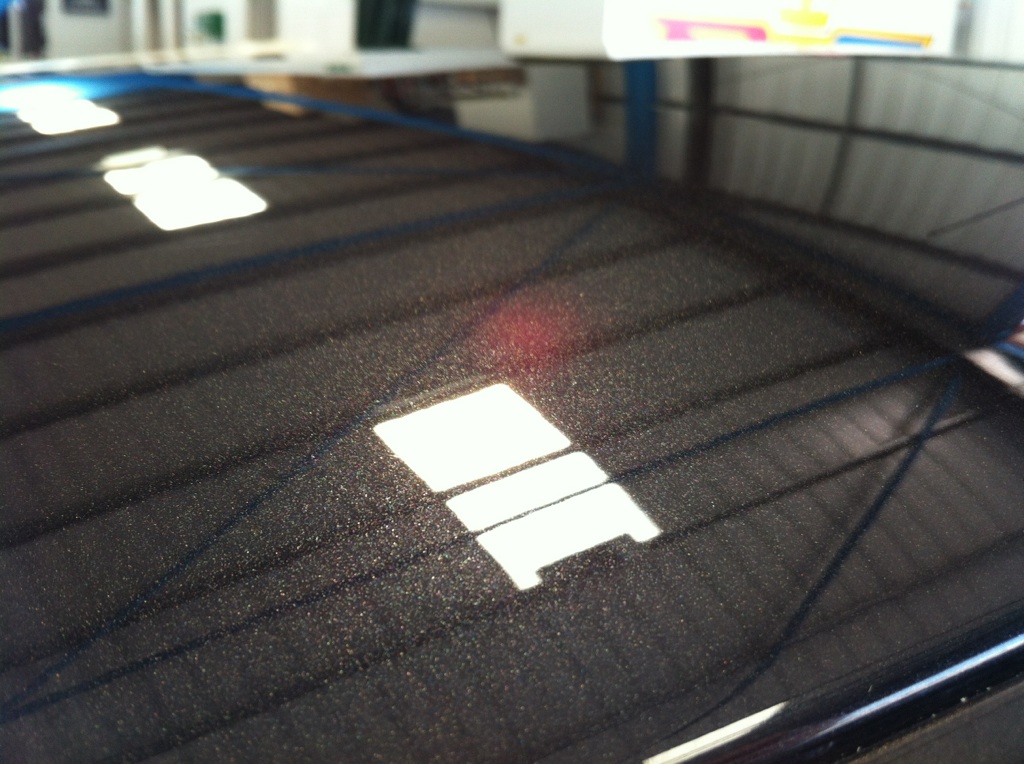

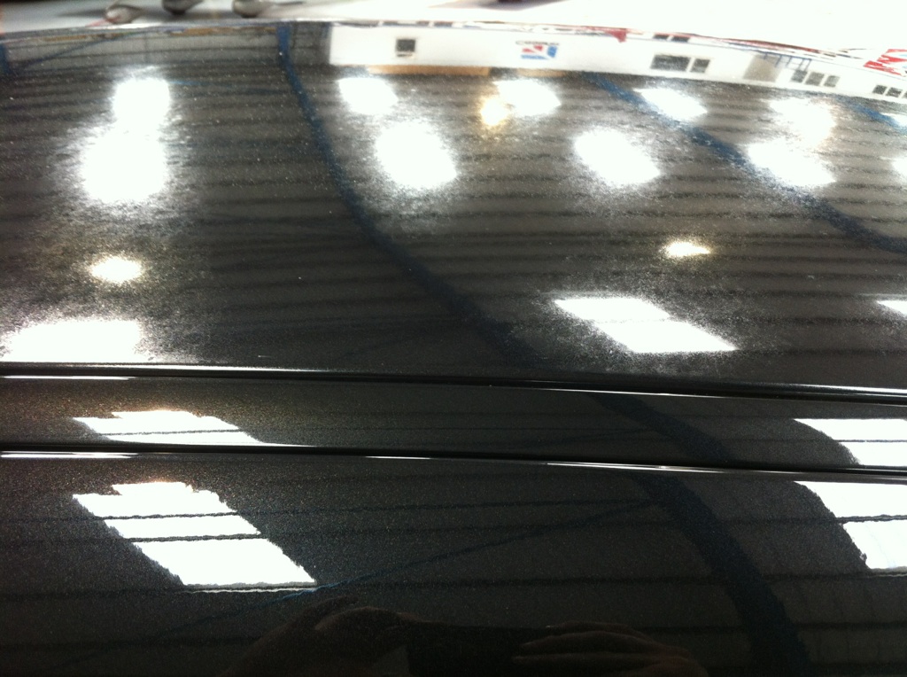

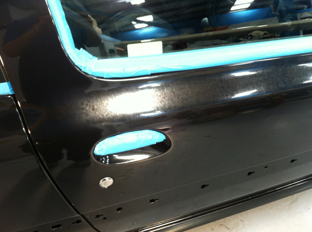

So I went around the car with megs 105 with 3m green & yellow pads. Some area's weren't as bad. Once I was happy I then refined with megs 205 on a 3m blue pad. I left the dredded bit till last! The roof!

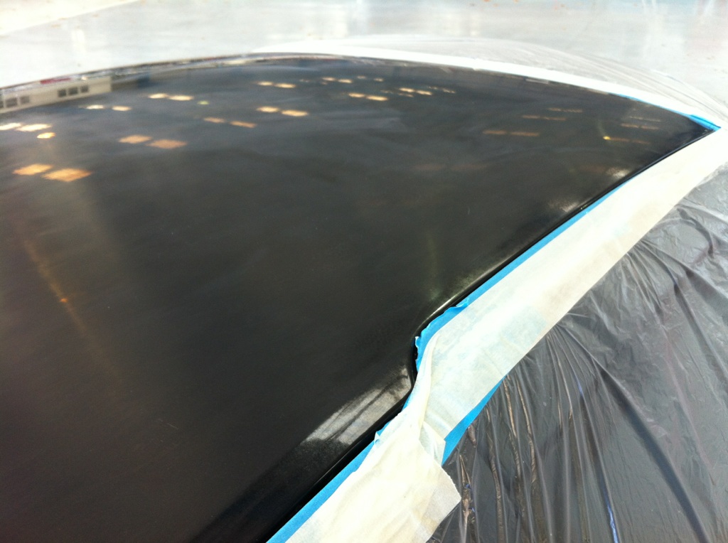

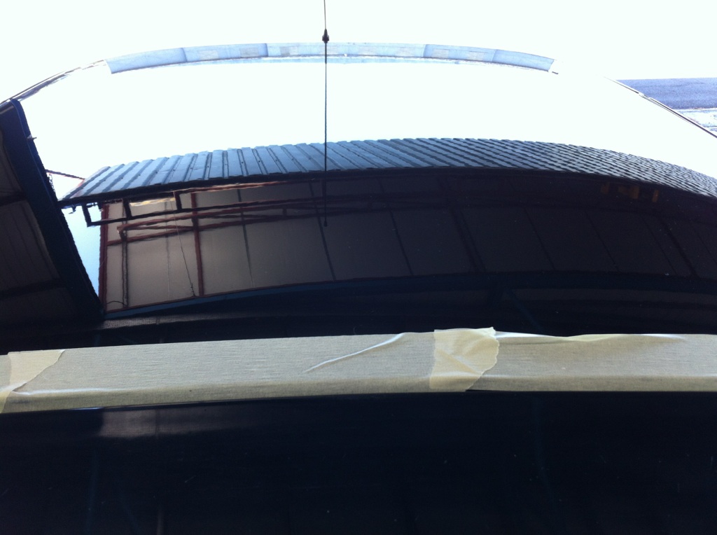

So, with 105 on the 3m green pad not touching it I had no choice. I had to wetsand the entire roof! First time I've ever wetsanded a car before!

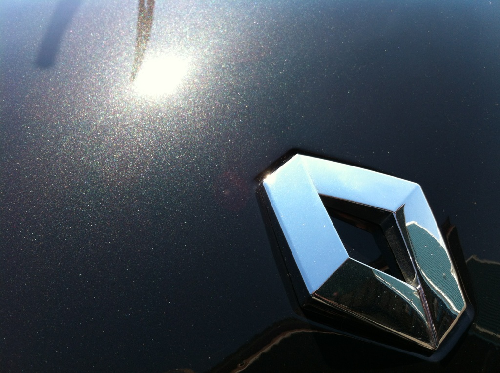

So, on with the dredded sanding. 2000,2500 then 3000. Buffed back up. :)

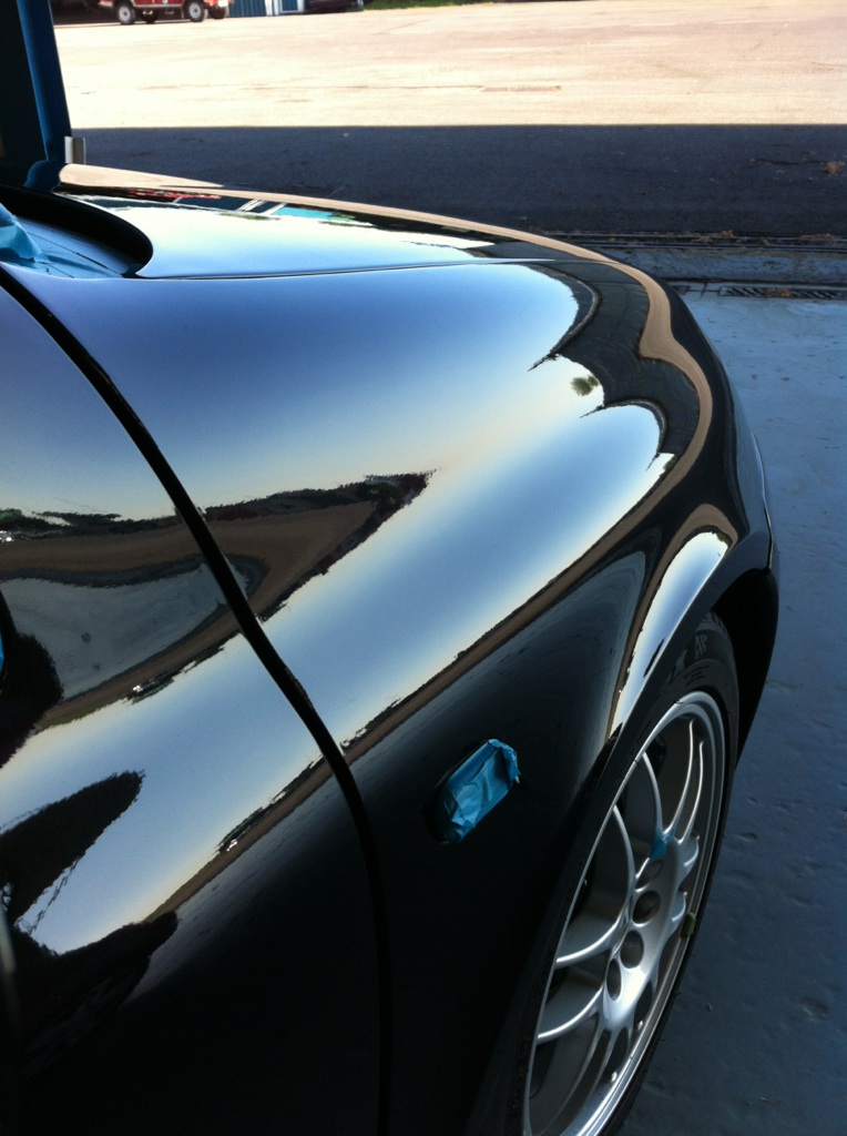

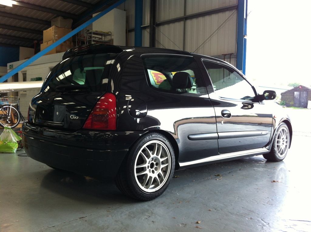

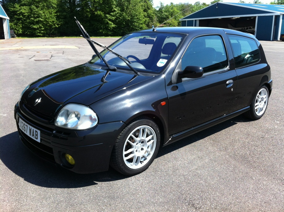

Once that was done I proceeded with the rest of the car, shuts, under bonnet. Black max glaz was applied twice by hand, qd wipe down & applied Vintage. I wish I had another day though, still need to wet sand the headlights.
Cheers :)

cheers guys, friday eve i did 3 hours, saturday I started at 7.40 till 7pm (1 hour lunch to feed my kitty) & sunday I started at 9.30 & finished at 4.40!
