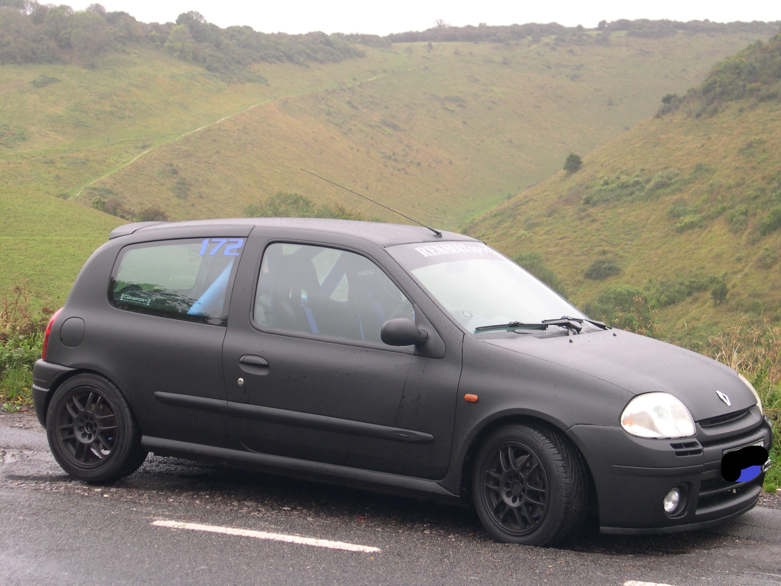

Spent about 14hrs doing this last weekend
3 hrs removing decals
4 hrs cleaning and masking everything up/ removing some stuff
6hrs spraying (2 coats roughly every hour)
1 hour removing masking and replacing some parts
I love it, looks nice and mean, and good coverage in 99% of car, and everyone else seems to like
Not sure how it will wear, but intend to change colour every year or so- yellow or orange next up
And it looks even better in real life (Was Iceberg)

Not fan, looks like a decent job though!
chris blue
  172 Ph1 2001
That looks awesome. I'm wondering what matt AG would look like now :D
The matt is really nice effect- even better the colour can be changed pretty easy every year.
I really enjoyed doing it too, except removing 3 yr old decals with a hairdryer.....
Cleaning and prep is key

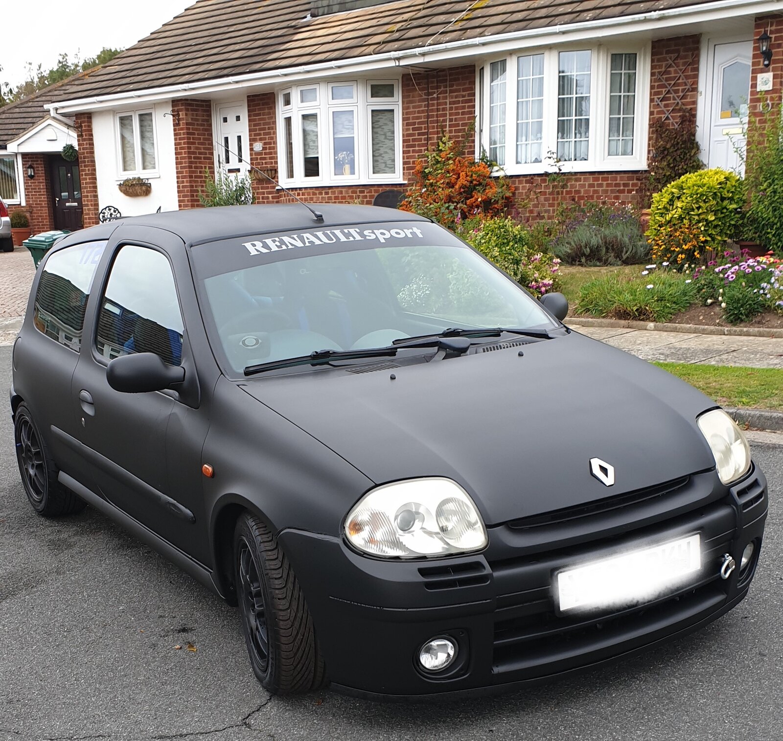

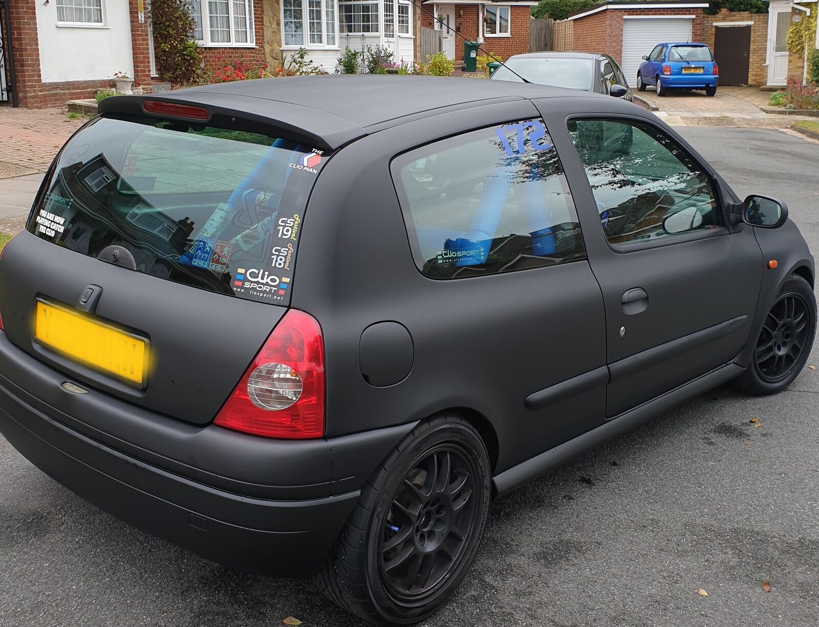

Couple things to comment on since car was sparyed up over 6 weeks ago: The paintwork looked like it gets sort of "bruised" for a couple of weeks after, when touching or brushing past it, but some bruising can be brushed/wiped away, and other bruising can be sprayed with a light coating of aerosol. No major problems. After the 6 weeks the whole paintwork seems to have settled down, sort of flattened out even and looks even more matt than before- which is great
It seems to be holding up well on the peeleable away front. No sort of movement there.
I havent had the balls to wash it yet, bcos other than paying £10 pluse postage for the proper stuff, am a bit nervous to wash it with washing up liquid (Which is the recommendation) in case it gets ballsed up. not sure how to dry, cos of rough surface, other than dabbing with microfibre
Finally, i love the BLACK but I cant help planning my next colour change - also bcos i liked doing the work. But then I may regret moving away from Black. LOL.
