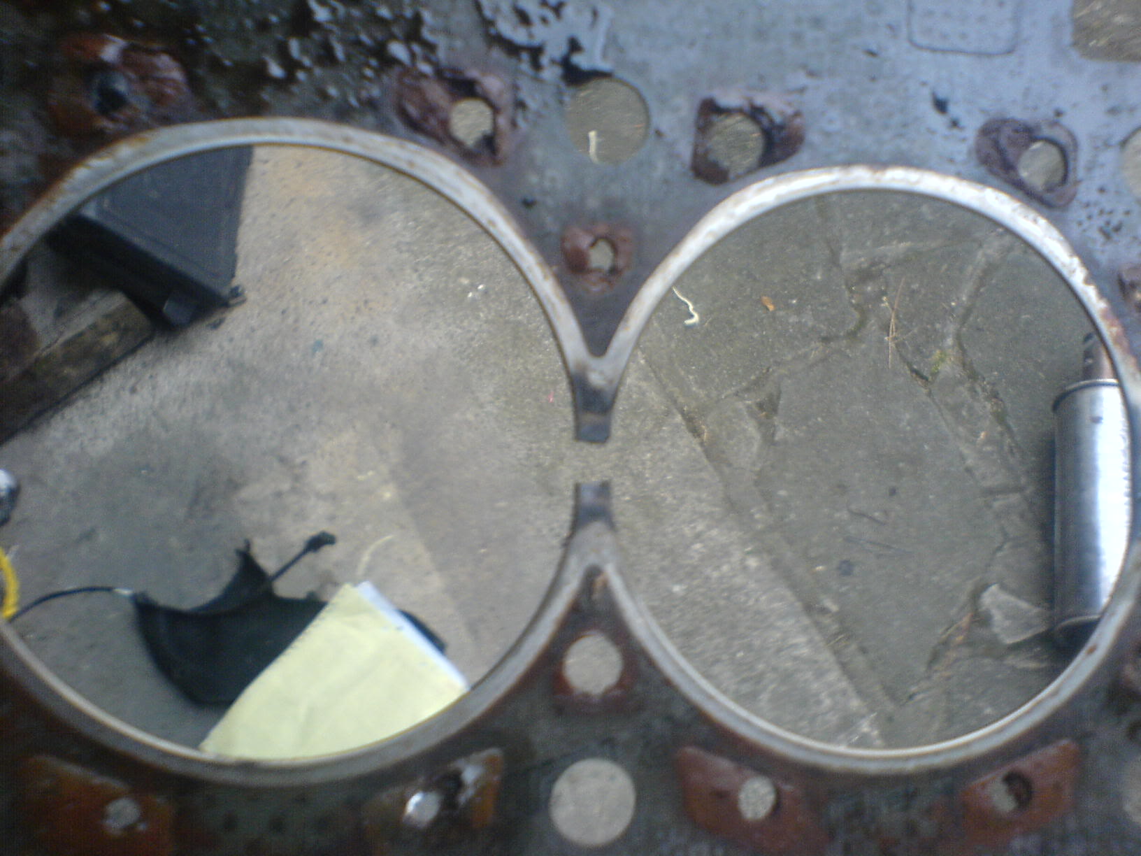

mine completley fucked the head and block.
where it had blown the 600cc gas burn holes where it jumped the cylinders
