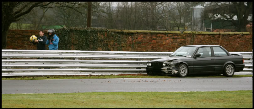

Had some time to strip it down for a few hours earlier today.... and I was hoping it would be a scratch! Unfortunately not..
About the only thing on the front end thats still solid (thankfully) is the intercooler. Suspension/wishbone/brakes are all OK too. Radiator has twisted/split and the bumpers/panels are scrap too obviously..
Luckily when I was putting the engine in I took measurements of the distance between the chassis legs from both front and back of the engine bay. The first thing i measured was the difference in the front which was obviously going to be quite a bit... measured the back hoping for there to be no difference but it was approx 20mm narrower.
The steering was very notchy when we moved it after the crash and kept sticking, I thought it may have been the rack but it wasnt..
Its the steering linkage touching the downpipe, which means the lower subframe (that the engine sits on/rack bolts to) has moved... I could fit my hand between the linkage/downpipe beforehand.
After looking at the other side where the alternator is near the chassis leg it seems the engine has moved slightly (well, the lower subframe). But the main problem is the difference in measurements between the two chassis legs, the side that hit seems to have moved all along and took the inner wing/strut/lower subframe with it. Now if it was just the front section of the chassis leg it would be a relatively simple fix I guess, but replacing the whole leg means going from the bulkhead.
The upper crossmember has only deformed on the side that hit, the middle and other side have retained their shape. The lower crossmember that the radiator sits on has moved all the way along and would need replacing from the other side across to the side that hit. Obviously its fixable, anything is, but I dont want to be cutting chassis leg/inner wing/strut/ off all the way up to the bulkhead, its just not cost effective at all.
