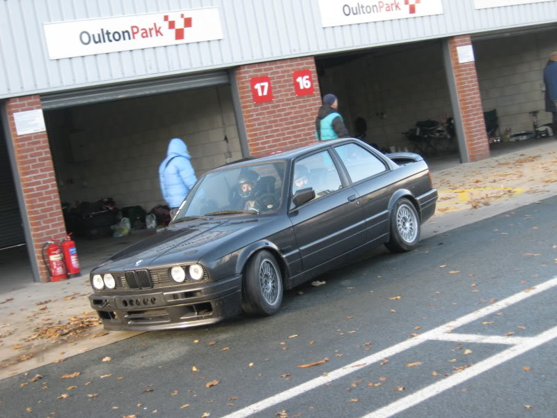

Haha a pet dog could have drove a faster lap. It wasn't holding boost, pissing about with it all day, never got a decent session in really! Il update this properly later
Bit of a summary about what happened at Oulton then..
I had the exhaust made on Friday - I wanted it 3inch all the way back and not boomy/loud. Ended up putting a 100cell sports cat (that I already had) up front with a backbox, then just a 3" straight tip. Whole thing was TIG'd, really nice job, happy with the sound too. You can see it in the previous posts.

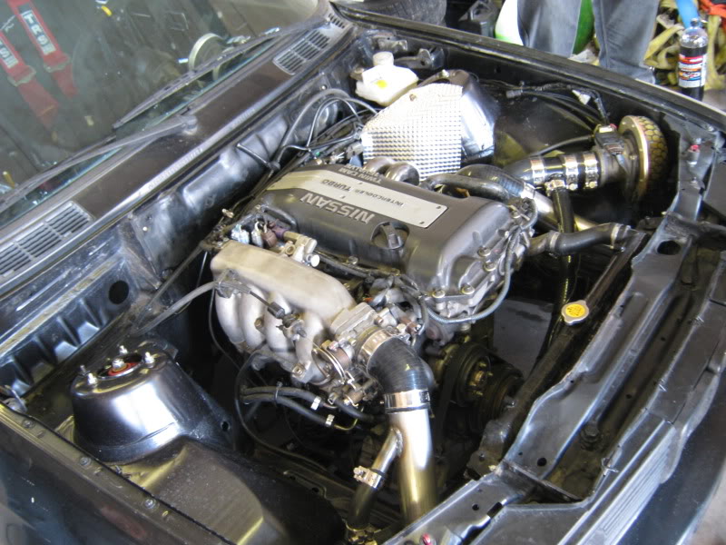

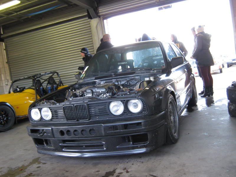

Arrived at Oulton on the Saturday, all was well. Took it out on the sighting laps and it certainly spins the rear wheels up very easily when the boost comes in (only stock at the moment!). Anyway, after a few laps I started giving it a bit more throttle (plus there was a dry line by this point), but it just didnt want to boost past 4000rpm, it was like the engine didn't want to rev, or the turbo was dropping all the boost.
Everything else felt OK, suspension is really nice, turn in is good despite not even being set up fully yet, brakes are good too. After a lot of messing around with boost pipes, checking if the actuator was OK, running it without a boost controller, running it without a recirc valve, checking all the vacuum hoses, it still didnt want to rev up when put under load. I originally thought it could be fuel (before checking any of that stuff), but ended up thinking it wasn't after testing it at the rail and it seemed to have good pressure. You could rev it up to 7k when stationary, just would not pass around 4000rpm once moving, and it had very little power.
After testing all the above and it making no difference, I decided to remove the pump from the tank and try it in a bucket of fuel. When it was inside the tank it was very loud (high pitched) but I thought that was just how it was (Walbro 255 from an S14a). After running it in the bucket it was silent, which kind of pointed towards this being the problem. I removed the filter from the bottom of the pump and it was full of sh*t - I think it had been sat on the bottom of the tank and the pump was just sucking against the bottom, not getting enough fuel - hence not being able to rev up under load. You could put as much throttle as you wanted on but the revs would not change.
By this point it was nearly 4pm, so I decided to re-fit it into the tank without its filter as a test. Started it up and the pump was near enough silent, engine ran smoother too. Turns out that damn fuel pump was more than likely the cause of the whole days issues. Oh well!

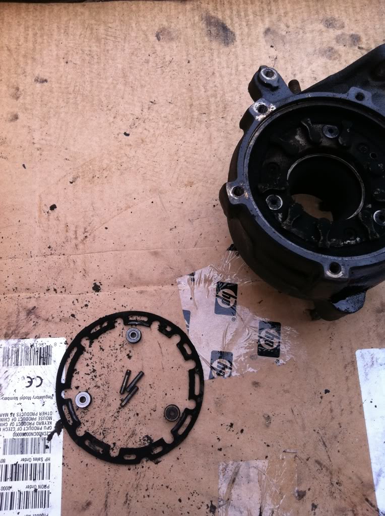

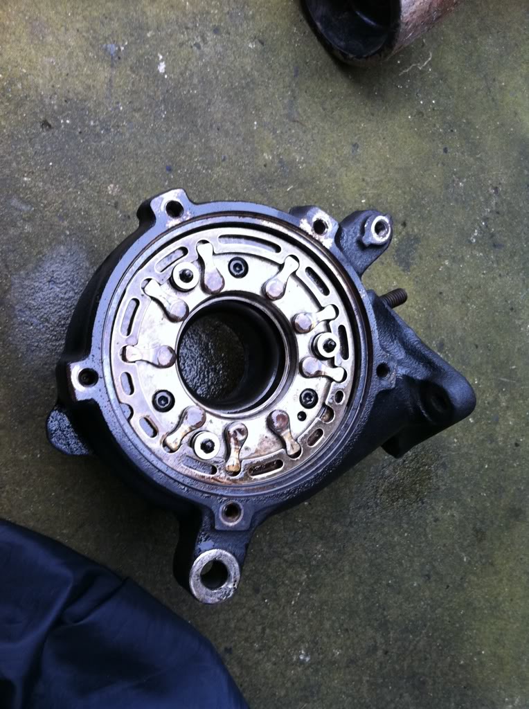

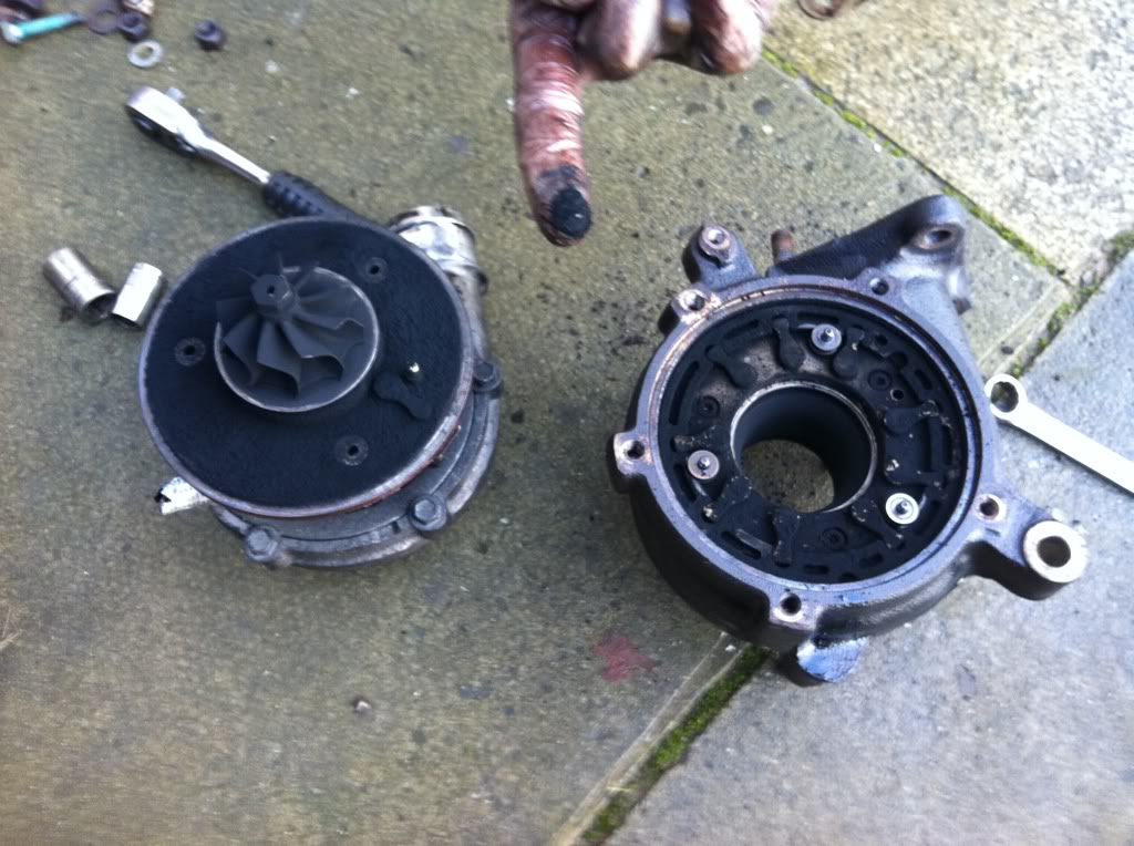

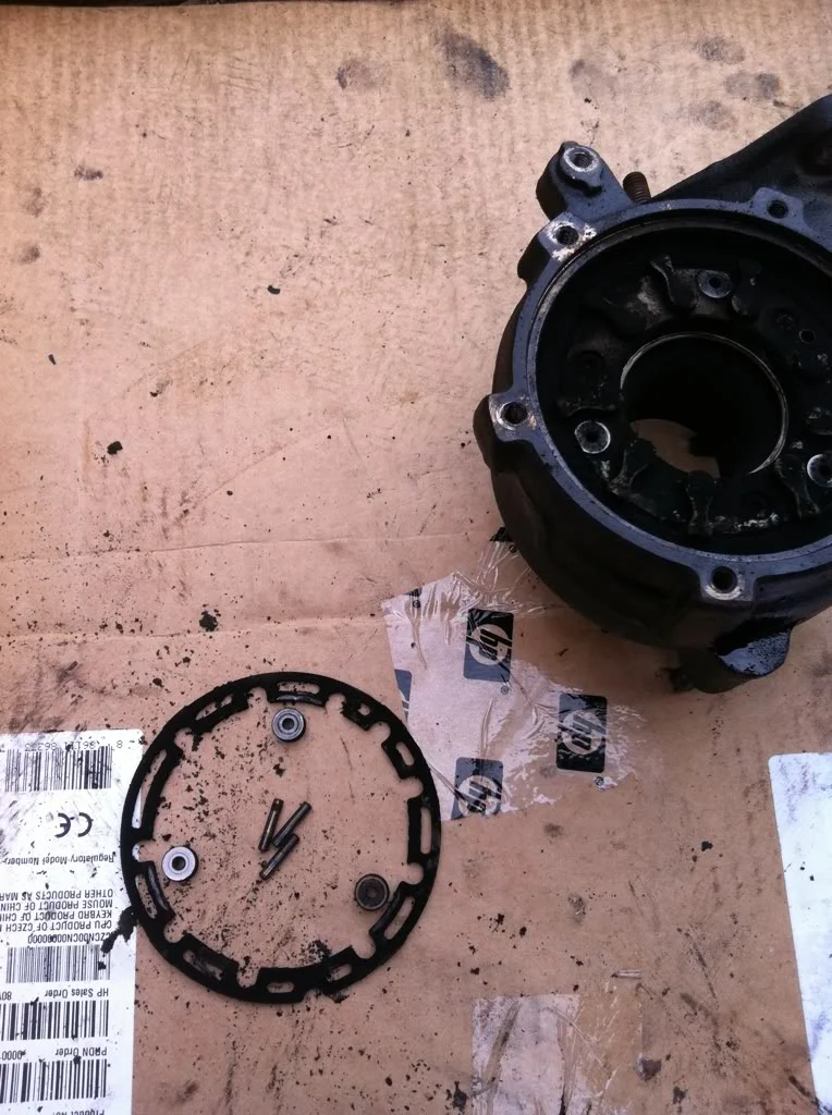

(un)Related post, finally got round to servicing the Passat I use to tow stuff around with today. New filters/oil/coolant/thermostat/blah and more importantly a turbo stripdown. I keep having limp mode issues under load (common with the TDi apparently on higher milage) - where it will drop all boost and run like an N/A diesel with no power. It had been getting worse over the past 6 months doing it more often - I had already replaced a lot of vacuum piping, boost solenoid, and a few other bits to no avail - the only thing left was the turbo's wastegate system getting jammed.
They use an VNT turbo, not the usual type of wastegate, some over-complicated variable vein effort which tend to clog up with soot (especially over 200k!) and stop moving freely, so the turbo sticks at high boost, the ECU panics and throws it into limp mode. Took the turbo off and split the exh. housing...
Plenty of thick baked on soot from the past 11 years/220k miles. A lot of the veins were sticking like f*ck and would hardly move. Stipped it apart and got some pretty strong cleaner on there, which brought it up very well.
The rest of the turbo seemed well, no play in the bearing etc - you could spin the whole VNT mechanism with the lightest touch once back on - so put it all back together and it should be fine for many years to come. Time for me to get something else after the new year though!

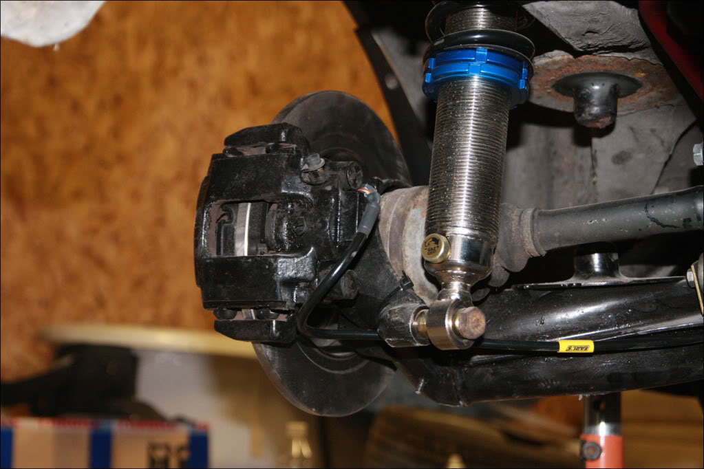

It'll be high tensile, easily man enough. Looks no bigger than any normal strut bolt on a RWD car.
You have the confidence of a man who's never broken or bent a damper bolt. Note that it's designed to hold a soft road damper, it's now holding up the back of car. You may well be right in your confidence, me, I'd brace it.

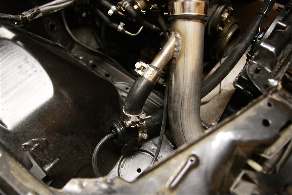

quick question: is the recirc valve installed correctly? or can it be installed in any position?
710N recirc fitted and tidied up..
i've been searching for some info about this valve as i need to replace one on a R21 Turbo and the 710N is identical to the stock one (at least externally) and i remembered that i've had seen one here but i also noticed that it's installed differently.
on the R21T stock setup, the pipe from the boost side is connected to the bottom of the valve and not the side.
should i stick to the stock configuration when installing the 710N and if the boost pressure forces the valve open, install it the other way?
I wasn't 100% sure either, but after looking around on the internet for pictures/a breakdown how it works I fitted it the same as it would be on a VAG 1.8T. It certainly works the way it is now when driven/revved up, only lets the excess boost through when off the throttle (on vac) as it should...

Andy/Gaz, its something I have read about on the E30 forum and it could be a wise idea to brace it somehow. People suggest bracing the ARB mounts on the rear arms also if using polybushes/or/thicker ARB, im using both so that might be a good idea too. Going to get it back out to check the fuel pump issue is sorted, then probably pop the wishbones off and modify them. Once im happy that they are right Il drop them off at the powdercoaters :)
