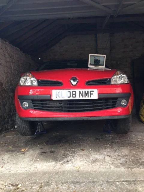

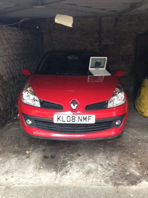

havent posted on here in a while but starting to subtly modify the mk3.

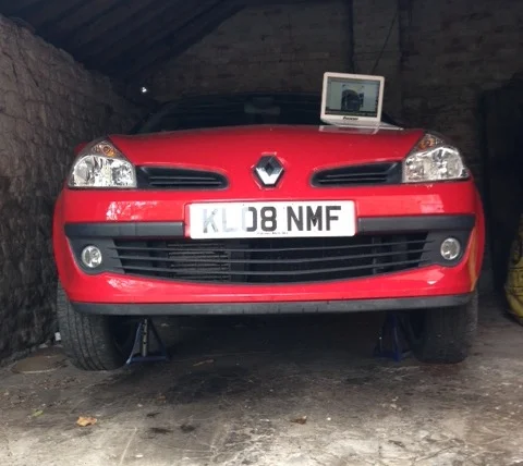

started yesterday morning on axel stands

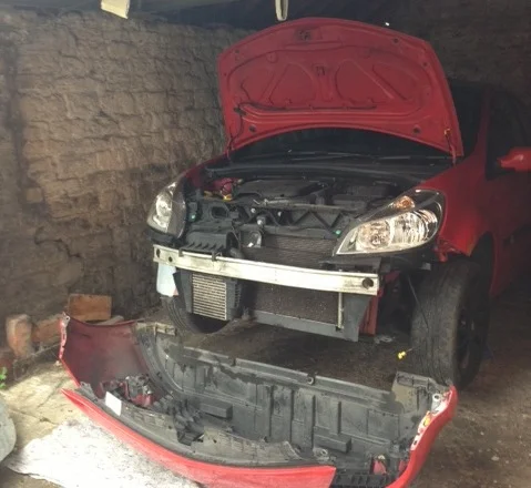

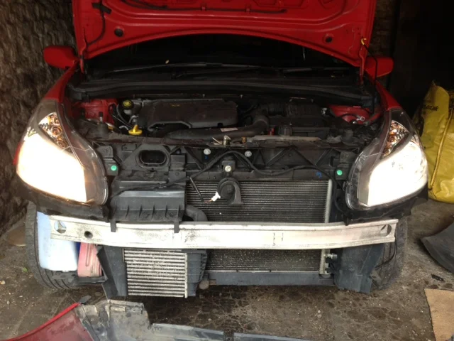

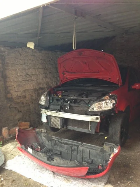

i then attacked the inner arch liners and undid the necessary bolts to remove the front bumper with help from Biohzrd's thread here -
http://www.cliosport.net/forum/showthread.php?357066-Mk3-Front-Bumper-Removal
this gave me this,

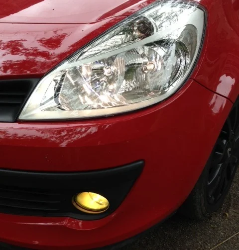

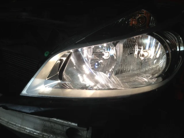

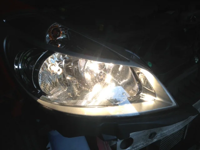

after a bit of fiddling i replaced the standard bulbs with super white's. you cant really see it in the day light but its a fair improvement at night as well as aesthetically IMO.
bumper off - light comparison close.webp white light - front left.webp white light - front right non hid.webp
the passenger light has been changed to super whites and the driver's side hasn't.

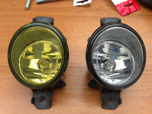

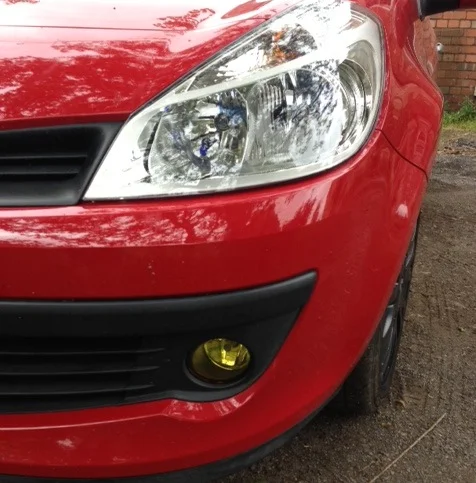

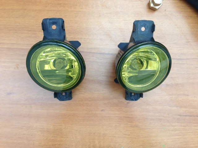

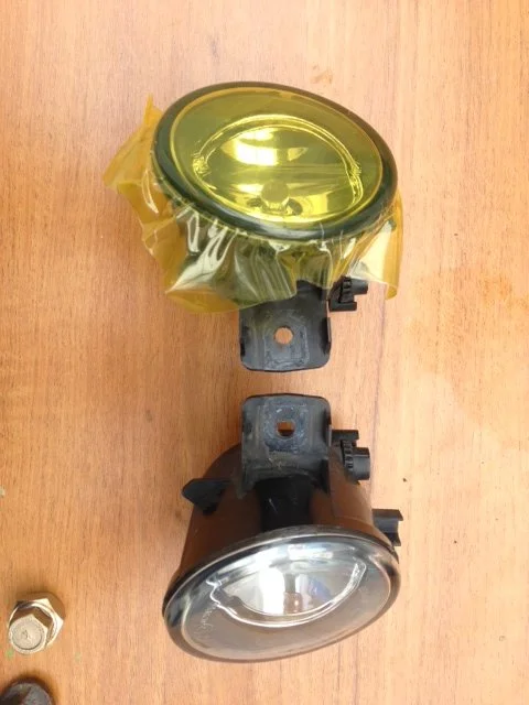

Whilst i had the bumper off I took off the fog lights and wrapped them in yellow tint.
this was fairly straight forward, particularly as its only two bolts to undo the light
jacked - front high.webp fog light - 1:4 complete.webp

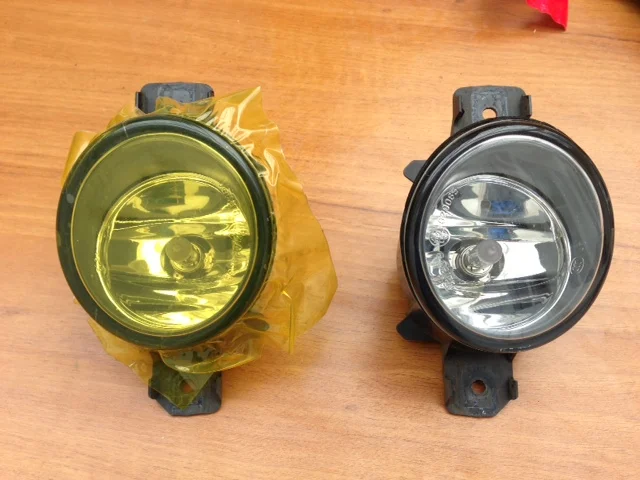

once i had the wrap on i used a heat gun to trim and shrink the edges to make sure the glue wasnt stretched over the edge as this causes the tint/vinyl wrap to unstick
this gave the following result
fog light - 1:2 complete.webp fog light - complete.webp

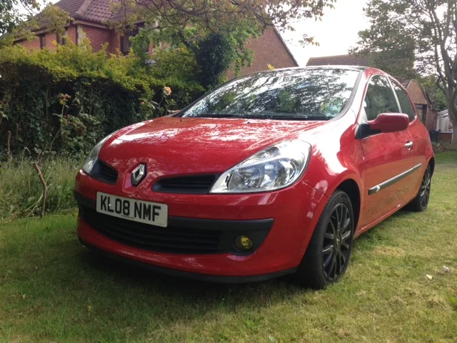

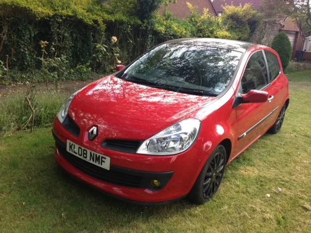

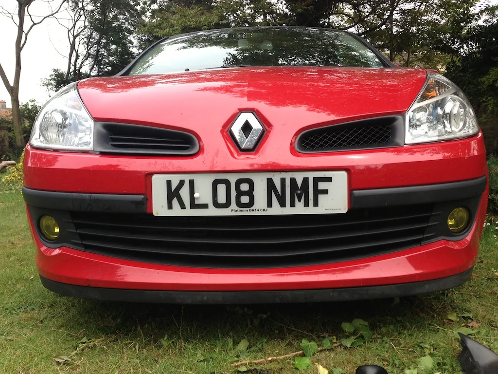

i rebuilt the front end and now the subtle changes look pretty sweet i think.
it was a lot of work just for a small change but i prefer it and think its pretty sweet.
this is how Megatron sits now..
front left view elevated.webpfront left view.webpfront left.webpwhite light - day.webp

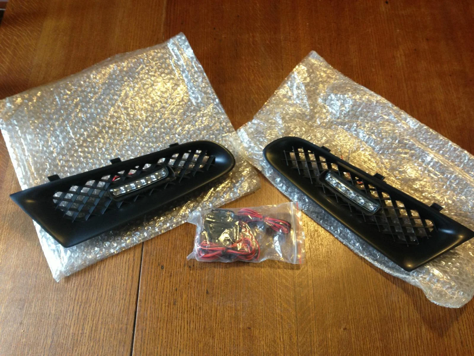

i was hoping to change the grill to an RS Grill but the shop sent me the wrong one so i have to wait for that adventure.

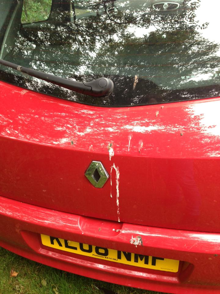

I have the same colour. Do you have trouble with keeping the paintwork immaculate?
Also mate i can get you an RS Grill for £28?
pretty much, especially because of the amount of pigeons in our area!
its not so much getting a new grill but getting my money back from the LED grill to be honest, considering eBaying it but doubt ill get a lot for it as it looks disgusting.
​thanks anyway

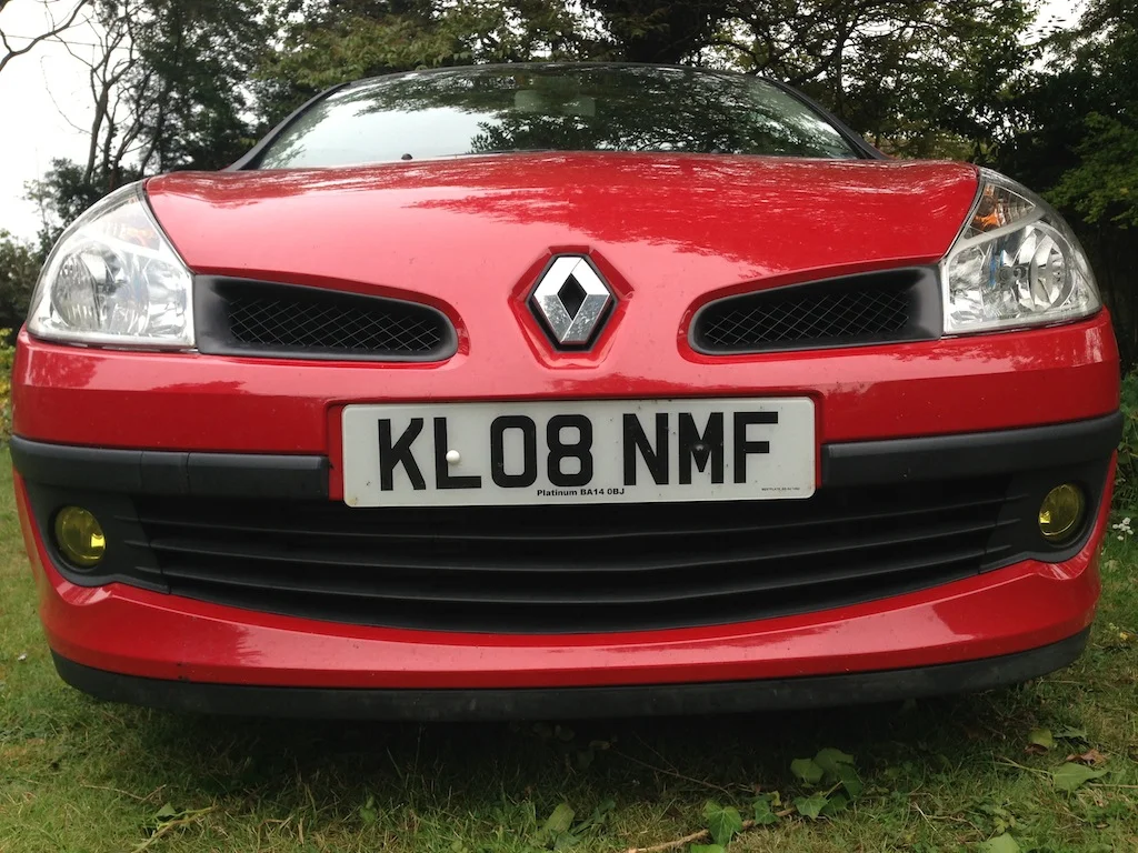

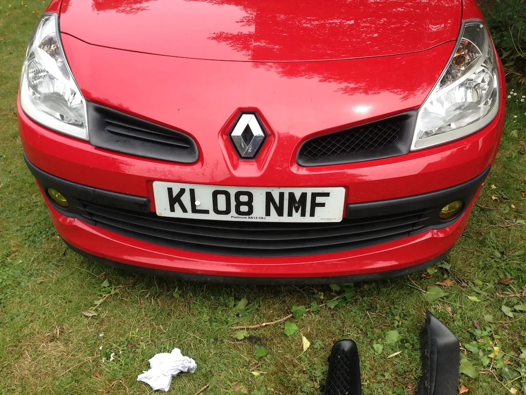

Was able to get my LED grill (seen below) sent back today for a refund. hopefully the replacement (without the LED's) will be here soon
The replacement grills came today so i set about fitting them.
was pretty easy actually, just pull the grill up and towards the centre of the vehicle from the nearest light cluster.
finished product:

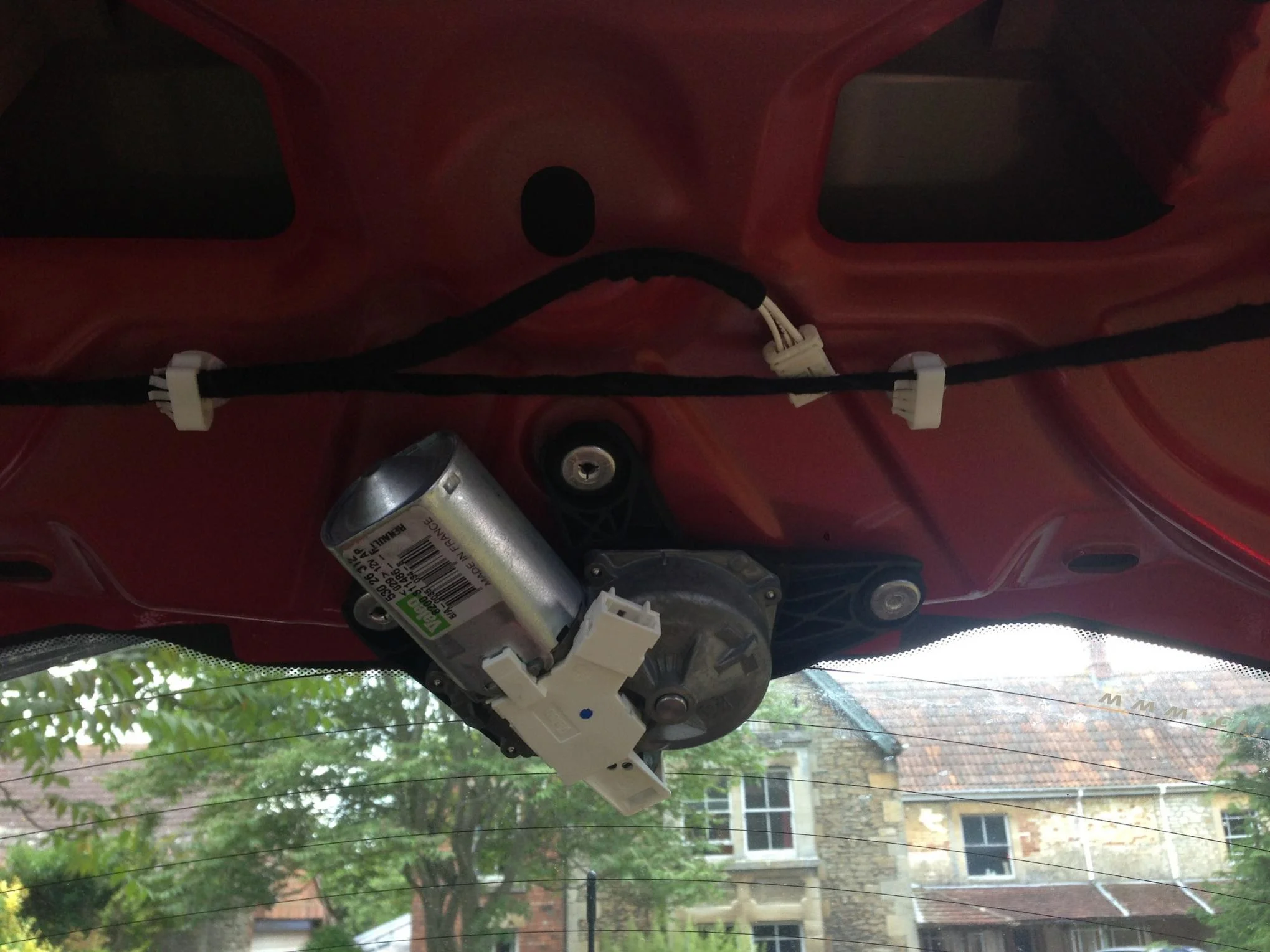

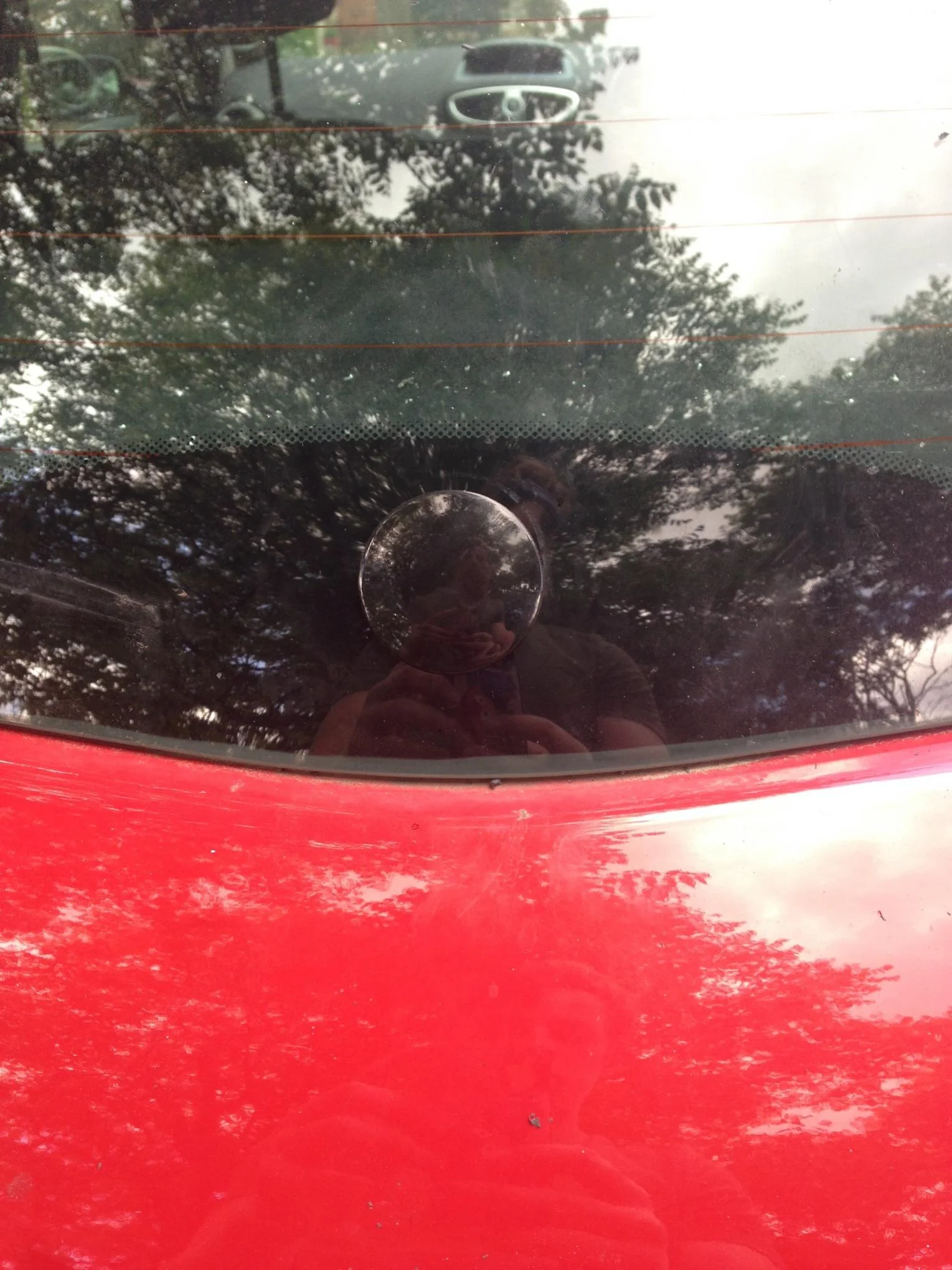

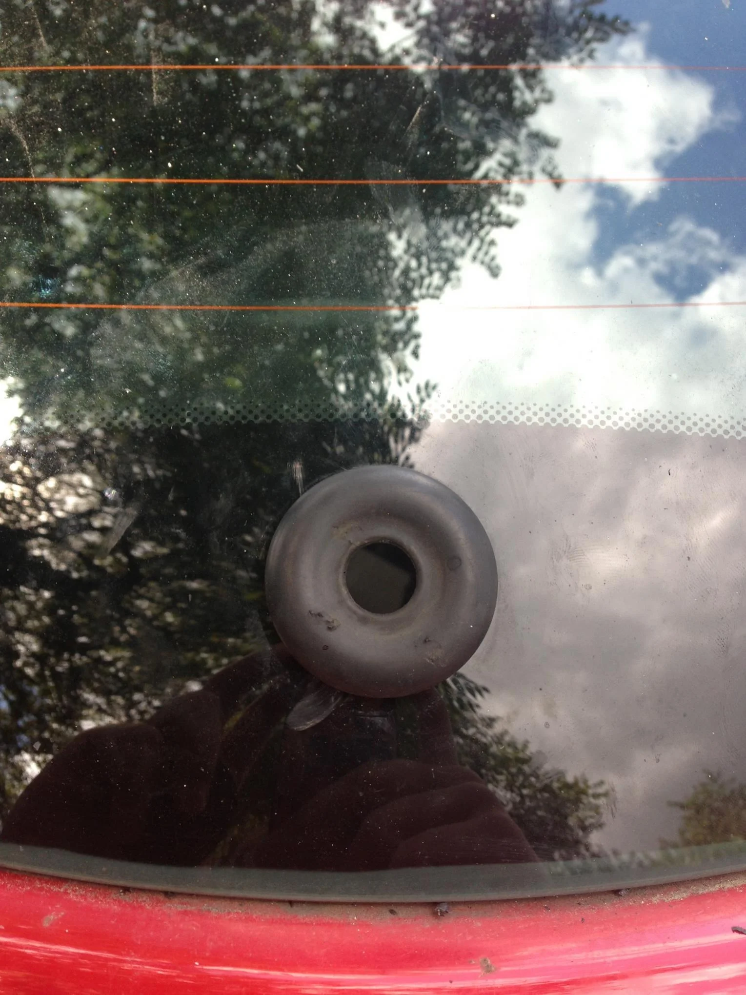

finished de-wipering my boot today!.. took bloody ages mind
i popped the inner boot cover off to reveal the wiper motor which is as follows,
sorry for the poor quality, but i unclipped the wiper motor's electrics then drilled through the rivets with a small drill bit and gradually increased the drill bit size as i wanted to be gentle.

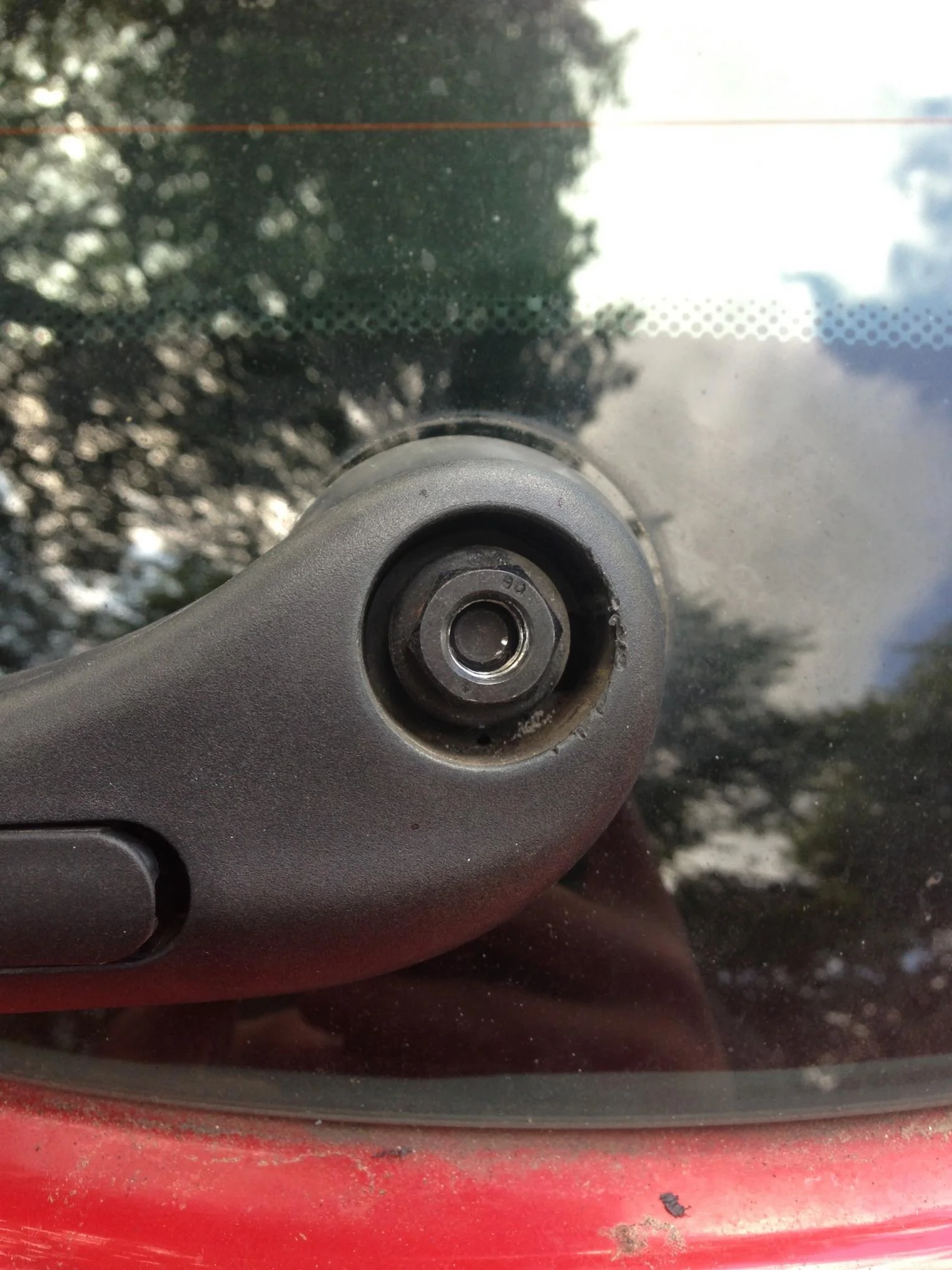

after the rivets were out i popped the boot down and took the wiper cap out.
i undid this 13mm nut.. but that got me nowhere because there is another nut in the wiper itself. i tried twisting the blade by holding the motor but it wasn't budging.
i couldnt find a hack saw to cut the right hand side of the wiper blade off so resorted to drilling around the nut in the wiper. this gave the same effect and i was able to pull the wiper motor back through the inside.
IMG_2054.webp- ta daaa.
i was going to keep the rubber bung as i thought it would help to seal the hole, but its a bit thick. i will try to cut it down at a later date so my cap fits over it.
i cleaned up my mess and had a think.. if i was going to do it again i would leave the motor on and try to get the blade off first. i think that would be easier.. as now i cant put my wiper back on without significant cost :/.
i also haven't put the boot trim back on as its an absolute ***** to re-attach.

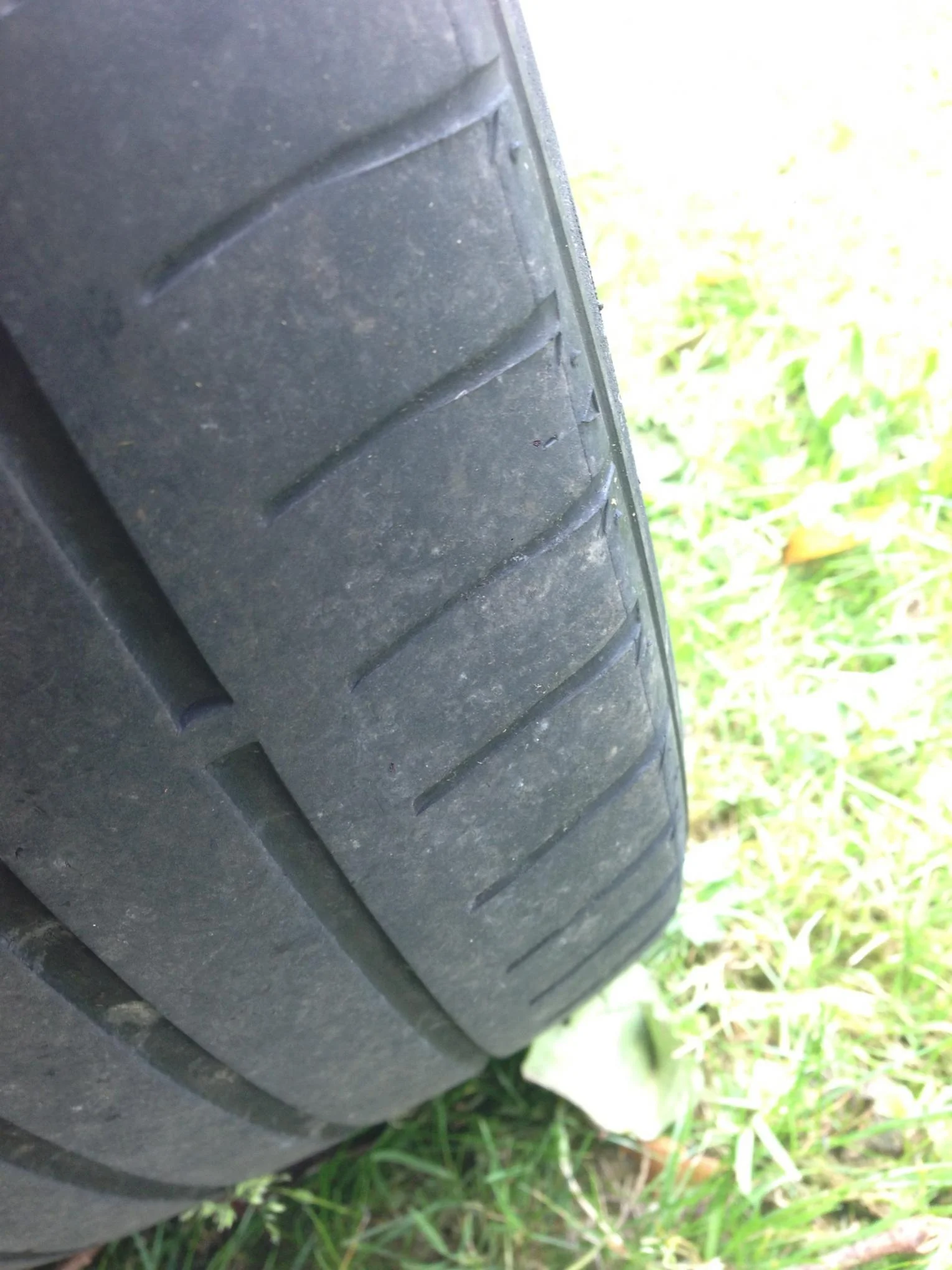

but i did notice that i need new rear tyres... oops

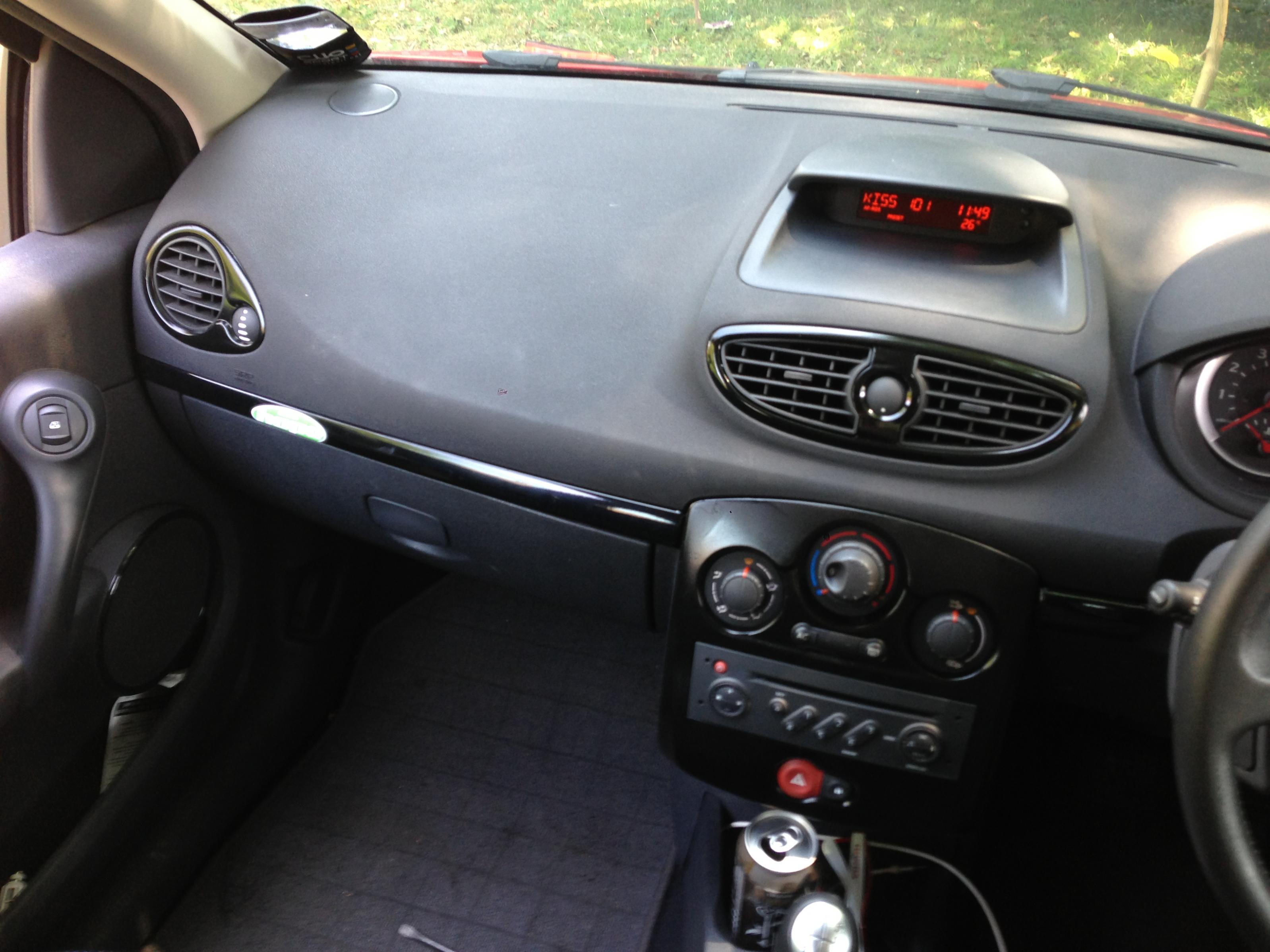

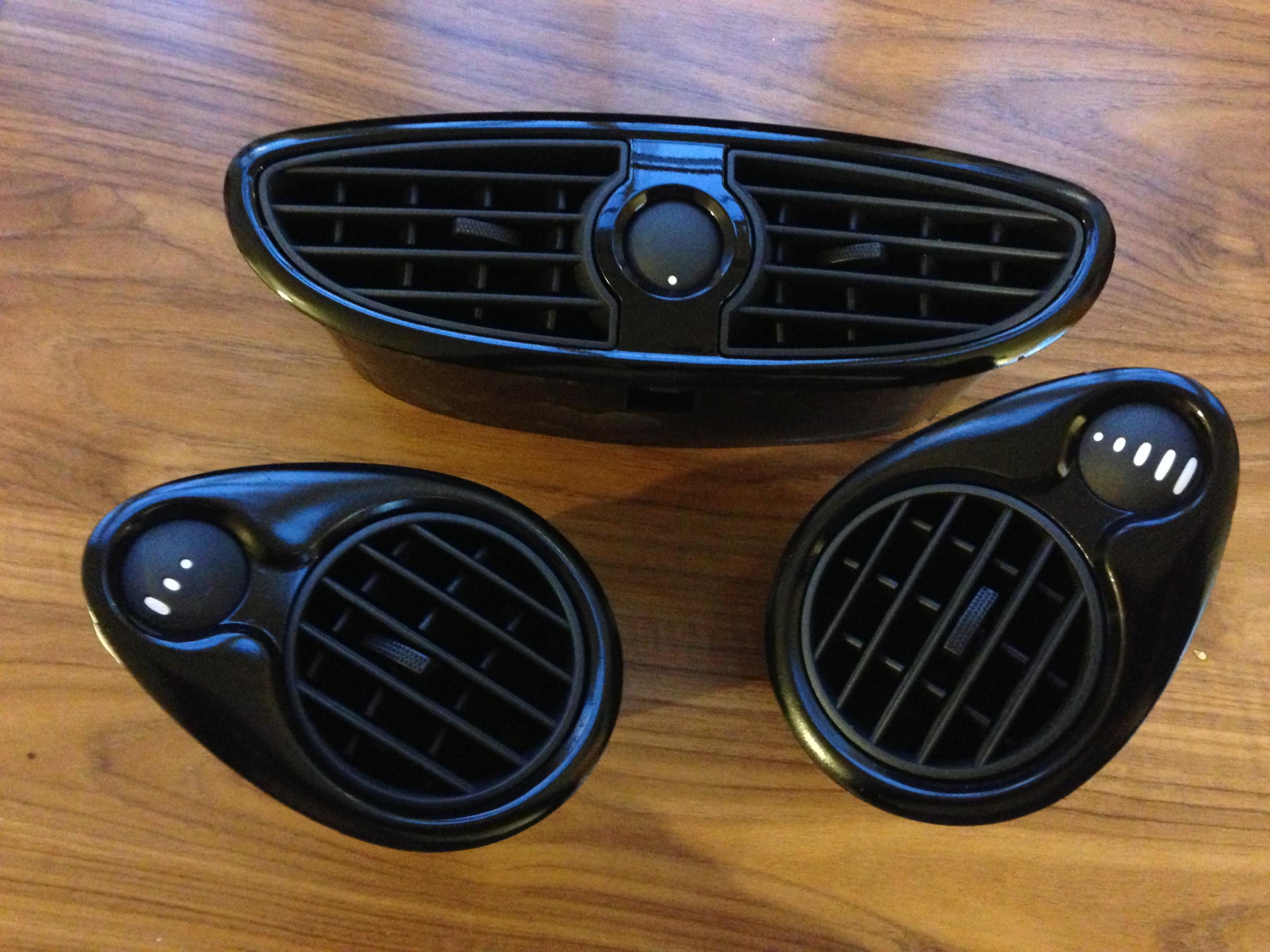

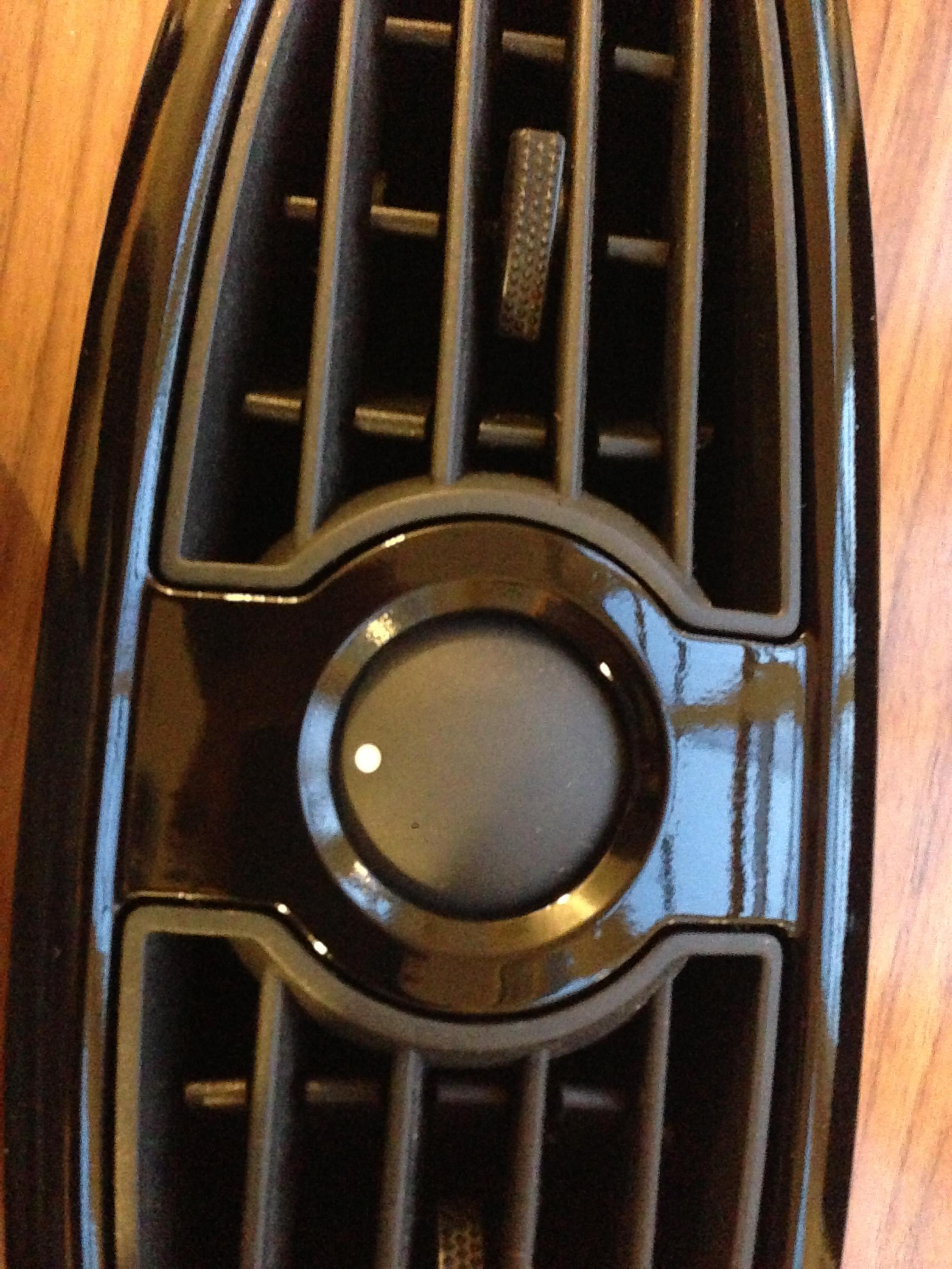

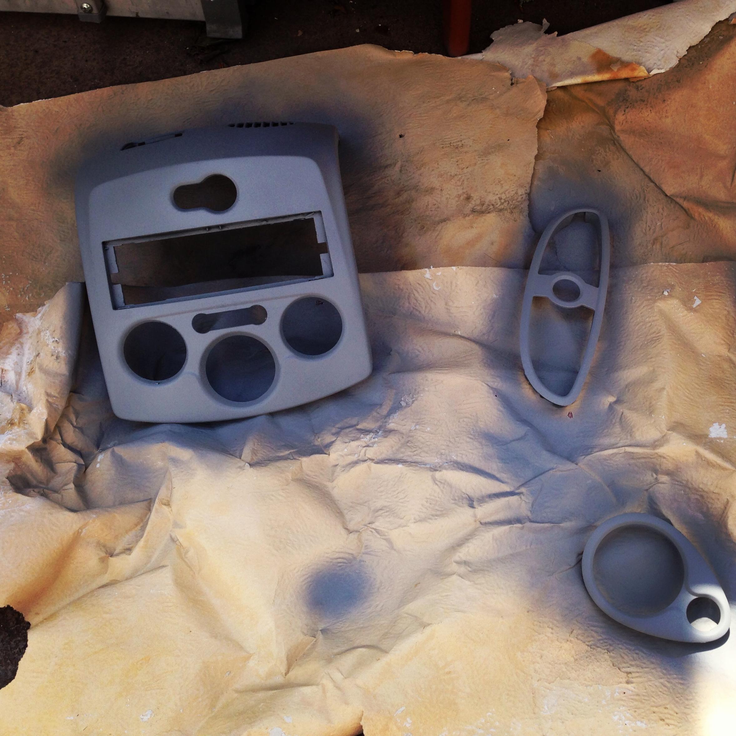

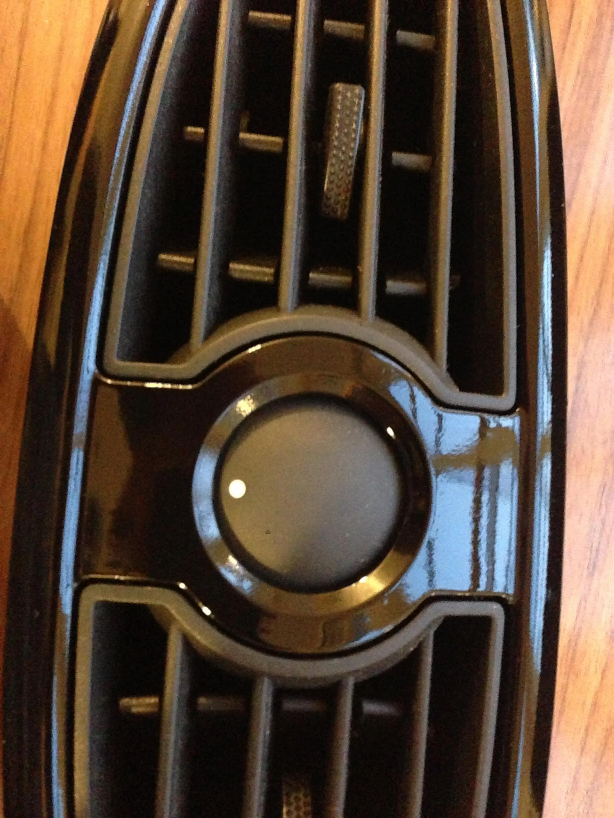

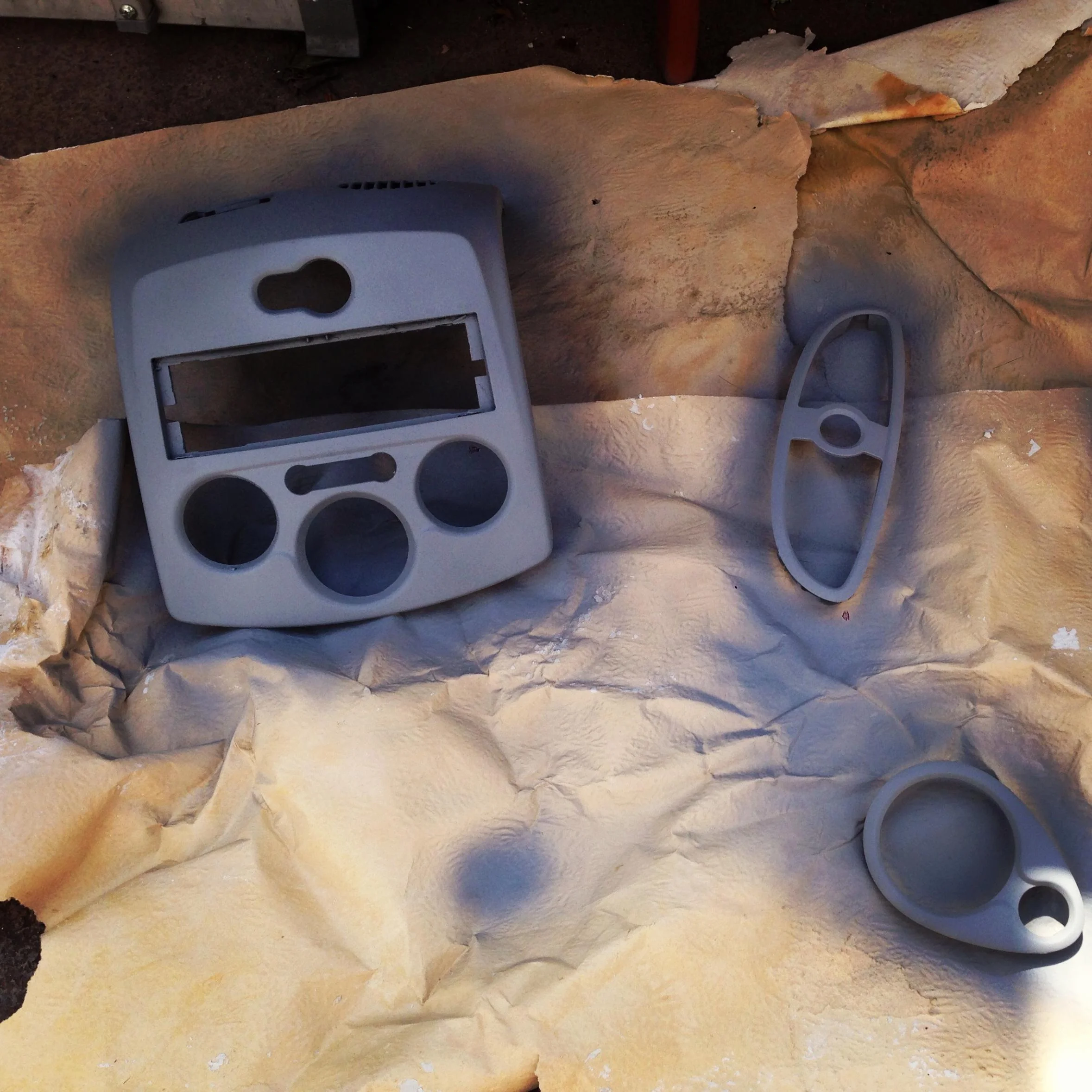

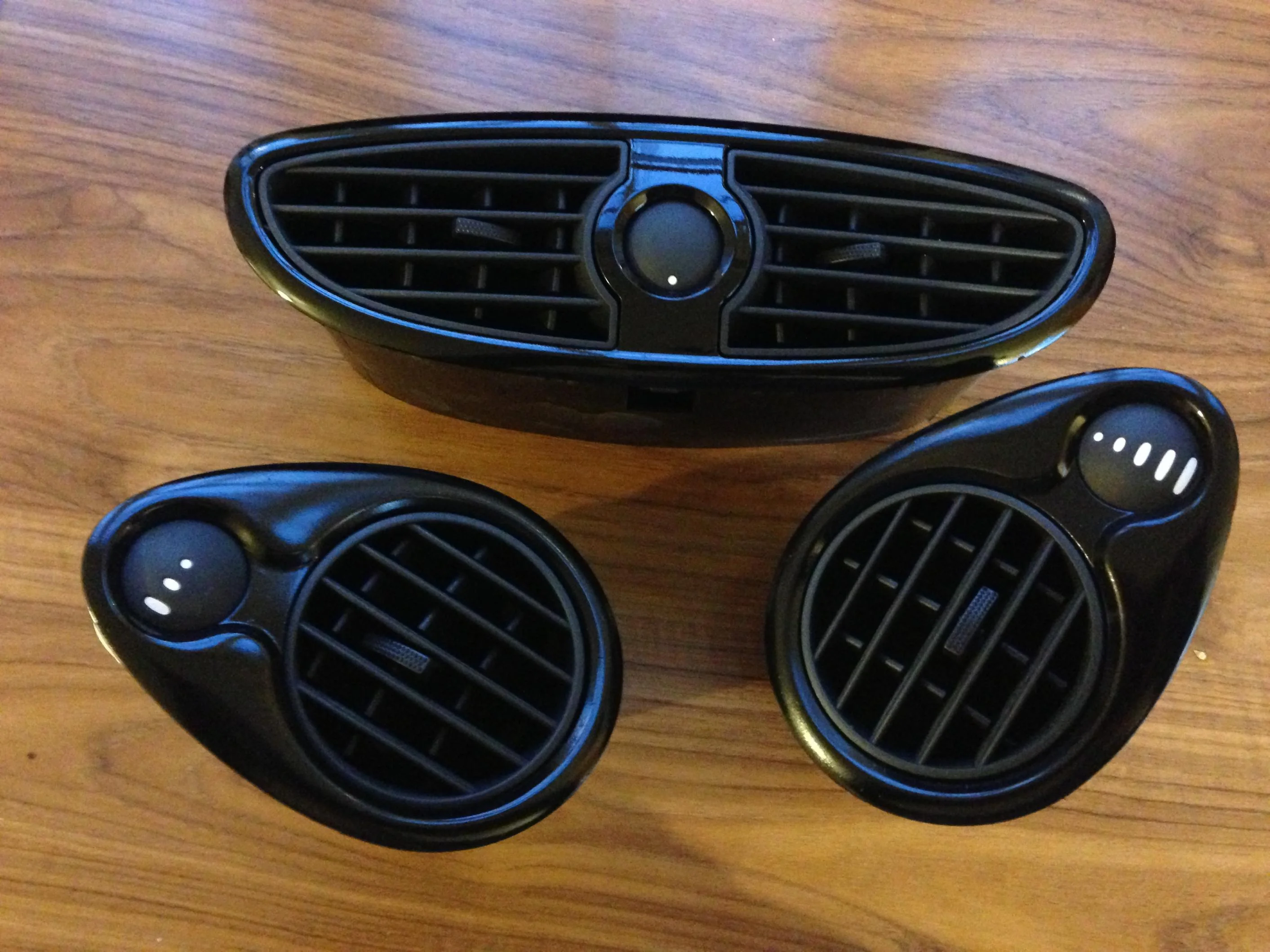

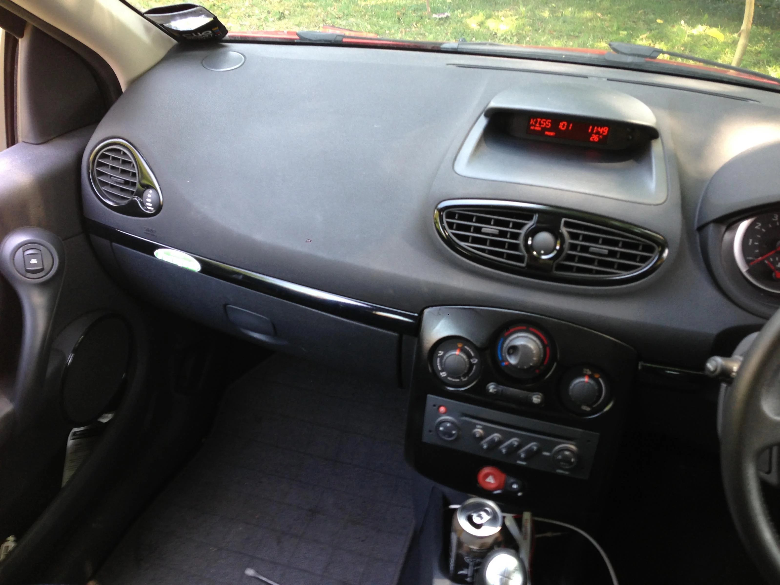

got started on colour coding this weekend.
i started with the centre console and vents, i had previously wrapped the vents but i took it off because it didn't look good at all.
the centre console was pretty easy to get off and so are the vents. just went careful with a flat blade screw driver.
after a few coats of primer, black paint and lacquer they turned out like above.
and this is the finished product, pretty happy with the finish and how even each coat turned out.
next mod i think will be to paint the outside's bump strips red and do something with the radio as it looks out of place now.
