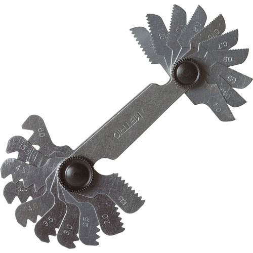

A good excuse to buy yourself a thread pitch gauge.
Although I imagine the majority will be standard pitch.
If you have a local fastening place on an industrial estate, they will sort you out for pennies. Alternatively pop the length and M number in to ebay and you can get most in multiples of 2/5/10 etc.
Peugeot's online parts catalogue lists the length and pitch for all bolts on an exploded diagram. I'm unsure if Renault's version is as useful.
I didn't even know those gauges existed!

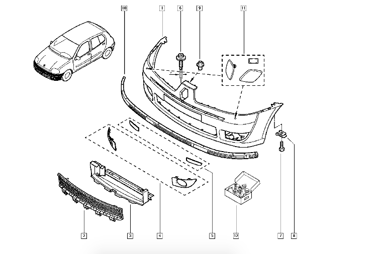

When you say bumper bolts what ones you looking for ?

Thanks @MarcR™ that pic is really helpful.
The bumper bolts which were an issue was the arch bolt on the passenger side and then one of the bolts underneath the car, both captive nuts where no attached so just spinning so need to fix that before re-attaching the bumper.
