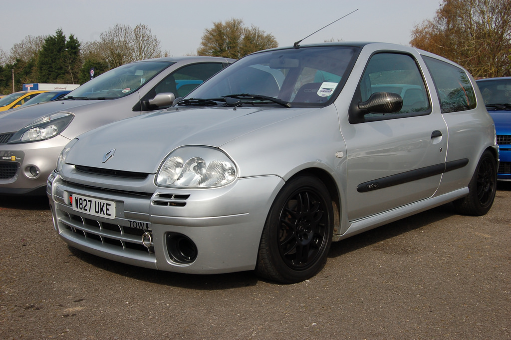

did a bit of work yesterday. havent had the cage back yet sadly, but got the car back with the painted interior.
got on with finishing the cut wiring loom
gave up with trying to wash the wheels, 18months of dirt wouldnt budge so i sanded them and painted black again. simples
before
after
and at coombe today...
should have my cage back by next weekend too
