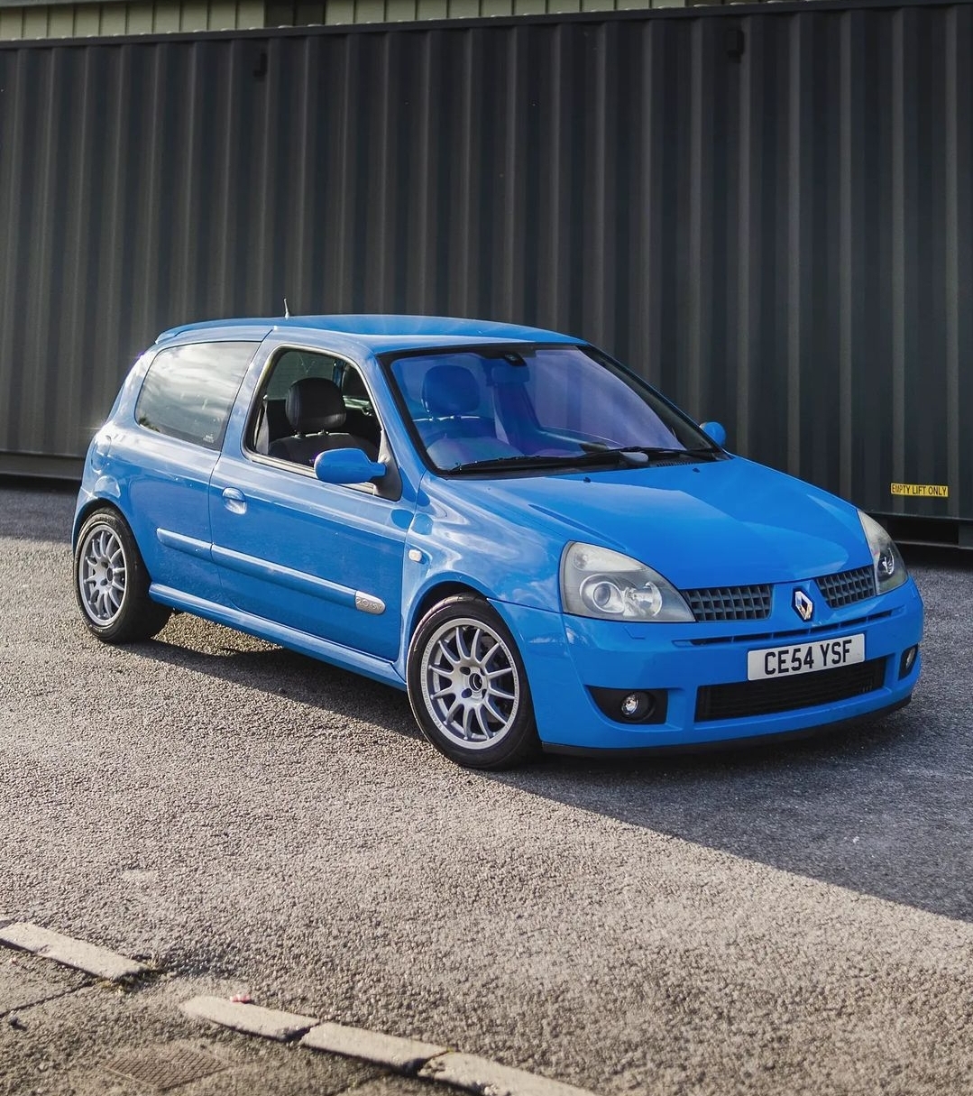

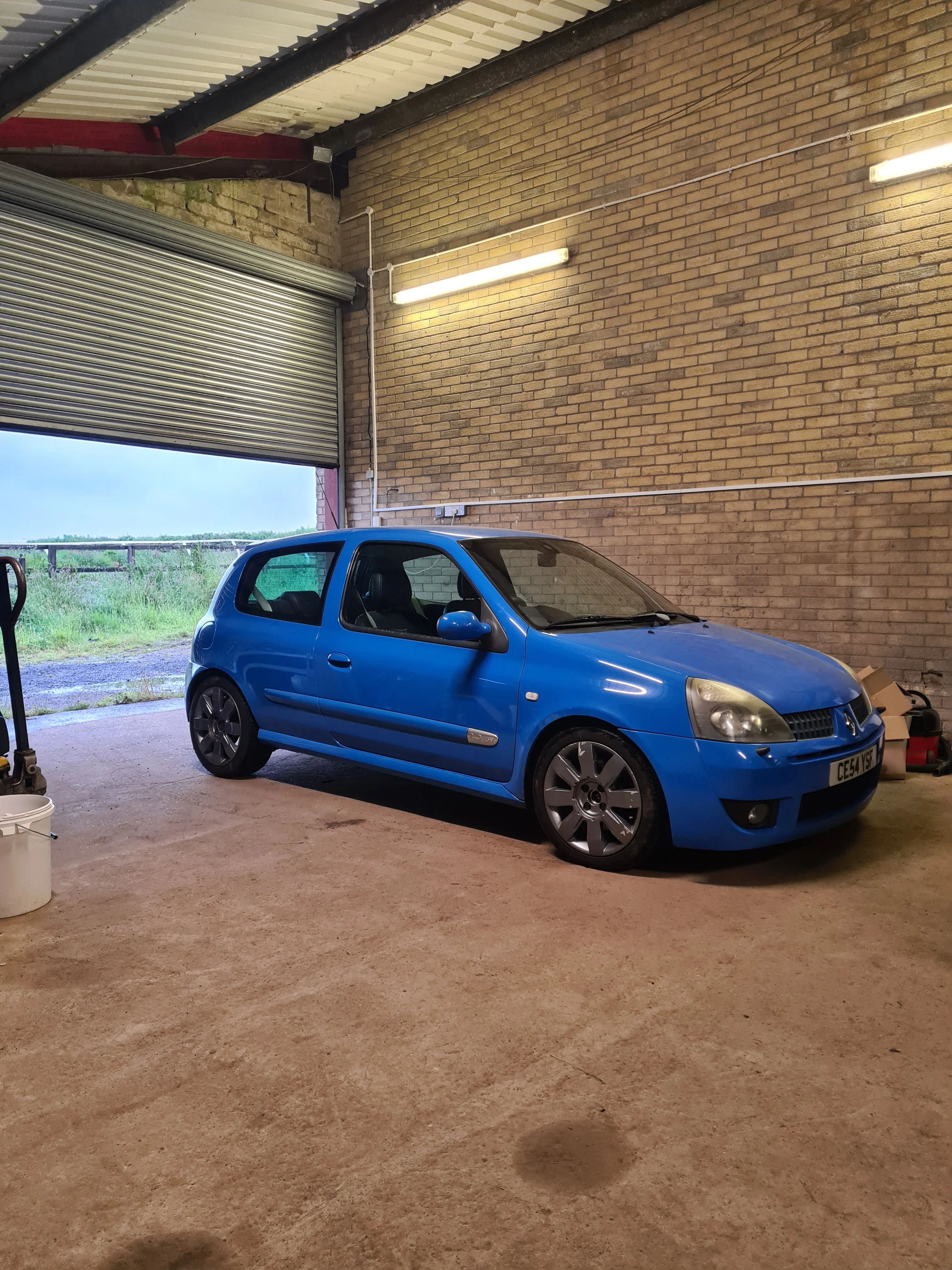

The car and barn it was stored in
And a pic from the advert (they threw these wheels in with the sale)

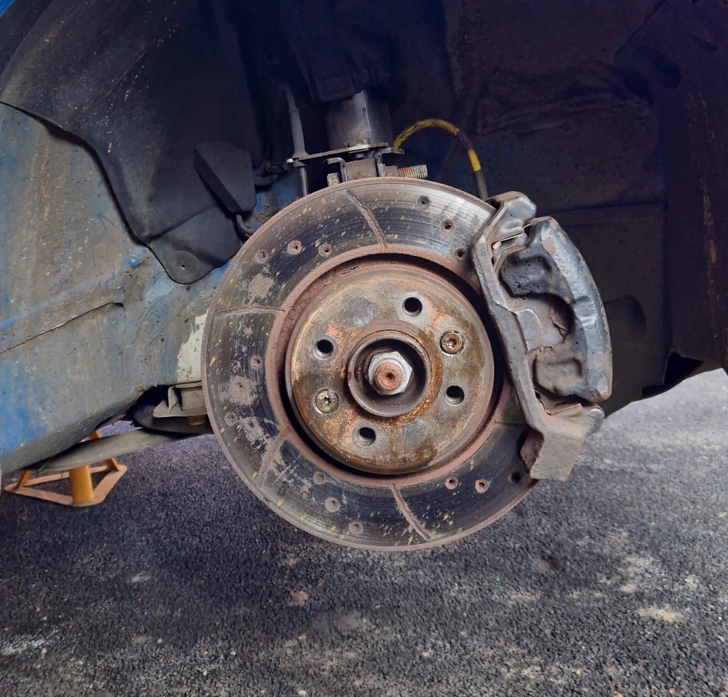

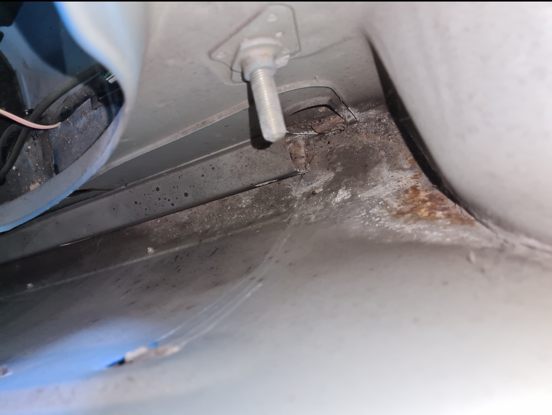

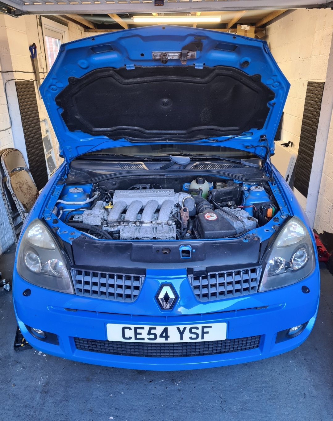

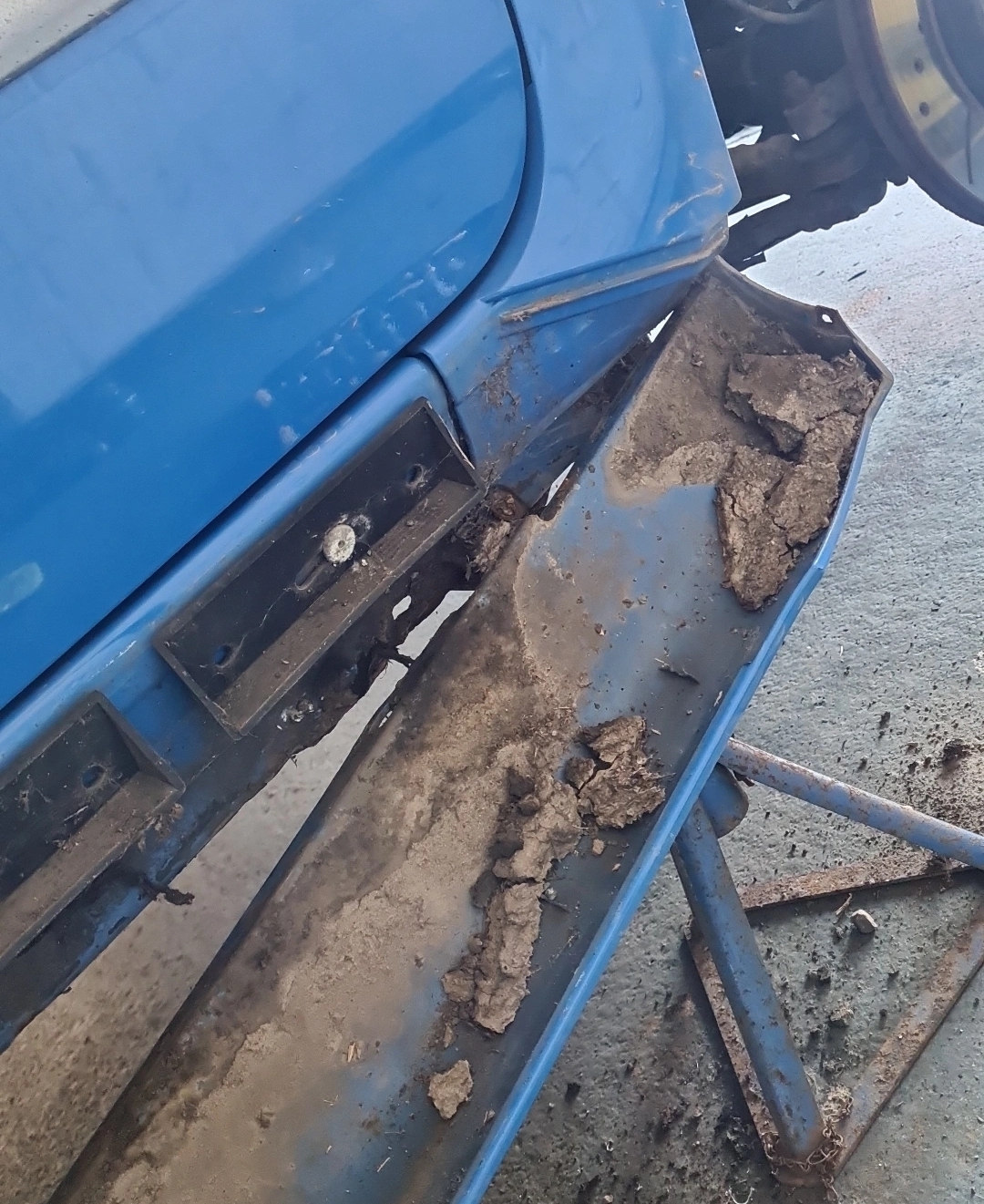

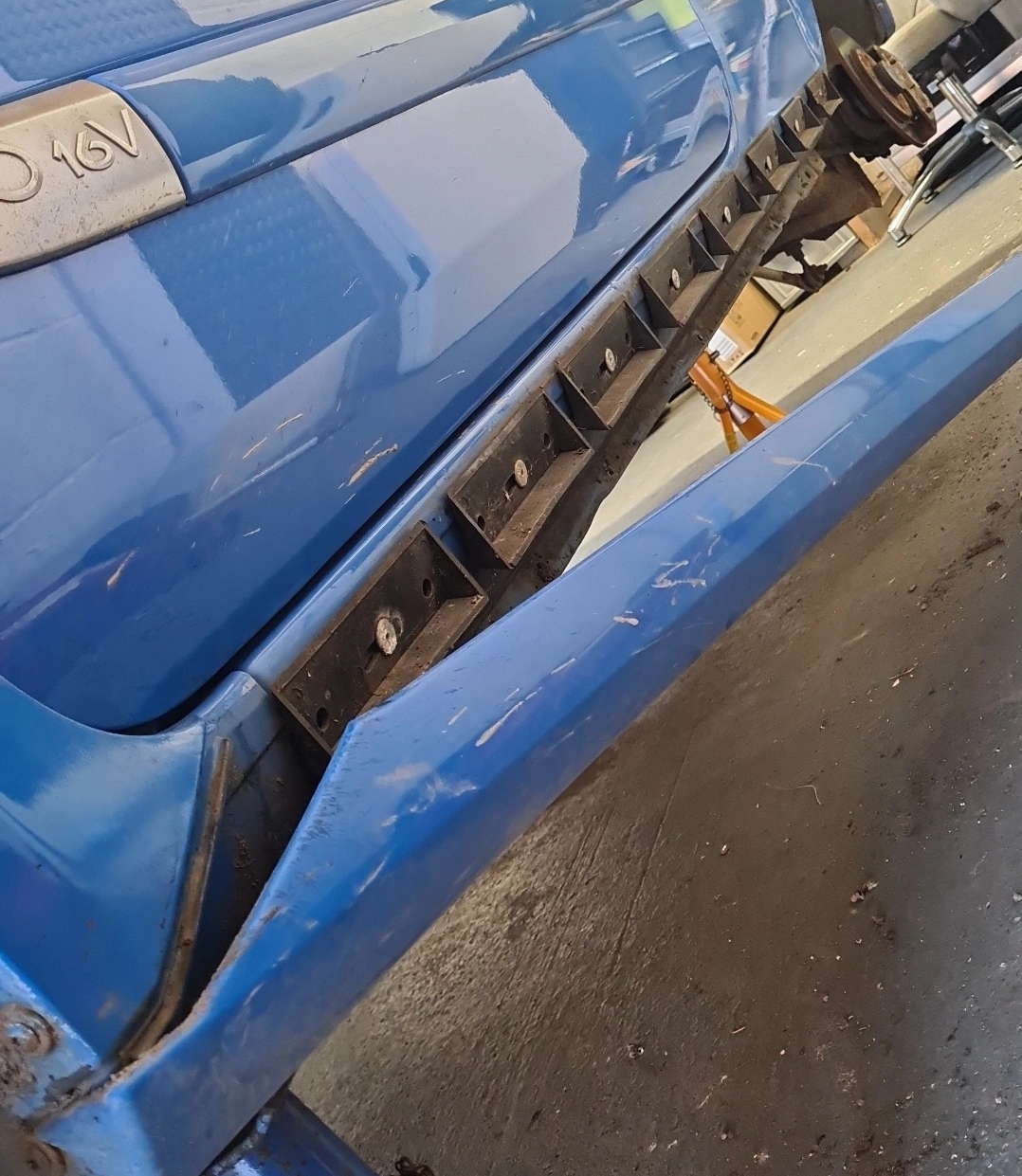

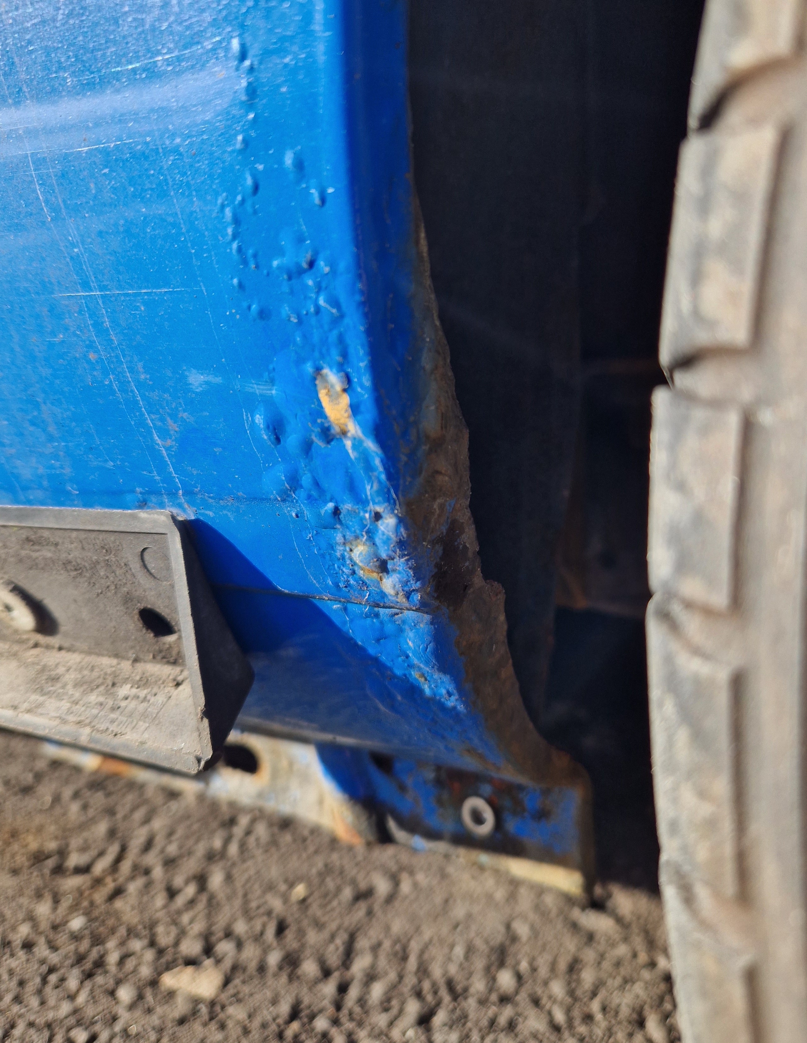

So I got the Clio home and gave it a strip down Inc the sills, a check over and and oil change.

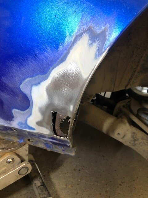

There is some bubbling coming through, something I'll deal with in the future.

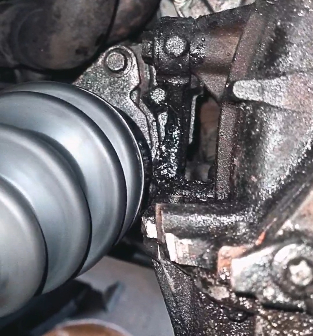

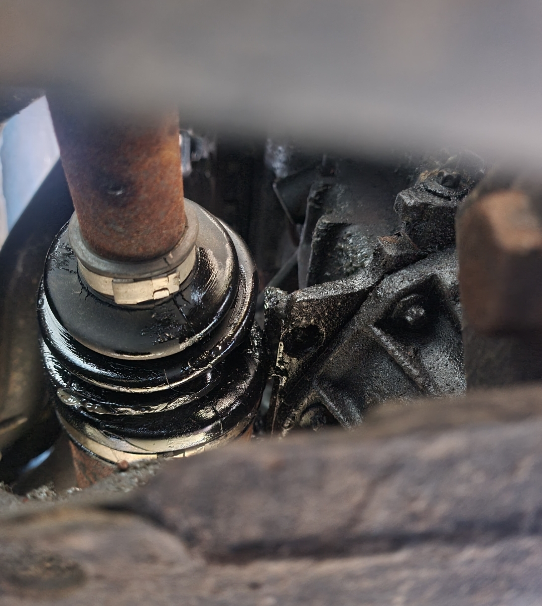

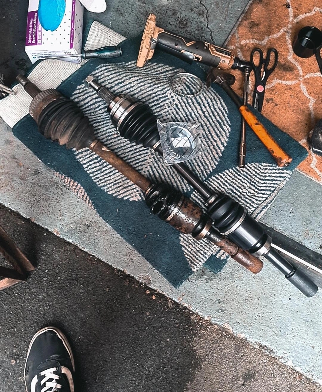

(aaaanndd...) Another thing all my previous Clios have suffered from is the engine block tearing through the inner driver CV boot spraying grease everywhere
See where the block has rubbed through the boot
Driveshaft out, block grinded back and replaced with a J&R driveshaft (Clio purists having mini heart attacks). There are mixed reviews about J&R shafts but in my, limited, experience this shaft was perfect.
In and you can see the clearance
Feel like I could offer this as a service I've done it so many times.

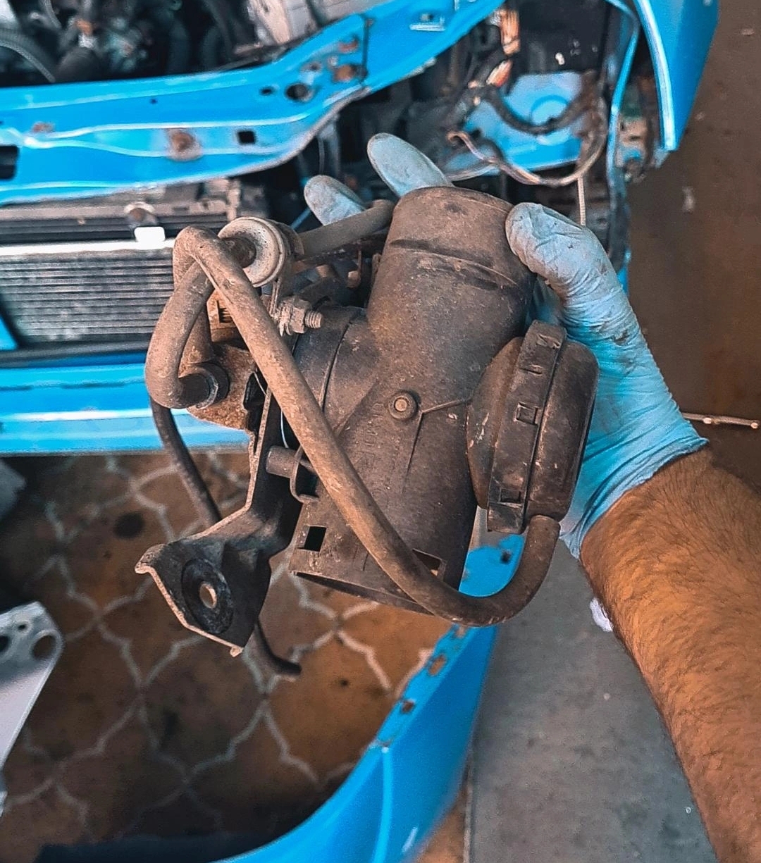

Then some more of those usual Clio things.
Removed this
And this
And that
And popped this in

You’ll have caught the rust early enough there anyway!
Hope so. I did cover this in one of the Bilethamber products to stop it progressing further. I'm thinking over winter drop it to my chosen body shop and have them sort it properly.

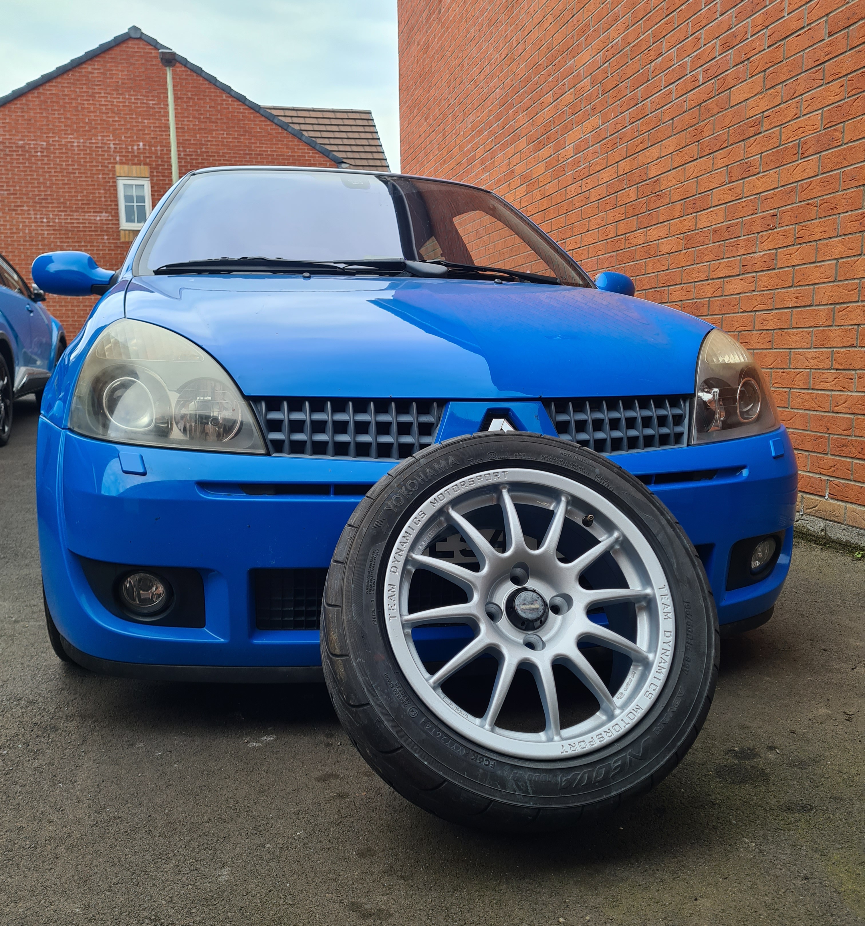

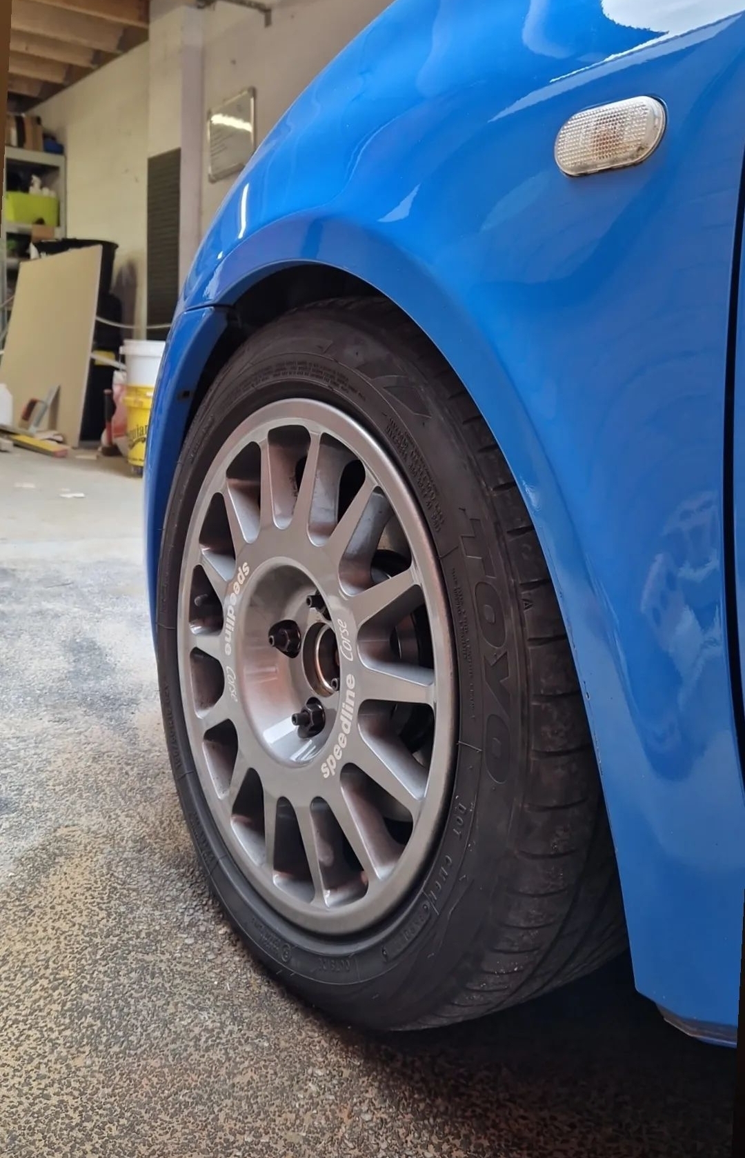

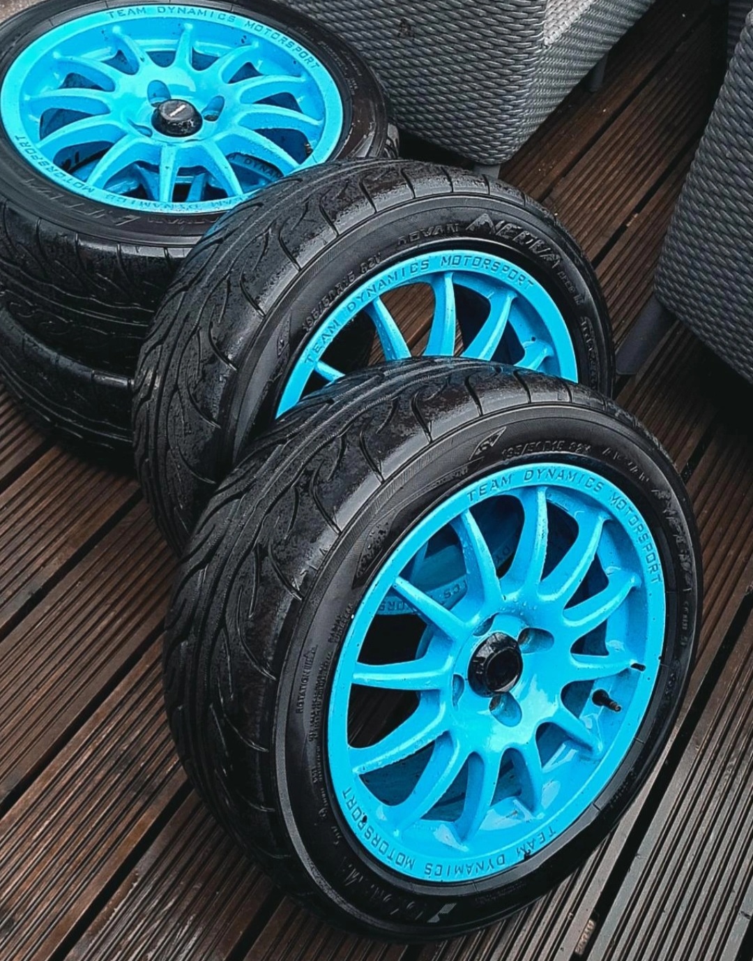

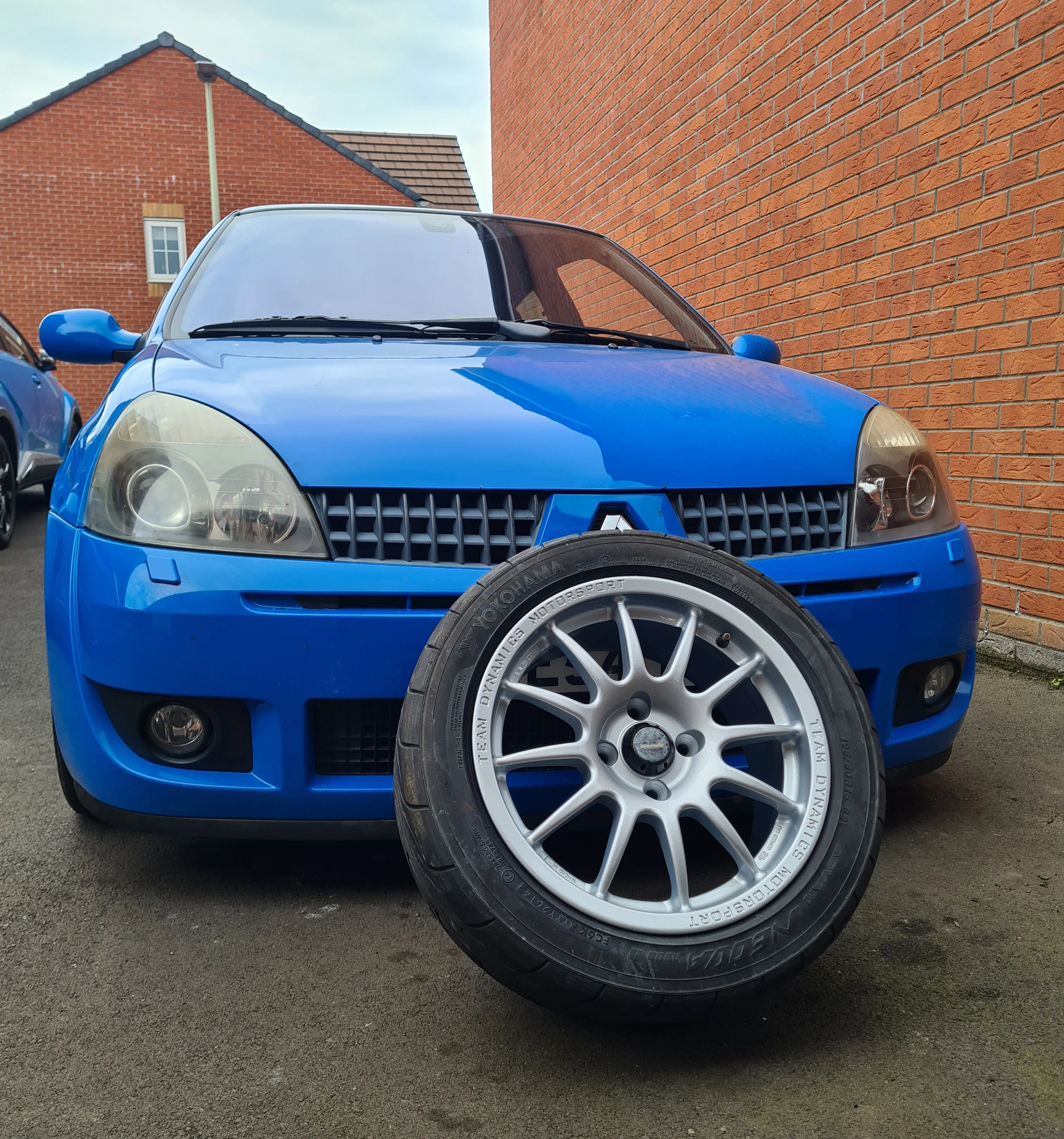

I sourced some wheels and tyres. The only issue, they were blue, very blue, almost racing blue...
So I had them refurbed a nice/safe silver
And on

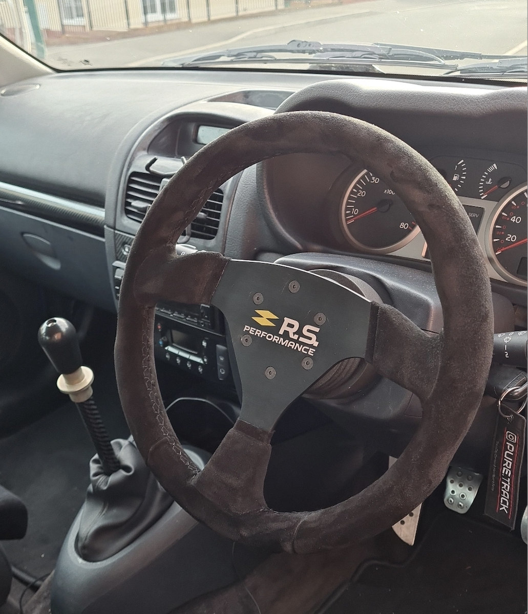

A second hand wheel, which I now regret as no ammount of cleaning it has brought it back and its just not a nice touch point.

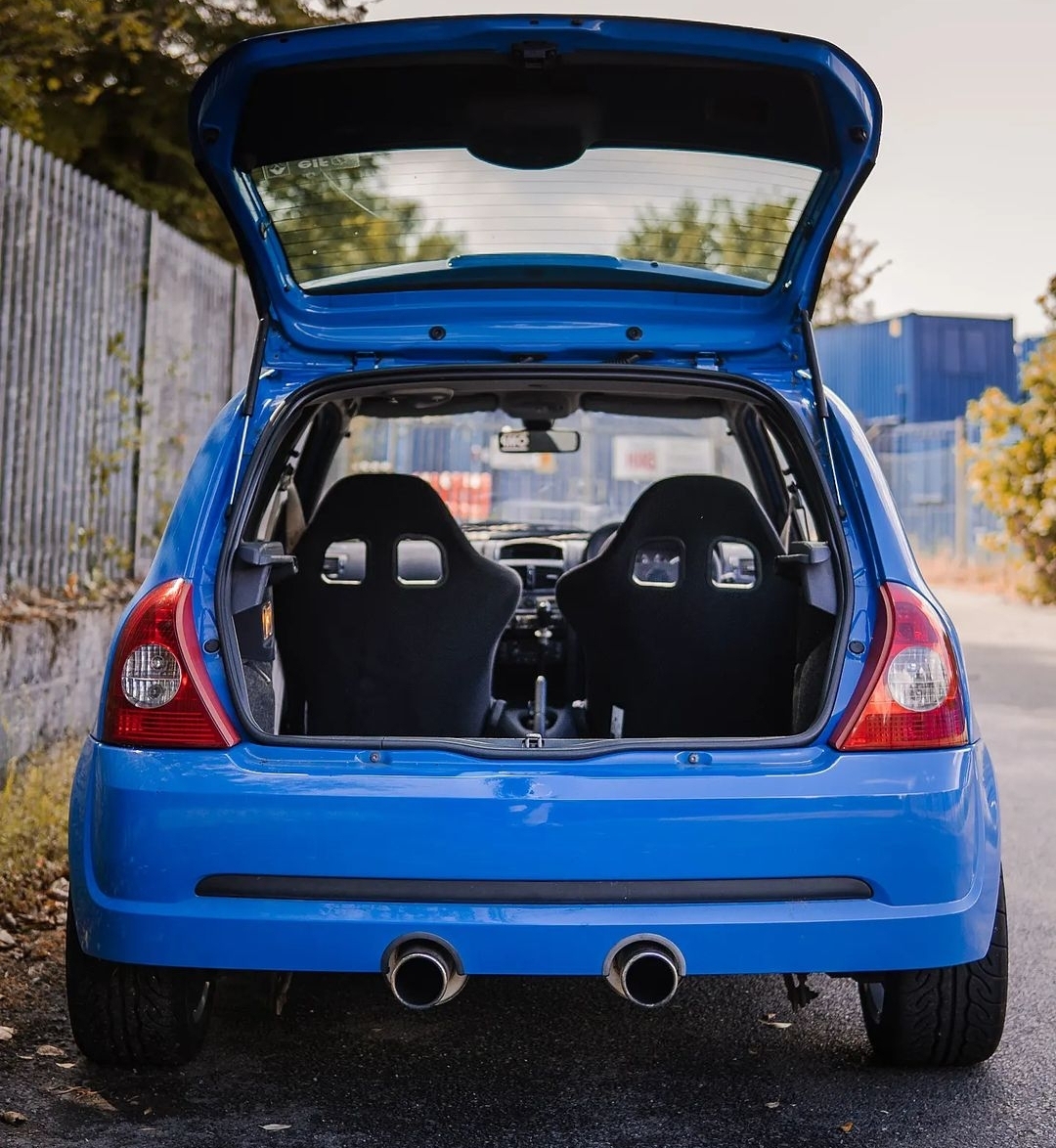

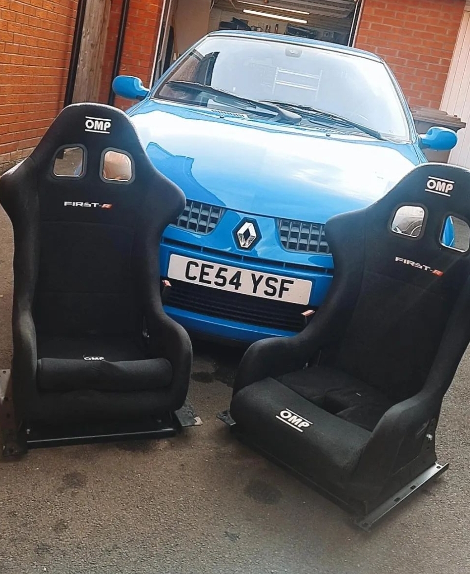

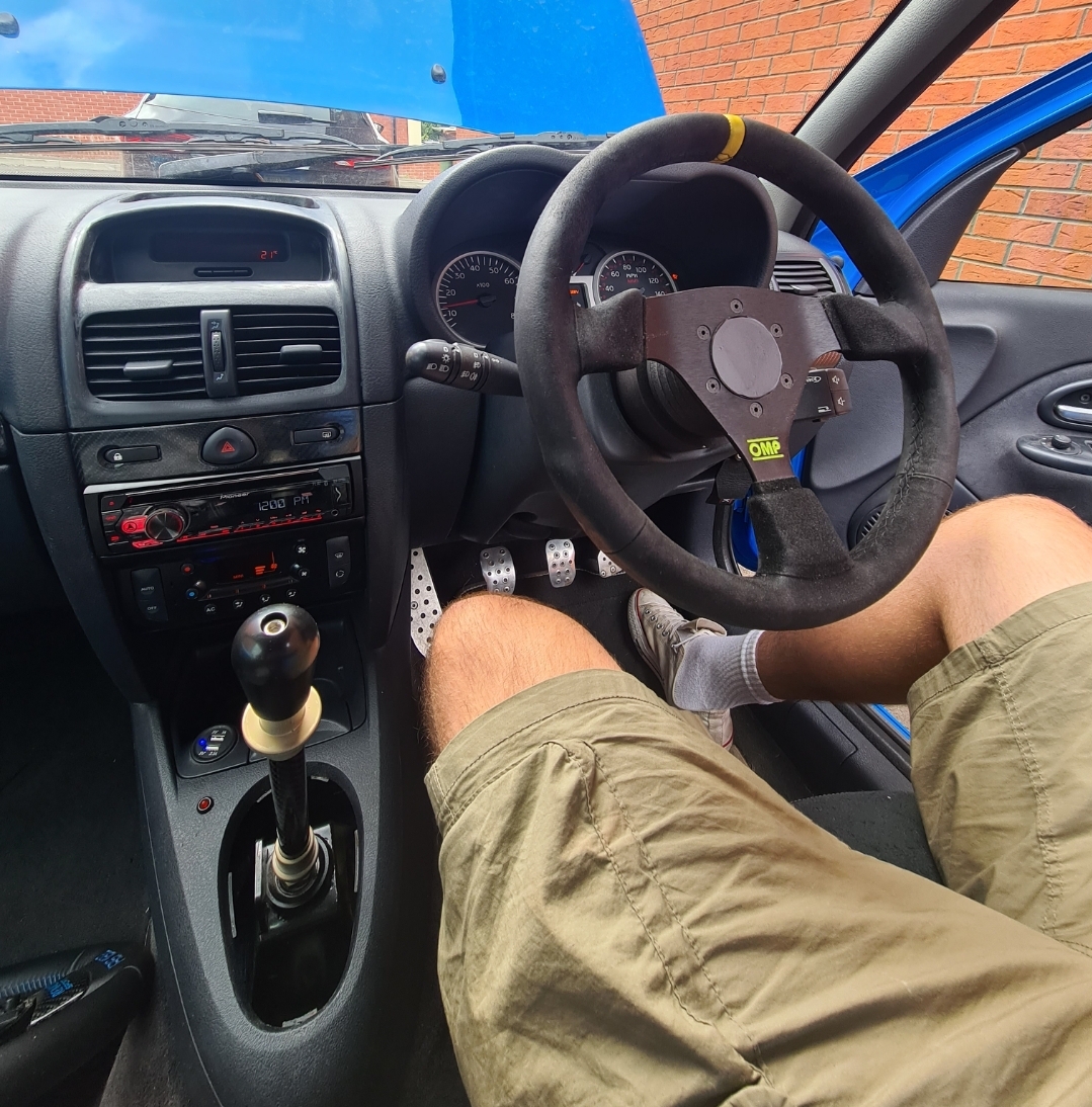

The shifter and wheel made a huge difference but the seat was just to high and there was quite abit of movement, when braking I was almost sat on the dashboard. So I needed seats...
Sourced with Jon Foz mounts.
Possibly the best thing a Clio owner can do is fit some bucket seats. Transformed the car and driver feel.

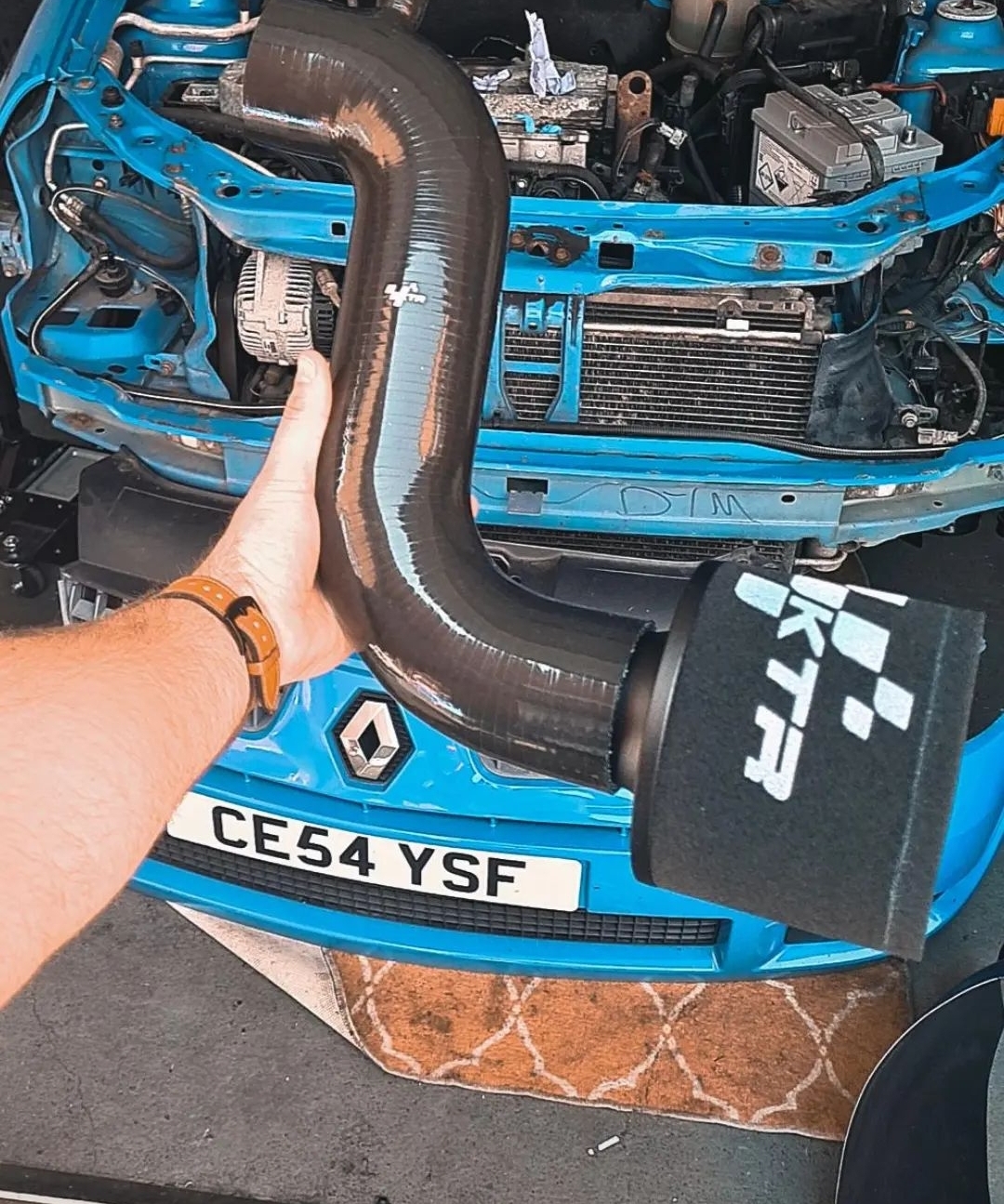

Then I fitted a KTEC induction kit

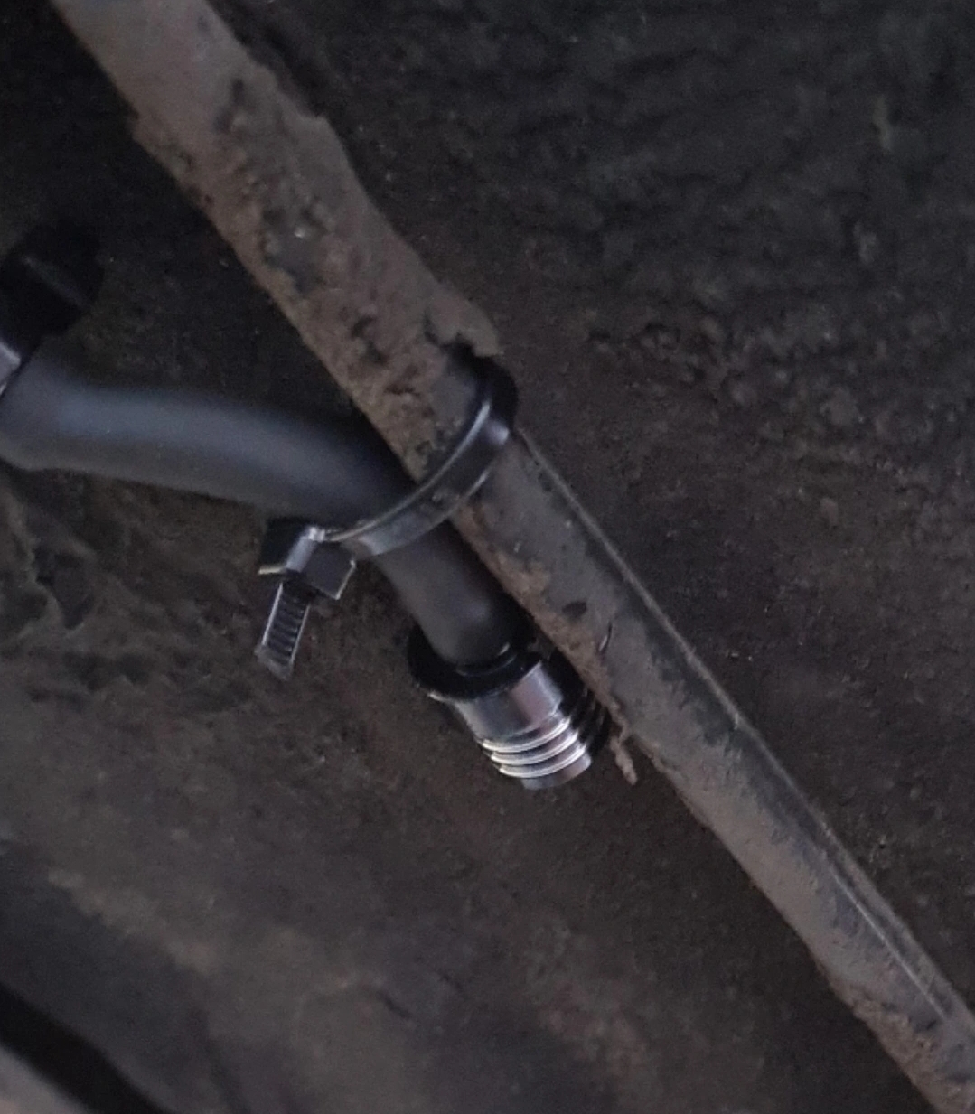

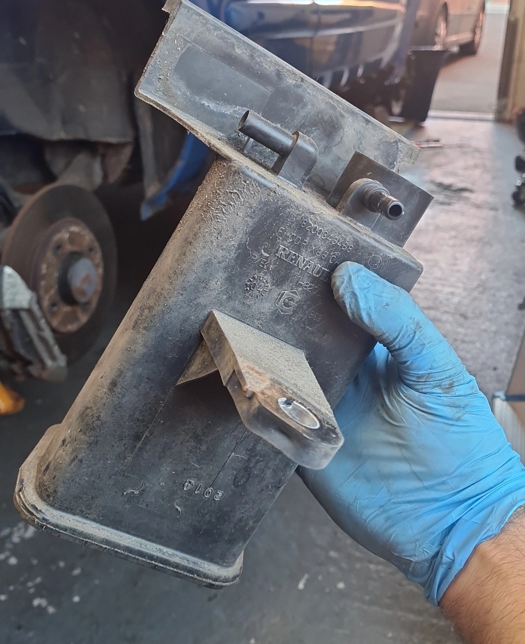

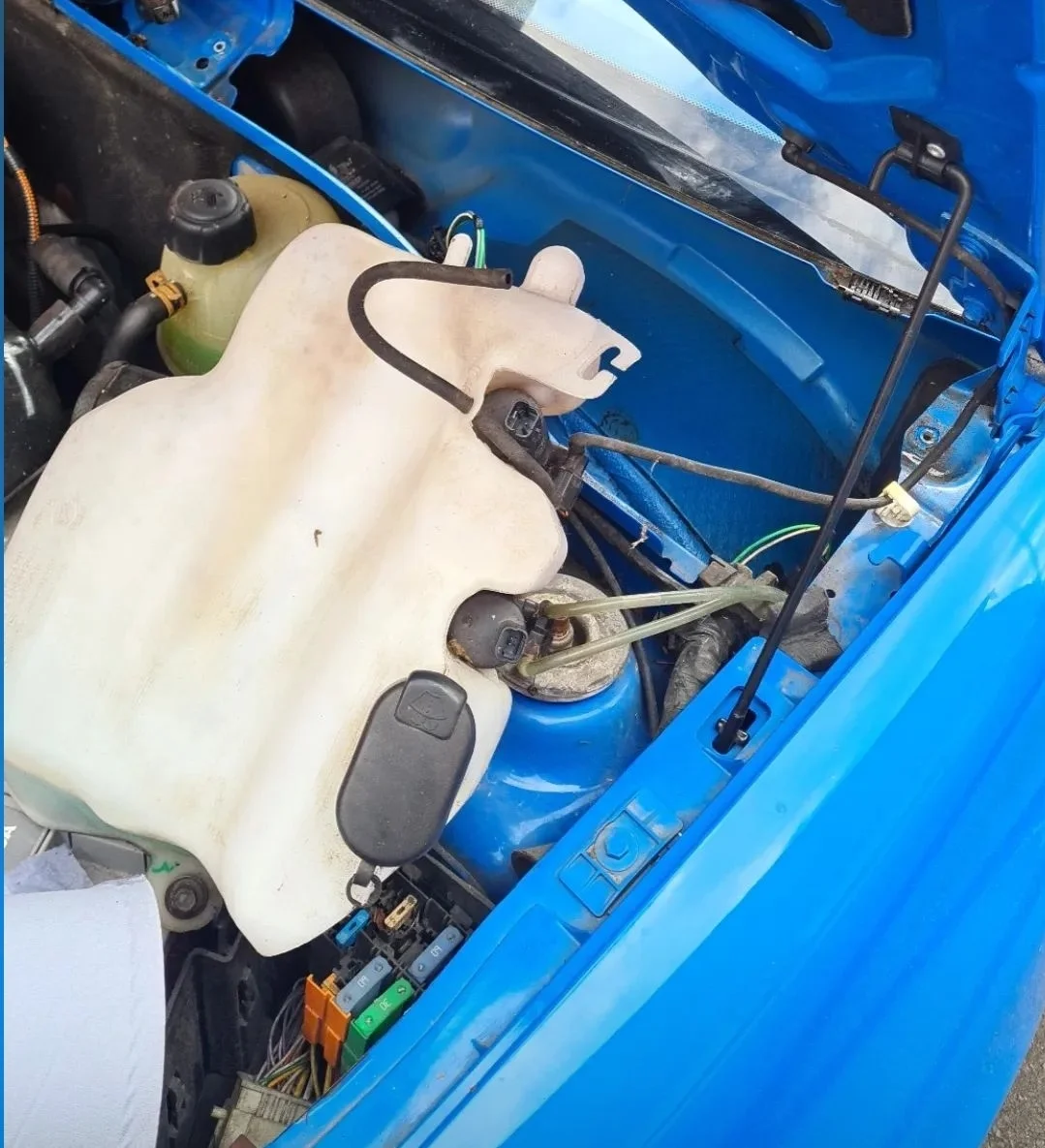

All was going well. Until I noticed an odd, damp smell in the cabin. Under the passenger seat it was soaking wet. Not the passenger foot well, but under the passenger seat. I siliconed up the rear bungs next to the rear lights and had a nose (and cleaned) under the washer bottle. Nothing obvious regarding the leak and it hasn't done it again since.

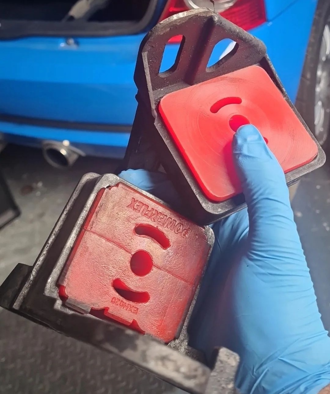

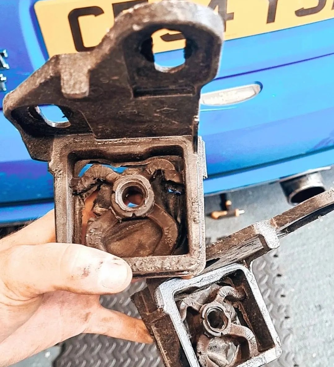

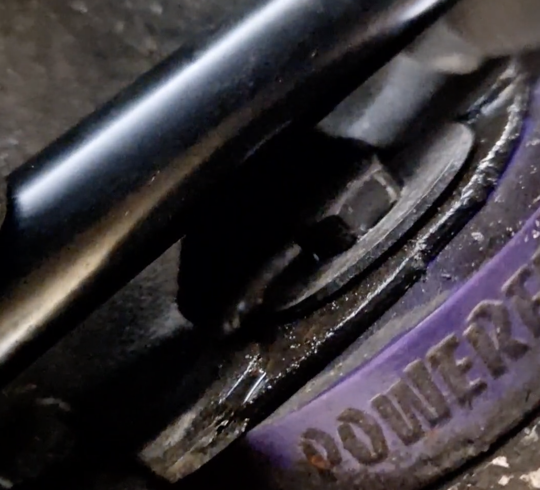

Lastly in this instalment of Bowen's Clio I took out the old exhaust hanger as they looked... exhausted (sorry).
Inserted some Powerflex bushes...
That's it for now.
Have you drove through any deep puddles?.as could be water getting from the seat bolts underneath?.i had this recently and think thats the prob on mine.
No it was dry when I parked it up, it rained and then I had a fousty smell and it was wet under the passenger seat. Doesn't seem to have done it again since.

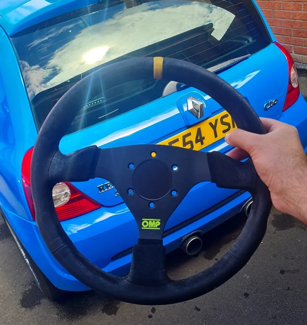

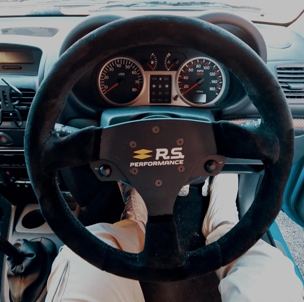

Ever since I bought the second hand steering wheel I regretted it, no amount of cleaning it could bring it back so I bought a new one from Volantech. Some issues with Volantech, took a over a month to arrive but it got here in the end. Feels much nicer in hand.
I do have the horn panel but the horn wiring isn't working....job for another time.

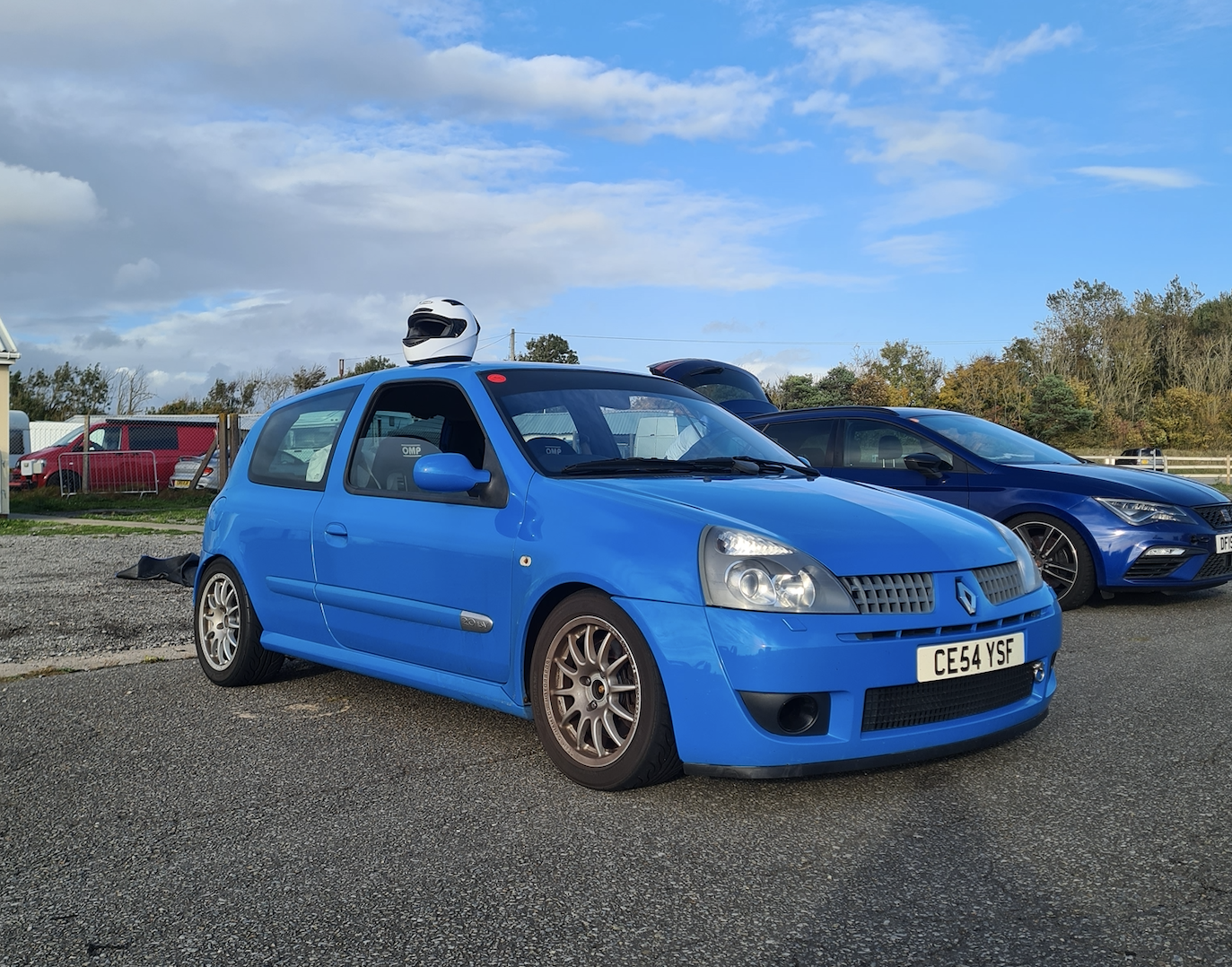

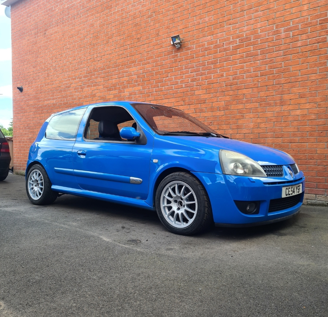

Last weekend I took the RB on a track day at Llandow. Noise test at 5250k rpm was 85dbs, that's a note for me more than anything.
Considering the work I've done to the Clio, it only dawned on me when I got there that I hadn't touched the brakes. They looked find and were sharp on the road but an unknown brand to me, they did well anyway as did the AD08Rs.
Only issues to report:
  • PAS left through the reservoir cap, I may have over filled it for track work. It was fine the rest of the day.
  • The rear of the car kept scraping. The rear tyres kept touching the rear bumper/archliners on hard cornering. I t did it on the front too but the front archliners are hanging on for dear life anyway so i could accept that, but the rears were annoying me. Running BC coilovers.
  • As the day went on I could feel that the brakes were getting tired so they will need replacing.
Llandow doesn't have a dedicated photographer and I also didn't have my camera, so here are some of the Clio in the paddock taken on my phone.

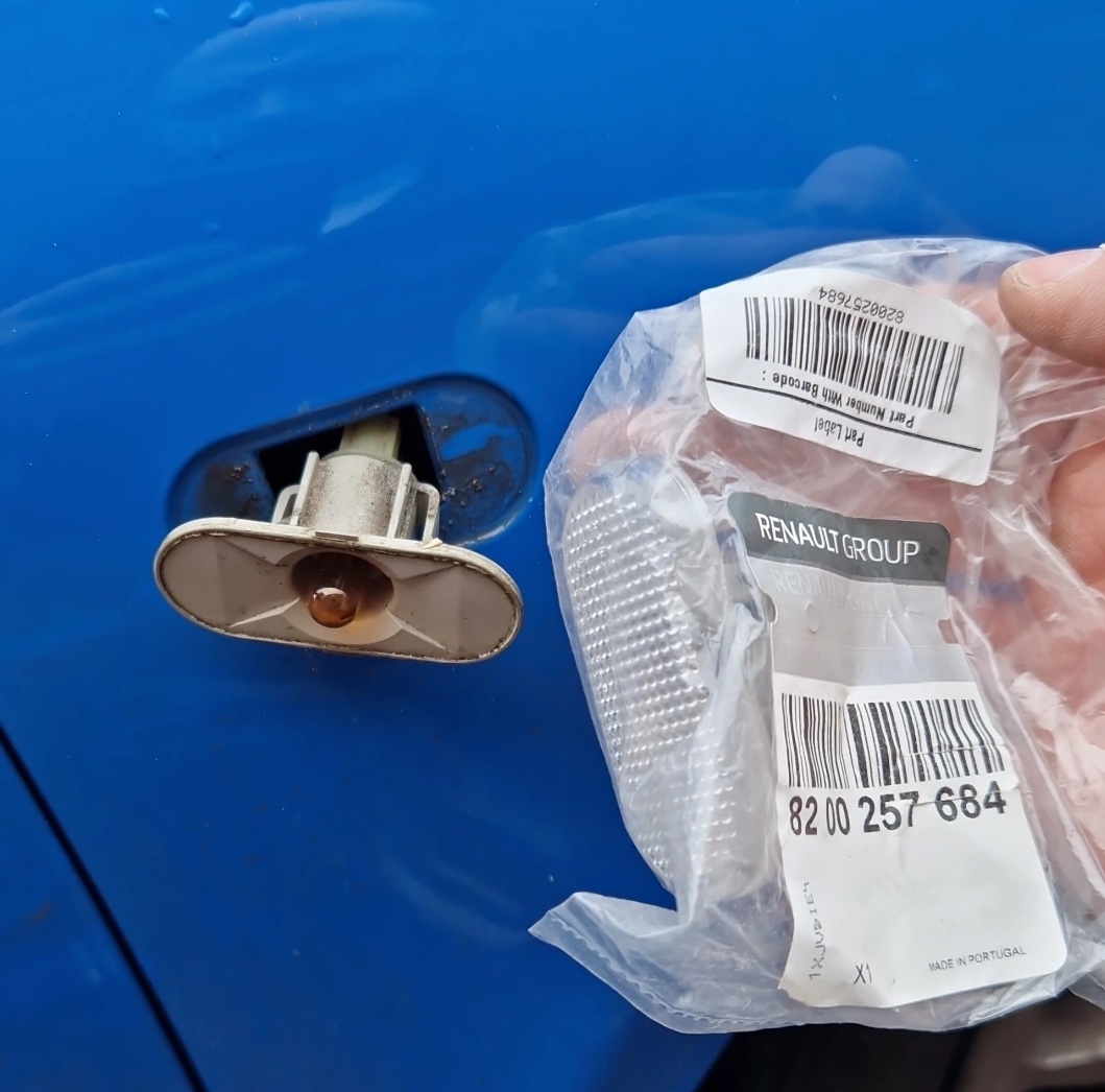

Lost an indicator lens at Llandow, replaced:

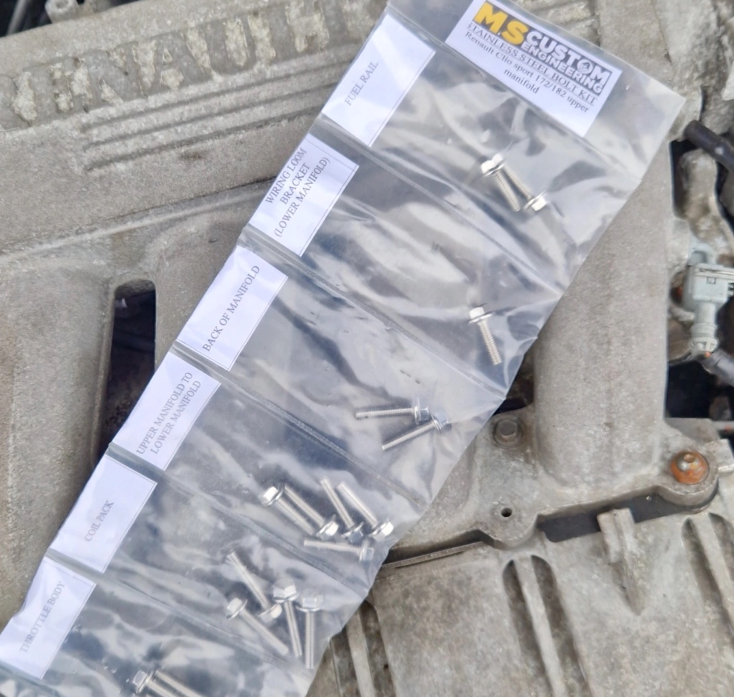

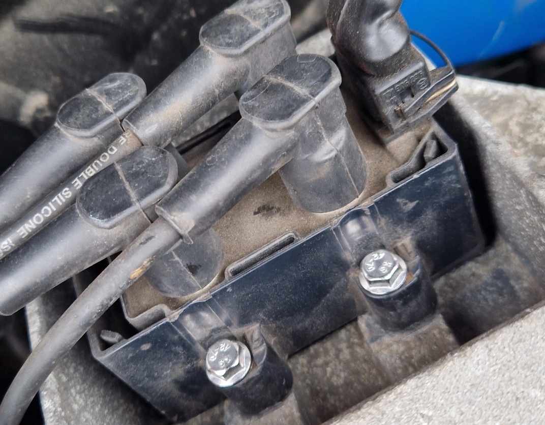

I noticed my coilpack was loose, I have no idea where the bolts went....*gulp* Sourced a lovely packet of bolts all labelled up from M.S Custom engineering
And bolted down:

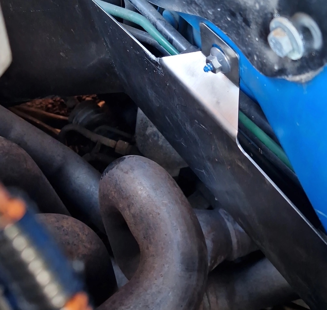

I noticed the above whilst fitting the 172 Developments heat shield. Again and other nice little addition.

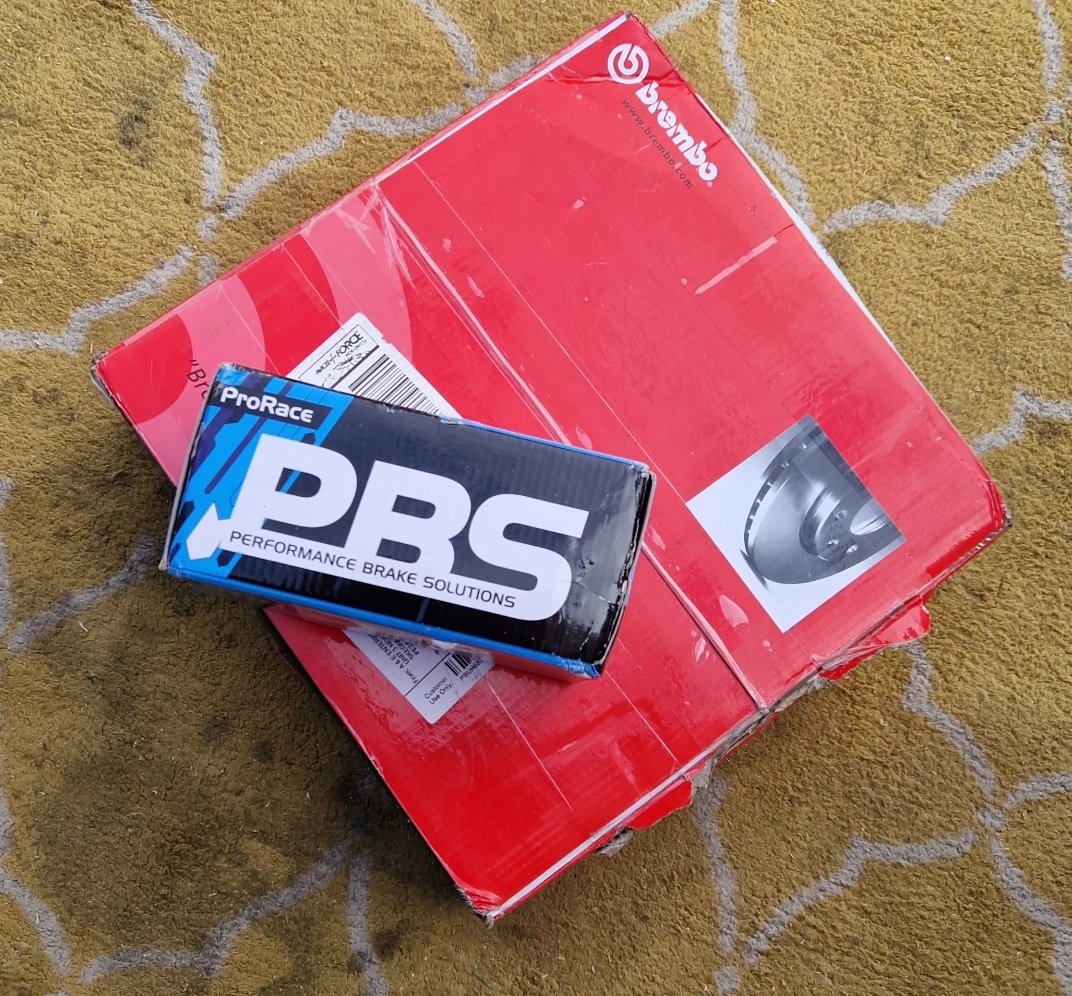

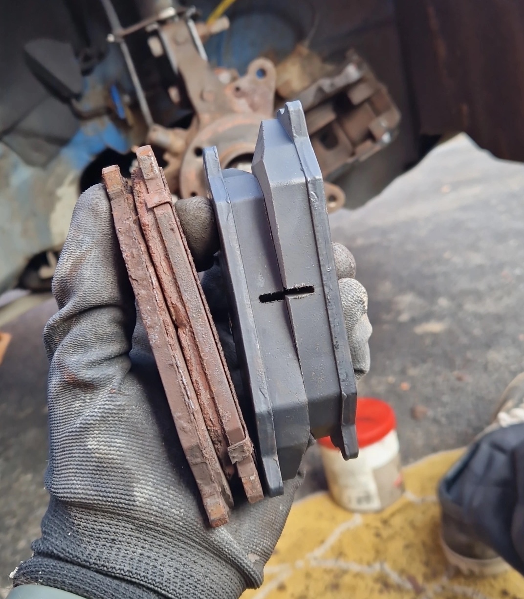

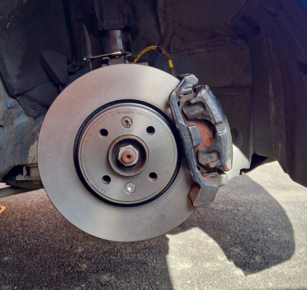

The brakes were an unknown brand and after Llandow, they were cooked.
They look proper grotty. Fortunately, everything was nicely copper greased and nothing fought me!
I opted for PBS Race and Brembo HC discs.
Comparison - Loads of life left in them....
Finally all done:
As you can imagine, much improved. Brake fluid change next.

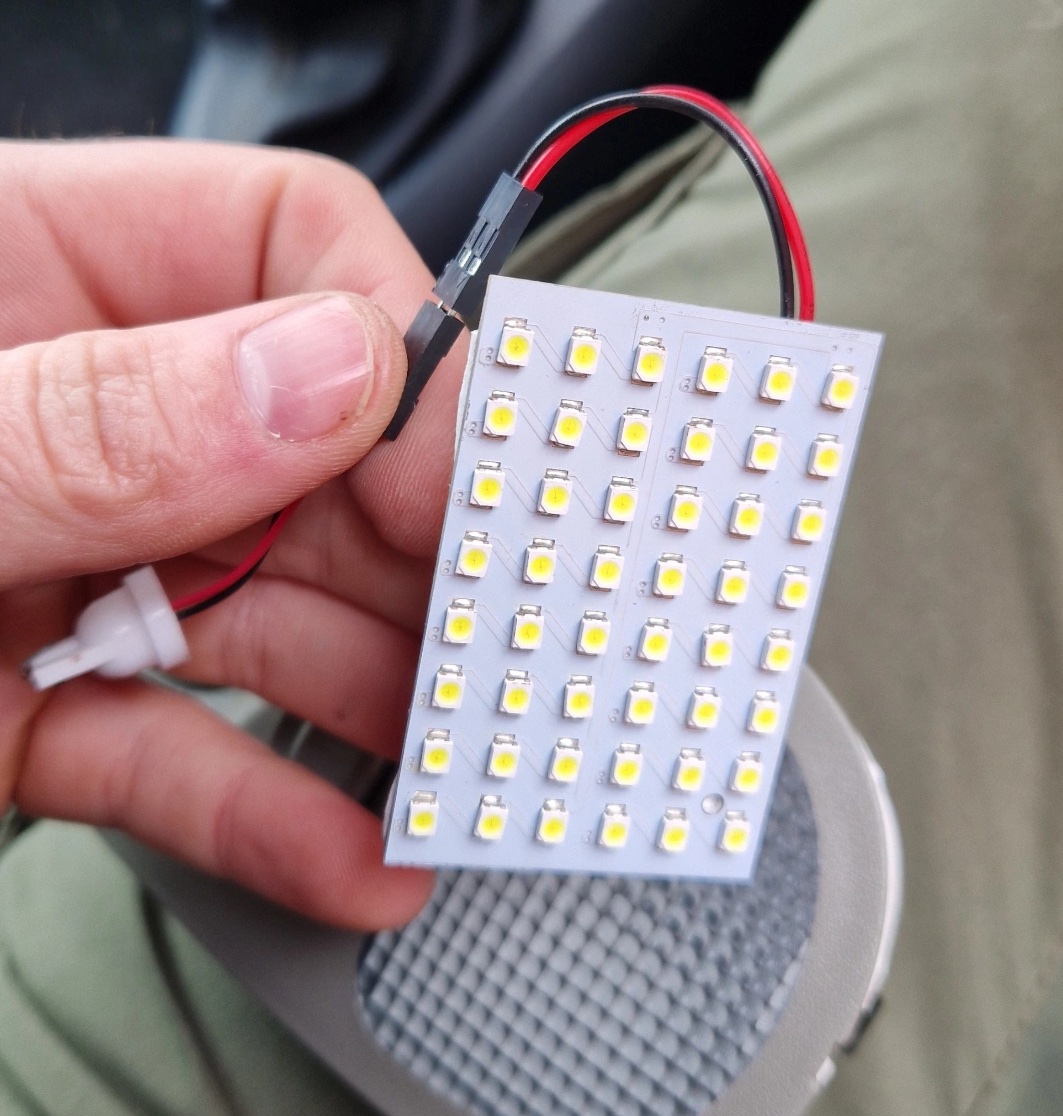

The centre interior light was super bright and would ALWAYS bit lit. I took out this monstrosity

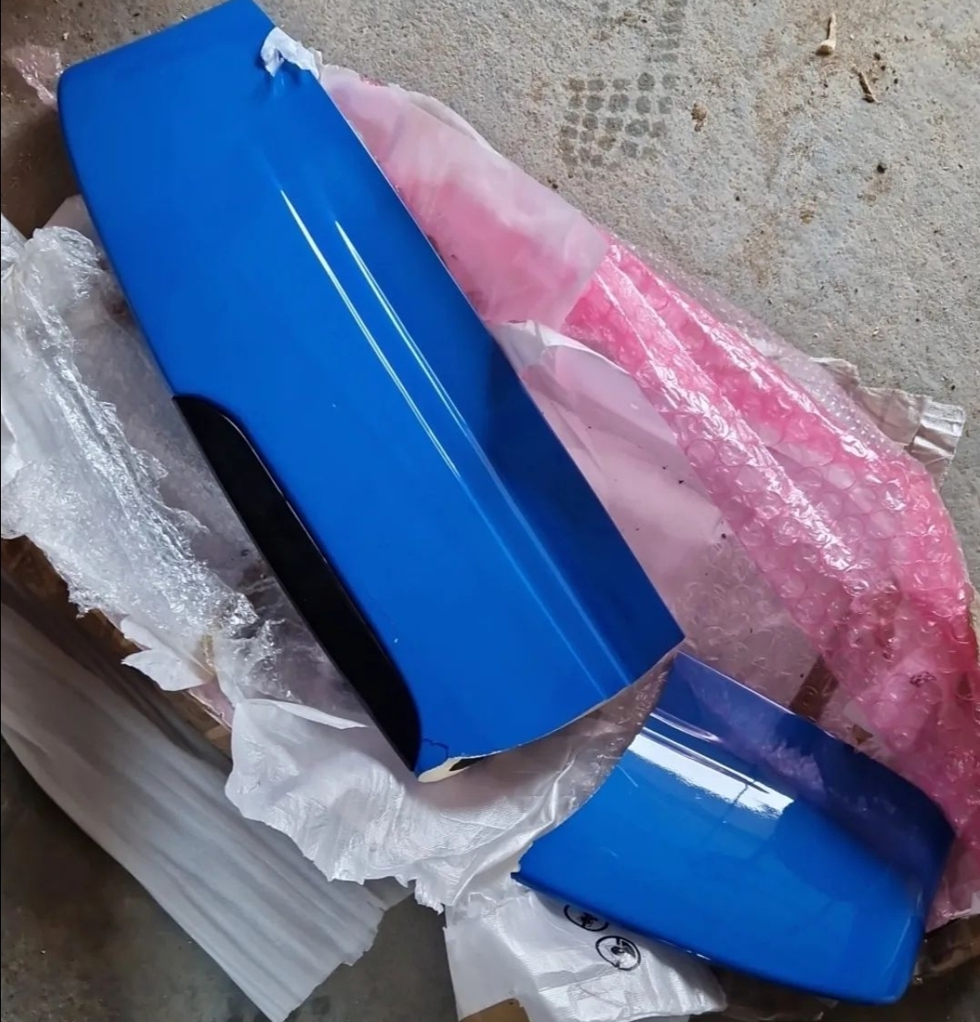

I had a parcel arrive a little while ago from @Coops Mk1 a lovely v6 spec spoiler in RB. Sadly it arrived like this:
Gutted was and still is an understatement. Credit to @Coops Mk1 for sorting me with a refund and dealing with Royal Mail.

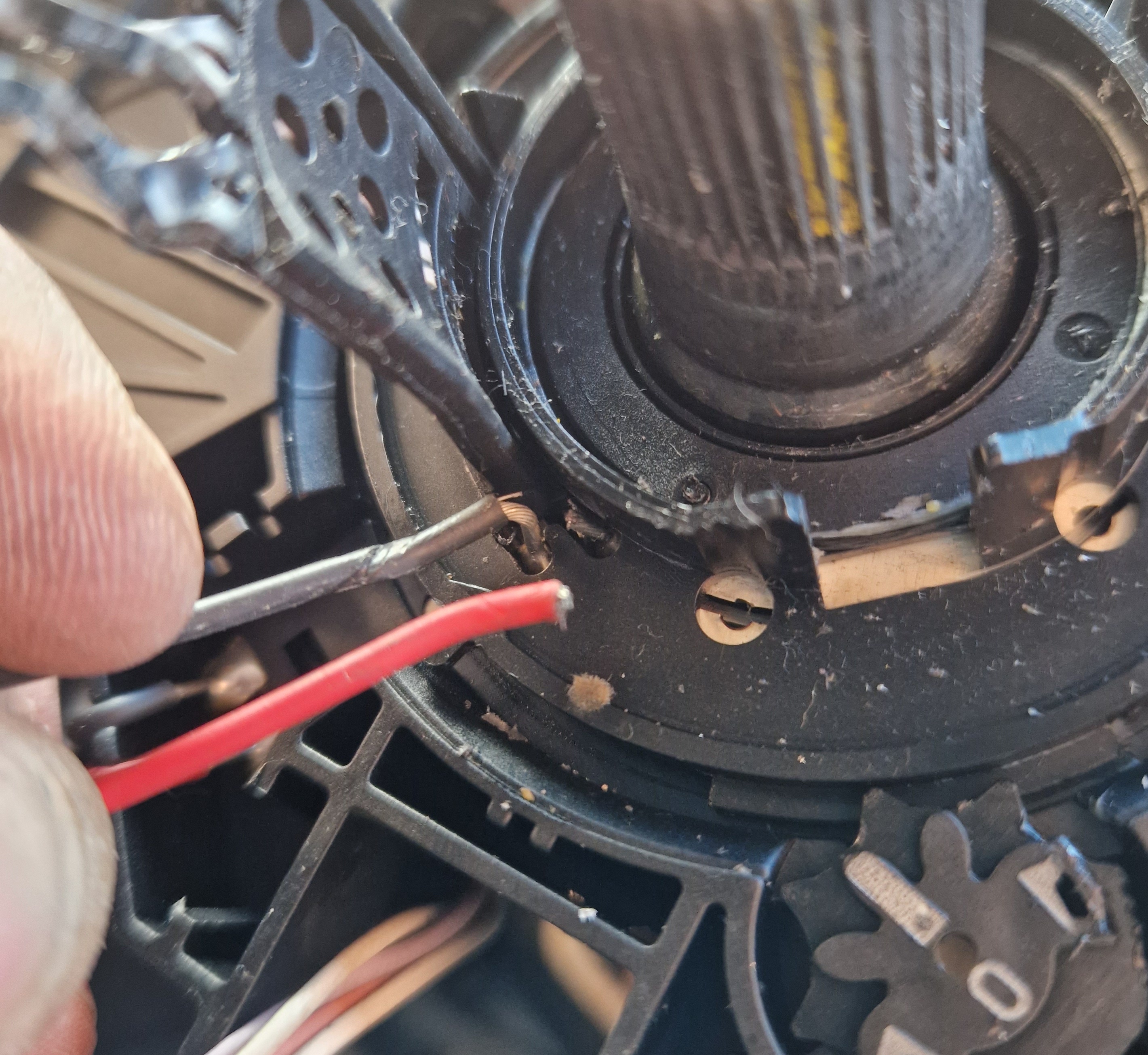

Since I've had the Clio the horn has never worked, even with the OEM wheel. I bought a volantech horn panel a while ago and when I came to fit it, I found out why the horn didn't work:
Yep, that's a snapped horn wire with nothing but a little nib to solder it back on to. I managed it, god knows how.

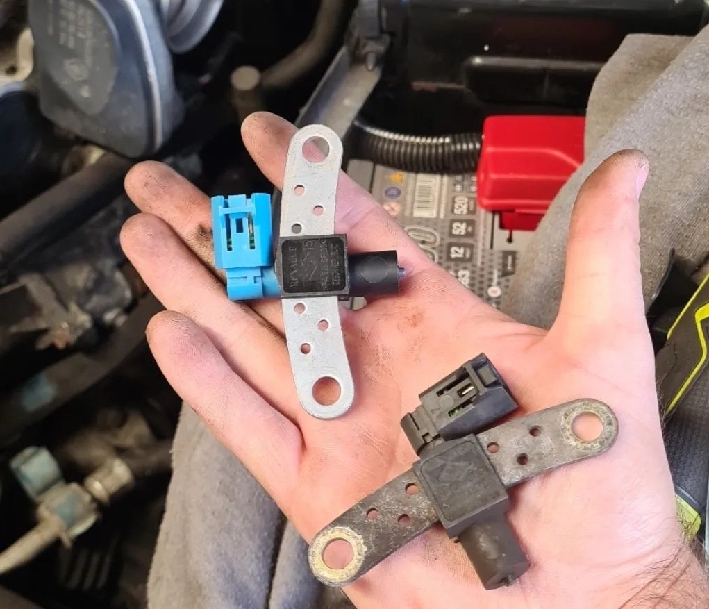

At some point I fitted a new TDC sensor and wiring too. Awkward AF to get at.

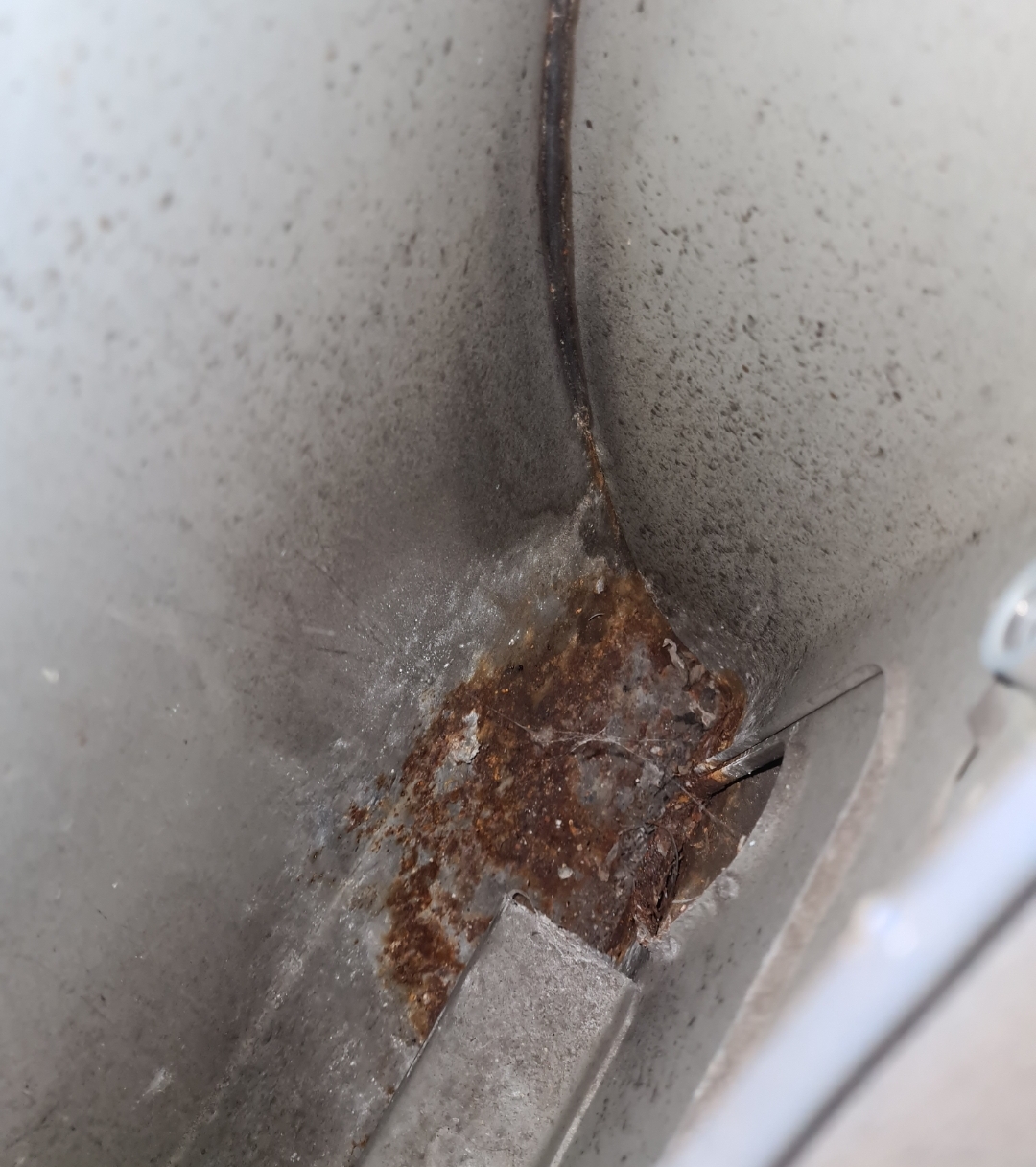

I have this issue....

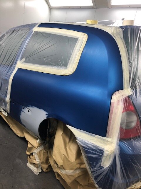

I'm having a few quotes to repair this and looking to book in ASAP. Problem is the quotes I have received range from £400 - £1700.

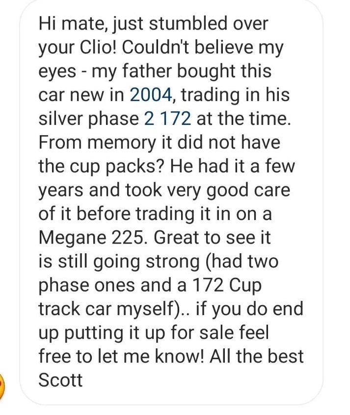

Ending on a high, I received this message through instagram:

Looking mega, catch that rust now before it looks like mine....
And yeah what a fucker on the Spoiler....sad face
I had both sides done on my old cup with the rust & cost just over a grand.That was about 4 years ago now & im looking to do the same with my 182,hopefully wont be as much as only tiny amount on my titanium,where as the cuo they had to cut out and weald in.

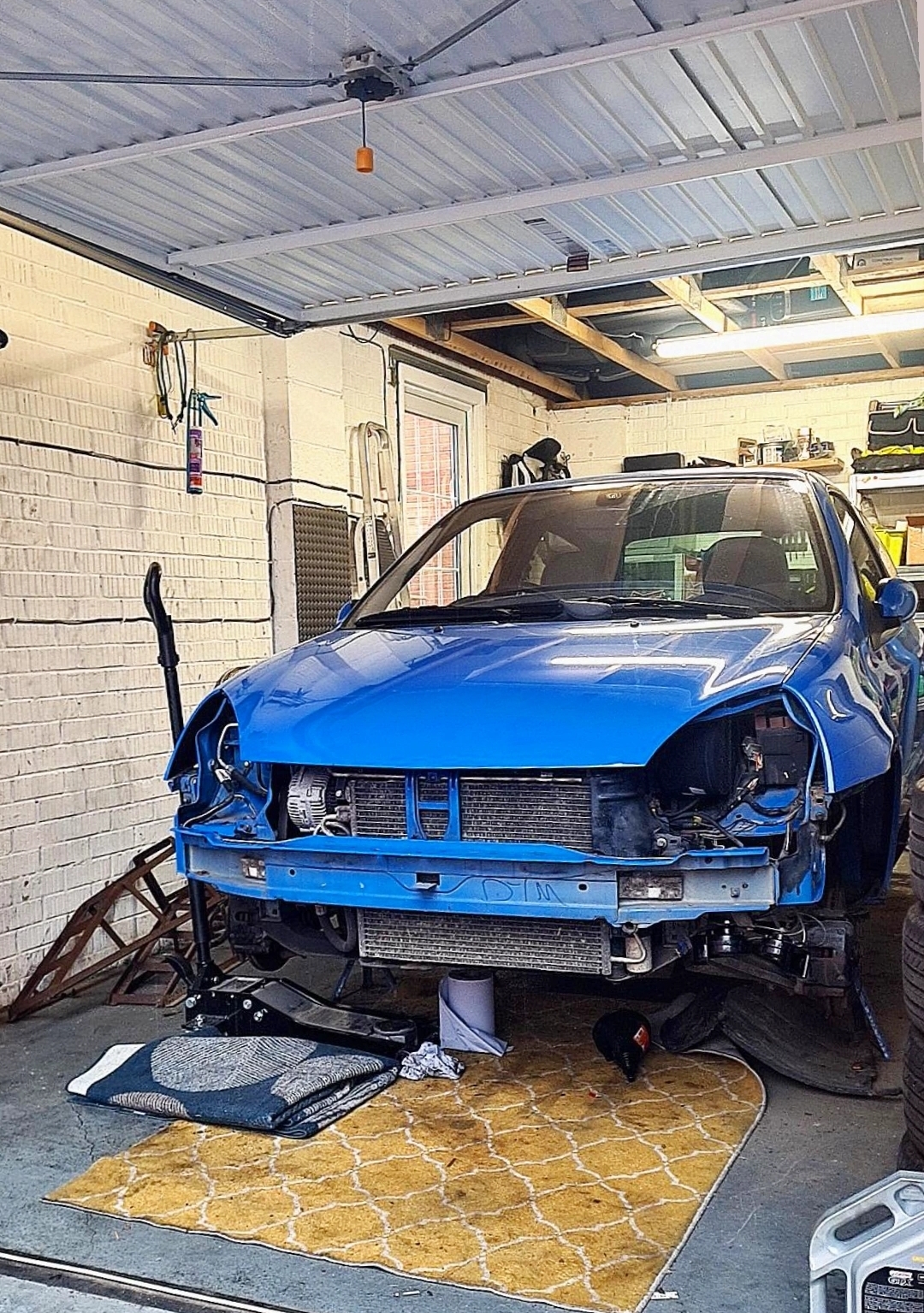

I chased a 3rd quote today, they're renound for their work in my part of the world. It's a busy place, which I know speaks volumes but chasing for 3 weeks (they replied once and were nice enough) is annoying.
Hopefully I'll have it booked it and I'll get this bit and the fuel filler done too.
I'd normally see some rust and freak out and ship it on, but this Clio has gotten under my skin and drives better than any of the others so I think it'll be 'worth' my time.
No real updates as I'm waiting for my slot at the bodyshop, my garage is full of building materials which is stopping me from getting stuck in and the weather is mehhhhh. I've also been busy with my daily.

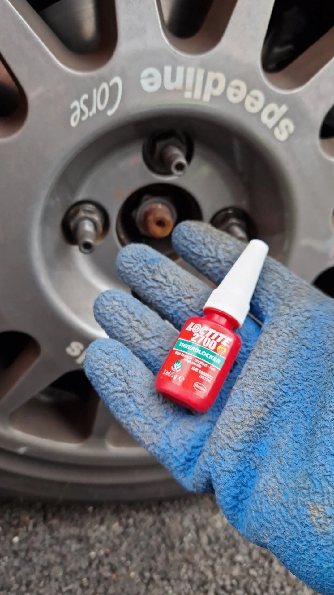

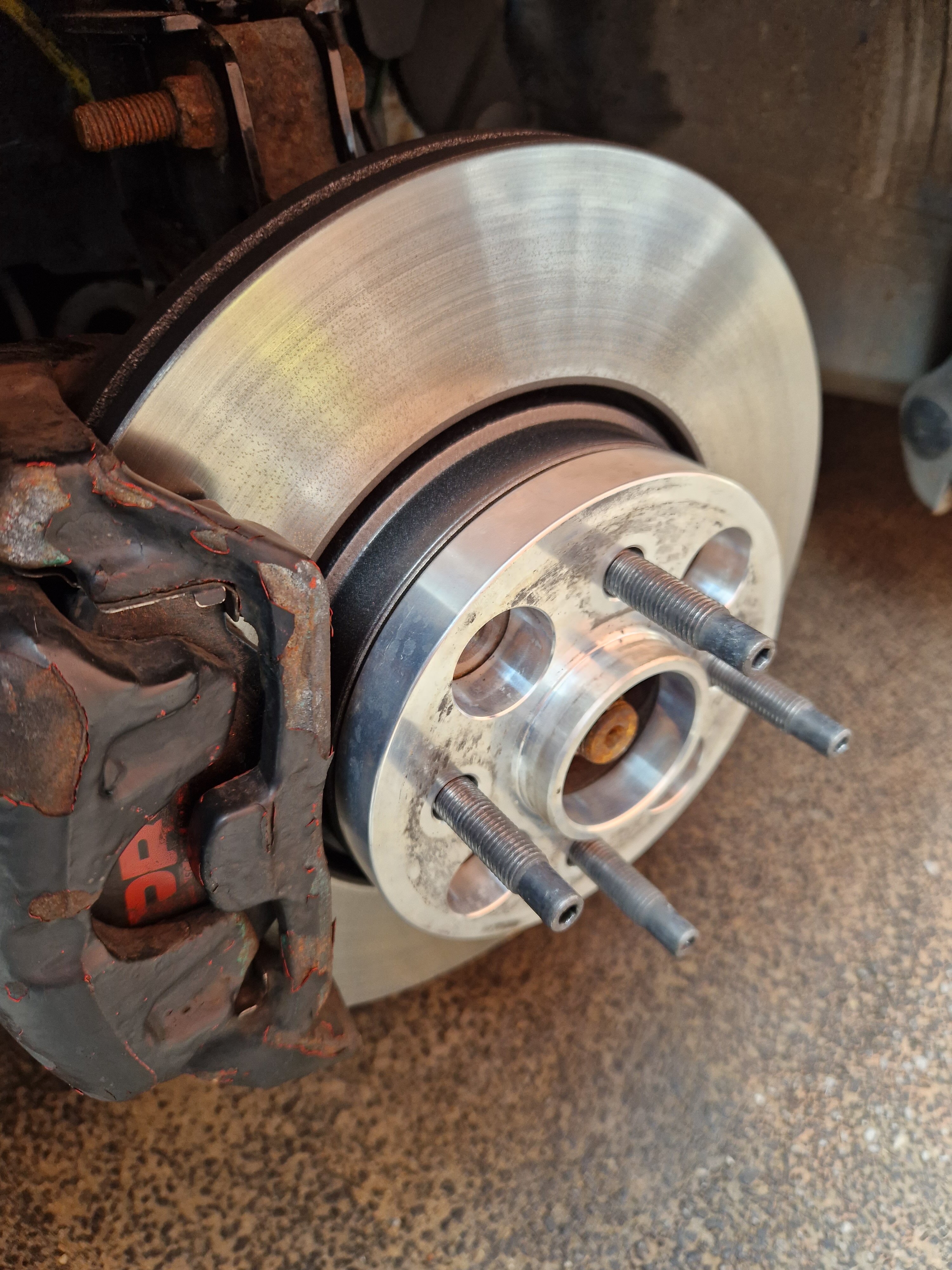

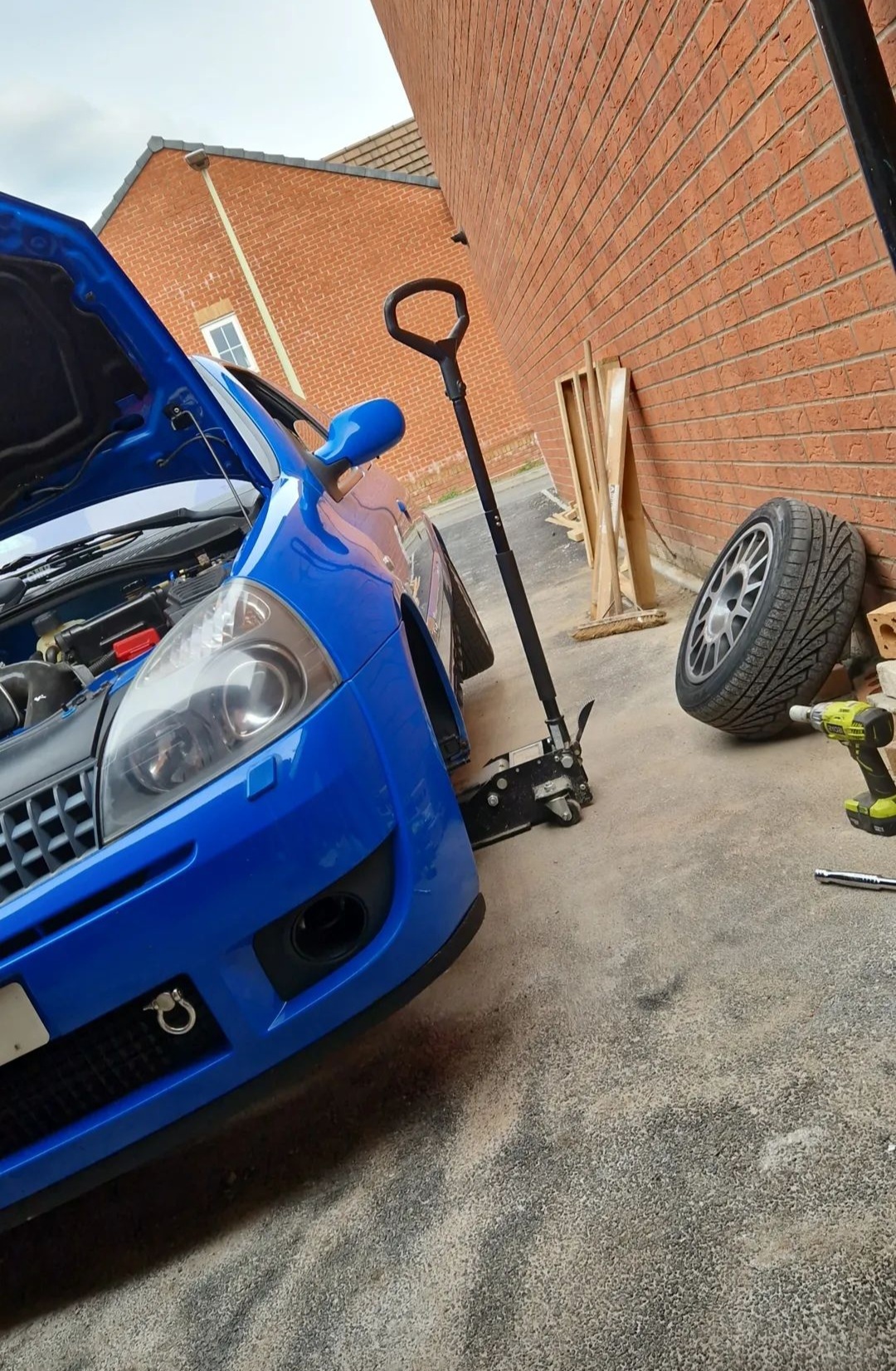

I did find time to fit a stud&nut kit and some 18mm spacers to the front of the car.
There's not much thread left on the end of the stud but enough to torque up. I may drop the spacer down to a 10mm if any one has any for sale?

Threads look fine on those studs, what length are they?
I've never believed the spacers make it handle worse theory. Mine still handles great with 20mms on
Studs are 82mm tip to tip.
I think it will handle better with smaller spacers mate,i have some spacers in the shed if interested.
On the spacer thing, it's a real mix of opinion. Some say no bigger than X and others say (like @Louis ) 20mm is fine. I've not driven it yet so can't comment.

Spacers:
Today I drove the Clio for the first time since fitting the spacers. Can't say I feel any difference in the way in drives. It is scrubbing on what's left of the archliners.

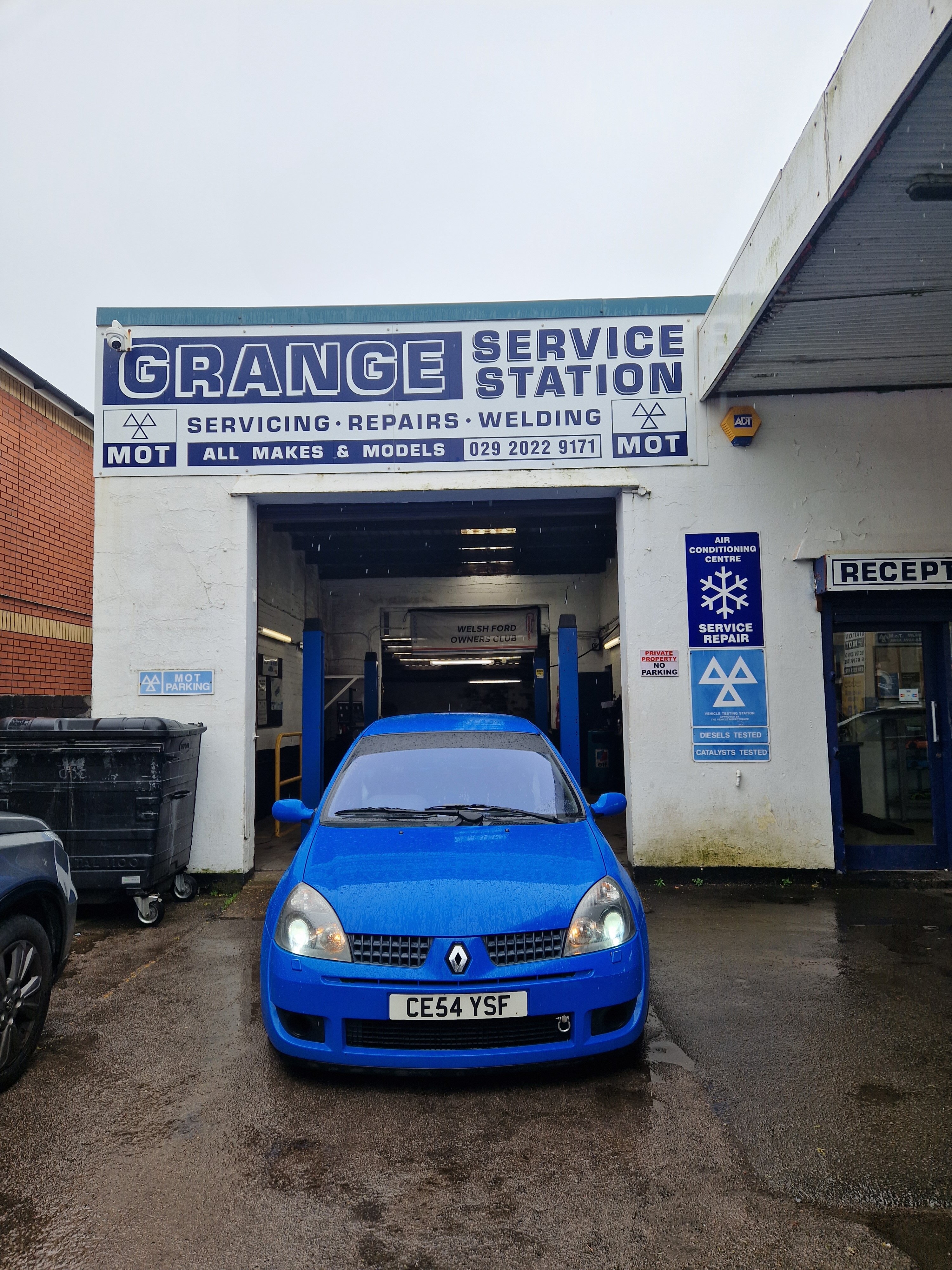

Brake fluid change:
The only fluid I've not changed in the Clio was the brake fluid, having recently done a track day and replaced the discs and pads I thought it best to do the brake fluid next.
I can and have done this multiple times but this time I left it to the pros. Combination of reasons, weather, time and I'm too old for this s**t.
I took it to Phil at the Grange Service station in Cardiff. The majority of the Clio's history is from the grange and Phil being a former Renault Tech (and having had many clio track cars) knows his way around them.

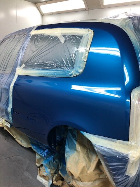

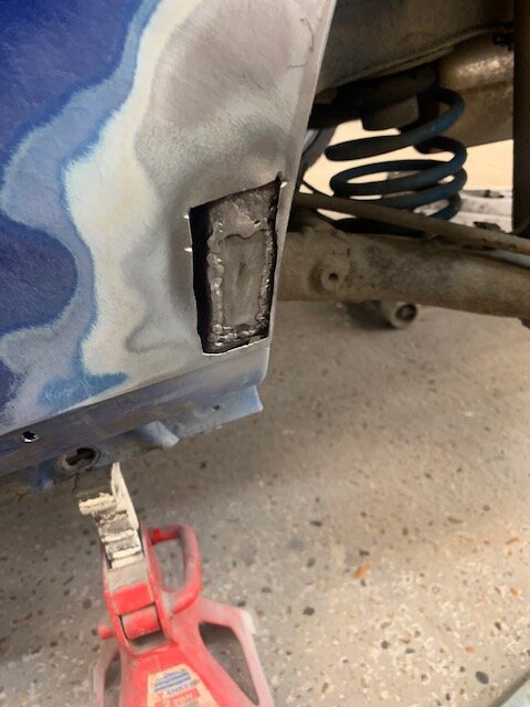

Next - Rust repair/body work
