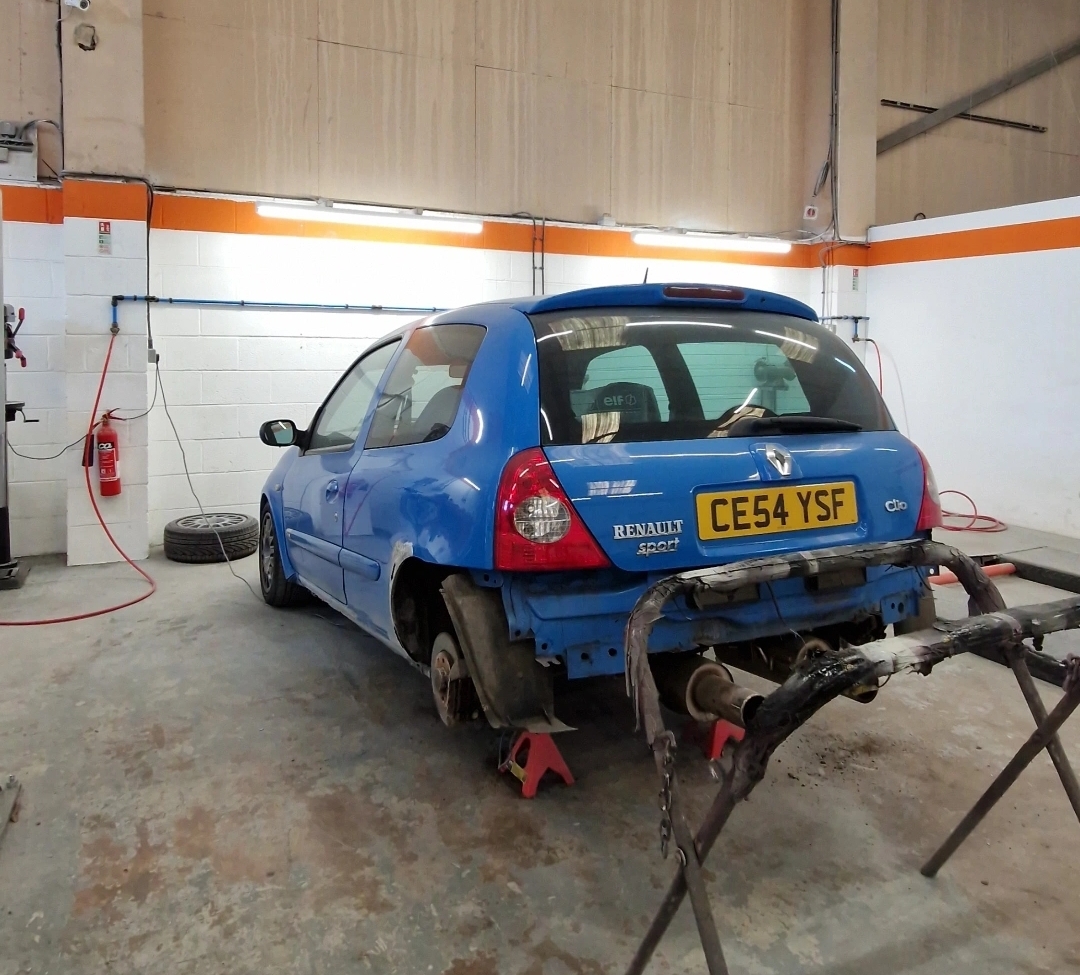

Bodywork update.

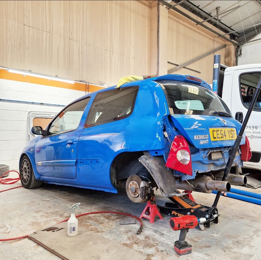

Firstly, it's in the bodyshop dropped it off 2 weeks ago
Any one else have anxiety when dropping a car off to have work done "please don't ring me with bad news!"
2 weeks later and no phone call, no news is good news?
There's a play centre right next door to the bodyshop, so using my daughter as a ticket to pop in to the bodyshop I did just that.

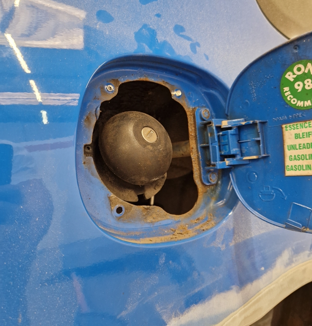

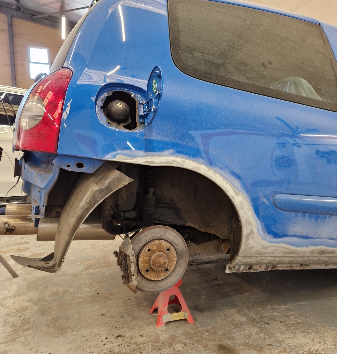

Brace yourself:

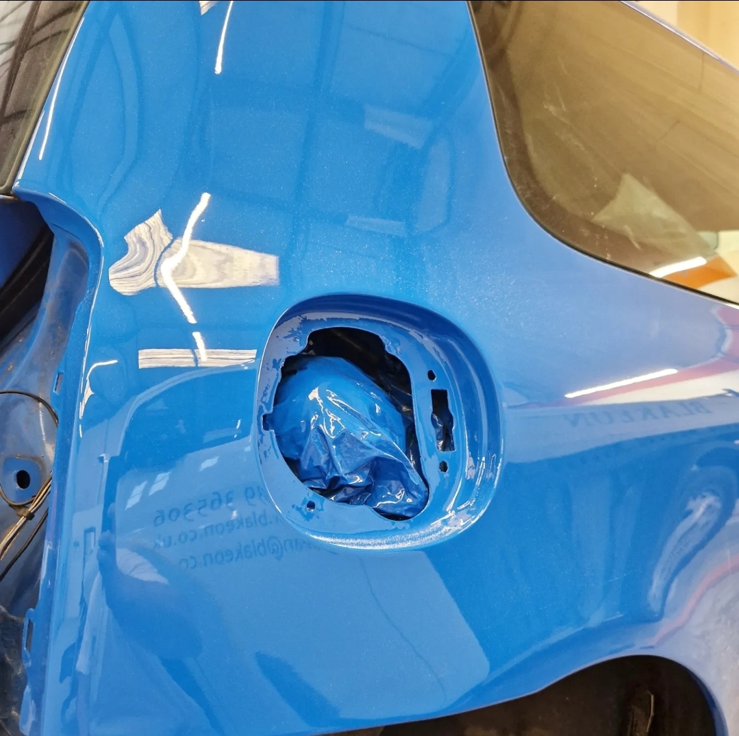

The fuel cap surround is yet to be done...

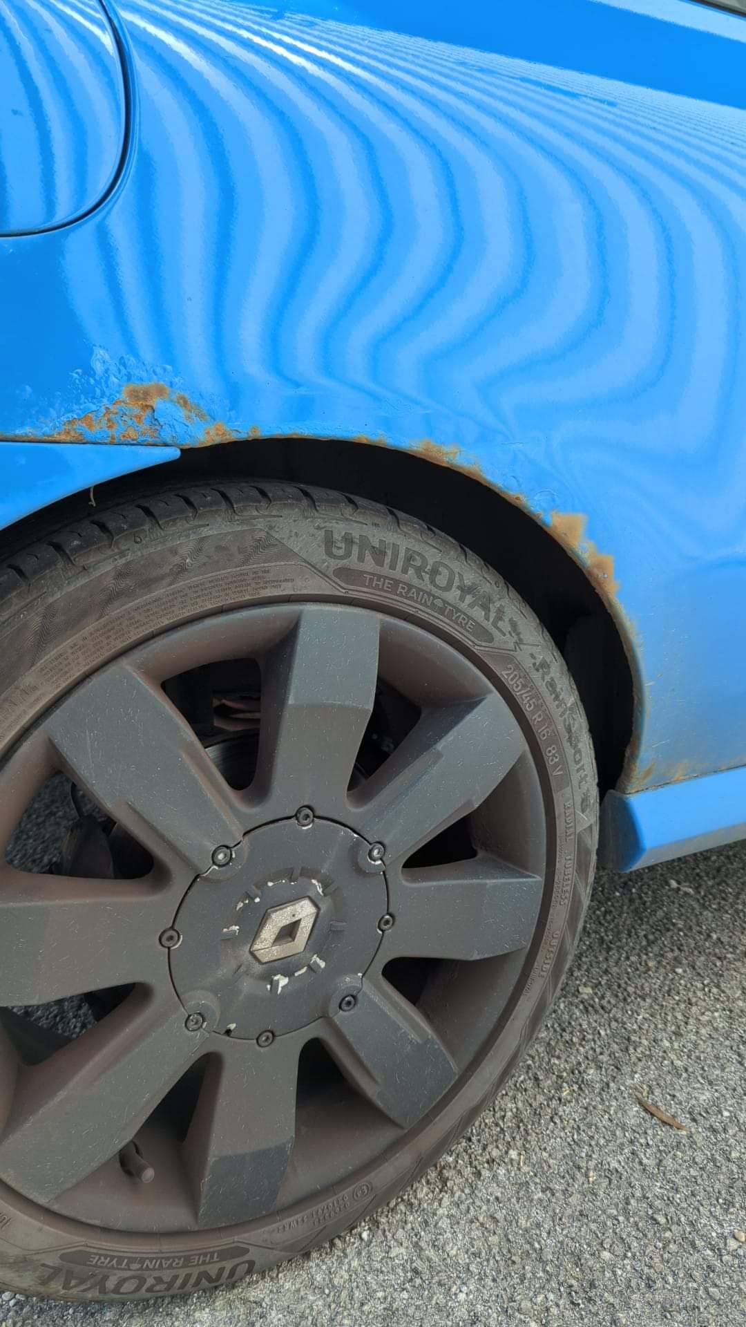

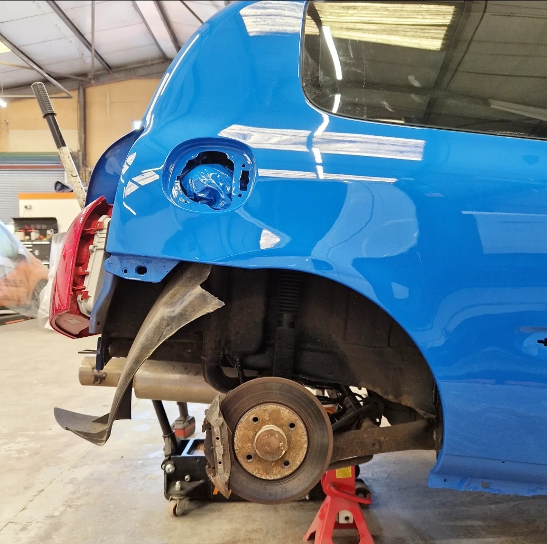

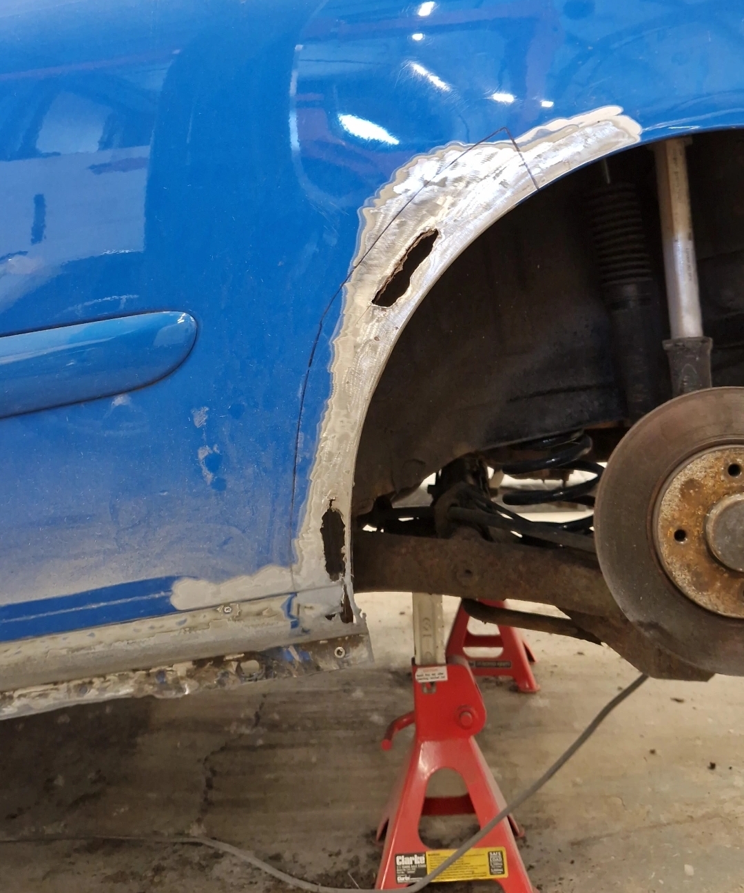

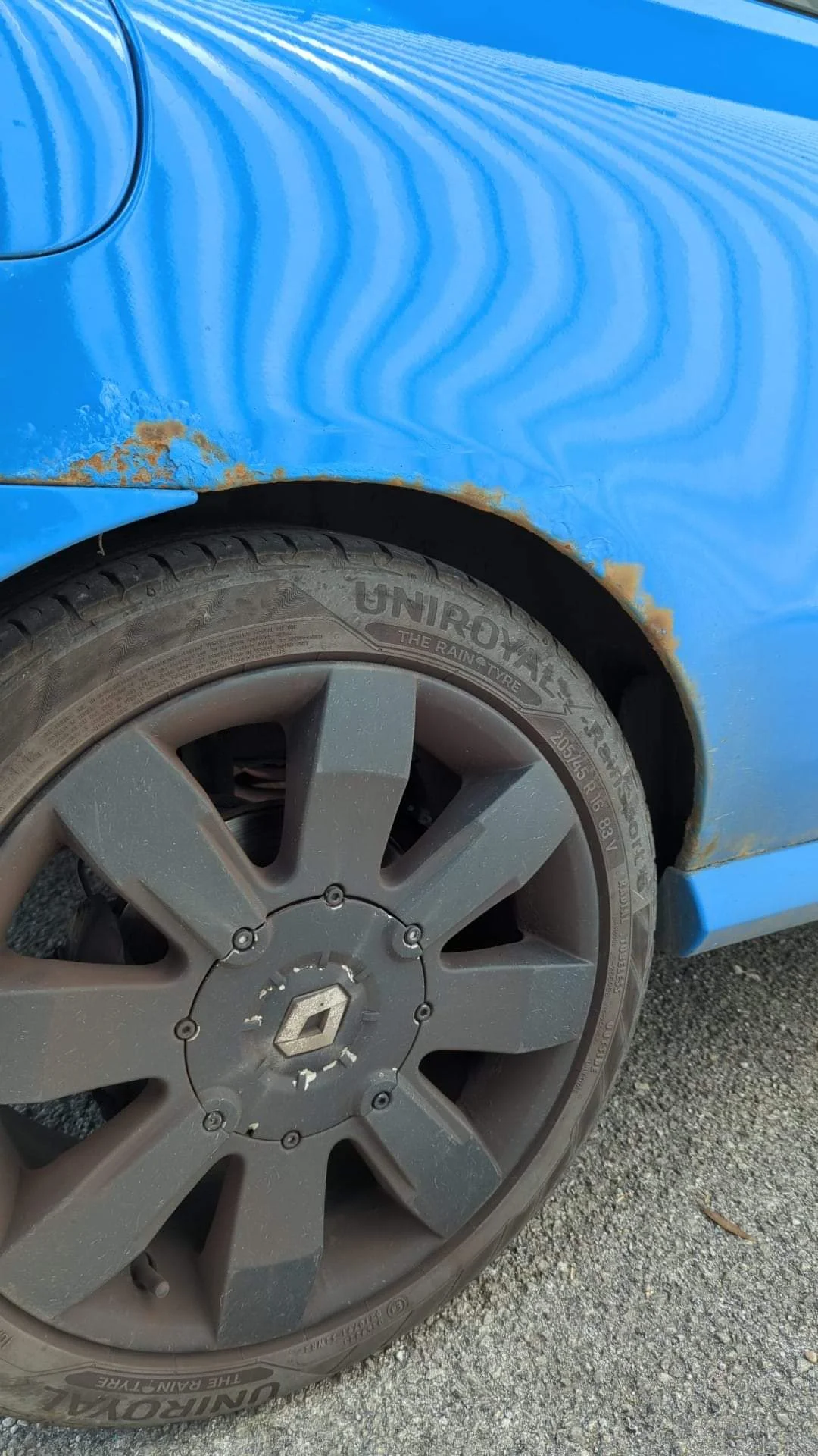

I was originally booked in for the one arch but in reality both needed doing or would and as it was there, they just did it.... Fortunately they said they'd given it a good poke and there's nothing else to be concerned about.
My wallet and I are relieved it's no worse.
Credit to the bodyshop, their admin may not be the best but there work and work ethic is right up there.
Looks like someone has been at the one arch with filler before! Fair play getting a proper job done bud!

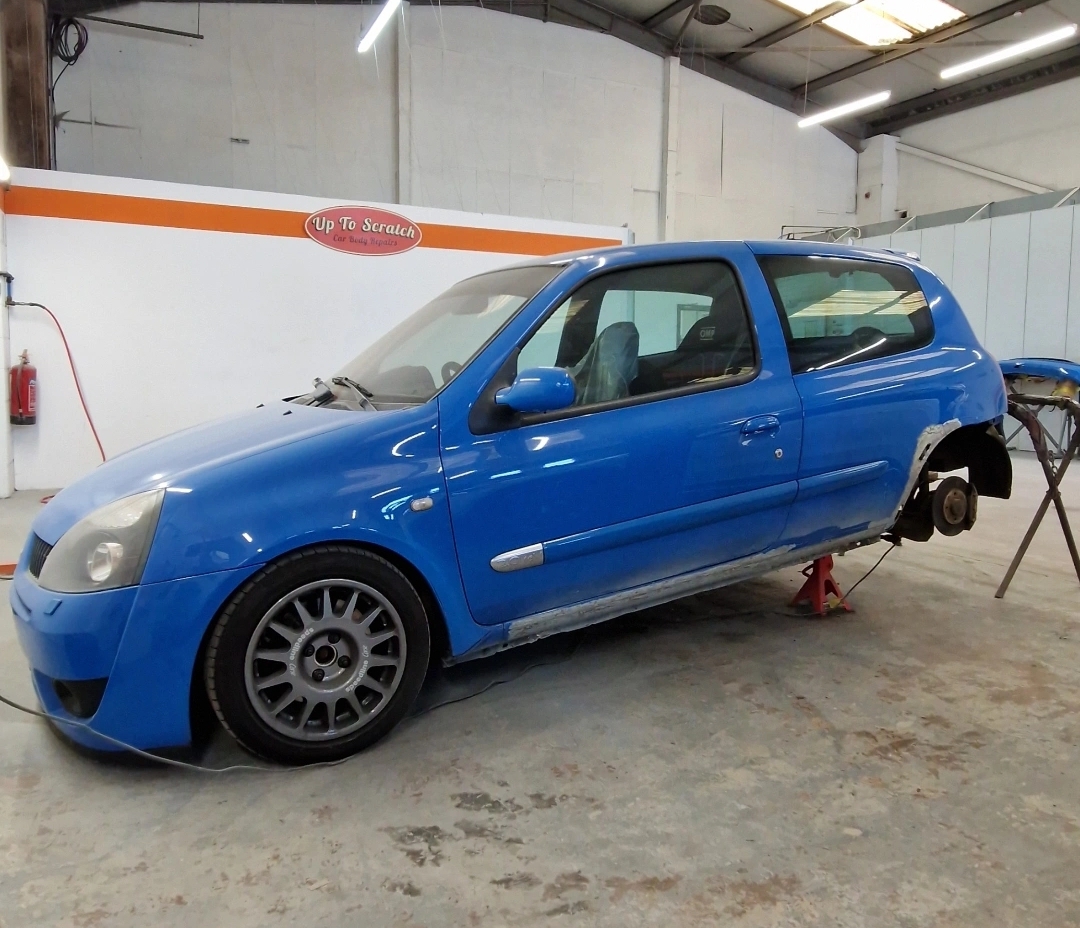

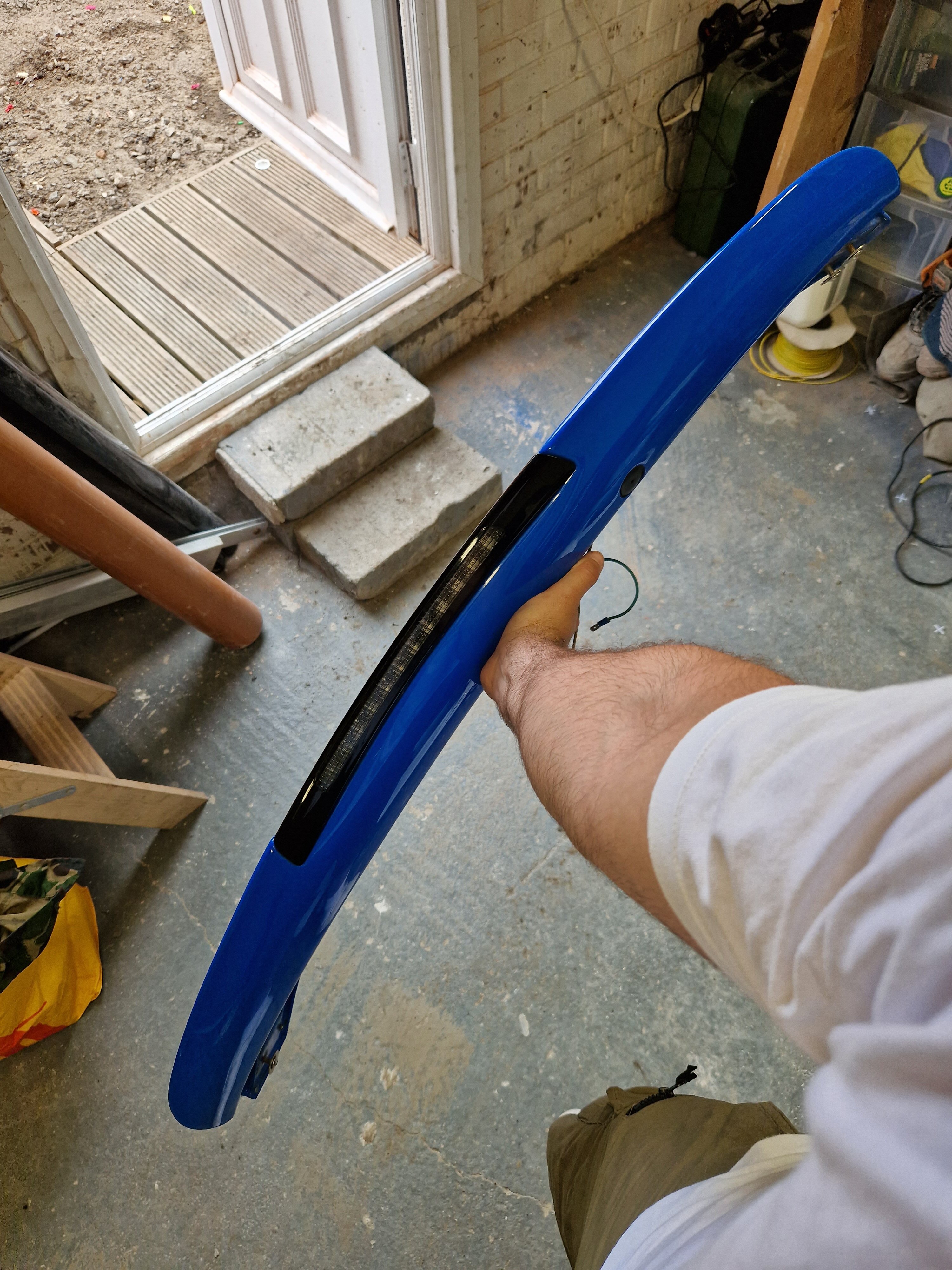

Bodyshop emailed earlier in the week with an update and I asked if I could drop the spoiler off and have a look at it, which they had no problem with.
Dropped the spoiler and side skirts off which will be fitted when I collect next week.
I spoke to the actual fabricator to understand what they had done etc for full peace of mind.
They also took photos along the way too.
I'm really pleased with it and looking forward to getting it back.
It’s a constant fight with rust on these cars so it’s great to see you’re committed to it. If they’ve chopped the rot out, you should get a couple of years out of it before it needs addressing again. Lovely work!

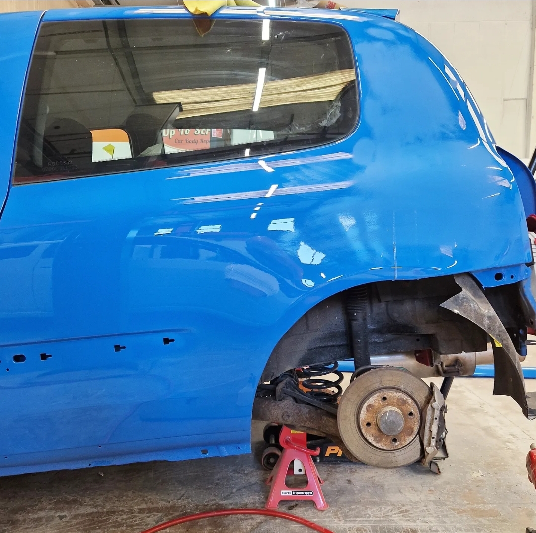

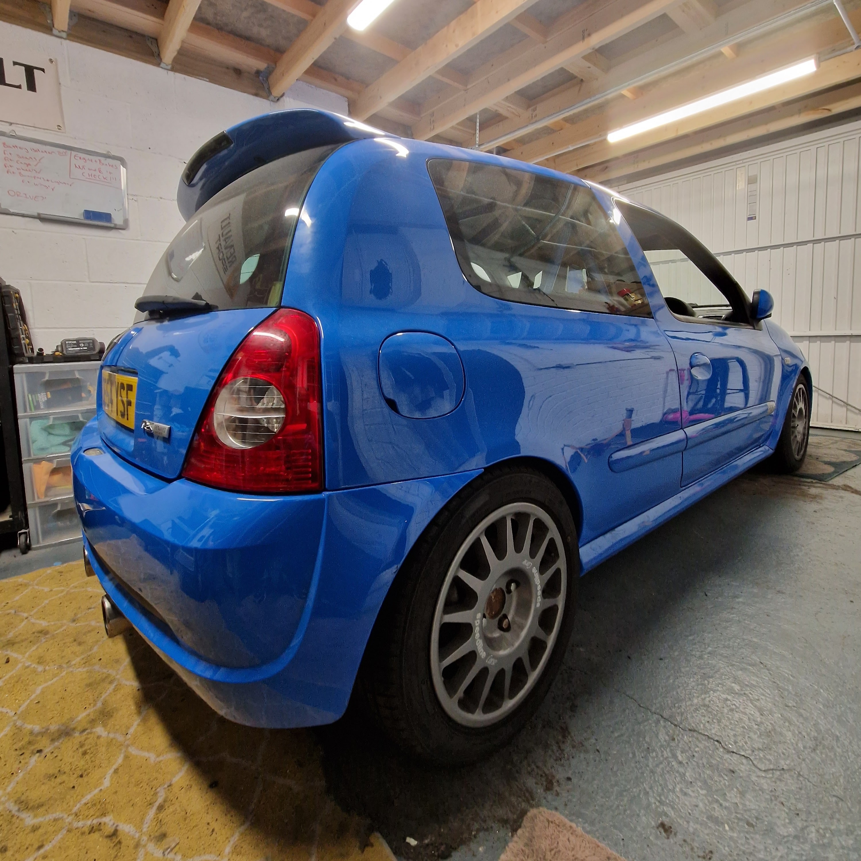

I collected the Clio, probably 2 weeks ago now, thought I'd updated this....anyway here it is
It took a little while longer that anticipated, however it was worth the wait. The bodyshop also fitted the trophy spoiler which really sets it off.

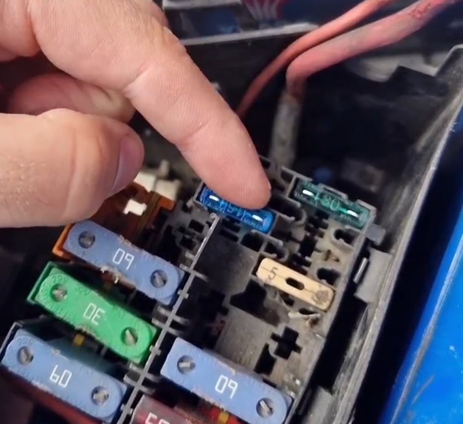

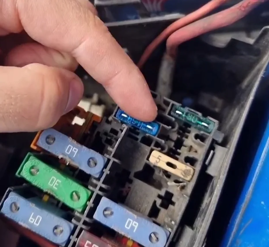

I stuck my head in the fuse box under the bonnet and everything looked OK. The fuses all looked good. I thought, "I'll just change them, they look OEM". Then it fired back in to life, thank god!
The fuse I question
That's it for this instalment.
Should add, the USB port/cigarette lighter still doesn't work but the CD player and climate does.
Any help/advice/common issues before I mess something else up?

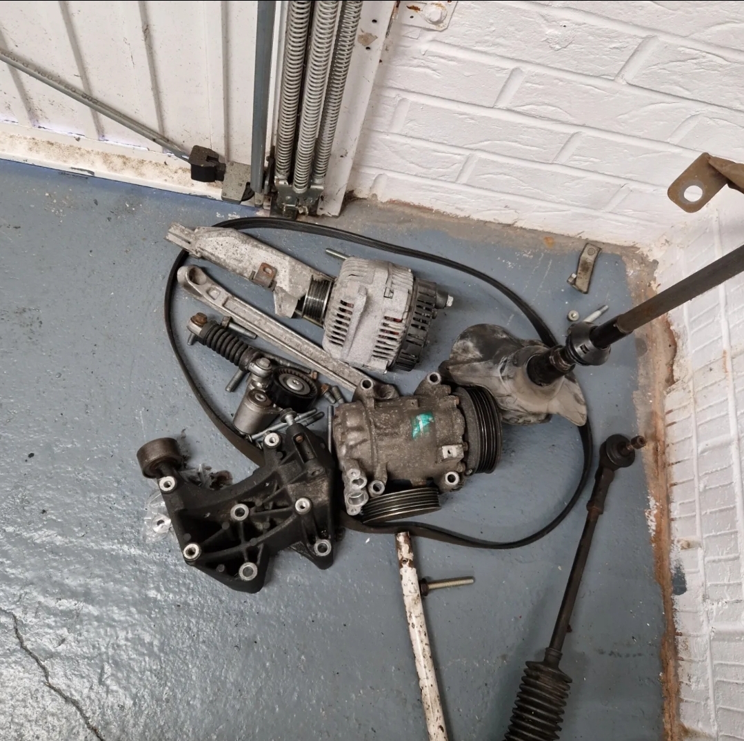

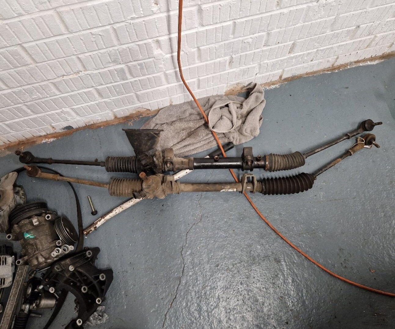

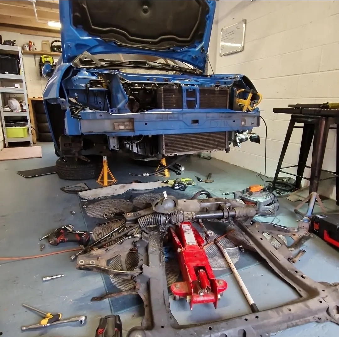

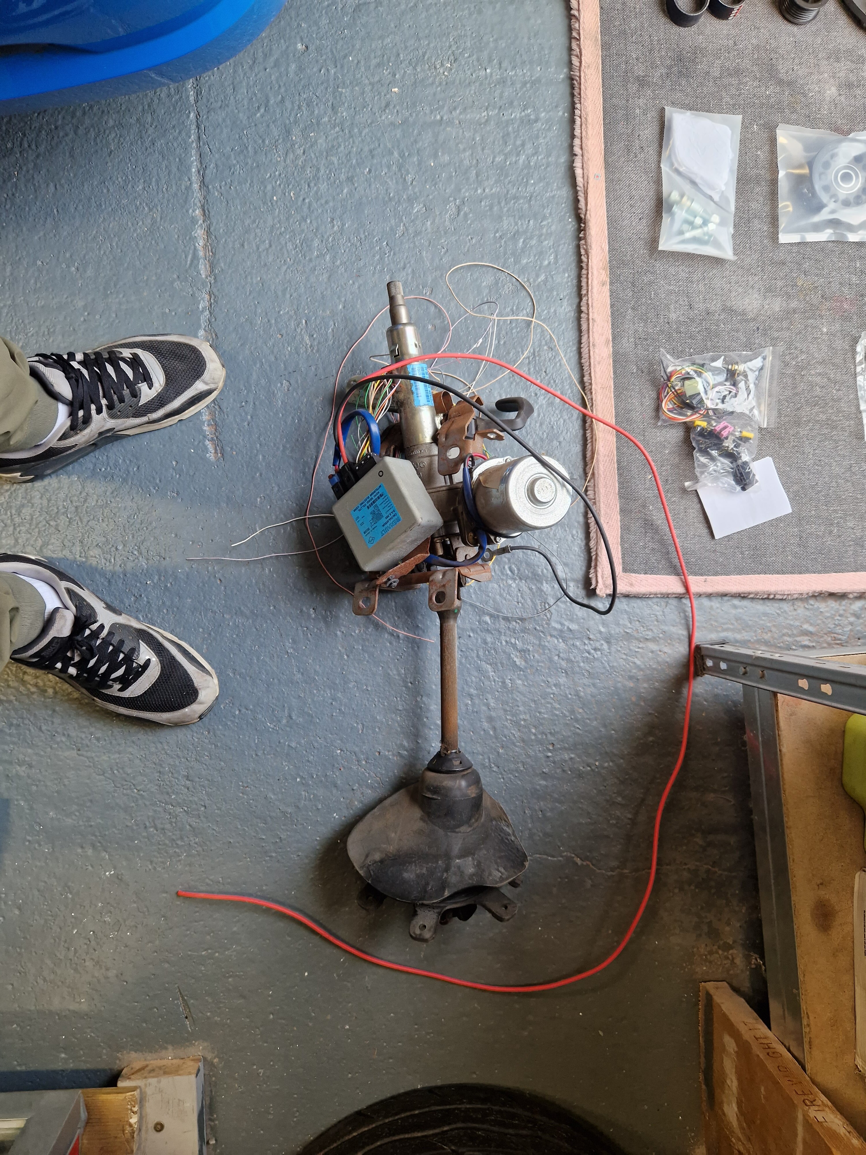

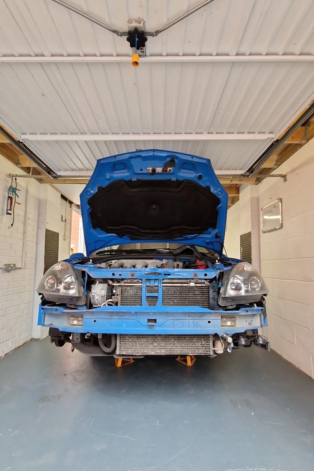

I wanted to fit EPAS as my PAS system was leaking and at the last track day I was black flagged as the fluid was causing a smoke screen and rightly the Marshalls flagged me in.
I sourced all the EPAS bits, Column, Portuguese ecu, loop rack kit etc.
What I didn't have was the knowledge of how to do it. SOS sent out to Kiv (need to find his user name on here) who has all the knowledge and kindly made the trip over to me from Bristol to South Wales.
To make it worth Kiv's while and to get the most out of his knowledge I also sprung an AC delete and battery relocation on him....
How it started.
Things started well(ish) and without Kiv I'd have been totally out of my depth.

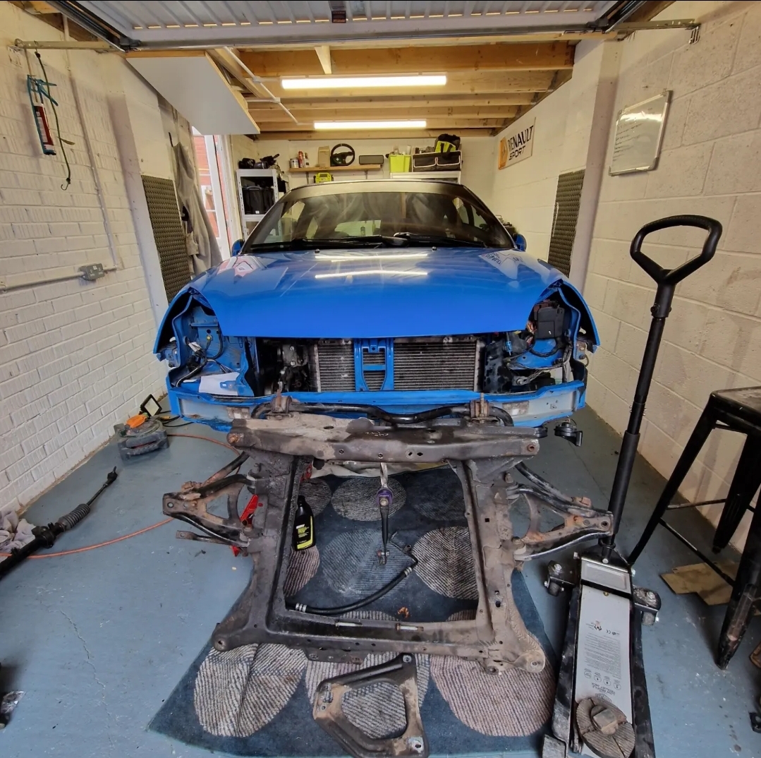

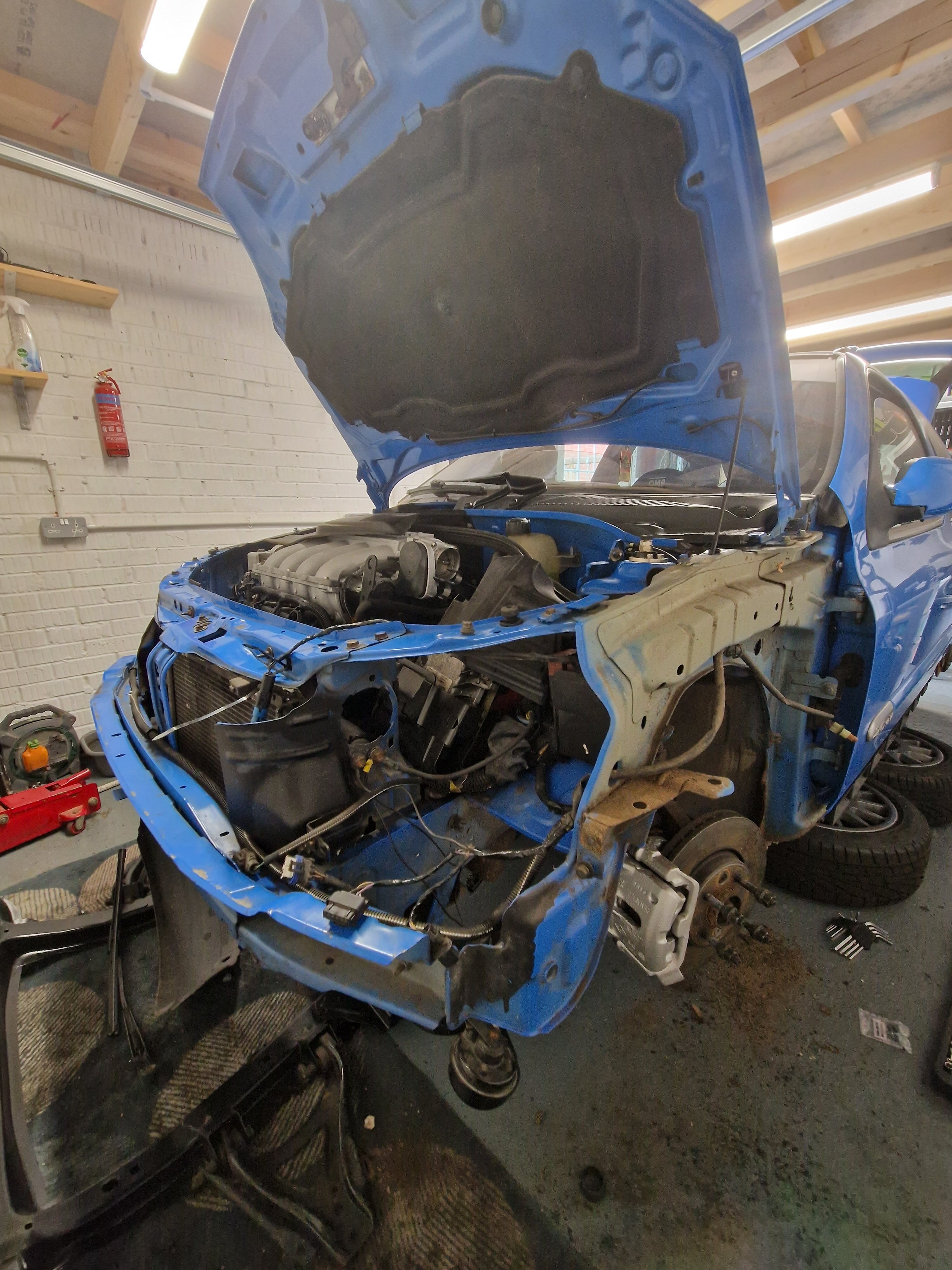

All was going well until we got to removing the PAS lines off the rack. One would not come off. Left with little choice, we dropped the Subframe. This was a good idea at the time, until we had the battle of our lives with the captive nuts/Subframe bolts.
Some of the bits that won't be going back on.

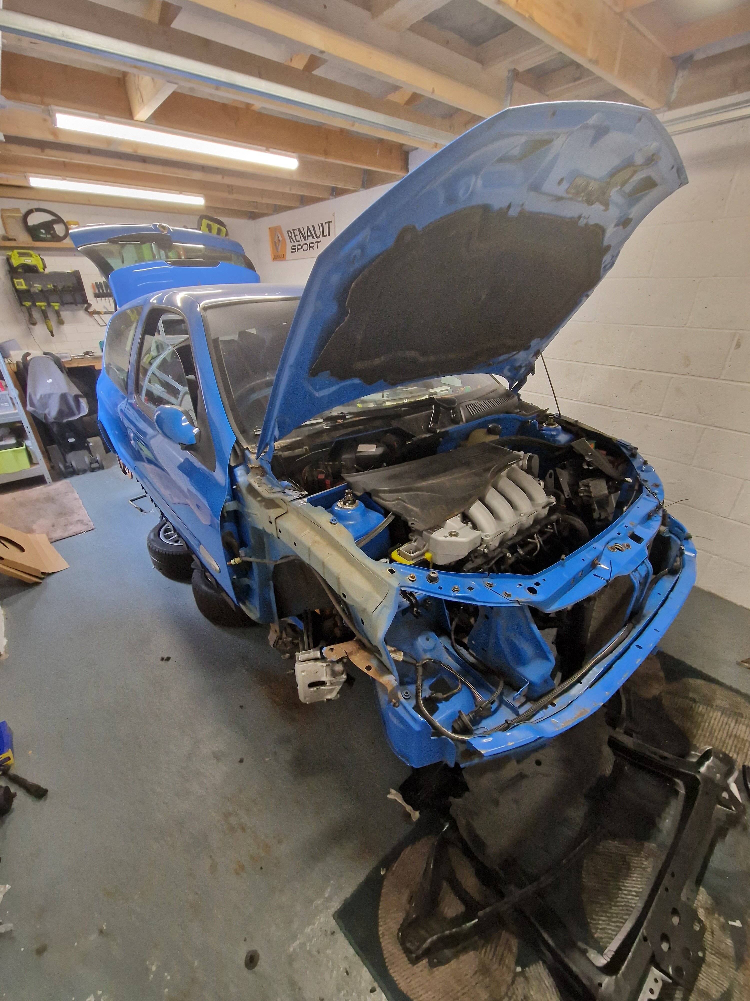

Can't underestimate how bloody difficult it was getting the Subframe off with the bolts spinning or not moving at all with all our effort. Out came the angle grinder.
How it was left...
There's more updates to come but wanted to give a massive thanks to Kiv firstly and all of those ClioSport members on Instagram who dropped me messages of encouragement, advice, uselessness or banter during this leg of the build.

It goes mildly down hill from here.
How it started.
How it was left...

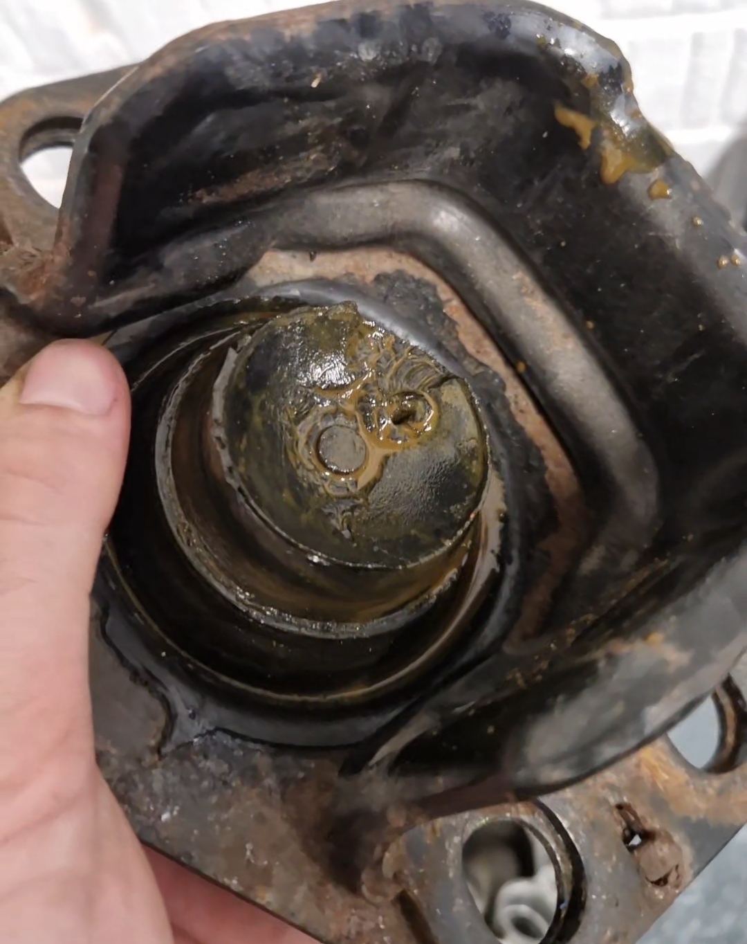

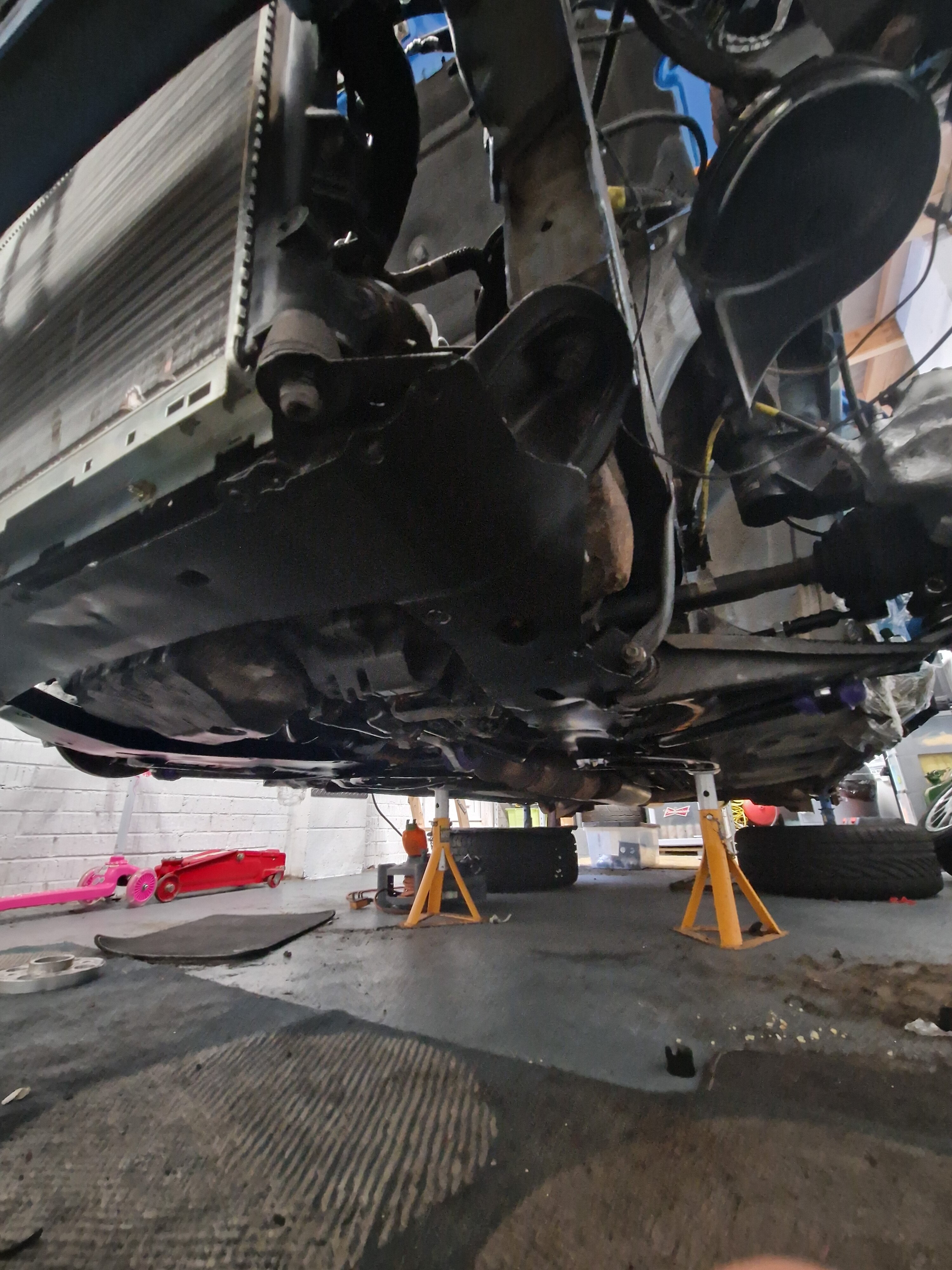

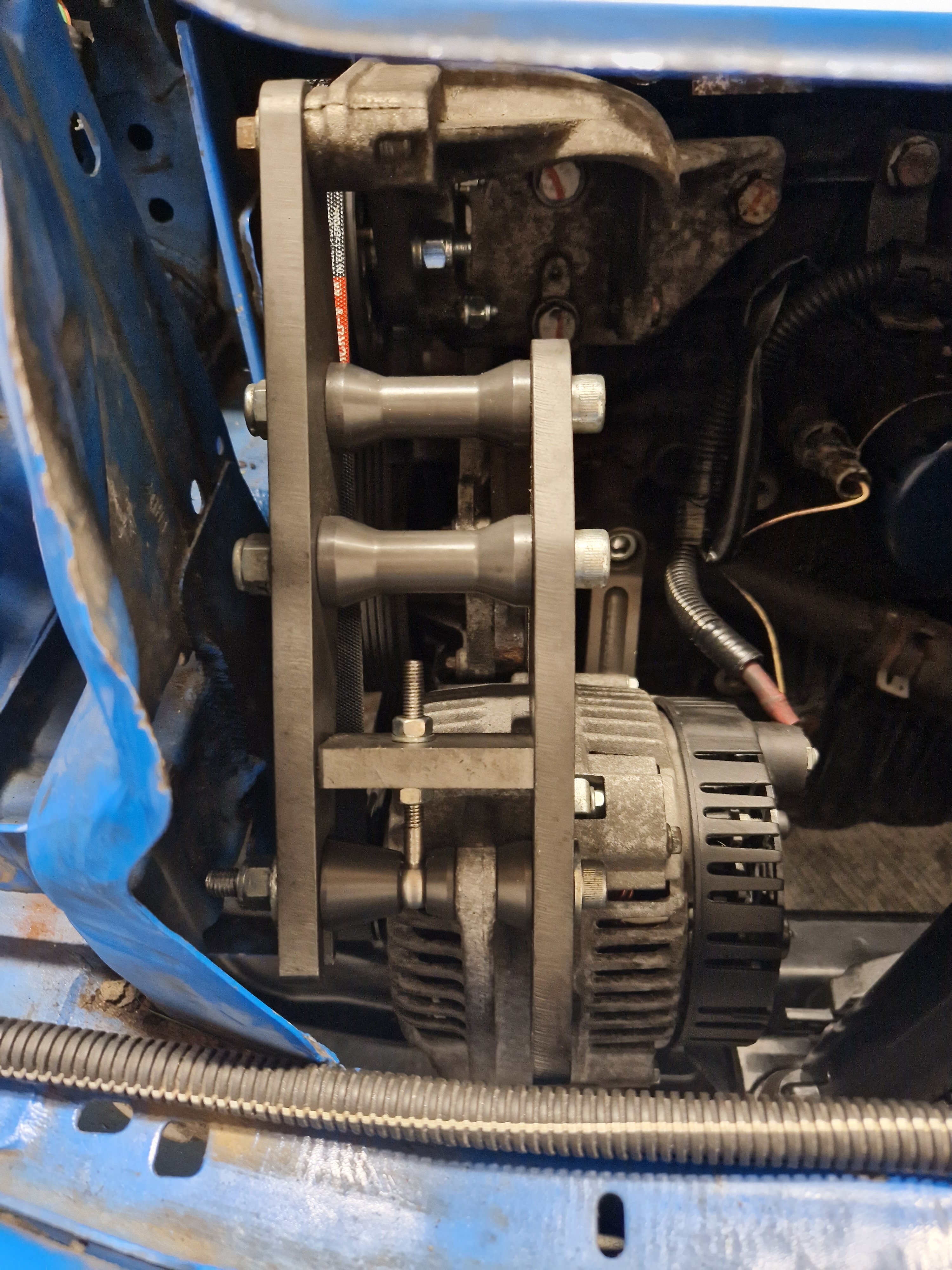

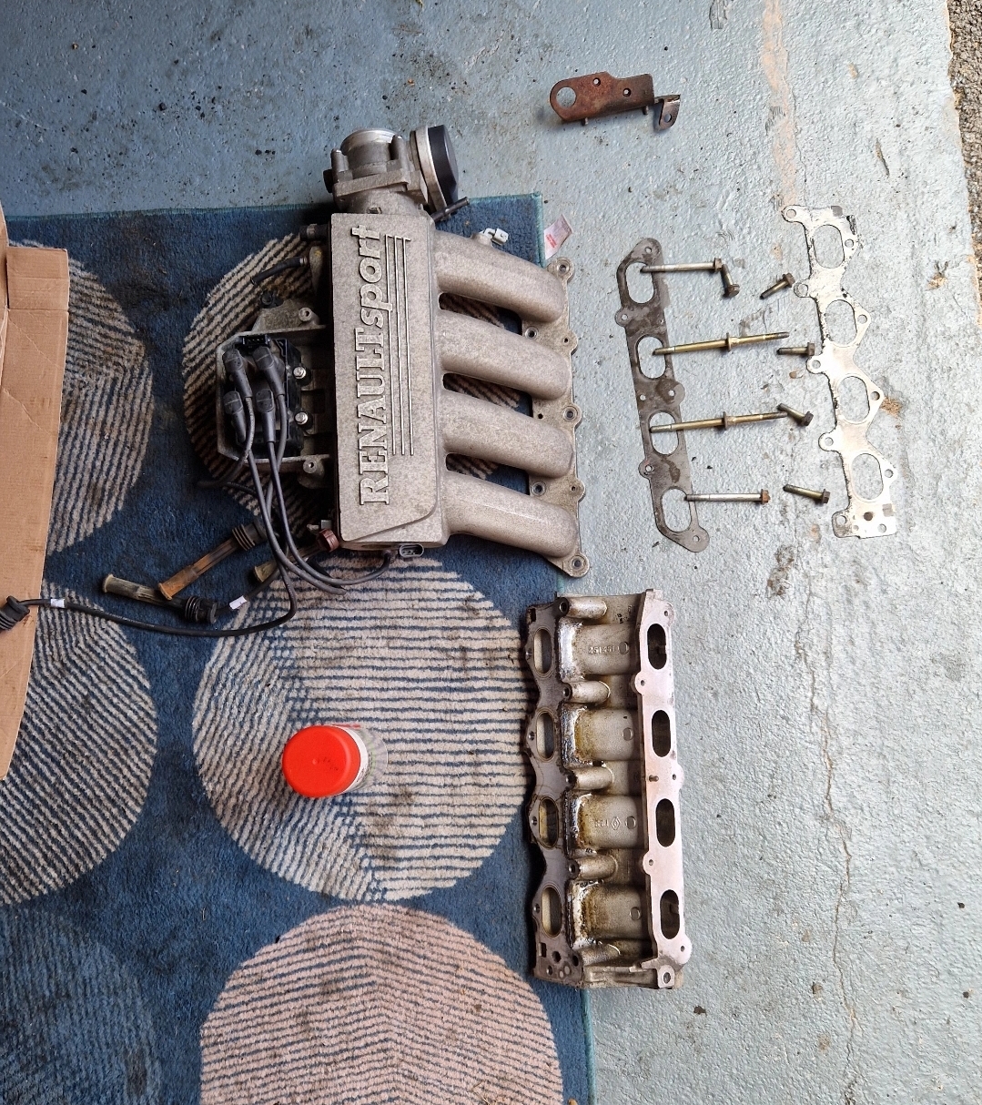

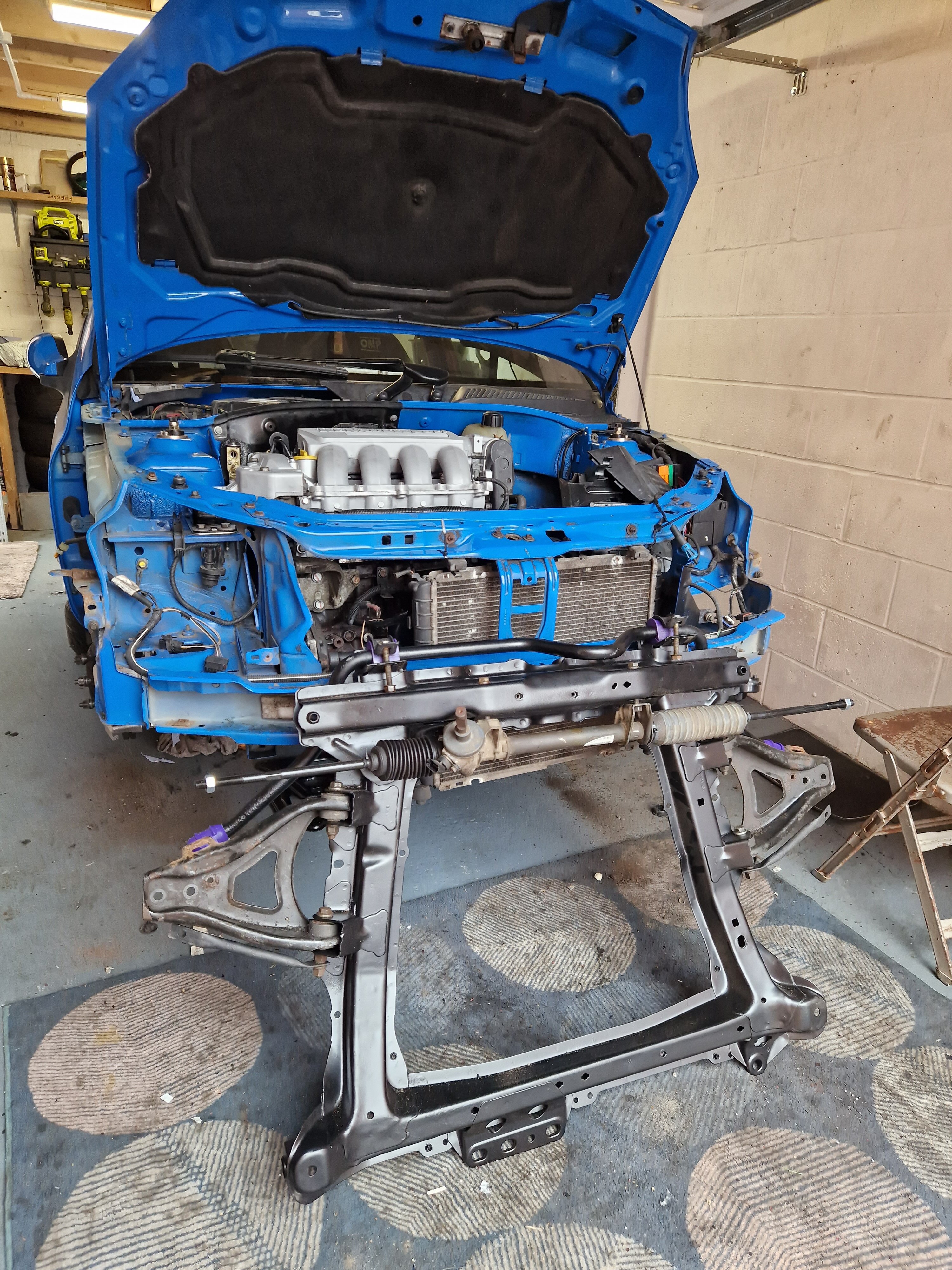

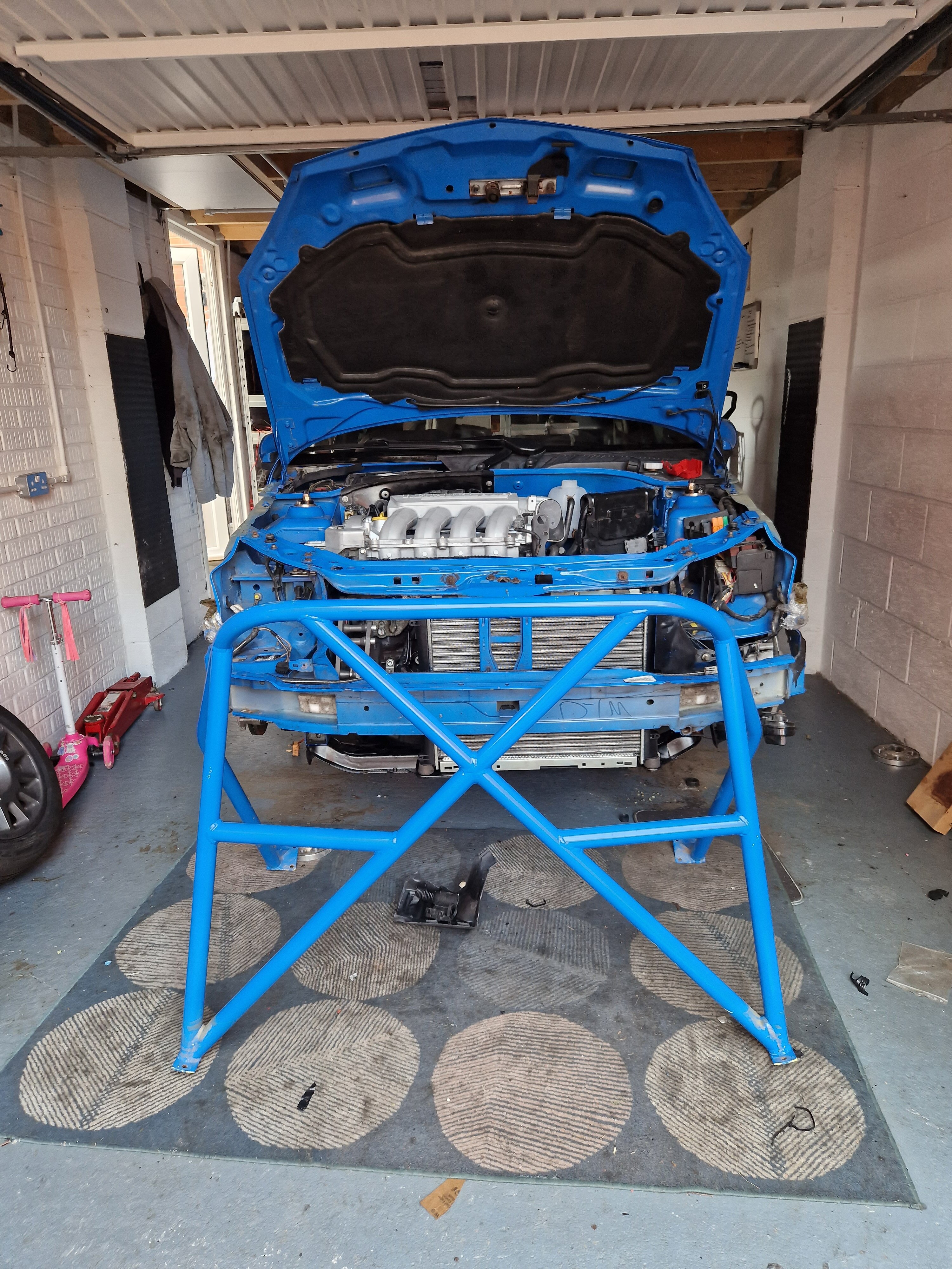

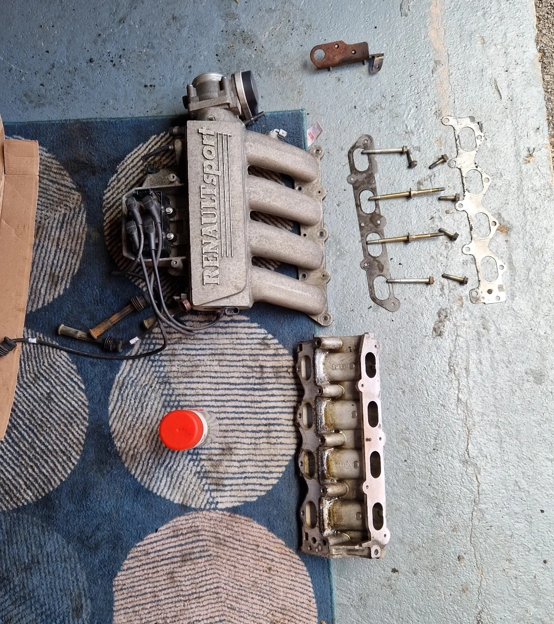

It was a dodgy captive bolt that kick started me removing my engine. I replaced them with new genuine ones, so the next person wouldn’t have to go through the same dilemma. It’ll look great when you’ve finished.
We got the Subframe off and eventually got the PAS line (that caused us to remove the Subrframe) off.
Filled the PAS rack with fluid, went to fit the loop kit and I soon found out why the one line wouldn't come out, it had been cross threaded somehow. This now meant I couldn't loop the rack.
Decided to go whole hog and get a DCI rack to complete the EPAS setup.
Also fitted new inner and outer TRE's but no photos.
Whilst the Subframe and ARB was off I thought I'd clean it up myself with a grinder and some degreaser
I soon realised that this would take me an age. Contacted my local blaster/powdercoater who said a two weeks and £100. Deal. It's still there, pick it up next week.

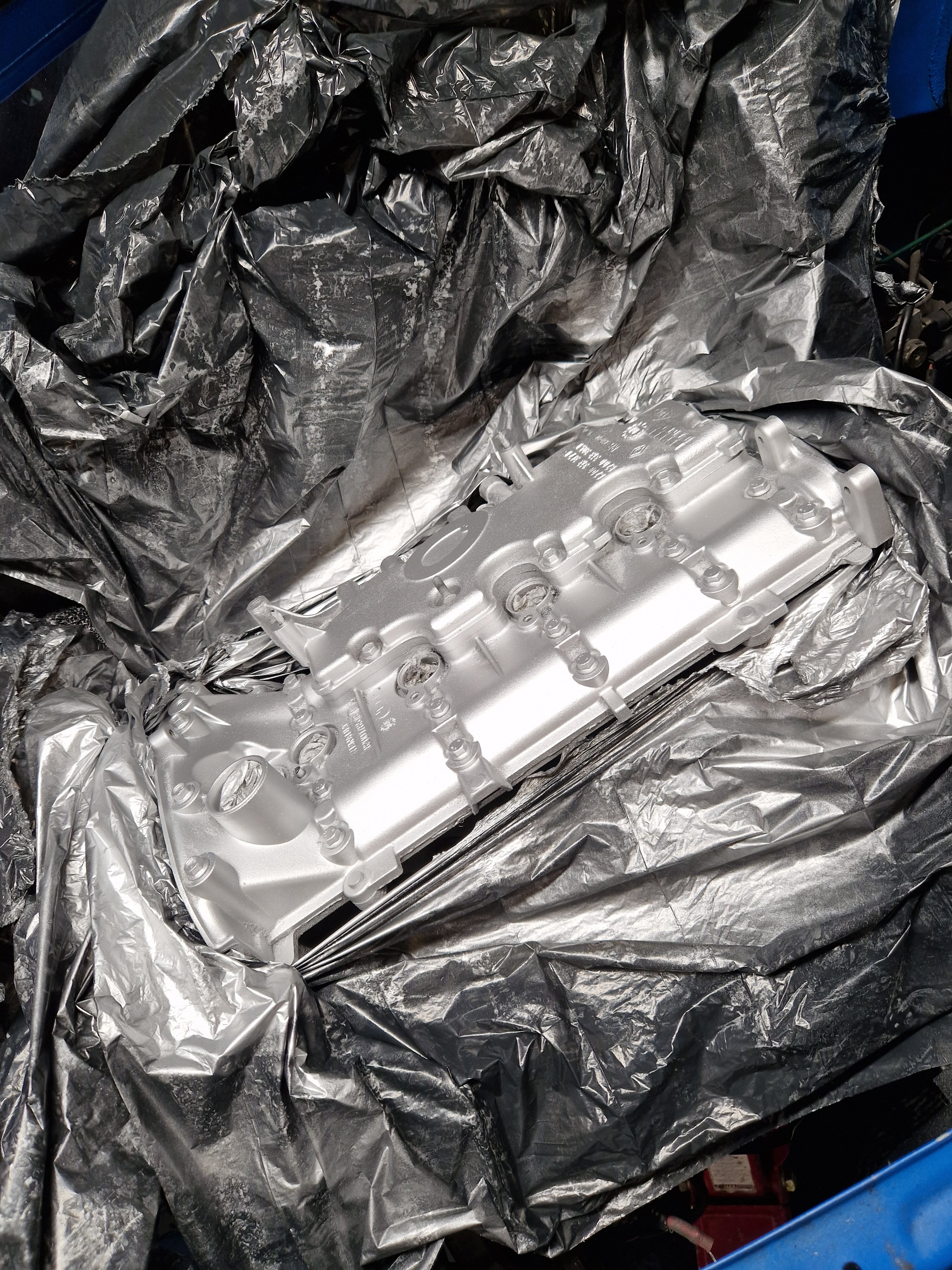

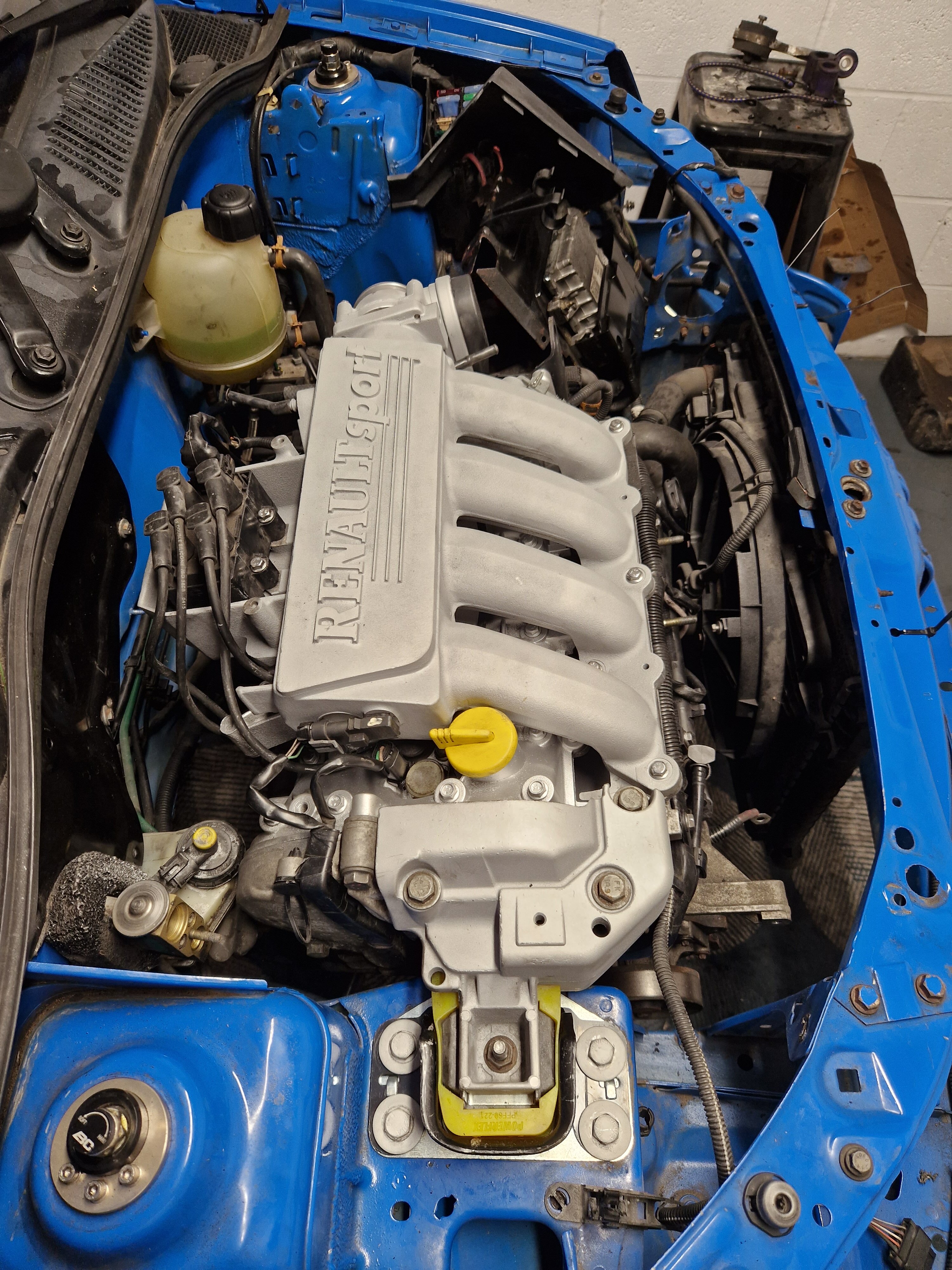

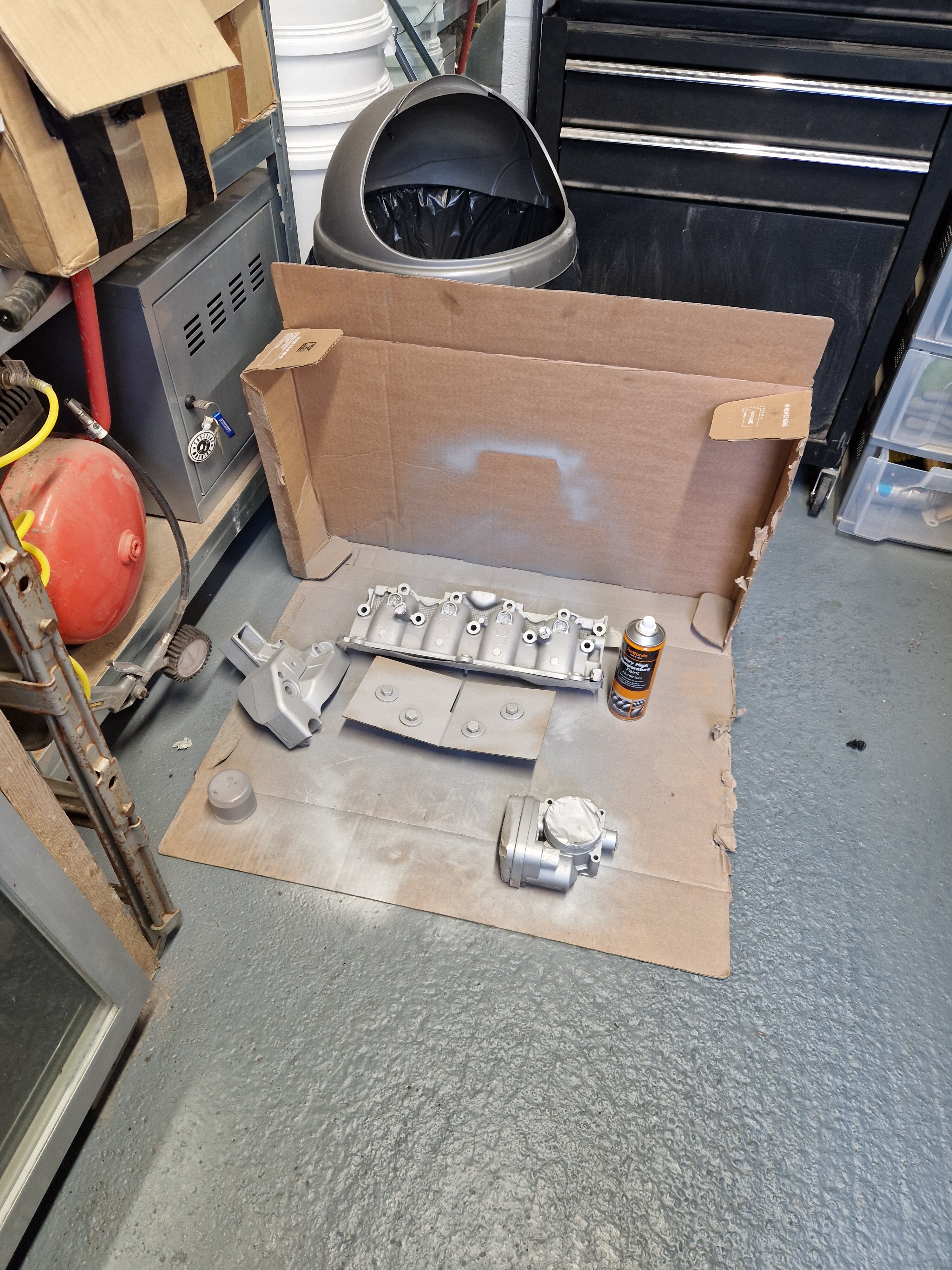

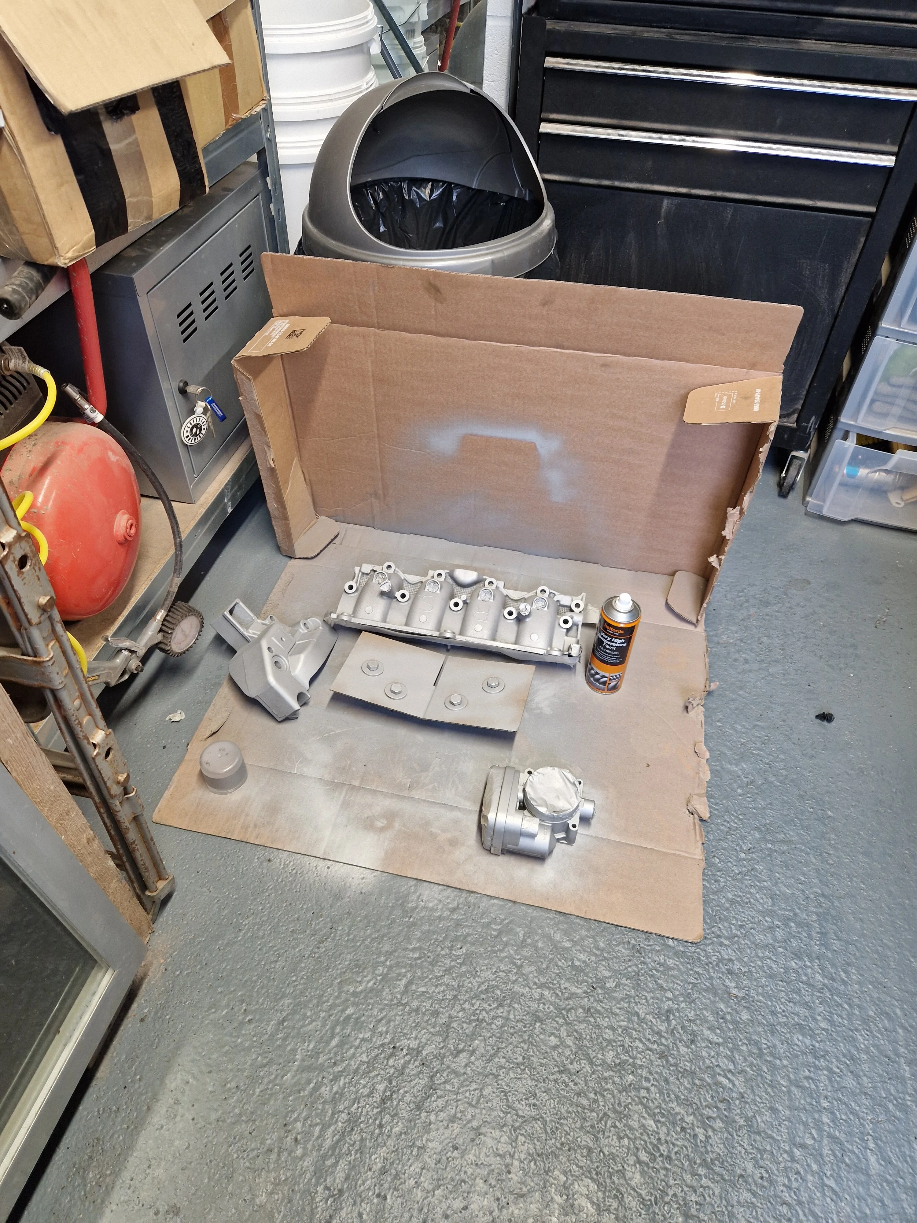

Gave the engine bay a lick of paint and fresh gaskets.
Also a new engine mount as the one on there had become detached(?!)

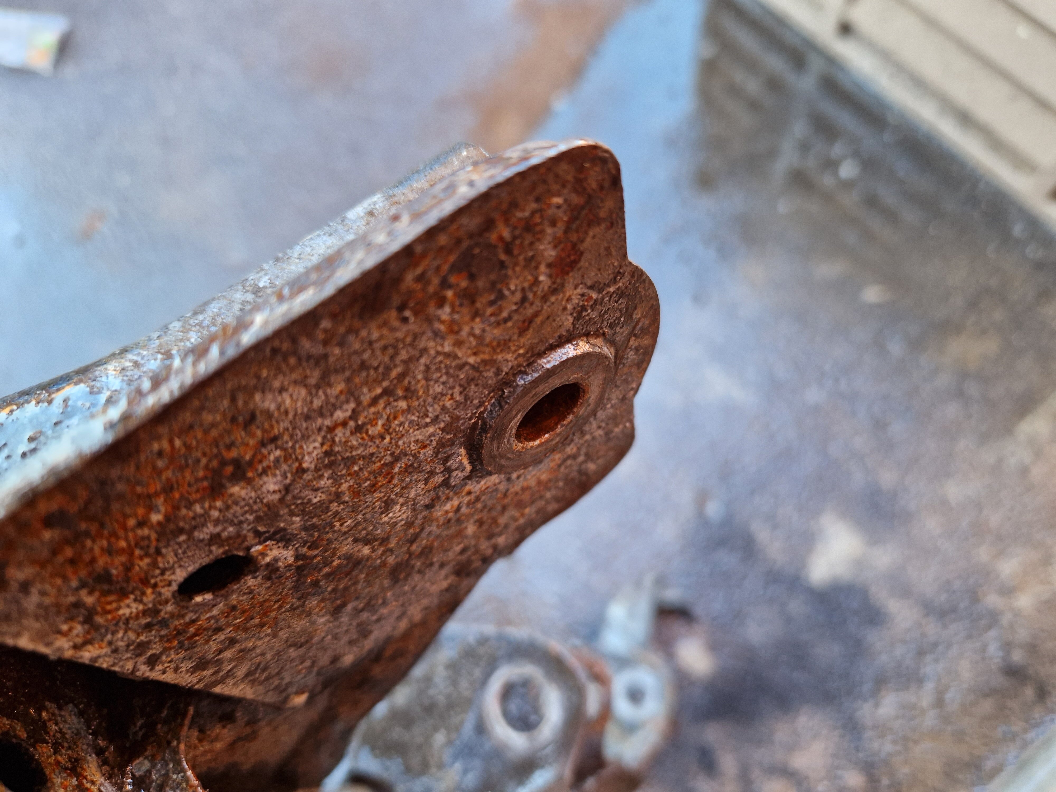

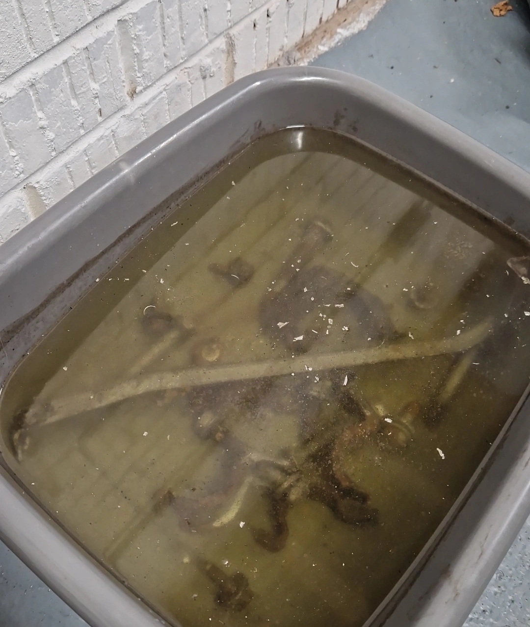

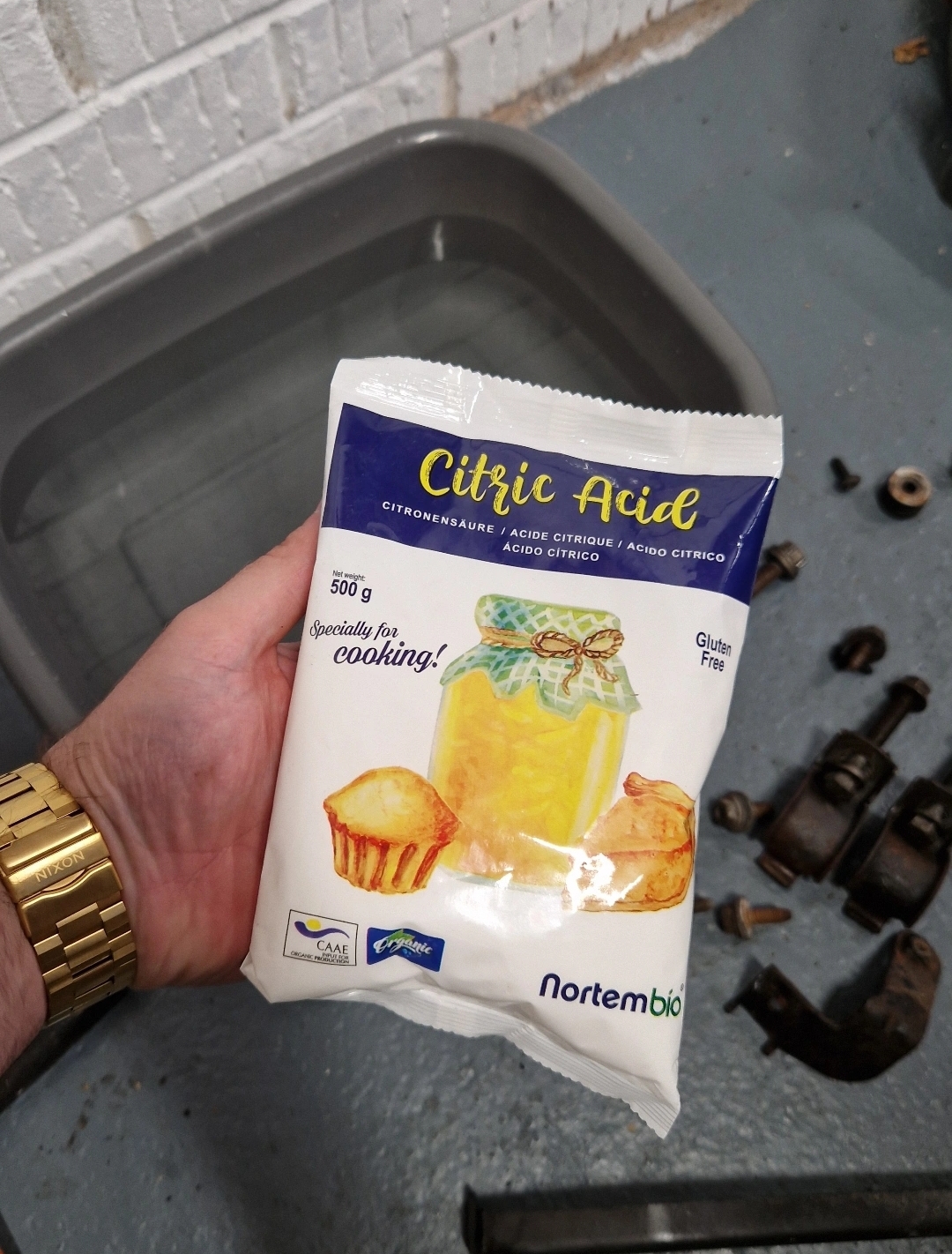

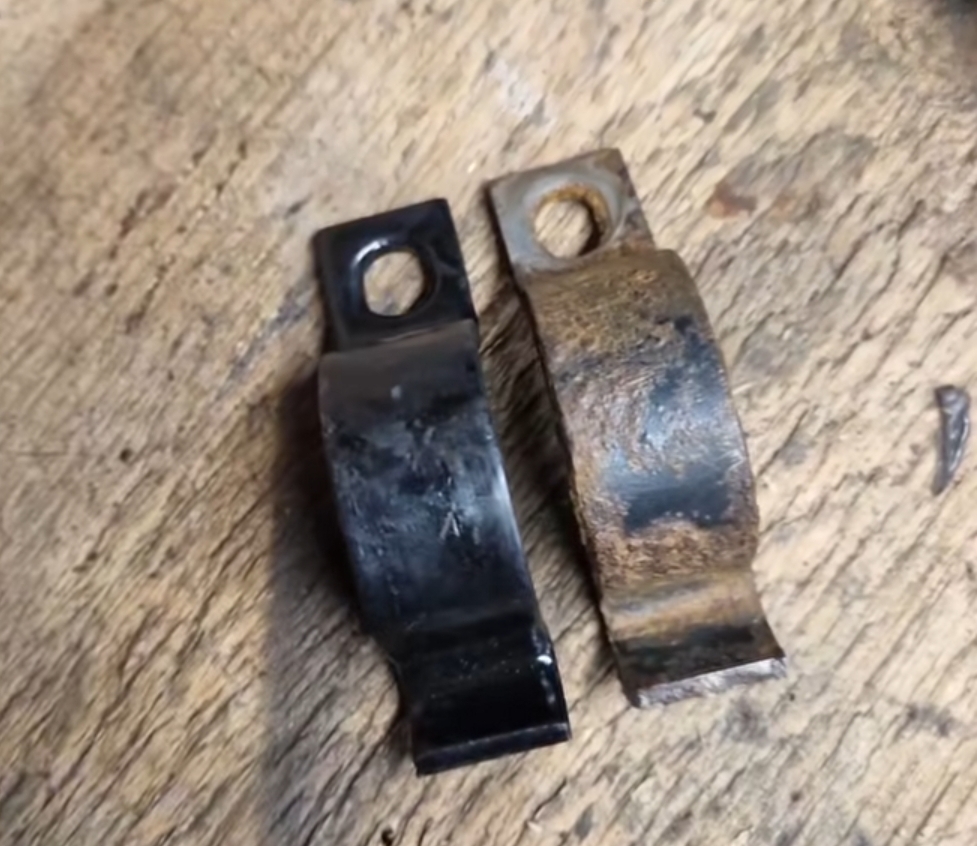

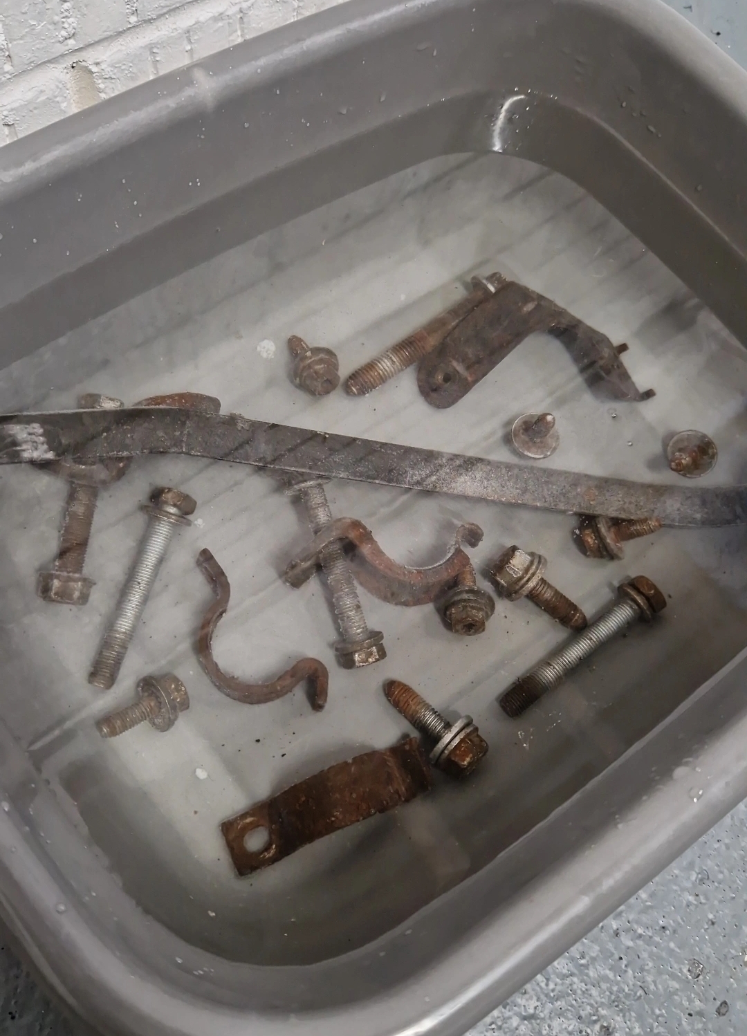

Knowing I'd have a fresh Subframe and ARB (and powerflex purple bushes) I could have old or at least rusty dirty hardware on it.
Saw a hack on here about using citric acid to freshen things up.
Overall pretty happy with how they came out.

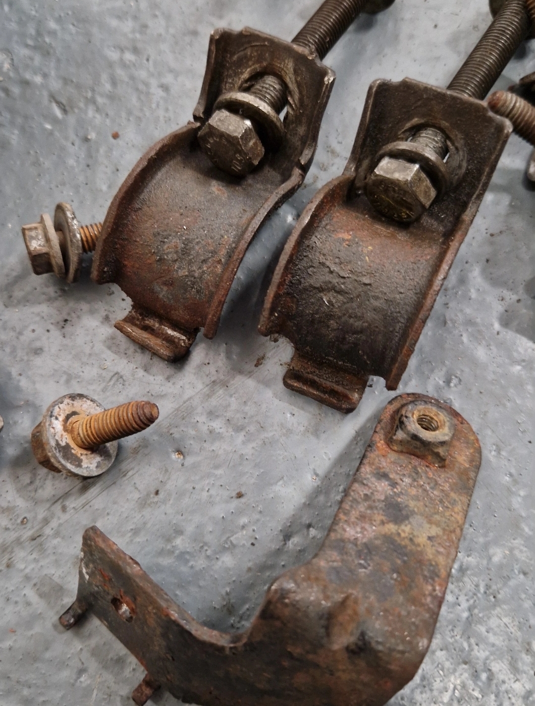

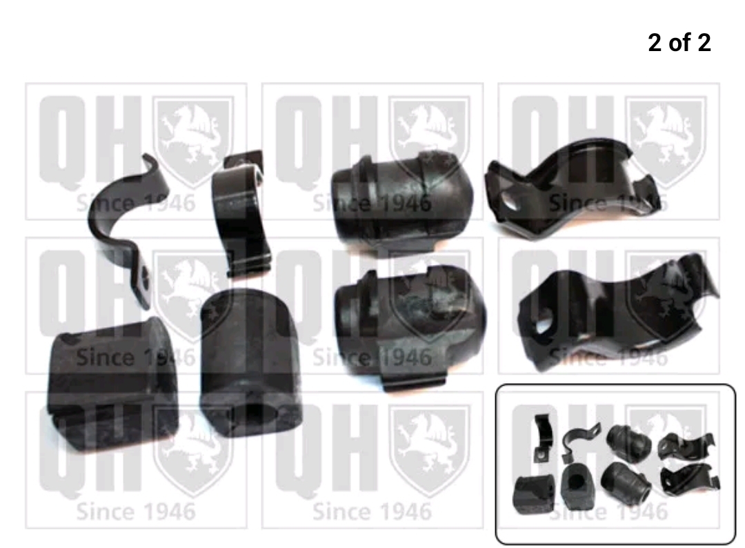

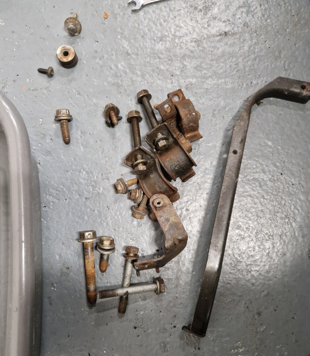

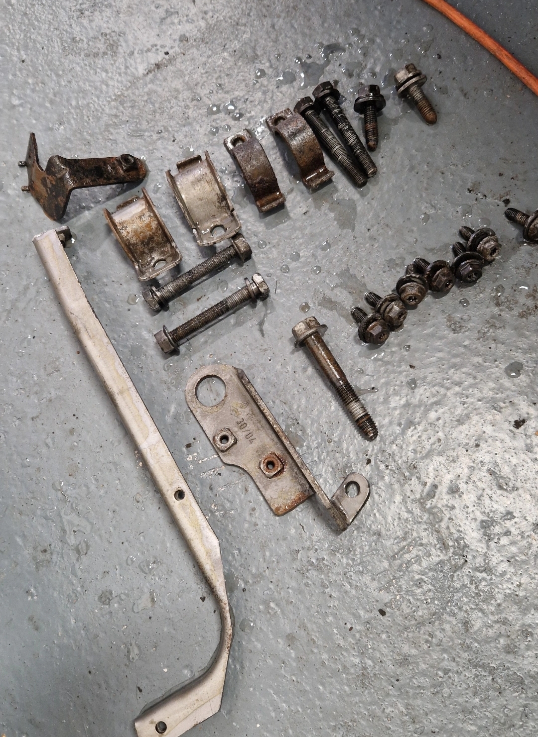

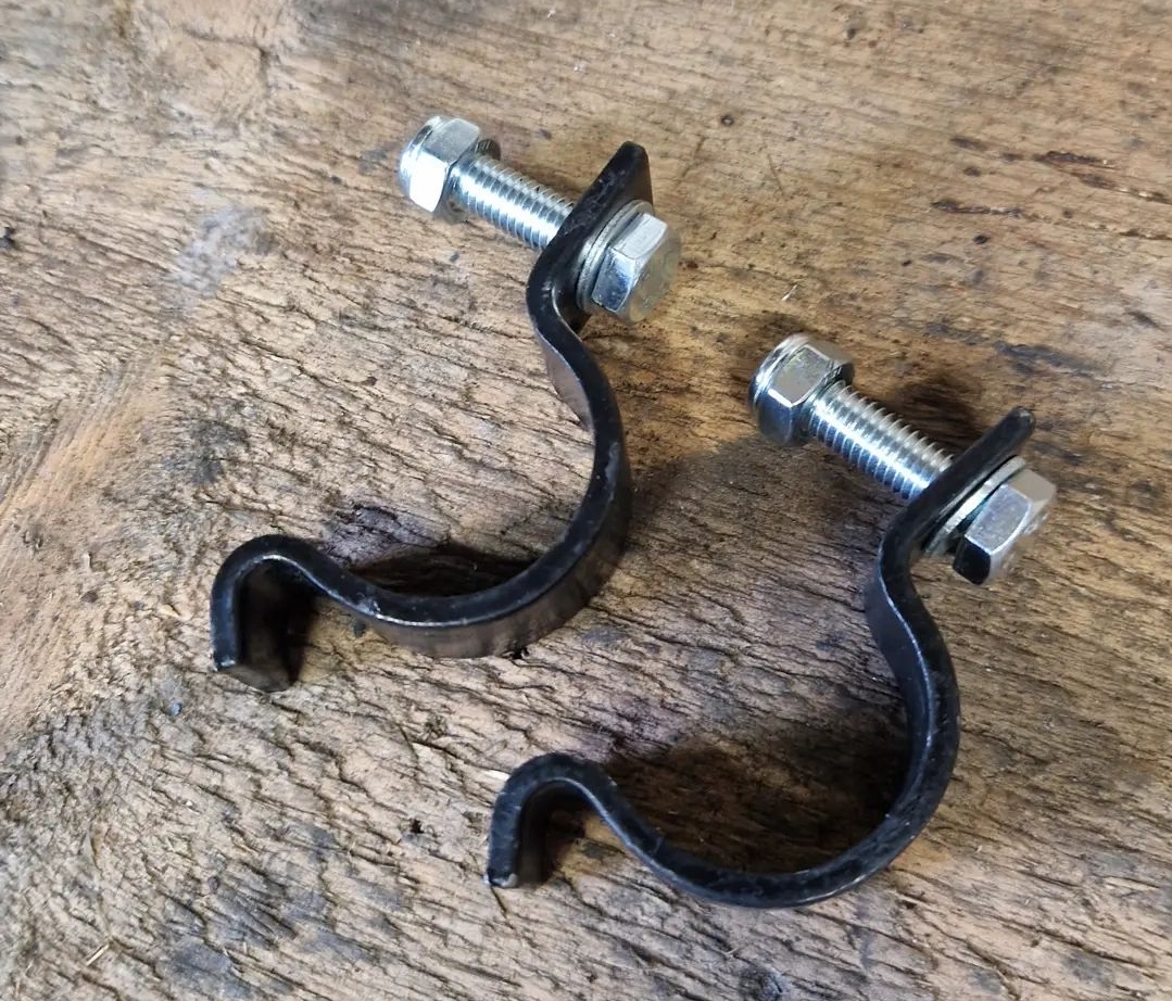

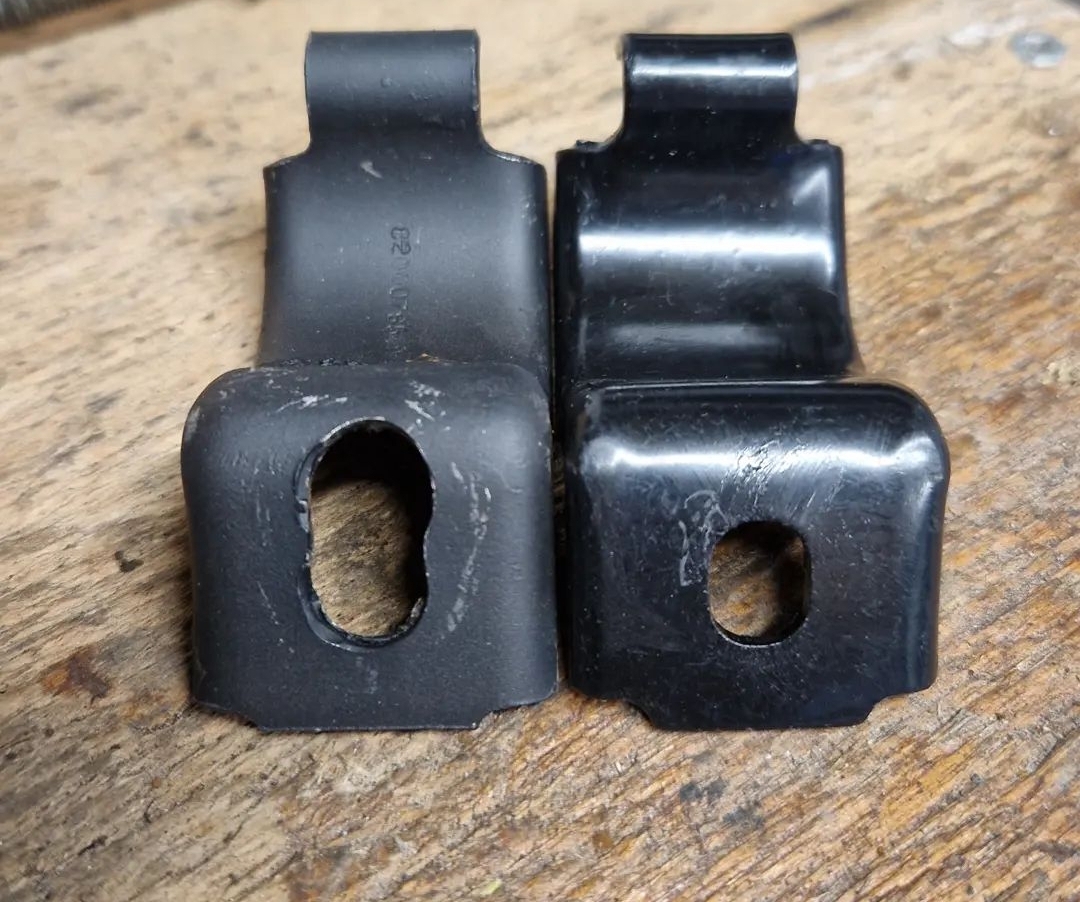

However the outer ARB brackets were beyond saving and I was just about to order OEM brackets, nuts and bolts when @Louis gave me a link to an Ebay kit including new inner and outer brackets.
No their not OEM but if that's your thing, you must be great at parties. 😂
Compared next to the ones that came off they were identical.
Also new inner brackets and you can see the old brackets have been er... Modified.

Citric acid works great. If heavily pitted twke out and wire brush and chuck them back in for longer.
The aftermarket outer arb bush brackets are prob better than oe

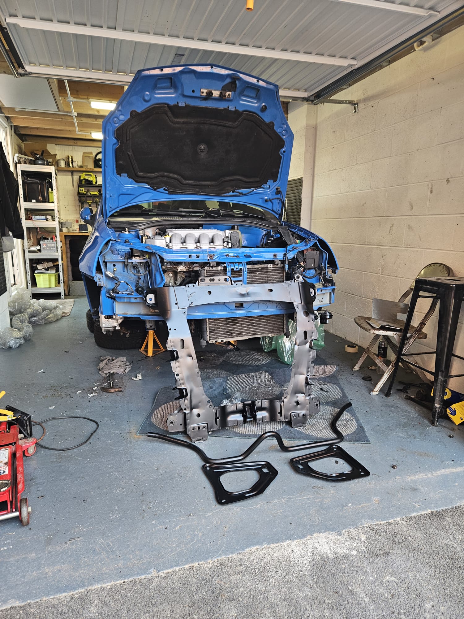

Subframe, ARB and those brackets back from the powdercoasters.

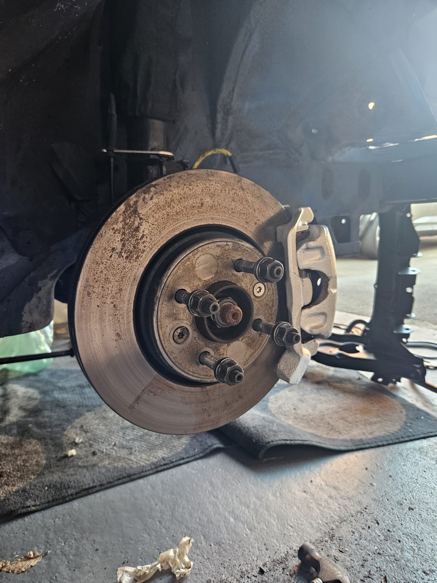

Gave the front brakes a lick of paint.

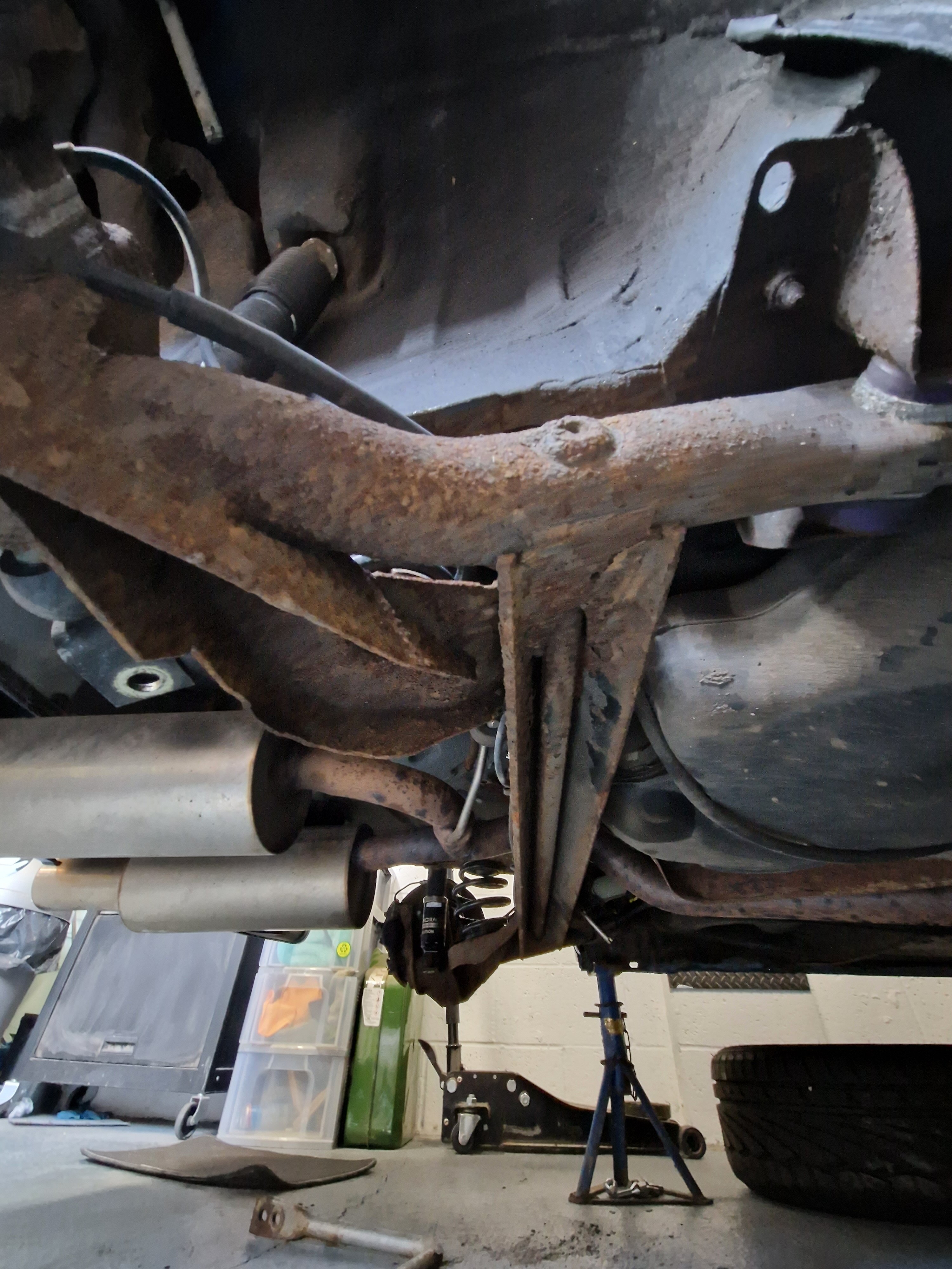

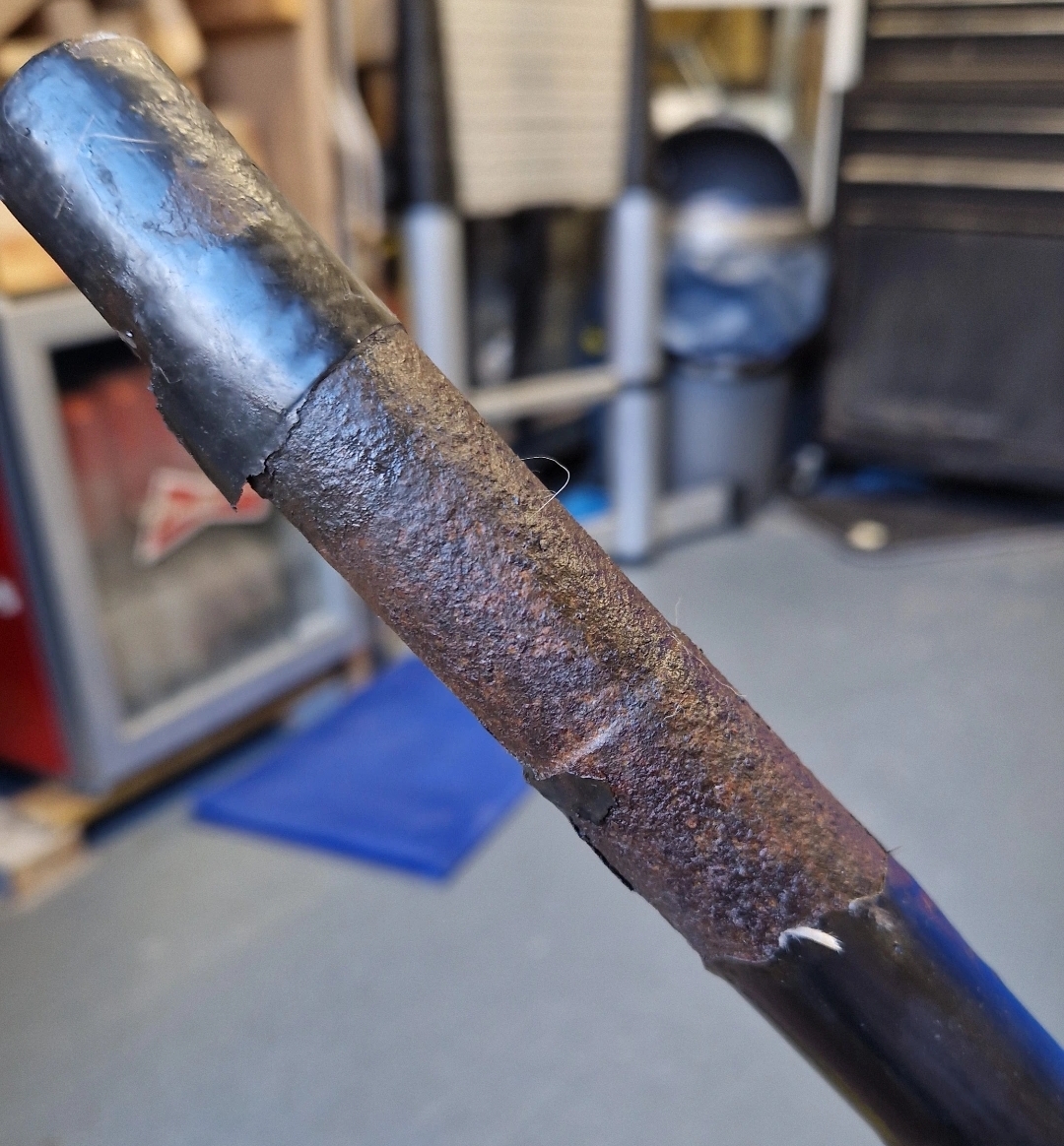

Took a quick look at the rear beam, determining how much of a problem that's going to give me.

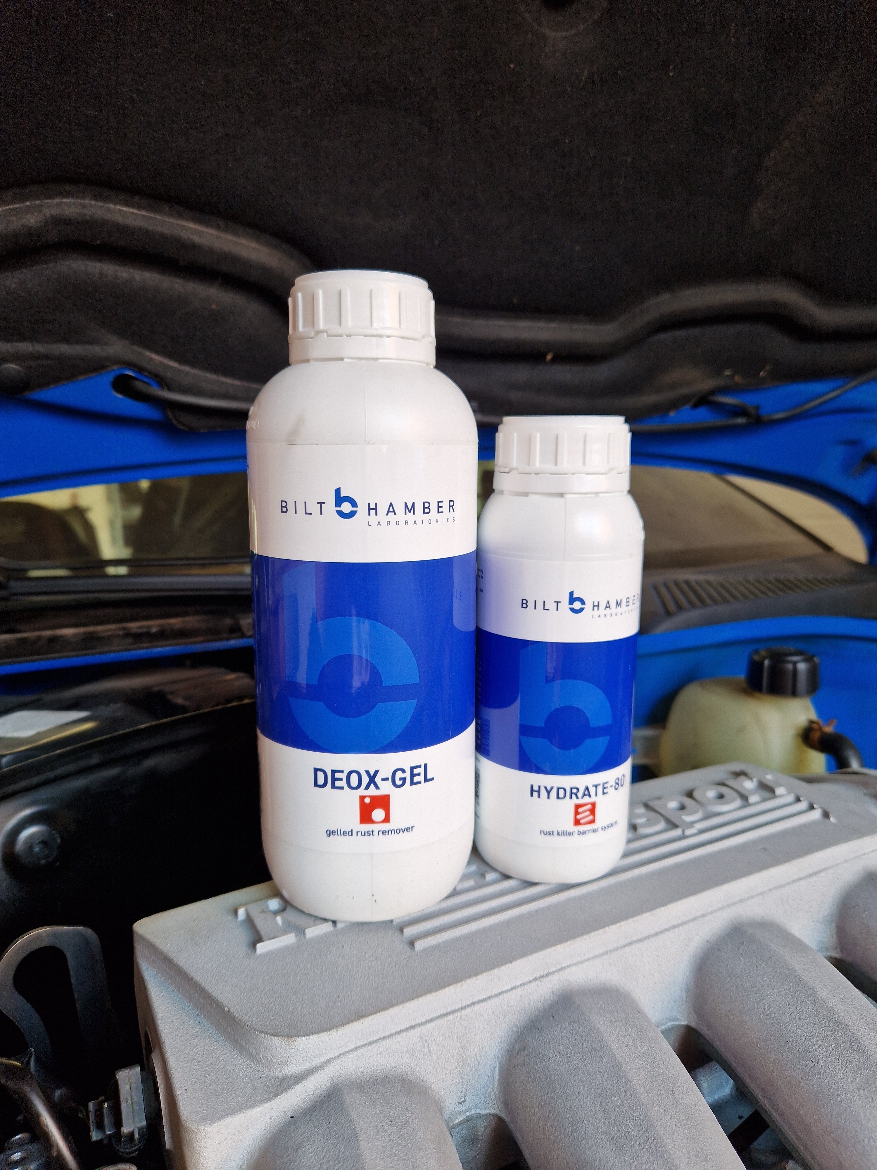

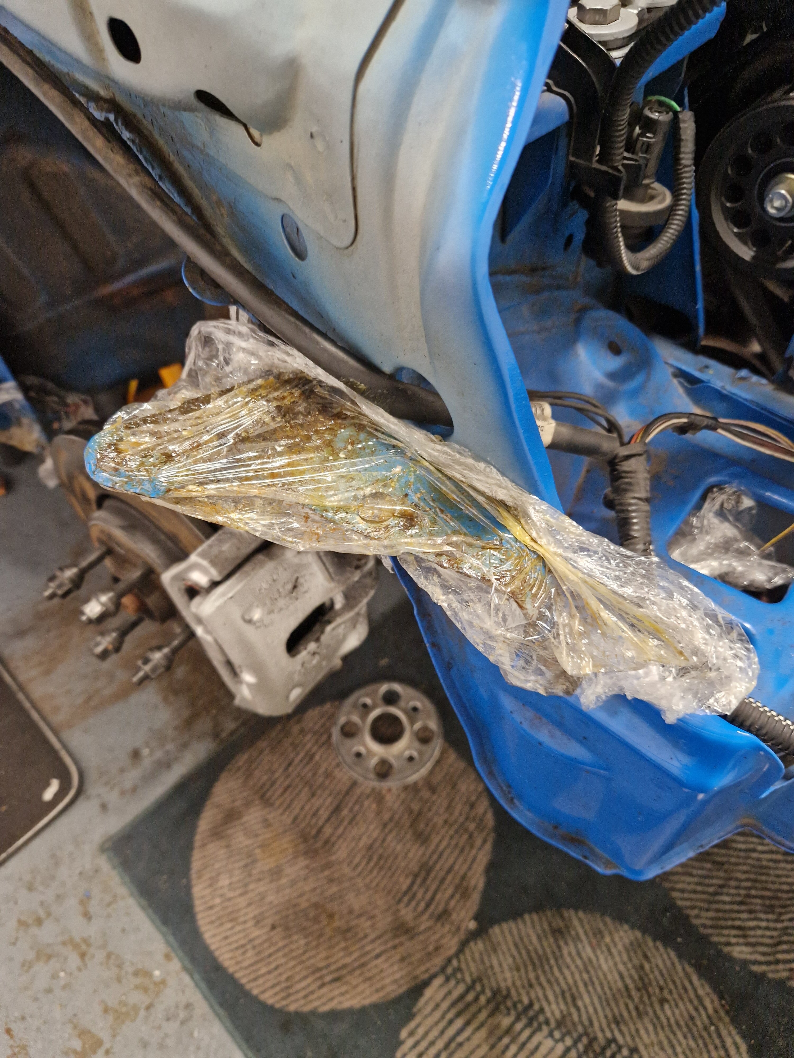

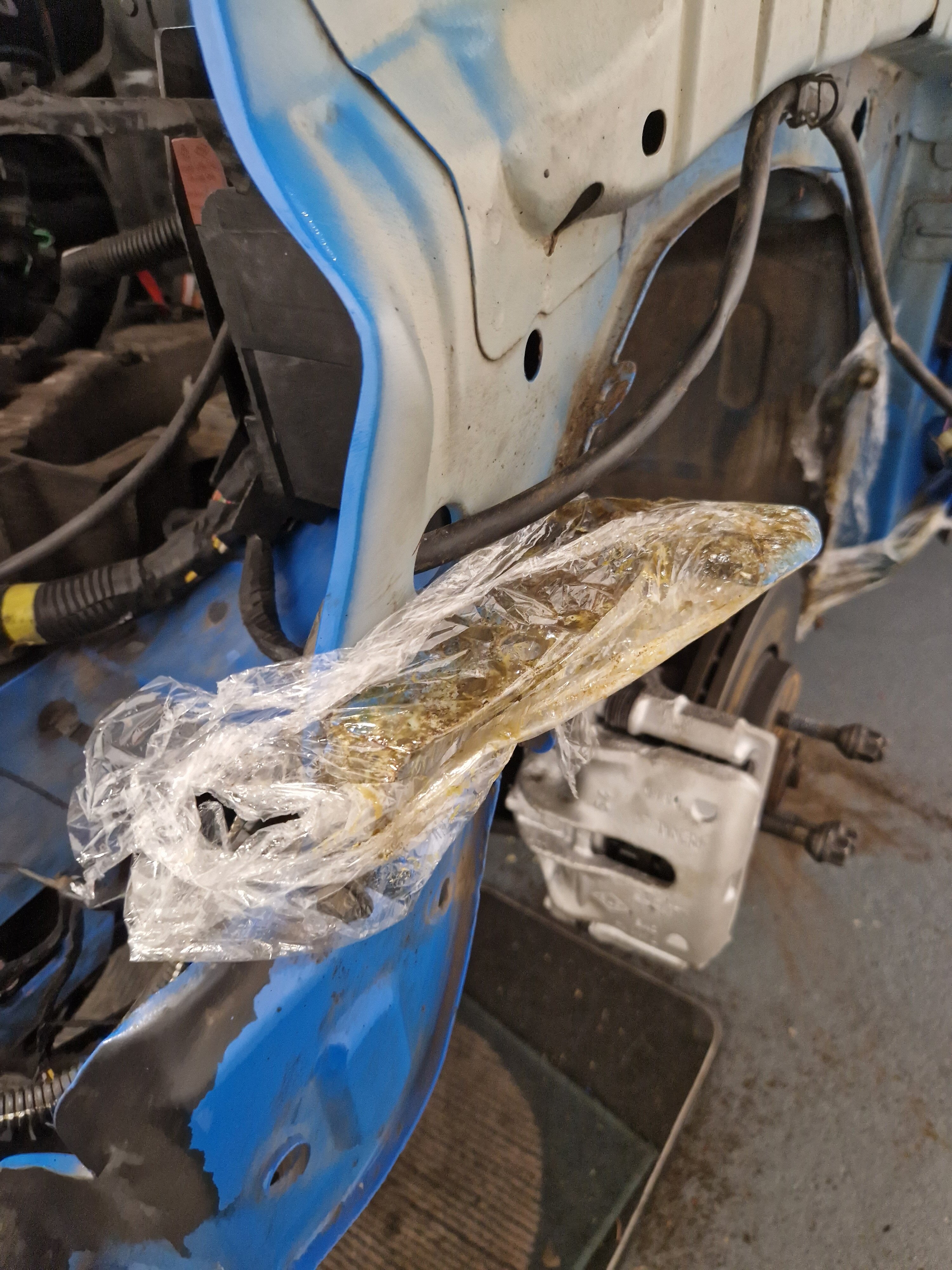

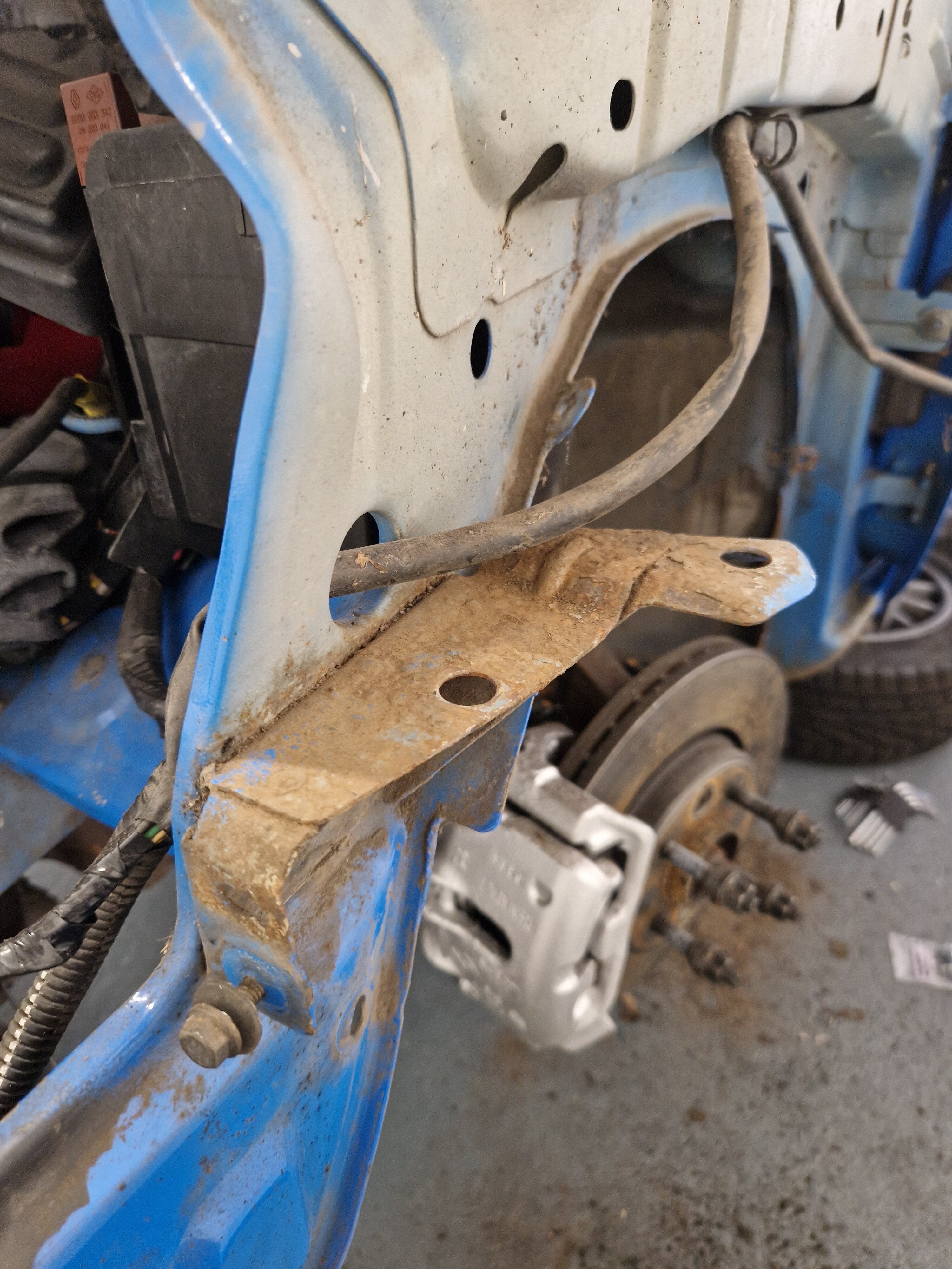

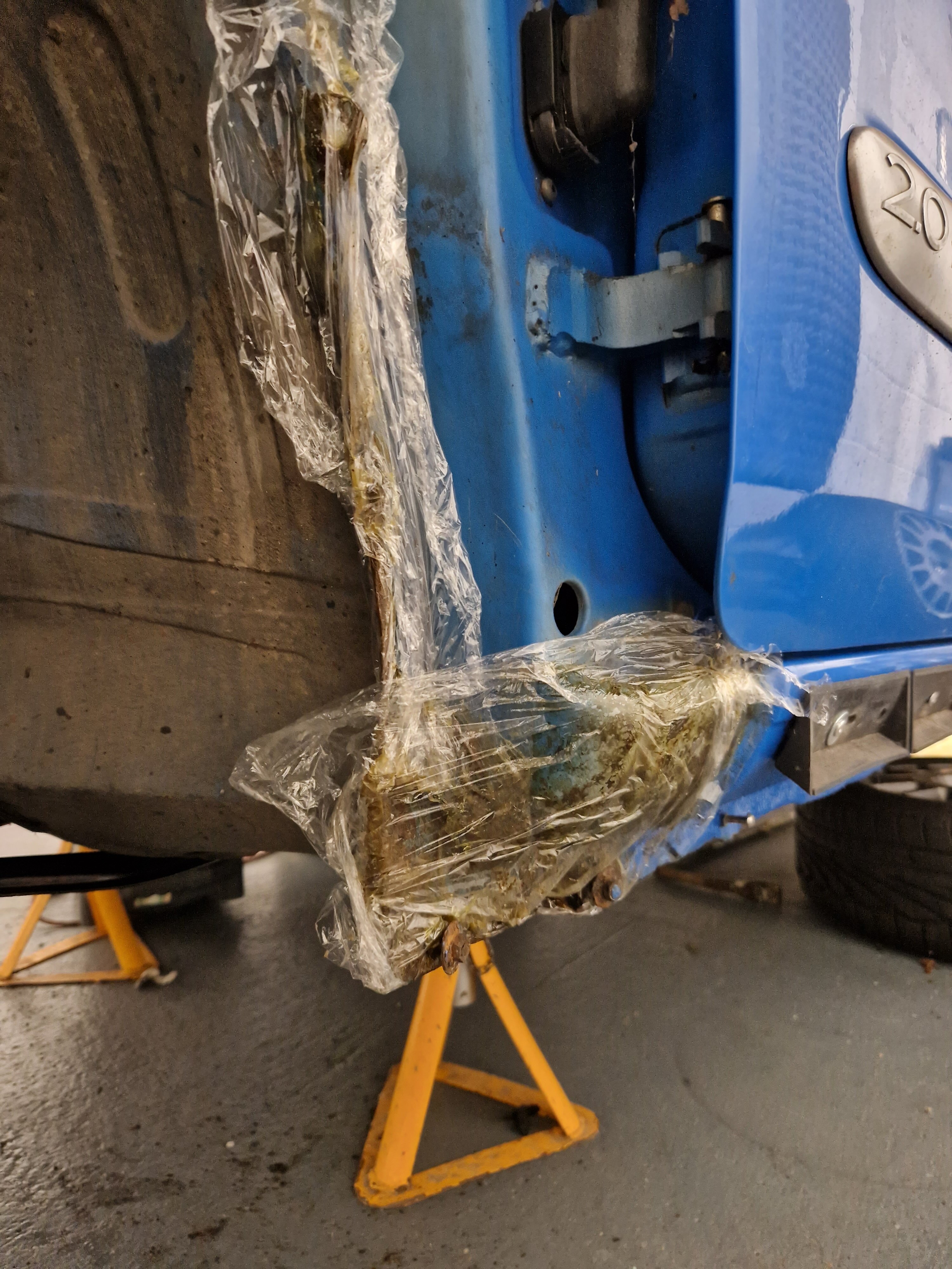

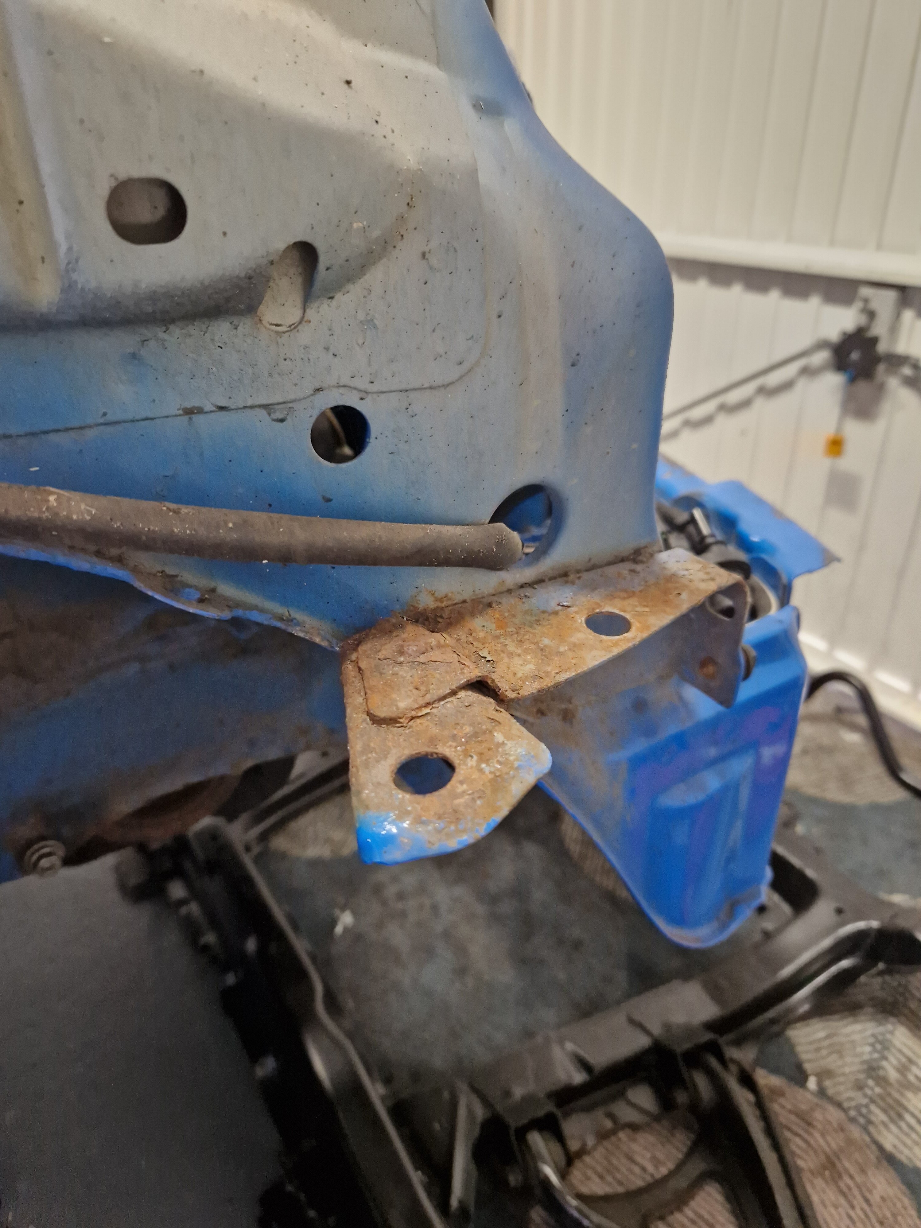

Took the wings off and treated the bumper brackets to some Bilt Hamber treatment. With advice from @Mr Underhill on the rust treatment process (much appreciated).
Those are the before pics... Obviously. Currently under clingfilm wrap with Bilt Hamber Deox C.
Rebuilt the front Subframe up. The wishbones, although dirty, we're fairly new and genuine Renault. Bushes were all good so they stayed.
Fresh brackets and bushes on the ARB.
DCI Rack fitted with new inner and outer tie rods.
New Subframe nuts and bolts.

I bought some BH products to sort the surface rust.
Still stewing in Deox.

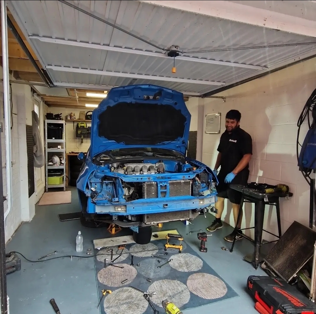

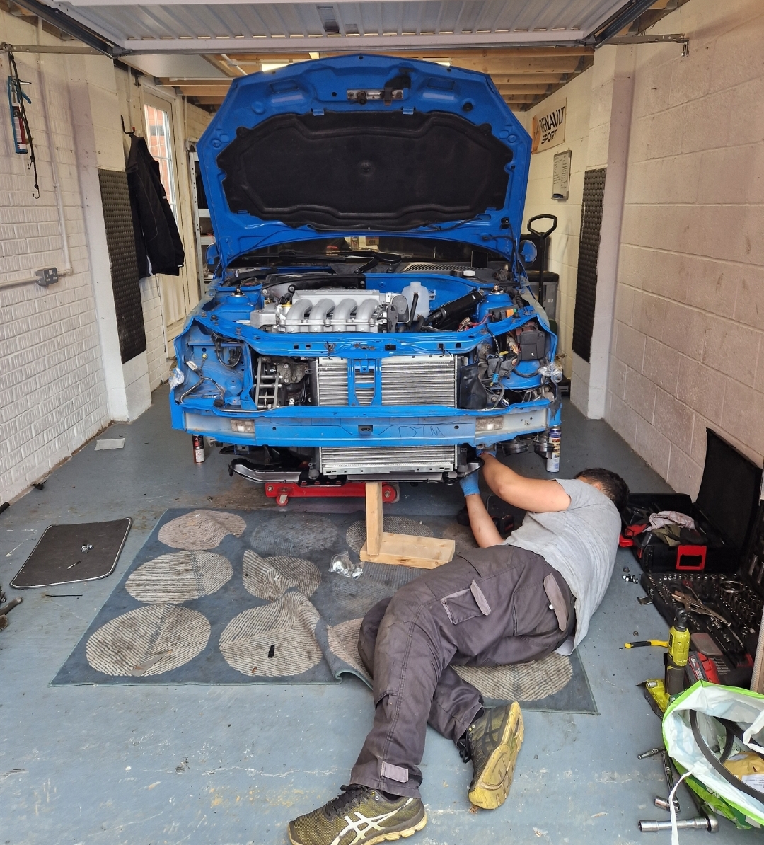

Then last weekend a rather busy shift with @k.sokhi

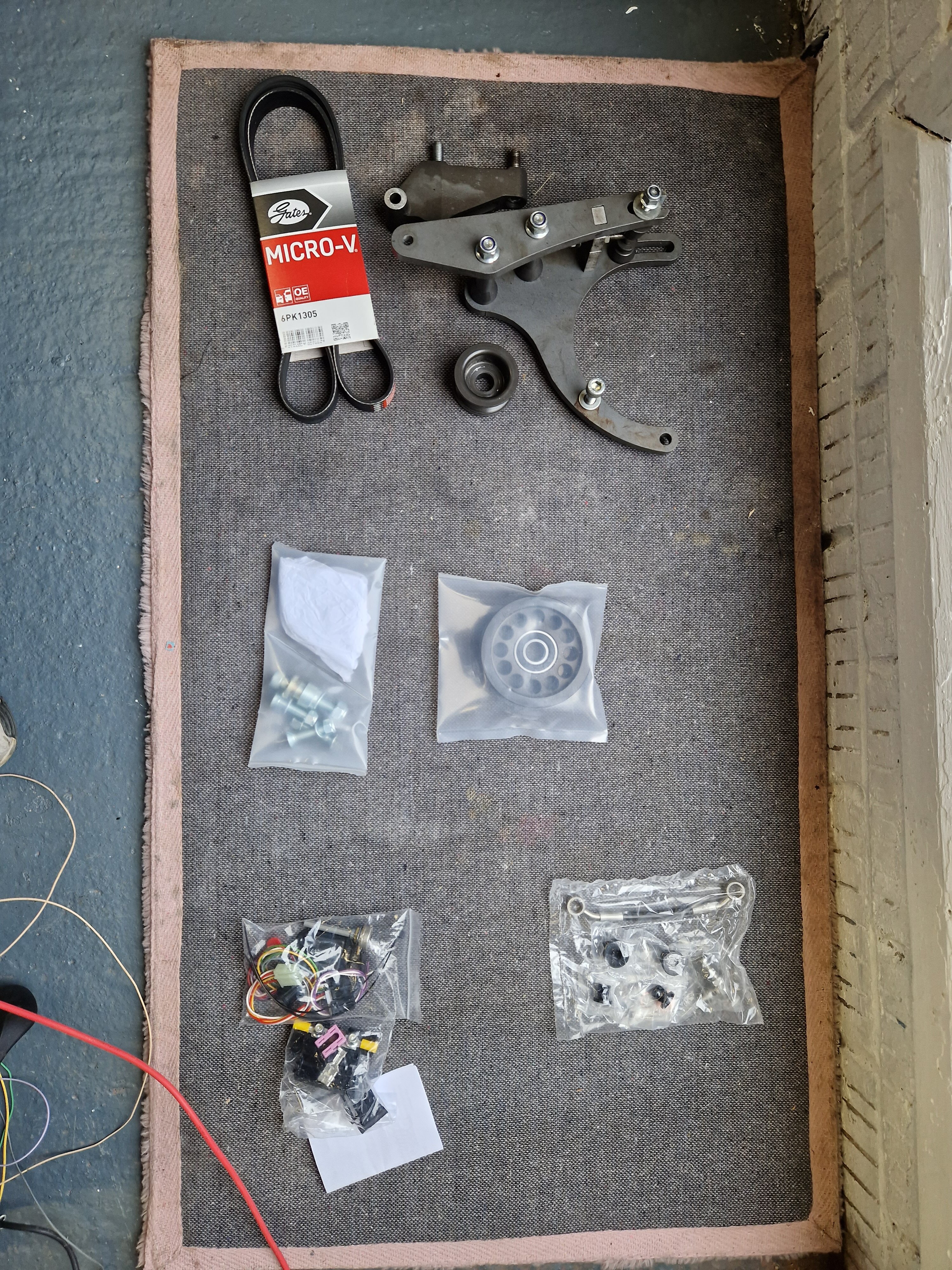

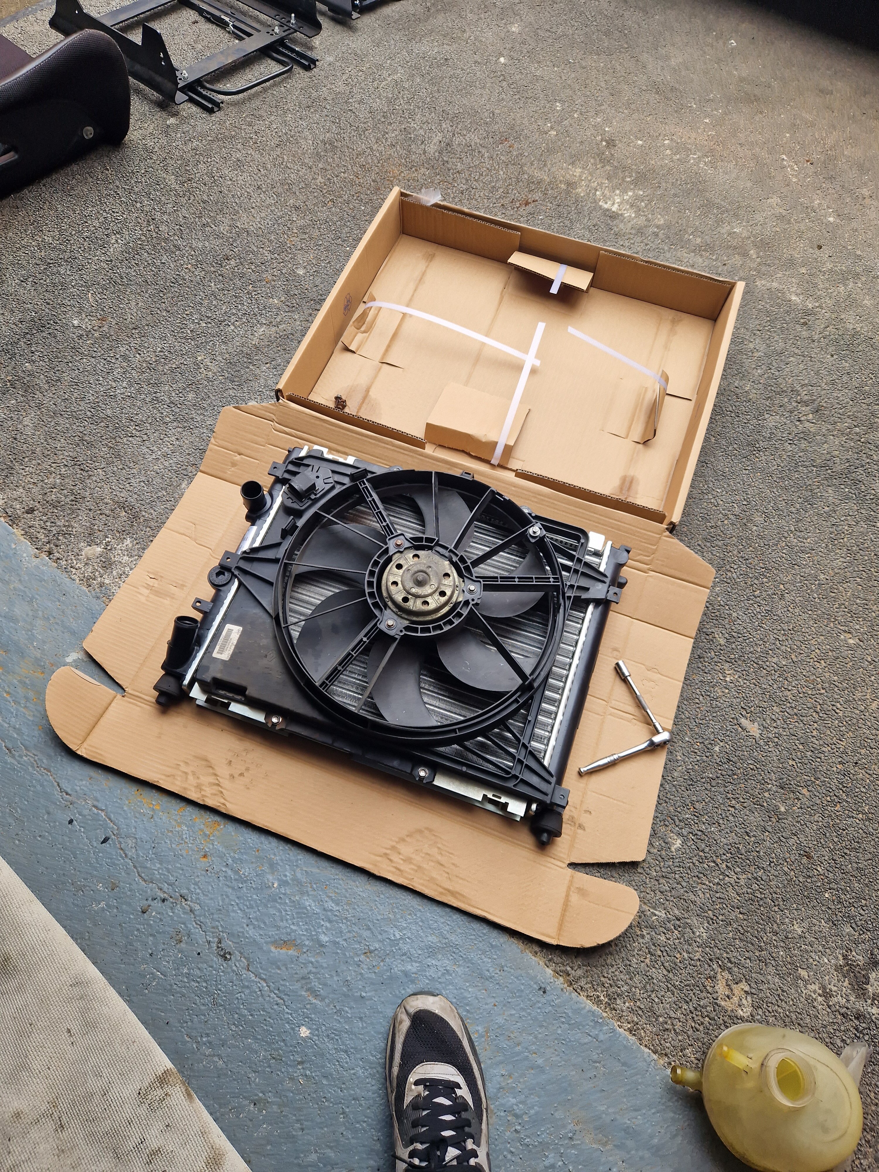

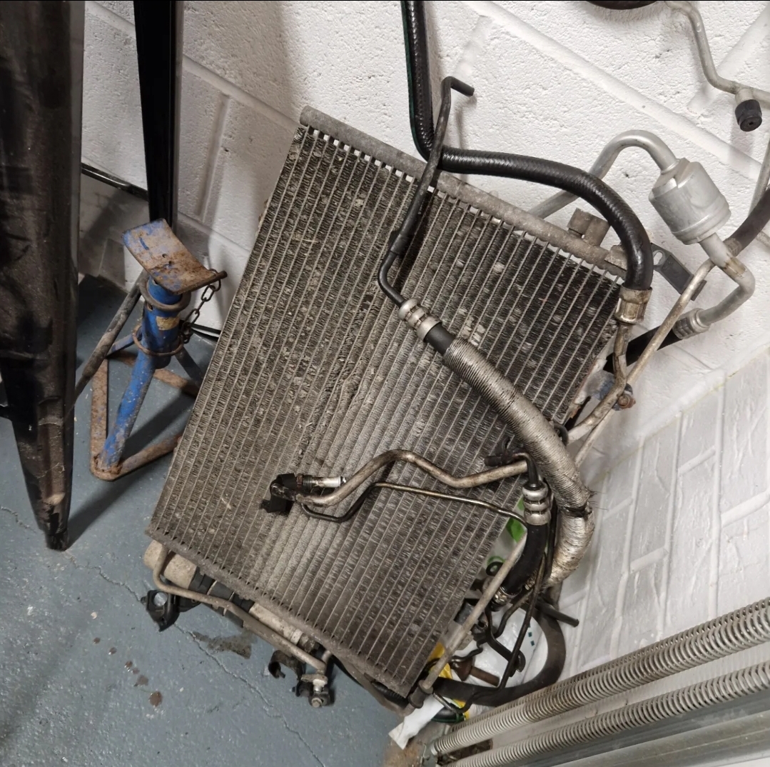

PMS AC Delete fitted
New Rad and expansion tank
(bottom right, old expansion tank)
Powdercoated Subframe with fresh bolts in.
@k.sokhi doing the work, whilst I made the tea.

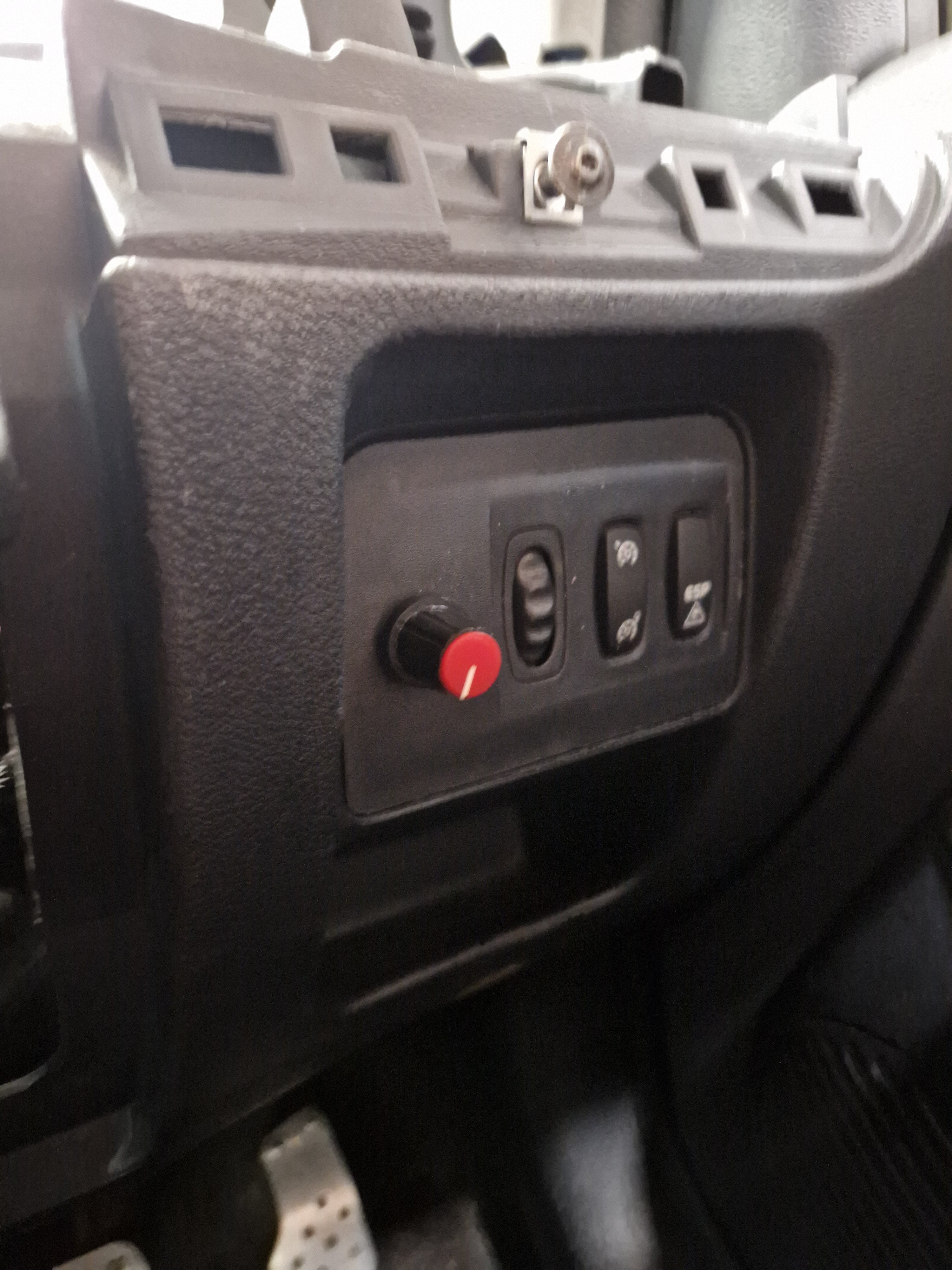

On to the inside. The EPAS was wired in
We (Kiv), also aligned my PMS shifter and relocated the battery to the boot.
Massive thanks to Kiv for his help. The EPAS was way out understanding.
Long day but productive and nothing fought us, which after the last stint (removing the Subframe etc) was nice.

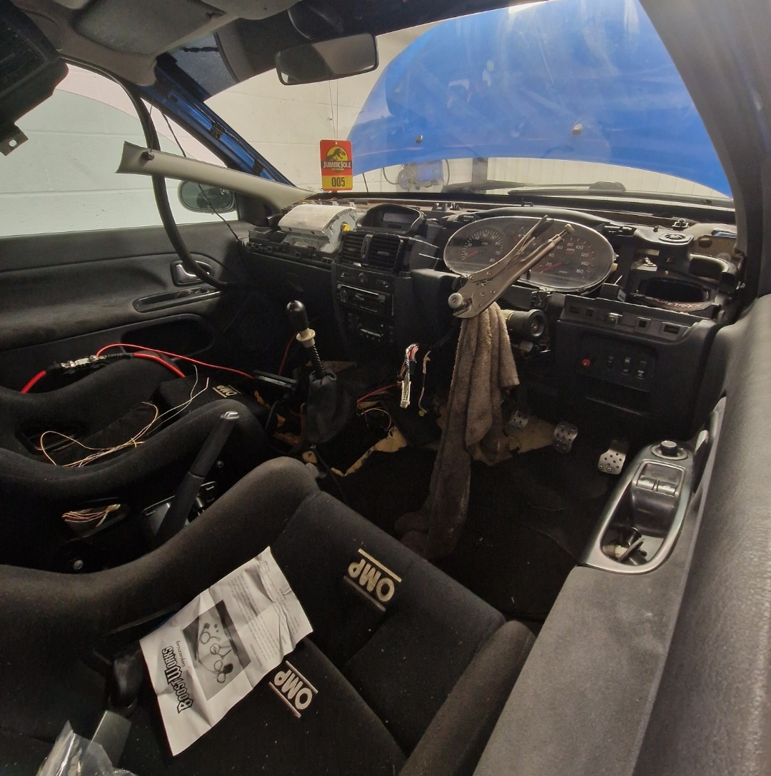

Not long after I had everything in this turned up
So out came the seats and in it went at some point I relocated the battery too.
(Wonky tips I know)

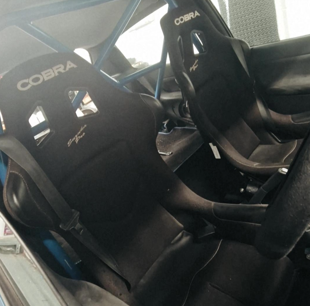

Then being the tart I am I fancied black seat belts and hard backed seats, so the seats came out again.
And now it's driving great, seat position is good and everything is as it should be.....

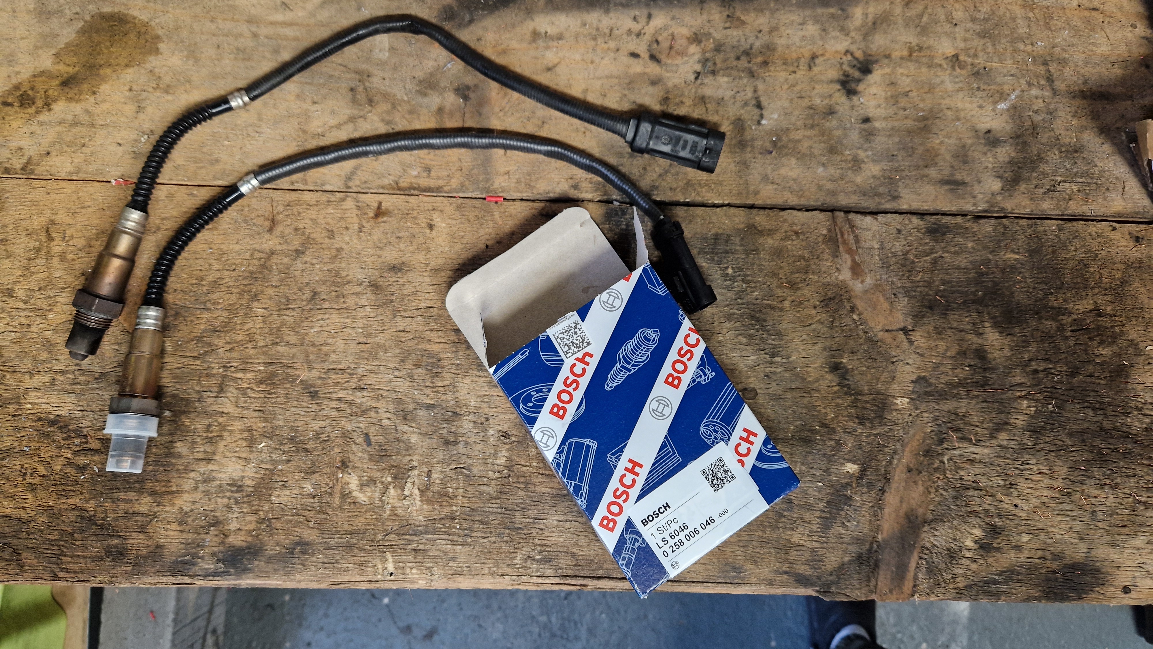

Lights on the dash.....ABS and SERV. Got home plugged in the RSTuner met with 5 codes:
1. AC refrigerant - That'll be the AC Delete
2. Lambda Sensor - Had a feeling the engine was even lumpier that usual
3. ABS Fault
4. ABS Fault
5. ABS Fault
My RSTuner doesn't have the ABS Module so I can't see what the codes are exactly. I disconnected the battery, left it overnight, turned it on and the lights are still there! Would have assumed they'd have gone out briefly, but no. I've checked for snagged wires around the subframe, wiggled some connections and nothing. Visibly checked the ABS sensors. Check the clock spring/squib and everything seems fine. HELP PLEASE?!
I did replace the 10 year old lambda sensor for a fresh bosch item and I'm really surprised how smooth the engine is now. How an EML wasn't on for the lamda, I don't know.

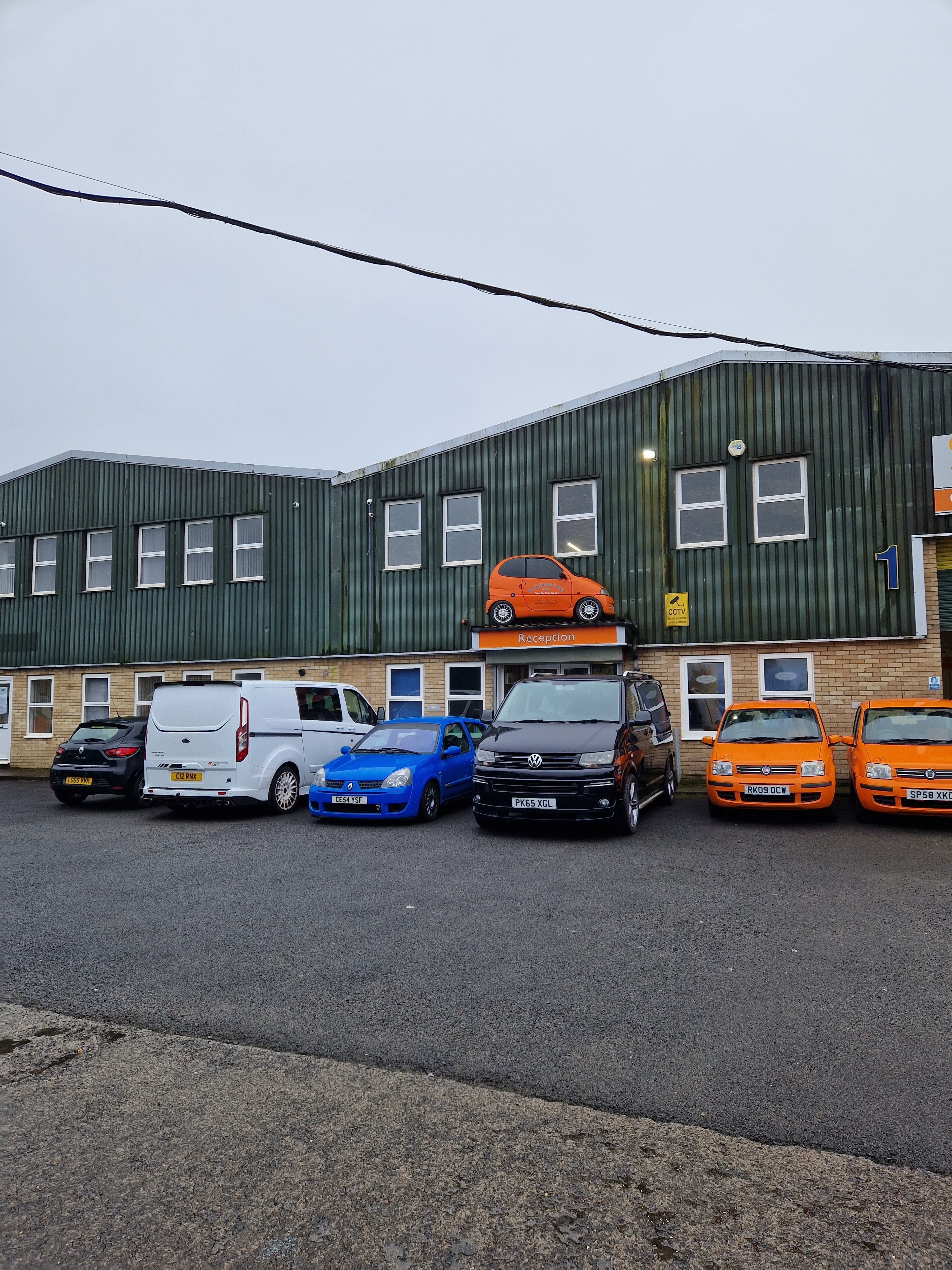

Booked in next month to drop the rear beam, underseal, surface rust treat and rear discs/bearings and pads.

So, recently the clio has been driving me up the wall.
Mainly the above ABS + SERV light.
I tried wiggling wires, checking earth points and a new brake light switch. Thought I fixed it, but I hadn't.
Bit the bullet and bought the ABS module for the RSTuner.
3 codes.
1.ABS front right
2.ABS rear left
3.Steering wheel angle sensor....
The angle sensor threw me, but gave me a clue. And it was a big clue.
Started looking around the column which was replaced for EPAS. No snagged wires.
Looked at the little yellow bubble thing on the steering angle sensor, lined up and moved with the wheel.
Airbag, horn and cruise wires all fine.
Then I saw it. A tiny little 6pin connector, not connected. Where did it go?
The Squib. It wasn't connected.
Plugged in and all the lights are out.

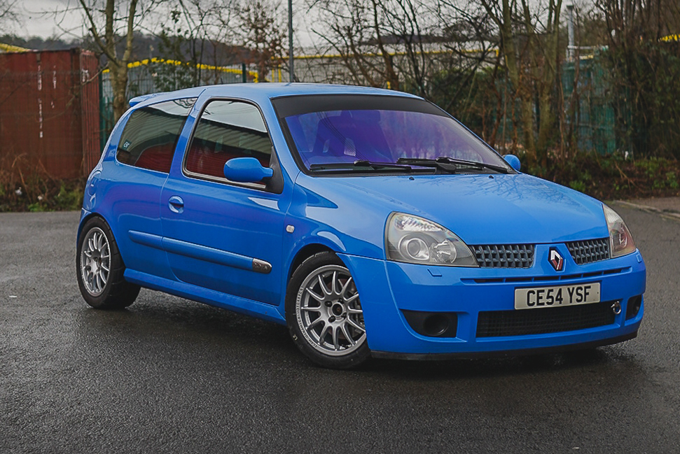

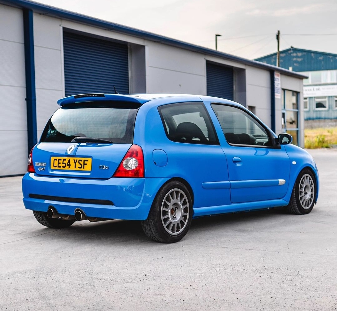

Ball ache for an unplugged connector. Crazy how much better a car drives without lights on the dash.
Here's a picture to celebrate!
