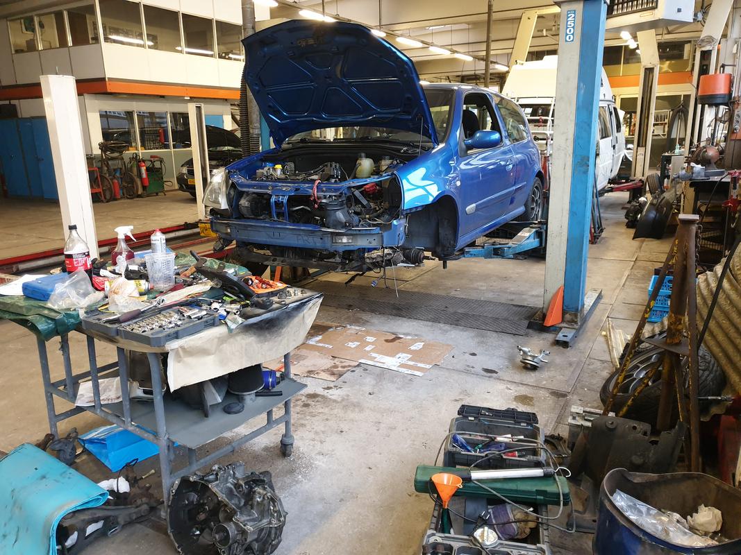

this is what took me 5 days to do:
To Do
  • Set car on ground and torque up wishbones
  • Put wishbone braces back
  • Set camber
  • Set toe
  • Do a testdrive
  • check all bolts etc after a week
Done

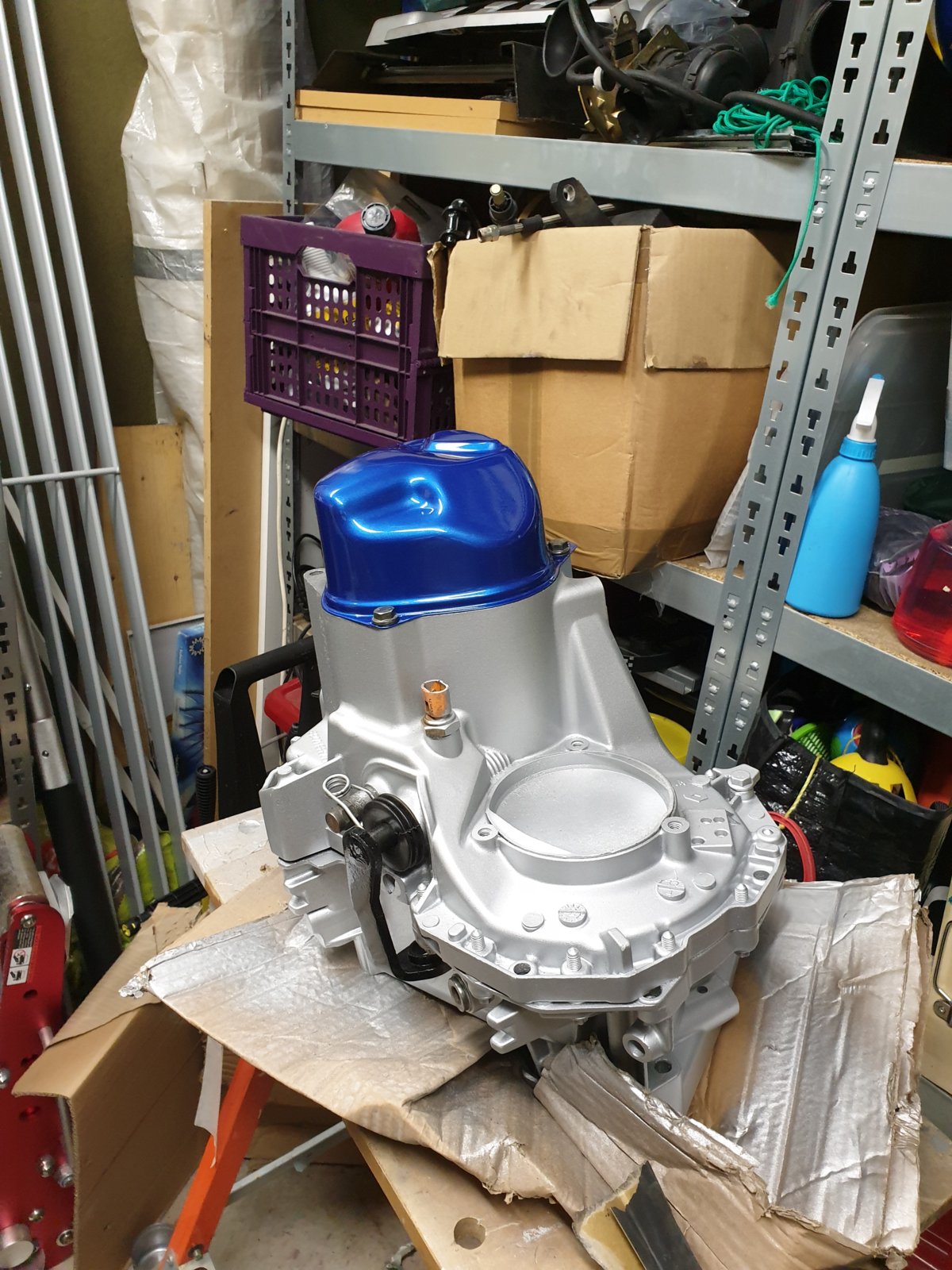

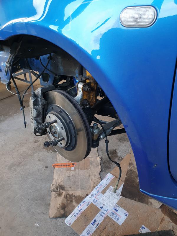

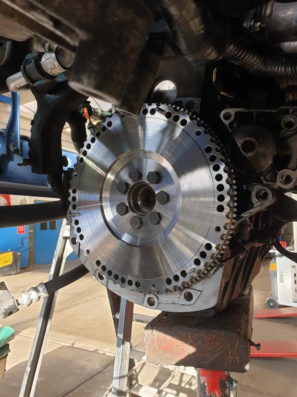

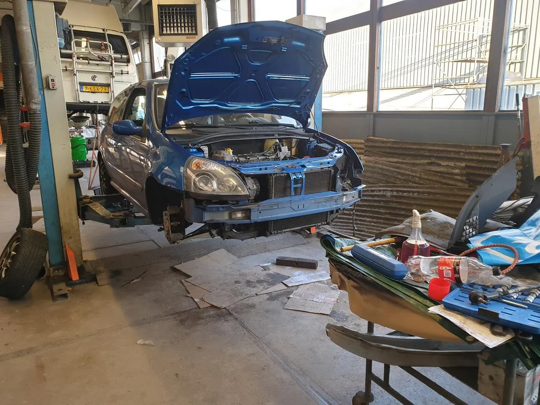

some random pics:

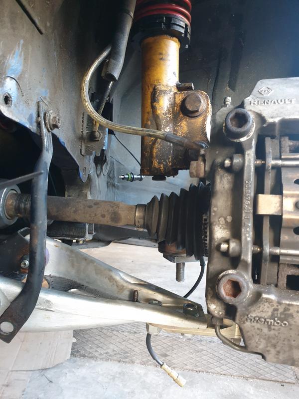

I think I dropped the lhd hub on its steering arm. This created a nick about 0.3mm high.
this allowed the conical piece ( to drop the track rod to seesaw over the nick :eek:
Couldn't make it do that when torqued up, but it always bothered m,e that the problem only was when turning right....
small bit of filing sorted that.
