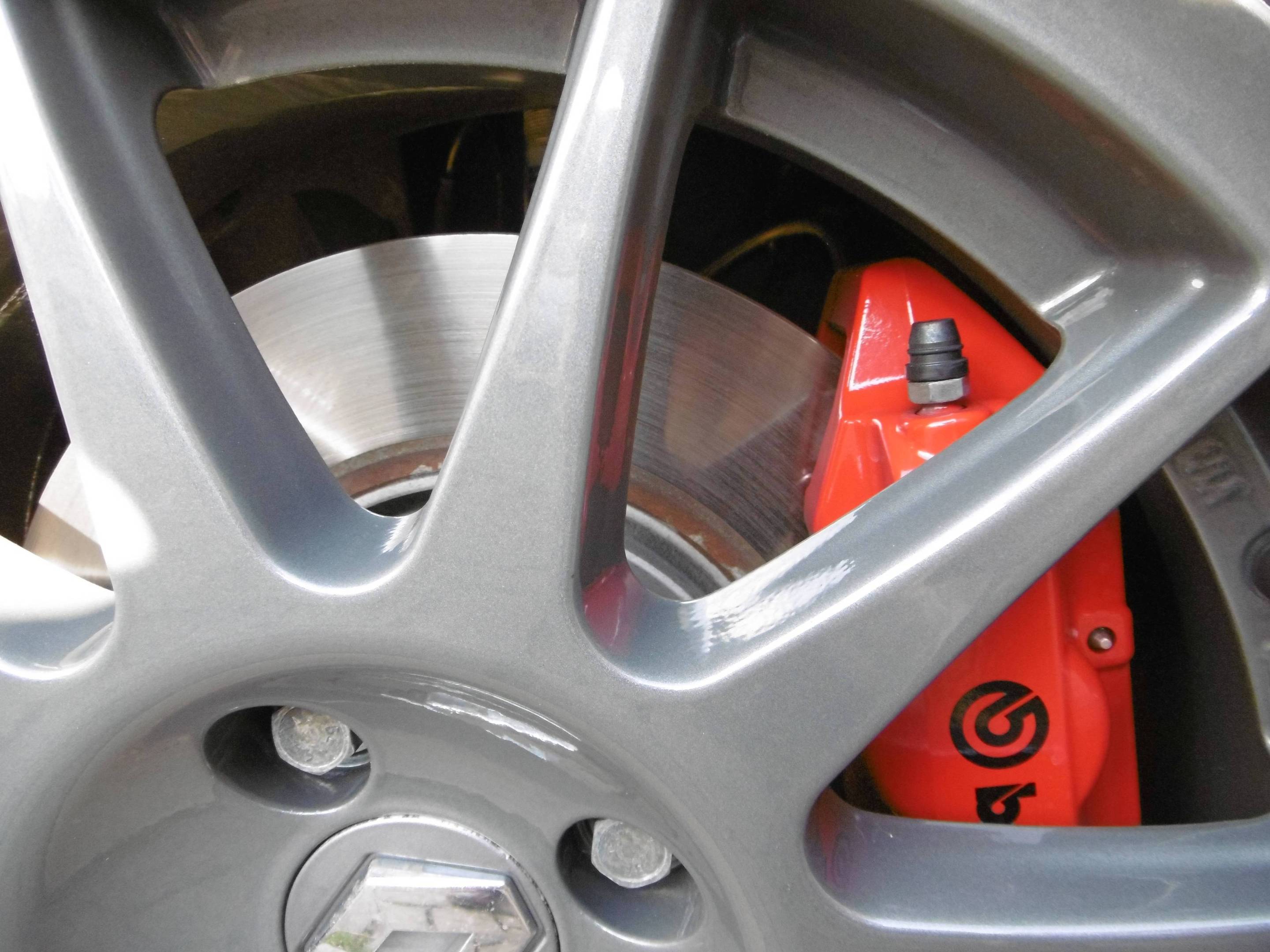

I would recommend the pure motorsport mounts, they are a tiny bit more expensive BUT and its a big but they are much better in that they are offset a little which means the caliper sits slightly diagonally by a degree or two and this means the pad sweeps the entire disc.
You know on standard 182 discs and pads you get that unsightly ring of rust around the outside edge of the face - well with these there is none of that.
look at this pic to see what I mean:
The above is using the 300mm brembo discs and 300mm mount.
Worth every pennt in my opinion.
