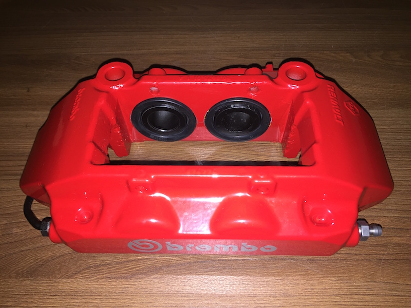

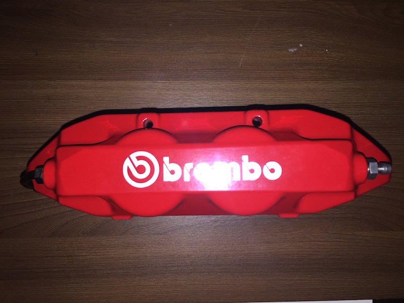

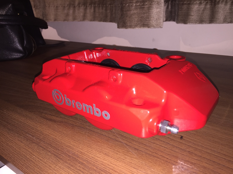

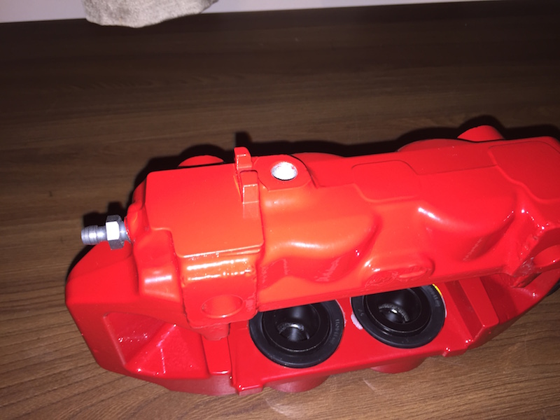

I had my brembos blasted to remove all the old crap, but it did mean that they needed a set of dust boots on them. They were blasted with iron filings from memory as normal blast media either didn't cut the mustard, or was too aggressive.
After that I gave them a coat of Acid 8 etch primer, followed by a couple of top coats. Left them to dry and gave them a coat of lacquer. All the paints I used were the vht stuff (apart from the primer). The application of the paints was nice and simple too. Really rate the vht stuff.
  dan's cast offs.
know a few people who've used the same paint and had good results.
i use halfords adhesion promoter, or whatever they call it, as a primer. have used it on all sorts even ally and it's a good base. goes on like water but let it dry out or chuck in an oven for half hour or so and good to go.

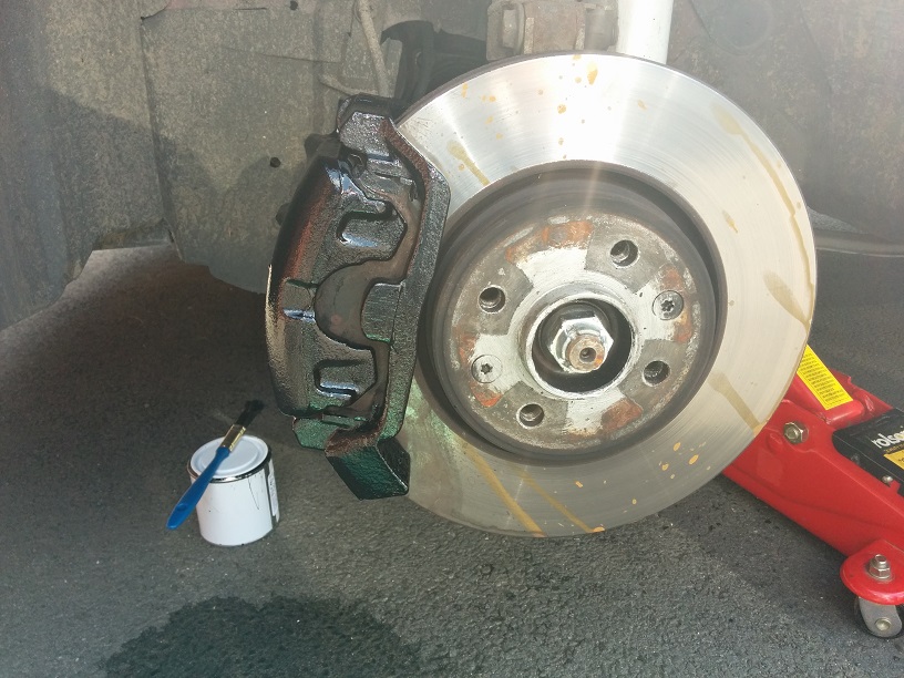

Personally I wouldn't even use the other stuff Steve. Couple of coats of hammerite but don't rush the coats as it runs very easy when too much applied. About an hour between coats.
