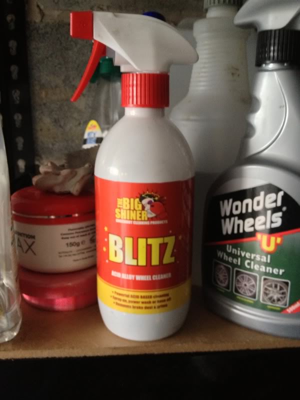

I used this on mine.
It ate the drive but got the s**t off the wheels.
  Golf GT & A4 Avant
Just be careful using that, any marks in the lacquer or paint and I'm sure it'll soon start to eat through it if it isn't already dulling the paint
