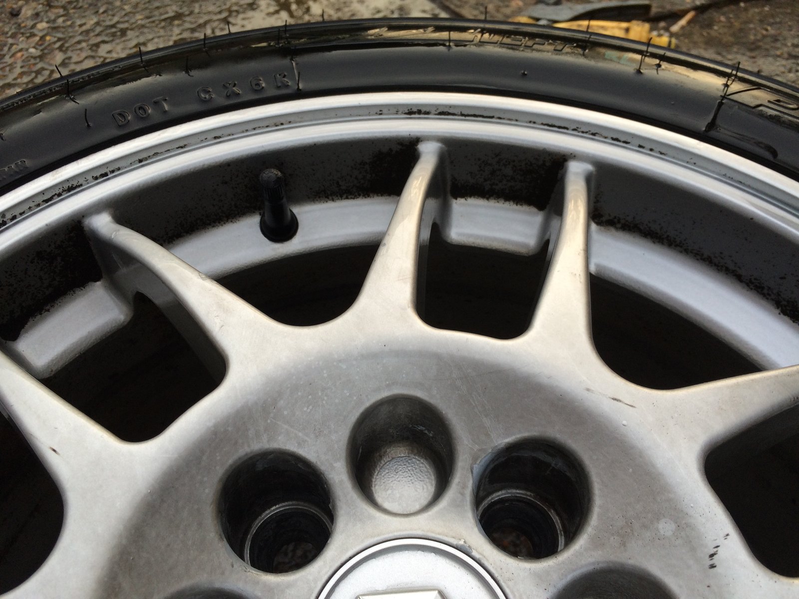

Hi, me and @Bunta are thinking about swapping wheels but he does track days using CL pads iirc and they are quite caked in brake dust.
Is it possible to remove this with a simple wheel or fallout product or would they need to be refurbished? It looks almost like rust and feels rough to the touch but its definitely caked on brake dust.
Any products which will remove this will be appreciated.
Thanks.

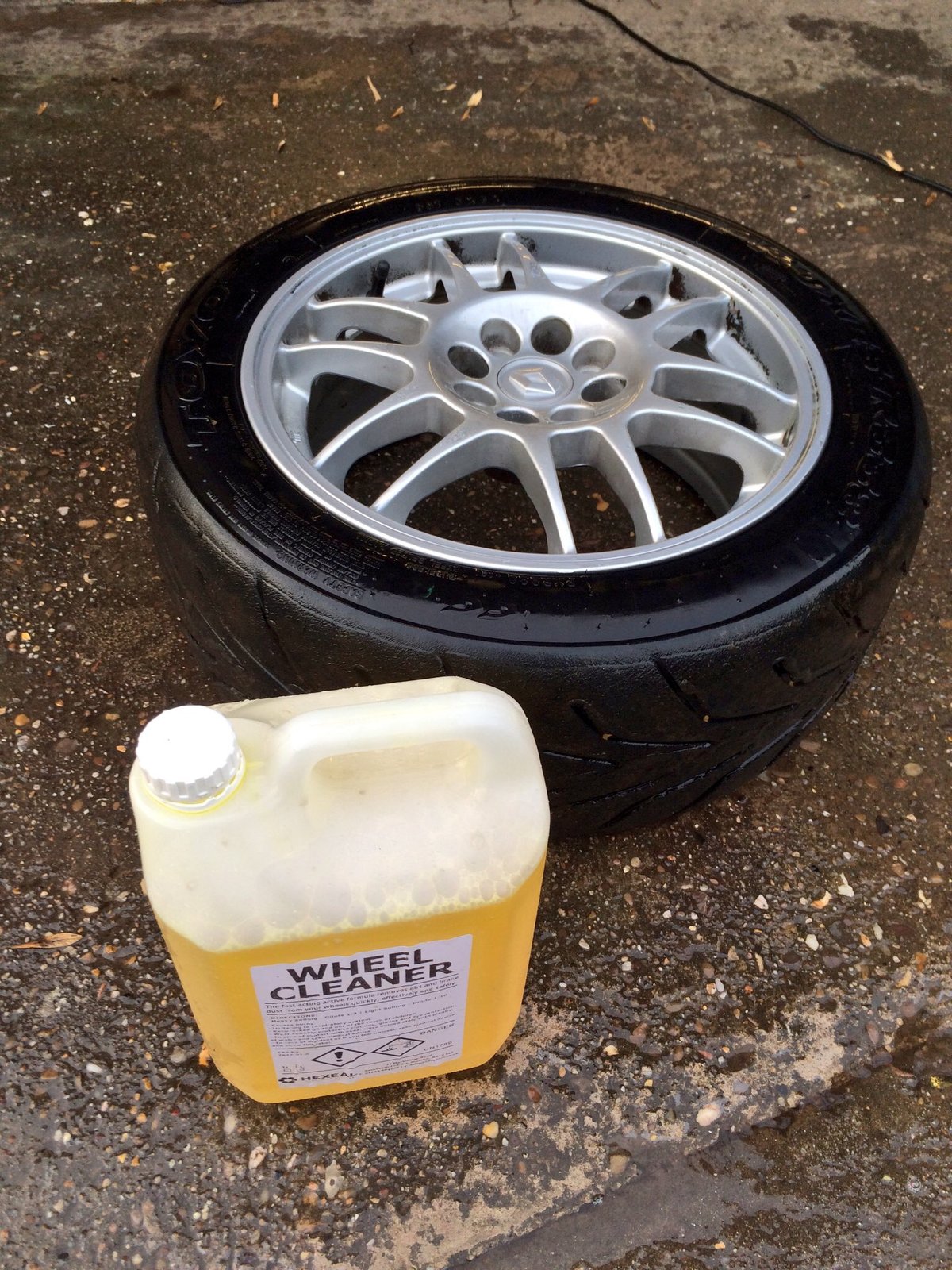

I've been cleaning cars for 20 years and I've never come across a wheel that can't be cleaned up with decent acid.
Only use it once though and ideally with the wheels off the car as the acid will discolour the calipers, make the wheel bolts rusty etc.

I have the same issue having used CL pads. Wheels seem ruined. Nothing is touching the baked on dust! Gone through lots of wheel cleaners and fall out removers.

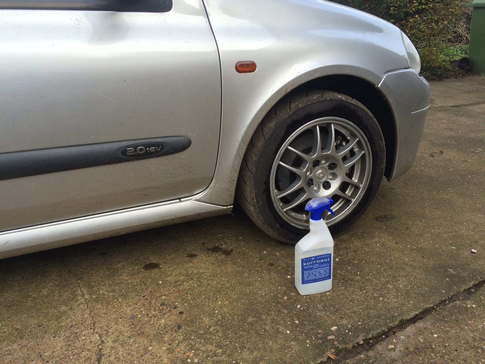

Ironx, failing that, ironx paste.
It'll be reet.
http://www.cliosport.net/threads/ca...ia-vrs-bleeding-content.773303/#post-10744406
Wonder wheels won't touch the majority of it. With it being a cleaner and fallout remover it's not as potent as a dedicated remover
