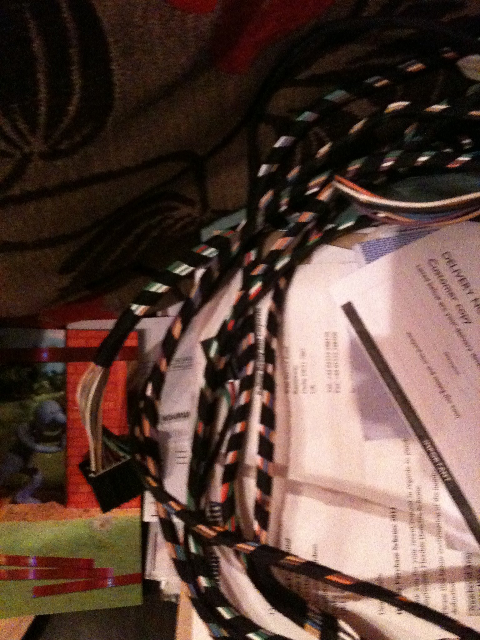

Would love to do the loom in my track car though, just to simplify the loom alone.
This is my interior loom that's been simplified and rewrapped.
My advice is - re-wrap your original loom to tidy it up and forget about it. You just can't save any noticeable amount of weight from doing the Clio loom unless you rip it all out and start again.

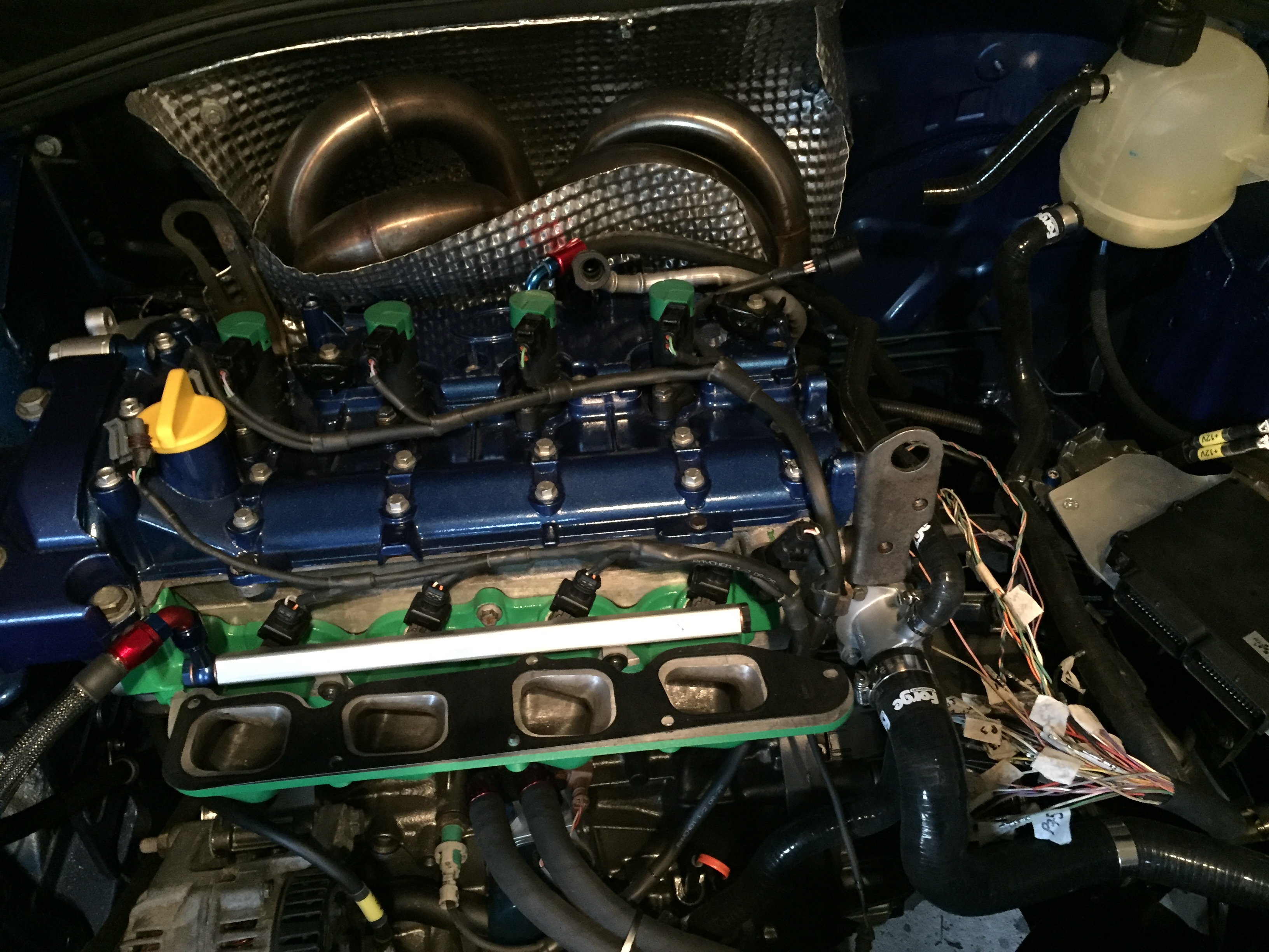

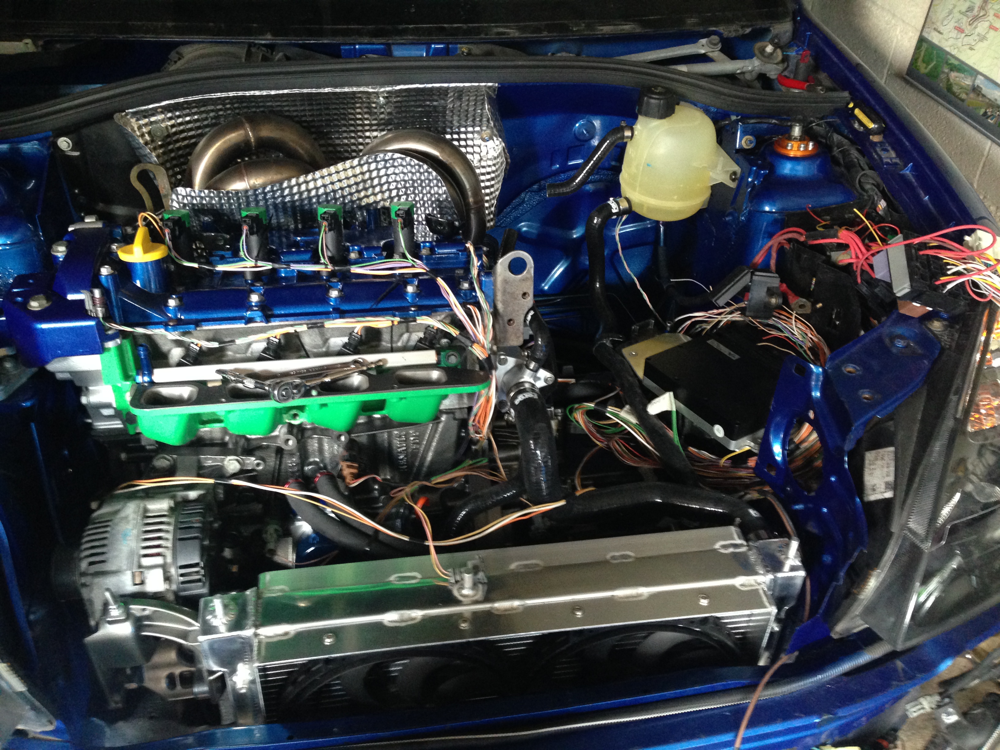

On a different note, I came across this picture whilst I was scanning through them on my phone. It's already been posted, but gives a good idea of how much the wiring has come on.
Then:
And now (from yesterday):
Then:View attachment 138849And now (from yesterday):View attachment 138850
I feel your pain doing the loom mate, took me ages to get it all looking neat

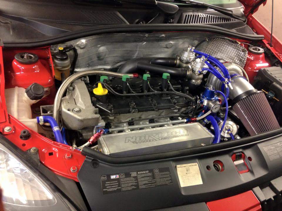

😊.. No wonder you have problems Steve, there appears to be a turbo where I have a battery.
  Trophy,R26,GSXR1000
I think it's the only photo I have of it, Specky took it when I was getting my running in map, just used gate pressure that's why the boost solenoid is disconnected and the vac pipes is off.
Must admit I pop in here often to see how your getting on with yours, think your the N/A equivalent of me LoL
