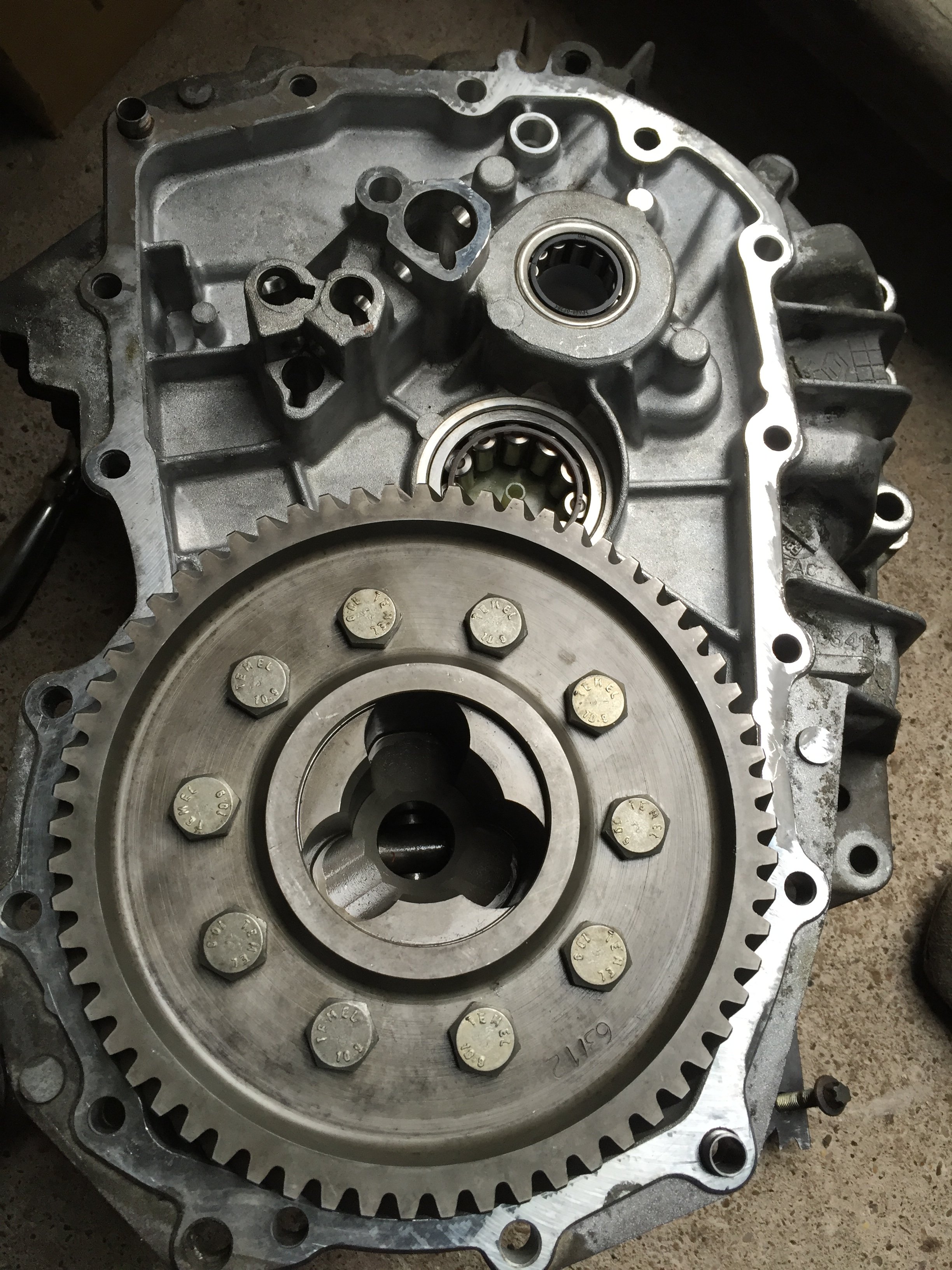

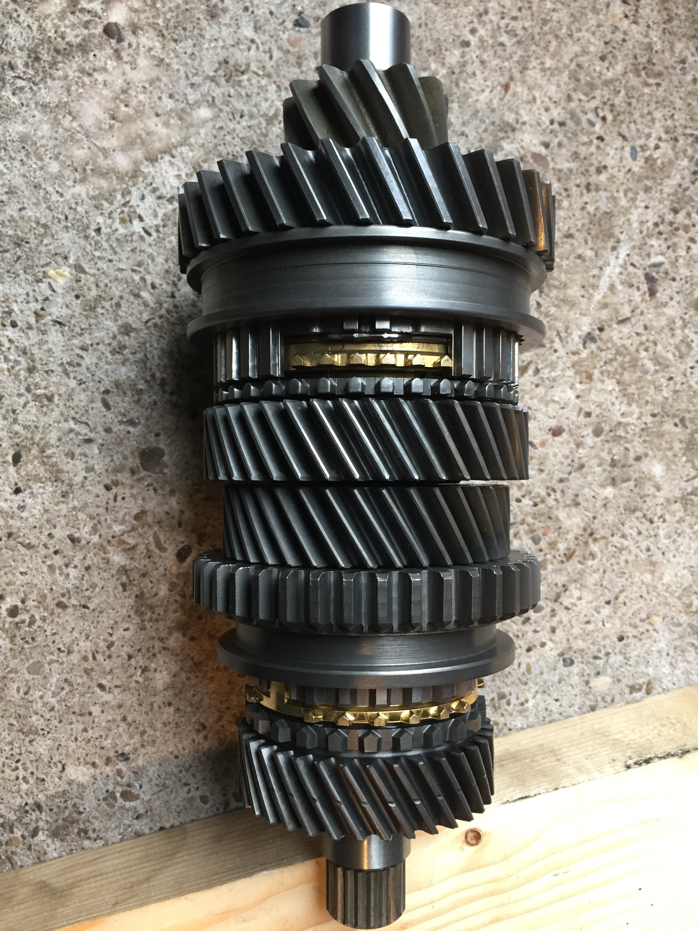

Nothing to update I'm afraid, but I have been in the garage! The time spent in there has been used doing some odds and sods, but nothing cup related.
Here's a couple of pics for you!
Yes that crownwheel is funking huge! The casings had to be modified to allow the diff to turn! Lol!
A bit of gripper diff, crownwheel and pinion action. I'm building this up for a member on here. He shall remain nameless unless he chooses to speak up. :wink:
More to come. :up:

Never imagined the crown wheel would be that big,

I know mate! It only became clear just how big the crownwheel is when I fitted it, or at least attempted to!! Lol! Die grinder to the rescue to relieve the casing.
