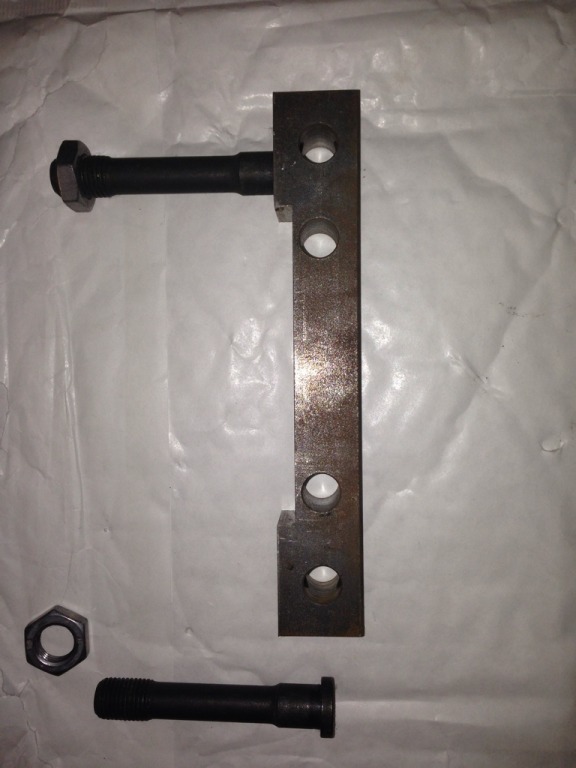

No not really, with 300mm disks there is just enough room to use the standard renault calliper bolts. Yeah they're steel mate, need to be as you said. Using the same offset disks as standard will require the equivalent of a circa et10 wheel, more with a 288mm disk.

Good quality key steel is what mines look to have been made with.

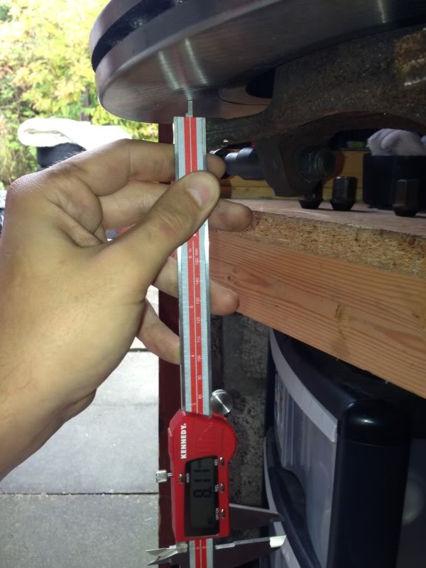

Out of interest how far from the face of the disc does the calliper protrude towards the wheel? And how much does it add to the radius of the disc?
Yeah 2mm more clearance from the spokes in your example, but it's just an example. Bells and rotors are done in offsets typically though.
No measurements but a good bit as they aren't a slim calliper, try and find something like the below drawing (top left cross section and drawing below that) for the Brembo callipers and cut it out to scale and slide it over the disk for clearance. It's the the angled bit on the inside of the rim that it hits on 15" wheels I have tried.

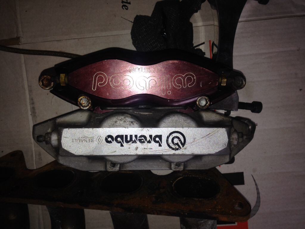

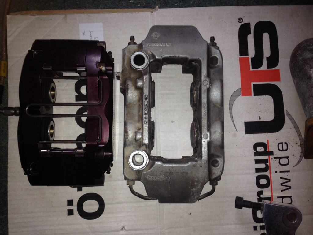

You can see in the second picture they have been machined on the 'plaque' face it seems for clearance. Was they from a twingo rally car?
Well I thought I'd upload a picture for you too compare sizes..

Yeah thanks for that, shows you why I feel I'm pissing into the wind.

The benefit is a larger pad area on the Brembos (around 20x10 bigger)
Also with the Brembos being monobloc they are more rigid.
So if I can run 288x26mm with the Brembos I'm not sure I'd see a benefit going 295x24mm with the Wilwoods.
