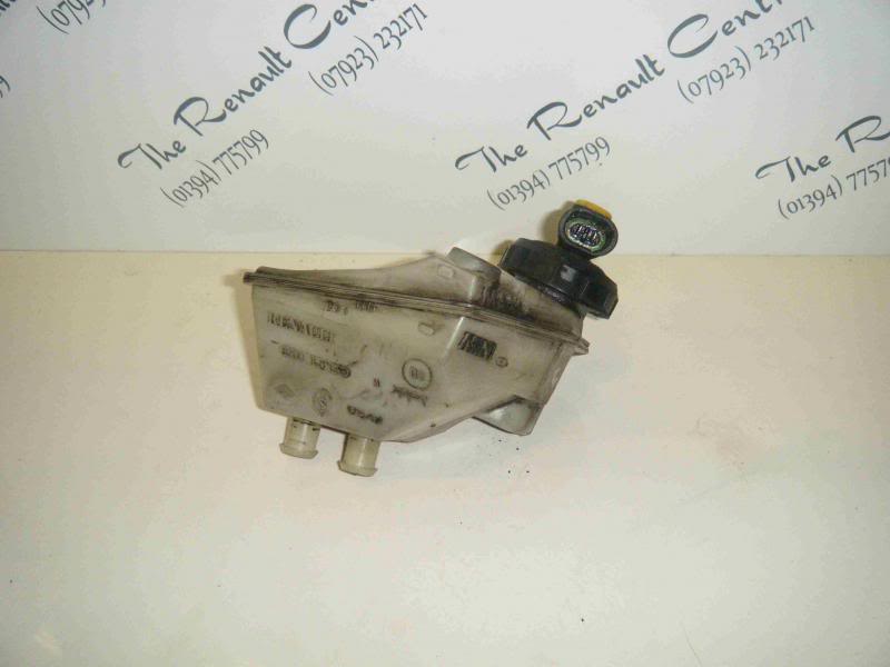

I cant work out if a pipe is cracked or the plastic reservoir is cracked, somehow the top of the res plug got caught under the jacking point and the back and lowering it had ripped it downwards.

Having a look at a reservoir, the two out/inlets on the bottom... are the hoses flexible or ridged?

Got any brake cleaner? If you can, clean it all up properly, get a mate/your mum to push the pedal (slowly!) and you'll see where it's leaking from.
I have yeah, good idea, I was so fuming I couldn't think straight, after work tomorrow Ill remove the reservoir... how? and then look.

If its the fulid reservoir then its not on the pressure side of the system.
I think the reservoir is just a push fit into the master cylinder. There should be 2 black O ring/grommet seals in the top which it just pushes into.

Cheers tony, seeing as I caught the lid and pulled the res down I hope its just popped off... or do you think its possible Ive cracked a pipe? res seems to sit much far forward to the front of the car than it has before...
It's back on now, took a few pulls to get it out, inspected it, no damage, cleaned it, made sure it was bone dry then put it back,
It was fiddly like you said, hard to get the back tube in,
Filled with new fluid and eezibleed bled through a liter.
