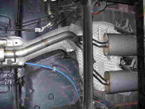

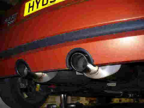

Right, the system has been designed and built after 6 days of hard work by Joe Ellis at BTB. Its been sent away for noise testing and when its back (should be by now) he's gonna make the jig so that the system can be reproduced, once the jig is done we will have the car back. Here are some pics for you guys to feast your eyes on until then (hopefully they won't be too big). Any questions, just fire away.

fmp. A few Qs on the exhaust.
Why two back boxes not one like an Orbisoud?
What bore is the pipe?
Are the silencers chambered?
What options will you offer ie louder and a sports cat?
Are you doing before and after RR?
Does it have a removeable decat section?
Price seems high for that money I would want a sports cat aswell.

looks nice from the rear shot. is it only 182 exhausts your doing??
We'll just be doing 182 for now, as the development costs are quite high, a 172 BTB mat be along later, it all depends on the feeedback we get on this system.

Mat (FMP) isn't about and has done most of the dealings with btb. I'll do my best to answer your questions as much as possible. Some details I can't give right now, we won't know all of them until we pick the car up as btb have done all the design and development, none of it has been done by Shed Motorsport.
Without asking Joe at BTB directly I would say that he has chosen this set up using information gathered from the very expensive simulation program he uses, Ricardo Wave. This program models things like exhaust pulses once all the details of the engine, inlet and exhuast system have been entered. The two boxes may also be as a result of our request to make the system sub 98db so its suitable for track days. With the orbisoud being a race exhaust it wouldn't need to be so restircted in terms of noise and can get away with just a single rear box.
I "think" the bore is 50mm, although 54mm seems to ring a bell. More news on this later.
Simple answer, i don't know, but i would think that they are to meet noise restrictions. Again, more on this later
As quoted before the limit we have set is 98db, I doubt anyone would actually want anything louder than this.
BTB have there own 100 cell FIA procat. The decat section will be removable, so I think think that a sports cat would be possible. Don't quote me on this but I think the guys at BTB have designed it to function properly if a cat is installed.
A before figure was obtained at regals rolling road in Southampton, the car will be going back on the same rollers once we have it back.
See above
The price may seem "high", but you get what you pay for, hopefully this will be reflected in the gains we get. Mat has all the pricing details so i don't know what he has based that price on, but the prices drop considerably once we start ordering in quantities, i'll ask Mat about it asap, so watch this space.

Mark, dont worry about not having a single rear silencer at the rear. Having a single rear silencer and having the split inside the silencer isnt great for flow, its more of an attempt to equal up the lengths to tailpipe from the 'Y' split. Unequal lengths lead to unequal pulses and all sorts of mayhem.
As for cost, i think the problem is that the general public have been so used to off the shelf mass produced exhausts that cost £350, are made of taiwaneese stanless, mig welded in a matter of seconds, have zero detailing or design influence.....where they are basically built to be big bore, loud and to fit the 'hole' of the original.
A proper exhaust by the likes of BTB etc with hand built silecers, tig welding all round (which takes ages to do nicely, and the skill itself is highly sought after), quality stainless and at least an attempt at theoretical design, the price isnt so scary and can be considered a bargain to a 'racer' or a serious power enthusiast. In other means, the quality pays for itself and can carry a level of bragging rights.

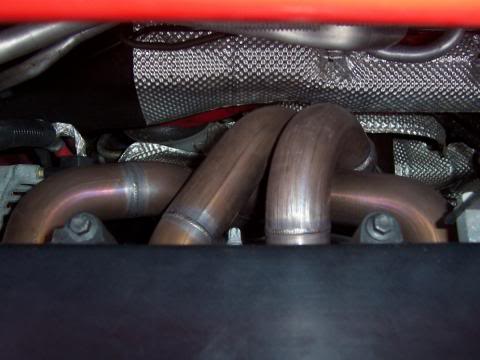

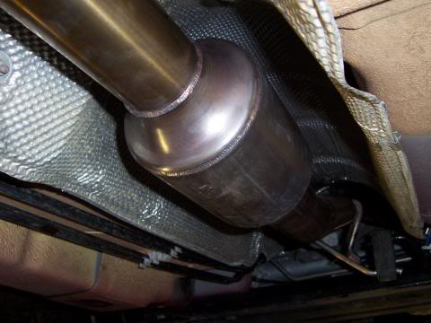

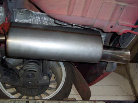

Thanks a lot for your comments Ben:D, as you rightly stated, people are too accustomed with mass produced rubbish. On another thread, someone seemd concerned about the quality of the welds, for those in doubt, here are some pics of the Fiesta ST system that BTB produced.

the bore from the y peice going into the backboxes seem smaller than the centre section are they?
50mm bore? 2inch system? isnt the standard system 2inch bore?

i am 99% sure the bore of the system is 63mm, until the final back box split. which obviposuly doesnt need to be so big.

I see nothing special there design wise. Got any internal pics of the y piece ? Unless the special bits are in not in that pic ? ;)
Build quality looks good though.

I'm of the opinion that exhausts are very rarely something that you can "see" anything special in terms of design. A lot of it is down to the lengths of the pipes and the spacing of the resonators, construction of the resonators etc etc. AFAIK there are 4 boxes in total. As to whether it is actually anything "special" in terms of power gains, we'll just have to wait and see.
No pics of the y piece. Sorry.

There ended up being 3 boxes in the end, consisting of 1 resonator that replaces the cat and then the 2 rear boxes shown in the pics. Originally there was a small 4th box just after the cat but BTB had problems with it rubbing on the bodywork. BTB noise tested the system with and without this box and it barely made any difference so has been left out. The resonator box at the front of the system can be replaced with a btb 100 cell procat, or the suprisingly efficient original 200 cell metallic cat (not the usual ceramic and restrictive type of cat), to use the original cat it will need to be sent to btb for modification.
