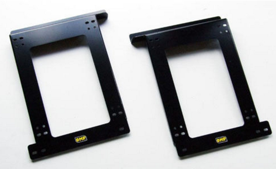

These fit perfect:

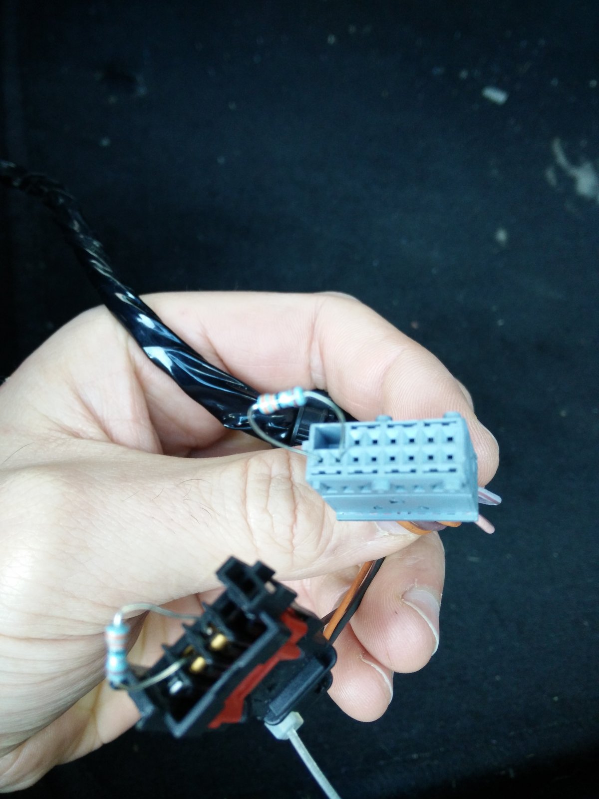

This aint my picture but grabbed it from another post showing how to bodge /fix the cable doo dars. Works perfect with no warning lights. 3.3omhs resistors.

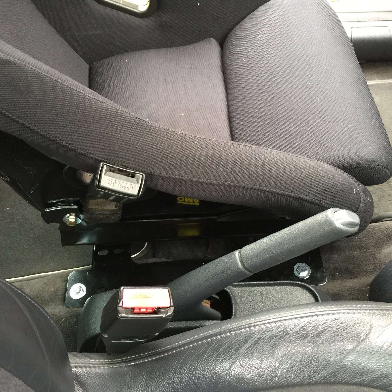

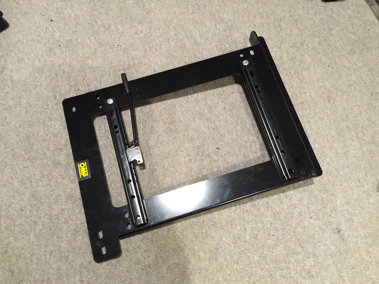

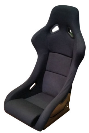

Hiya. Pics of the OMP subframes already posted above. Got the first seat fitted which shows how they sit on the subframes.. pictured below Only had to drill 2 holes in the subframe to get the runners to line up. The subframes are ebay no. 331704247313 and the runners were ebay no. 250840724515, and the seats 161375123975. You can choose different runners/seats but I recommend the OMP subframes, they are vehicle specific for clio and fit perfect. They jusy happen to sit at perfect height but are adjustable up or down about 30cm on the seat side mounts.

You need x4 m8 45mm stainless steel bolts and nuts (or use nuts removed from before) to hold the subframe to the floor (per seat). You don't need to drill holes in the subframe for it to meet up with original holes to attach to floor... you only need 2 new holes in the subframe for the purpose of attaching the runners.
You might not need to drill 2 holes if you buy different runners as they might have correctly spaced holes, but i needed to.

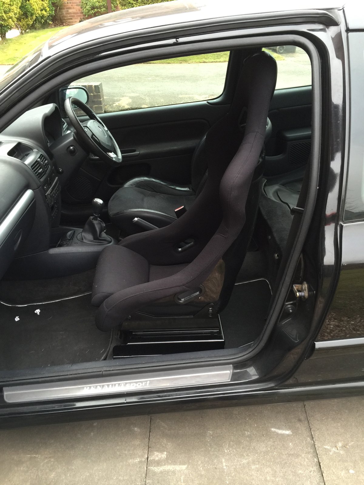

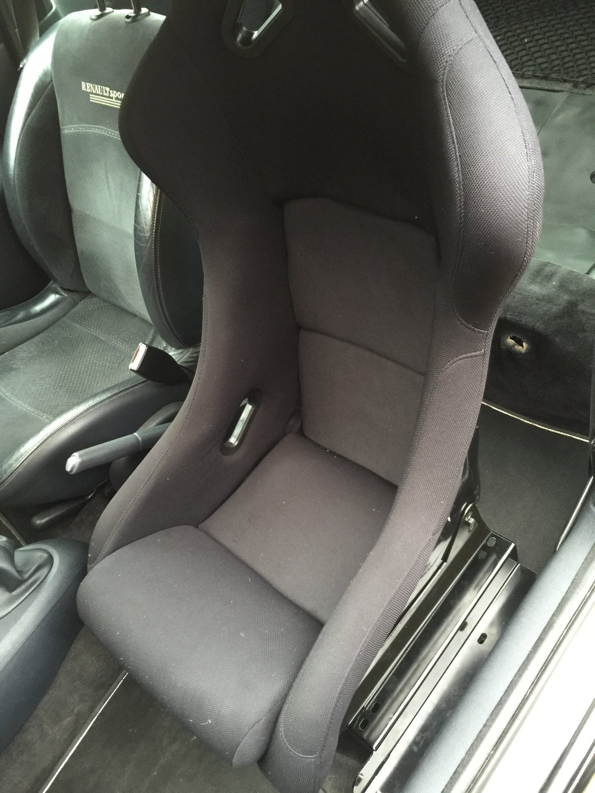

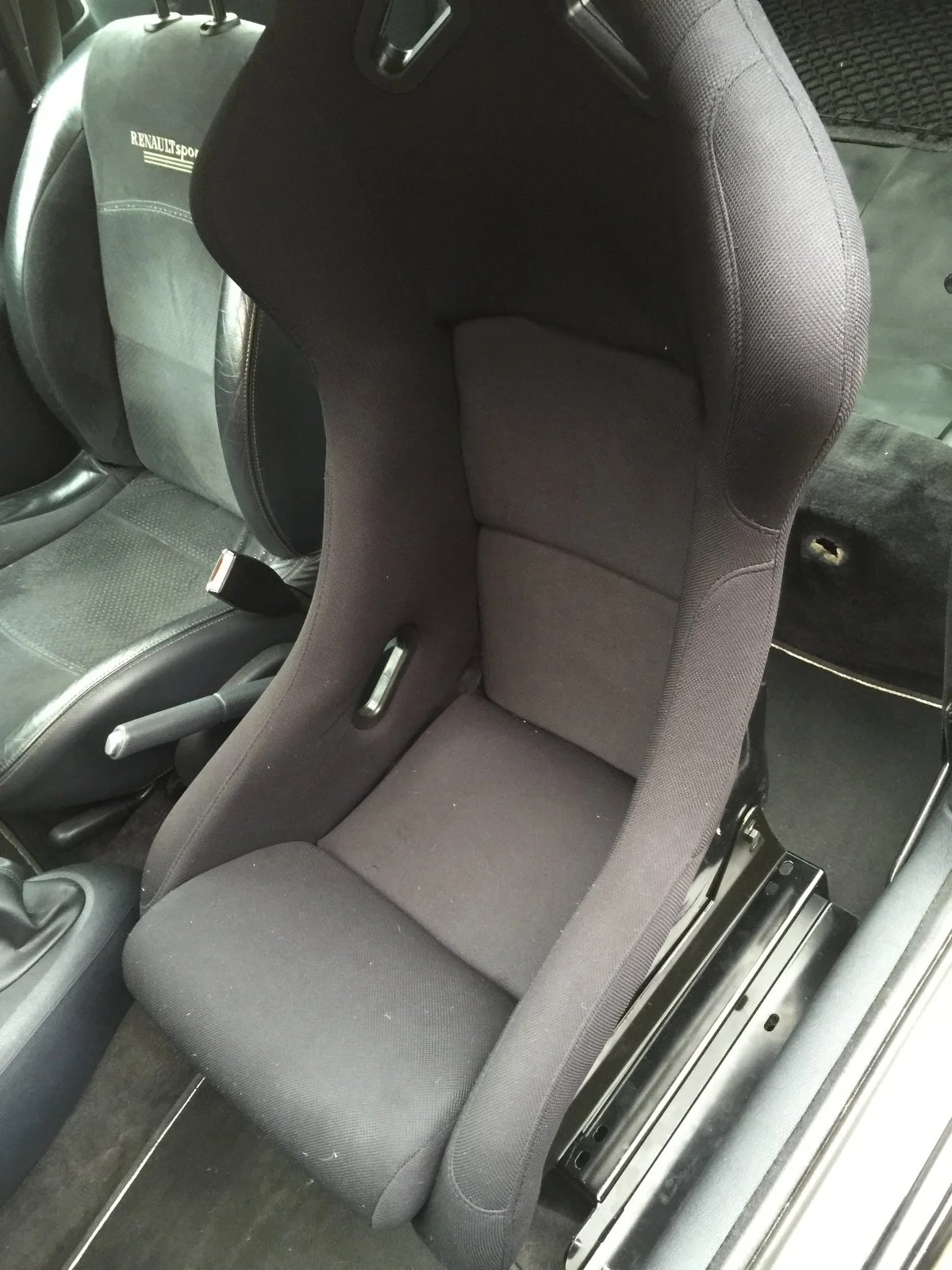

Here is pic of part assembly of drivers seat prior to attaching seat:

Also, that passenger seats looks a little higher than standard?
Interested to see if the drivers seat is lower as this is one of the issues i find being higher than comfortable.
  RS182 Full Fat
Nope.. the part you sit on is lower than the original seat. And you can go 1 cm lower than what i have them in pics. They just look higher because they are taller with higher head rest, and camera perspective.. you will sit lower to the floor!

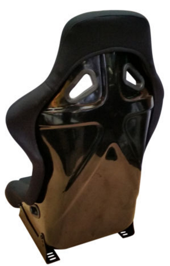

Oh if getting same seats measure ar*e first.. I am kinda slim (34cm waist) but they are a squeeze to get into.

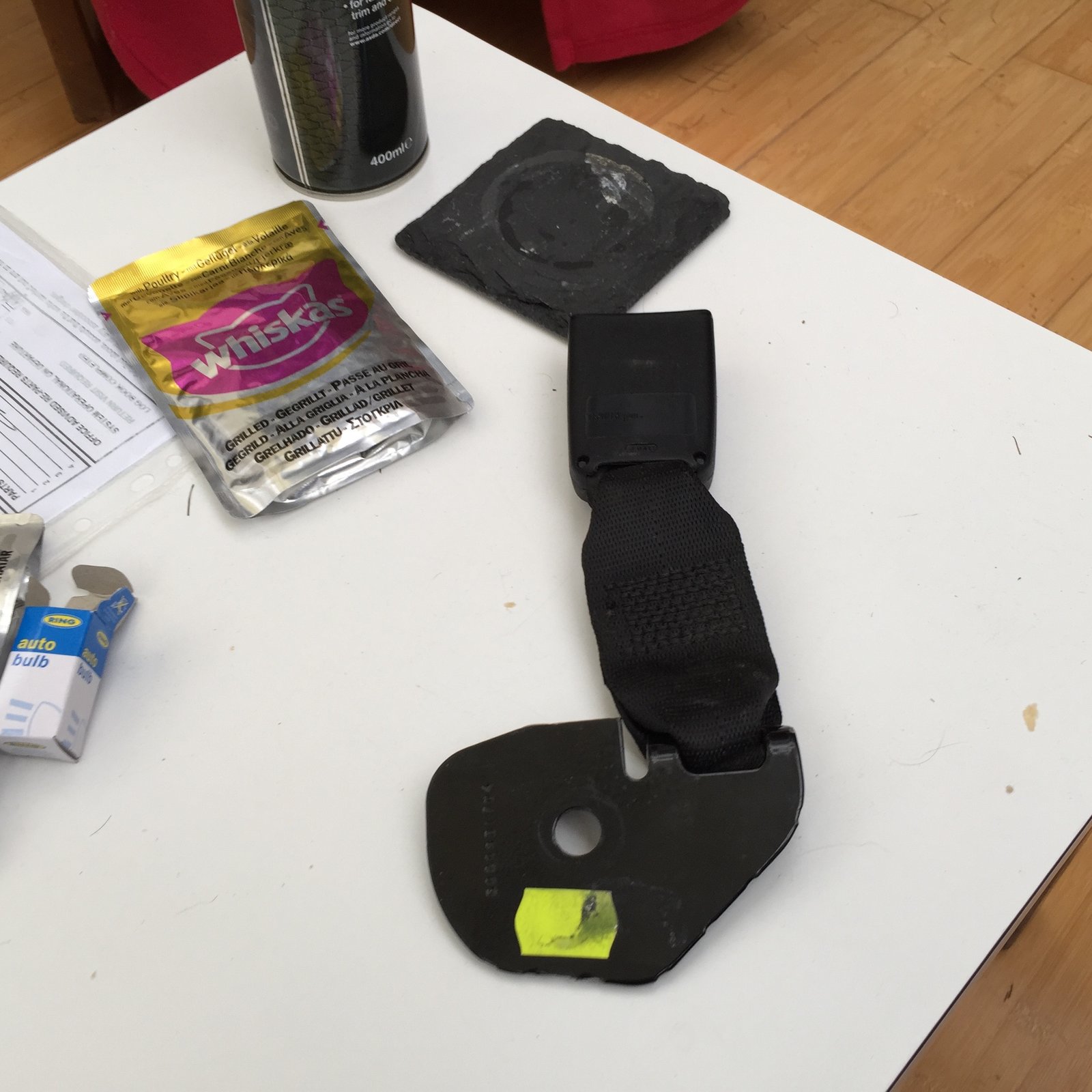

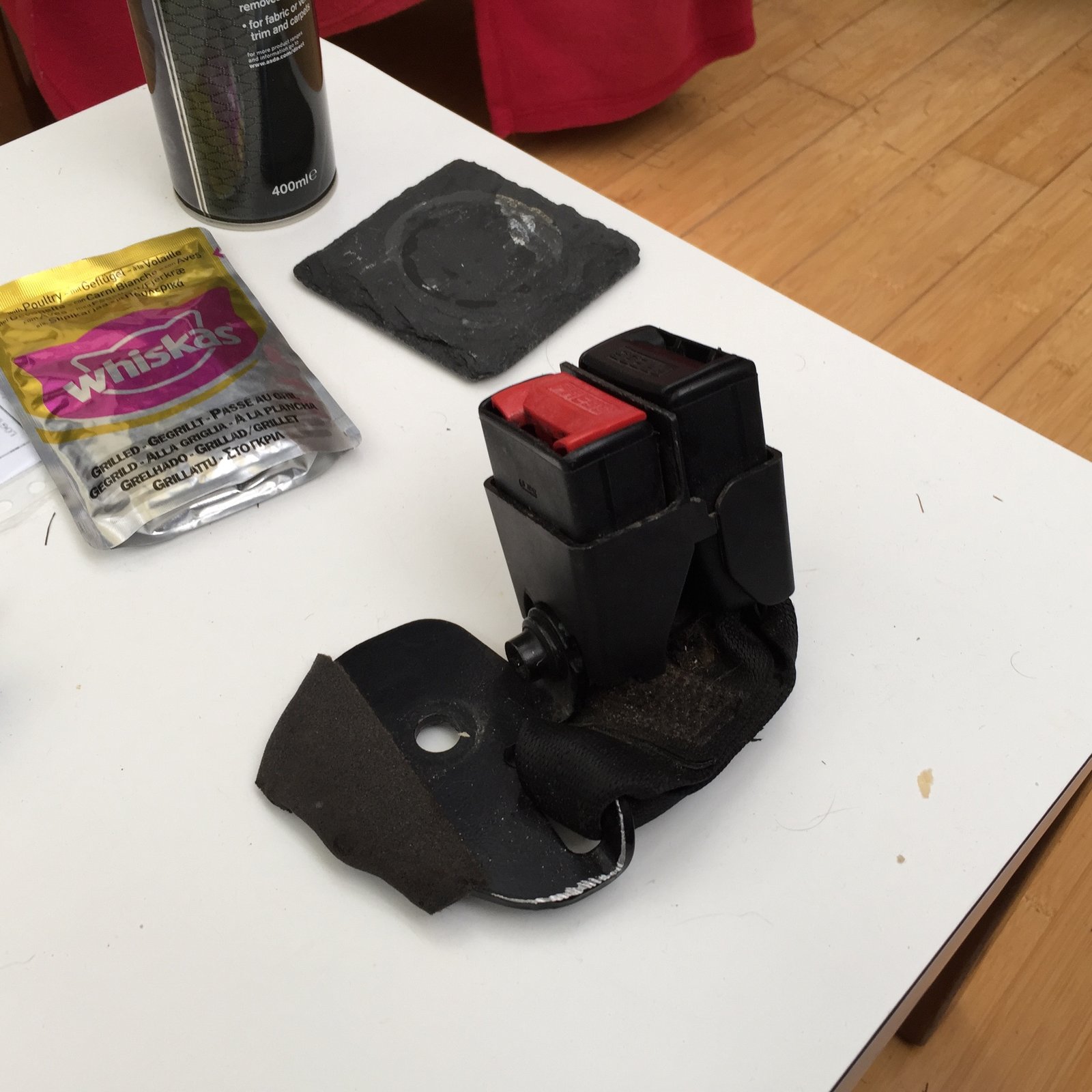

sorted seat belt fix by modifying the rear belt parts.
Using this part and cut away at it until i was left with whats shown in the 2nd picture
to this:
Fits perfect but took half hour to cut the metal seat belt fix as i don't have an angle grinder
