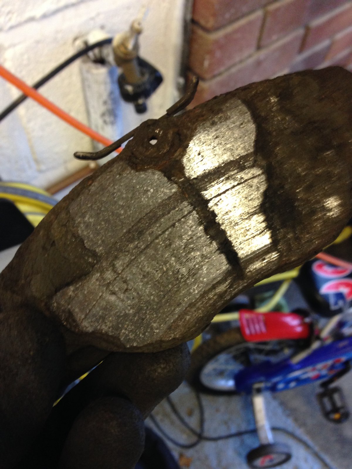

I've had the 2500 on and off track. Waste of money, imo!!
You mean you were on the track, & then this happened,
and suddenly you weren`t?
