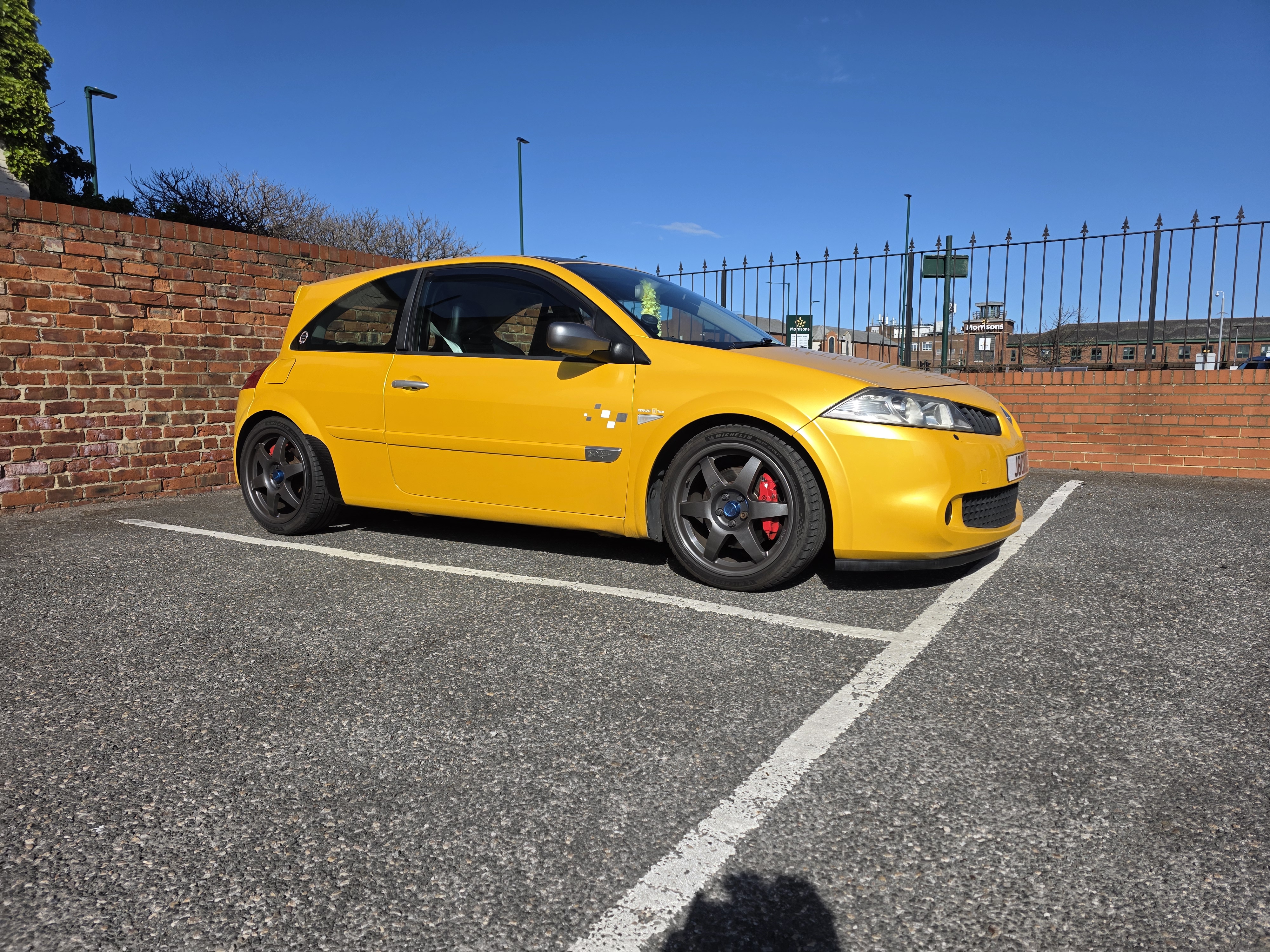

Bumblebee 2 featuring LY R26
That leather looks fresh!
Not bad for £100 too

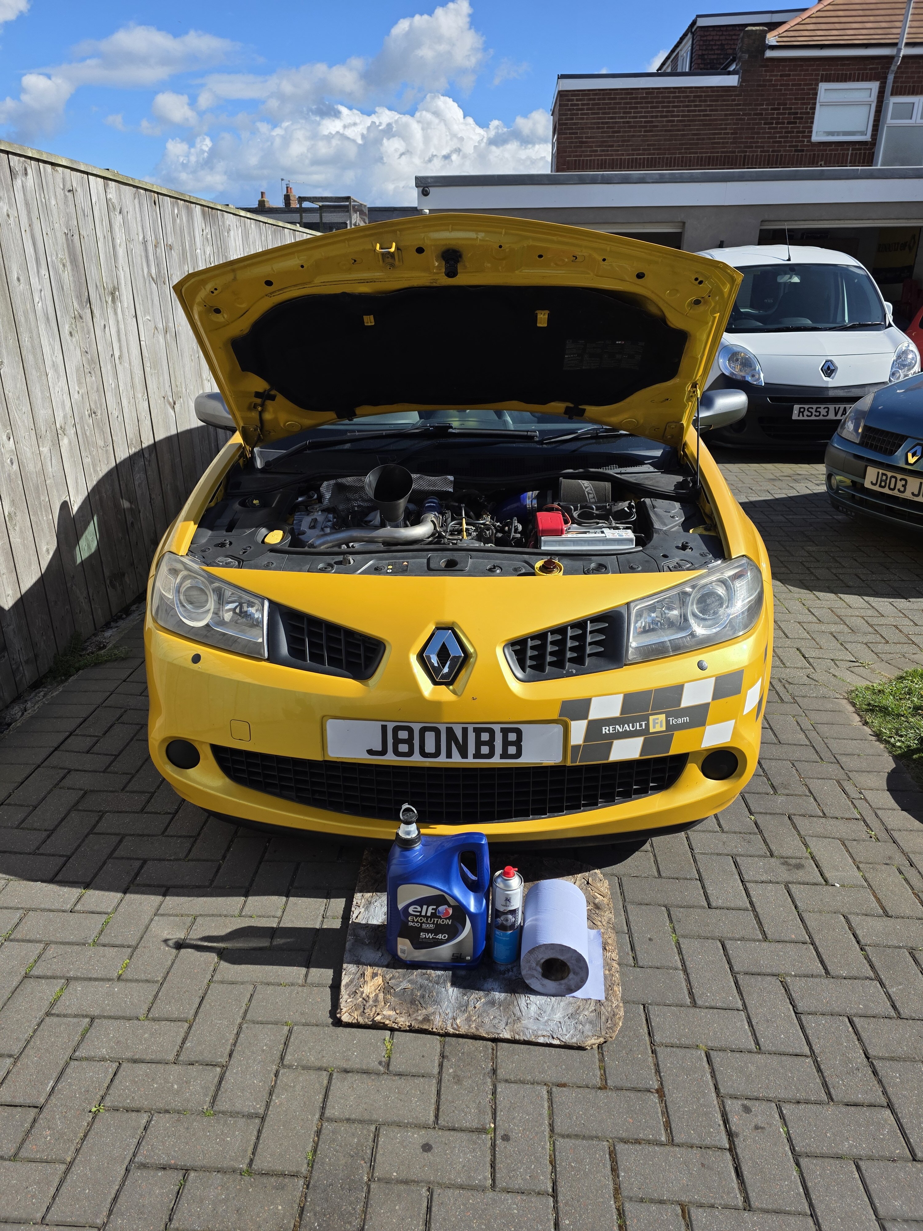

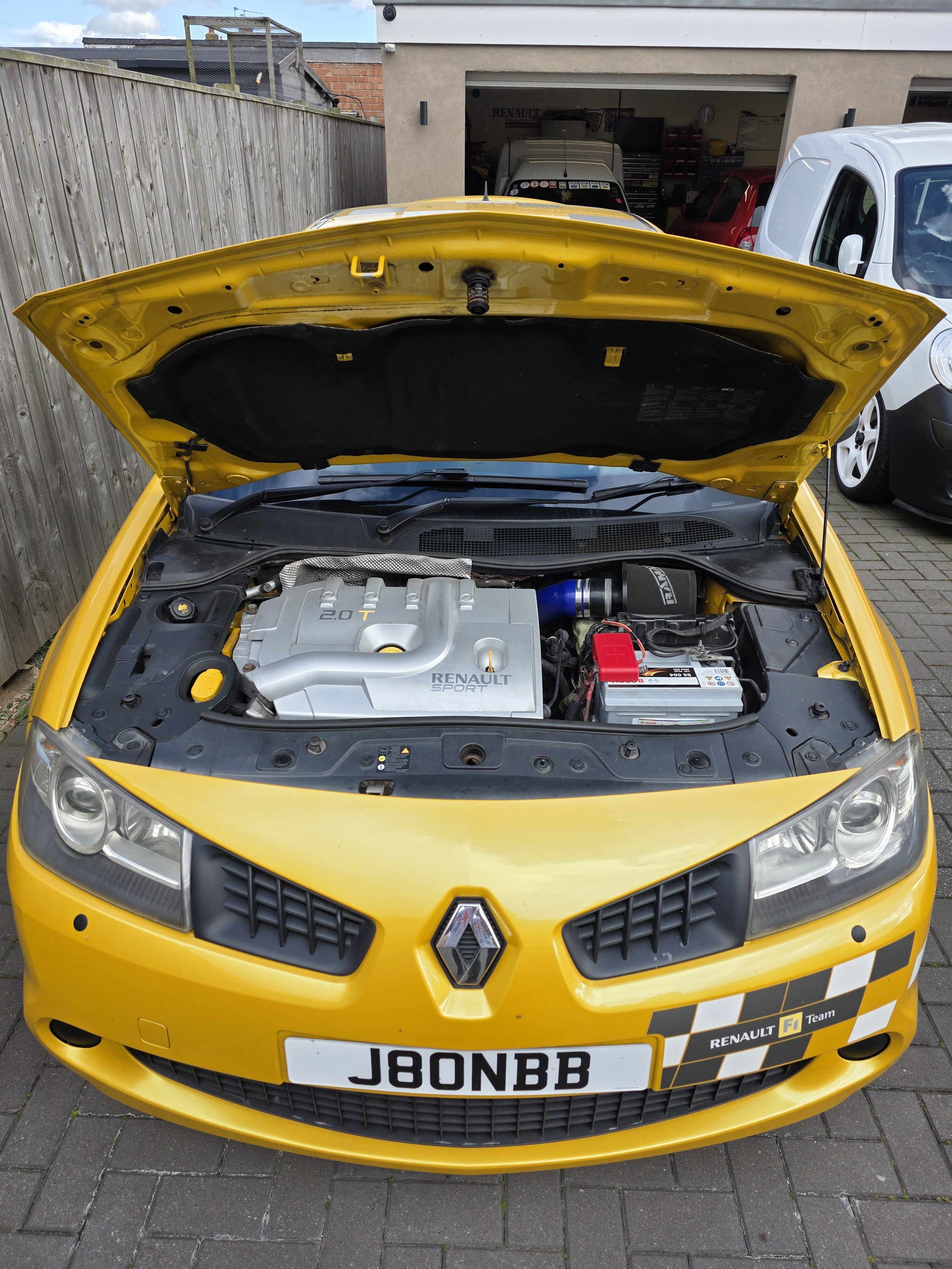

Fluid change yesterday. Fresh Elf 5/40 and purflux oil filter.
Also changed the gear oil with Elf nfx. I put fresh elf nfj in when i rebuilt the suspension approx 12k ago, it was typical ndo when cold, bit notchy but overall fine no issues when warm. The nfx has suprisingly improved cold shifting, so nice bonus.

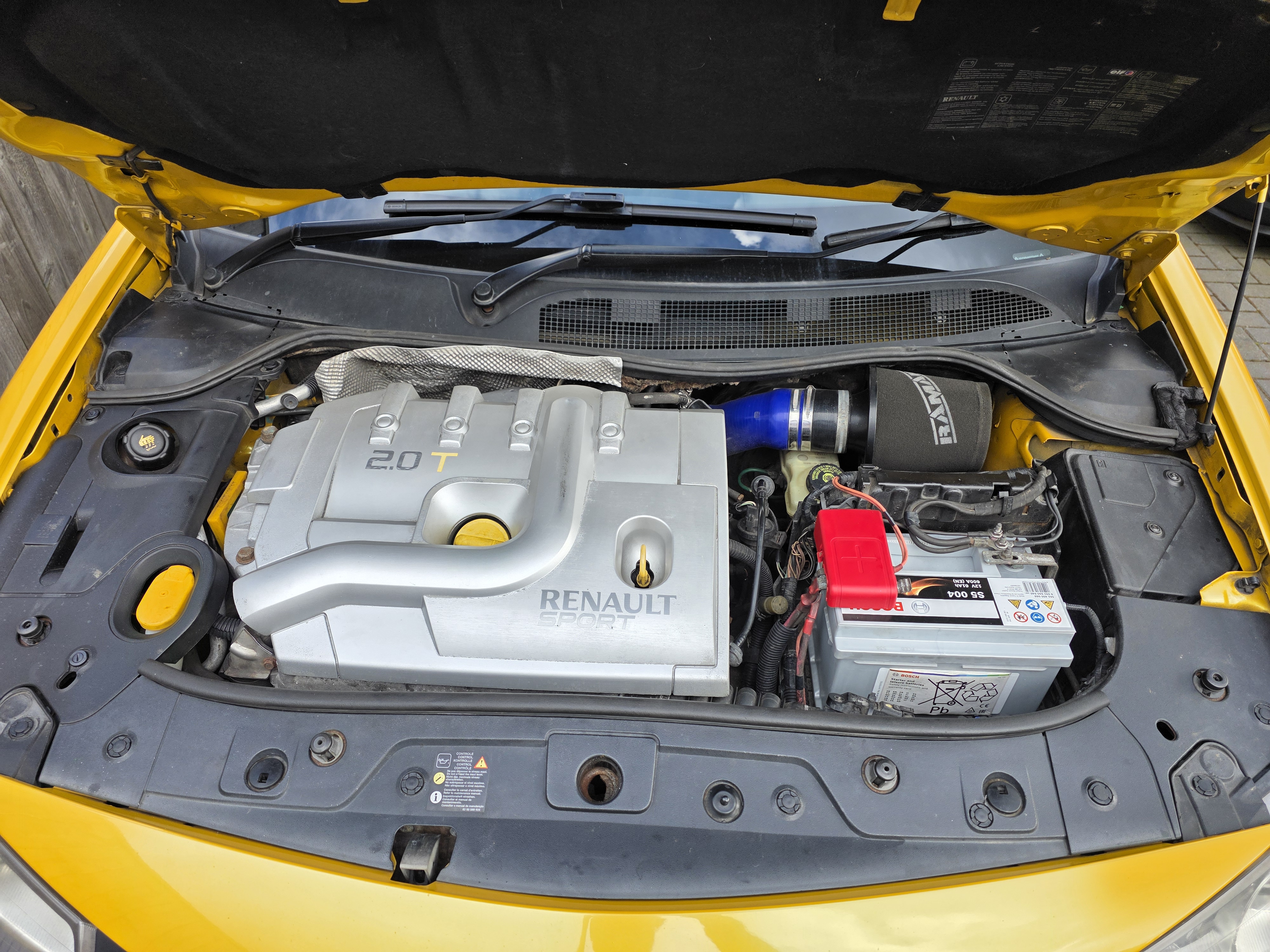

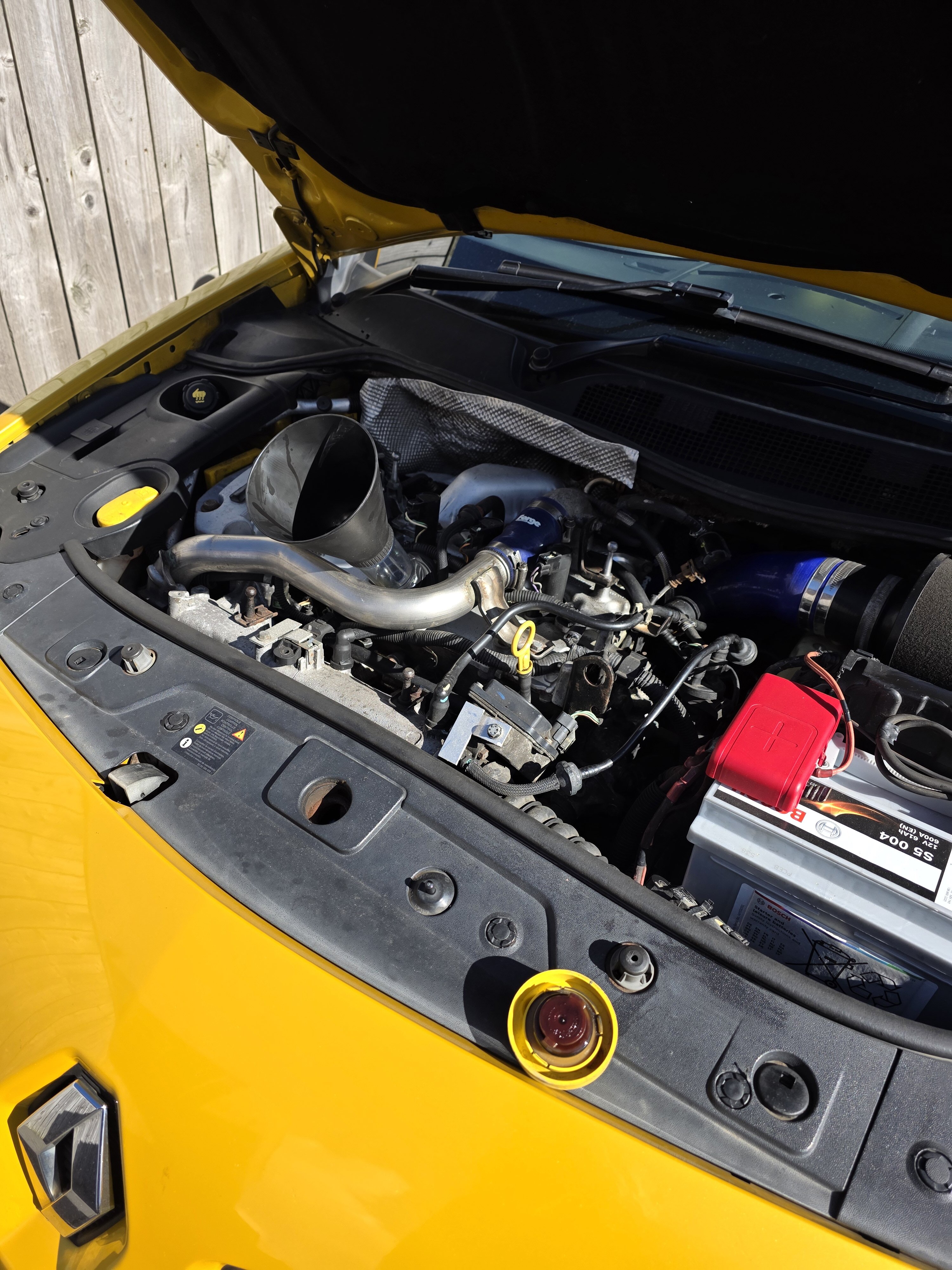

Give engine bay a quick wipe over to finish.

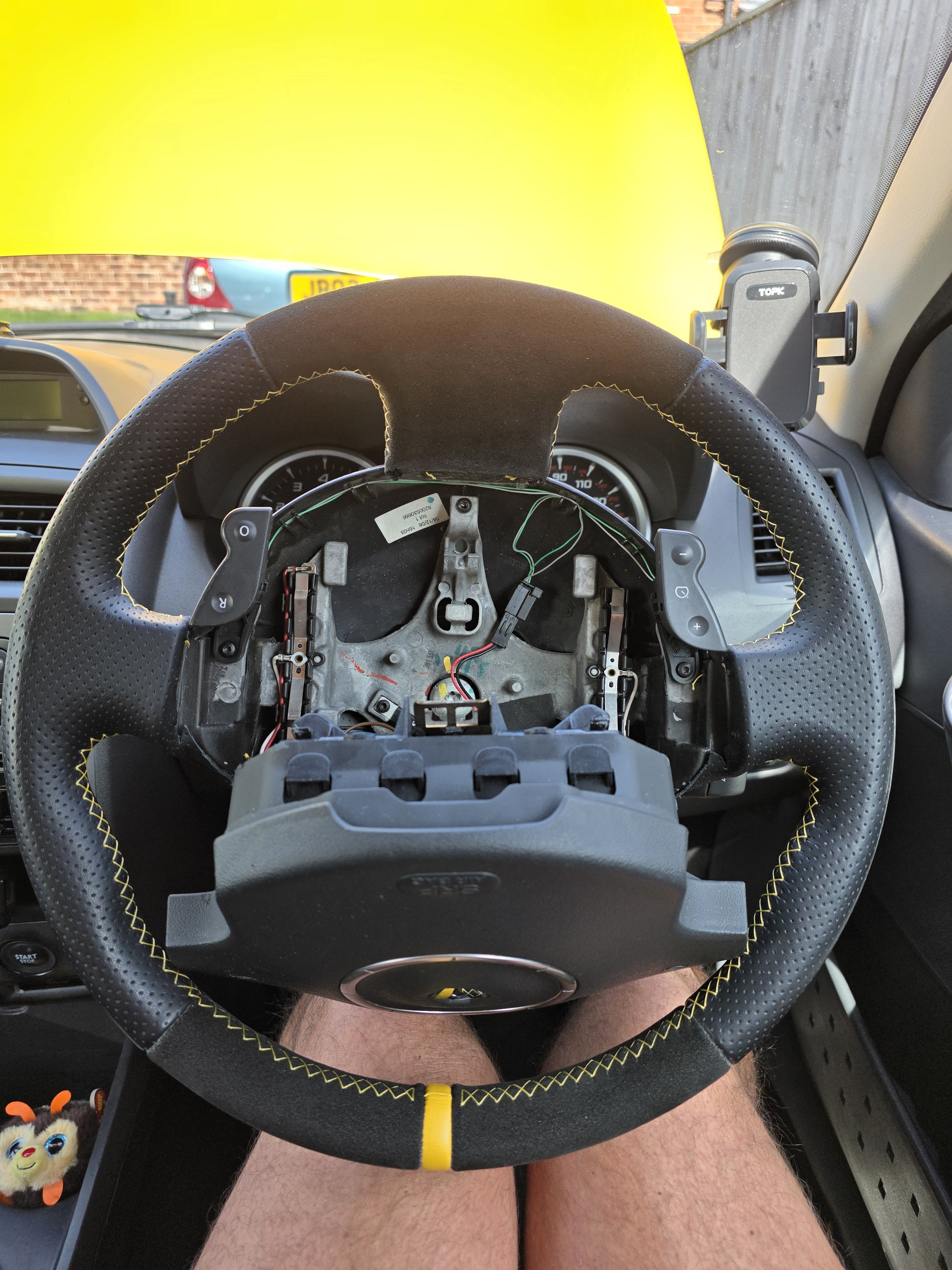

Cruise control buttons have been a bit floppy / iffy for ages with the button that decreases speed increasing it when pressed. Increasing speed also increases speed, usually end up sending it🤣. I had a good spare set of cruise buttons in the stash from a low mile megane i broke years ago and found them the other day.
Fitted in 3 mins and work as they should.

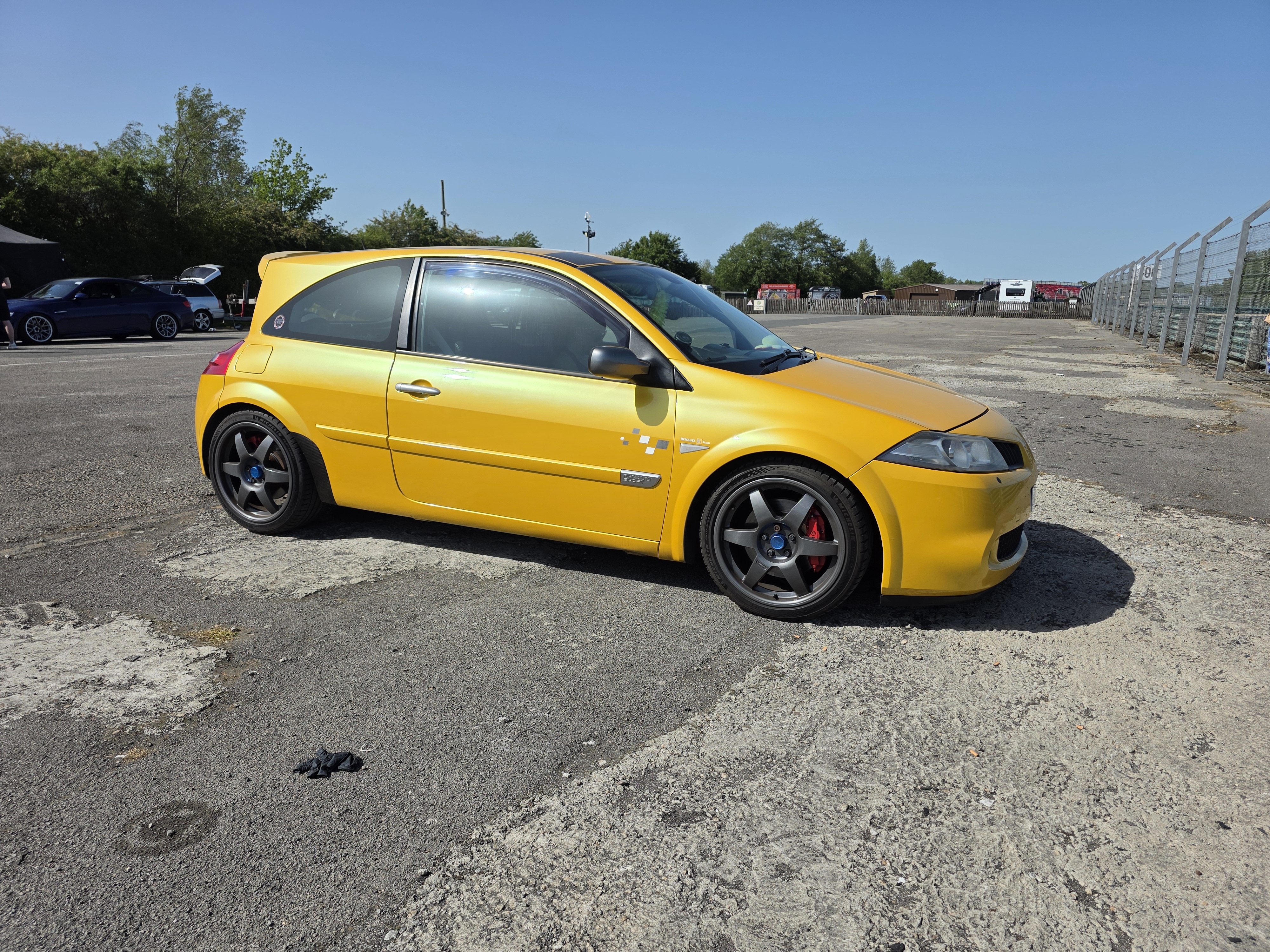

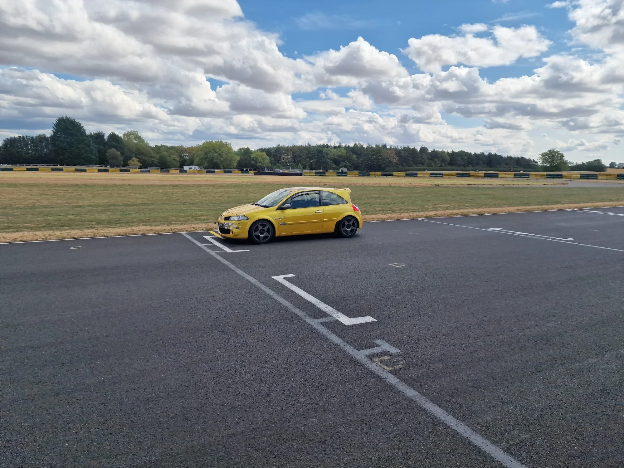

Quick run down to Croft on bank hol Monday. 32deg, ac works superb so nice and cool.

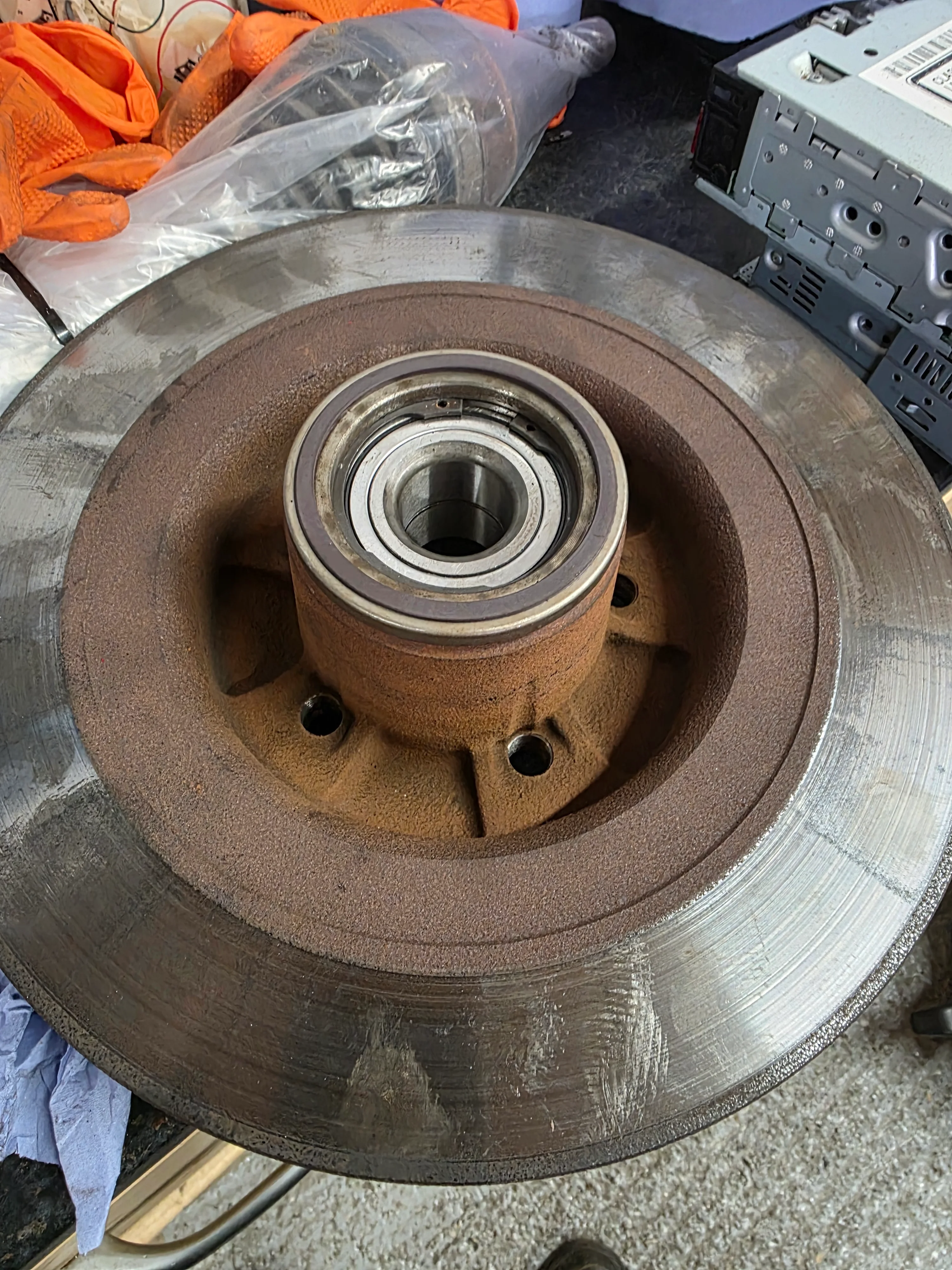

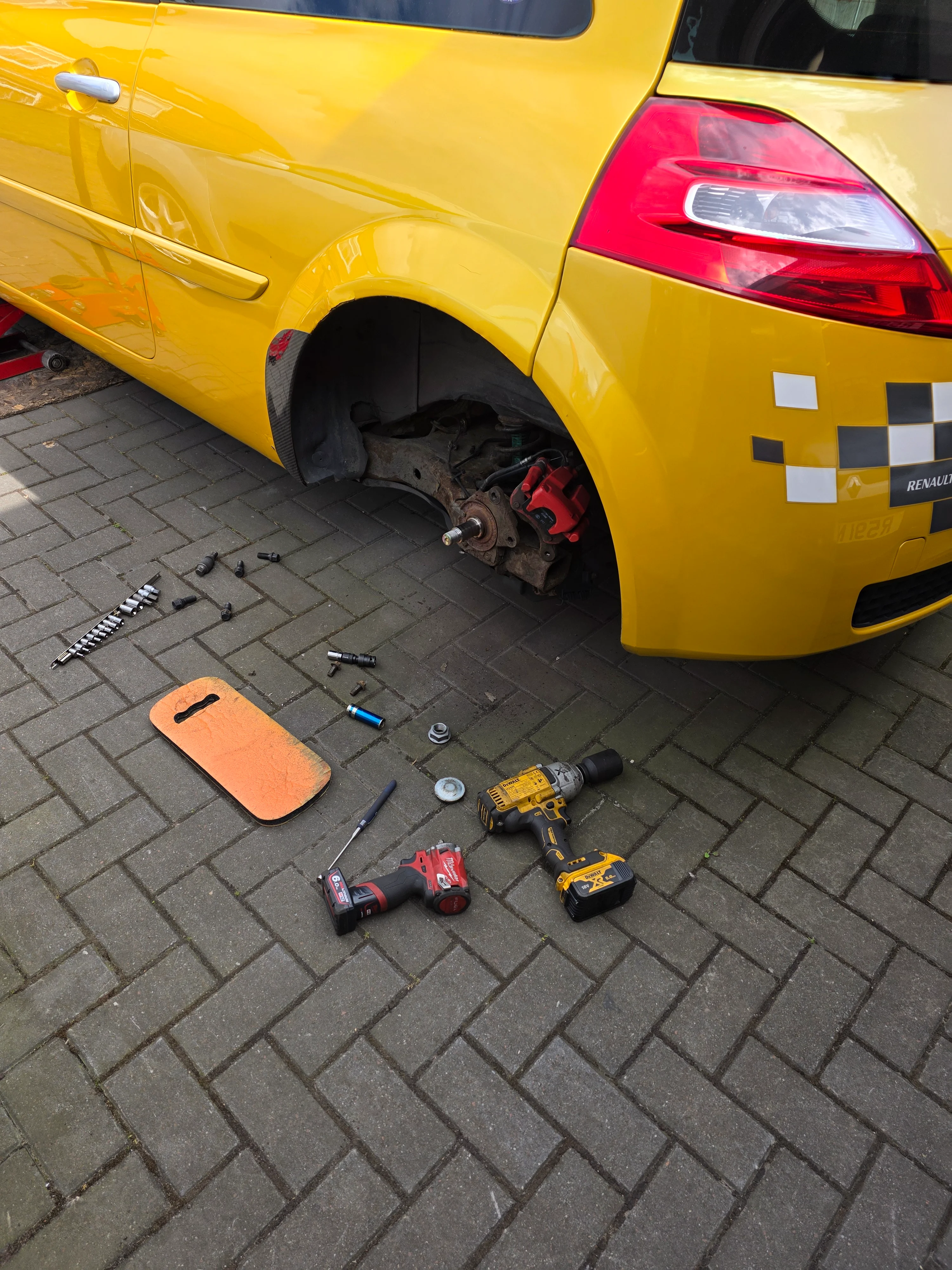

First job, rear wheel bearing on n/s. This will be the third one ive fitted as they have all developed play. Being honest, i think i was being super fussy and looking for issues as the play was that minor i dont think it would ever cause an issue..anyway parts in stock so done.
New snr bearing pressed in, new abs ring and bearing torqued up tight. Done.
I then inspected/serviced the rear brakes to check if any binding. All good, no issues. Noticed exhaust heatshield failing at one fitting so thats been repaired/refixed.

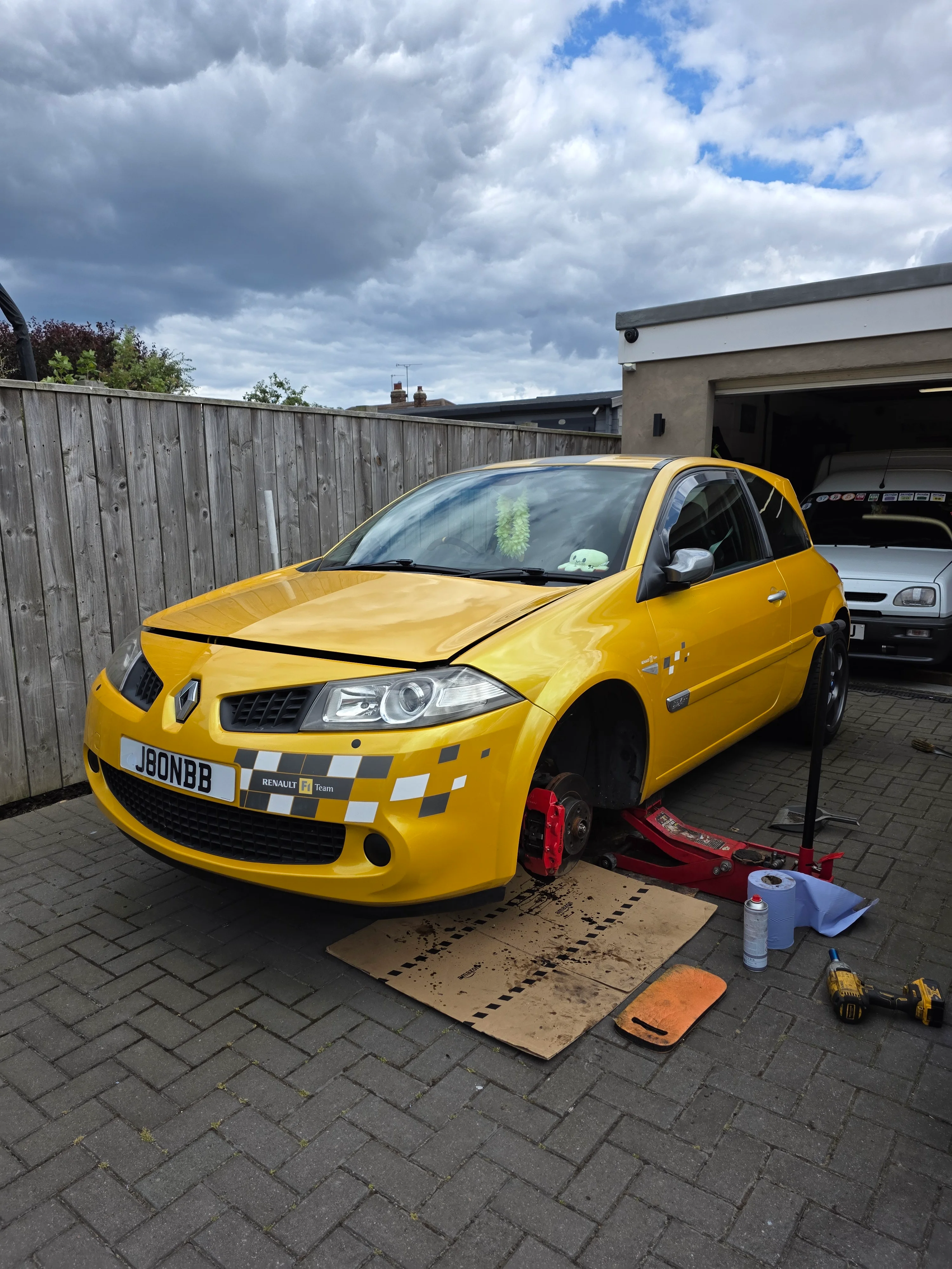

With that done, front up in the air.
All suspension components checked and no issues. Greased the lower swivel bearings and refitted the Ds1.11 front pads.

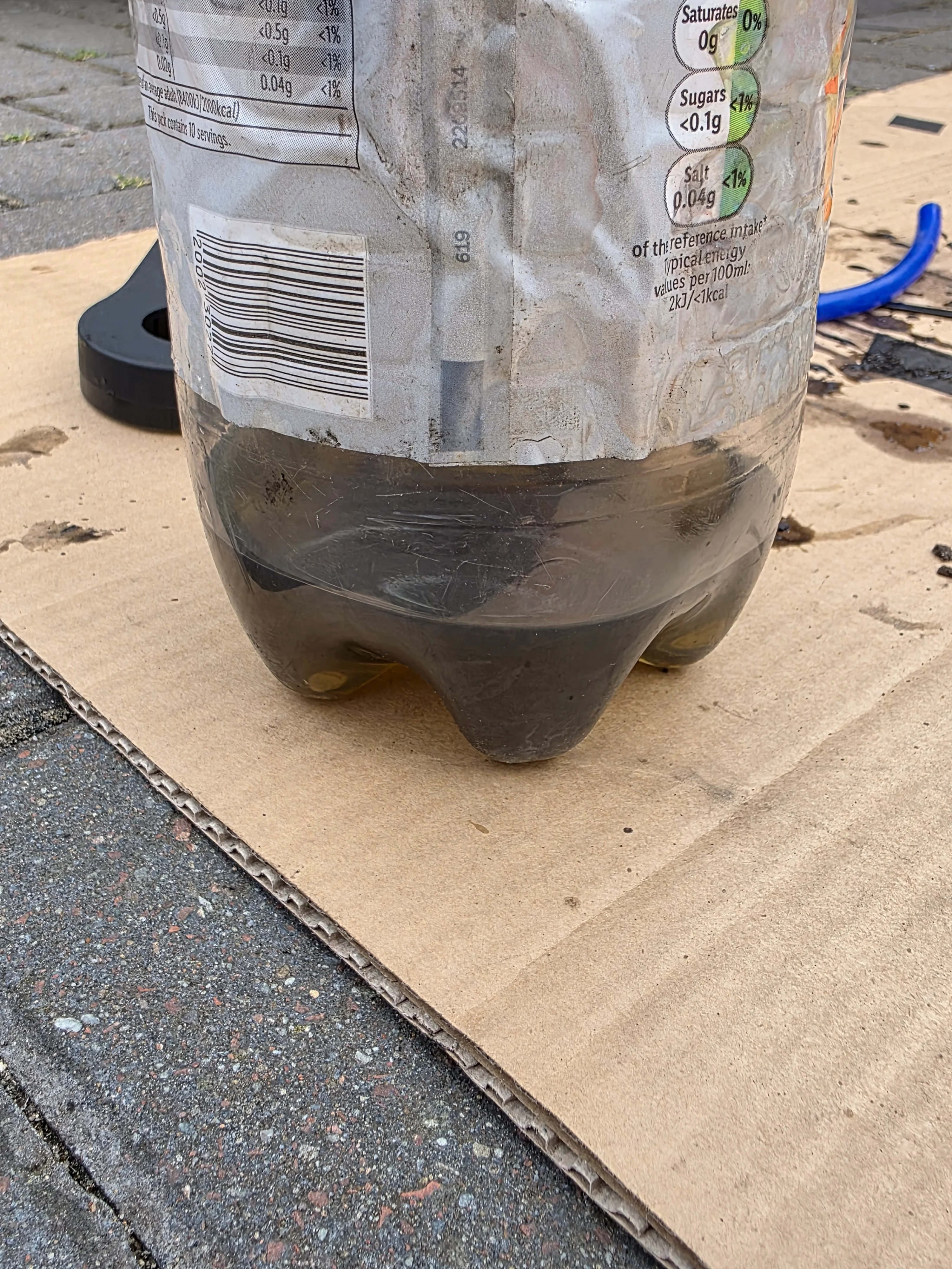

With everything looking good, on with brake fluid change. I usually run motul rbf600 in this and yearly change/3xtrack days. I generally have no issues and it works, brake pedal gets a little softer on 3rd day but no cause for concern. After discussion decided to try Castrol Srf for potentially longer service intervals as it has a higher wet boiling point and known for longivity..only downside is price but if it lasts longer thats fine.

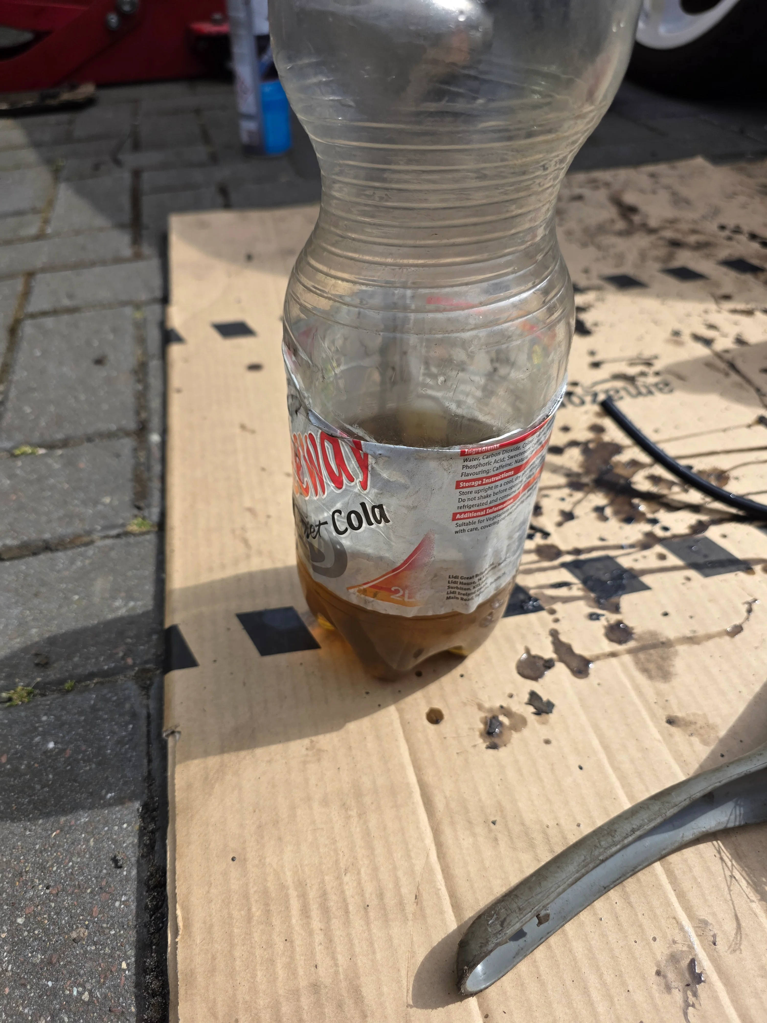

Syringed the res and pre filled/pressure bled. The brake fluid was pretty manky.
Clutch fluid however, totally fcuked as usual😄
You would think thats been in years not 1x year/maybe 3-4 thousand miles. Noticeable improvements in clutch pedal feel, same as every time ive bled it. Brakes all good, pedal rock solid after re bedding the front pads in.

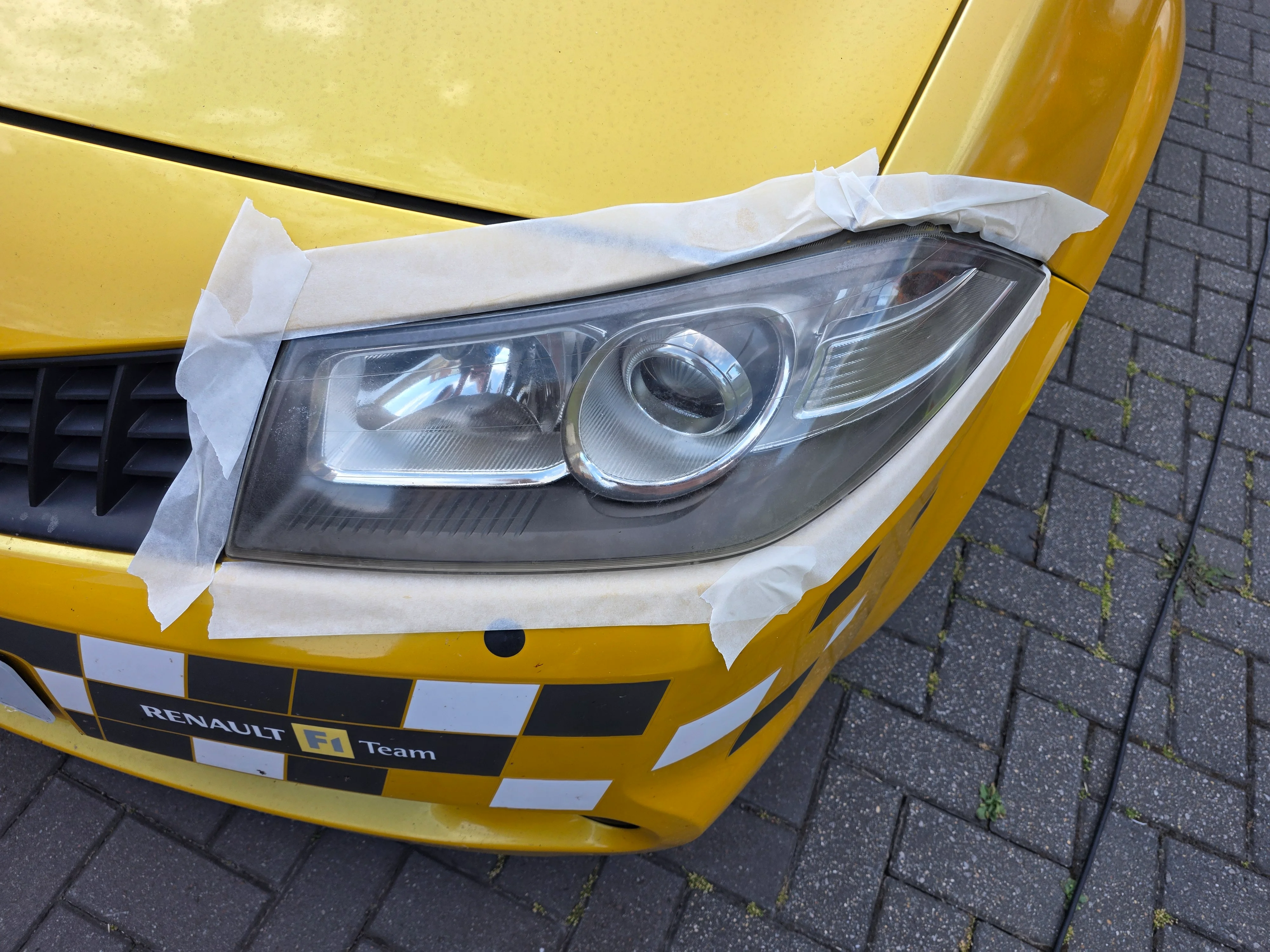

Headlamps polished and coated with ceracote headlamp ceramic wipes.

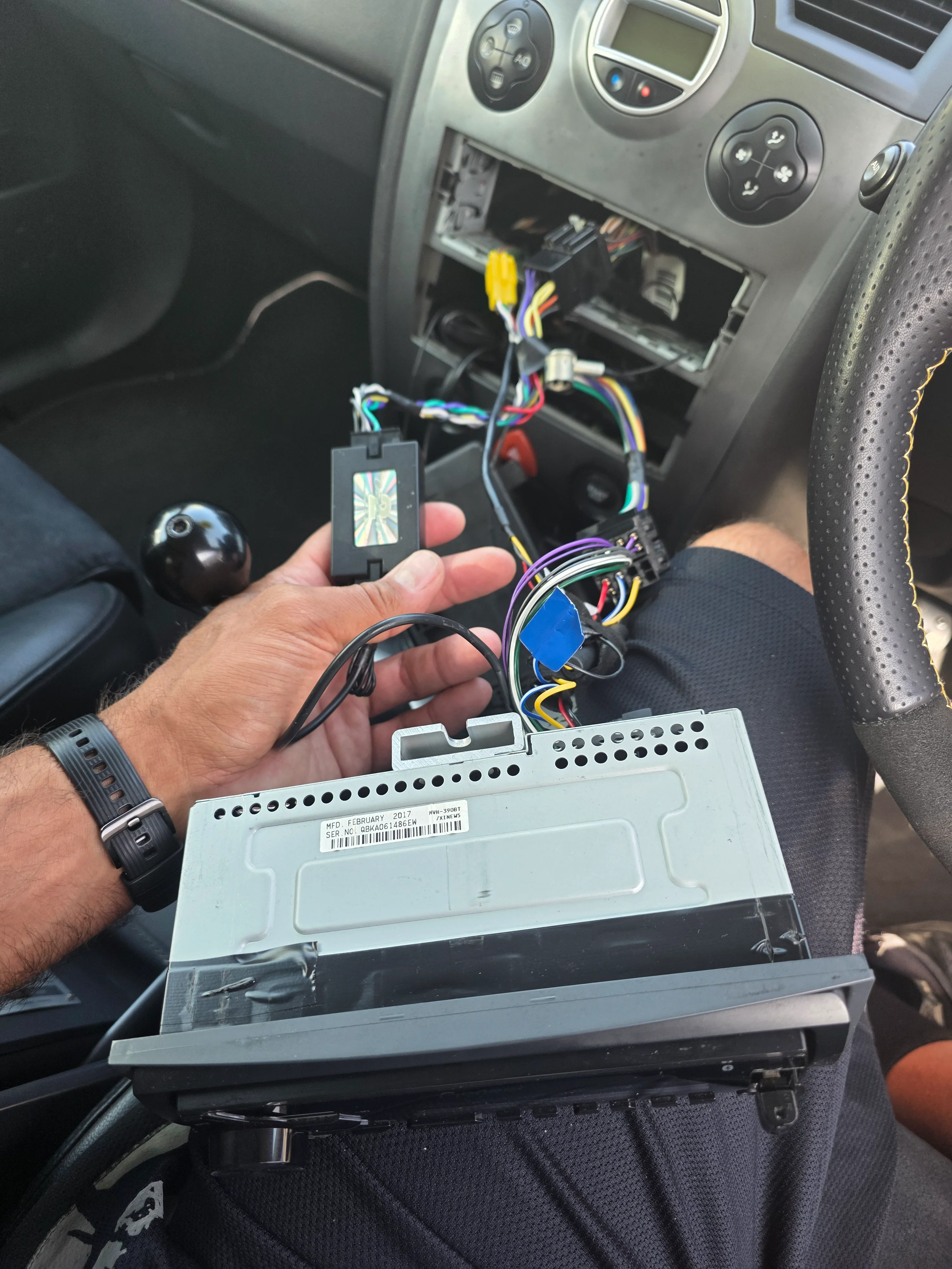

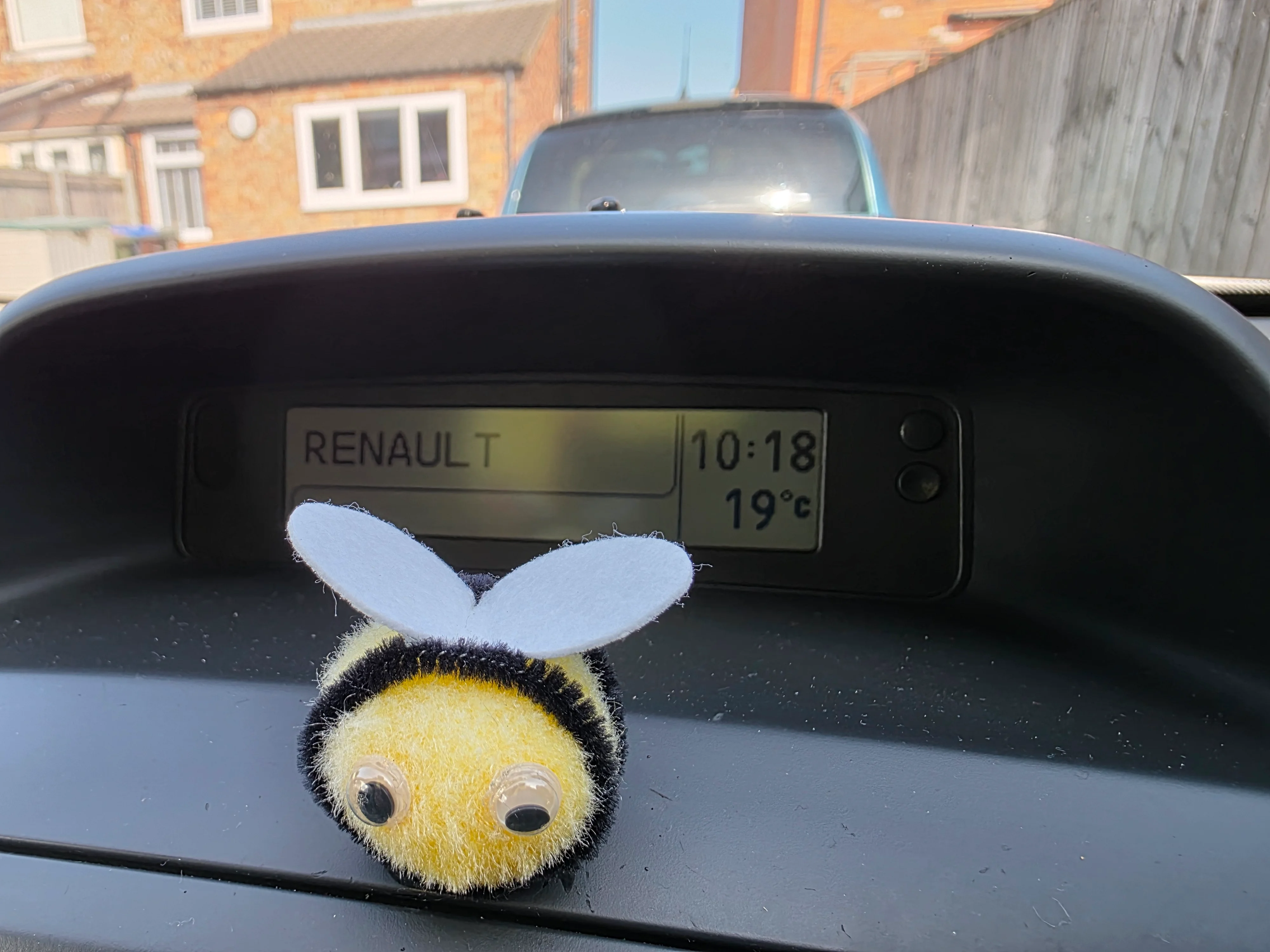

Following on with the connects2 saga on the kangoo, i tried the canbus version in the r26 and it worked in a fashion albeit wrong patch lead so the controls responded but not correctly. I spotted a badly listed 2nd hand connects2 for £7 delivered on ebay which matched up part numbers to previous one, so took a punt.
FItted
Works fine and had the correct pioneer patch lead. The display only says Renault as the stereo does not output can data sadly. Anyway steering wheel controls work good.

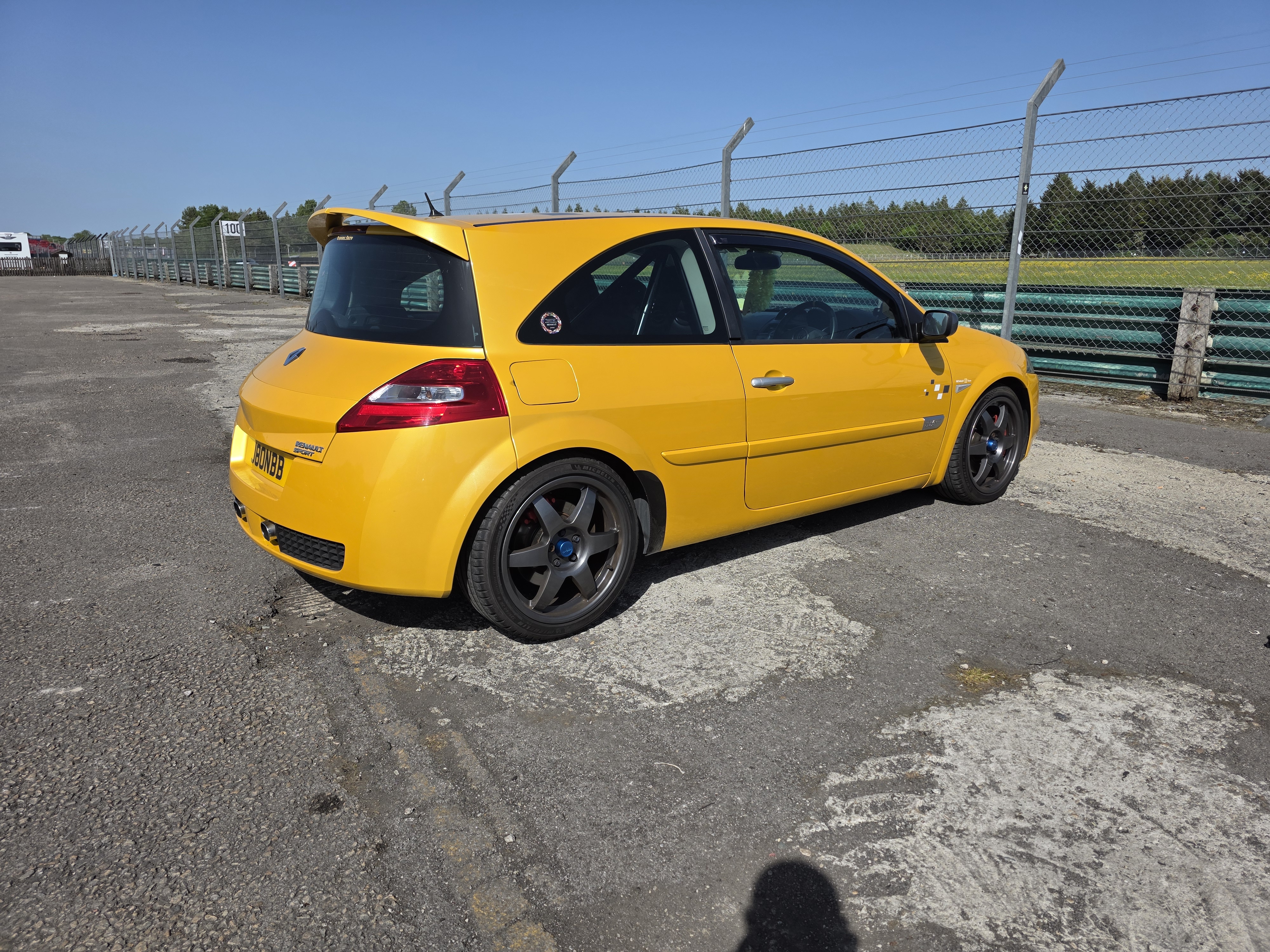

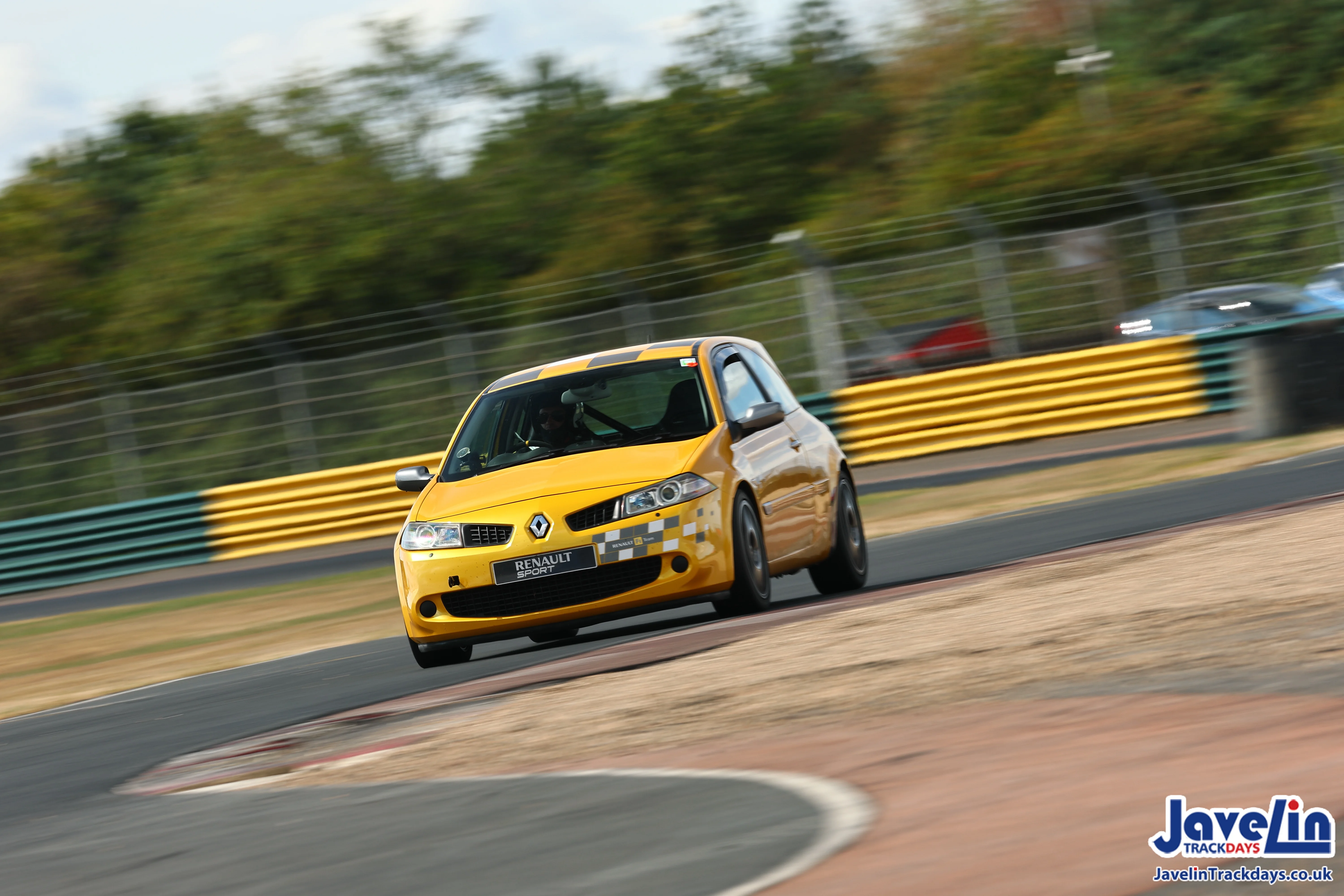

Croft trackday last Friday, had a great day. A few of us had booked on so was a great turnout.
Weather was far too hot being in the low 30's and all turbo cars were suffering with heat, so was shorter duration sessions compared to 10+ laps at a time. The r26 was creeping up to 107deg and beyond when behind cars due to lack of cool air, so i tried to avoid following people for too long.

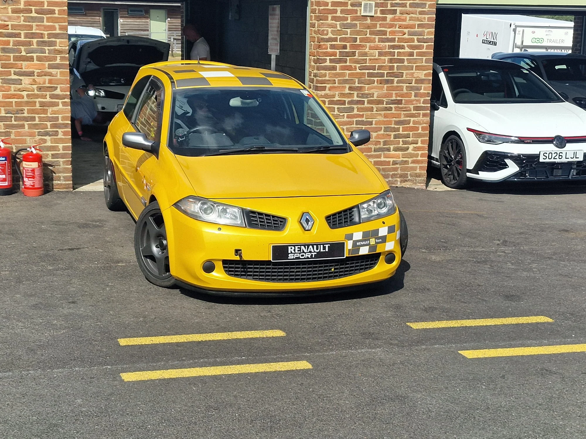

R26 and backup vehicle.
Crew.
Most important tool in the garage
R26 performed ok in the heat. Had fun following @YorkshireKyle and @Rskennedy for a few laps.
I also took the white r26 in the pic above out for a few laps. Its the one i fitted ecumaster to / 467hp on g series turbo. Its mega, can make ridiculous pace in it..traction out of low speed corners is unreal with boost by gear. Unfortunately really suffering with the heat so limited to 2 fast laps and cool off. It was keeping pace easy with any of the bm's etc.
On last session the clutch in my r26 started slipping its bollox off briefly, not sure if overheated/whatever, clutch pedal was still working ok but pedal feel has felt a little bit off for a while. Im still unsure whether the clutch did not disengage fully being honest, It has seemed to right itself now cooled down but once its slipped, it will do it again so its time to renew.
Assume stock clutch and dmf as ive not changed it, and its done several trackdays in my ownership. Ill pull it out for a smf kit / r26r clutch in the next few weeks.

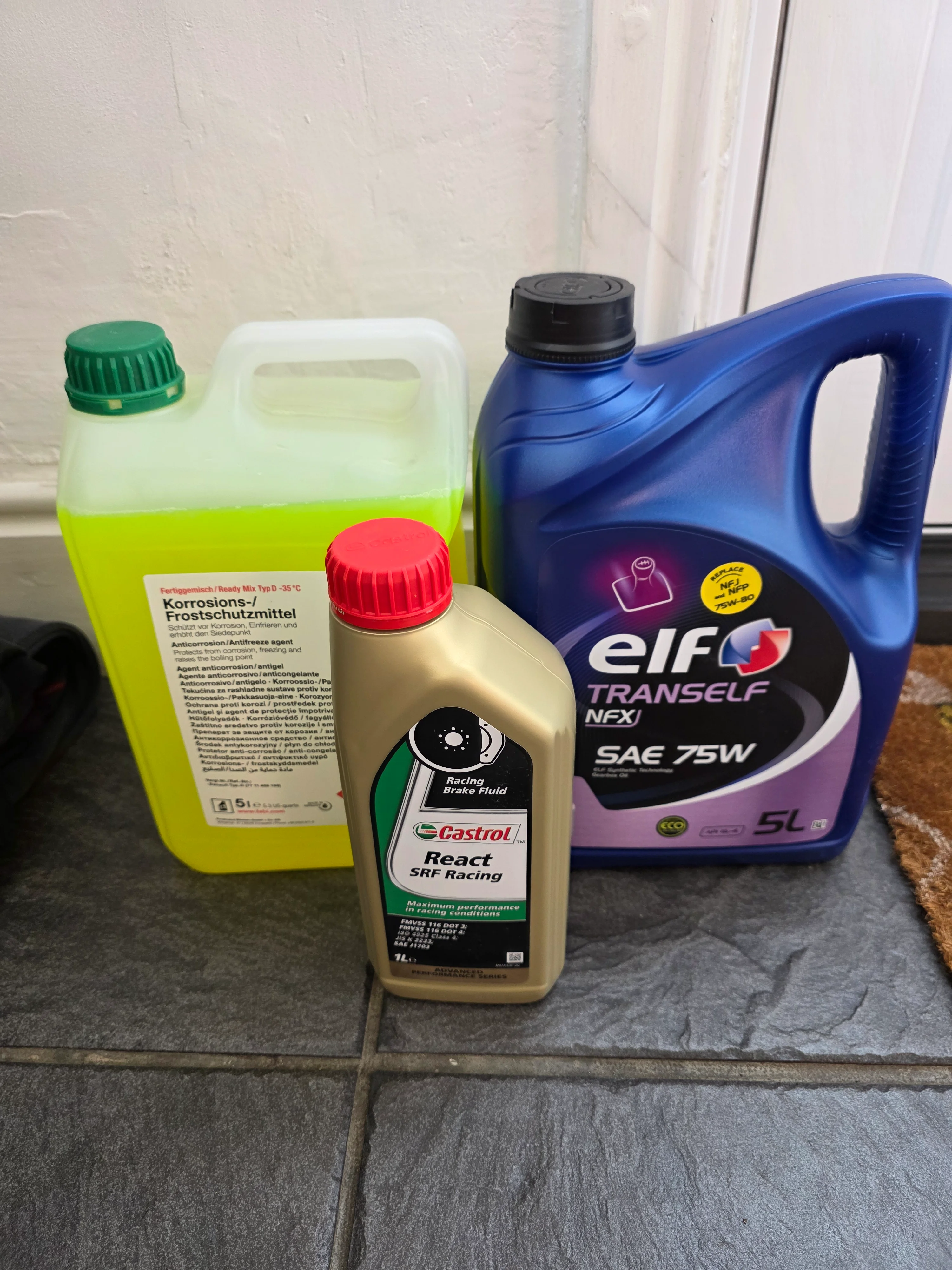

5ltrs ready mixed febi type d (actually for blue clio save postage etc), 5ltrs elf nfx gear oil and a ltr of castrol srf brake fluid. £150, prices are getting ridiculous compared to years ago, like liquid gold🤮

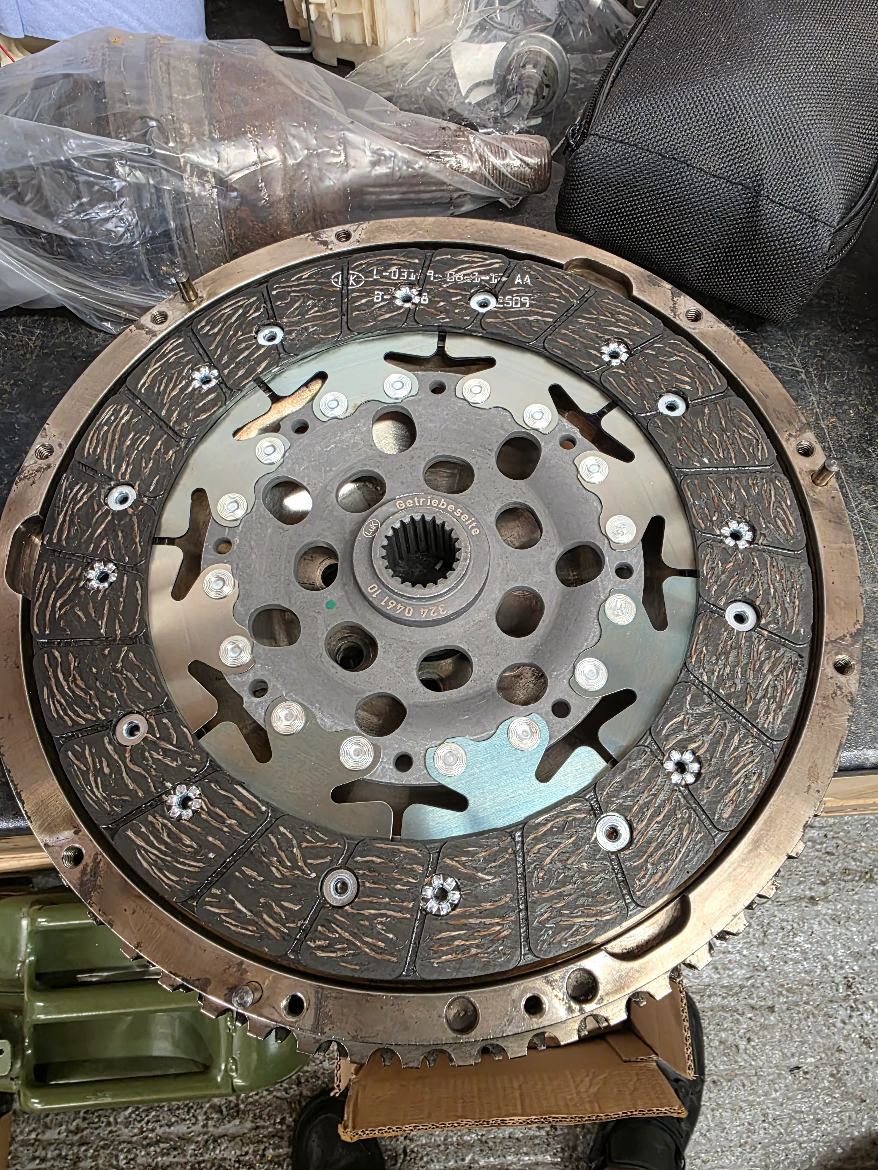

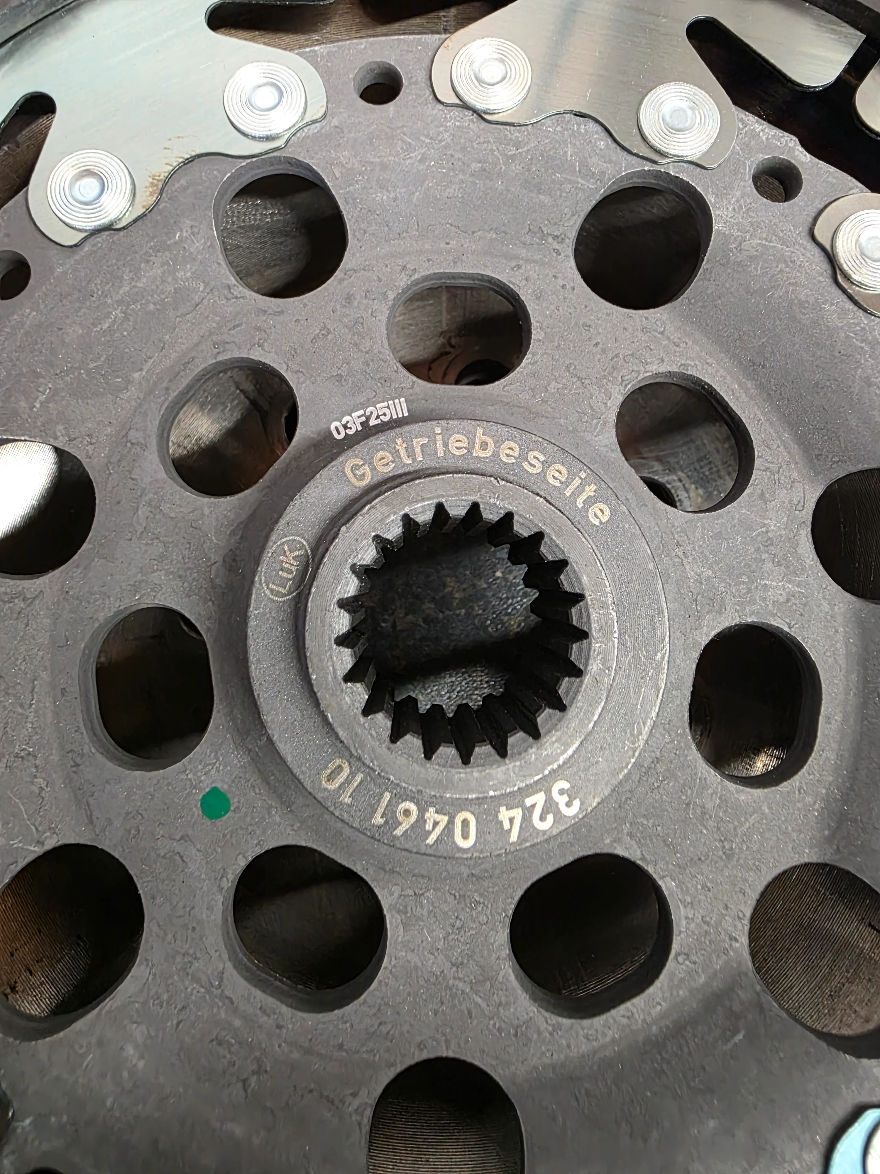

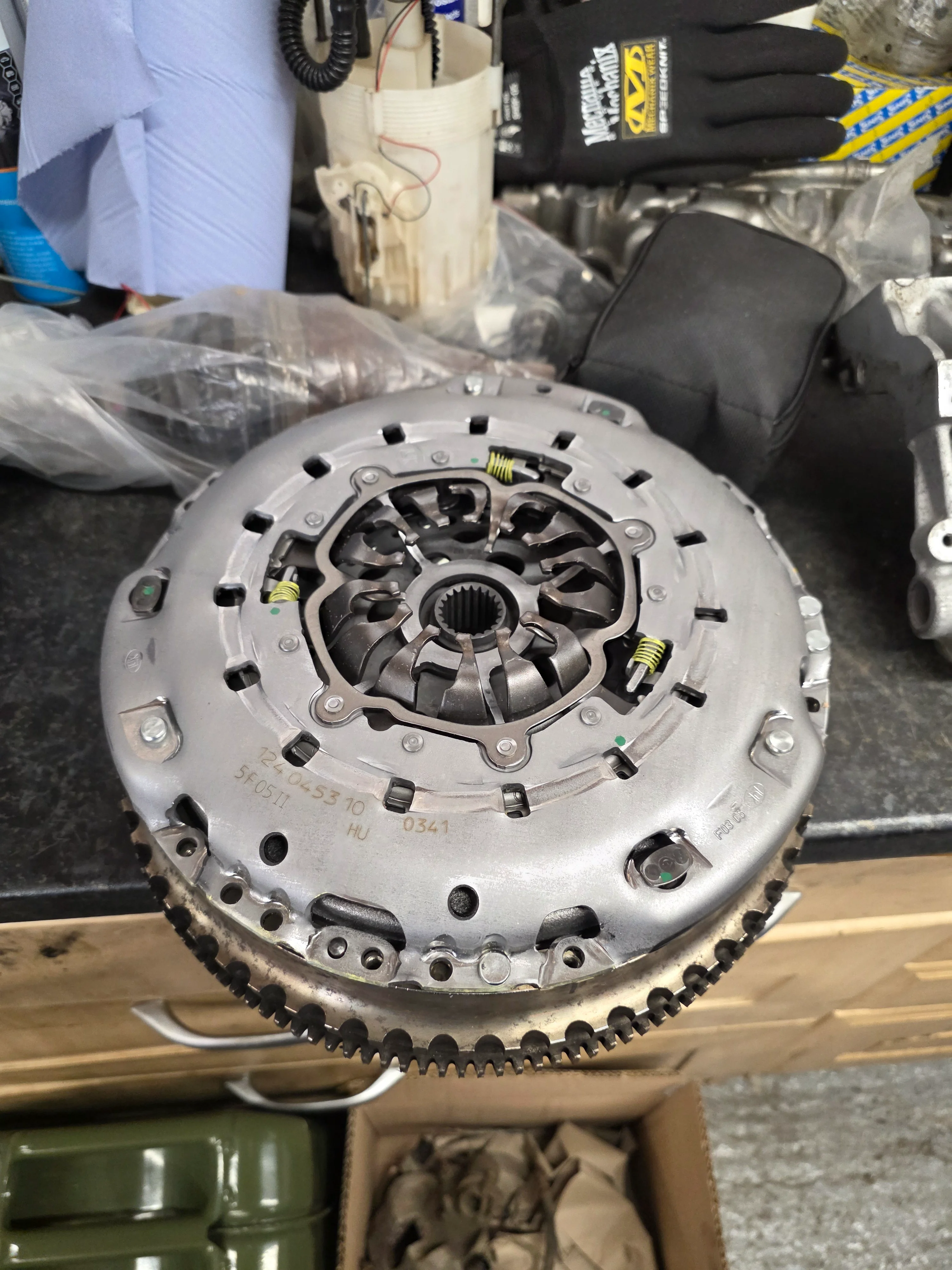

LuK R26r clutch (scenic diesel clutch) arrived, this has higher clamping force than the oem megane r26 230 clutch.

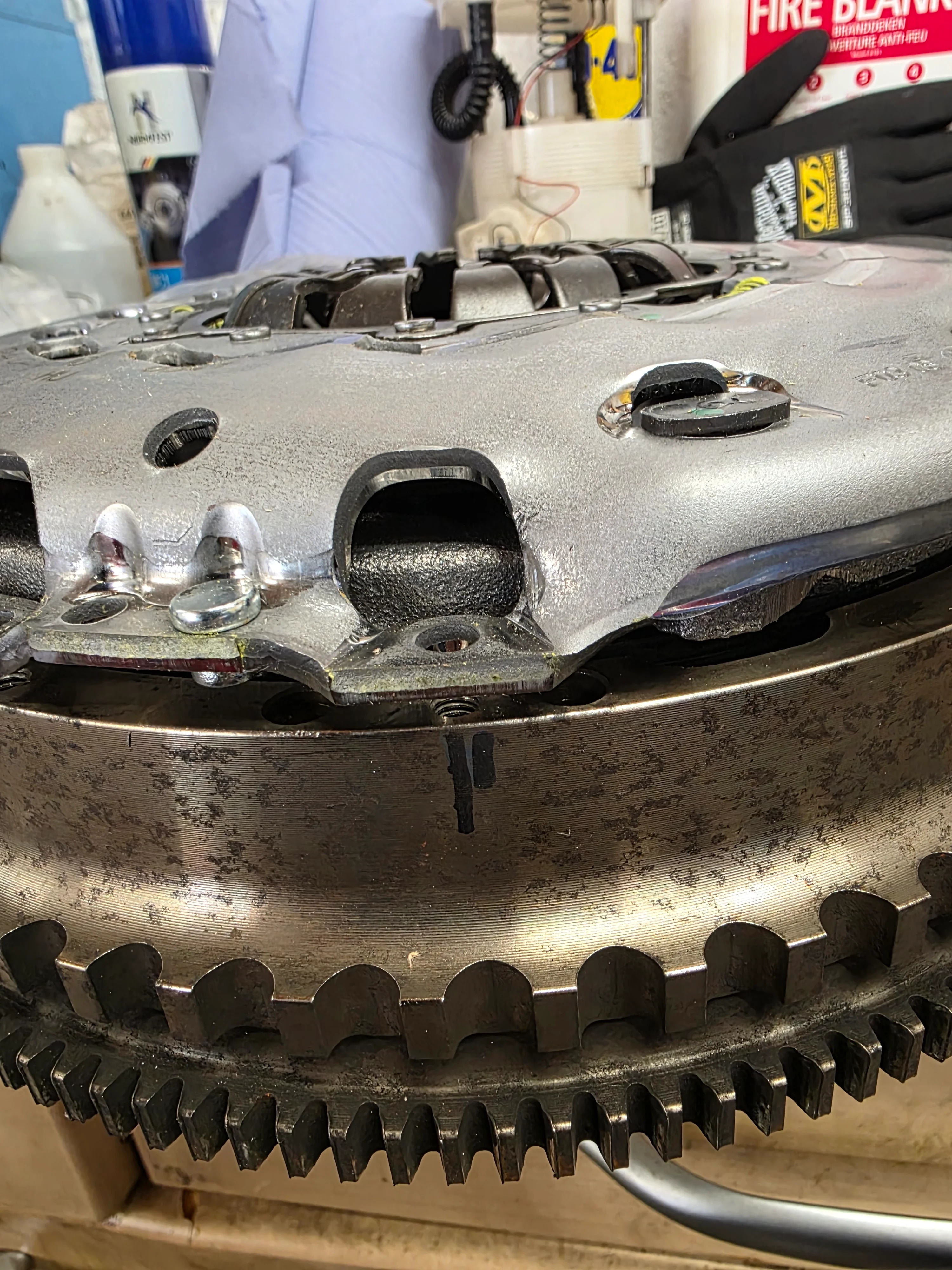

Test fitted clutch to ttv smf to make sure correct. Theres 2 variations of flywheel, this seems correct for R clutch as 8mm recess in flywheel and the plate fits flush
If you know, you know
That should work
