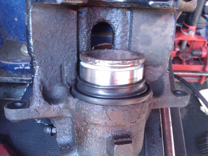

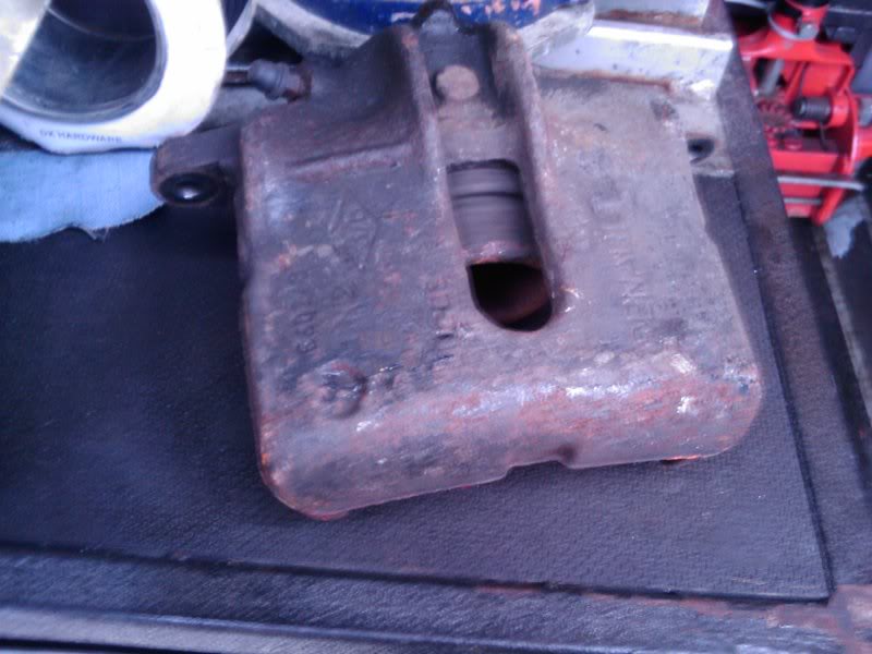

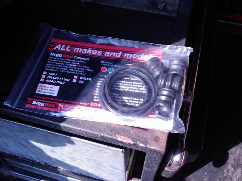

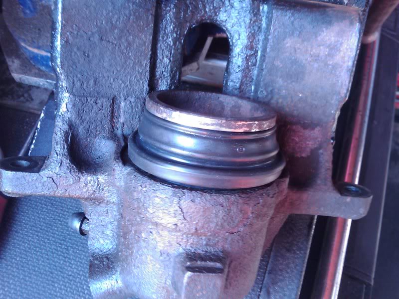

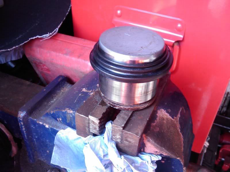

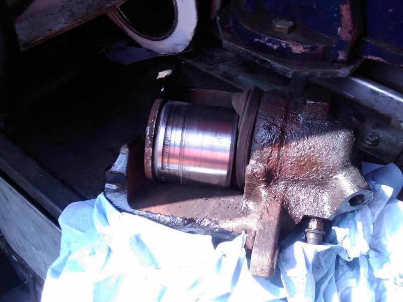

I rebuilt my front calipers over a few lunch breaks.
Got a seal kit for them.

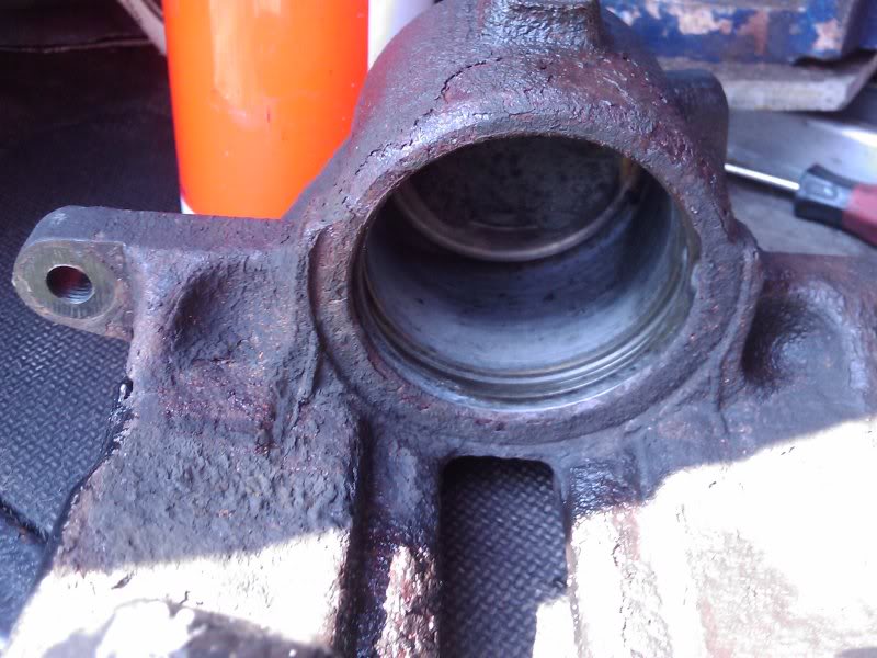

Piston out, all in very good condition,
Fitted the new seal to the caliper housing then fitted the new dust seal to the piston
All done!
Didnt really need a rebuild tbh but its done now and I know they are good.

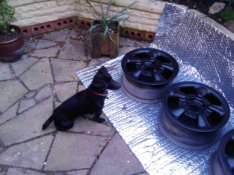

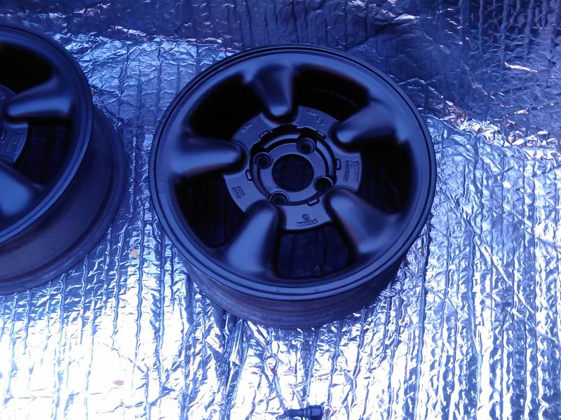

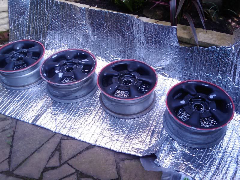

Ive slowy been refurbing some wheels to run as my road wheels, the team dynamics ones will be on track duty.
These wheels have quite a bit of history. I bought them off Pheonix and intended to use then on my phase 2. I lent them to Justin, then to schweppy (who had a blow out) then I sold them to a mate and then bought them back again.

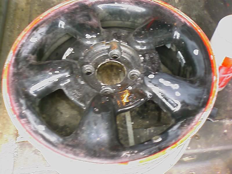

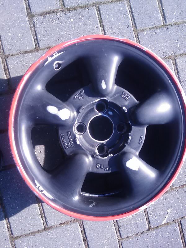

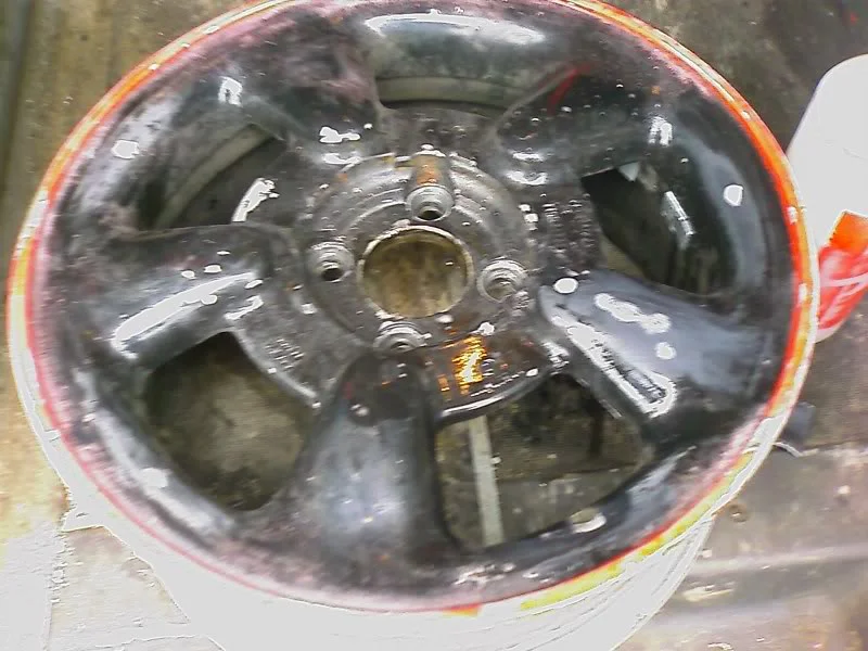

Some where in a sorry state so I rubbed down the affected areas. Some were worse than others.
When they were all ready I set up a temporary spay booth in the garden
The primer reacted badly with something on the surface of the wheels. I should of degreased them before spraying.
They didnt look too bad after the satin black had gone on. My mrs said they had a leather effect to them, Lol. They look ok from a distance.
As you can see my dog isnt overly impressed with the quality of my spraying.

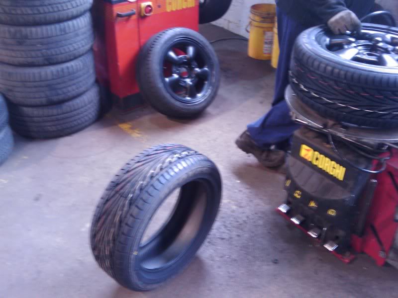

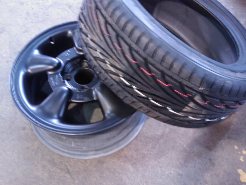

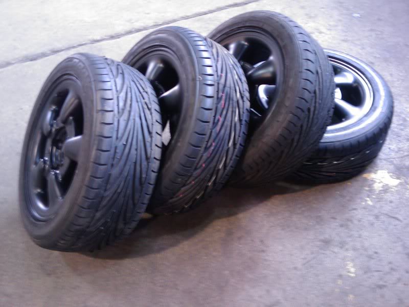

The next day I went down my mates to fit some tyres on them. I already had a pair of lghly scrubbed Toyo T1R's so bought another pair to match.

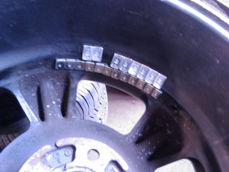

This wheel took some ballancing, think that will be a rear one, Lol.
One set all done, got nothing to bolt them too yet but they are ready for when the day comes.

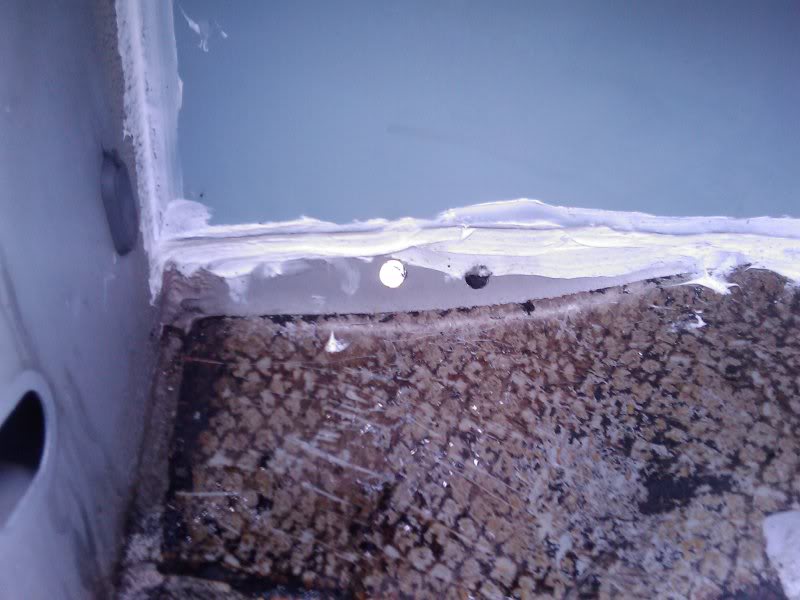

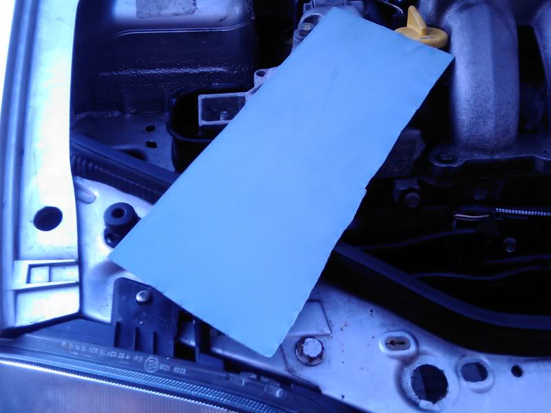

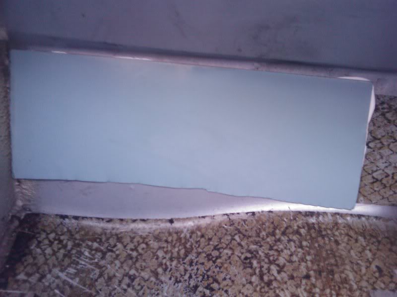

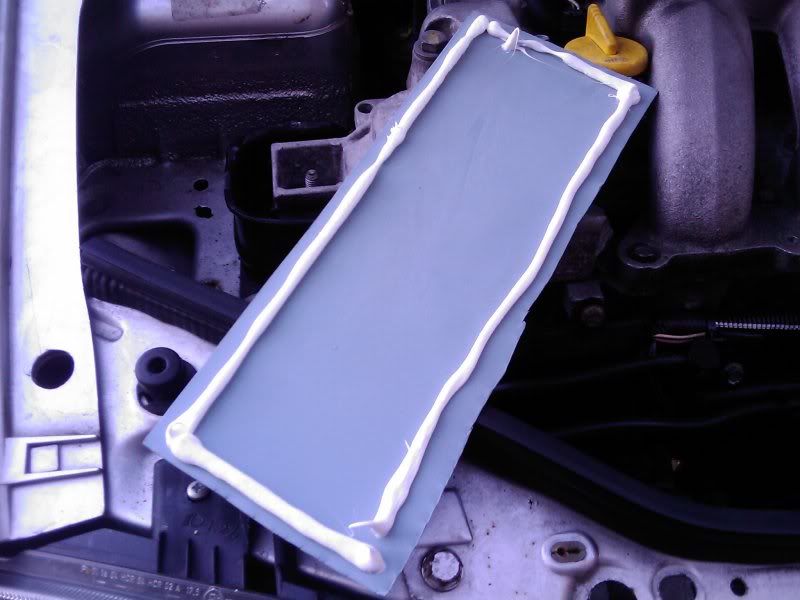

Finally plugged the 'glory hole' left in the bulkhead by the a/c box removal.
Hunted through the attic and found some white bathroom sealer.
Just the job.
sealed all around it now

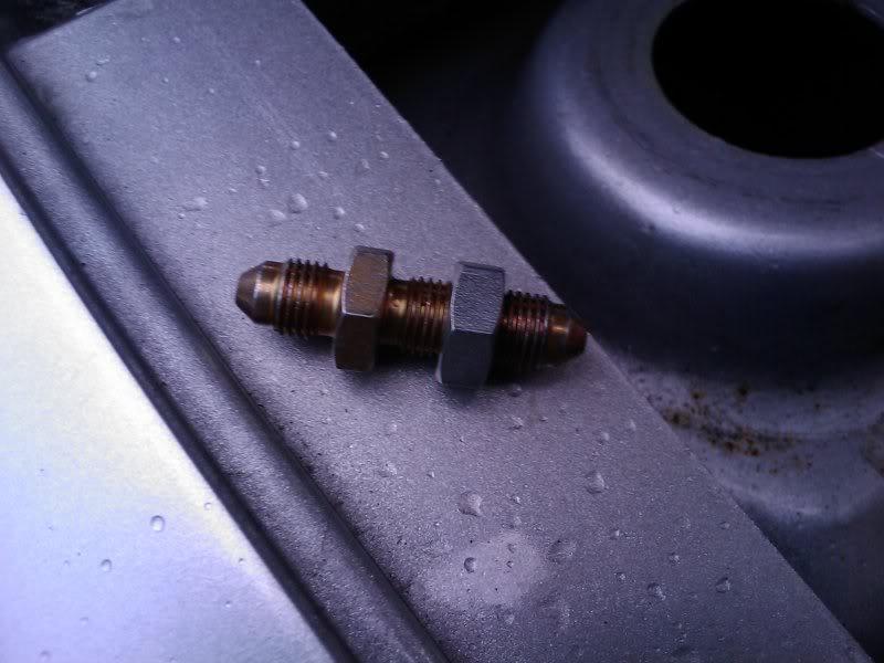

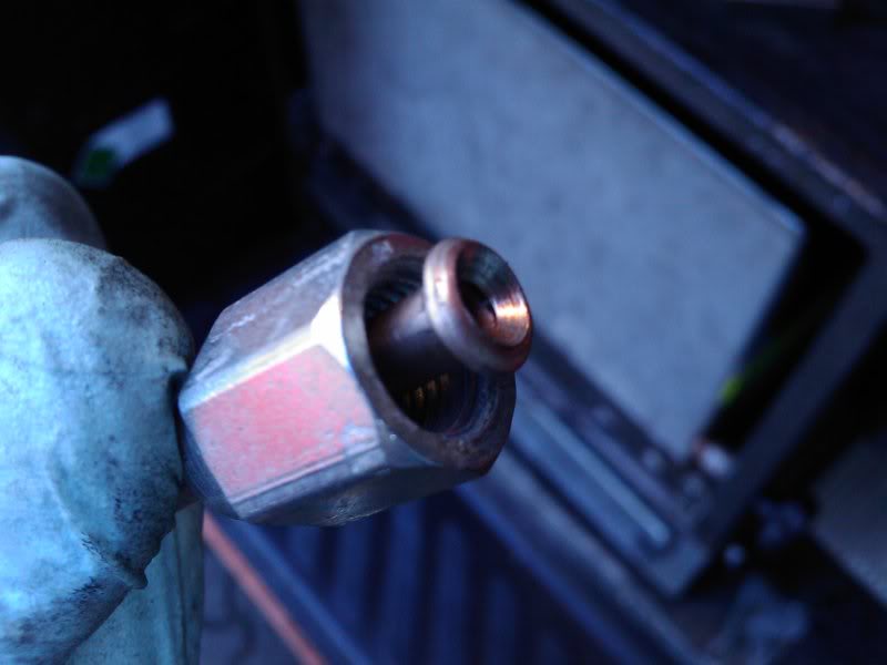

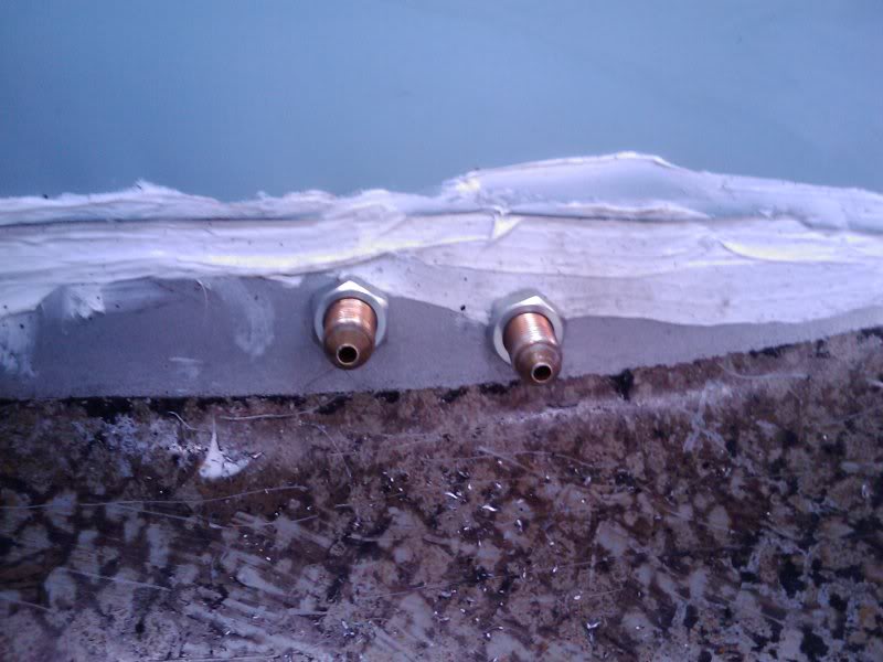

First I had to fit some unions to allow the brake lines to pass through the bulkhead (to go to the bias valve)
Drilled two holes for them.
and fitted. One for in and one for out.

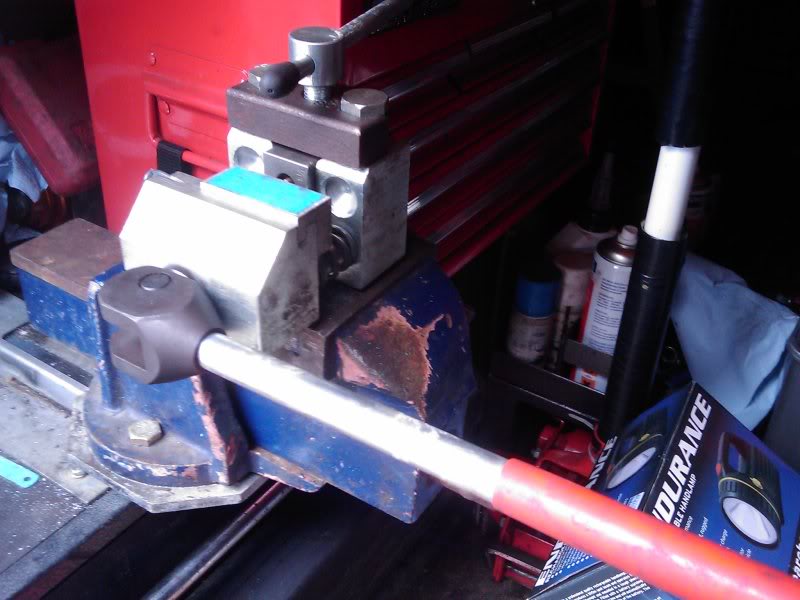

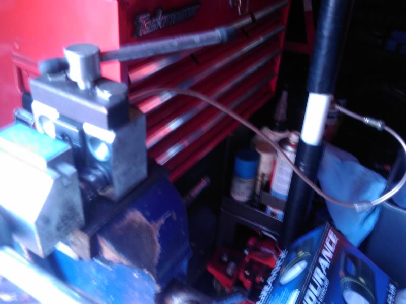

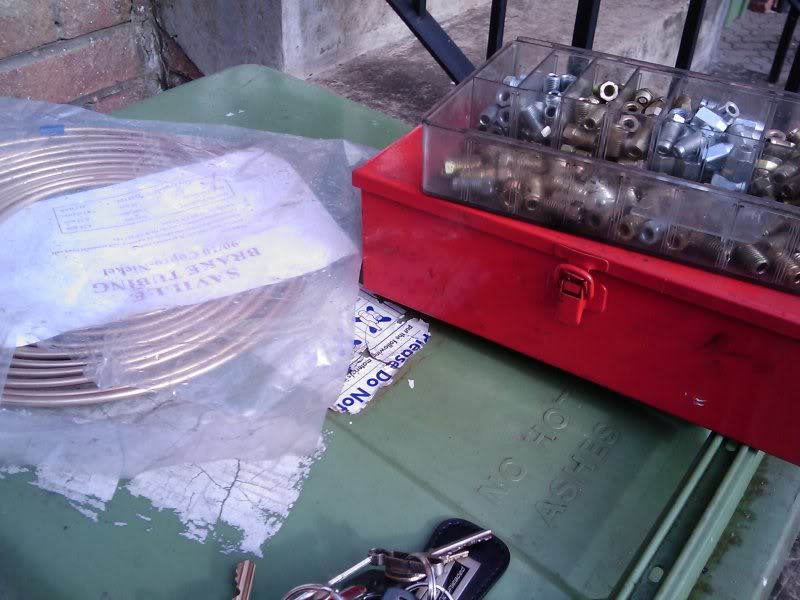

I borrowed all the brake pipe making kit from my mate.

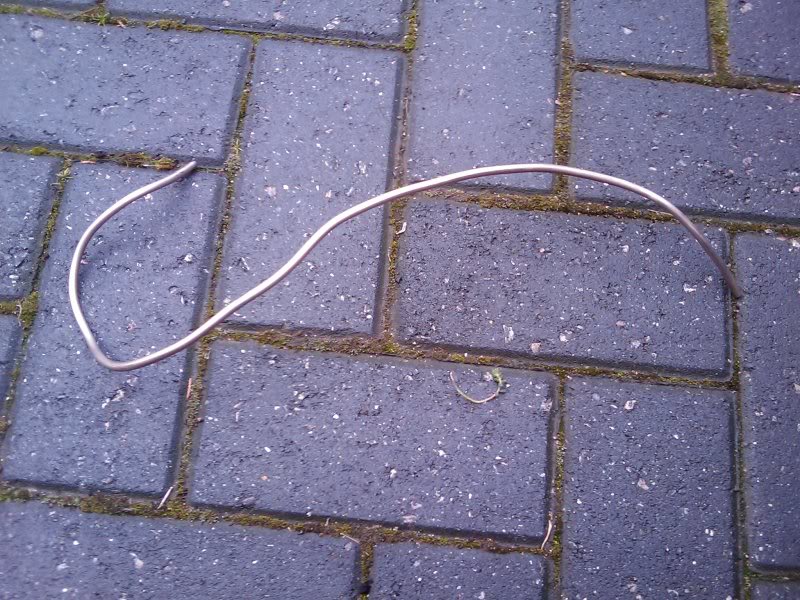

I havent made a brake pipe in almost 7 years so I set it all up in the back of my van and had a little practice
very very pleased with my third effort :eek:

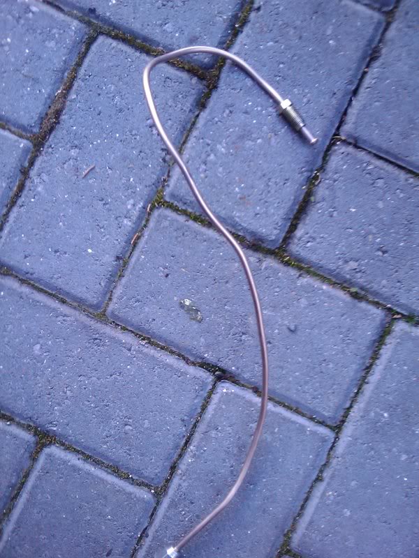

First pipe cut to length and roughly bent to shape.
And into the 'flare factory'
tada!
Only another 8 to go! :dead:

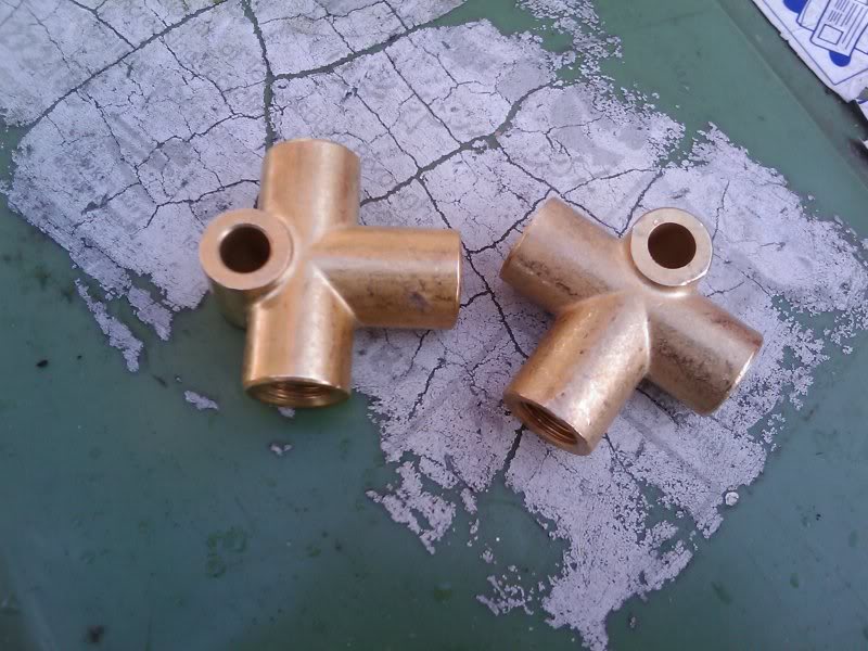

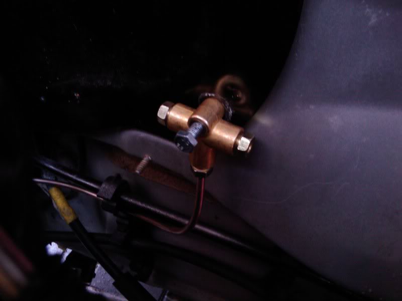

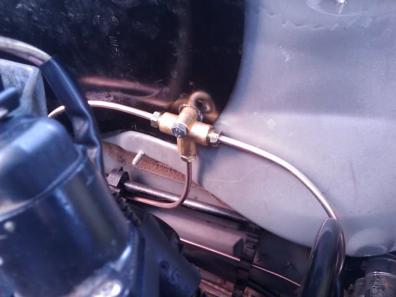

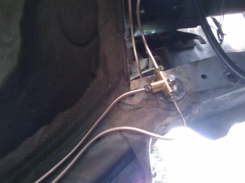

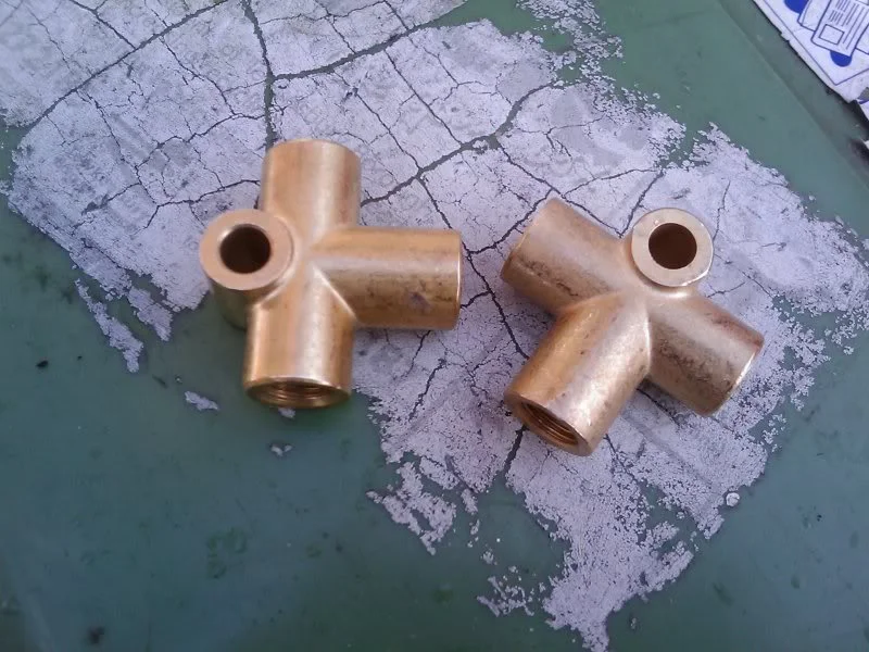

Got some splitter blocks off ebay
Fitted one, to spilt the front circuit, to one of the bolts on the bulkhead panel and the rear one fitted nicely into one of the old captive nuts for the abs pump.
I carried on making pipes and after about 4 hours work over 2 days they were done.
Front split.........
Rear split....
All very neat, quite pleased with it all, just need to get a few P clips to secure them in a few places, just to be safe.

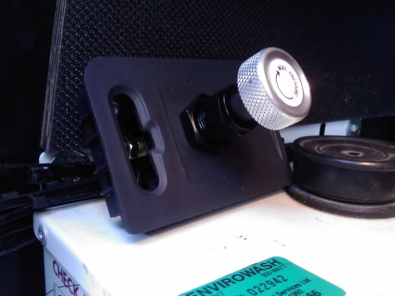

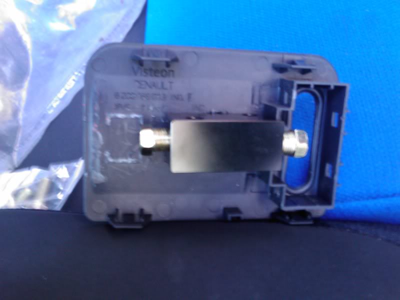

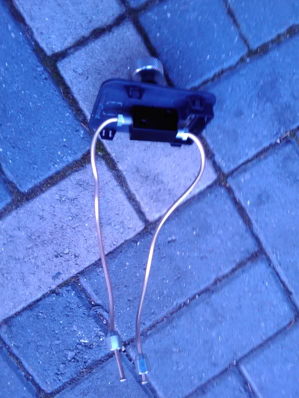

So then all that was left was the bias valve side of the system.

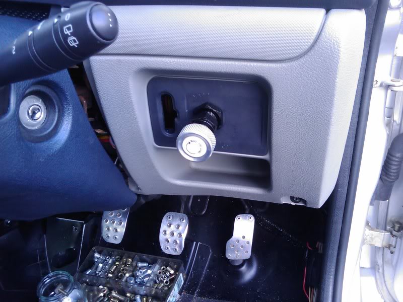

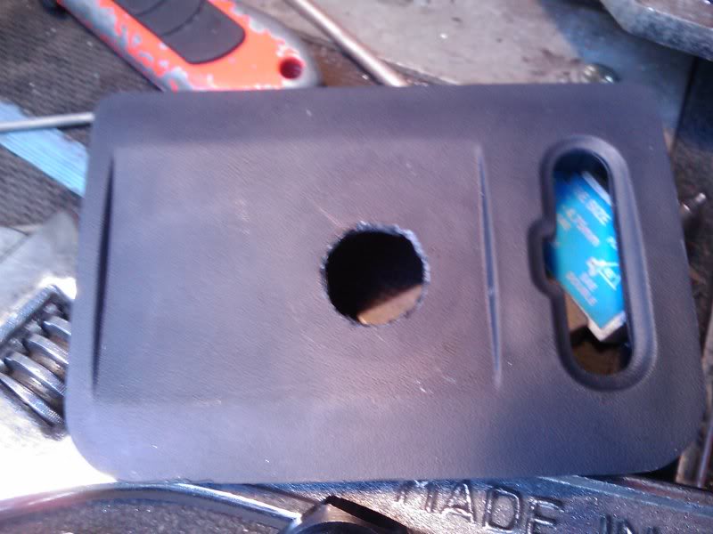

I drilled a hole in the headlamp adjuster panel.
and fitted the valve to the panel.
Plenty of room for the pipes.
Trial fitted to the dash. Mmmmm.........
Made up some more pipes :rolleyes: and the brake circuits are done, Thank f**k!
