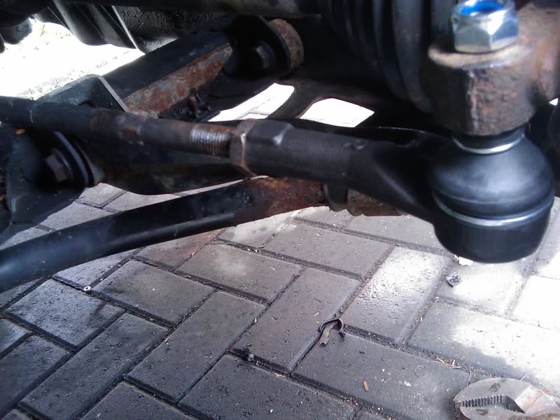

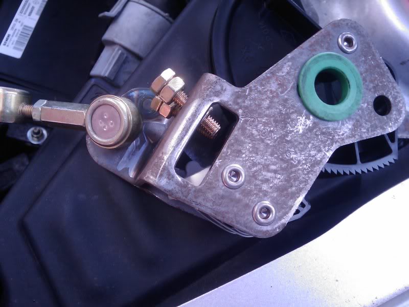

track rod ends on and threads cleaned up ready for set up.

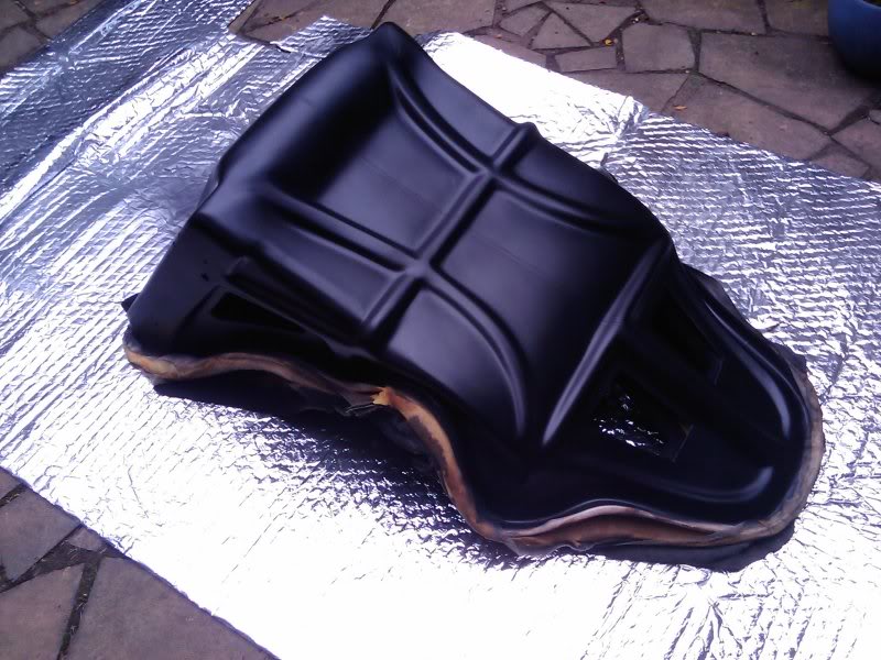

Sprayed the back of the passenger seat to tidy it up a bit. looks much better. Shame about the front. Gonna get my old dear to see if she can glue the cover back on or something for me.

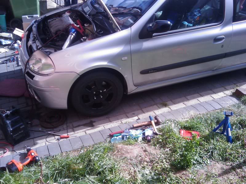

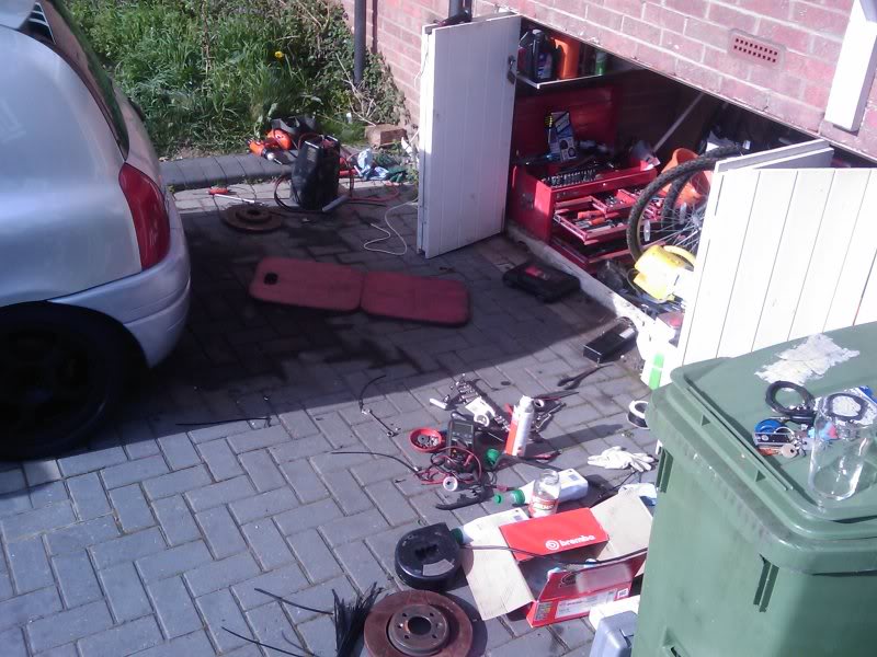

Yet again Dan (Shadowness) came over to lend a hand.

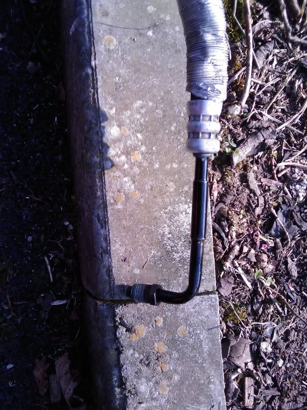

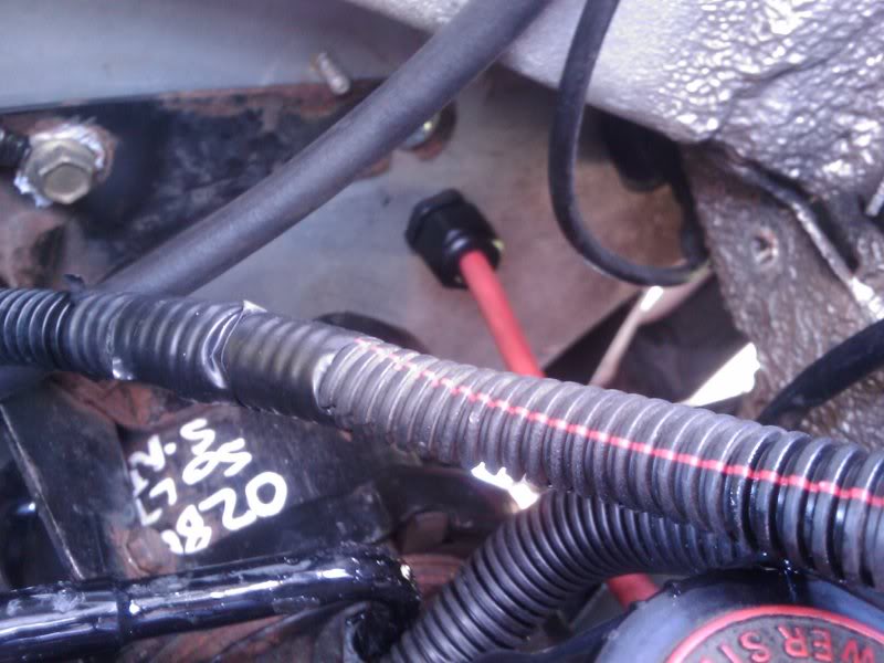

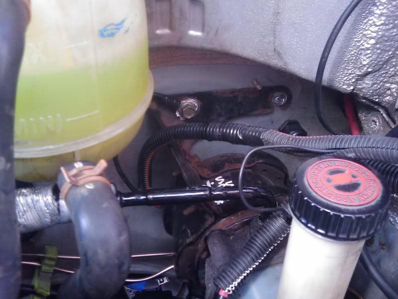

I fitted the newly made pas pipe.

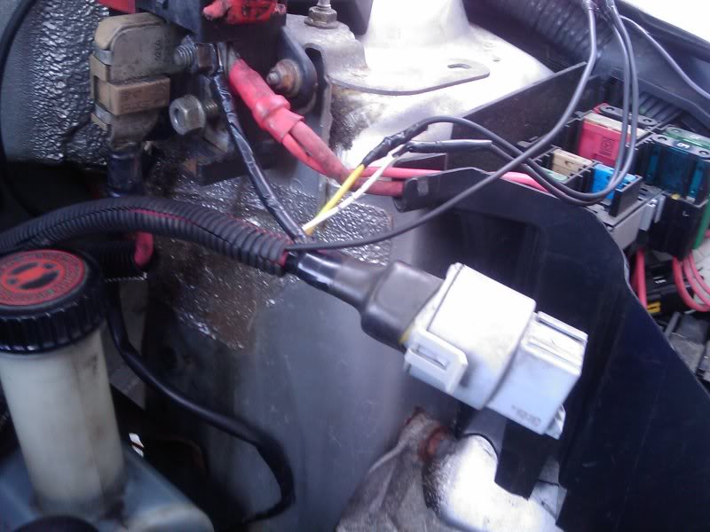

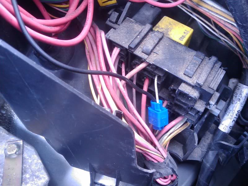

And finished off the loom and relay for it.

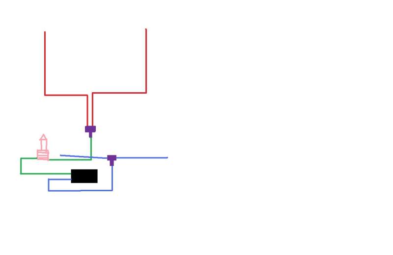

Ran the wire through for the cooling fan overide and tested.

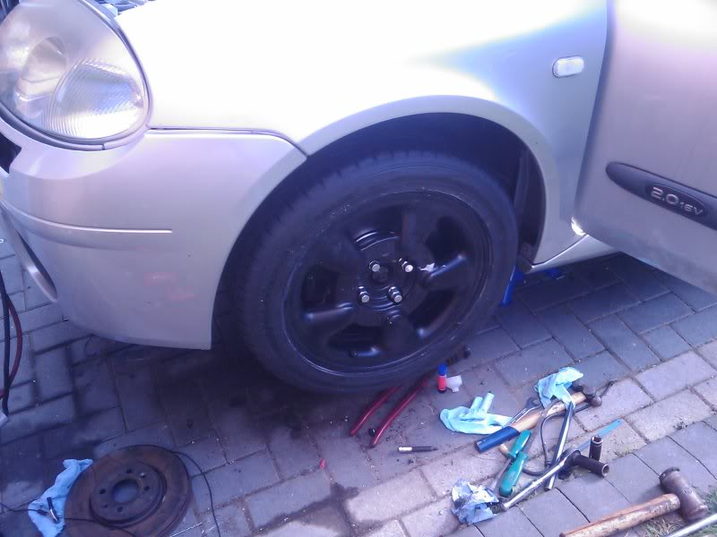

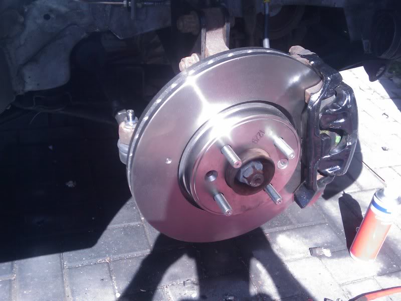

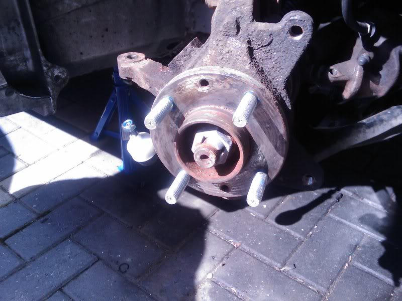

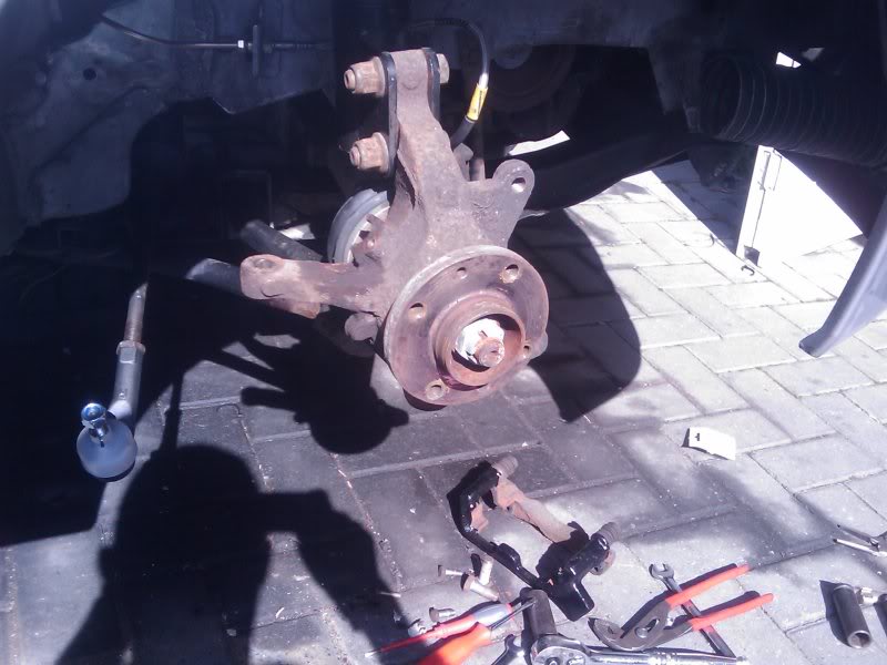

While I did that Dan stripped the front brakes down as I managed to get some discs this week.

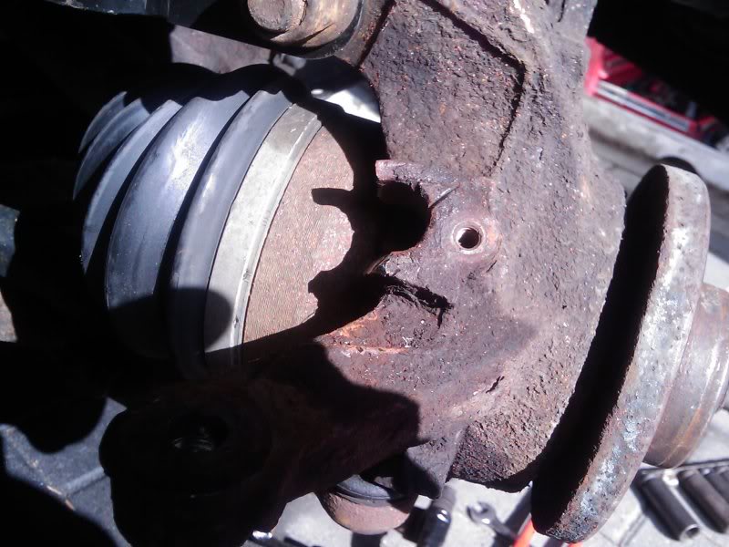

I wanted to remove the ABS sensors but they were 'In there' so had to get medievil with them. Ended up cutting the hub carrier.
Stud conversion was fitted to the hubs.

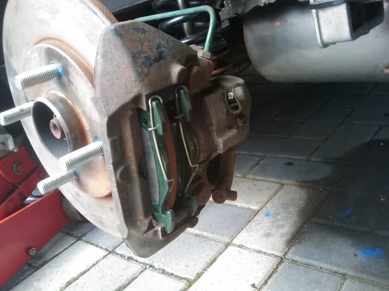

And new disc on, again with the previosuly loved Greenstuff (*spits on the floor), brake pads

We filled up and tested the pas system and found no leaks.

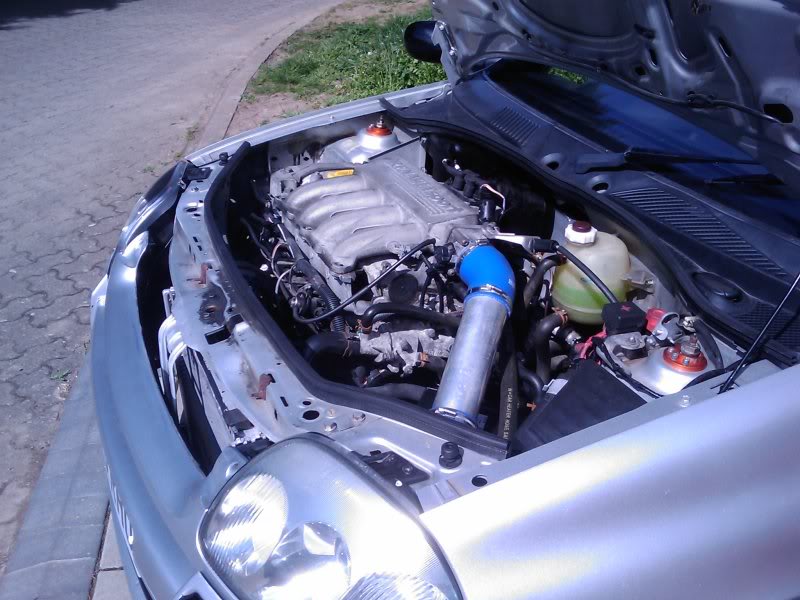

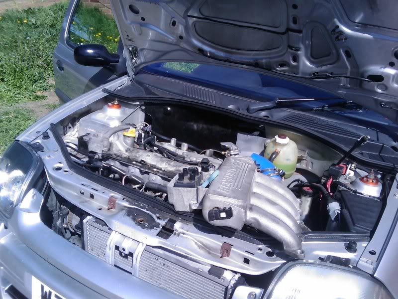

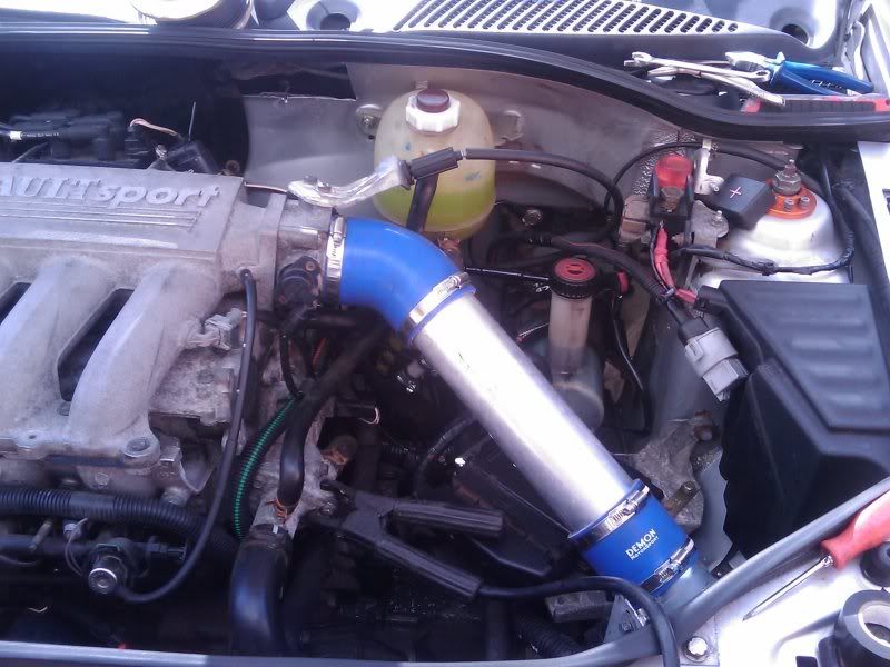

Fitted the induction piping

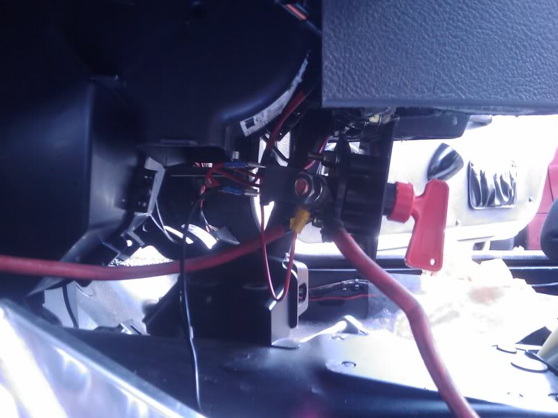

Ran some cable to the interior. Might change this later to some better stuff.
Almost finished the wiring for the cut out switch

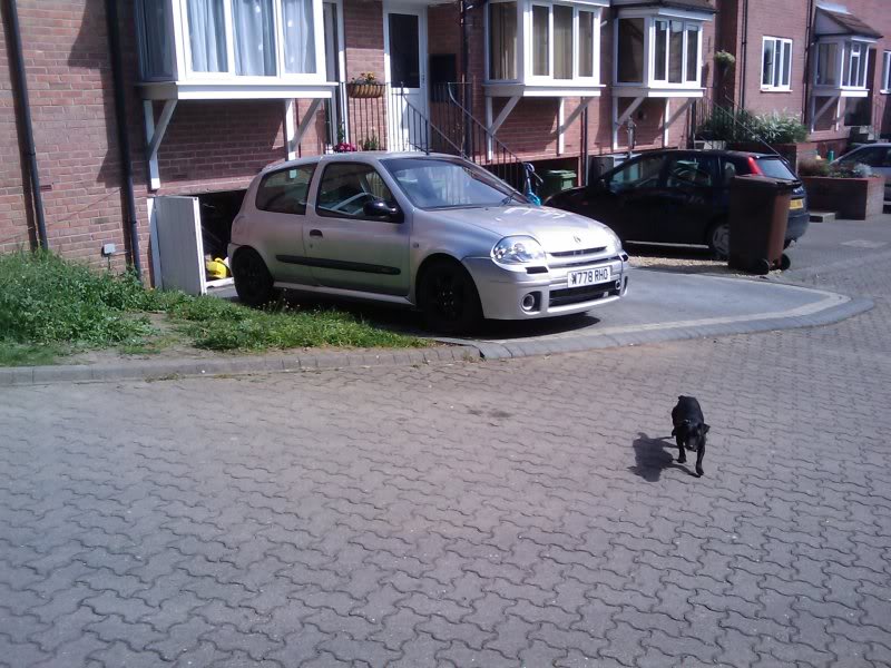

Then down on its wheels for a quick run around the street, check the clutch and gearbox, pas, brakes etc.
Turned her around on the driveway for some rear end attention next weekend. shouldn't be far off an mot after that.
Bomber had a little spin in it around the street.

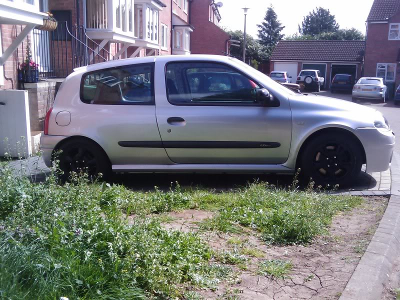

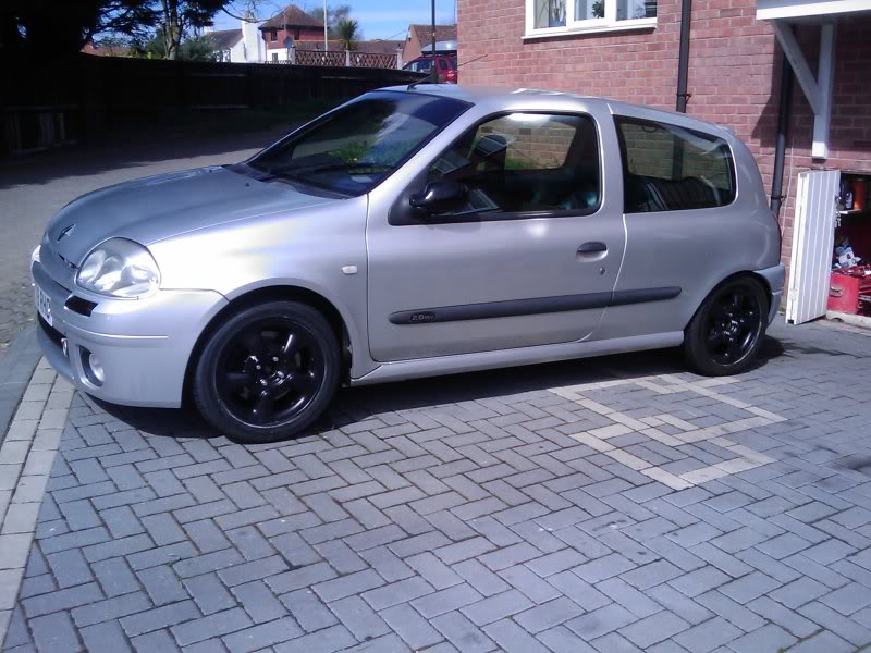

Im super happy with the way it looks sat on the drive right now, the rear ride height on the AST's looks so good. It may have to go down a little at the front tho. Front bumper looks good, needs a spliter, will keep an eye out for something cheap and suitable.
After todays acheivements, I have a big grin on my face tbh

I had a NIGHTMARE getting those ABS sensors out too, but I ended up milling them out as they were off the car at the time
  172 Race Car
Nice work once again...
I thought about taking the whole lot off and taking them to a mates garage to get them out but felt it would eb a backwards step to take stuff off id just fitted, Lol.
Still got the back to do yet :rolleyes: hope they come out easier

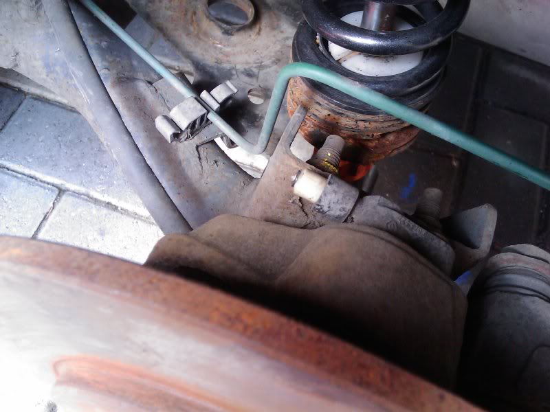

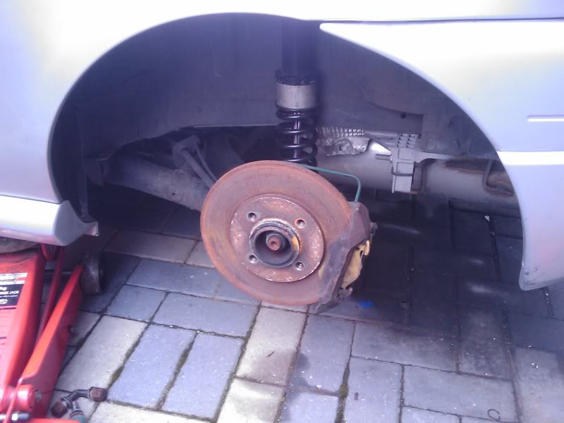

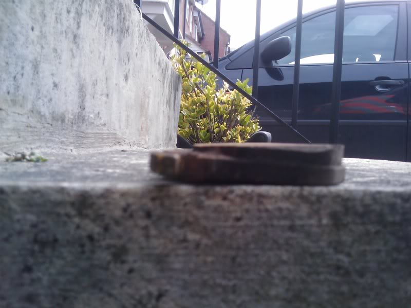

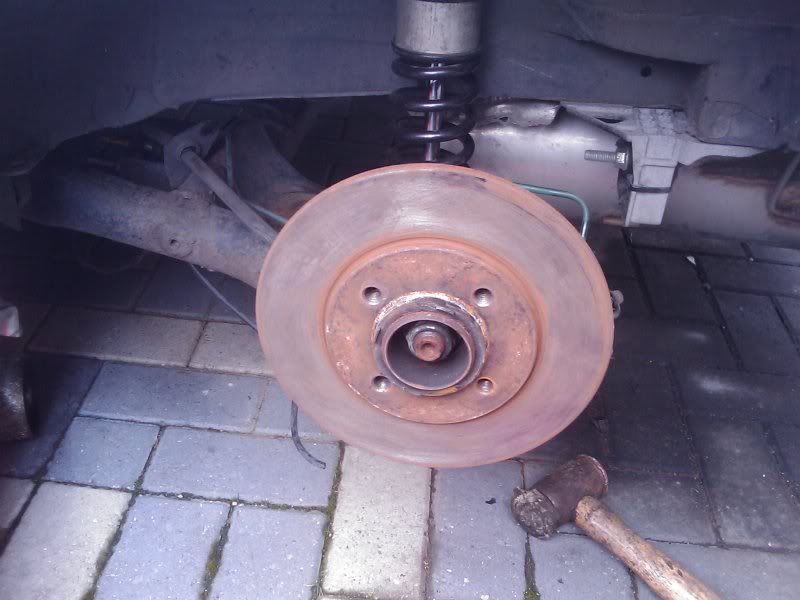

Turned my attention to the rear brakes.
Took off the pad carrier and gave the discs a clean up.
Found a pad on the O/S had been sticking and worn on a funny angle
Everything seems free on the caliper now but I did have a little problem with it on the mot last year where it was binding slightly. Put it down to being parked up for a few moths coz after a few aplications of the handbrake it freed off.
Will have to keep an eye on this.

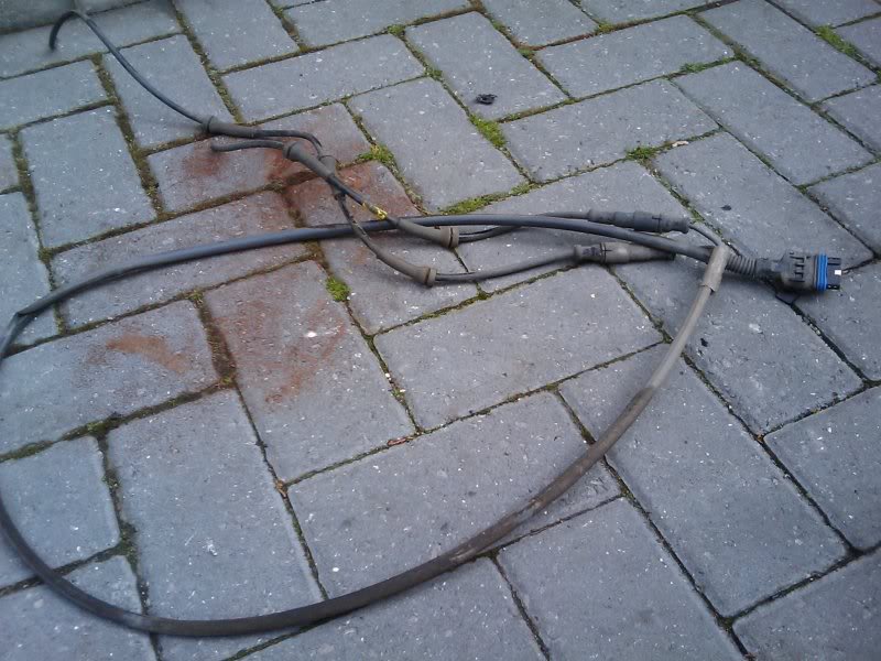

Decided to leave the rear abs sensors in for now. If I have to take off the hubs for camber adjustment then I'll get them out then. Just cut the wires off for now.
Rear abs loom out..

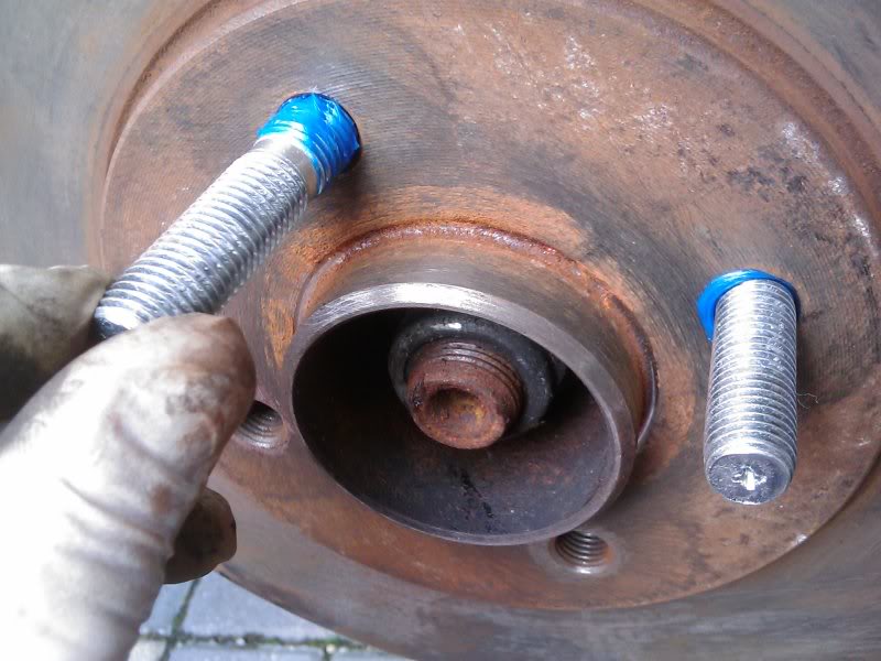

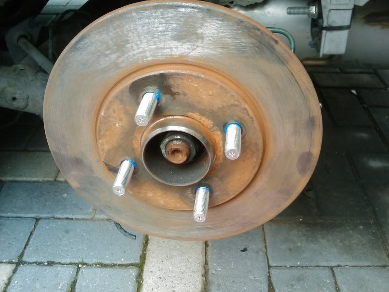

Fitted the studs to the rear
New pads fitted.

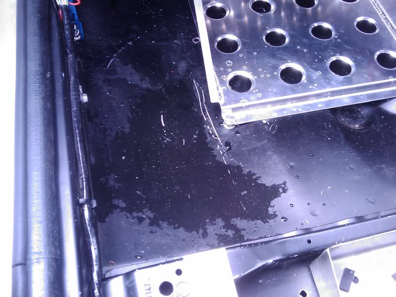

Found a puddle in the passenger footwell, its been bone dry all winter inside the car. Been parked the other way on the sloping drive for a week and this happens.
Another job for another day.

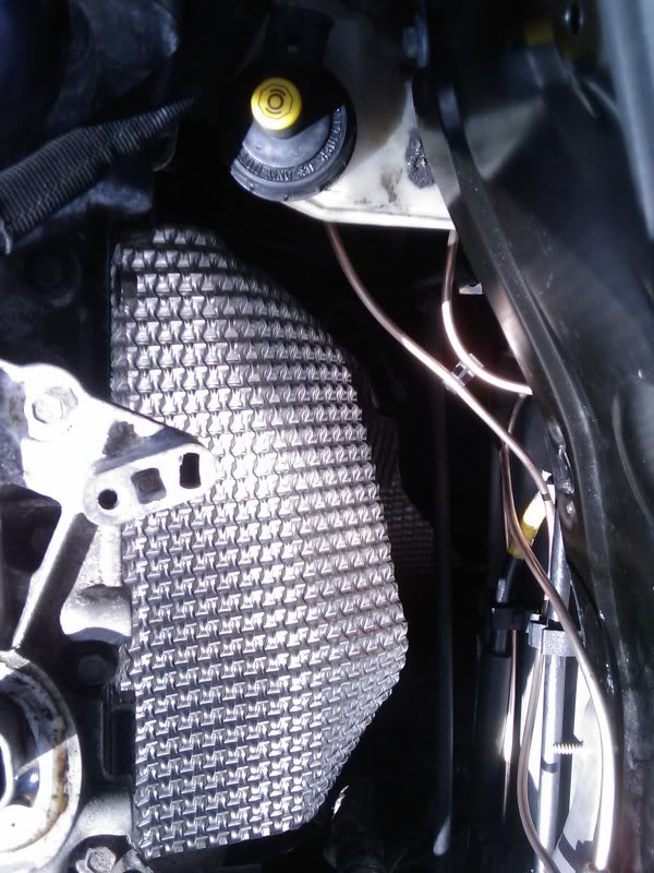

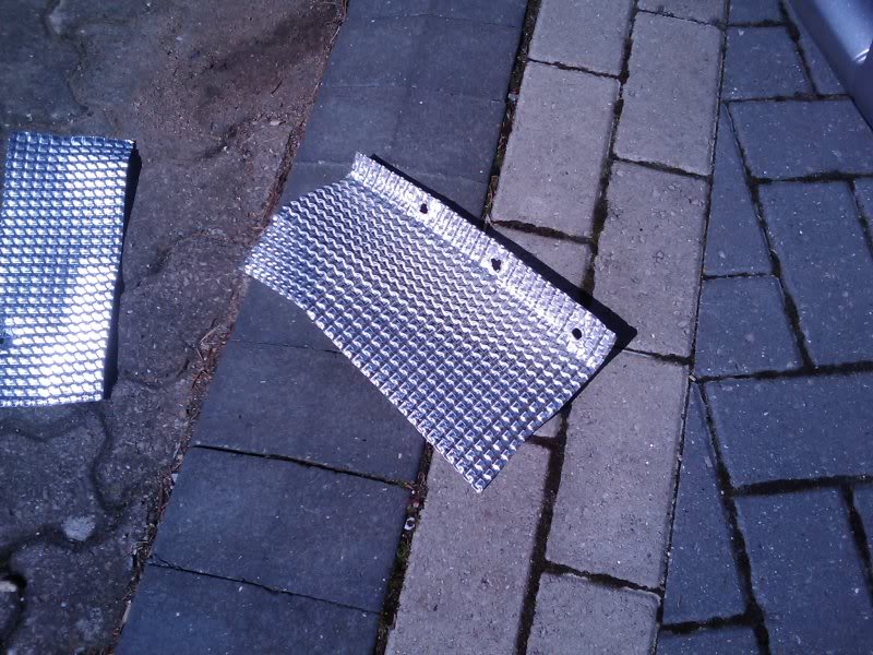

Decided to tackle the heat sheild. Planned to attatch it to the egnine instead of the bulkhead this time. So the plenham had to come off again (are you keeping count?)
Used the old one i had and cut it down a bit, idealy needed a new piece as this is a bit small but it will do the job just fine. Needed something to keep the heat away from the master cylinder.
Fitted to the manifold studs
Engine put back together again...........

Studs kit is available on ebay for about 35 quid, real easy to fit, you could do it your self.
http://cgi.ebay.co.uk/Stud-conversion-kit-Renault
  172 Race Car
Really? Even with my ability to f*** up the most seemingly basic tasks?
you can take the wheels off cant you. so therefore you just have to put a little thread lock on the studs and screw them in with a screwdriver............. Easy?

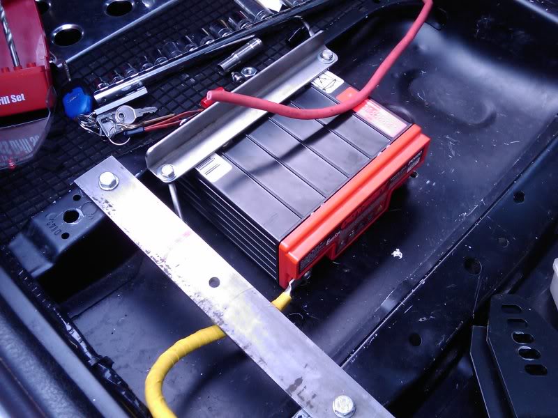

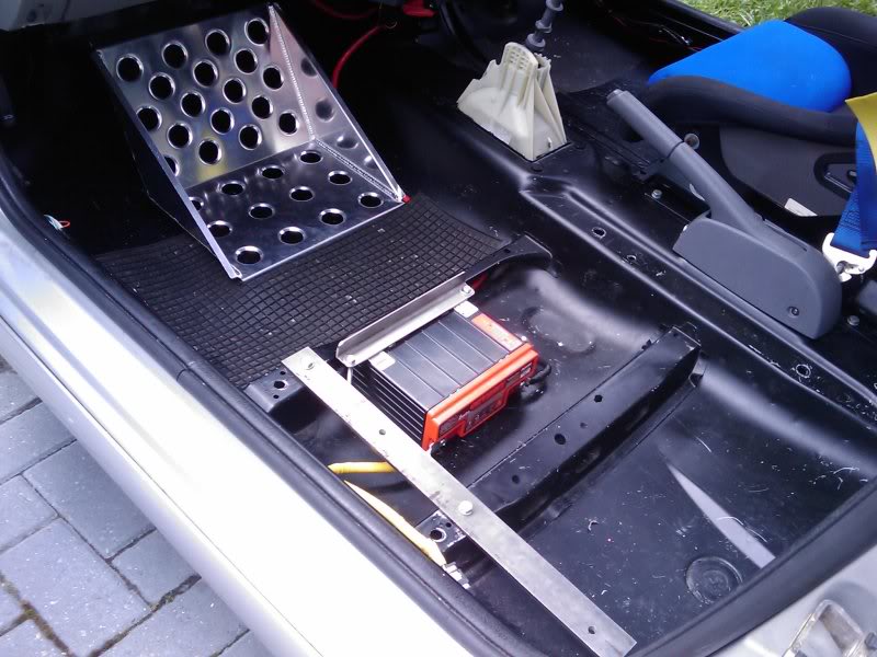

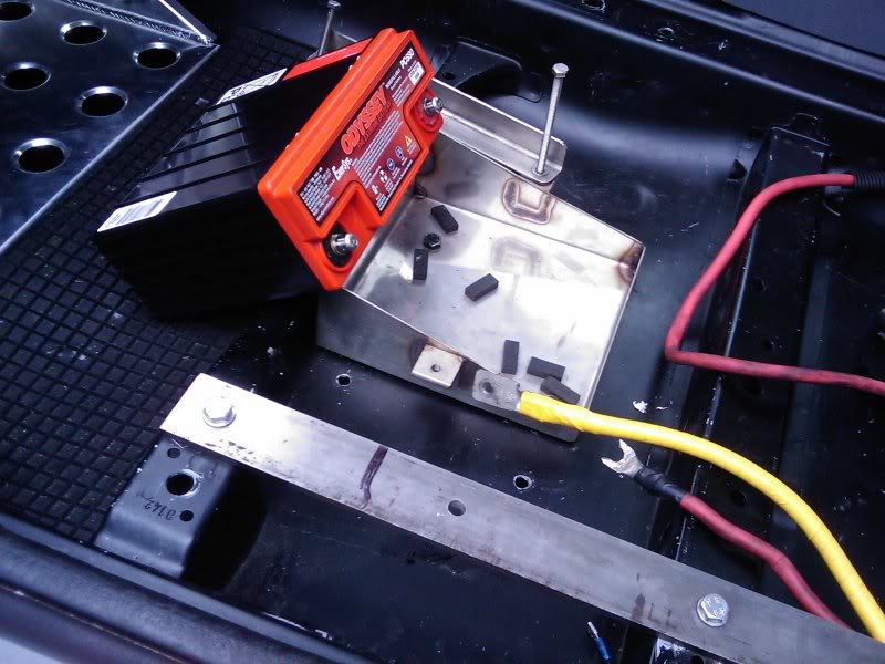

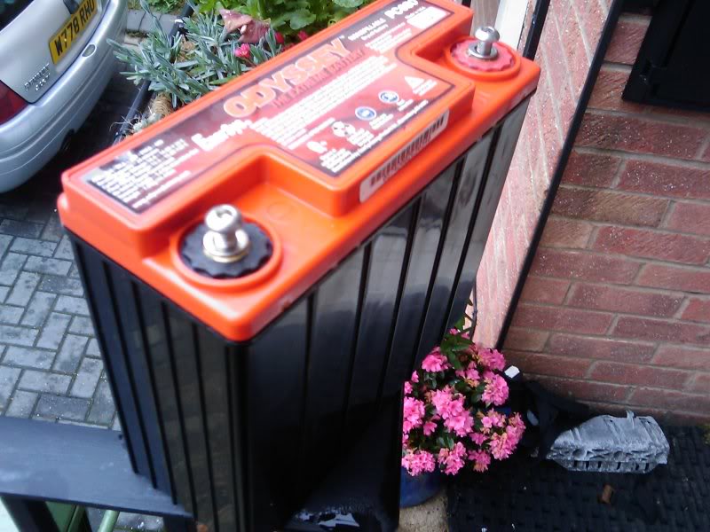

Decided to buy a new battery instead of dicking around with the old one. A direct replacement for the one I had was over £130!
Had a chat with the guy in my local battery specialist who sells stuff to race teams regularly. I ended up with an Odyssey 680, basically the same as a Redtop 25. He has used this type to start F3000 cars in the past. Its more than man enough and at £75 not cheap but better/safer than a normal car battery.
Only weighs 7kgs too....

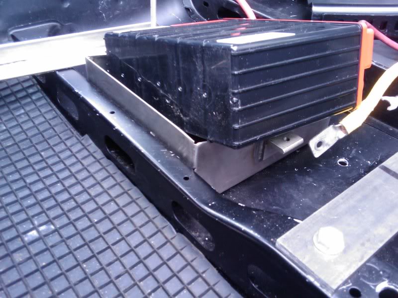

Problem then was it wouldn't fit the lovely Adeyspec battery box.

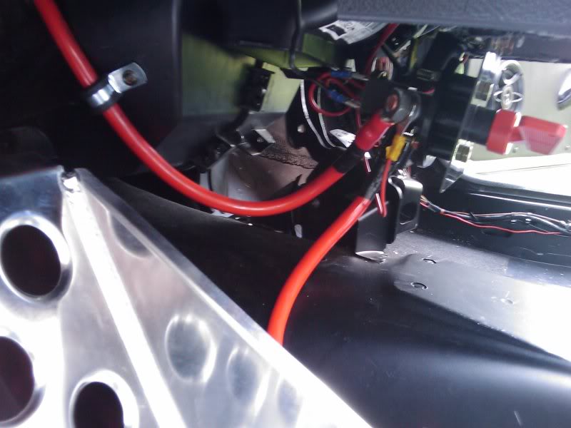

DanR was over to help get all the battery cables in neat. We bolted the battery straight to the floor (more holes!) using the top of the battery box Adey made. It will be secured better at a later date.

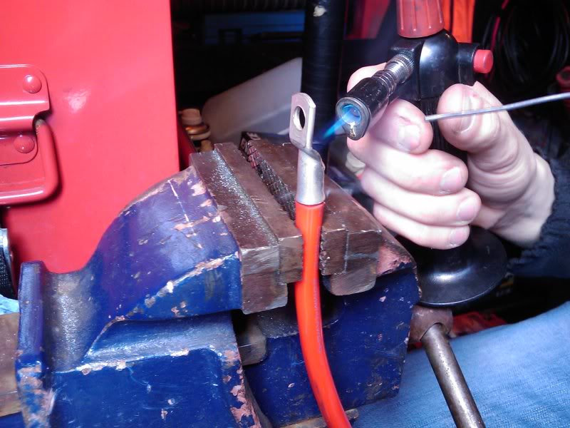

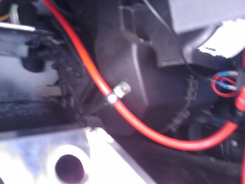

Dan then made up some new cables using high quality cable. He's a perfectionist and made a very nice job of it. Better than me, the king of bodge.
We just need to secure and insulate the cables in a few places soon.

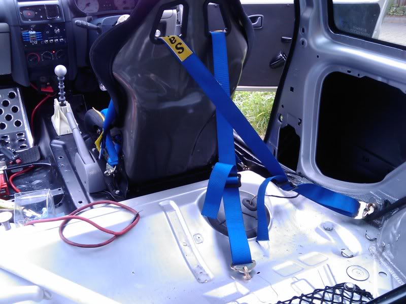

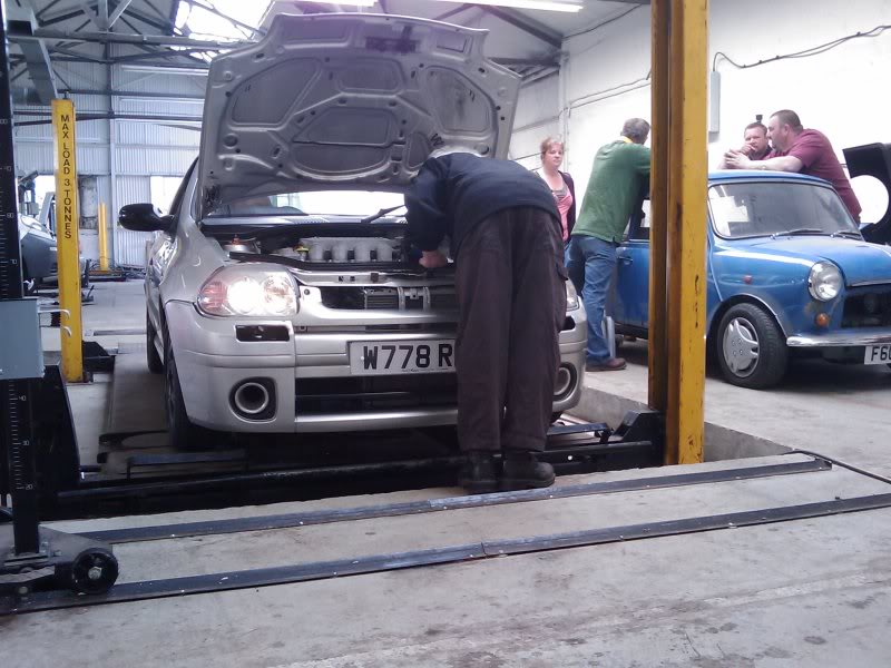

So after id put the seatbelts in, we had checked the lights and had a quick subway, it was down to the mot centre at 3pm.
I was bricking it tbh. Id had so much of the car apart, I was worried I may have left something loose. I don't know the guys very well down there but its literally 300yards from my house and they only charge £25.
The guy doing the test was 137 years old and didn't look to impressed with my handywork, Lol.
No mention of the tw*t strip at all (failed on that last year and I had to rip it off) he was a little worried by the missing abs system at first tho.
The emisions were spot on. That phase2 cat did the job. Last year (with the original cat on) it was a little slow to warm up and the CO was very high initialy.
Then came the problem!!
Handbrake efficiency low! 15%.
Minimum needed to pass was 16%
Fail! :dapprove:
New pads and only 300yards to bed them in, no wonder.

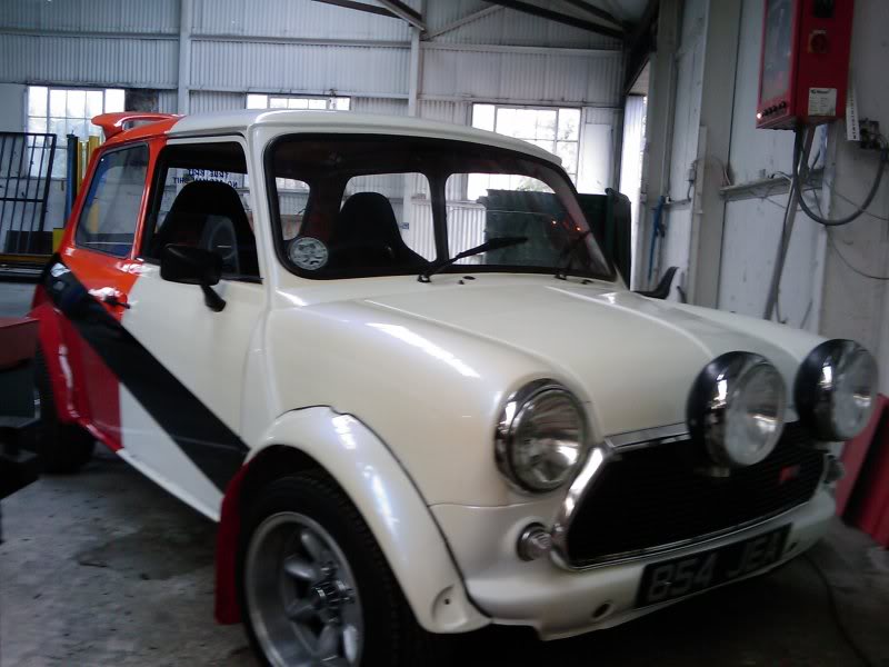

While the 189 year old guy had been doing the test, Id been chatting to the owner of the garage. He has a very mad Mini. Its a turbocharged A series. It runs at 200bhp before the nos, Lol. It has a quaife straight cut box that you can hear the otherside of town. Love it!
Anyway he lent me some trade plates so I could take the car out for a spin to try and bed the pads in. So completely unexpectedly I had a nice little run around the town in it.
40mins later it was back on the mot ramp and it JUST scraped through with 16%.
Pass! :D
