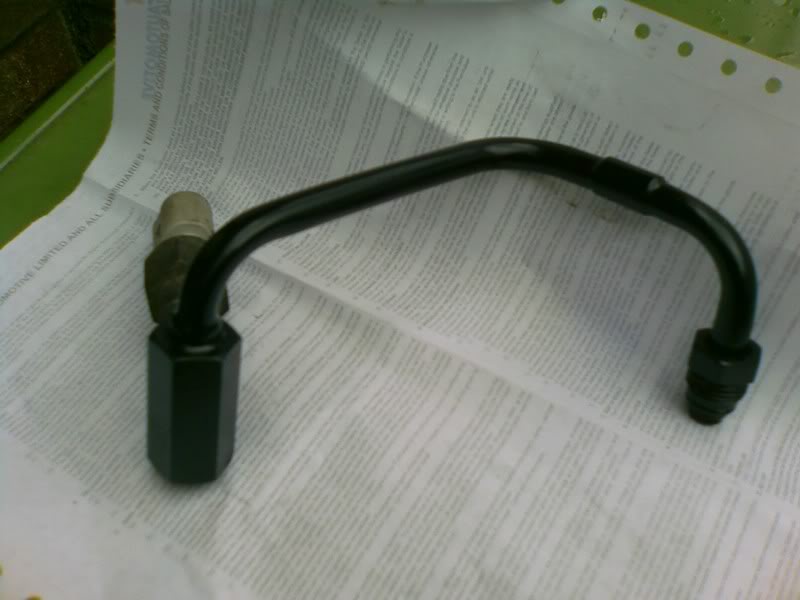

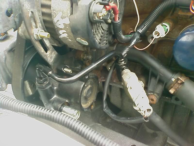

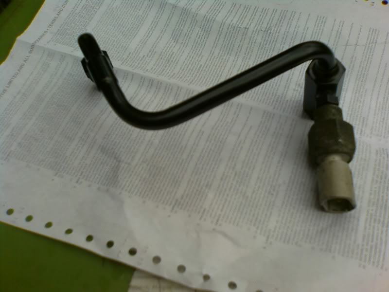

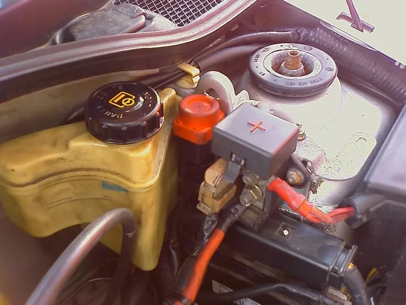

The first problem was the need for a custom pas pipe from the pump. Now its in a different location it just didnt fit. I went to a local one man band hydraulics place and the guy told me he could make it no problem. He promised to ring me, before i went on a weeks holiday, to let me know how it was going.
No phone call :rolleyes:
After my week away, I popped into see him and he couldnt even remember who i was, he then said he could do it but would have to sub the job out to another firm in Gloucester. f**king messer, so i took the template pipe off him and went straight to the other company in Gloucester. They used the original fittings of the pipe and just replaced the tube part to my new shape. They were really busy but managed to do it within a few days, top stuff!
Total cost £60 and i think they done a good job.
Fitted this to the car and realised i needed to support it some how as it would probably break with vibration. More on that later.

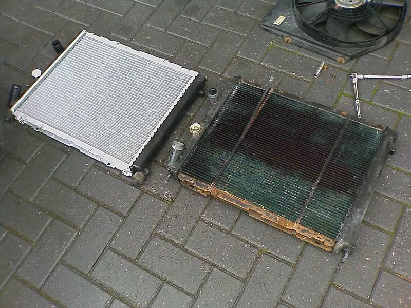

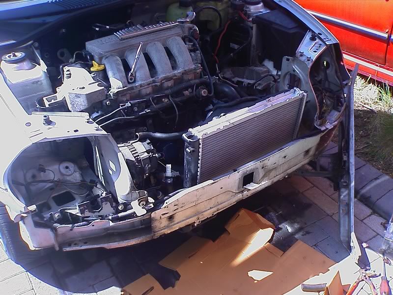

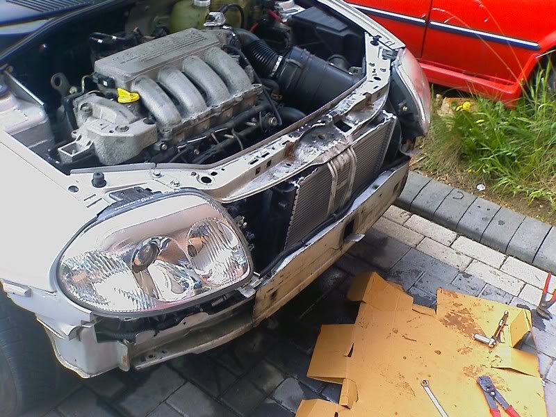

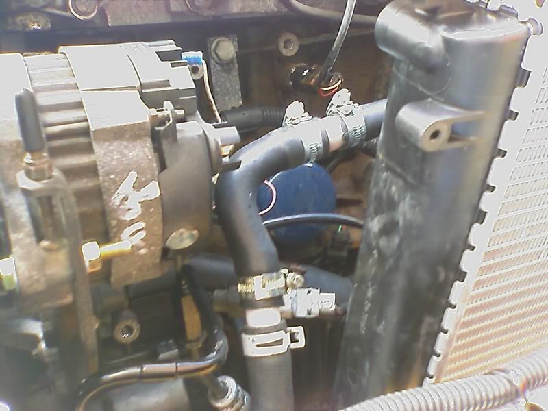

The radiator was looking rather tired so i managed to pick one up off the internet for a very reasonable £73 delivered. Its an aluminium one and it weighs 3kgs less than the original! Lol.....

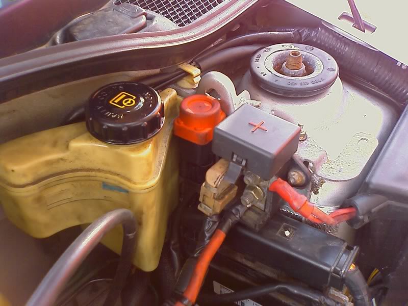

fitted this in and then was reminded how little space there is in the engine bay
Still using the original airbox for now, with an itg, Untill funds alow for something different. The space is made for it by moving the ecu etc. Routed the standard feed to the gap under the passenger headlamp. Only one of them coz the other fell to bits.
started putting the front end back together but left off the grill and bumper for now as ive got to sort the pas pipe brackets.
Finished the low pressure pas feed pipe, lots of joins.

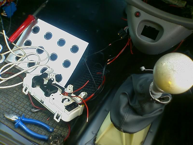

While the car is in bits ive taken the oportunity to change a few things inside. As ive driven it abit since the original build I found a few things i wasnt happy with. Just being fussy really.
I fitted a new/remodified heater panel. The last one i did didnt have illumination, which i thought wouldnt be a problem but it pissed me off first time i drove it in the dark.
Also i cut off the supports for the heater cables so they didnt work that well and the speed switch was faulty.
Got another panel off Joshydee and did it again, this time leaving the cable supports untouched and fitting some bulbs to light it up.
Changed some of the wiring for the boot realese too.

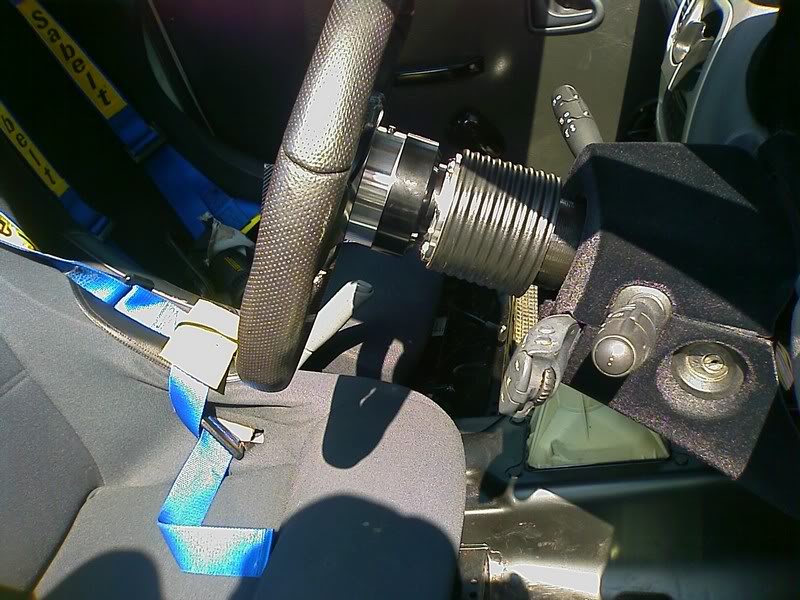

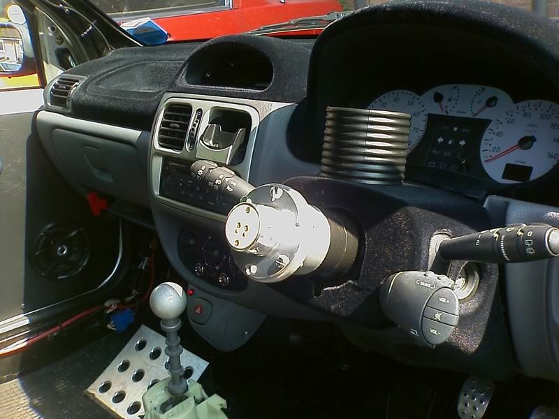

Now im reasonably happy with the driving position and those who have sat in it have commented how good it is with the coloumn lowered. I see the idea has been copied already, Lol. That said I wanted to adjust it a little more so have straighted it slightly.

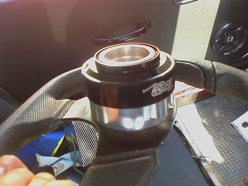

To bring the wheel closer i have fitted a quick release adaptor that i got off Batman ages ago.
This brings the wheel nice and close and if feels better placed. A test drive to check its what i want is needed soon.

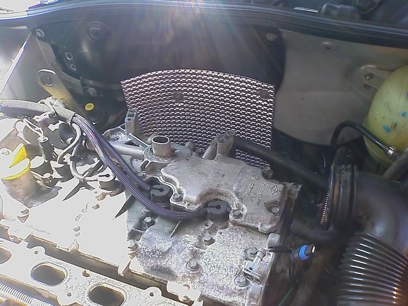

After that it was manifold off again to fit a small heat shield to the bulkhead.

on those radiators, what the white thing between the 2 hose connections? Looks like its blanked off (for a fan switch?) - don't think mine has one...
yea its just a blank. maybe its used for something on a different model. It came fitted with it

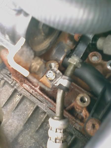

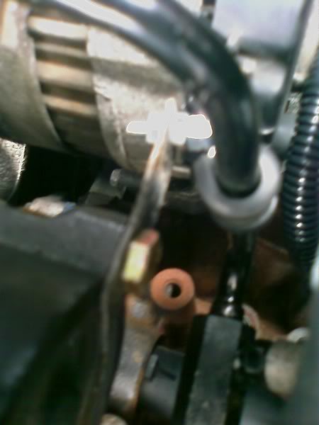

Finshed tidying up the ecu area and managed to squezze the cut out switch in there. Previously it was screwed to the bracket that goes from ecu to radiator area.
brackets made up and fitted to the pas pipe to stop it moving.......Crap pictures, sorry

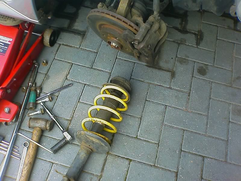

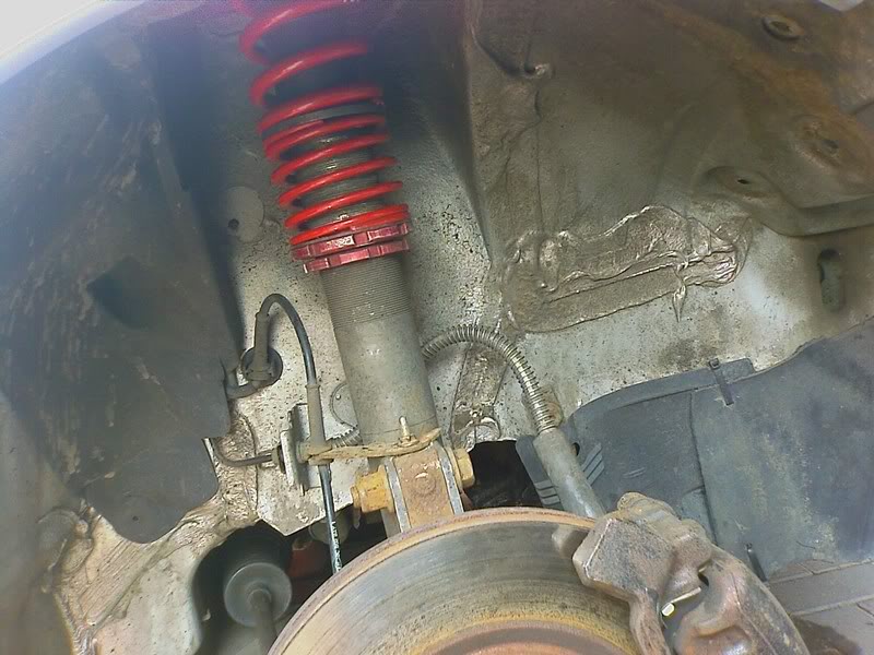

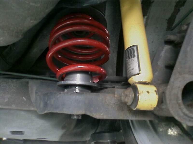

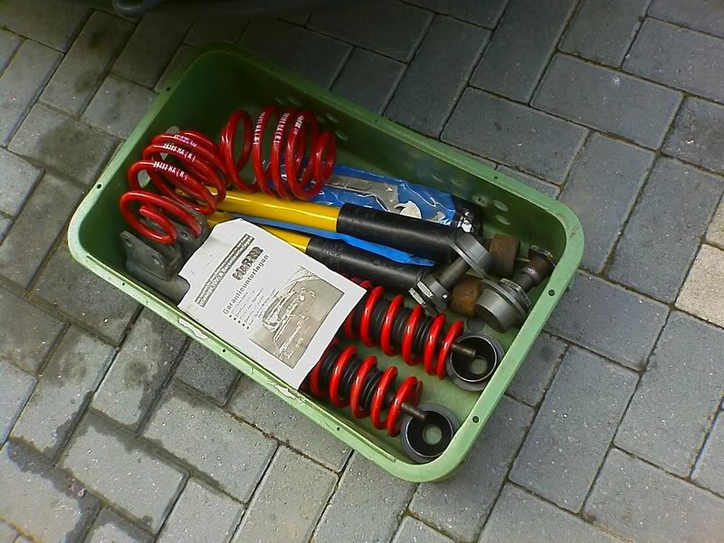

First on the list was to fit these things that have been gathering dust in the attic.
Out with the old......
And in with the new (second hand)...
Booked in for setup on Tuesday.

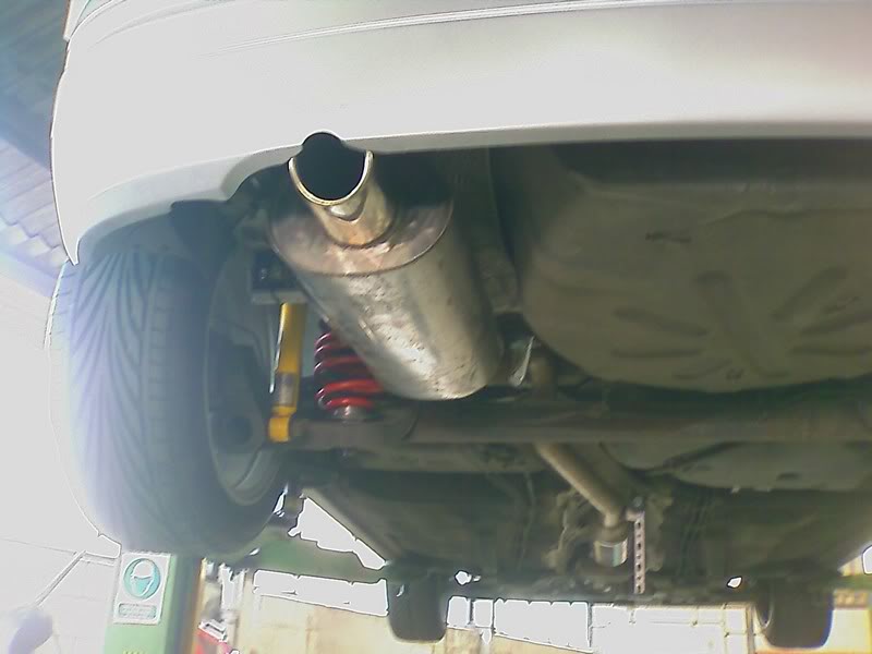

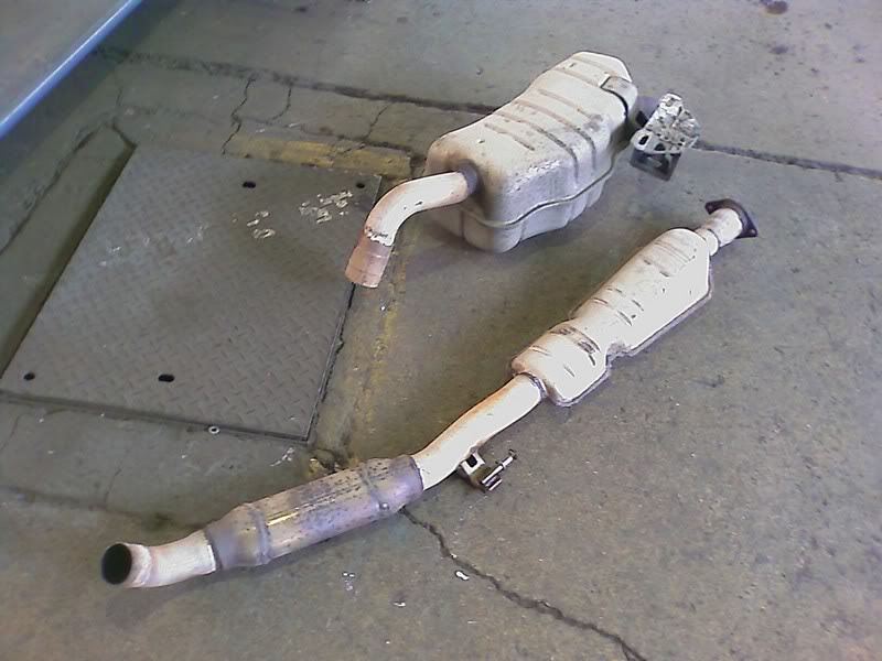

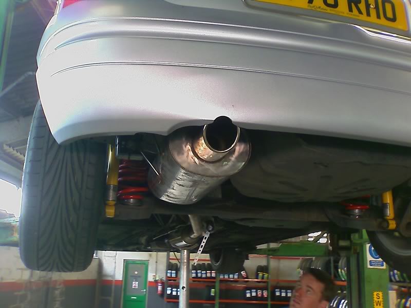

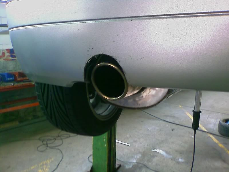

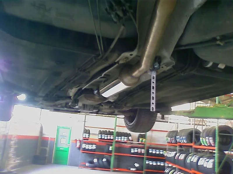

After i fitted them it was off to my mates place to tackle the exhaust.
Bye bye standard Renault.......................

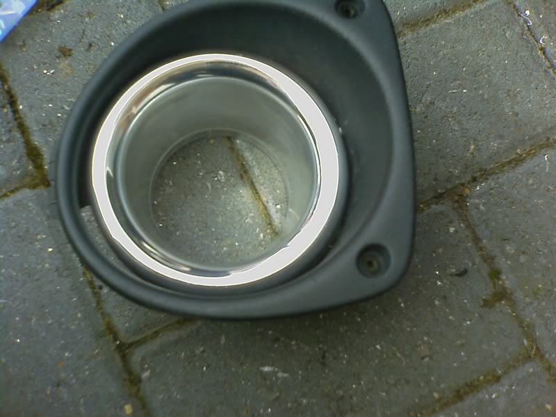

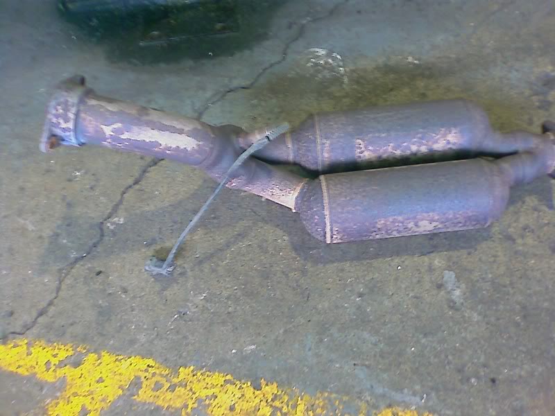

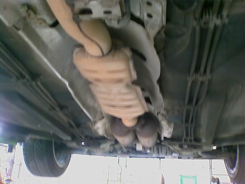

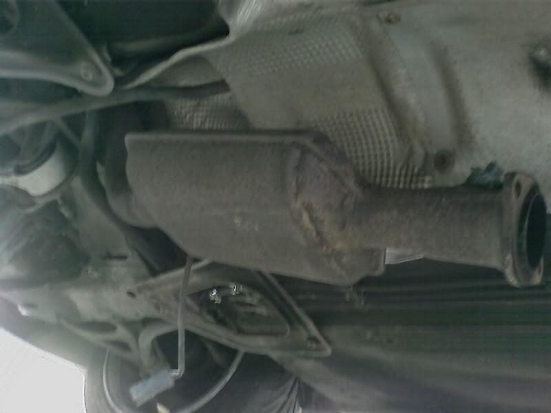

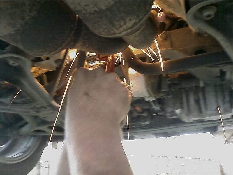

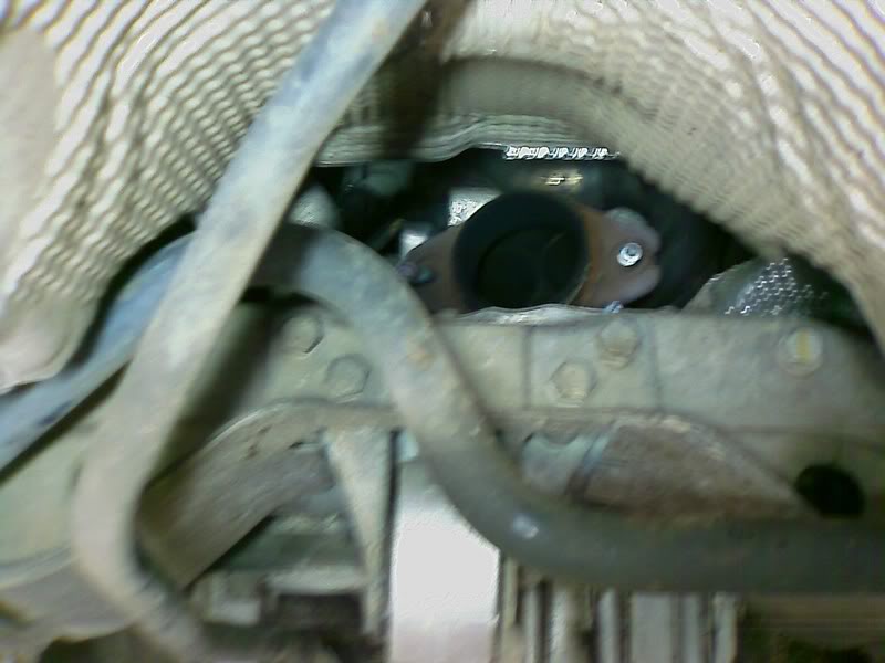

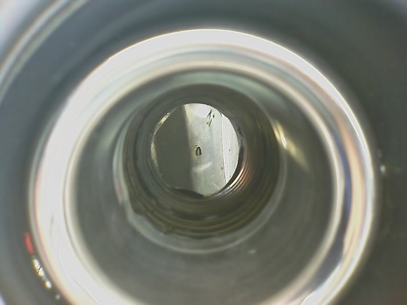

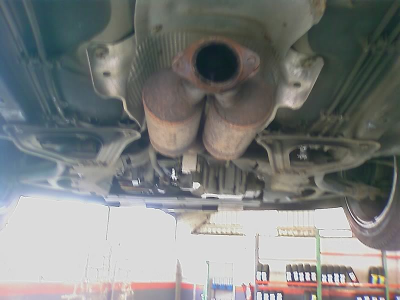

As my exhaust is off my old phase 2 it wasnt a direct fit onto the cat. (different length) Decided to get myself a phase 2 cat to solve the problem. Also its gonna be much easier to make a custom decat at a later date as there is just the one box instead of the phase 1's split cat design.
The old cat didnt want to leave tho. After 103,000 miles it felt quite at home. So we had to get the HOT SPANNER out!
Fitting the cat is a right s**t job. I knew it would be. I intend to get the cat put on a flange and a de-cat pipe made so i dont have to do it at mot time.

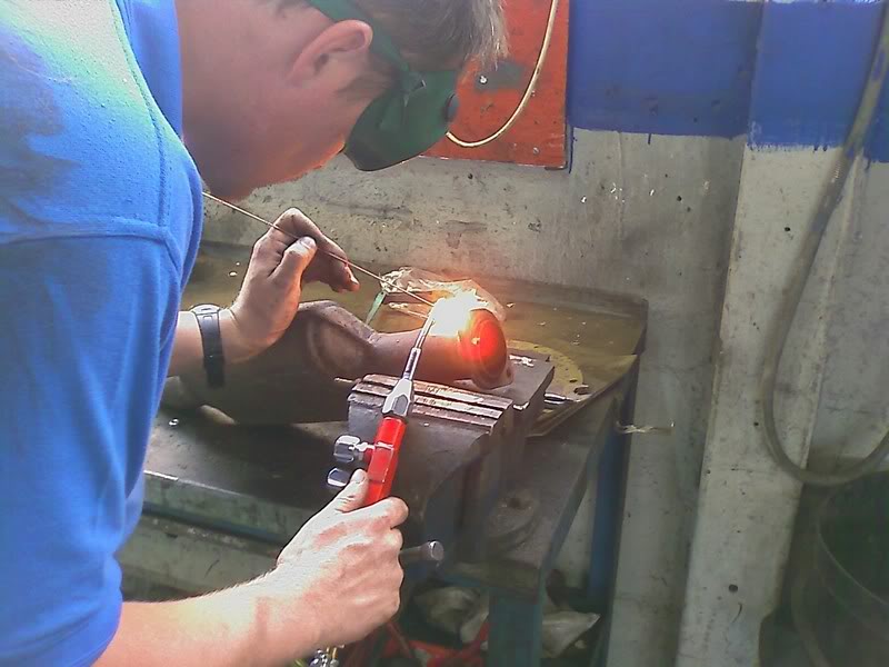

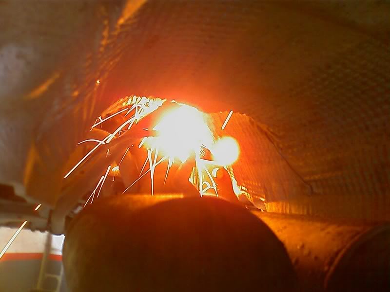

Needed to weld up the hole for the second lambda sensor.
And fit the cat
We spent loads of time dicking about with the exhaust trying to get it right.

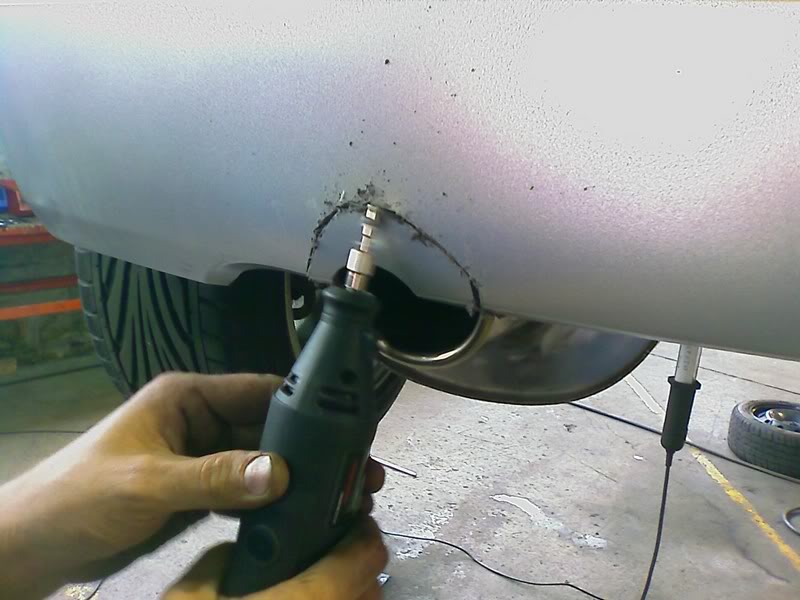

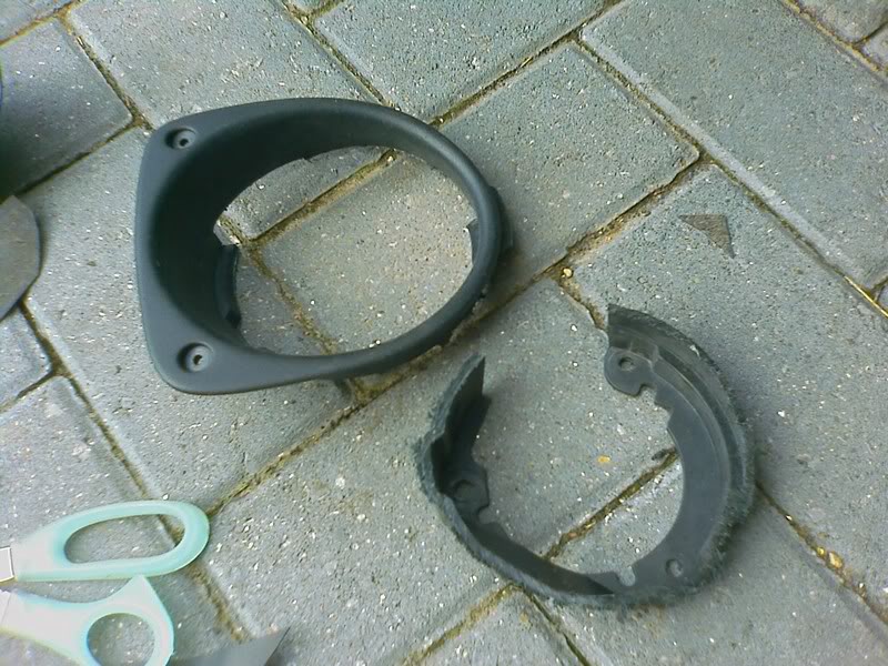

Then cut the bumper and added a 182 surround to finish...
Done..............

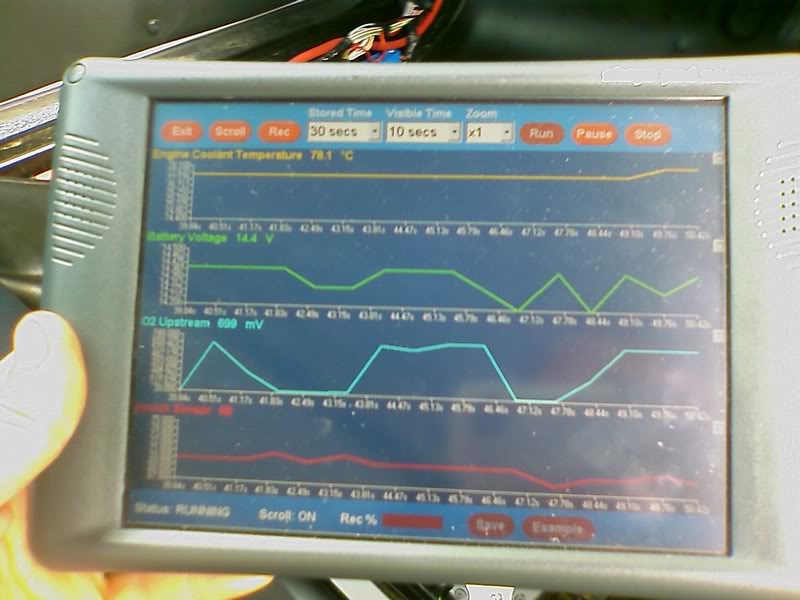

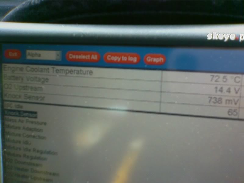

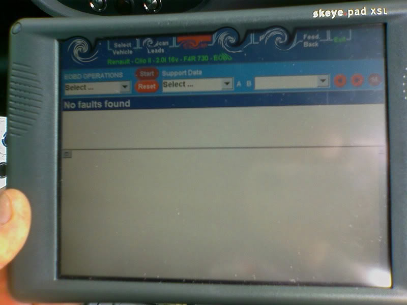

Today decided to stick my work's diagnostic system on it and make sure it is all ok.
A pleasing sight
Checked the live readings and all seams to be ok, lambda switching, knock sensor working.
Found that there is a function to test the actuators and warning lamps. Everything was ok except the high speed fan. Might have to look into this. Low speed is working so it will be fine, could even be because the a/c is removed.

Looking good as ever. Just to add on the fan side of things, the AC is the only thing that uses the low speed fan function iirc. Theres two relays to control the fan, one puts 12v though a resistor first which is mounted on the left top of the fan shroud to give the low speed function and the other puts 12v onto the output terminal of the resistor bypassing it and giving full speed.
Theres not much to go wrong so check the relays first then check the wiring, they are both protected by the same fuse so it won't be that. They're two of the engine bay relays.
Re: My Ph1 172 track sl*g Progress Thread
Awsome info, just what i needed. Thanks mate.
The fan does cut in when running upto temperature but i cant remember if it was low or high speed. If its just the a/c that uses low then im guessing it was high speed.
Wonder why the scan unit couldn't actuate it. Will check the fan comes on again when hot later in the week.

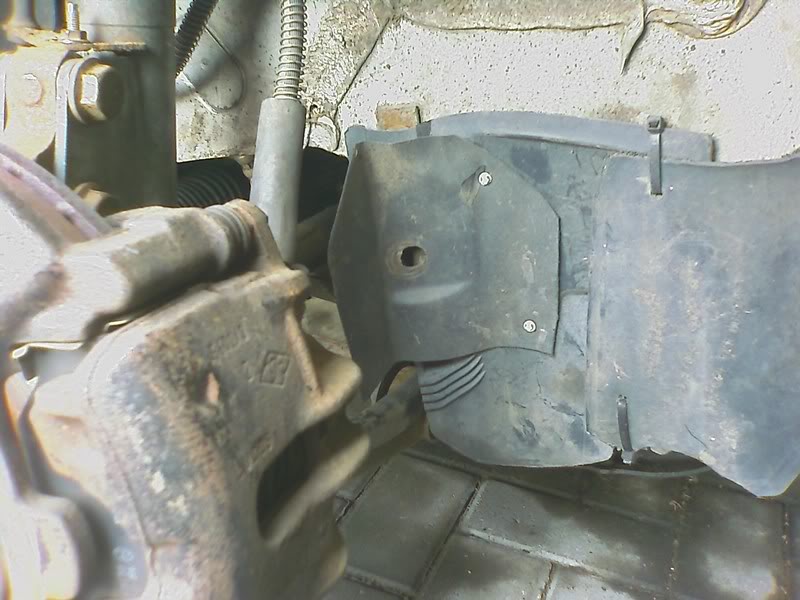

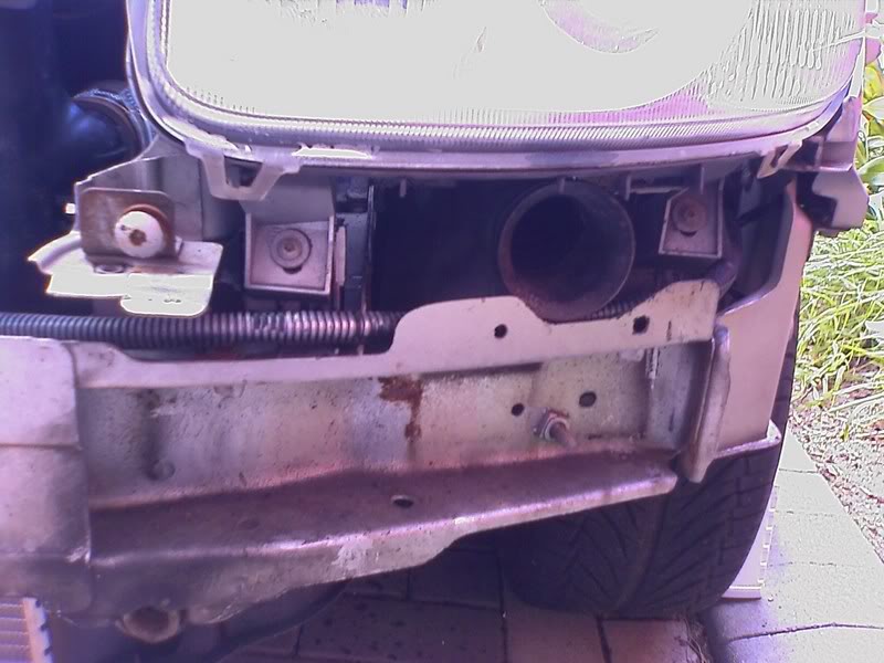

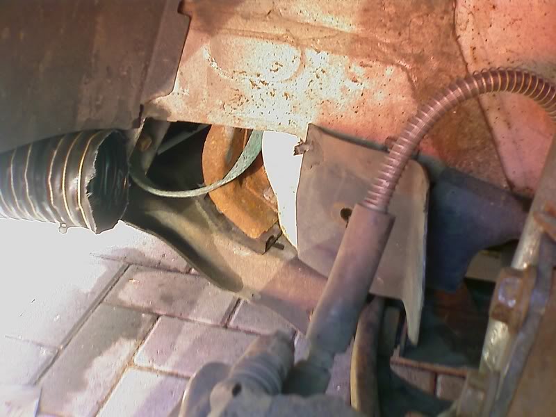

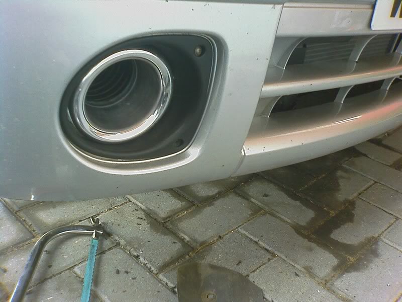

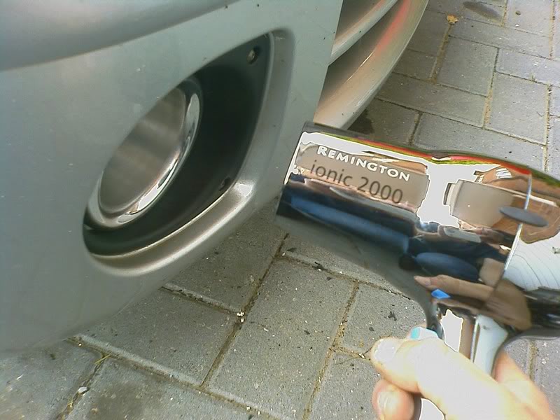

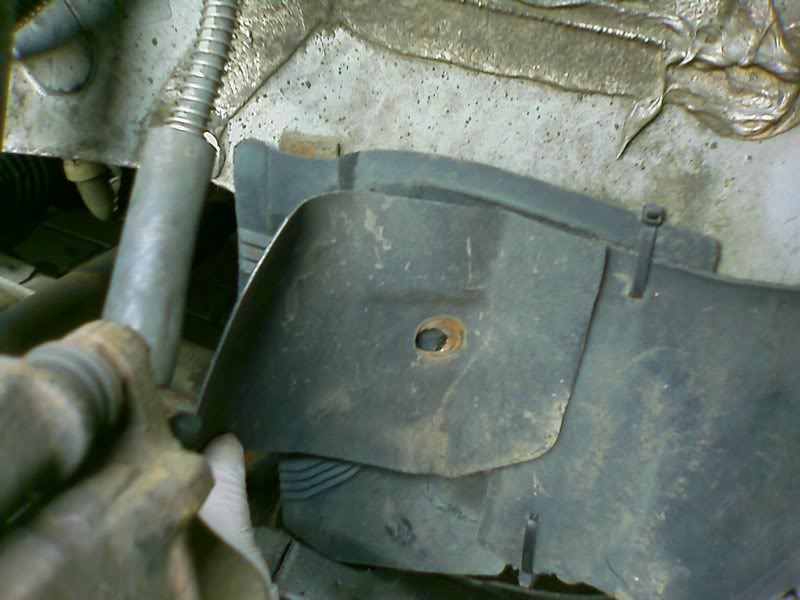

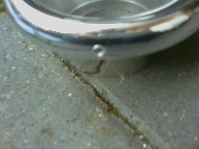

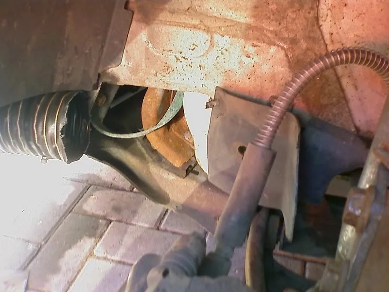

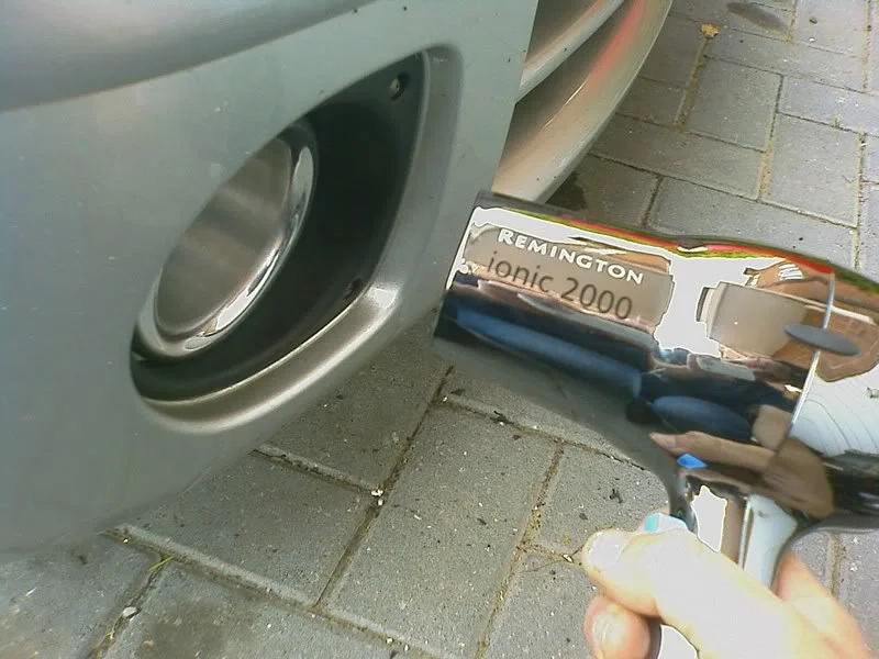

Todays task was to get the last few bits done ready for Friday. I got a 75mm pipercross caf kit & fitted the trumpets into the fog lamp holes. Drilled some holes around the edges & bolted to the plastic surounds.

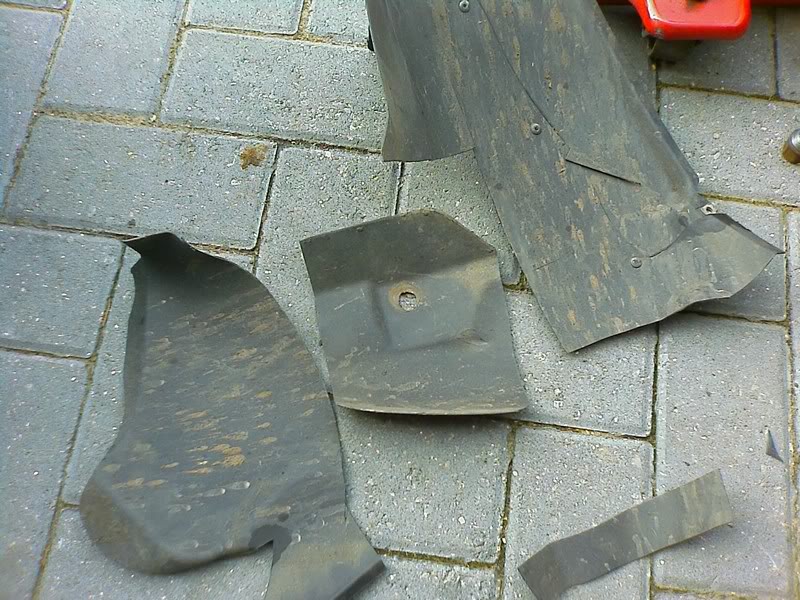

Made some deflectors out of the old rear wheel arch liners & fitted in place.
Then tested the air flow direction using a special brake duct testing device that i borrowed from my mrs.
All done..

your cafs are defo larger than mine, bolting them in looks a good move also.
like the way you have sorted the brake coolers too

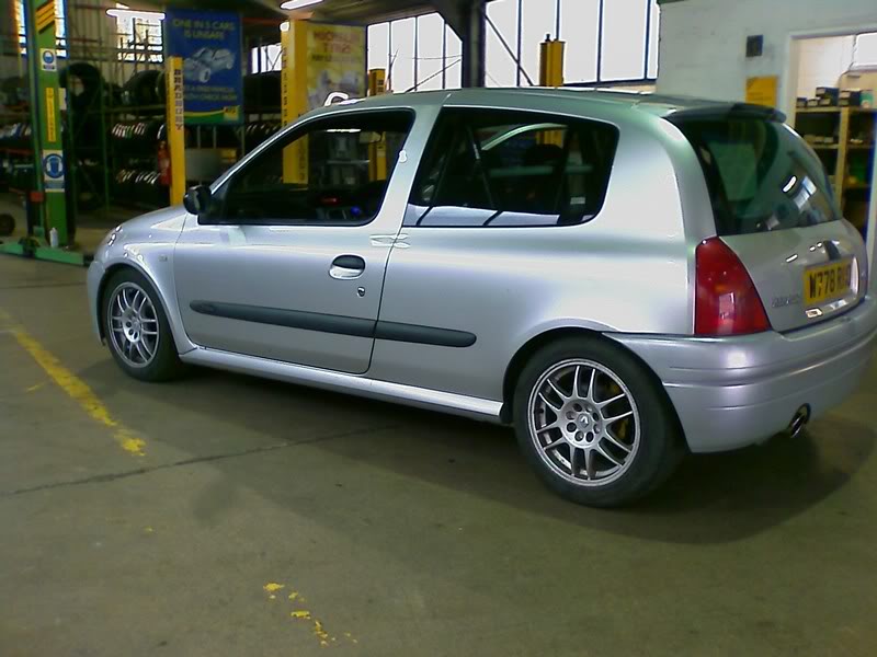

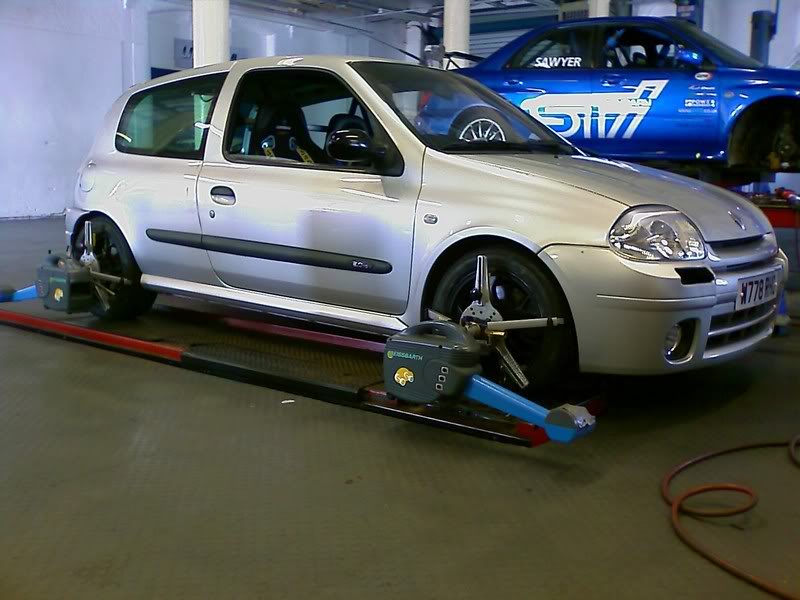

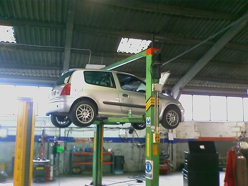

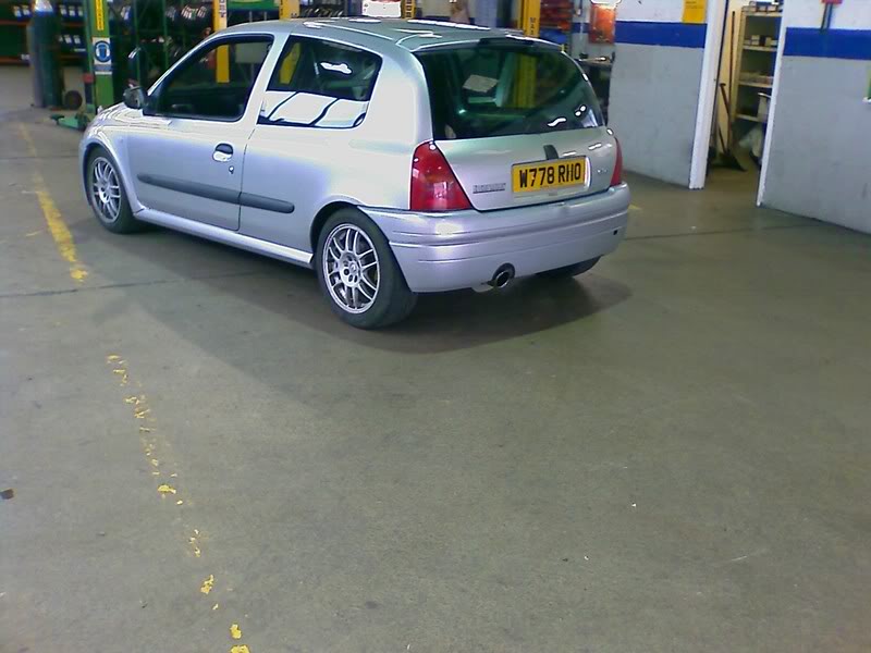

The suspension has been set up. Biggest problem was that the front was too low. They sugested raising it very slightly and lowering the back a bit. Unfortunately the back is already at its lowest setting. Because there is no weight it the back it doesnt sit as low as ideal. So the front had to go up a long way from where i set it.
It looks high now but i still had trouble getting on my mates 4 post ramp, at least i dont have to worry about speed bumps etc.
They sugested that they could sort me some shorter springs on the rear, allowing the whole car to go lower. Tbh im not sure i want to go to that expense for the sake of 10mm or so.
Camber was set to give a good comprimise between road and track.
As ive not really driven the car since its open heart sugery i thought it best to get some miles on it, kind of a shakedown run. Went down to Bristol to see Anim@l and we gave the car a much needed bath.
Driving it home in the cool evening air, omg its a f**king missile! So much more keen to rev. The exhaust and induction noise is pretty quiet when cruising, mainly drowned out by the road noise. But drop a couple of gears and floor it and holy s**t!
Love it ....................... Bit scared tbh!
