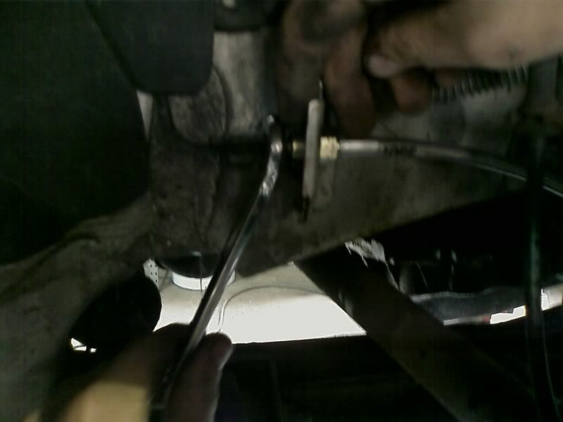

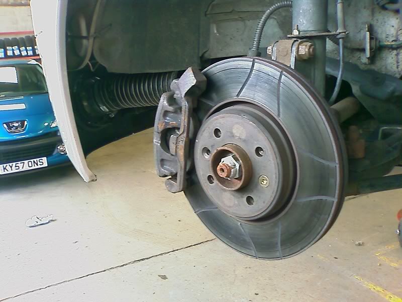

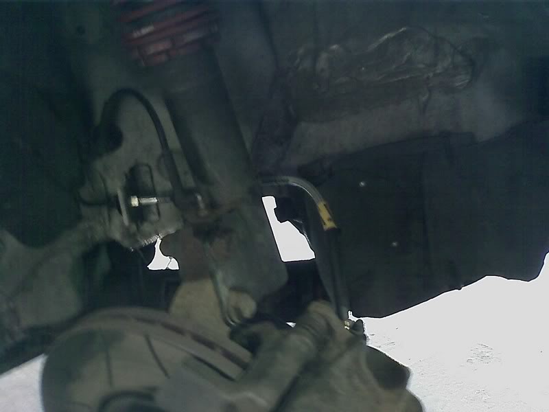

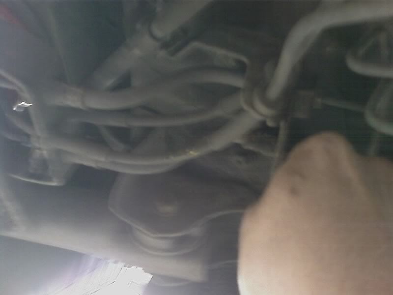

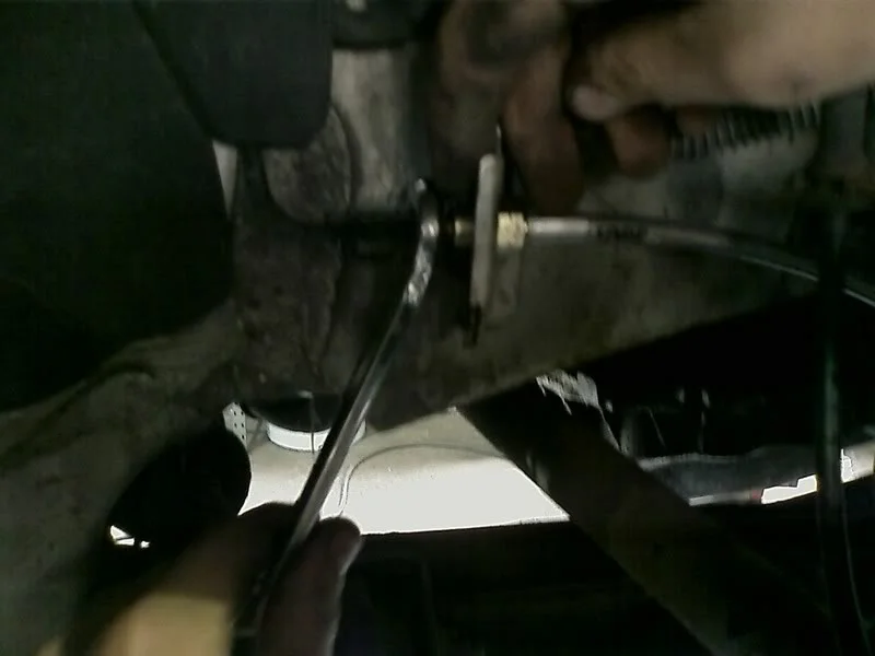

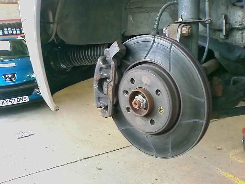

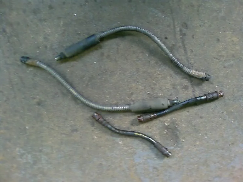

Fitted my new (previously loved) front brakes recently.
Was still on the standard lines at first and they do have alot more initial bite. We'll see how they feel on track and see if i can actualy get confidant to use them properly.

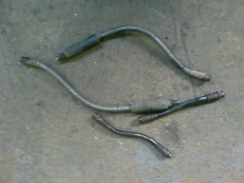

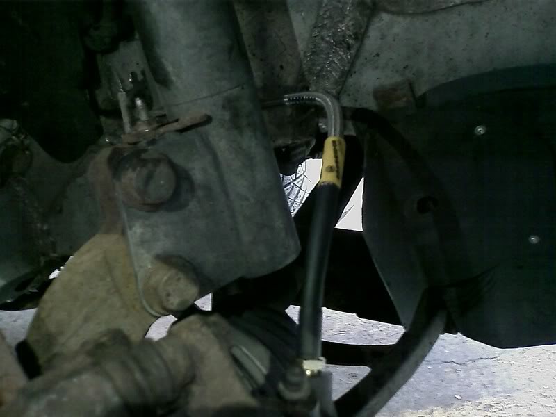

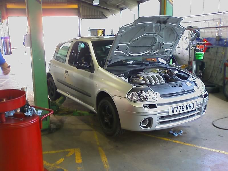

Ive been so busy at work recently and working 12hour shifts that the last thing i want to do is work on my cars on my day off. So I took our Peugeot to a garage for him to do a clutch for me and went to my mates place to fit the braided lines.
I let him do the messy bits and passed him the spanners.
Bye bye rubbery-ness
Hello braidy bunch..........
Finshed the job off with a bottle of Castrol fluid, super dot4 vintage.

i just went out in it to fetch the gf from work and it really does stop well.
  Nikon D700
Re: My Ph1 172 track sl*g Progress Thread
Looking good matey - got the same disks on mine now.
What pads you using? im on DS2500's now :D
Tried to fit my hoses, one of the originals was seized at the caliper, the other at the line - my mate is sorting on Saturday - so i'll have the trip up to the rock to get used to them - eek!

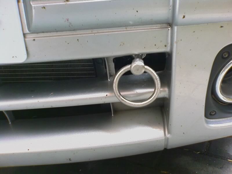

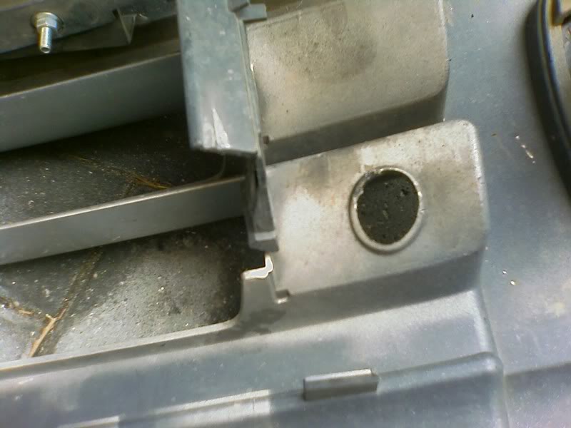

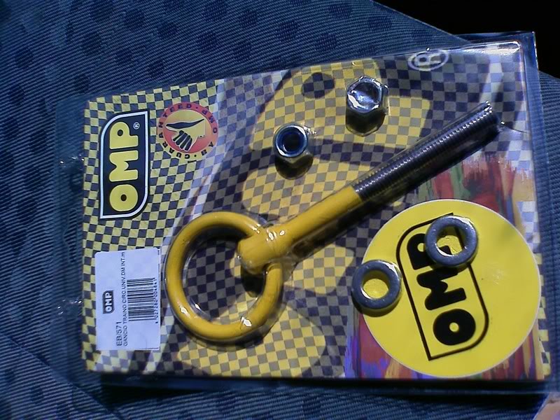

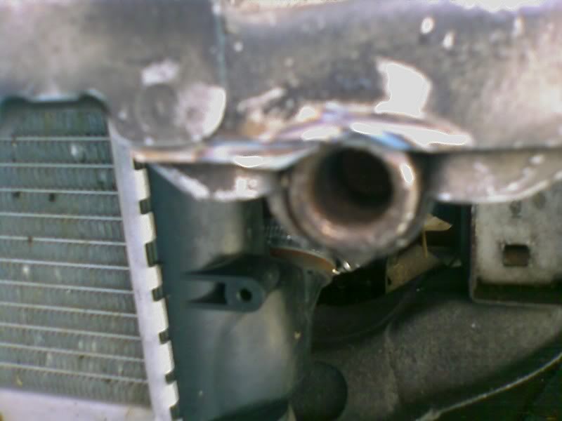

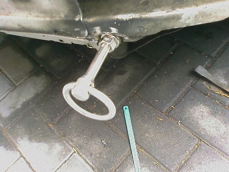

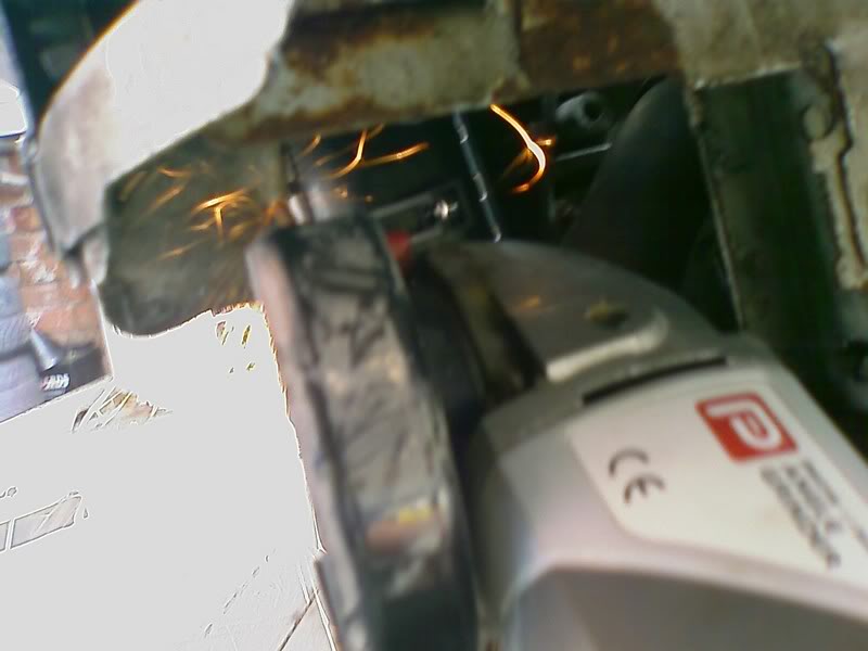

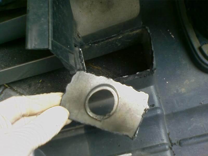

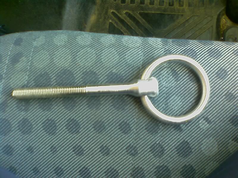

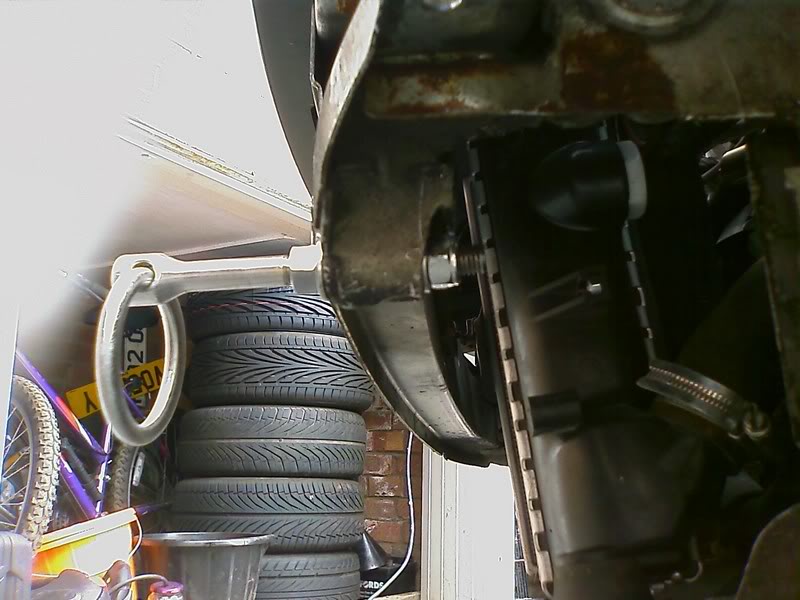

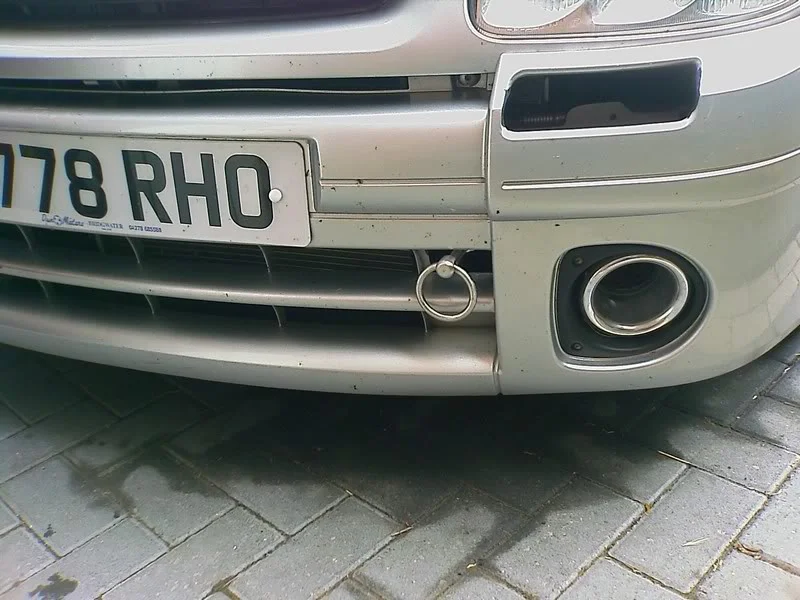

Got one of these recently coz i refuse to pay the price cup racer ones go for. As everyone knows they are not a straight fit.
Only came in one colour so i stripped all the paint off, took nearly two hours off and on.

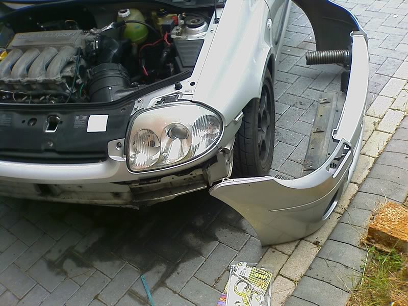

First thing bumper off

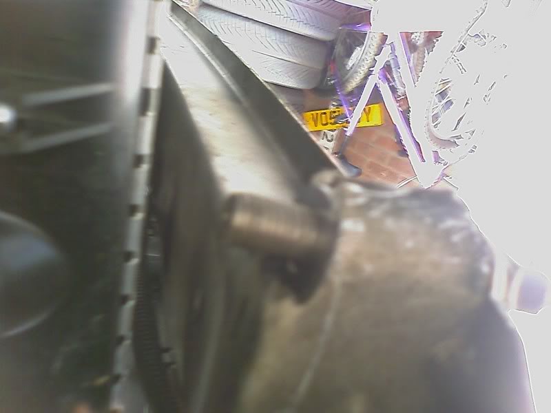

Next up had to modify the tow eye holder to alow the omp eye to pass through.
Like so.

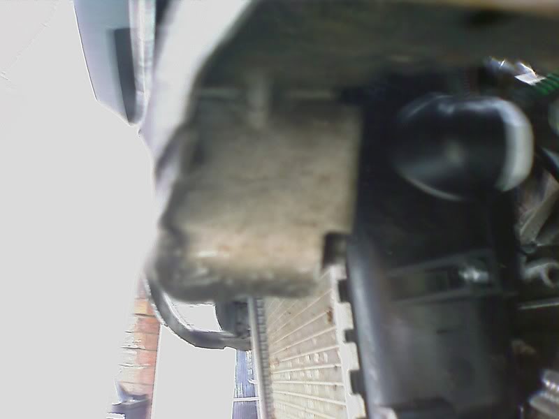

small amount of grinding needed to get it sitting level on the front.
And its in.
Also coz its basicly bolted to the car it cant be unscrewed and stolen like the cup racer ones.

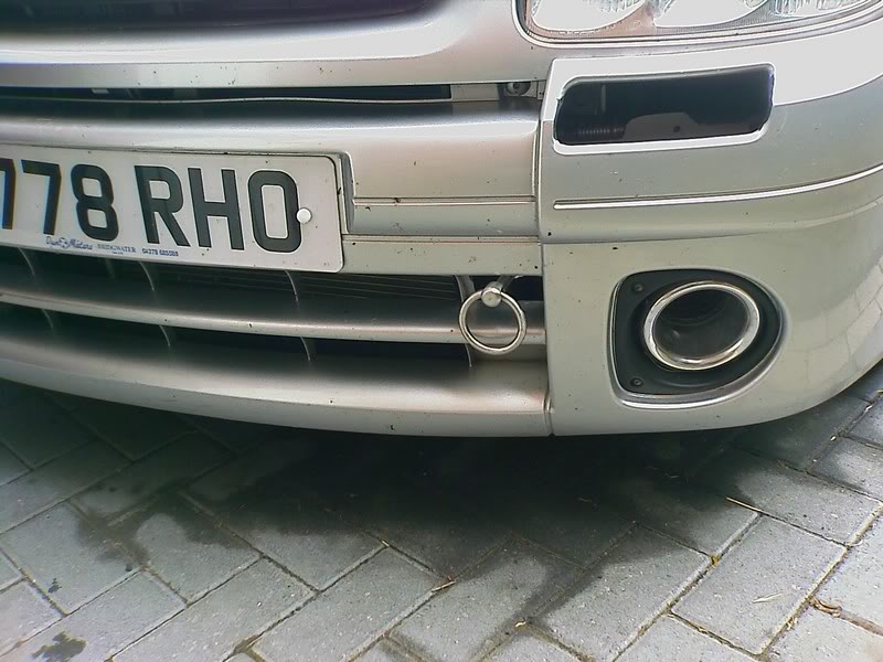

Bit of modification to the bumper to alow the hoop to pass through.
And its done...........
For around £12 and 1 hours work.
To those who say it WONT fit.
Use your imagination f**kwits!

jay - good work mate, i don't fancy cutting the bumper so must find another way, could you retap the hole so it takes the bigger thread?
  172 Race Car
omp is a smaller thread.
You could probably refit the bumper once you have modded the holder and pass it trough the bumper hole. then tighten the nylock nut from behind.
Personaly i couldnt be assed with having to remove it everytime i take the bumper off
Nafoff
i will be very rarely be taking the bumper off, is it accessible from the rear like justin or is it a pain in the ass also like justin?
  172 Race Car
pmsl^
Not sure mate, cars not here atm. the peugeot isnt done yet so the gf has had to drive down to the gym in it!
Lol, she hates it with a passion!
Could you not heli coil the thread ?
Having said that all you need to do is make up a thread reducer on a lathe.
Just a small collar , internal bore tapped to the omp size and the o/d would need to be threaded to the size of the renault tow eye using a dye.
  172 Race Car
aint got a lathe or a f**king clue what u just said.
