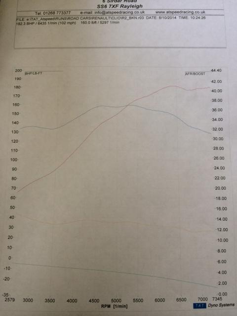

So it read at 182.3bhp @ 6435rpm and 160 lb/ft @ 5297rpm...
Always thought it was a quick one but that seems a little high to me? Either way I can confirm the timing definitely isn't out!
That does indeed seem high for a standard car but it's not about the numbers. What does the graph look like?

Although it's not heavily modified it's far from standard:

And it has also just had new injectors, new lambda sensor, new plugs, all filters replaced and oil changed so it should be fresh as a daisy although i still agree it seems high.
I'll stick a picture of the graph up later, seem to have misplaced it already somewhere.

Anyway here it is, mrs filed it in her bag. Not great quality:
Red bhp, blue torque, yellow AFR.

Alright alright, I was only having a laugh! Hopefully from that, one of the specialists should have a decent idea if it's peaking correctly etc.
