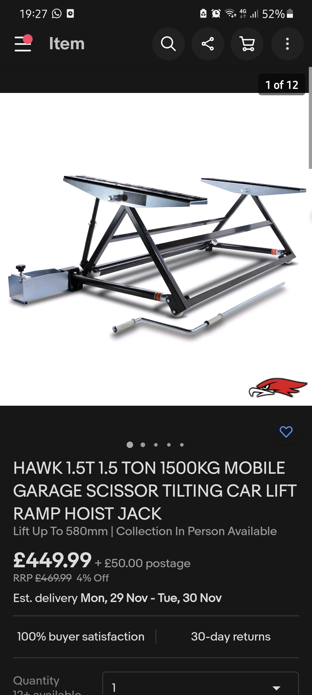

Nathan105e
I aren't sure what your budget is, a mate of mine has a set similar to this and we've Done some decent jobs on it!
i have one of there and struggle to the list the Front end up, always lifts the rear of the car. Am I doing something wrong? 😂
Nathan105e
I believe some tilt and pivot and don't actually lock. So it's a case of lifting up, sticking an axle stand under the subframe or axle for the ones that pivot, don't blame me if doesn't work though 😬😂

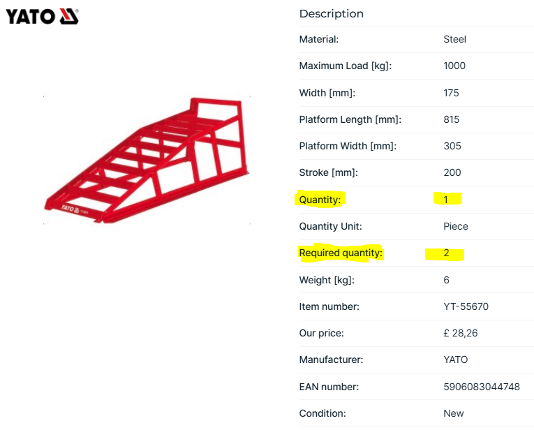

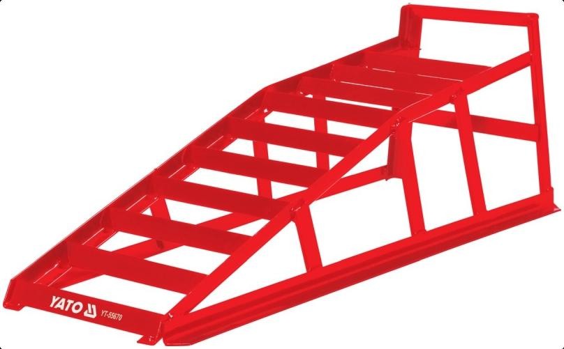

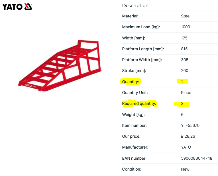

Thought I would chuck this on this old thread, rather than make a new one. I just ordered these ramps from Autodoc, they are currently £28.29 on the app, which I thought was pretty cheap:
www.autodoc.co.uk/yato/16371451
Will need extension ramps (or bits of wood) to work with the Clio, or virtually any non-SUV modern car.
If they're s**t I'll update the thread.

I'm reading that link as £28 each, is that right?
I just got back from holiday and my ‘Car ramps’ had finally arrived in a huge box. I get one out and unravelled it from the 200 metres of packing paper then went to remove the other one…oh.
So yes, the price is for one, which explains why they’re cheaper than Halfords. Currently £22 though so about the same at the moment, and the quality looks good.

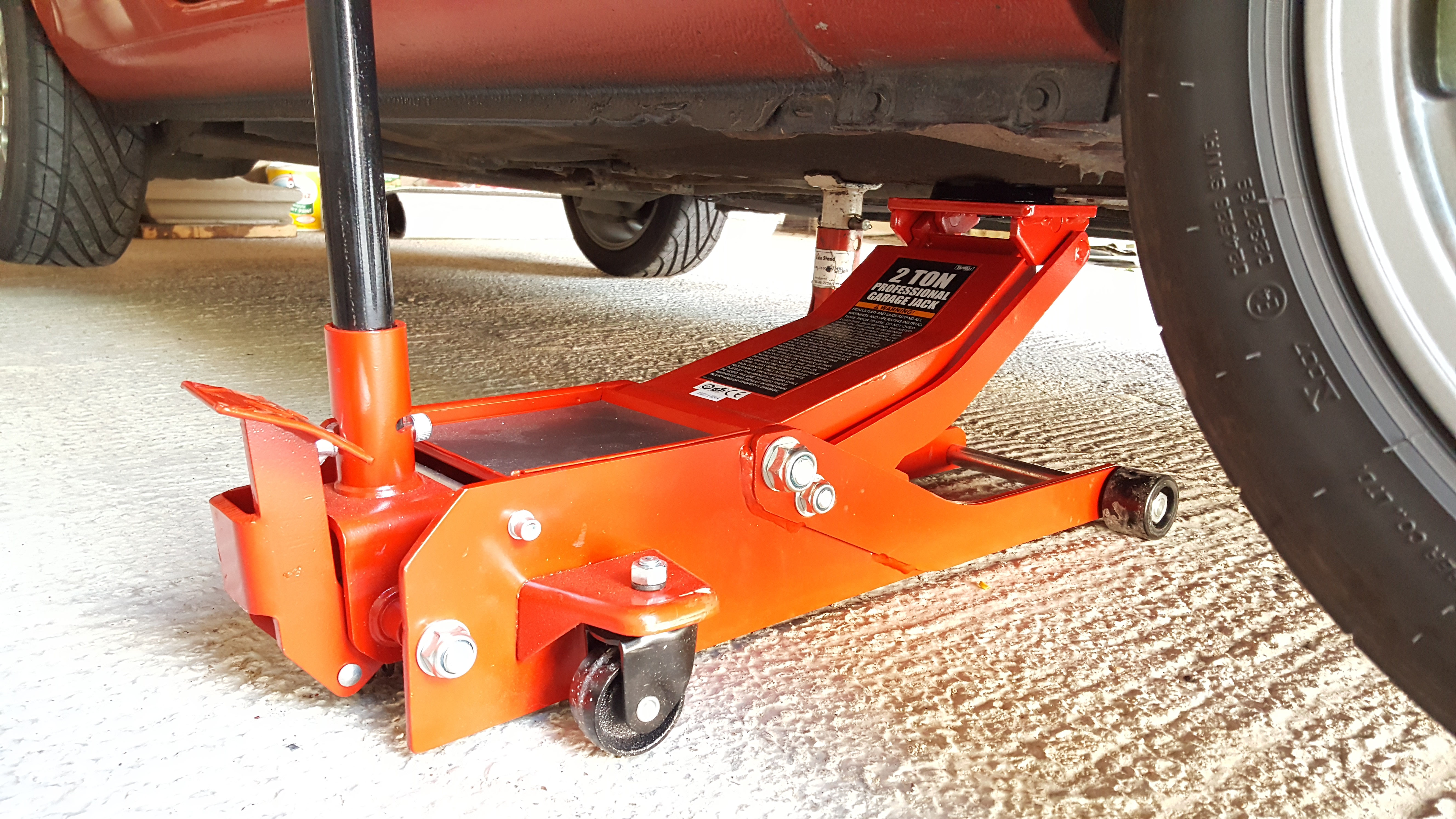

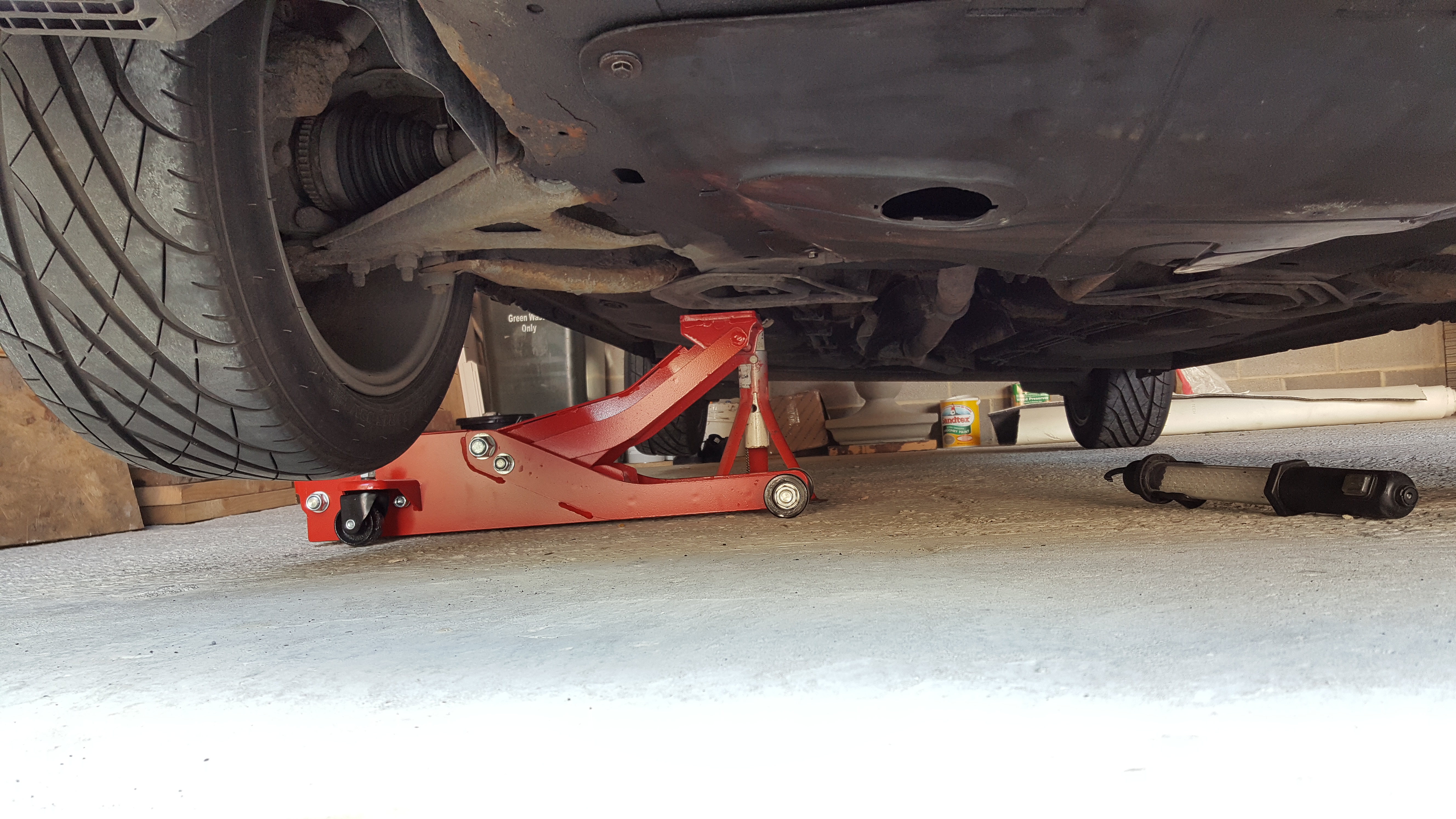

Axle stands over ramps all day long. Way too much aggro getting a lowered car onto ramps and then usually in the way.
Best thing you can do is buy a low profile jack with 100mm plate. Safe and can get to the chassis rail underneath so no need to wreck the sill.
  Renault Clio 172 Cup
I have a trolley jack that fits under the sills and axle stands. The reason why I hate jacking the Clio up is due to the soft sills, I use a slotted hockey puck but they still get bent. Whereabouts do you put the jack on the chassis rail? And then where do you put the axle stands?
Brigsy
  T.Turbo
Use the box section as pictured here and axle stand next to jack. Its solid and a proper low profile jack will reach it no problem on a lowered clio.
