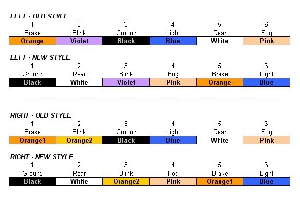

Changing Mk2 Ph1 rear light cluster to Mk2 Ph2 type
Picture courtesy or fubar ( i think!)
Great little guide, used it myself and works a treat!
cheers av done that but now i have a few problems
the interior light keeps on and the 3rd brake light is dull?
sorted interior light but still dull 3rd brake light all connections seem good and put some extra earths of both sides?
did you guys just chop and reconnect the wires or can the connections be pulled out and slotted into the new relevant point?
