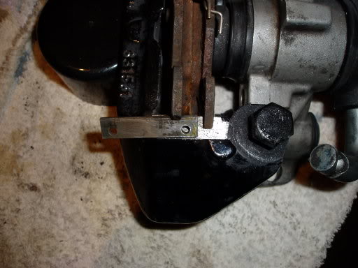

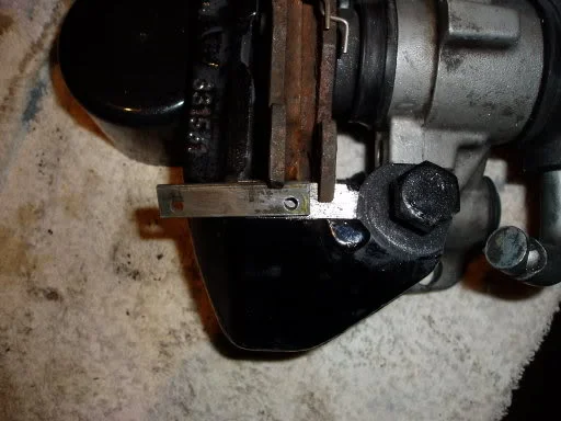

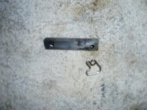

You need to remove the clip holding in this metal bar which holds in the pads , then tap out the metal bar .
Undo the cap on your brake fluid reservoir the wind the piston back into the caliper , clockwise .

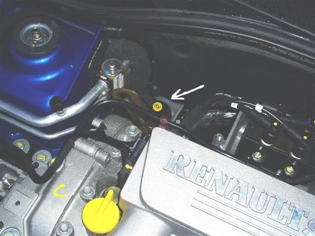

Take off your engine cover to gain access to your brake fluid reservoir .
