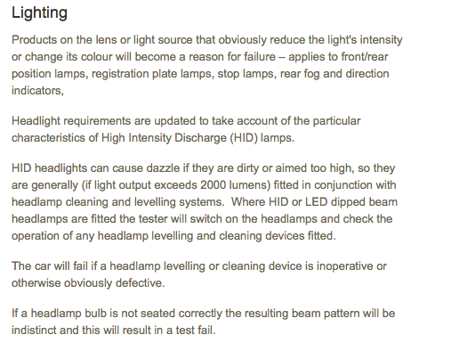

http://www.theaa.com/motoring_advice/car-servicing-repair/mot-changes-2012.html?affiliate=85386
loggyboy
Just to re-emphasise the above
The MoT manual states:
Vehicles equipped with High Intensity Discharge (HID) or LED dipped beam headlamps may be fitted with headlamp washers and a suspension or headlamp self levelling system.
Where such systems are fitted, they must work; however, it is accepted that it may not be possible to readily determine the functioning of self levelling systems. In such cases, the benefit of the doubt must be given.
