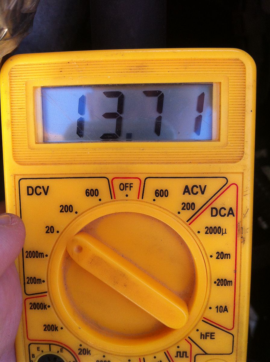

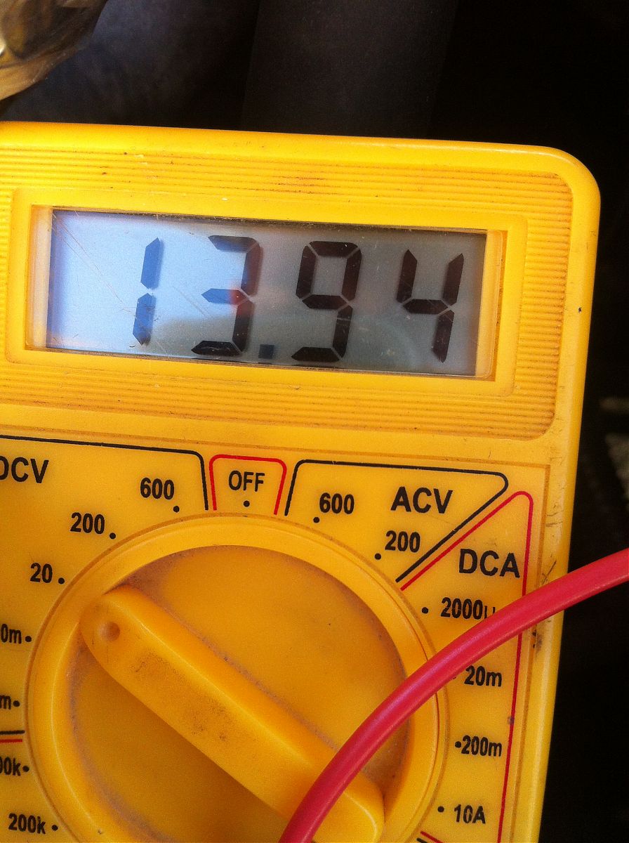

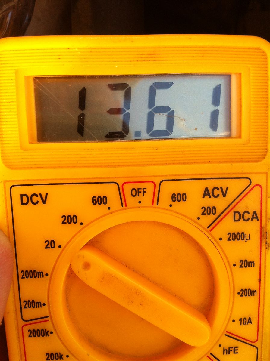

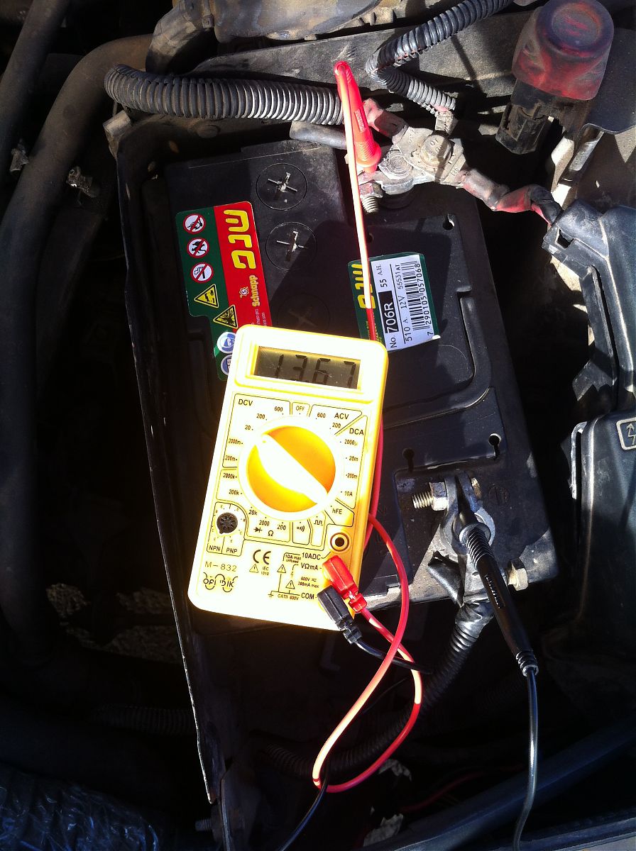

i managed to fix the problem during lunch brake from work,
i went to the car, opened the hood and started to Tighten all postivie conection that i saw. Especially on alternator and battery.
now its all perfect : on idle > 13.95+-
with lights on idle > 13.7+-
with lights and amp > 13.6-13.5+-
with amp sub and lights
only with lights
