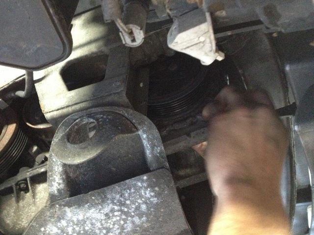

Above, old compressor coming off.

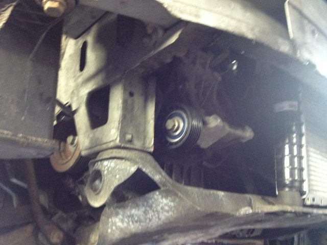

Ac / alt bracket pulled forward so you can see the new pulley bolted up.

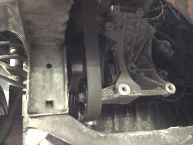

New belt mocked up so you get the idea etc.
