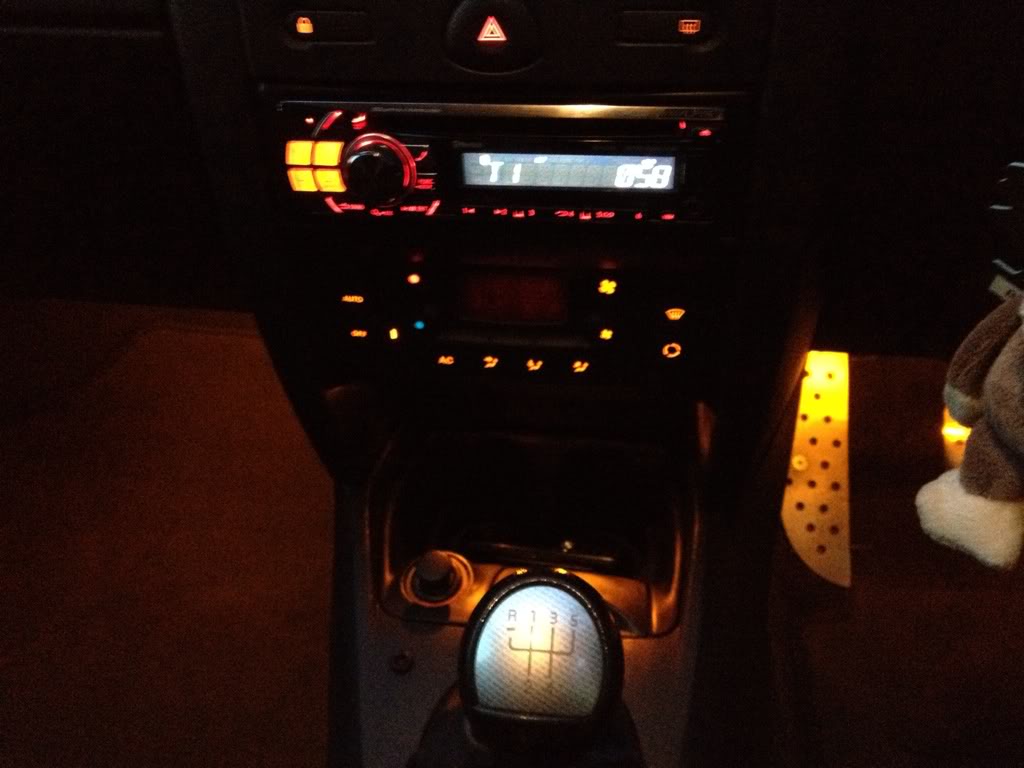

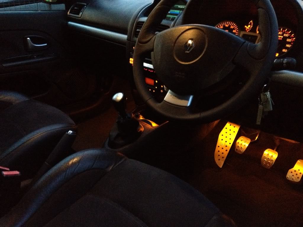

Done mine the other day wired them to the cigarette lighter ;) two led strips in the footwells and two 3mm LEDs in the cubby hole for the cup holders
