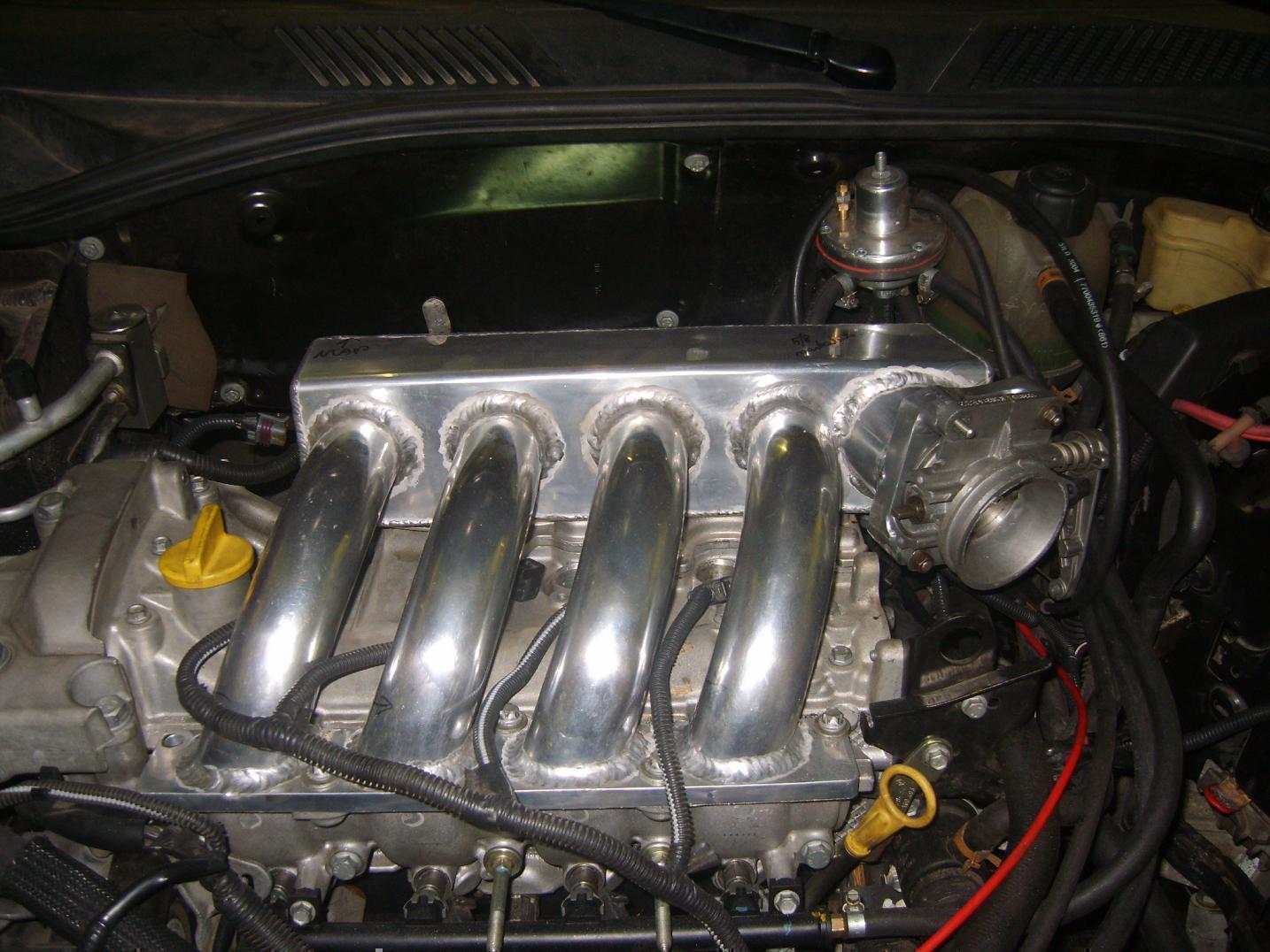

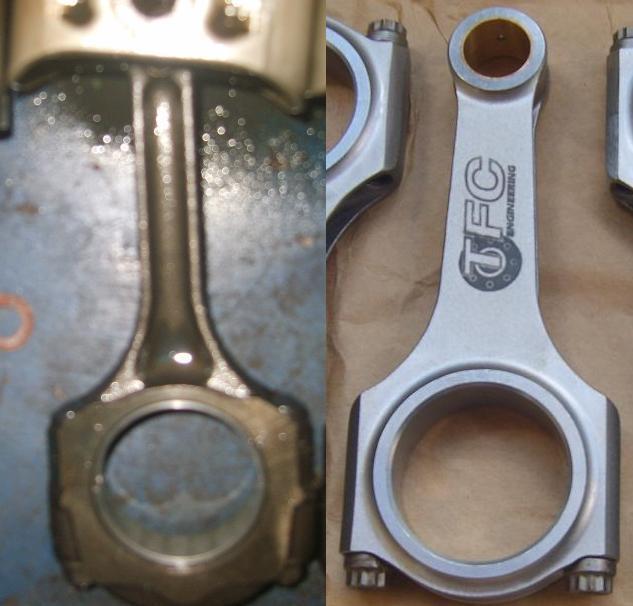

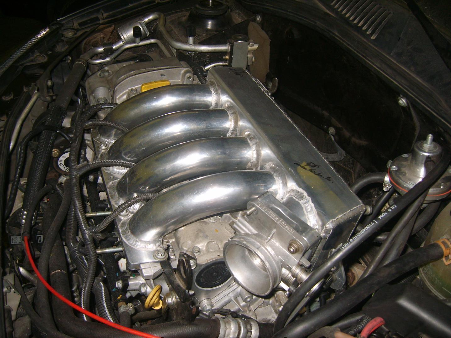

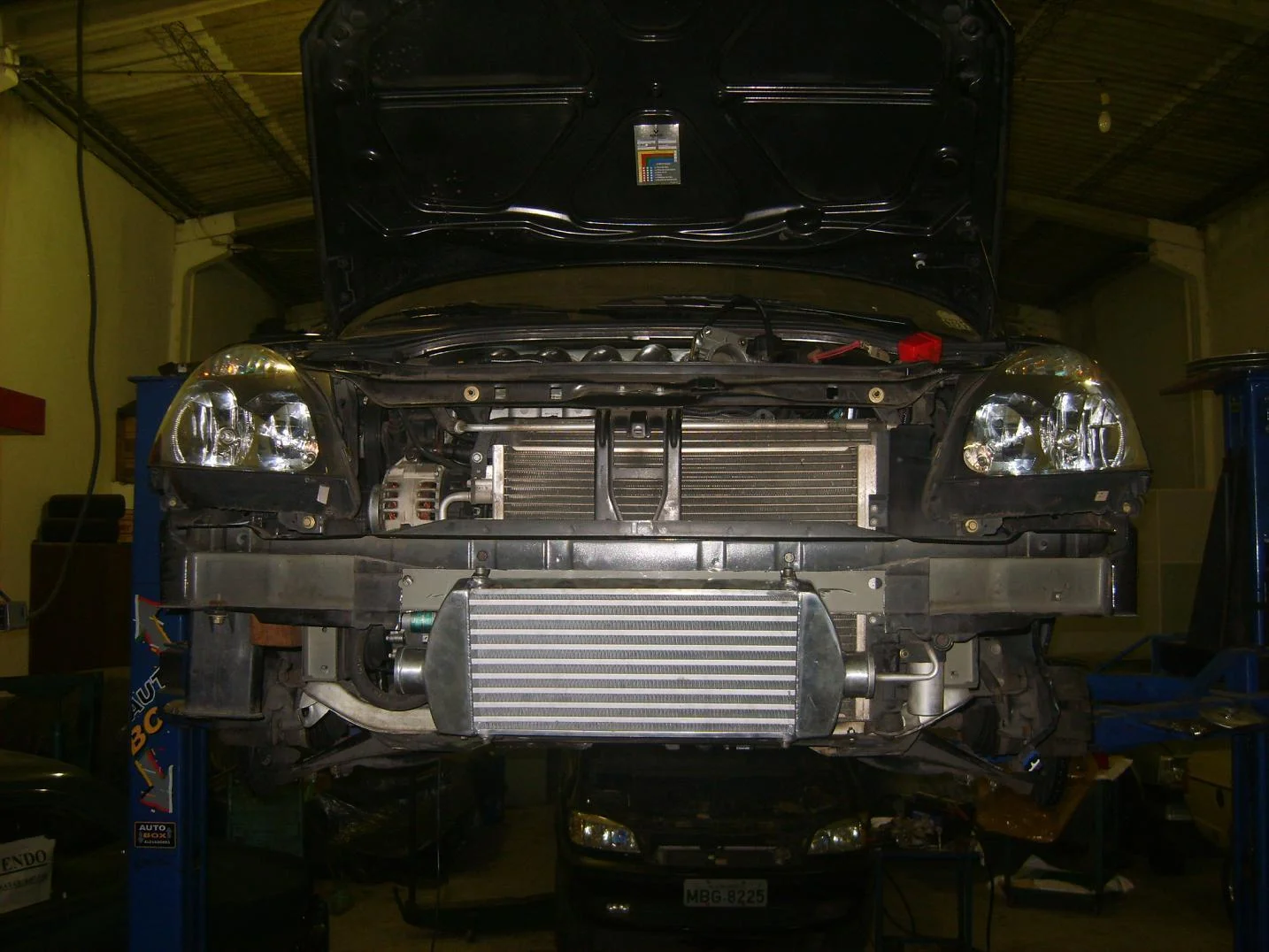

Hi guys, i'm from Brazil. First, sorry by my dab english. I had many turbo cars, all made, not original thing. Its a K4M engine with pistons and rods forgeds and use 0,7bar of pressure, but soon more pressure will come, with aluminium admission collector. After that, the car will pass in dyno, all filmed, and i share the results with you.

Excellent car mate. Realy interesting. Would you consider a gearbox swap? The ratio's seem a little short i.e. you can't reach 100kph in 2nd and your getting towards the limiter at 210kph in top gear.

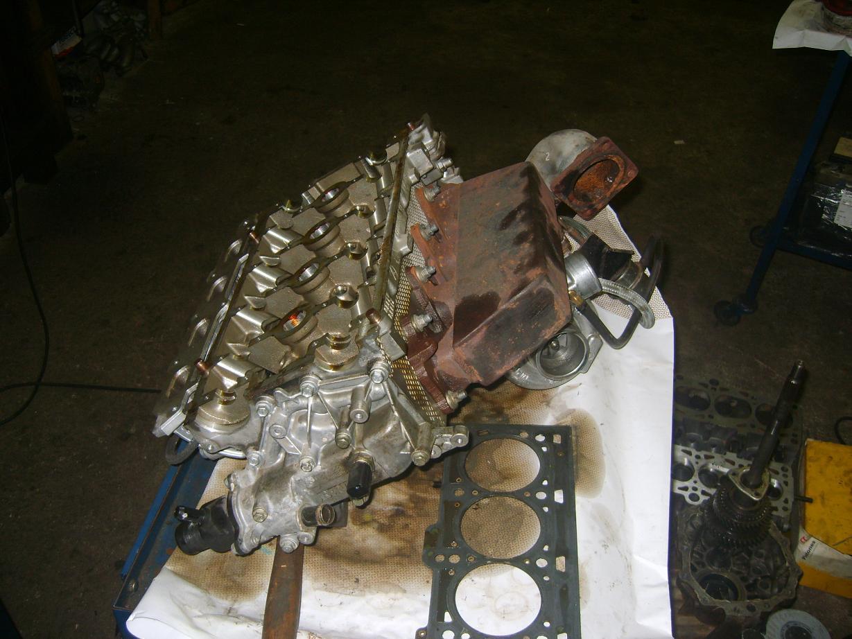

Nice conversion, but I´d like to have a better view of the exhaust manifold. Is it casted, oder welded? Or is it the OEM flange with a plenum welded on the flange?

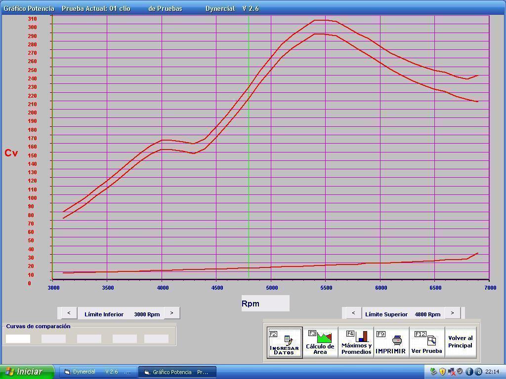

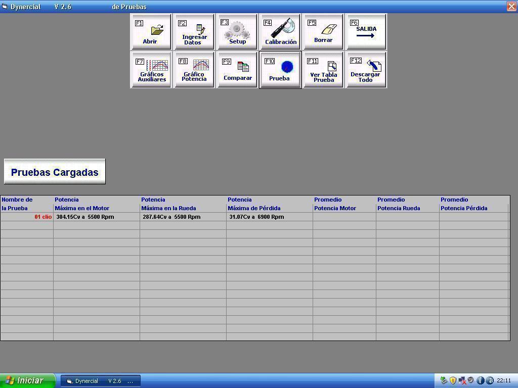

Some new pictures. The Stage 2 its done :evil:. 1.3bar of turbo pressure, the car is real good. Its go to the Dyno real soon. The result and new videos i will post here.
