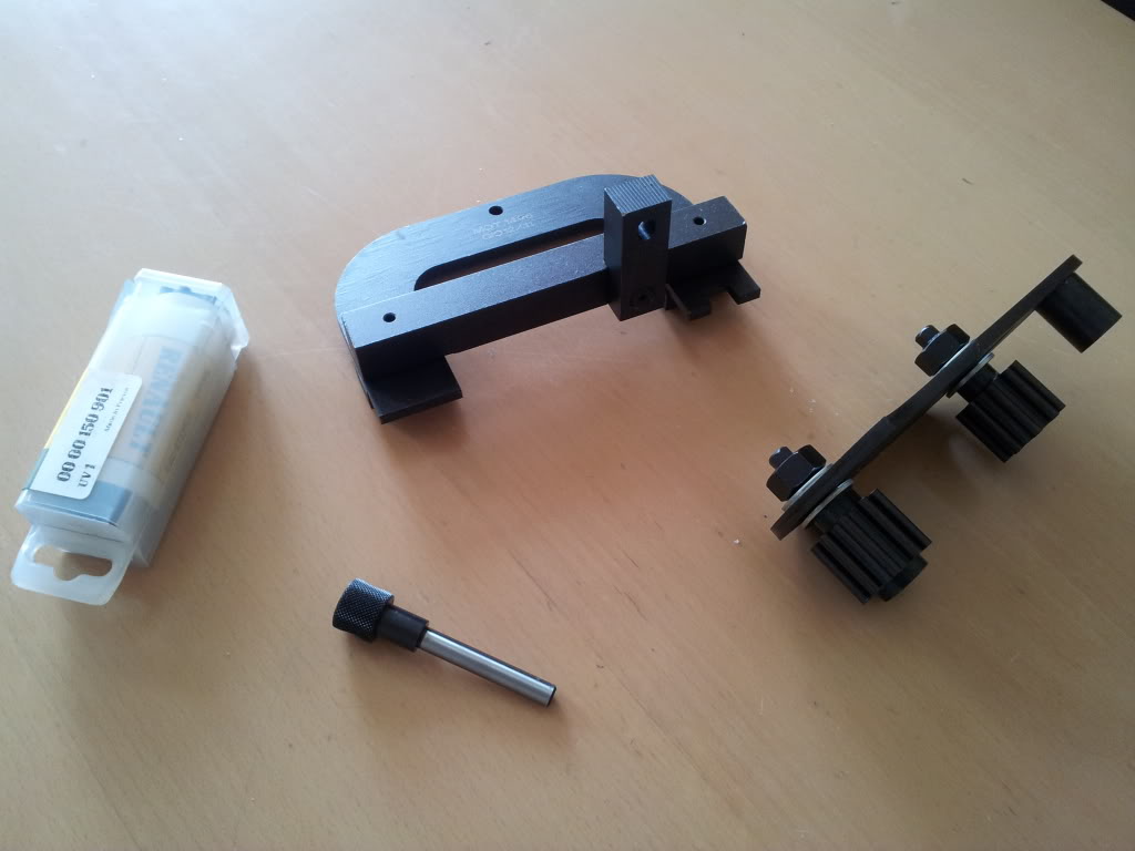

The belts are not exactly rocket science (no different to a zetec se engine in terms of floating pulleys) but it is vital all the correct tooling is used, I've done one today funnily enough.
There is a picture of my tooling, all genuine which is also a must. If all of these haven't been used the correct procedure has more then likely not been followed and the timing will be out.
Due to the Floating Cam Pulley's and Crank Pulley, the timing could be off by any number of degree's not whole teeth.
As said before it's vital to use cam pulley locking tools when tightening the pulley bolts/nut or the cams will likely move, or sometimes actually bend the cam locking tool/bust the slot in the end of the cams.

Also (just for info purposes) it's not as simple as just putting the genuine tooling in, changing the belt, locking it up and removing the tooling. When you do it like that it's probably a 95% chance the cam setting bar will not re-engage without some persuasion.
We've had one in recently that was done by a main dealer and they not only got it wrong but they damaged the cams bending the setting points in the process so timing that up is now impossible without replacing camshafts. Starts fine, idles and drives fine but does run a tad lumpy and rich.
  182/RS2/ Turbo/Mk1
Agreed. Takes a bit of practice to get a feel for how to position it on the bit of play it has so that when you've turned it over and come back it then settles and lets the tool pass in and out with little or no resistance.
